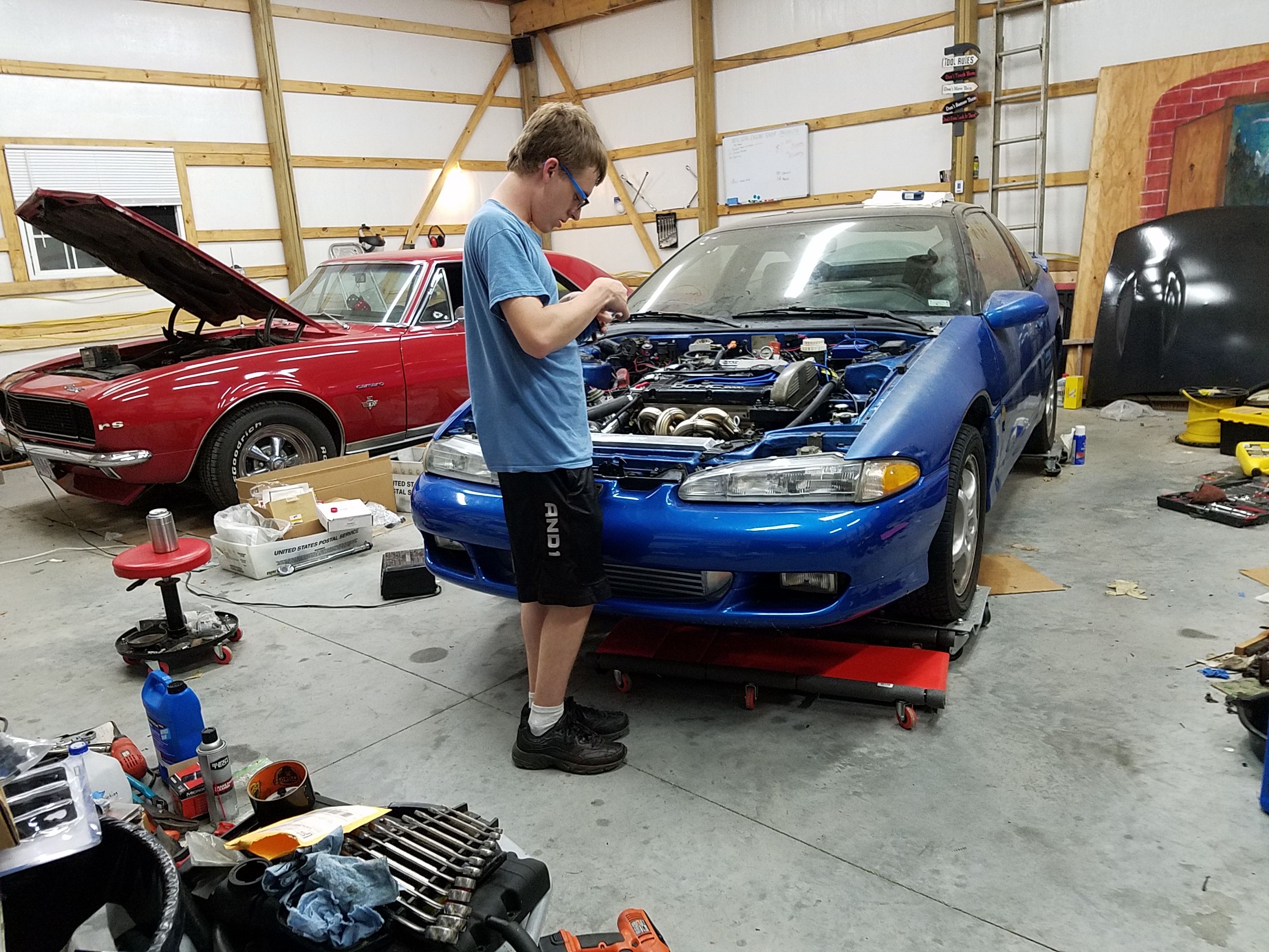

Well.......after how many months now????
I have oil pressure, I primed the new engine by pulling the fuel pump relay and then rolling the motor over several times with the starter without any sparkplugs in it. After the 3rd starter roll, the oil light went out and my digital oil pressure guage said "3", so I am primed. I have to get over my old man back syndrome and then put the plugs in, wire up the Arc2 box positive and negative and plug the fuel pump back in and I should be ready for.............
FIRST START.......
Everyone hold your breath and say a prayer to the DSM gods for me.
More very soon I hope!!!
Thanks for following along for so long!
Marty
