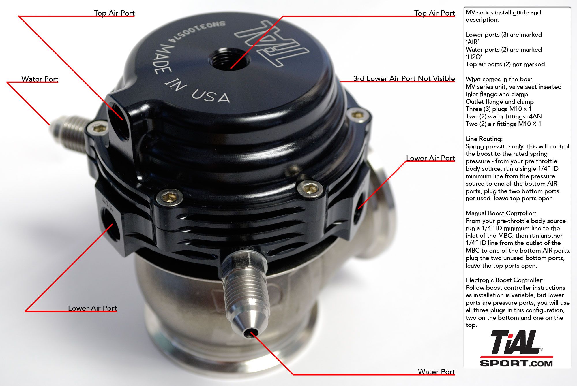

Are you saying you only use the top port on the wastegate?
How would that work? any pressure to the top holds the valve closed. I am confused how that would work.... I have run only the bottom port, but never the top only.
Here is how Tial says to route hoses: (am I still just confused? top only sure does not seem right)
Yep that's what I did on the red car and the TAIL 38mm. It worked fine with a bleeder valve for upping the boost from gate pressure. I guess that's why I plumbed the blue car that way to start with. I have some other gremlin tho, just haven't found it yet. On the red cars gate, I didn't have a ton of springs in it so I would bleed off any boost source to get the boost I wanted. I even had the control mounted under the dash where it sits today. May not have been right, but it sure worked good.

Okay if you were running the top only, you were holding it closed with boost and letting pressure bleed off to limit boost. That means the only driving force to open the wastegate valve is the backpressure caused by your turbine. While that may work out, entirely coincidentally, it is not correct. I think you got pretty lucky getting it to work that way.
Sounds like improper hose routing is your issue sir.
it could work on one setup and not another because the turbine drive pressure versus boost pressure changes with the setup....
Well, I pulled the line off Will and I got it to go up a pound or 2. But theres something up if I can run NO BOOST SOURCE and run only 35lbs. Hell I always ran boost to the top hat to hold it closed then bled it to make more boost. Maybe that wasn't right but it worked on the Red stick car. I tried bottom ports both ports and finally FULL SEND. It must be something with the gate in my opinion.

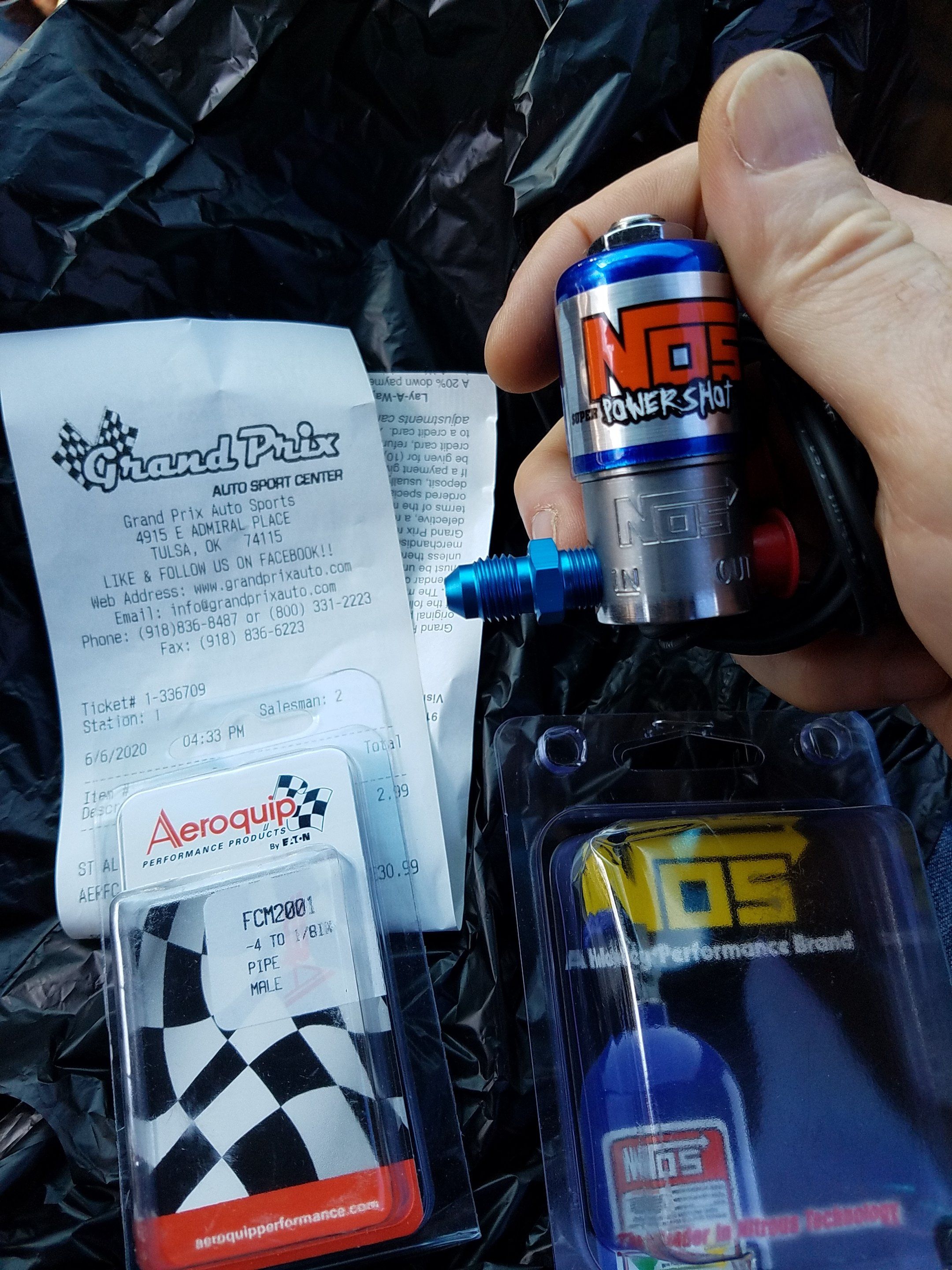

The bad news, the new NOS valve is LEAKING ever so slightly so I'm thankful that we tested first. The purge, well I just had to do it for shits and "giggles"!!! ROFL

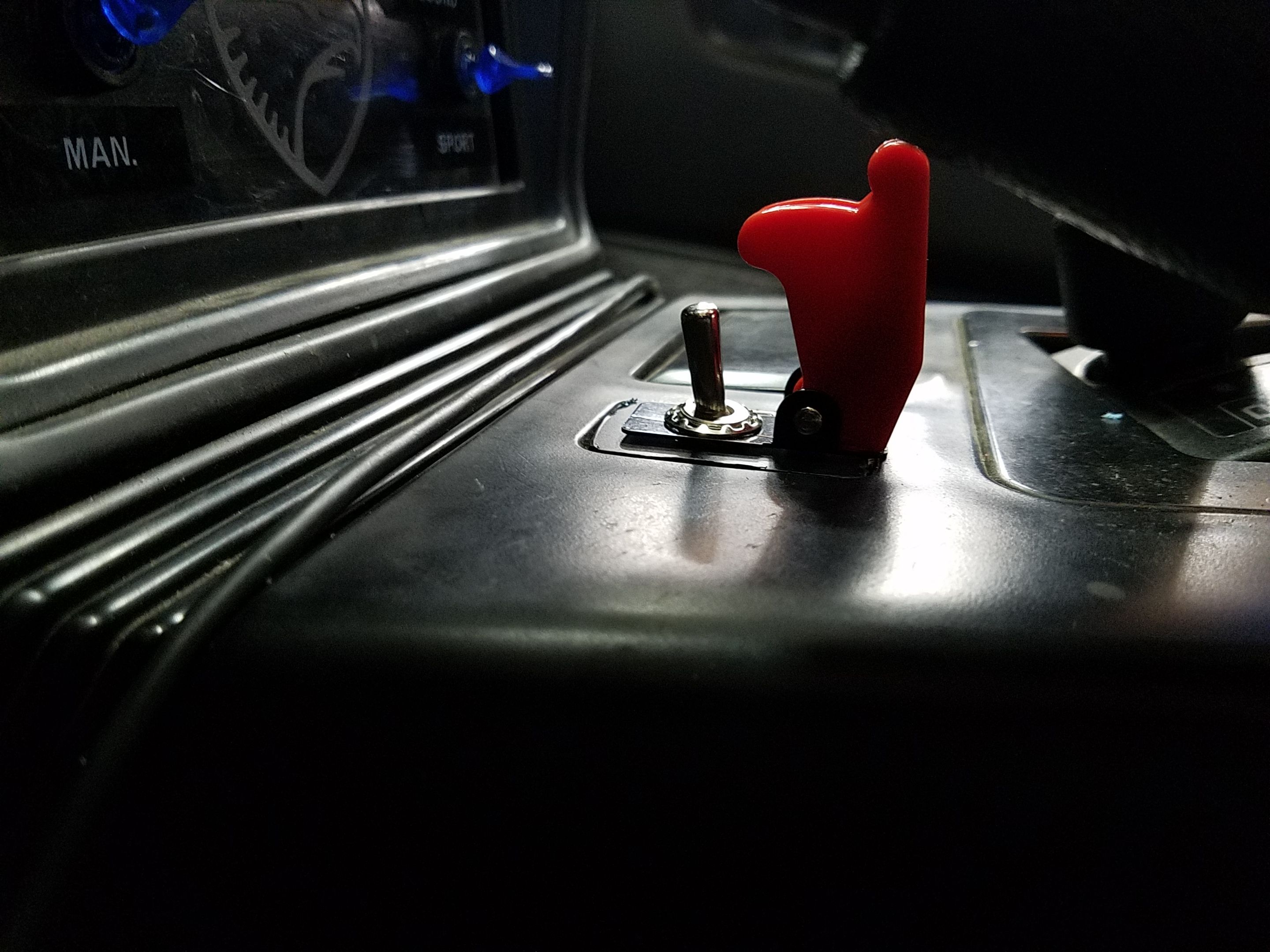

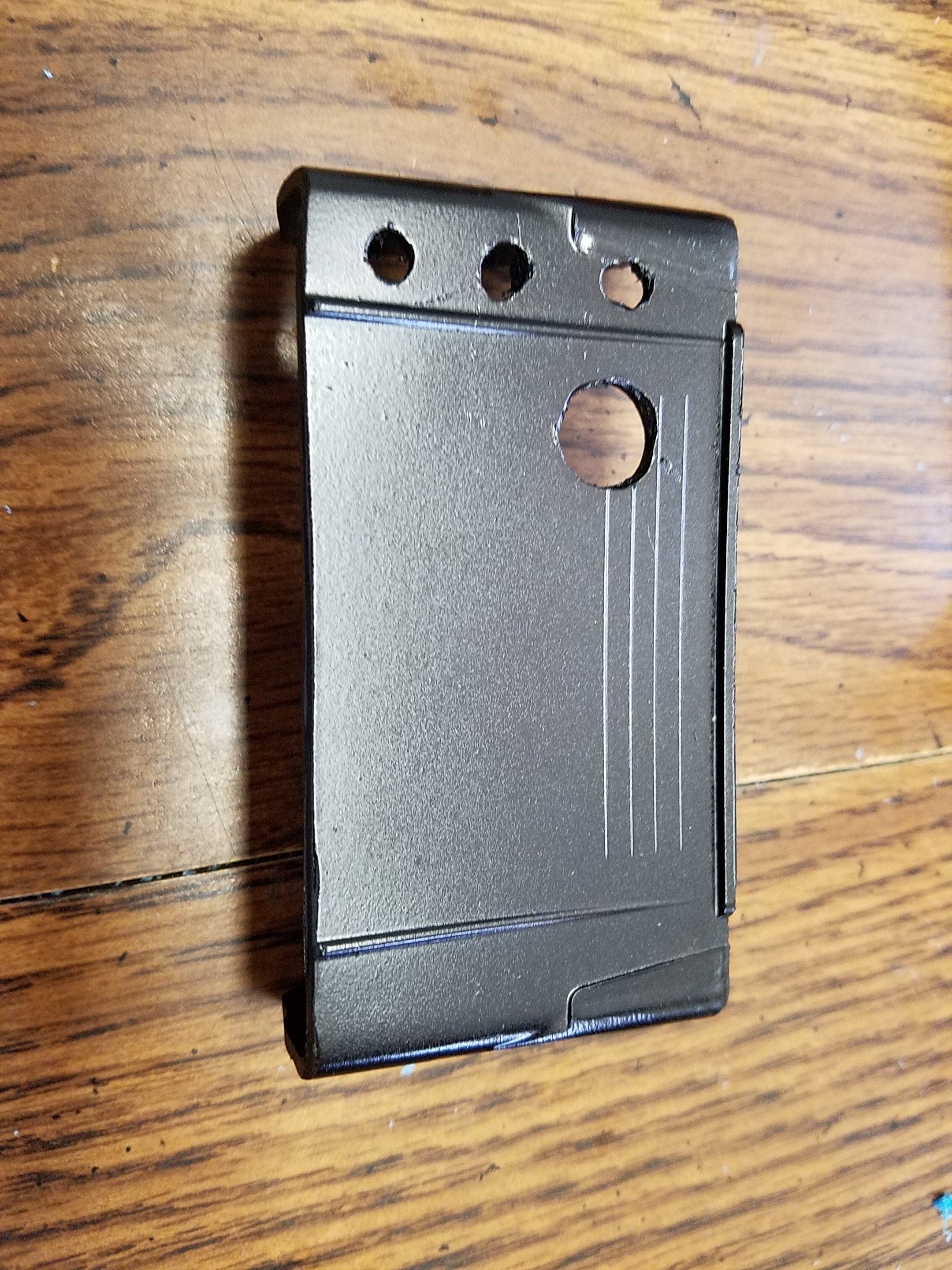

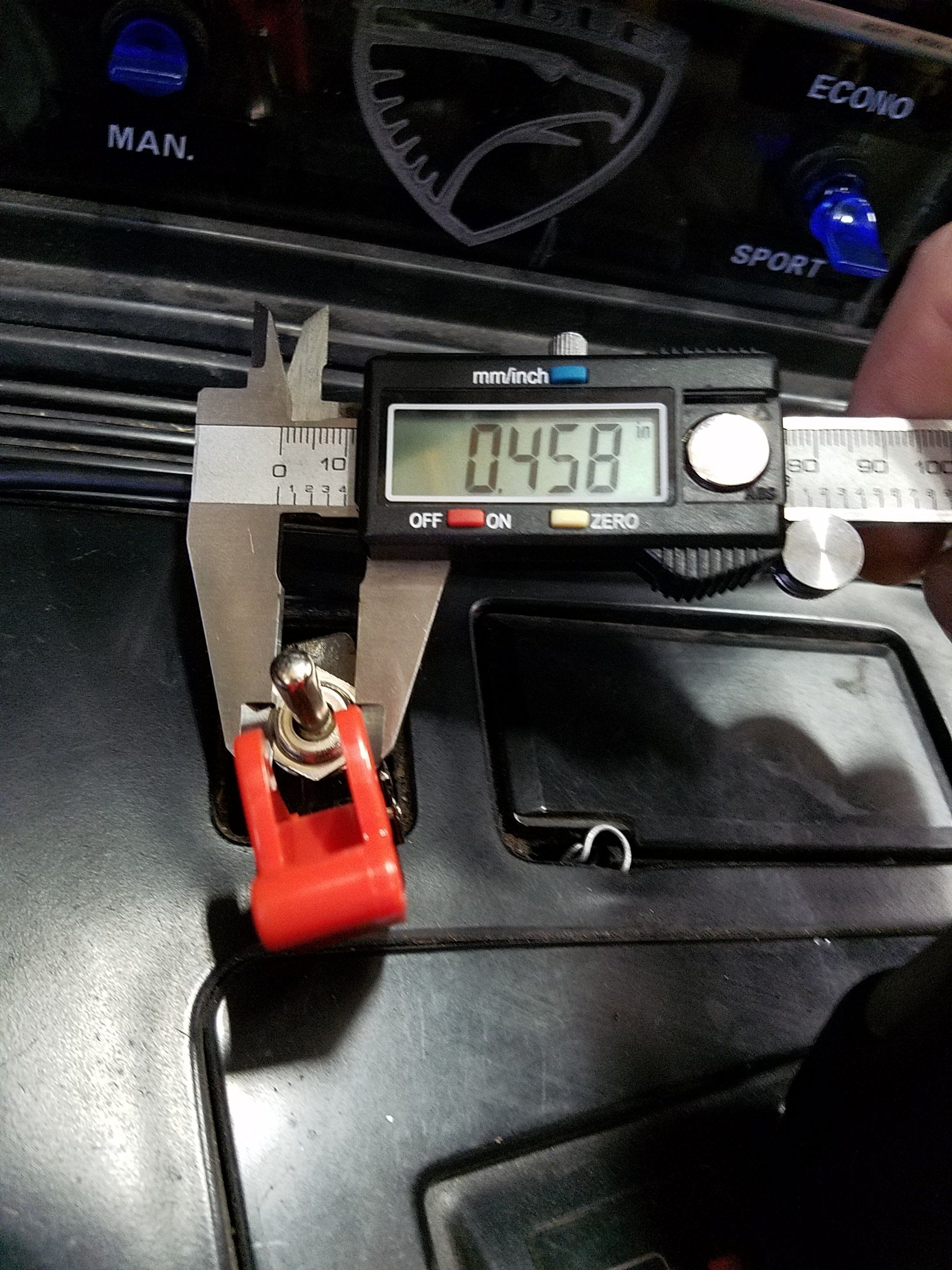

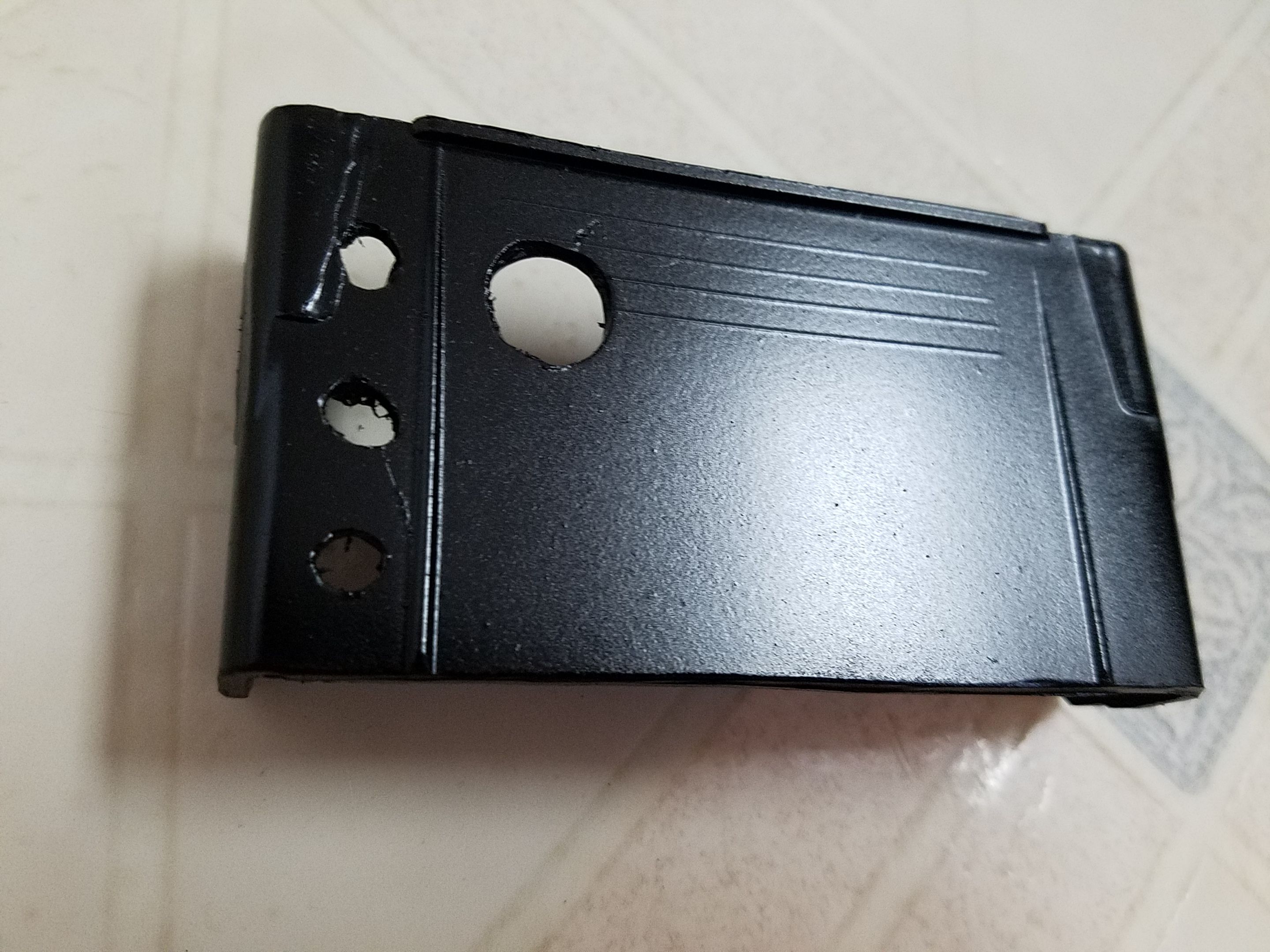

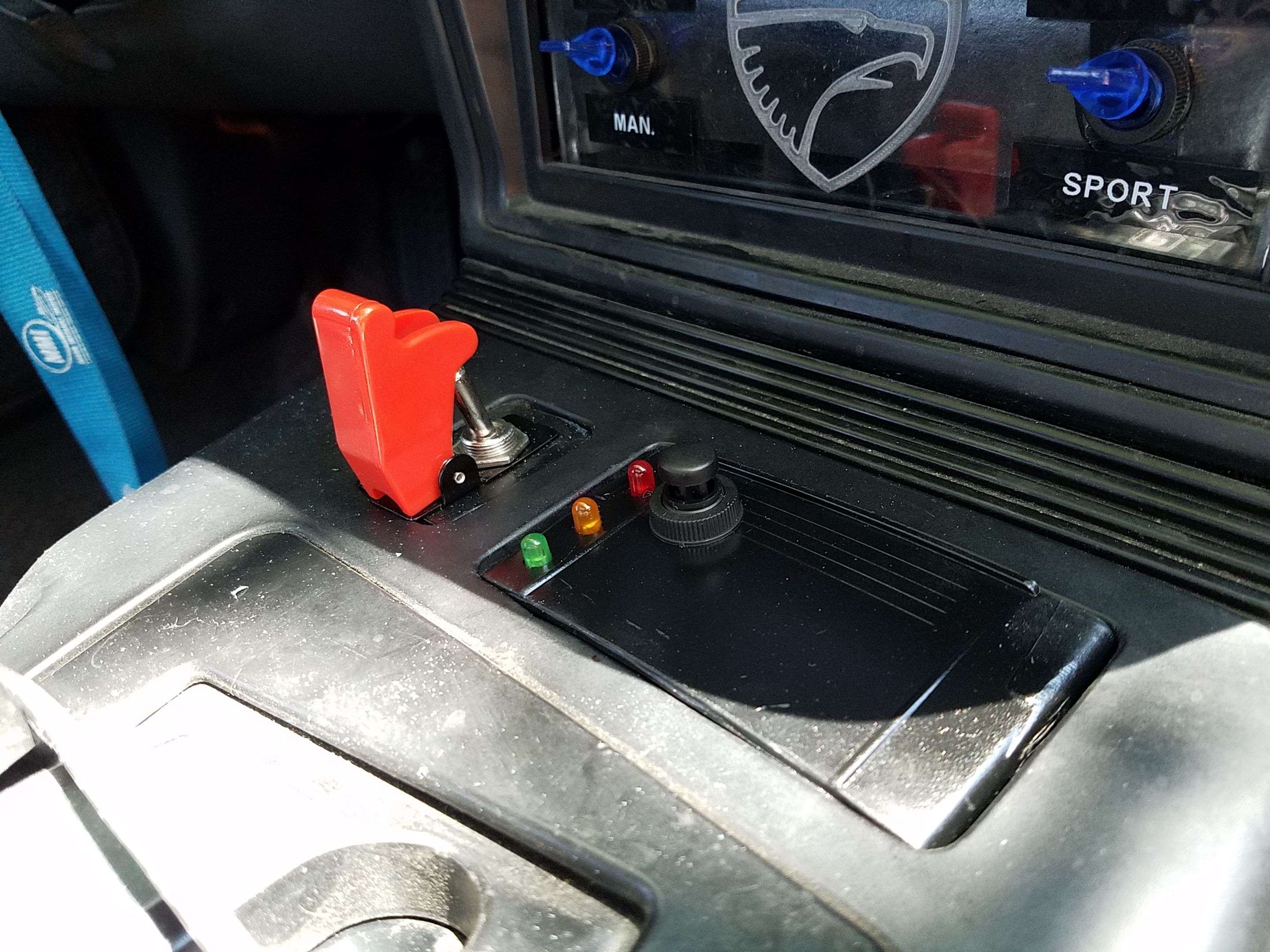

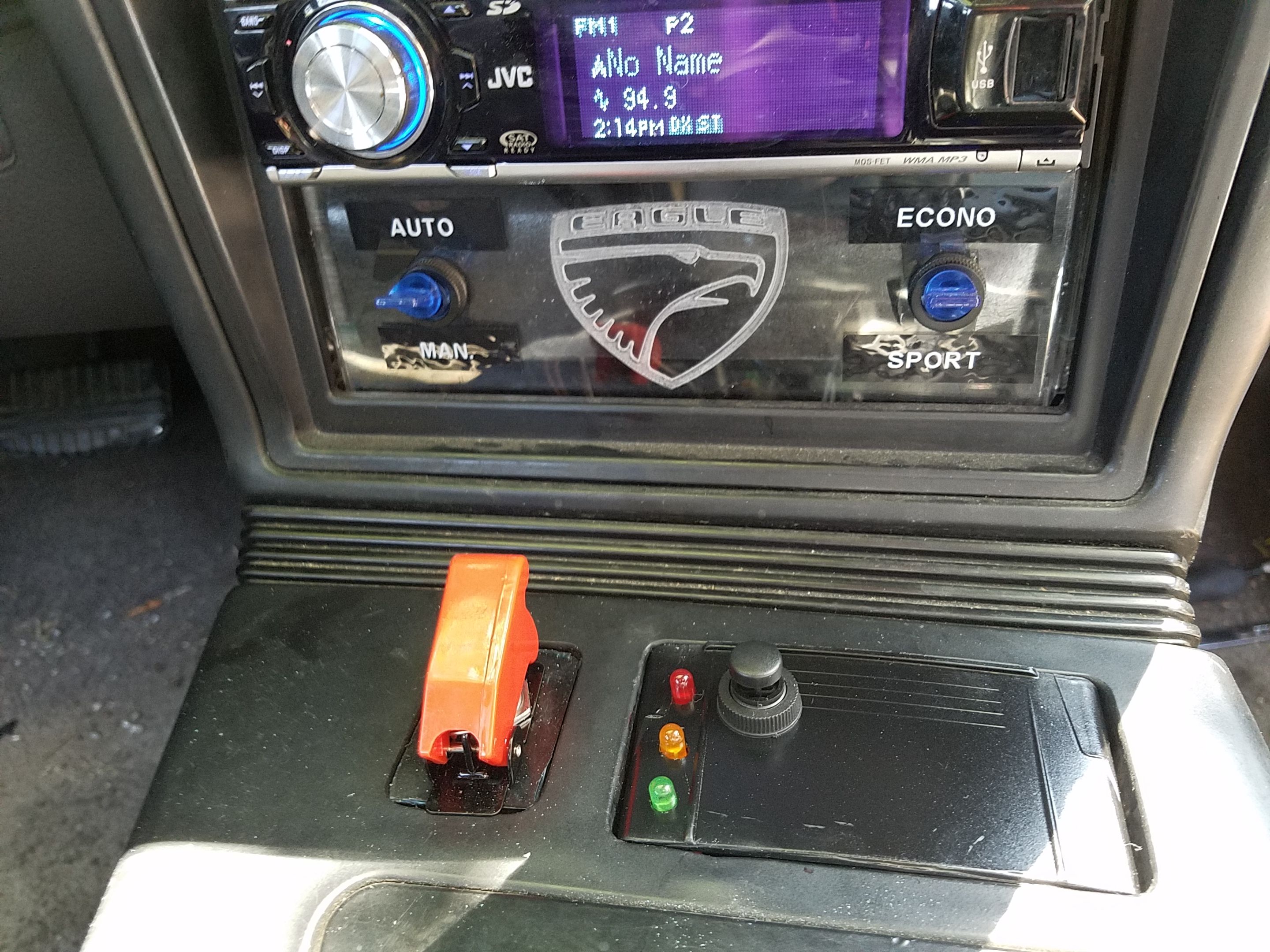

Making a template for the old Pwr/Eco switch spot so the Arming switch will go in its place.
Letting the paint dry on it and then I will see how to hold it in.
More to come!
Good place for a remote bottle opener!!!

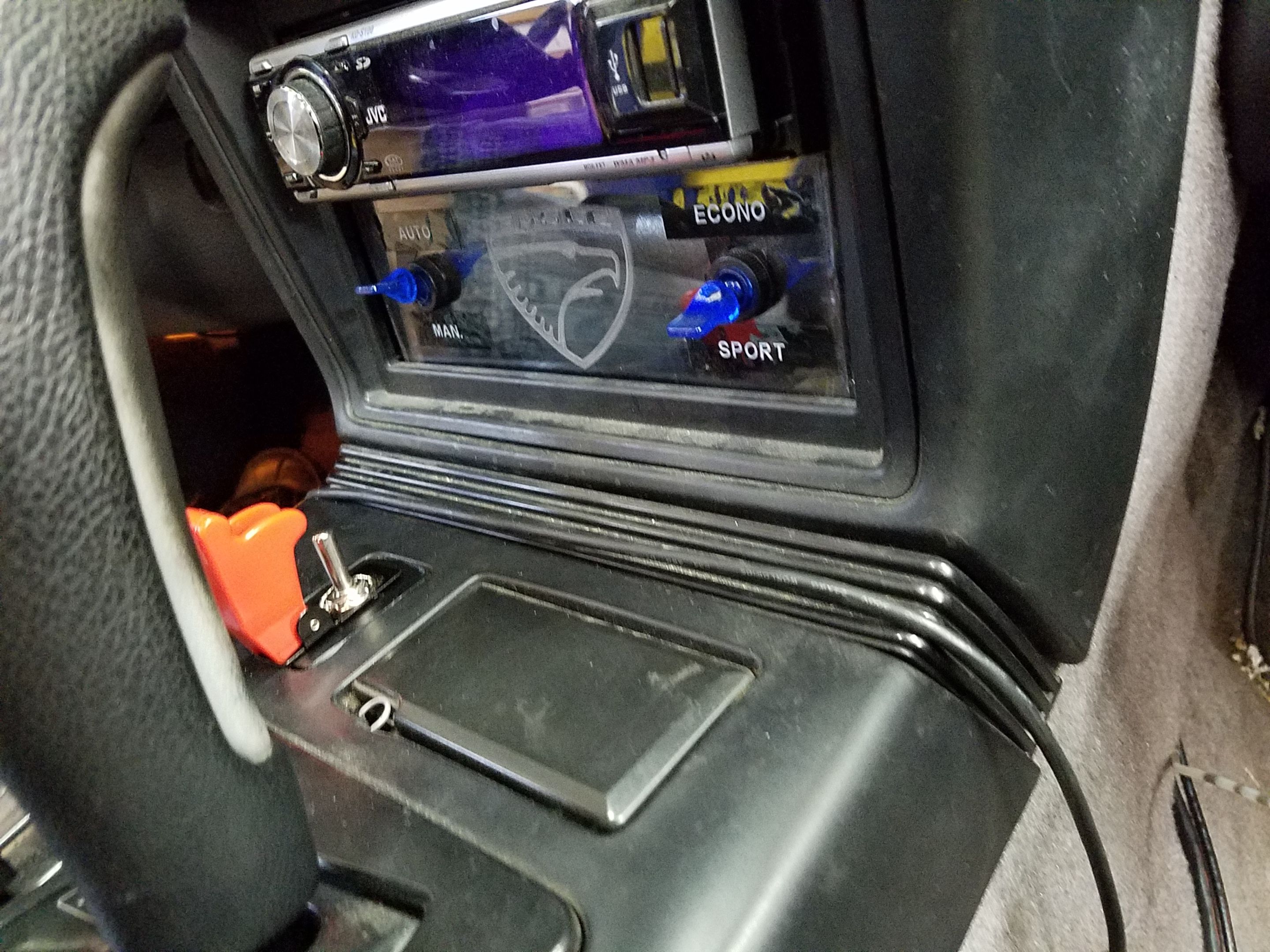

Just for those who get a kick out of switches and gadgets, when the Arm switch is OFF, my pushbutton on my steering wheel operates my EBC to hold it open for MAX boost if needed. Also made the Arm switch kind of failsafe so if you reach forward, you turn it off like in an emergency.

Just came from the speed shop a hr away to get a new NOS solenoid. Gonna see how it all works out but high hopes!
Big Thanks to Grand Prix Auto Sports Center in Tulsa OK for having what I needed on the shelf!

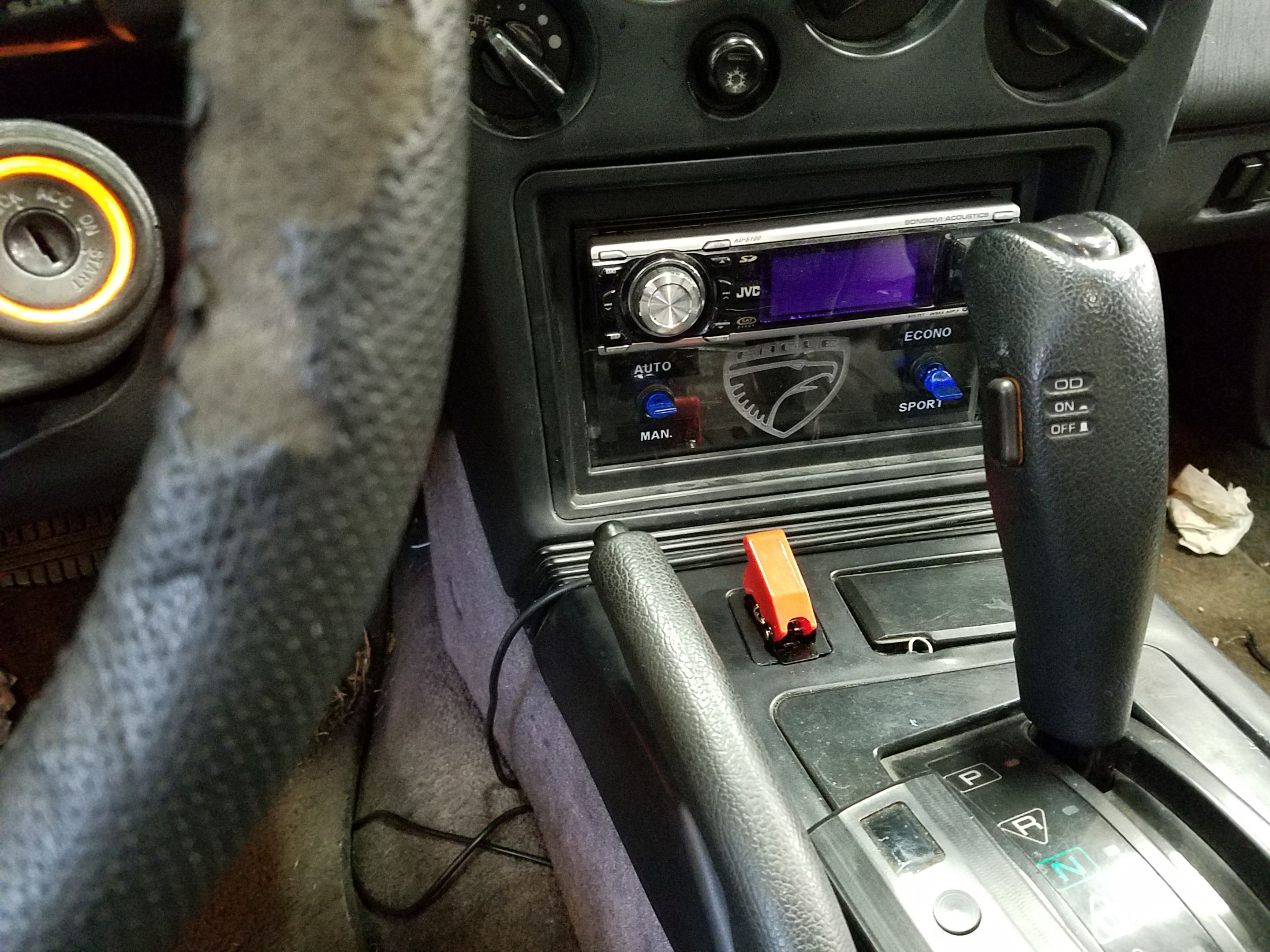

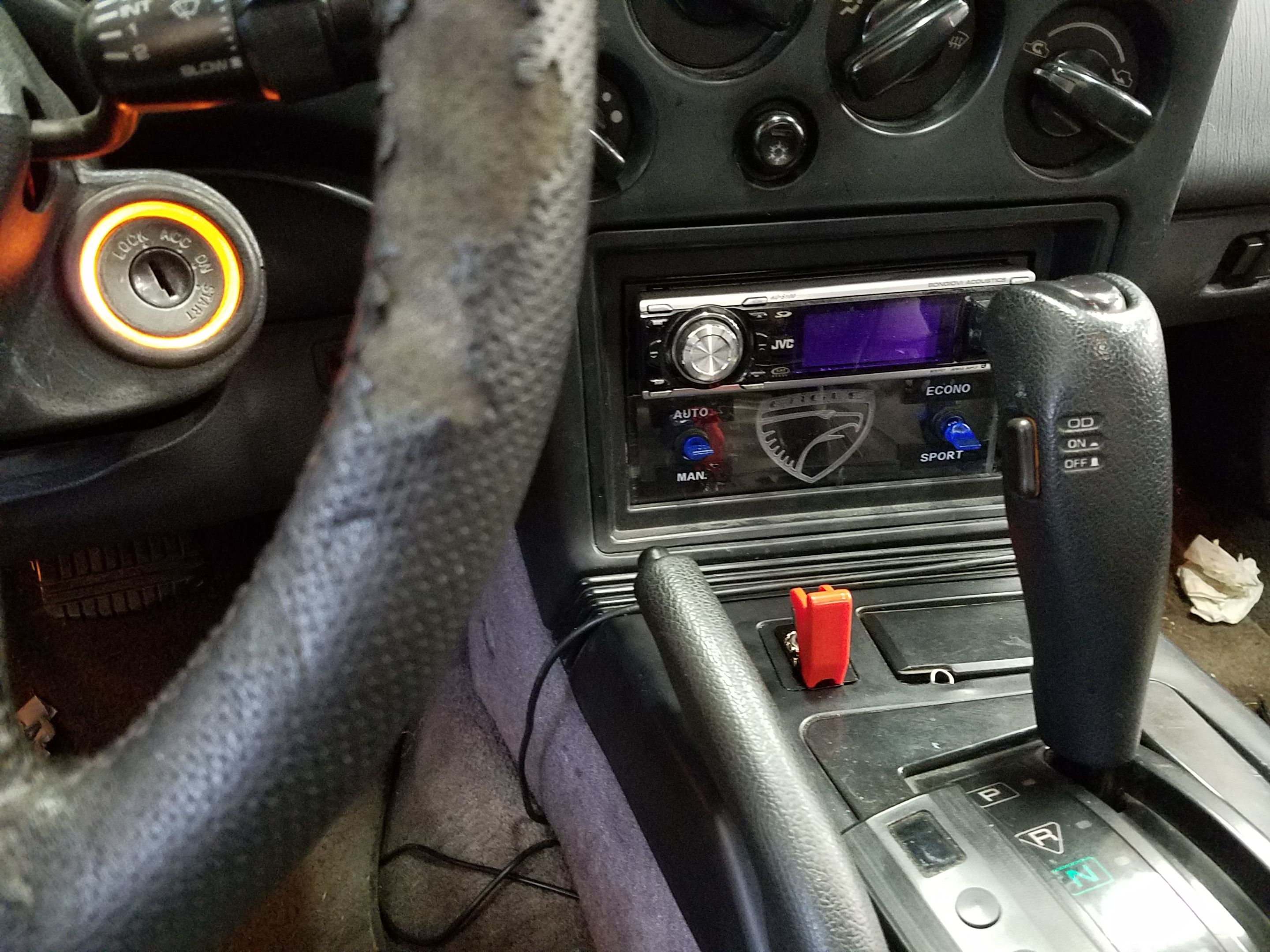

Semi installed Arming switch. Going to mount an LED somewhere to let me know POWER is on just in case I forget.

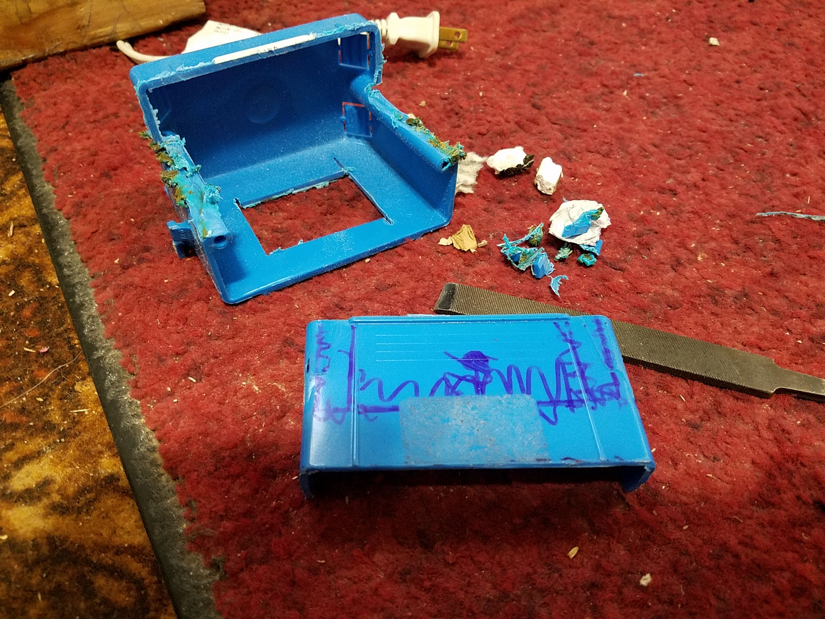

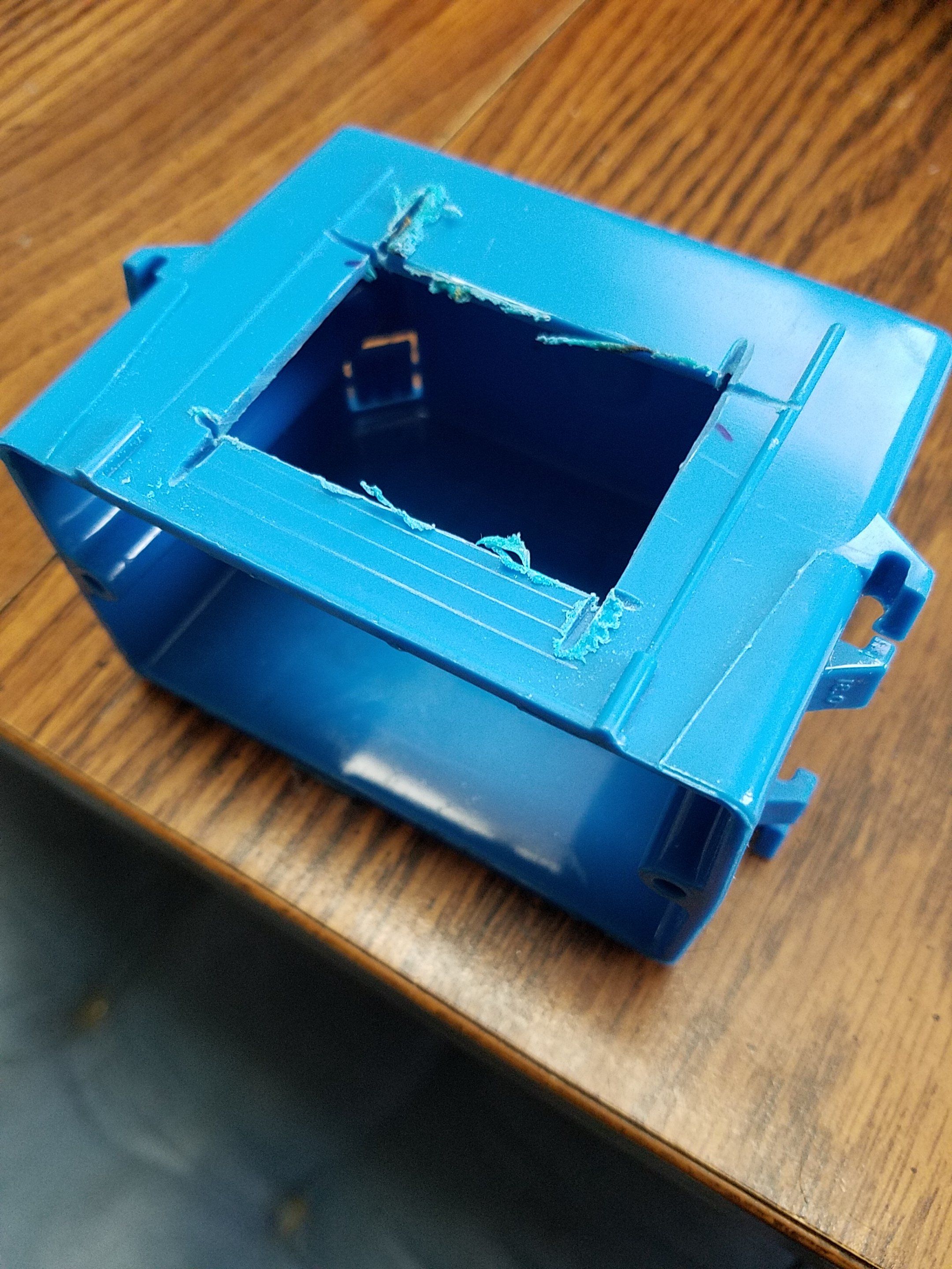

What did I make the plate cover out of????
This....ROFL :shhh:

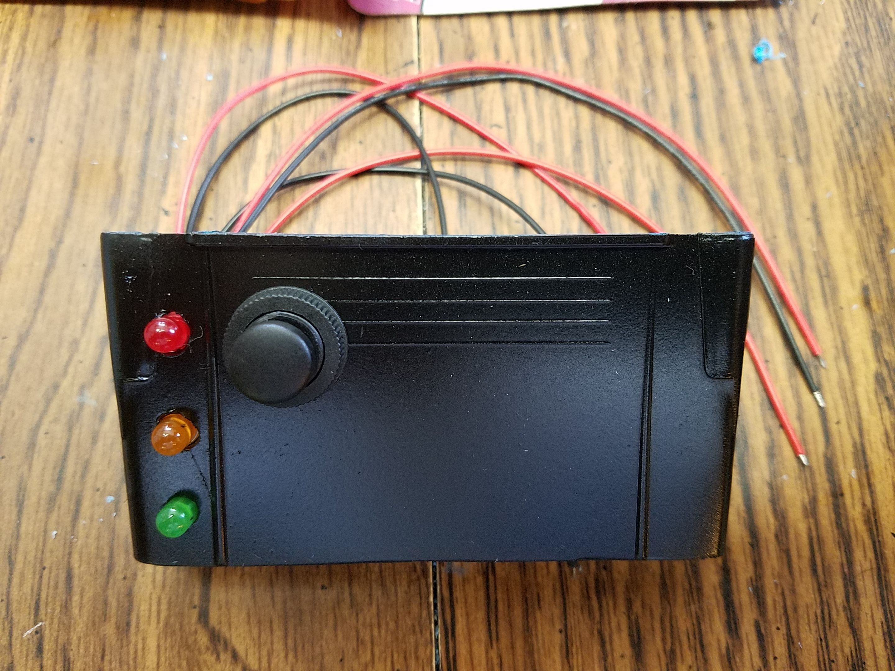

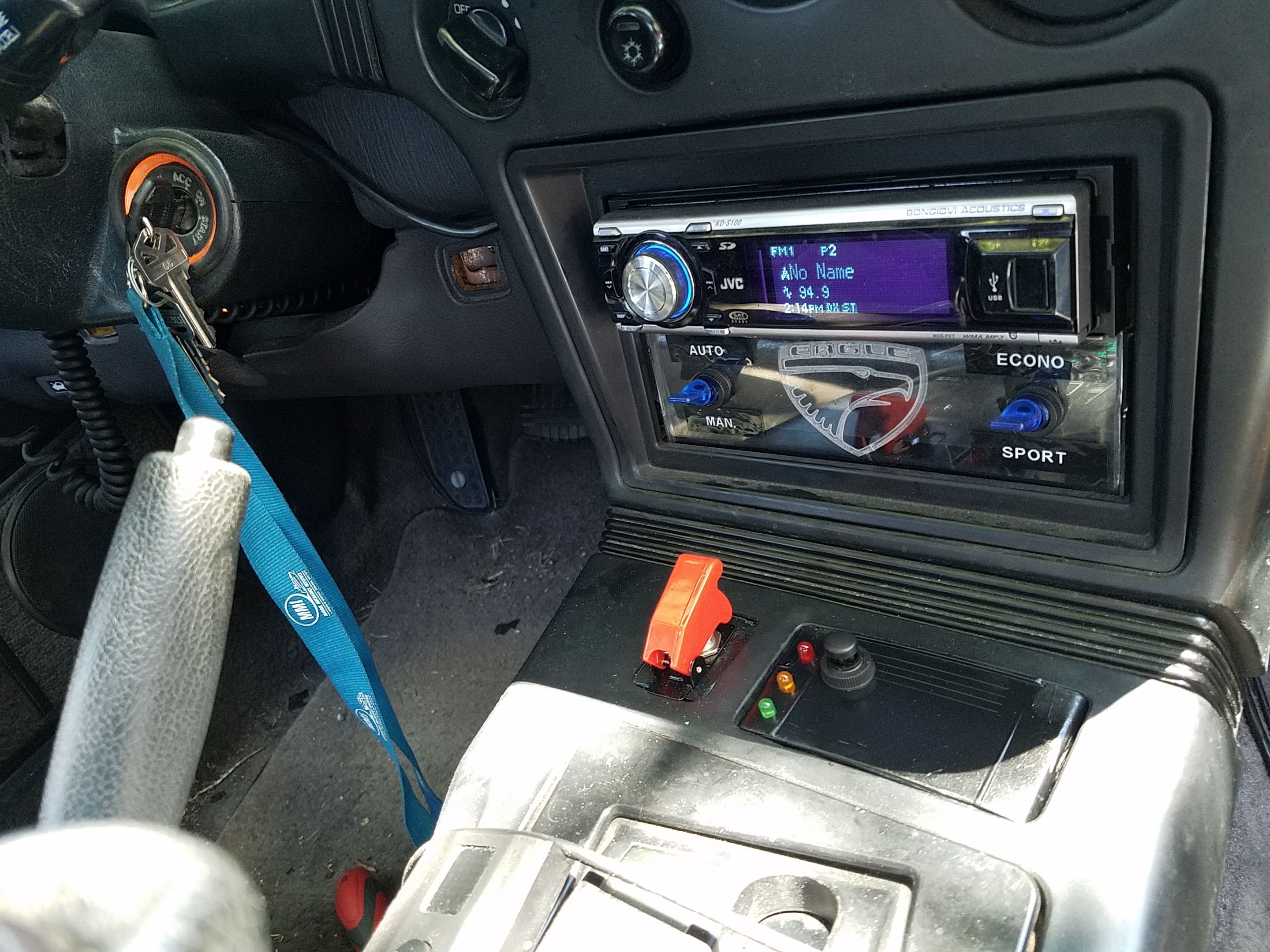

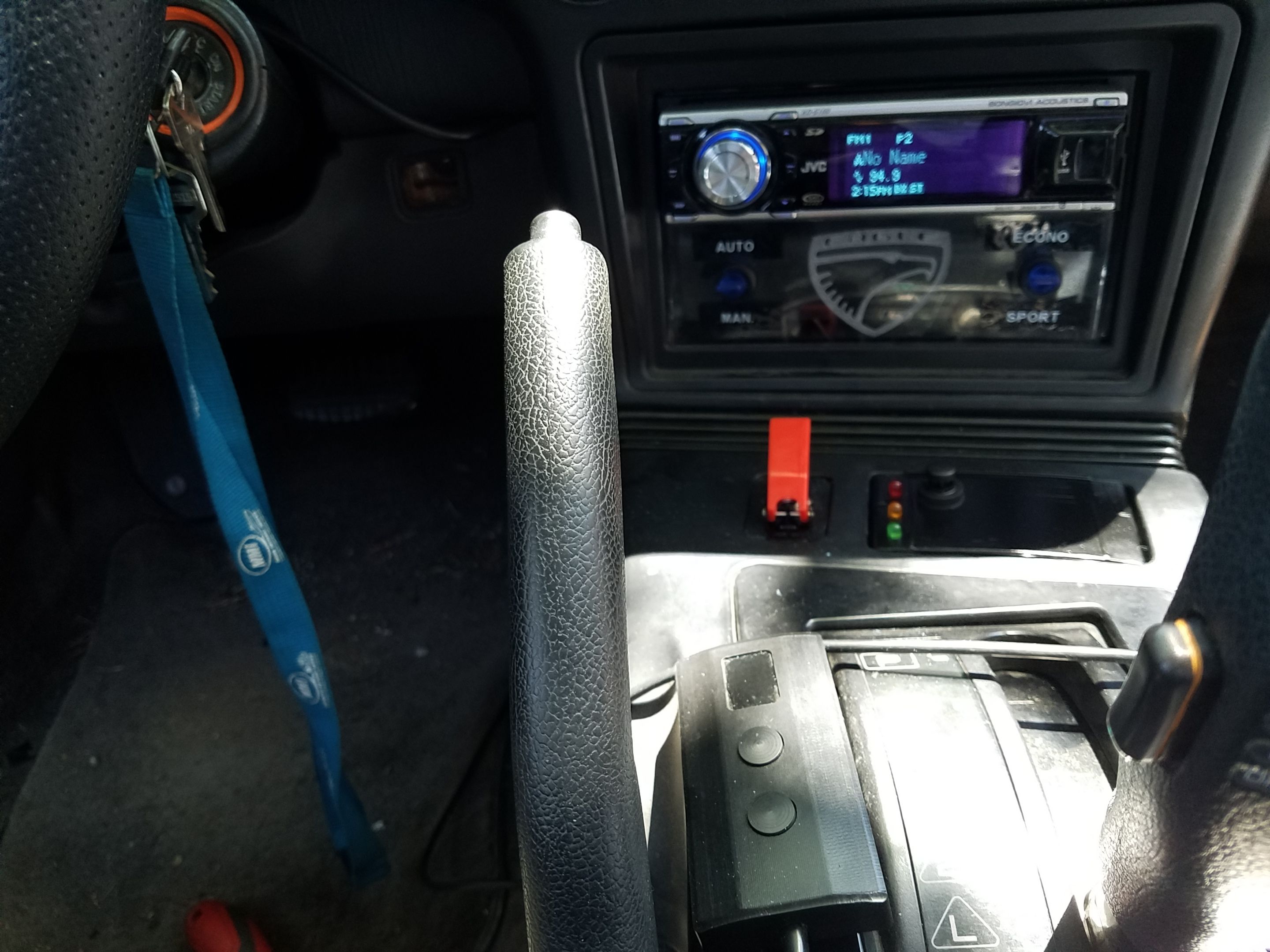

Ok, the EBC and Purge didn't like playing with each other so now I have a dedicated Purge button and left room for a bottle opener if I decide to put one in.
Maybe a SMALL NOS guage???
IDK but I left room for other "gizmos and gadgets" just in case.

Let me know how bad I fkd this up!

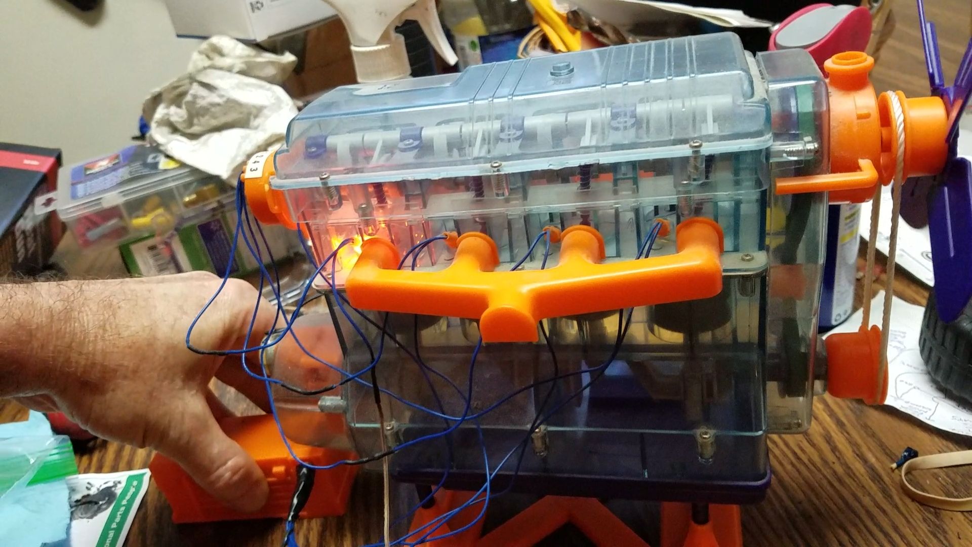

Had a little fun repairing an old toy I got the boys along time ago so just sharing why my signature says "still PLAYS with blocks" for my grandson who is 4. Never to young and he LOVES to help put a wrench on anything! :D Had to share. Video wouldn't load for some reason.
It still functions but its out of time. CAS is adjustable LOL.
