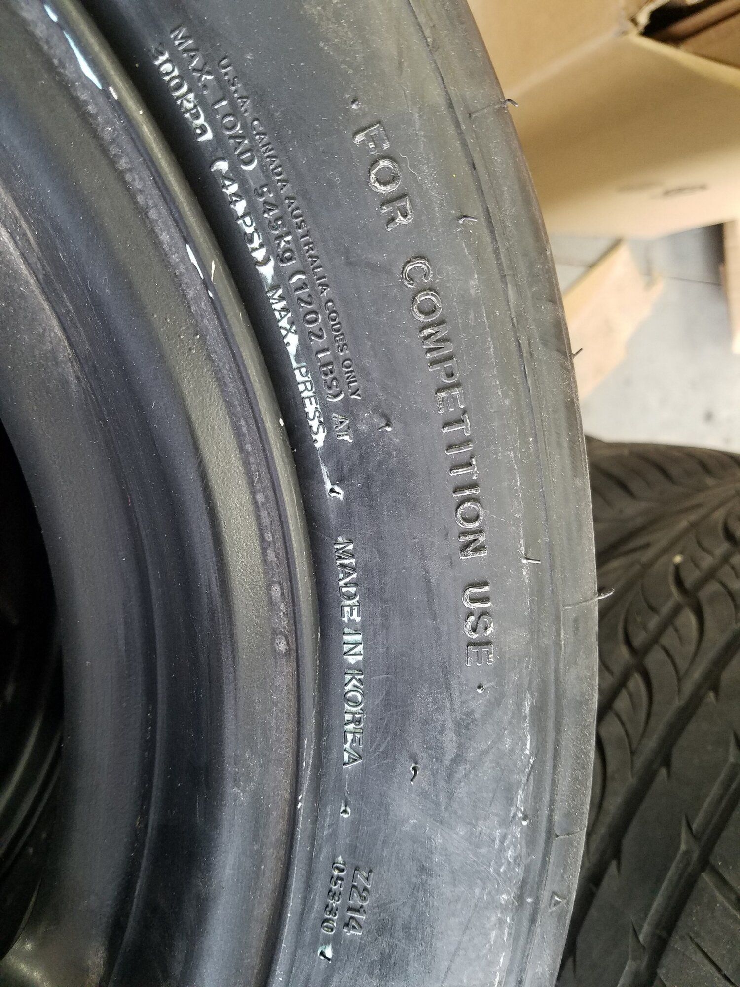

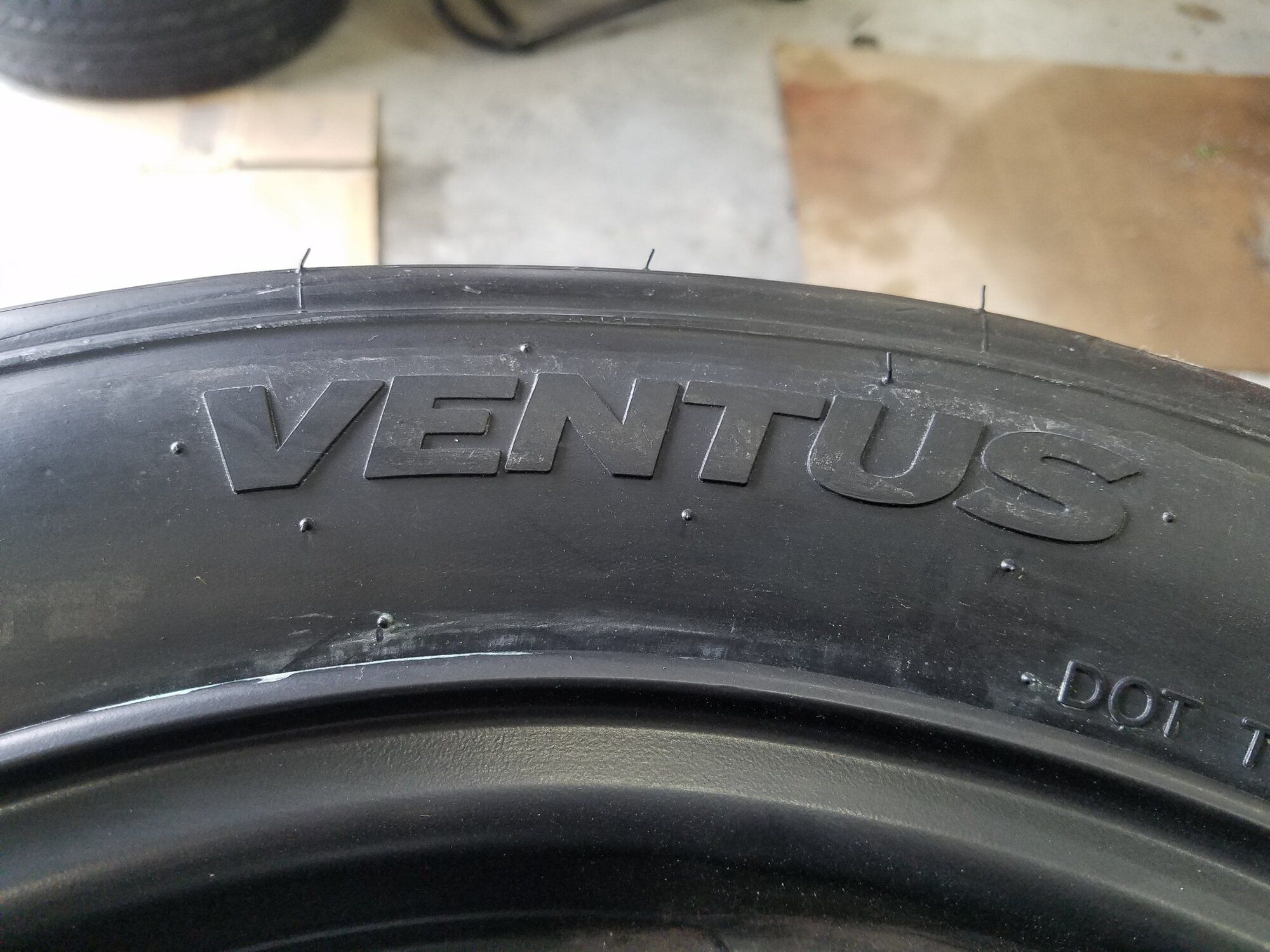

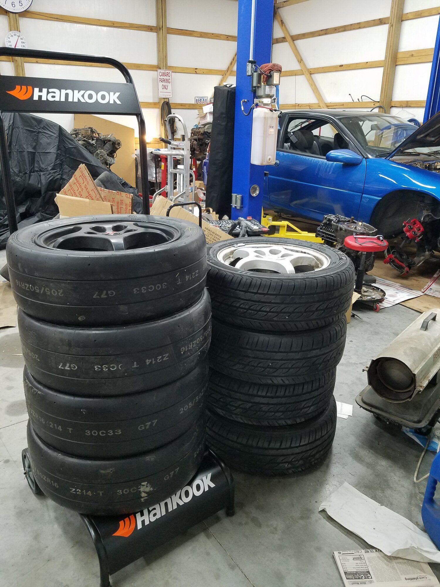

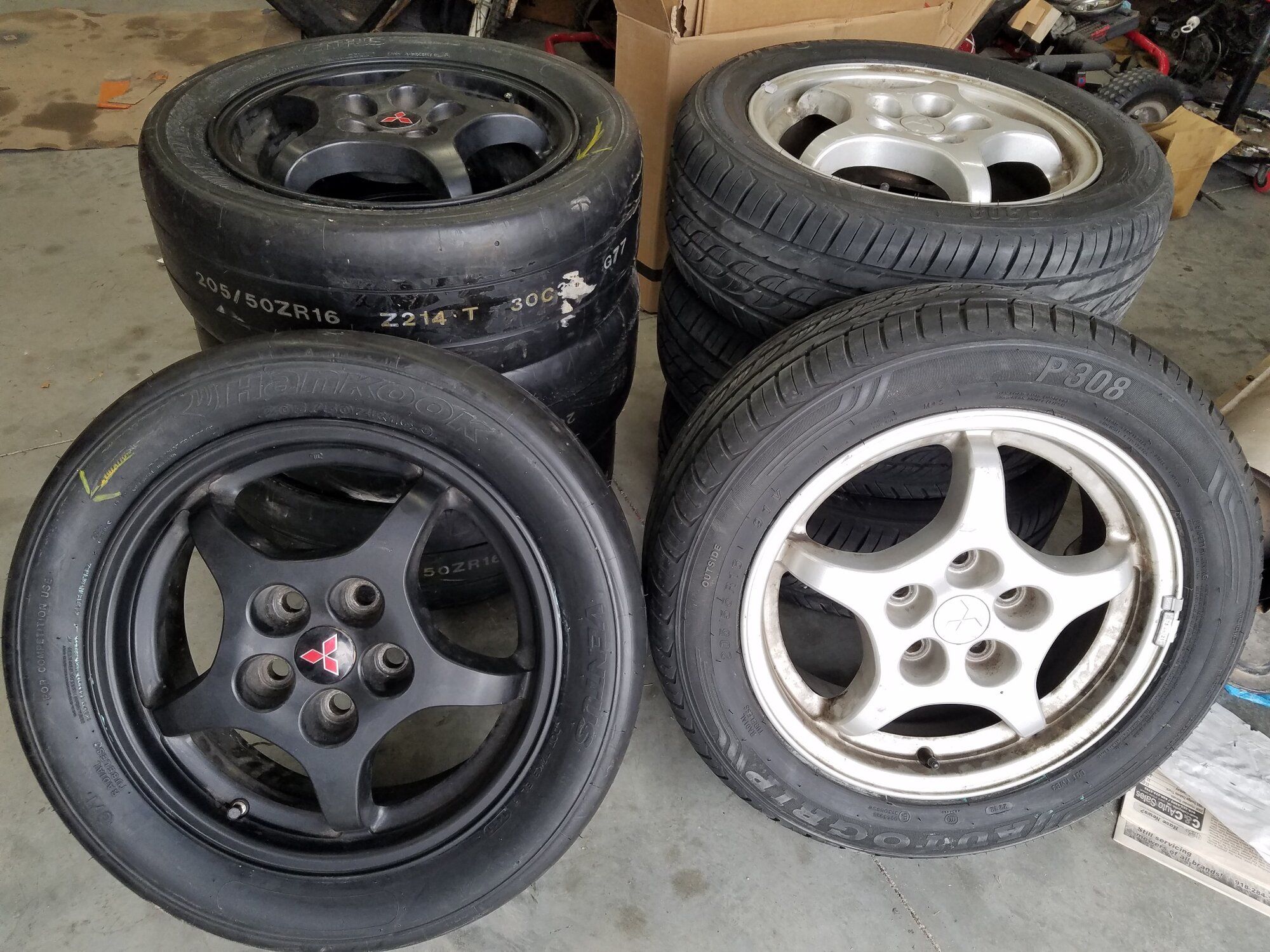

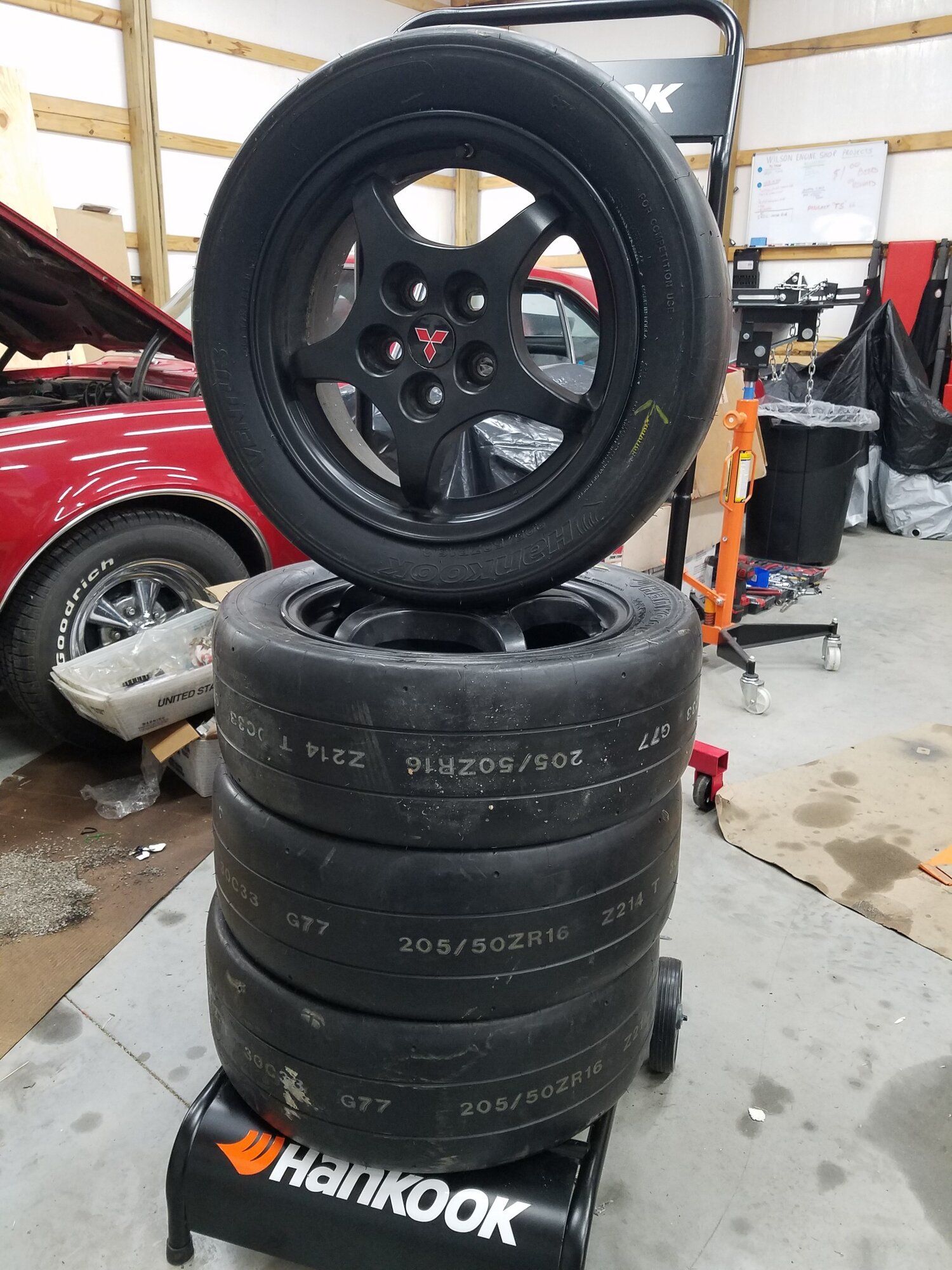

Also, since I mentioned earlier that I was getting my Drag Radials mounted (anticipated driving and racing) I have some pictures (cause we all like pictures!!!) of said tires that I bought way back in 2014 to use on the red Talon. Now when I am running on "Blacks", I am on the stickys!!! :D They are Hankook Ventus Z214's, and VERY soft!
I had a couple folks ask me about the center caps on the black 2g rims. They are these and I had to trim them with scissors and make the convex curve a concave curve to fit on the 2g center caps. They came in a little too big but I trimmed them and they do make the rims pop.
Anyways, just in case anyone else wanted to know, the link is above.
Marty

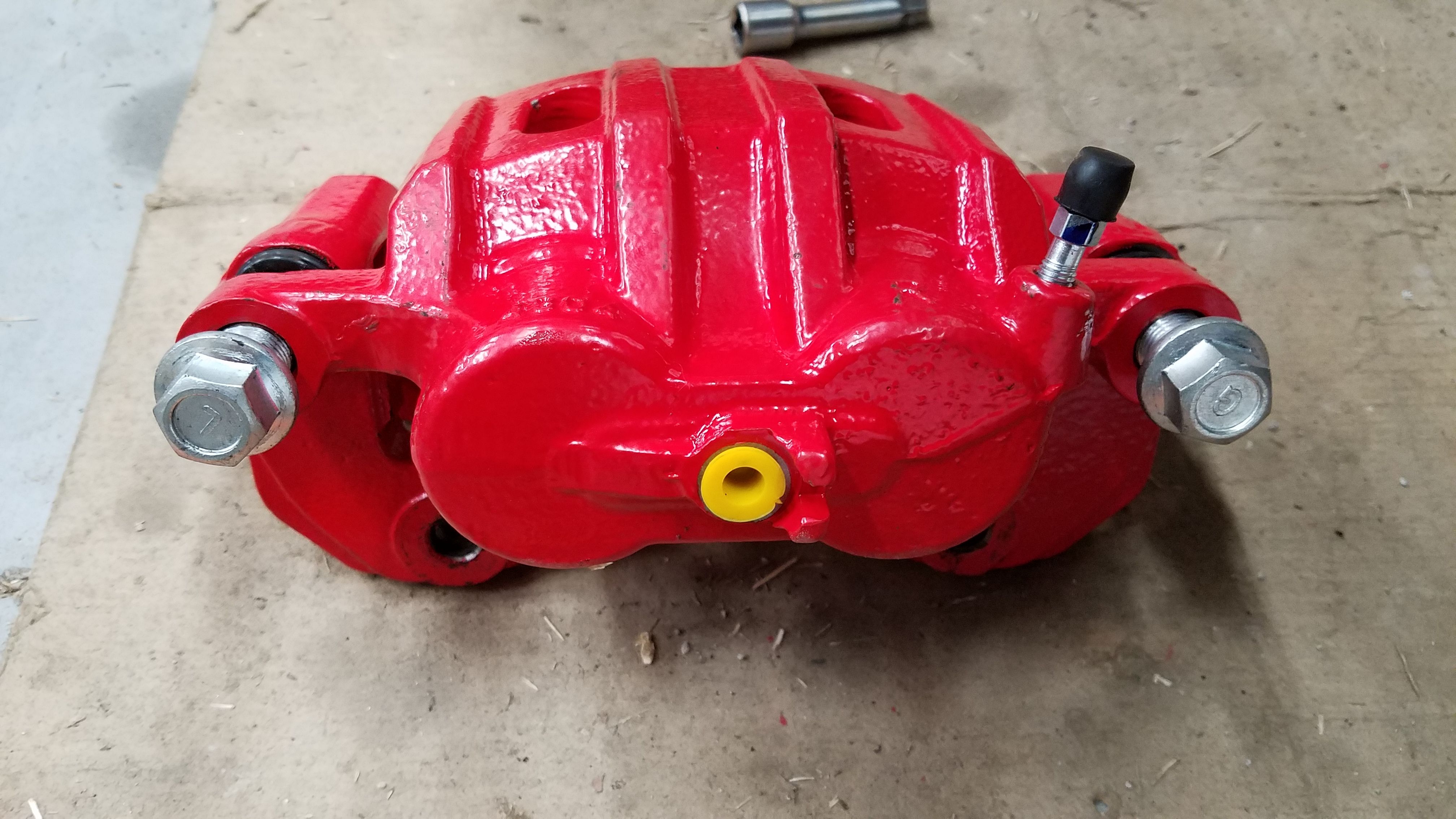

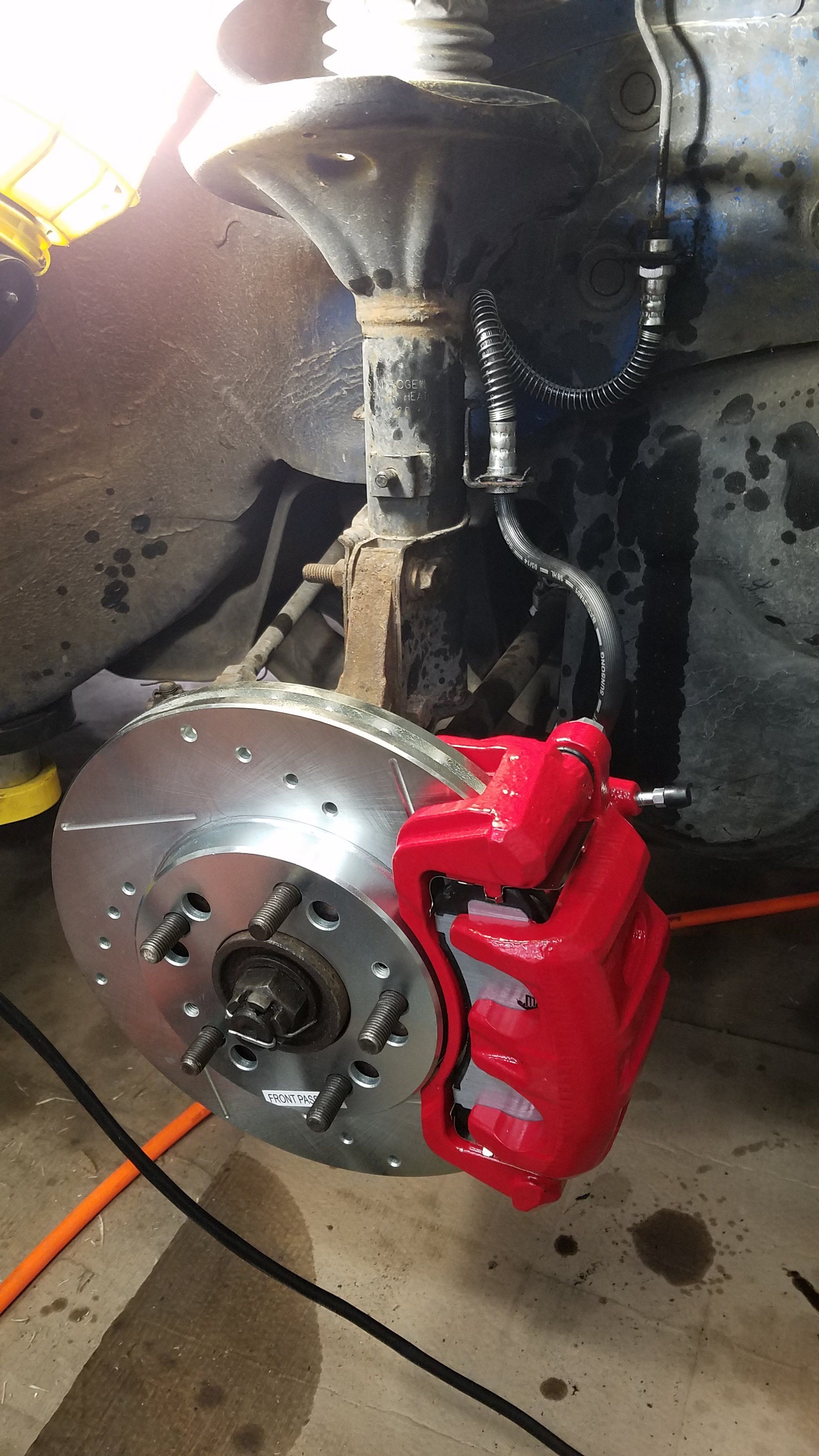

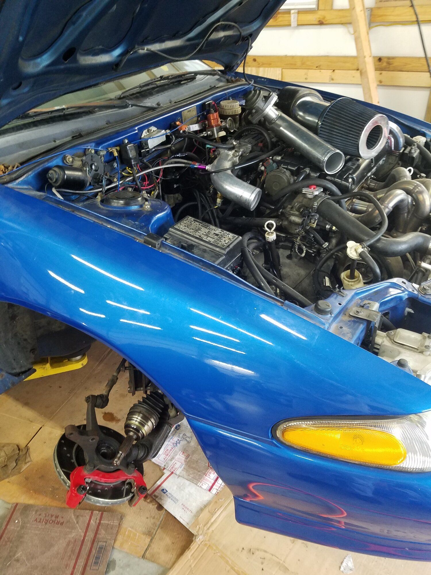

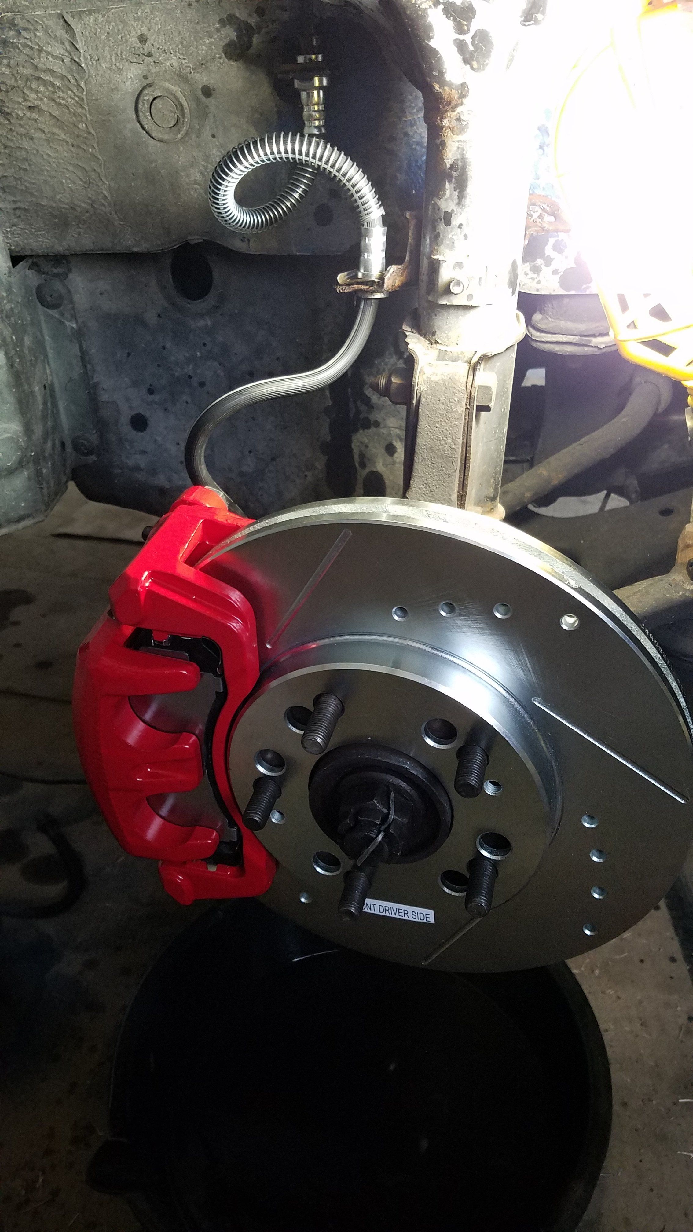

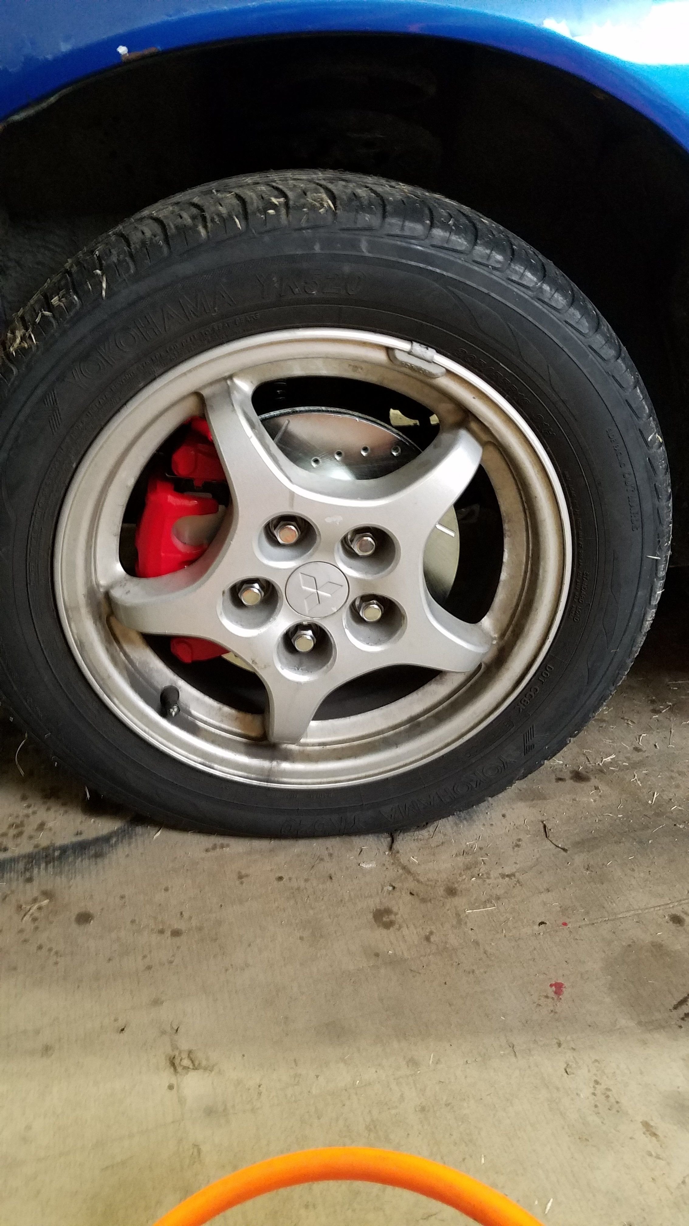

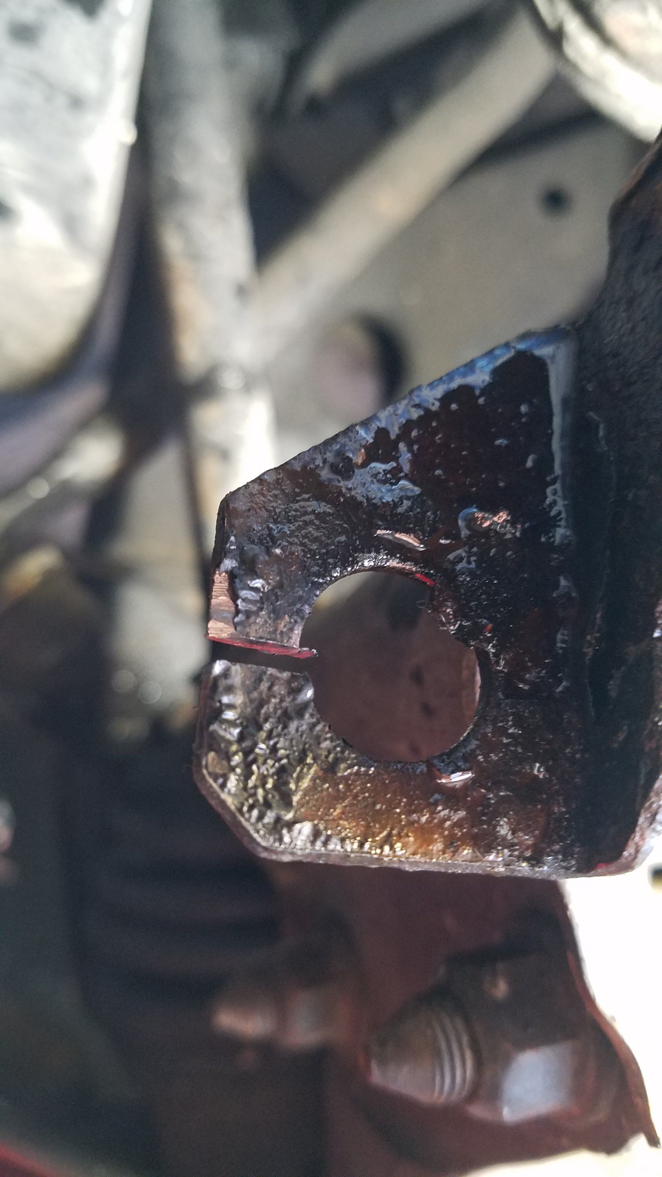

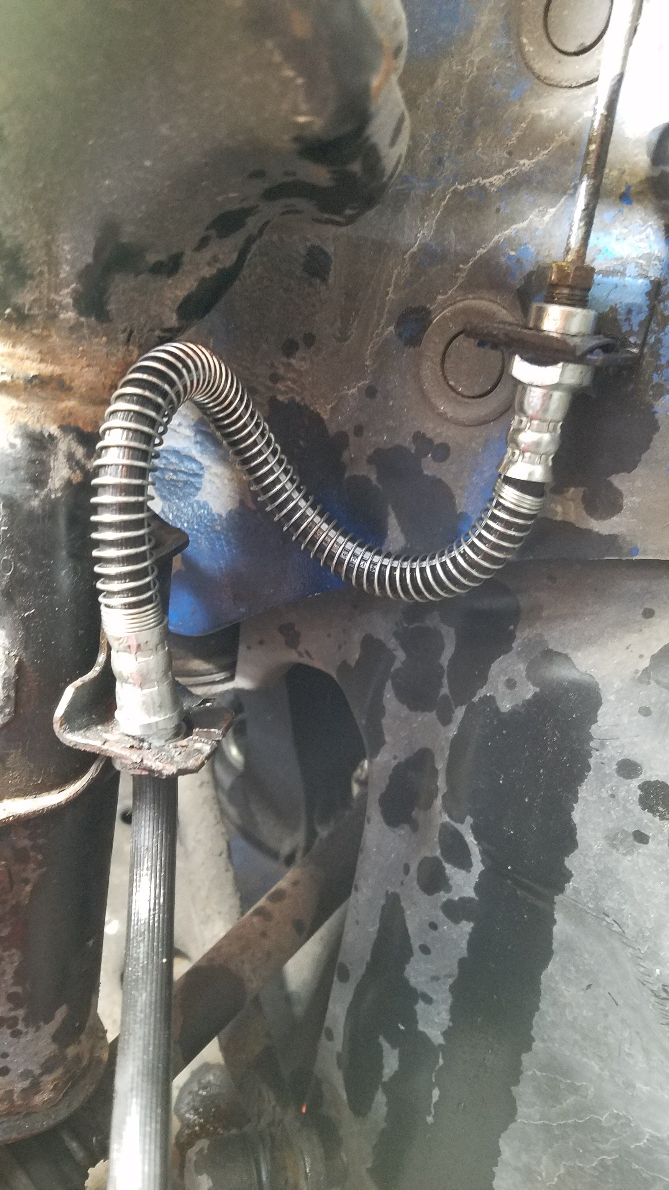

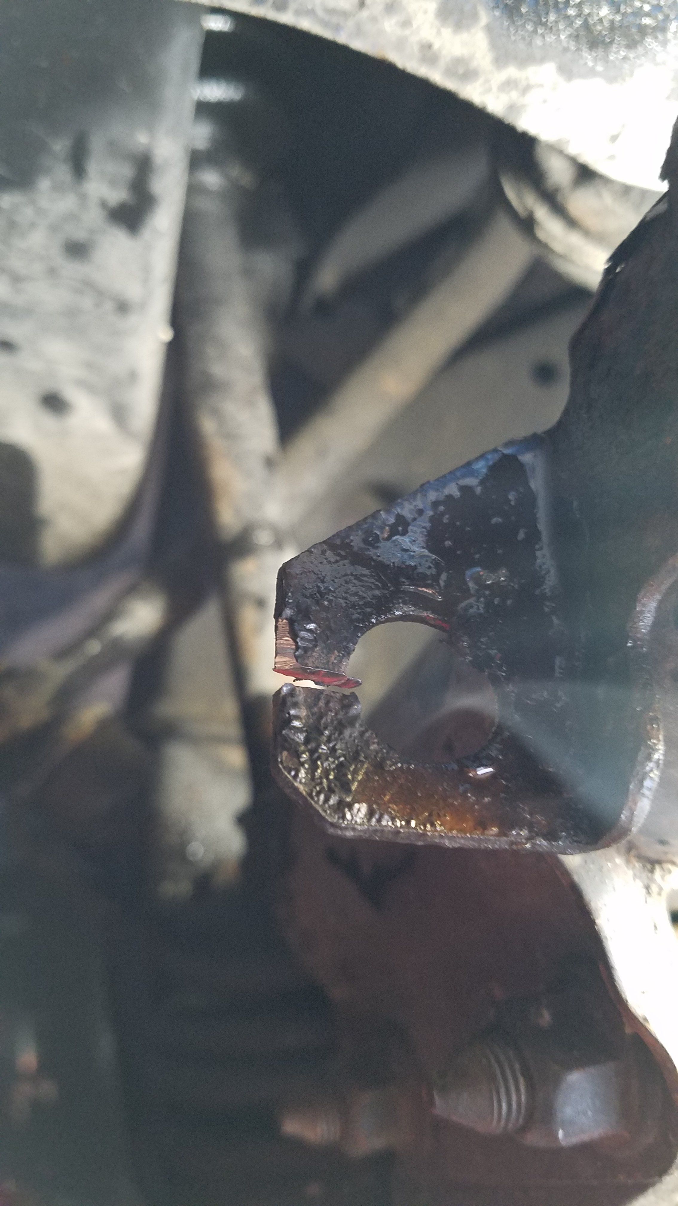

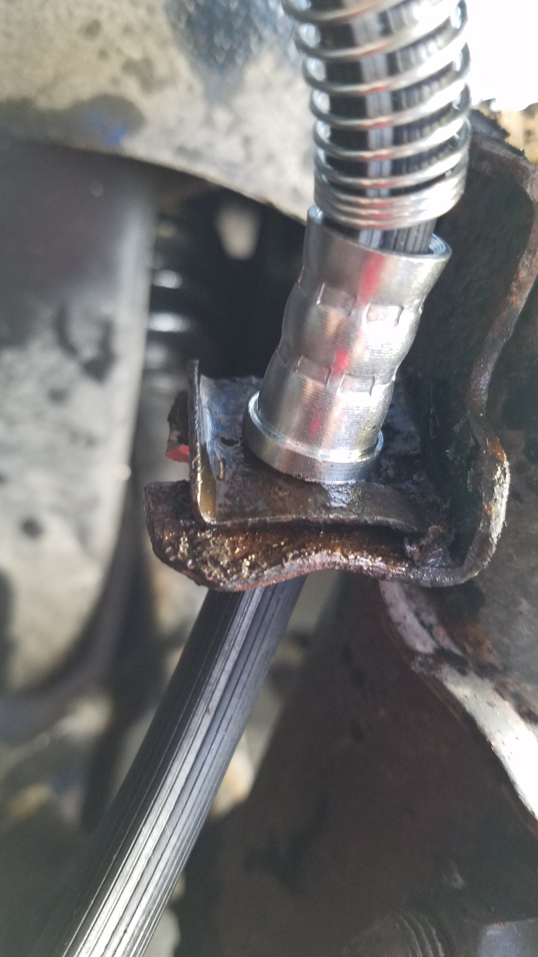

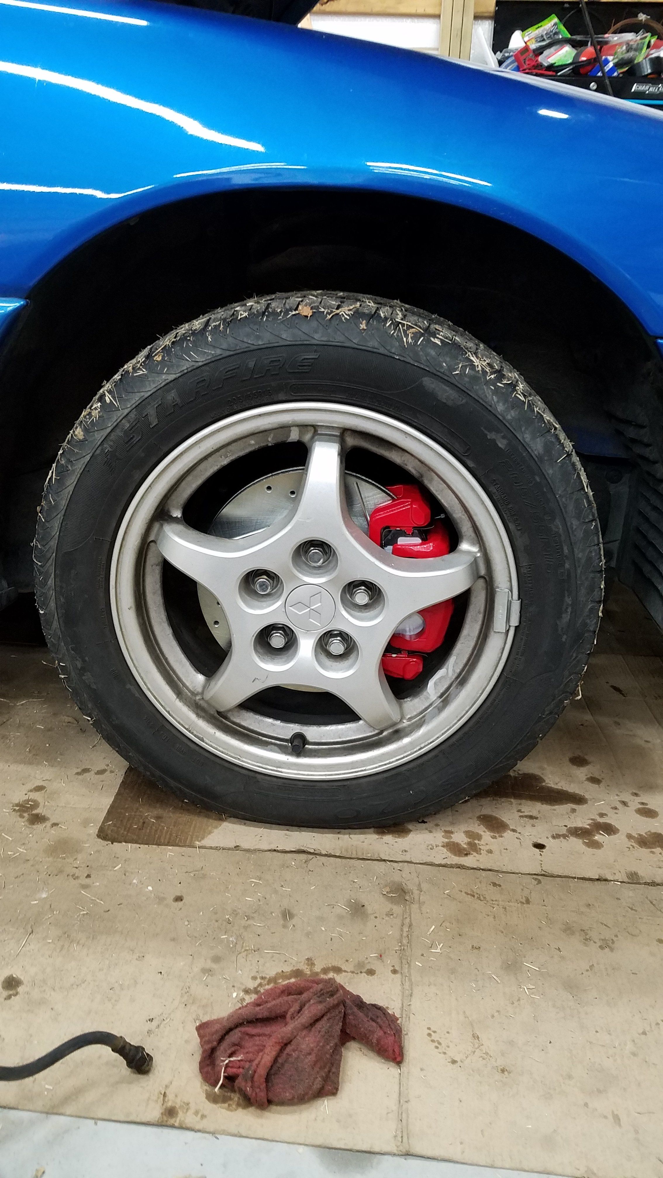

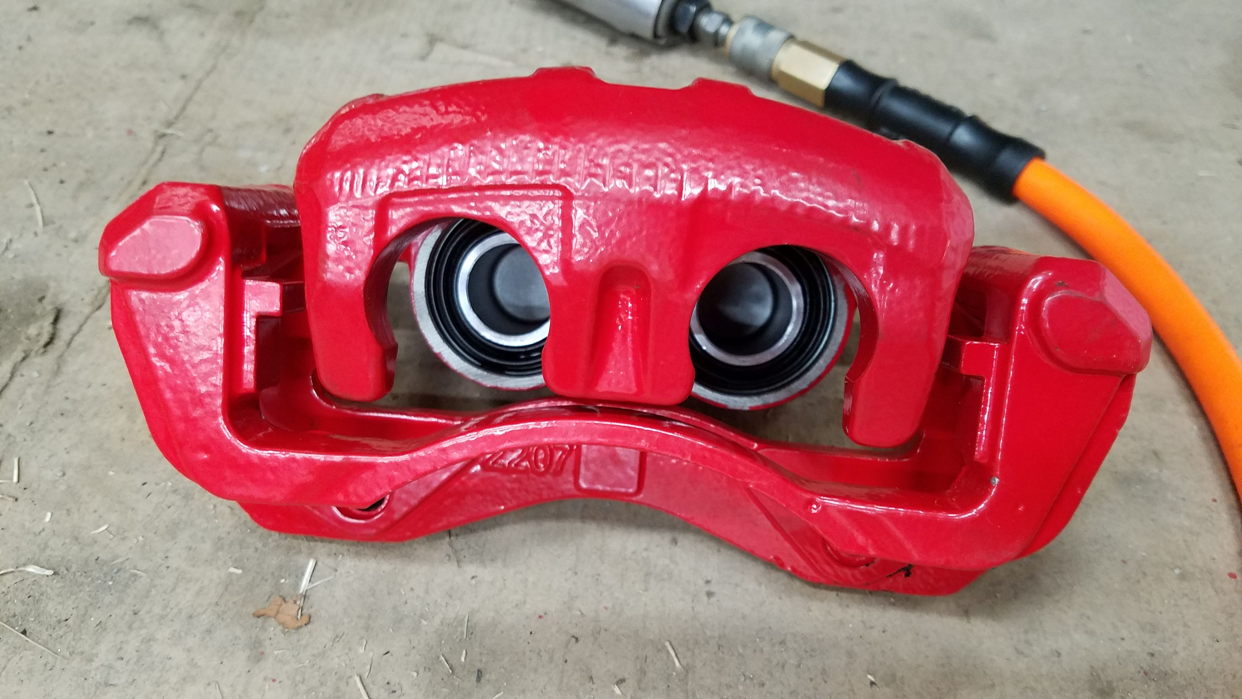

Alrighty, here's the new dual piston 2g calipers....yes they were ordered as 1994 calipers but I got banjo bolt fitting calipers so I think they are 2g by the looks. Anyway., a couple Oriellys banjo bolts and customized hose hold stays and we are IN business!
Here they are. If you have any questions about the hose hold downs just ask, it was pretty simple.
Marty
Oh yeah, just went to get groceries in her as a test after using the 1 man power bleeder!
:thumb:

Had a few questions about your brake upgrades - started a new thread so I didn't hijack this one on you. Please shoot me a dm or check out https://www.dsmtuners.com/threads/92-tsi-awd-brake-upgrade-help.534189/
Thanks!
@TalonsThree, shoot me a PM with any questions, it is pretty simple. :thumb:

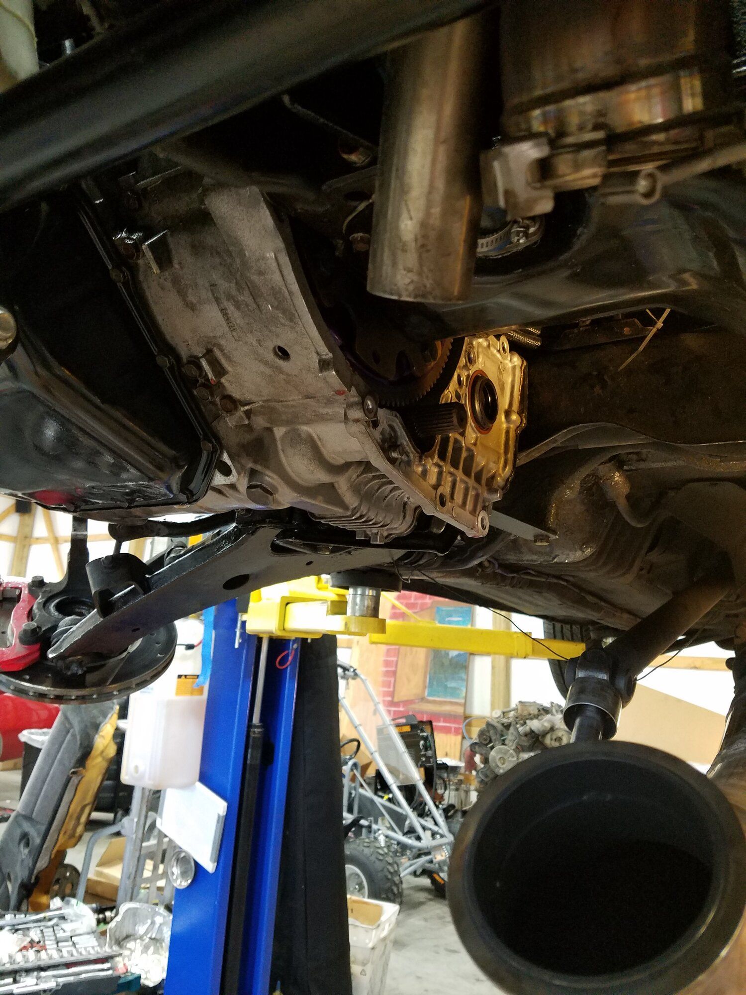

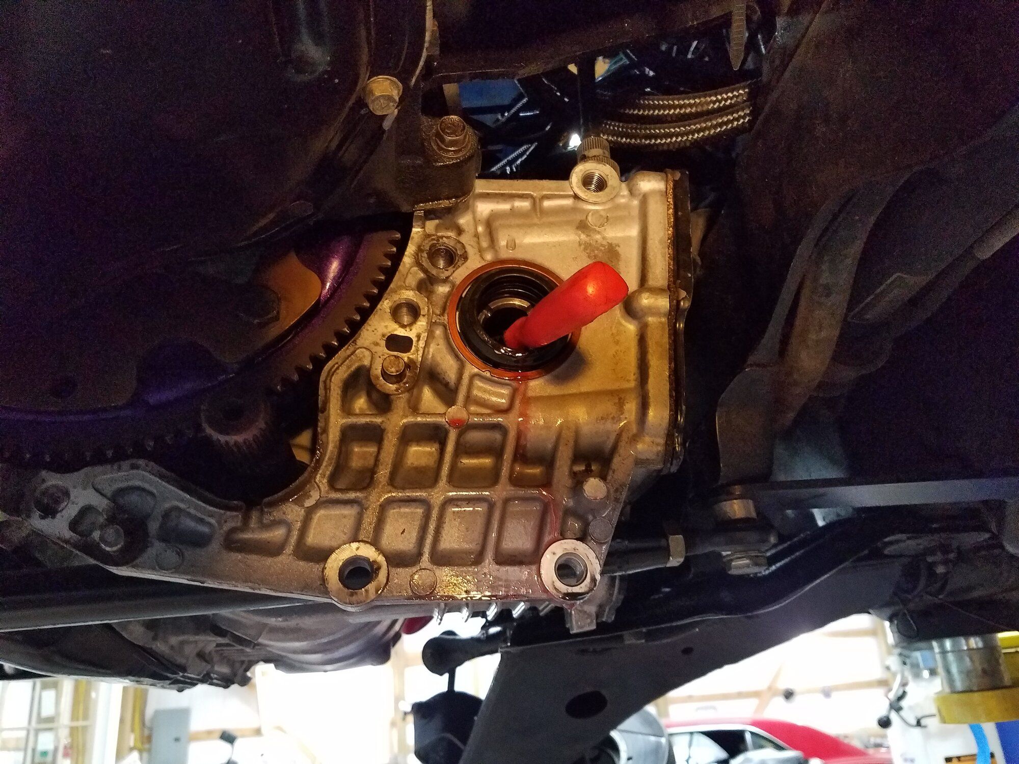

Well...…….back to the 92 Auto car. She is on the lift...….again......for the trans R&R. Thanks to all my friends that encouraged me to step back, take a breath, and then get back at it. I think I am ready for some "BOOST"!!!!
Marty
Proof is in the one picture that I shot yesterday, after work. :)
Quit giving me away dammit...…...ROFL
I'm up to my neck in projects, thats what I'm up too......
But, at the moment, we have more progress.

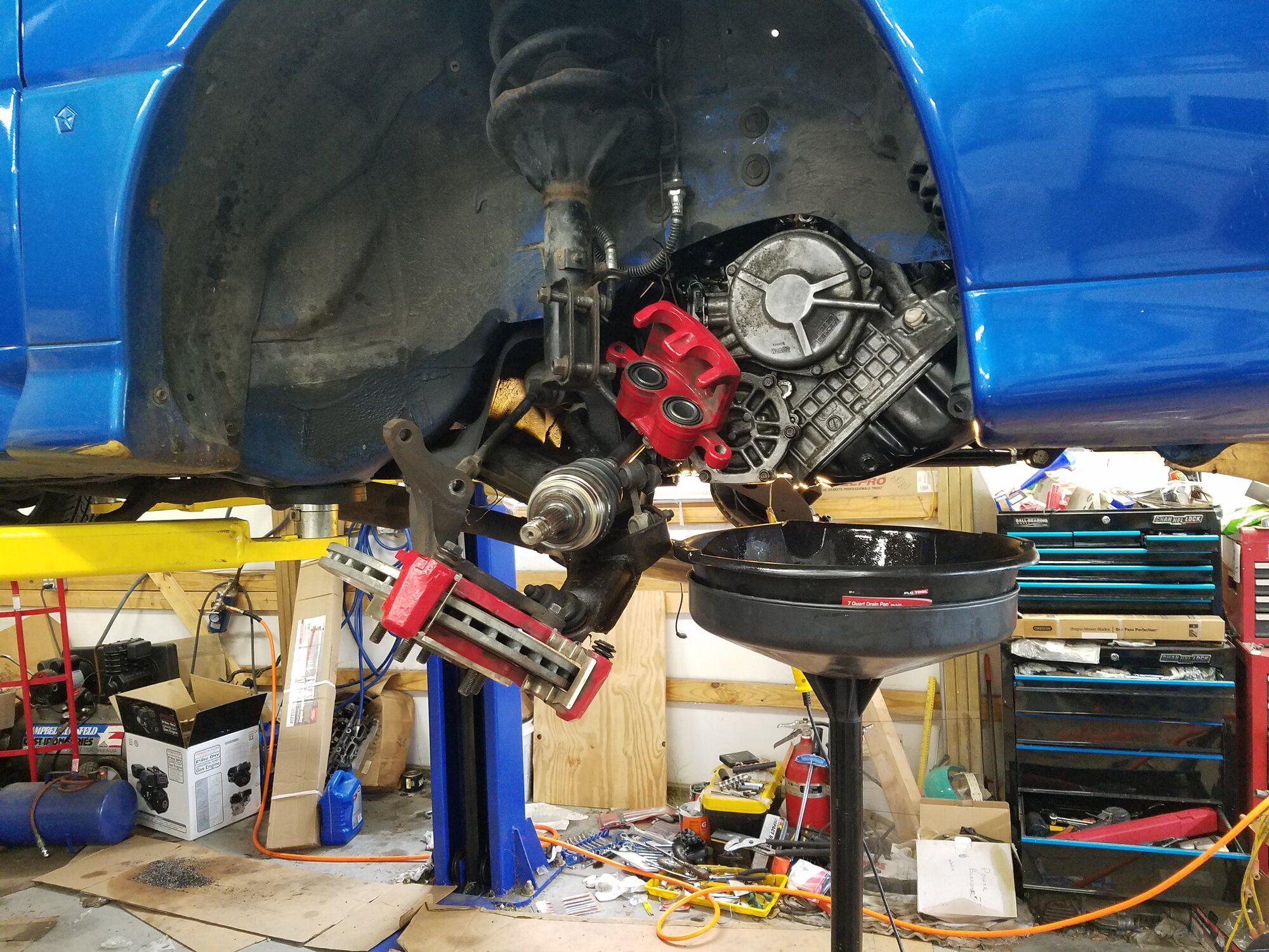

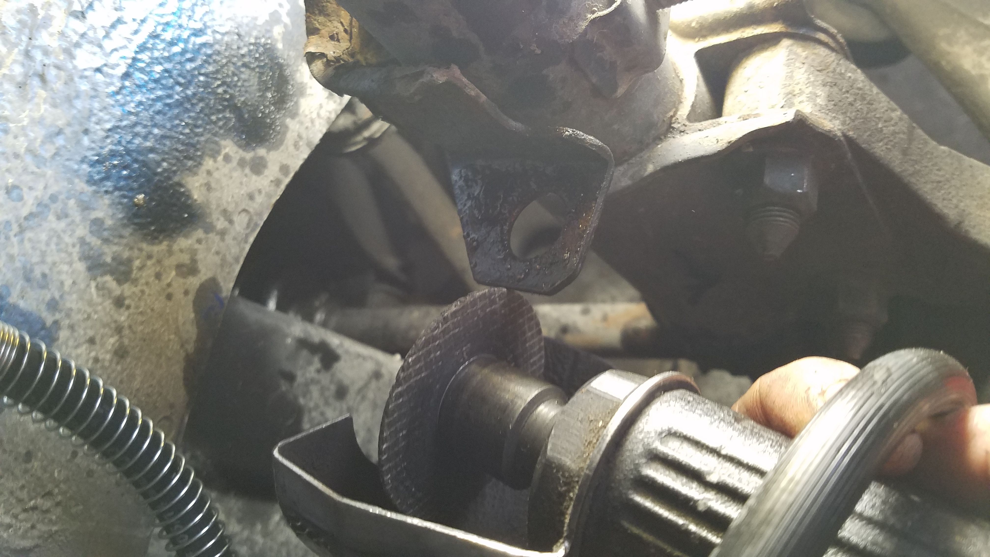

You'll notice a "stain" on the cardboard on the floor.....don't forget to drain fluid before puling the half shaft.....:ohdamn:

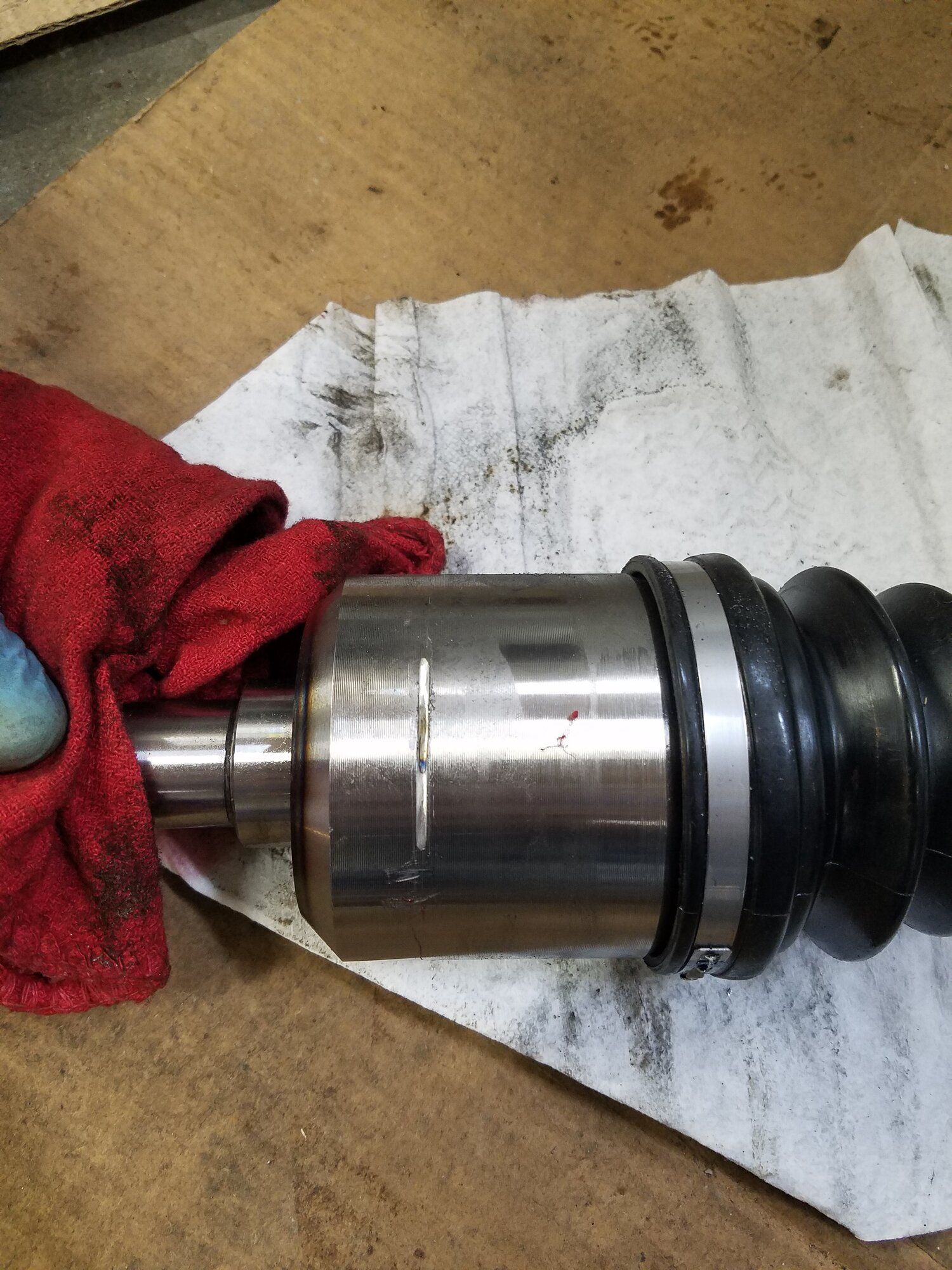

I took the time to notch the hub of the parts store CV shaft so I don't have to use my special punch to get the circlip to release the passenger side axle.
Maybe tomorrow it will be out and the new one at least bolted up.
The spyder gear crossbar is in the way. No extension will fit past that bar so I modified a pawn shop/harbor freight pry bar for just that situation.
Well progress on the Talon again. One unit out, one unit in. There are still many things to put back together but.....progress!!!

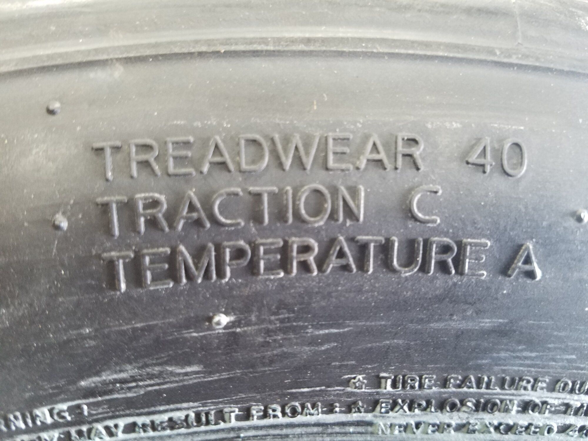

also, are those Ventus tires the ones that have the 40 treadwear?
