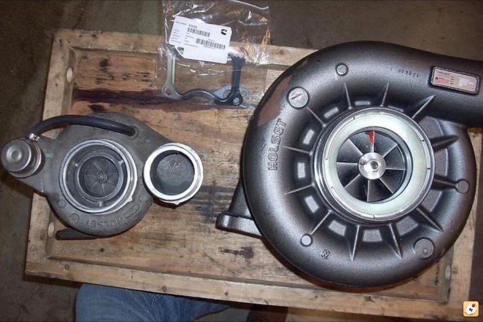

Hx83? You know thats like a 2ft turbo right? Compound or not.. Too big.
Hx35 on left
You could light that sucker using an s300sx or a 37r on kill kode.. Just in time for redline.
Hx35 on left
I should've clarified. I have one but didn't plan on using it in this application but its more so saying that I have a wide range of turbos to choose from.
Think 13-15k rpm needed at 2.0l displacement and a power goal far exceeding the most powerful current 4g63s to make that worthwhile as a primary charger. ~200lbs/min and very high PRs
I have a S256 but was unsure weather or not to use that.
I'm sure that 70+psi would have some interesting results on an HX83. However I do not have an unlimited budget. I am a student/fabricator. Not a millionaire playboy.

as a single in a 26cm housing they come on at 4500RPM on a 6.6l v8 diesel
Mine is a 29cm housing T6 divied. I'm sure there is no "real" chance of spooling it. The only reason why I listed the HX83 in my original post is to say I have some options if I so desire. NOT that I'm going to attempt to spool the HX83.
