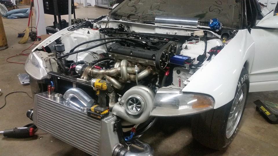

I finally started my own shop in Paw Paw MI, customer wanted my old car but even crazier than I did it. Of course the 2nd time around you make things better. This will be at shootout whether it runs or not but its damn close to firing.
Primary turbo which i wish was more normally flanged is a DSM 71HTA, and the secondary is a TiAL turbine 1.10 HTA 4205. It has a set of moran 250s and FIC 1120s, Twin fuel lab pumps, filled block, aluminum rodded 2.0L, FP4Rs, my old head, tubular subframes, Magnus intake manifold, ect ect
