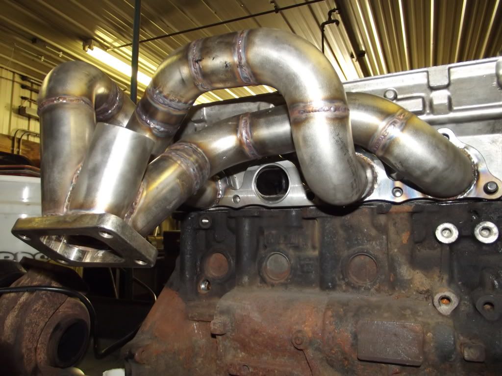

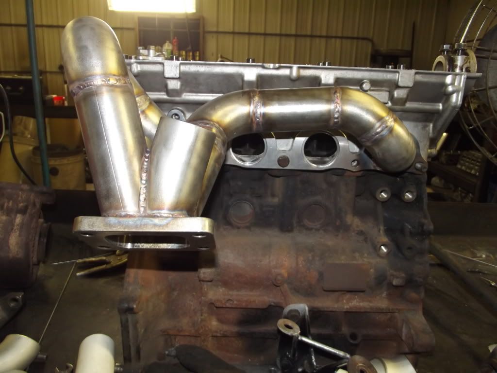

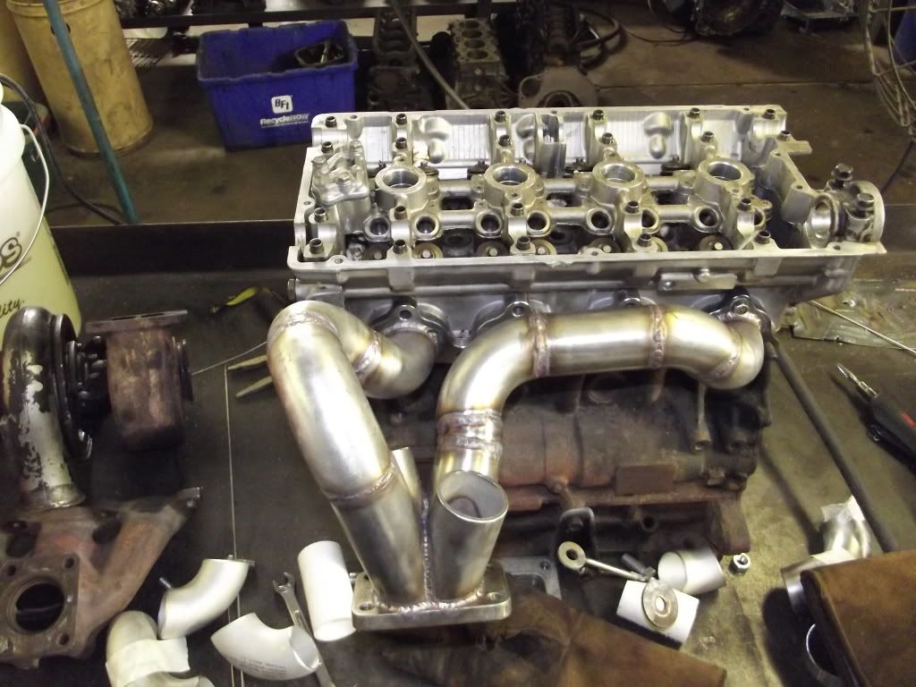

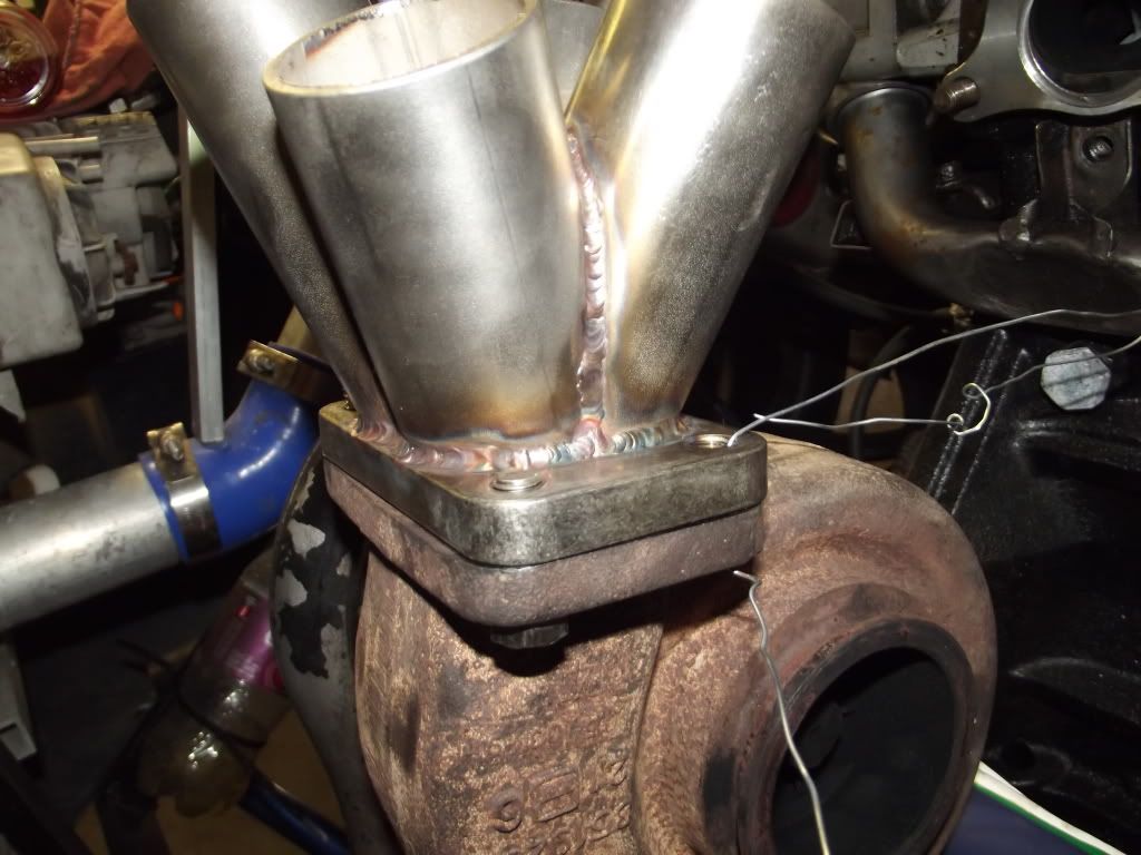

After building my first manifold it is rediculous how much easier it was to design this manifold. It took me a STUPID amount of time last year to design and weld the FF manifold for my HX40 and this year I built the entire primary manifold in about 15 hours. 3-4 of it was making the merge collector.

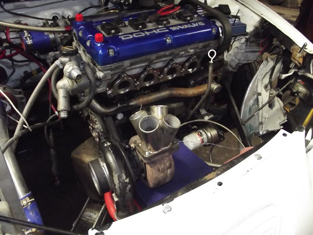

So enough talking. Here are the pictures

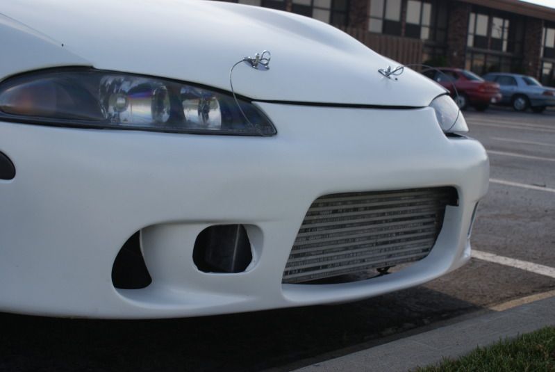

I decided on V mounting my intercooler forward so the charge pipe from the 52 to the 1C could run in front on my bumper support and behind my intercooler. I will have to cut into my bumper a little.
Making the hot pipe to connect the two turbos is gonna suck. I will have to pie cut most of it to make the transition but it should work fine. I am using two 38mm waste gates on the first manifold and 1 44mm in between. Plan is to run a full exhaust on this car so I can drive it more. I was worried about getting an exhaust ticket last year when I did drive it on the street.

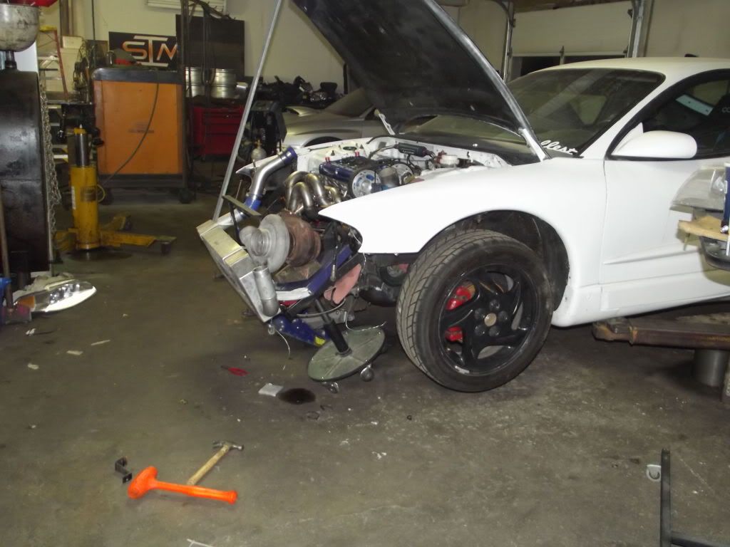

Ya the HX52 weighs a shit load. I get my head flange from straightline specialties and I get my turbo flanges from vibrant and my piping from ace stainless. The engine will be solid mounted with some custom mounts I am making and then the turbo is going to be supported by the frame.

How'd you mount up your IC and radiator? It looks like you've removed the original radiator support... I'd be interested to see pics of that setup as well. pm me for my e-mail or cell phone to text them if you don't want to post them up.
I have pictures in my old build thread of the front support. I am a much better welder now and working on getting a bender at the shop and when I do I am going to redo it in chromoly.

When I get the auto in I will finish the manifold. The engine moves to much having it supported by a jack and the placement of the big turbo has to be perfect. I will also be working on solid motor mounts when the auto is in. Hopefully next week will have some major updates.

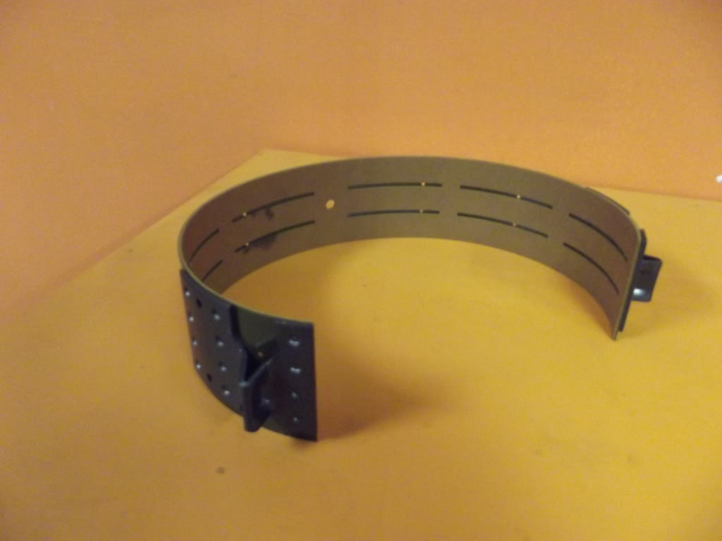

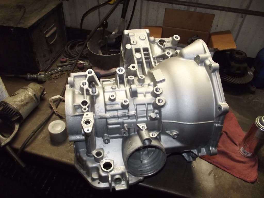

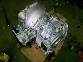

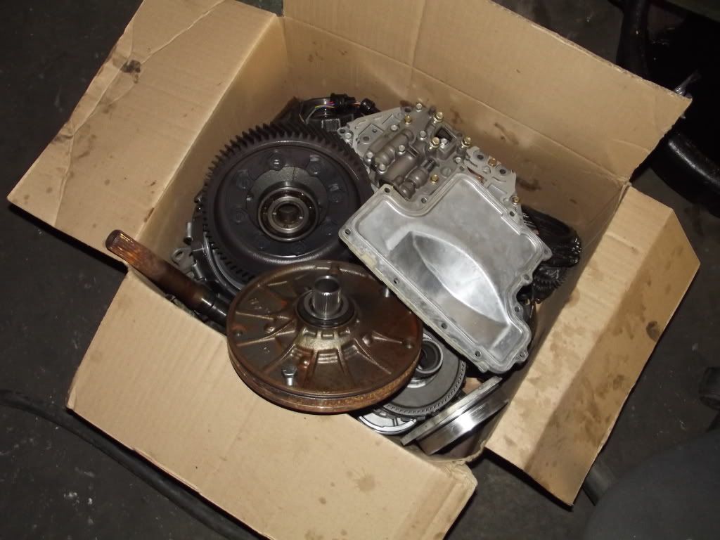

Well been busy as shit at the shop recently so I have been sneaking in some work after hours. I have my auto almost back together. Just need to order some small stuff. I welded the center diff and install both diffs. Now the fun part of installing all the clutches.
I am going to mount the trans in the car and start working on my solid motor mounts, rest of the manifold, and ratchet shifter while I save up for the torque converter and the flex plate. Should have some more updates this weekend
The trans build is lookiing good so far. did you paint it with aluma cast paint or blast the case? clutches aren't bad to do. are you changing all of the piston seals as well?
Ya I have replaced every seal, clutch, and steel. Kiggly front friction and steels are on the way along with a prototype 7 bolt flex plate!!(Kiggly and his wife are great people to work with and I am glad to be testing out one of there products). I am also waiting on a shift kit to install along with wiring up the kiggly manumatic.
I should have the internals of the trans finished up tomorrow and hopefully have the trans in by the weekend.

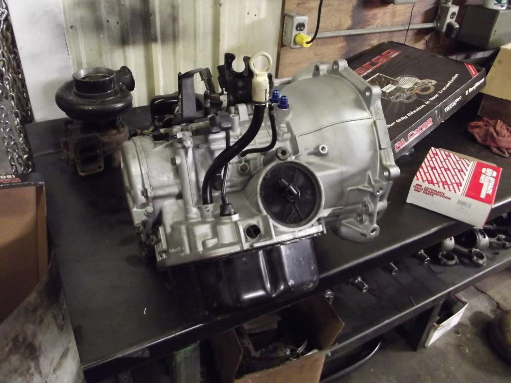

Auto build.
-Kiggly front clutch
-Kiggly 7 bolt "prototype" Flex plate(BTW fits like a dream and looks even better)
-Welded center/viscous coupling delete
-Kiggly Manumatic mod
-Full rebuild with borg warner/raybestos kit
-Translab shit kit along with oil port mod
-Sinister speed torque converter(waited to order to see what guys think. They are now working on a customer stator to help with the "loose"ness of the
TC. Once that is sorted out I am having one on the way)
-B&M quicksilver rachet shifter
-B&M trans cooler(-6an lines)
Pics-

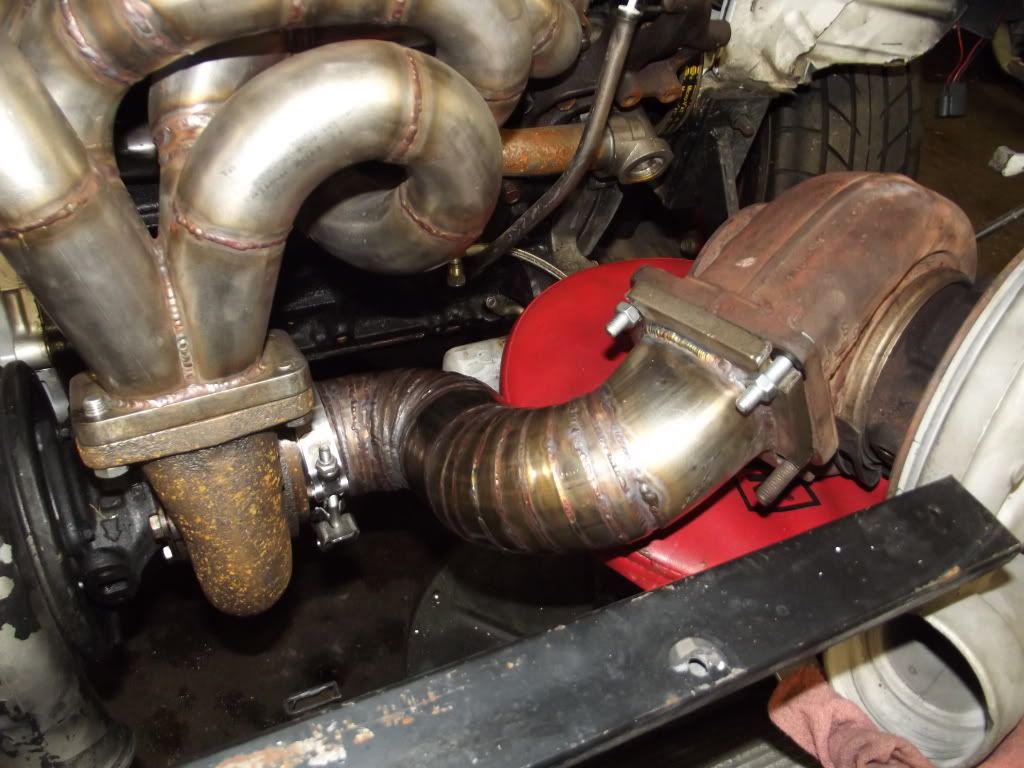

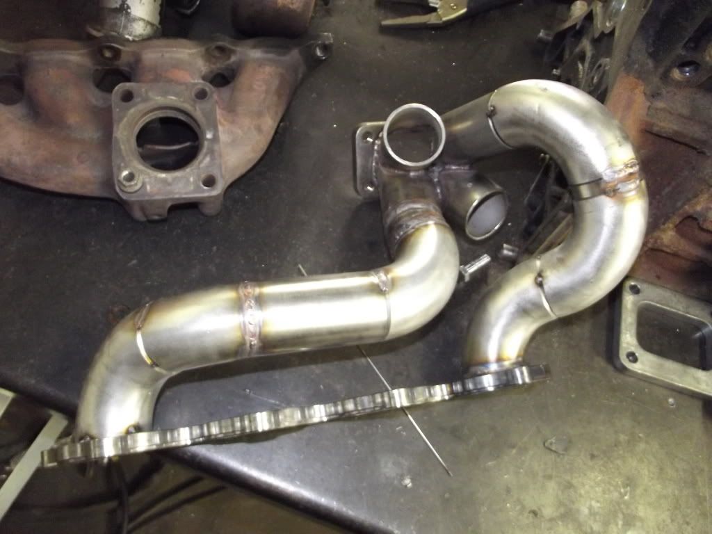

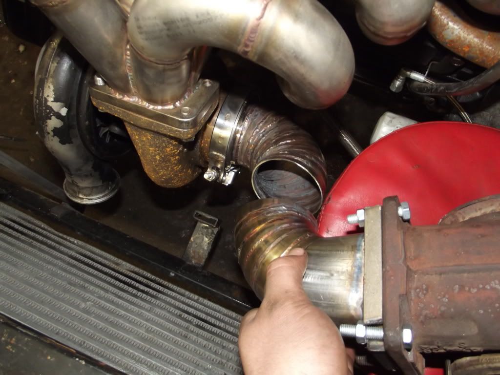

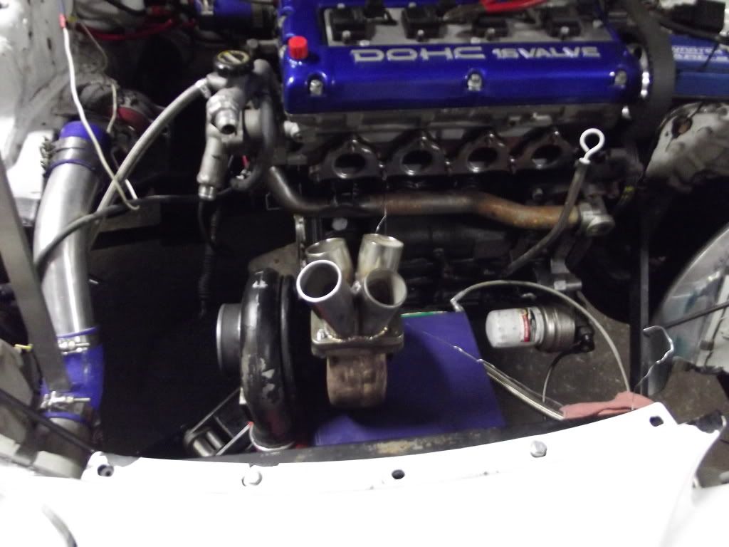

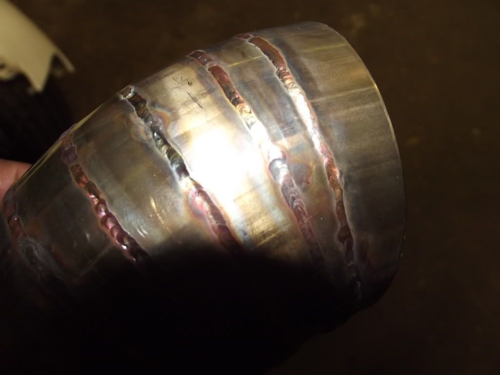

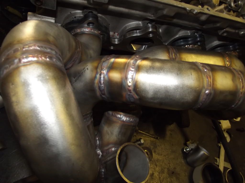

Trying to mate the two turbos has been one of my hardest fabrication projects yet. No one makes a bend as tight as I wanted and I was inspired by the LS1 intake on that E36 in speedhunters so I tried pie cutting the cross pipe.
Tial 60mm placement idea for the primary
2nd Tial 60mm placement for secondary
Car will have full exhaust and recirculating wastegate. Going after the DSE class at shootout should be fun with this thing.
Is it just the view or is the HX52 sitting at an angle along it's shaft's plane? I know they (holsets) have a specific amount of degrees specified as the max angle allowable on that plain but i'm sure you're probably within it if the turbo is at an angle at all.
