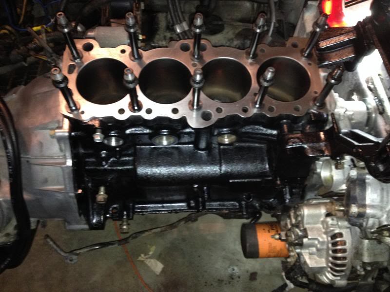

I drove it around with a tired engine running a 16g for the first year then I decided to build a engine and paint the car Black Cherry and make it a Shep look alike.

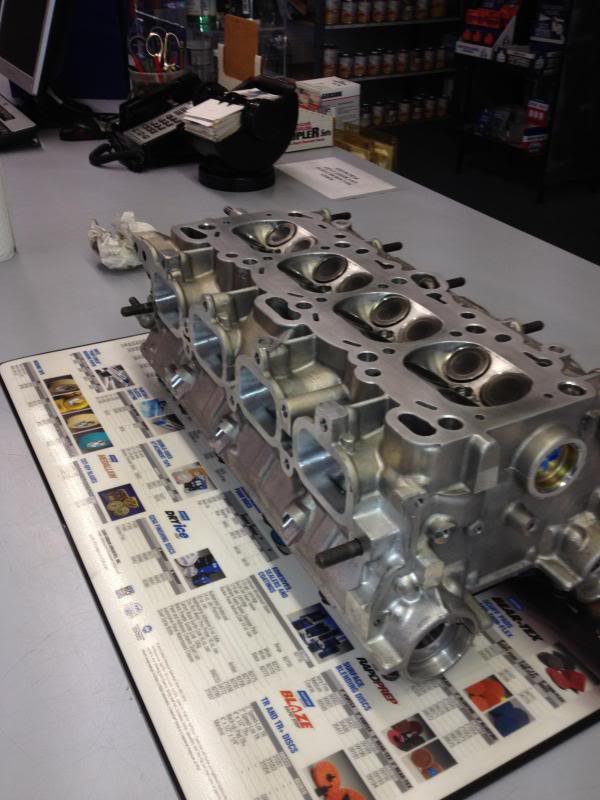

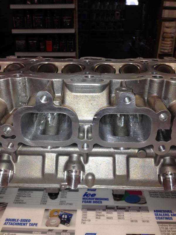

Nothing special just a stock rod 1g piston with file fit rings and a fresh head with some mild porting.
My home brew ring filer.LOL

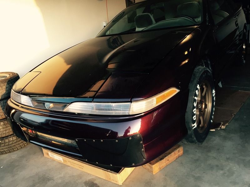

I always loved the way Sheps 91 Talon looked so I decided to make a clone.
Sheps Car.

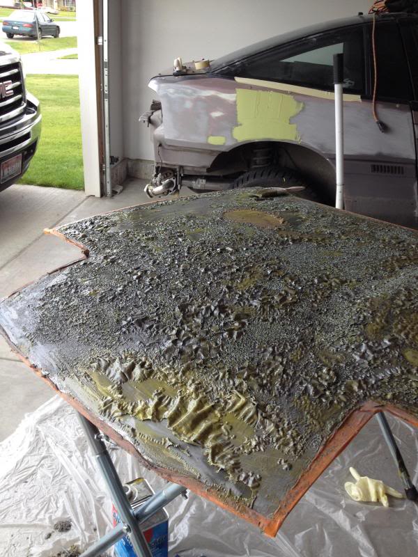

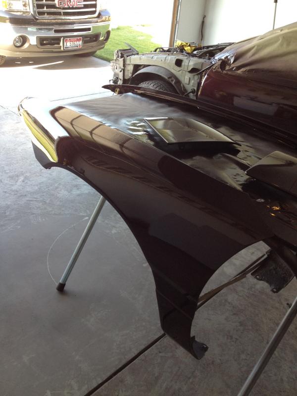

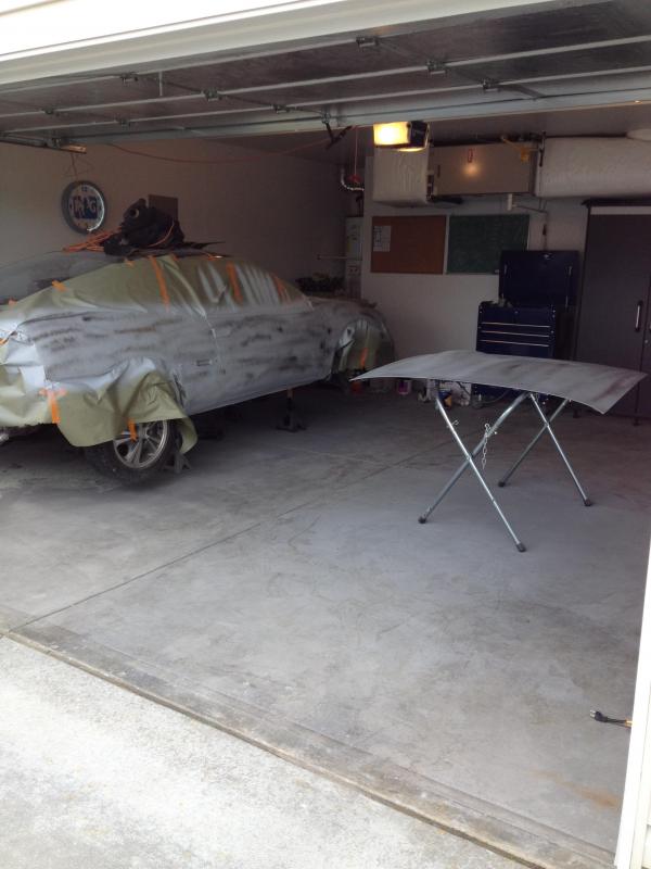

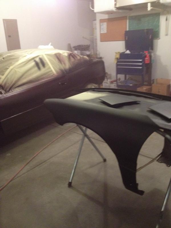

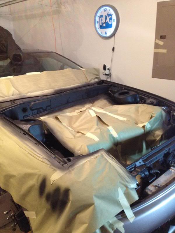

So I started with painting the engine compartment.
DP 90LF Sealer

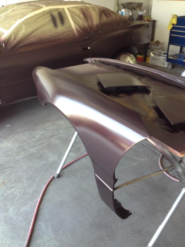

Black Cherry with Clear coat.

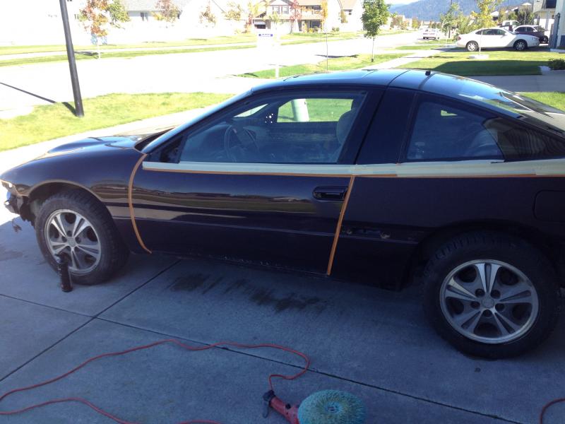

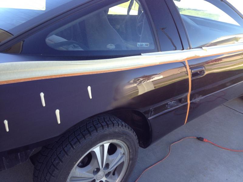

Body and Paint pics.
Black Cherry Base Coat
Clear Coat
Sanding and Buffing
All buffed out.

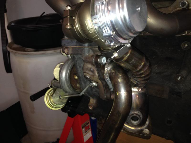

OK now that the car is starting to look the part I decided to do something a little bit different. I have been following Paul's turbo compound thread for a while and love the idea of going with a compound system myself. Then after seeing what Kevin Jewer has done I had to go this route. So I started making my 13g/FP Red mid mount turbo compound system.
DNP Manifold with a Tial 44mm waste gate by pass to the RED.
Tilton pump for mid mount Red.

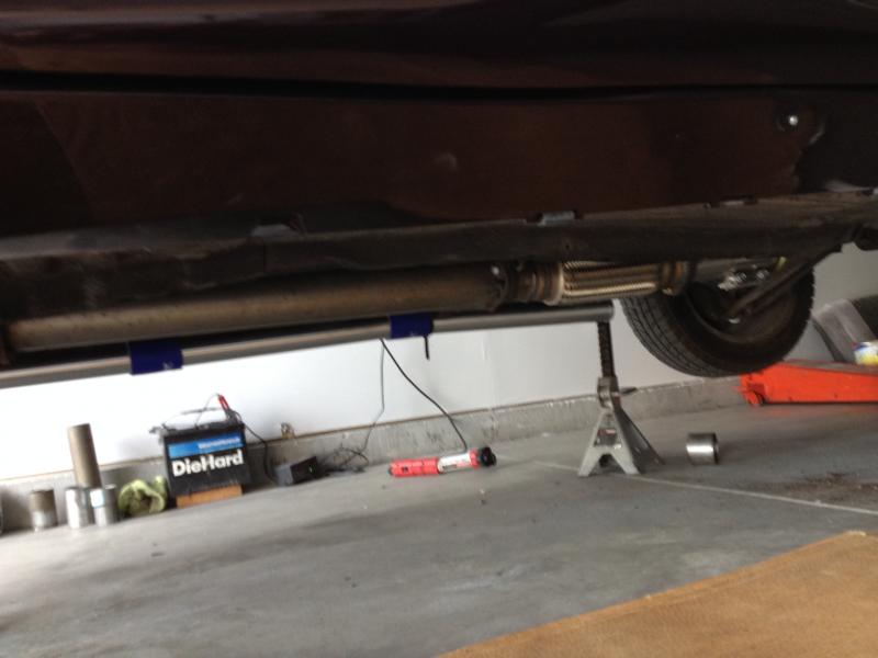

Keep in mind these are just temporary charge pipes to get it car up and running the permanent ones will be one piece solid units.
In the pic above you can see the charge pipe from under the car that's feeding the 13g from the mid mount FP Red turbo outlet. Secondary flex pipe at the rear also.
Charge pipe under the car connecting the 13g to the Red.

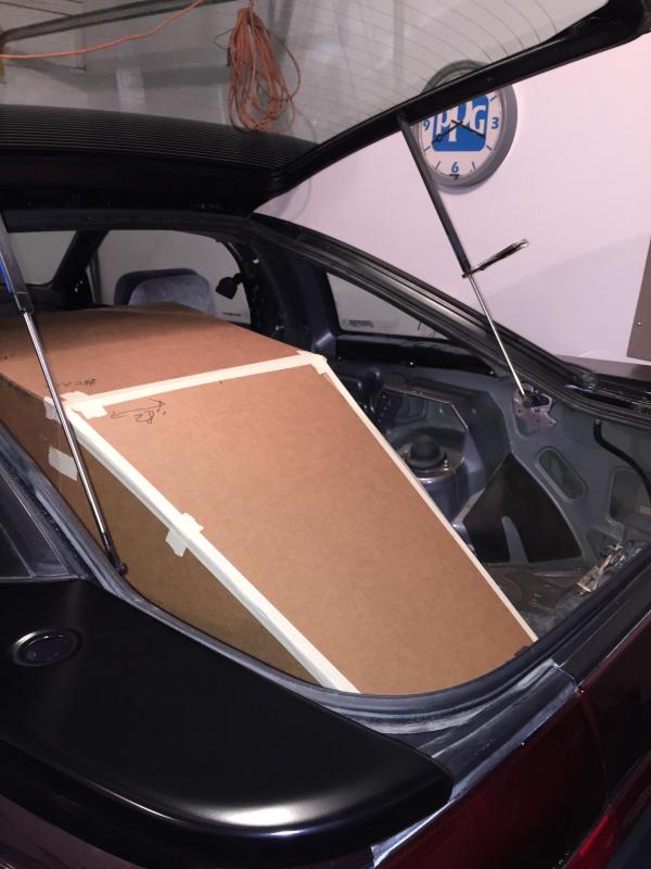

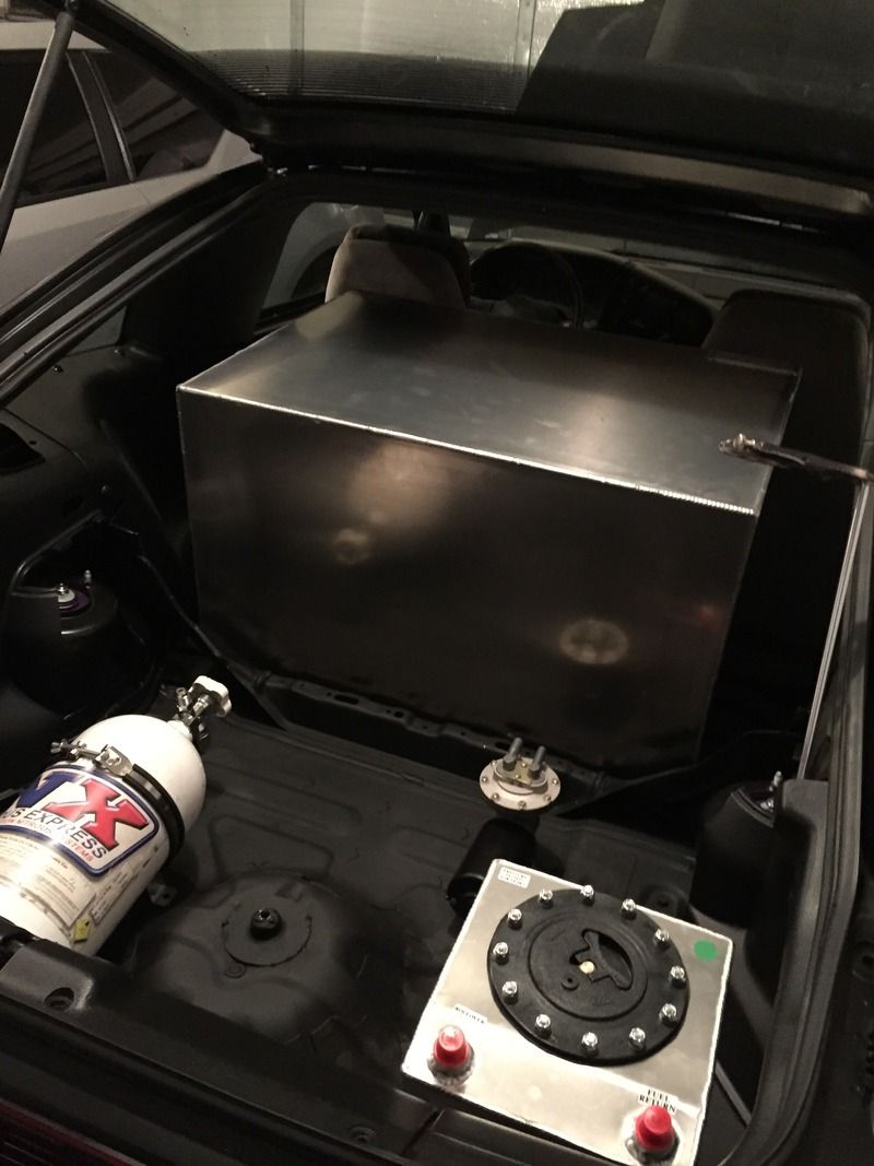

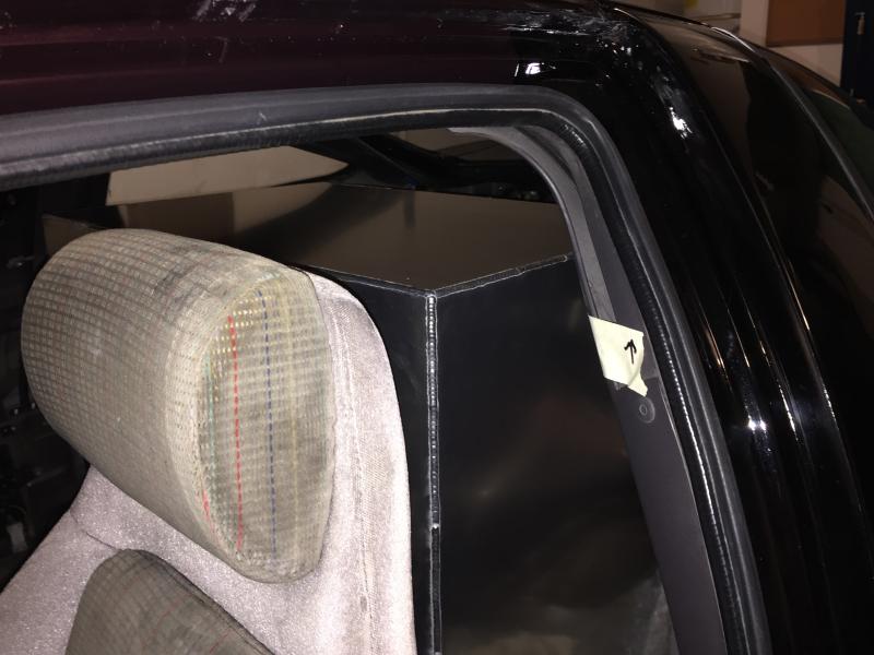

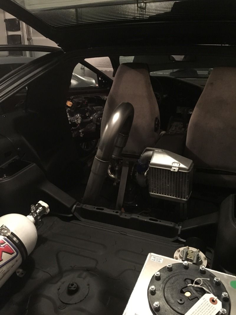

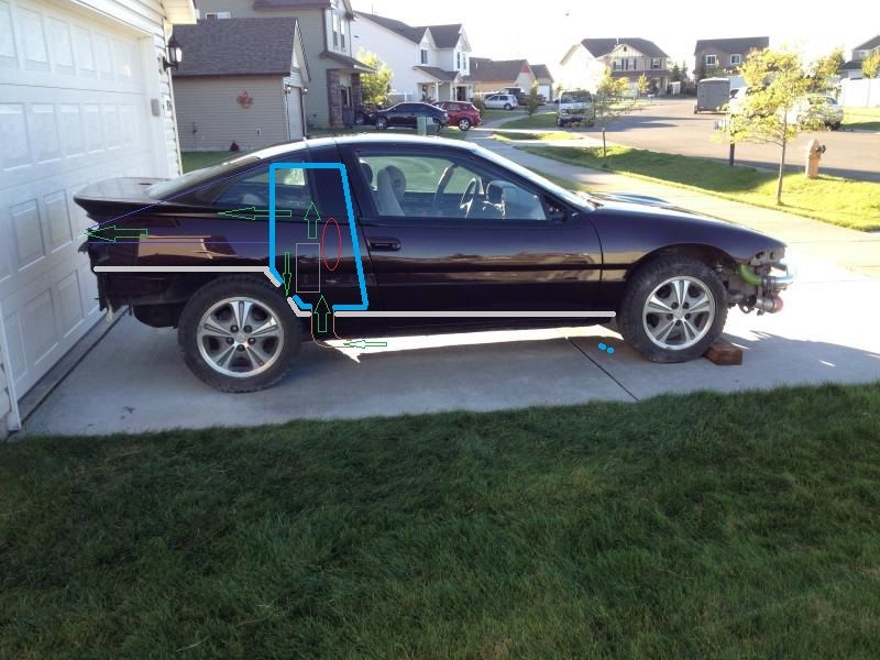

I'm having a good friend build me a aluminum turbo box that will house the FP Red turbo and low pressure inter-cooler. This will be vented from the floor and some air will go through the inter-cooler and exit, and some air will feed the FP Red turbo.
Mock up of the box.
I checked to see if there will be any blind spots and sitting in the car looking through the rear view mirror you don't even see the box.

Final fit on the turbo box.
Now I will drop it back by the welders tomorrow and have him finish welding it up.

I did some testing early this year and this combination makes instant boost.LOL
Here's a pic with the cover not installed. There is a divider between the intercooler and hot side of the turbo that's not shown.
Another pic of where the N2O bottle will go and vacuum pump. The 3 gallon tank is for road use only. I will write about it later.

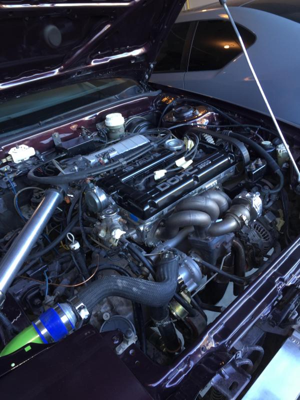

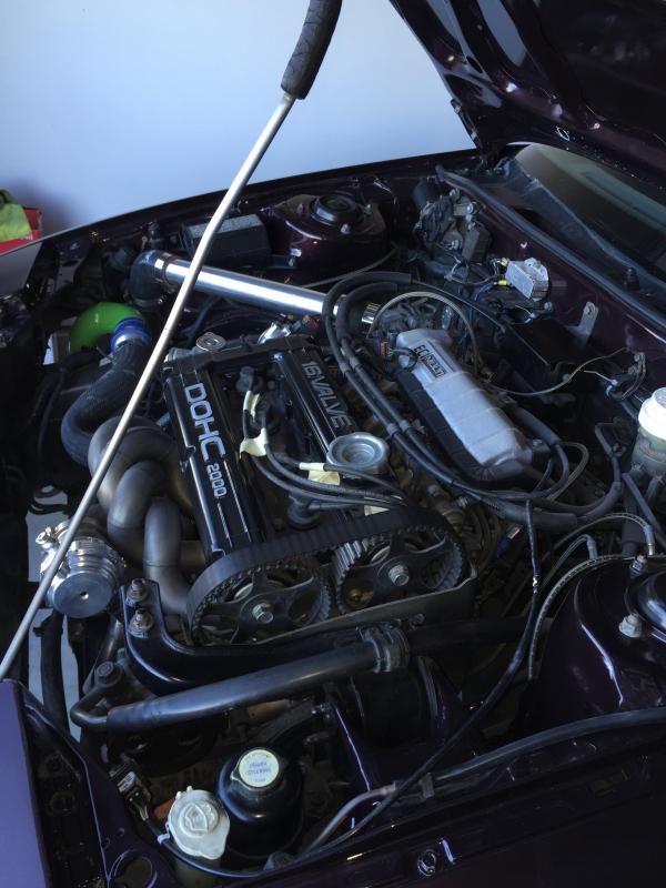

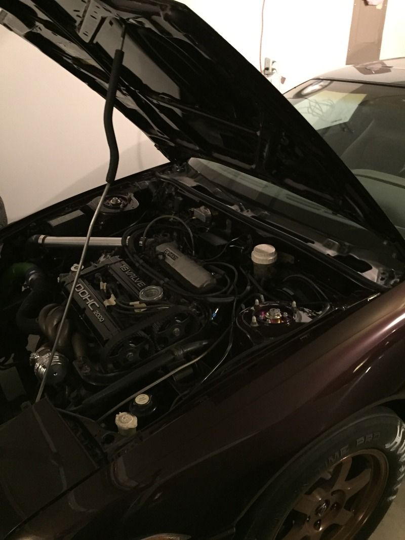

Under hood pic with the new D2 installed. The 13g charge pipe is just a temp to get it running. I'm having a one piece aluminum made.

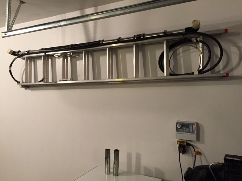

Finished my Low Pressure Turbo to High Pressure Turbo Charge Pipe today. This is the 3rd one I built and I'm happy with this one for now.;)
I decided to run my oil feed line and oil return line down the same path with the charge pipe. This keeps everything much cleaner and away from the exhaust pipe and drive-shaft.
I did some pressure testing also, from 10 psi to 30 psi to make sure it didn't leak or blow. Had my ear protection on also just in case.OMG
Also the ladder is not part of the charge pipe. Its just a great place to put the charge pipe while I work on some other things.LOL

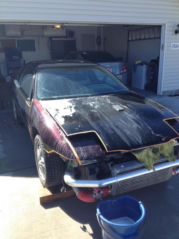

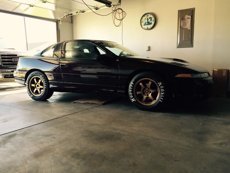

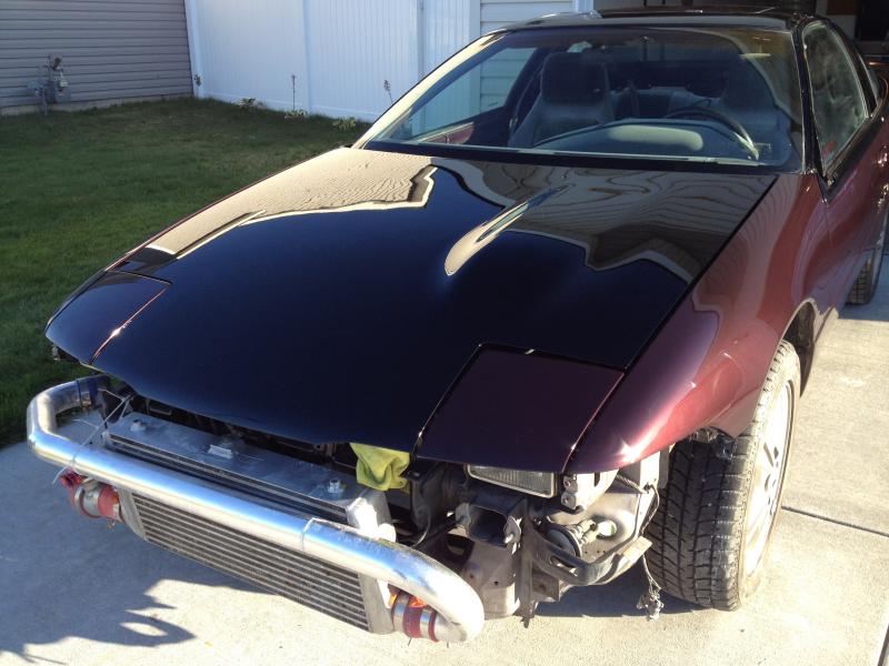

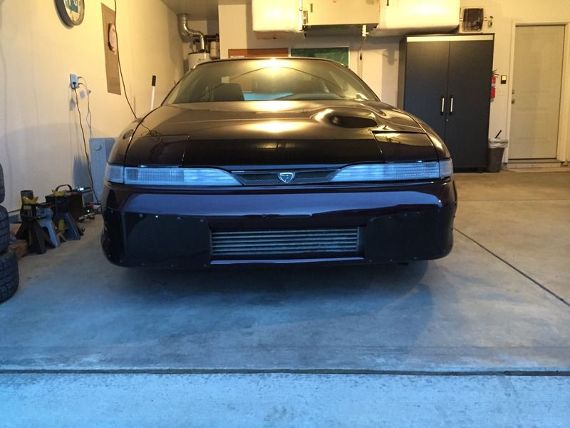

After I painted the car I forgot to fix the gap on the driver side head light door. The gap is large enough to throw a small size animal through it.LOL
So I worked on it today and got it pretty good for this beater.

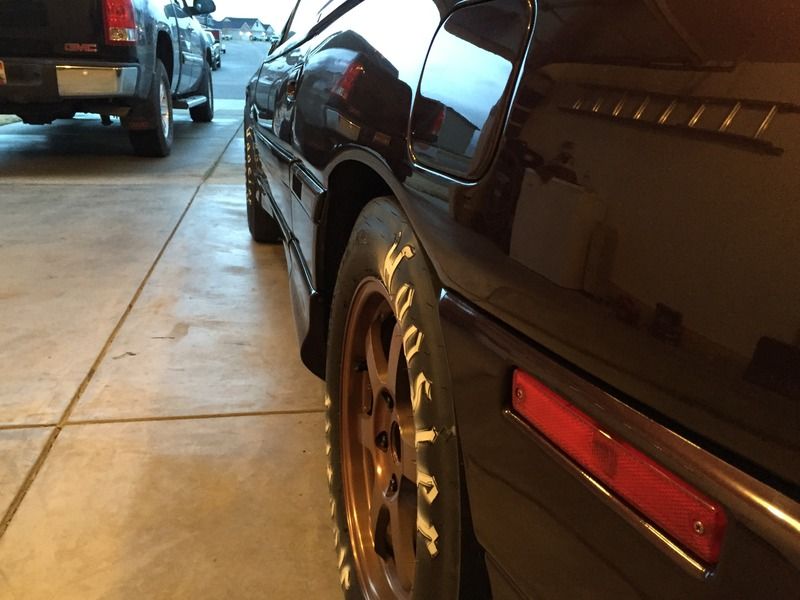

The first pic is where my ride height is set at now 3 1/2". The tires are clearing and everything looks good so far? I'm going to have to be very careful though and always be thinking about the low clearance when driving on some of our roads here. The other concern is the Tilton electric pump is mounted up front so I will have to watch out for parking stops and curbs when pulling forward. But I guess this is the game we play.LOL
I'm going to replace the front bumper later this winter with a new one. I didn't sand out all the rock chips as good as I should and it really bugs me.:(
My new version high to low pressure charge pipe is all mounted and tuck up and now sits higher then the exhaust system so I'm very happy with the results.
Now my biggest concern is the way this thing looks. It draws a ton of attention and we just had a bunch of young punks racing in our new local parking garage so now all the cops are profiling import cars again. Maybe the fact I'm a old guy driving this thing they will not pull me over?:rolleyes:

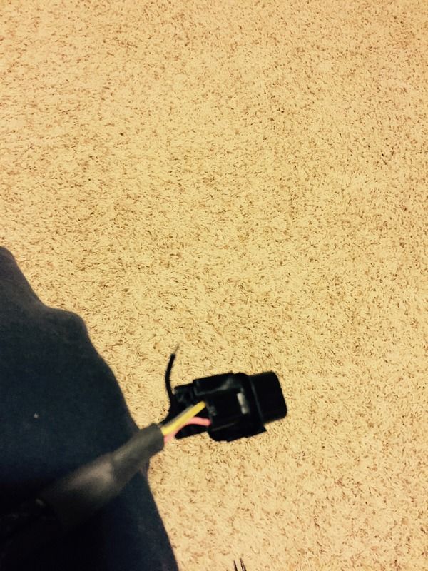

My MAP sensor was acting totally messed up. It would read 42psi at idle and 36psi when the engine was off. I couldn't keep the car running, after about 2 seconds it would just load up and die. I kept thinking I must of change something in the ECU inputs accidentally???
But after walking away and enjoying a nice dinner and a fire outside I decided to just look at what the map connection's looked like? Then I found this.
The ground wire for the MAF to MAP Speed Density cable came out.:mad:
So now I have my car tore all apart chasing ghost and crap that's not even there.
