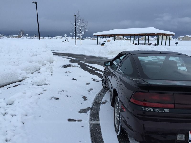

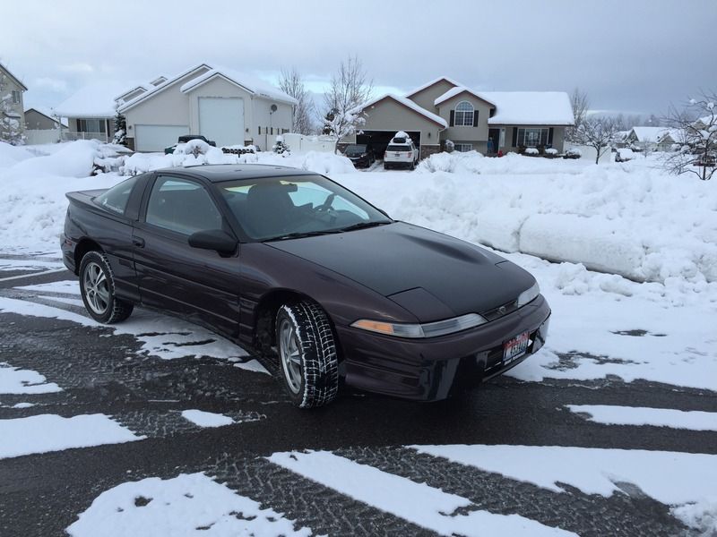

Took the Talon out for some winter fun. Took this pic at the same location that I did last Summer.
Merry Christmas everyone and have a safe and happy new Year!!!!!
right down the road from me. clean car, looks good man.

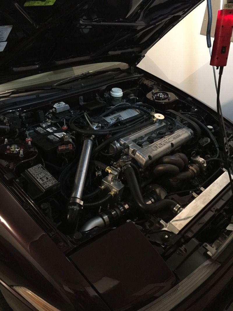

I went back to a single conventional turbo system. I killed 3 small turbos and a lot of drive-train parts. I'm going to change up a few things on my next turbo compound setup. This year I'm going to run my FP Red and spool with my nitrous system.

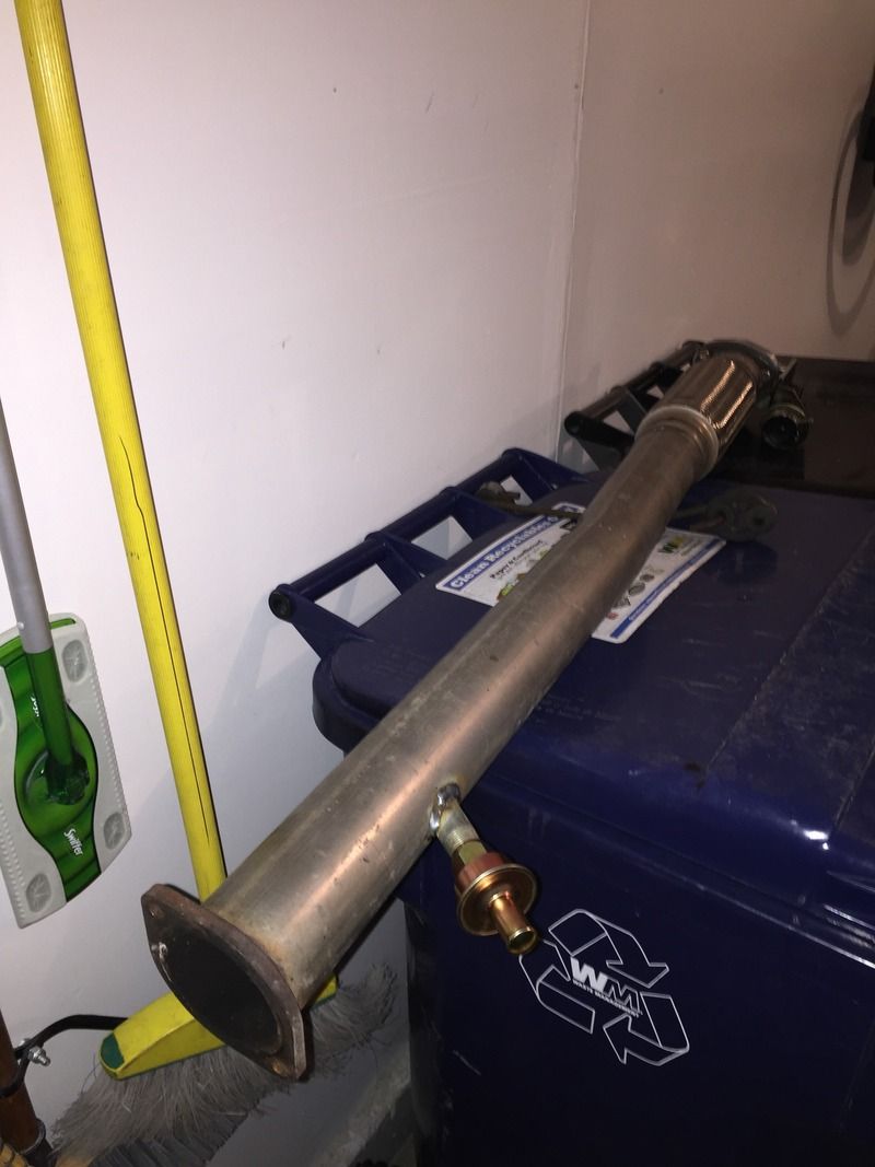

I just finished my sealed oil separator system with a exhaust evacuation. It works awesome!!!!
Been awhile since my last update. I got the nitrous system working great. First kit is a 75 shot to get it up on the convertor and run it out the big end.
My second kit a 150shot comes in at 6500rpm to 8500rpm. I also wired up my vacuum pump to hold it on the brakes along with anti lag activated through ECM Link. I need to get a Kiggly flex plate now because the bolts are starting to rock and kill the double stacked stock flex plates.

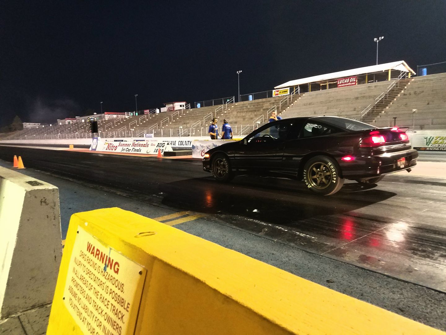

Its been awhile. I put my car threw some hell this weekend. Drags on Friday Dirt drags on Saturday. LOL
