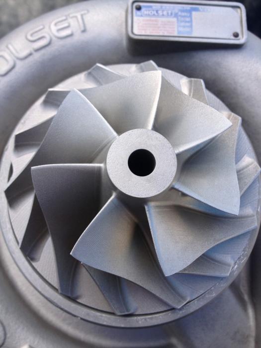

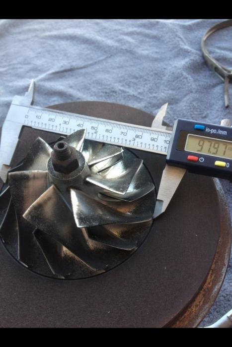

Finally got my HX52 on Friday. I took compressor measurements and mine was 65mm IND 98mm EXD. with a billet wheel. Info on this turbo a sparse. I've heard of 67mm IND as well
I have the 67mm model. Looking good guys!
The compressor wheel on my HX40 is 66mm. It's the "Devil Pro" that I had made by Turbolab, should put some pretty sick numbers down once I get the new motor squared away!
