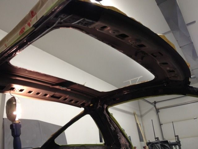

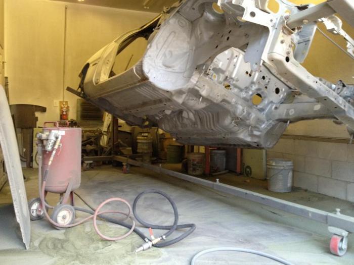

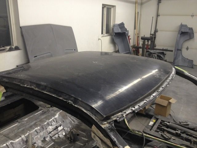

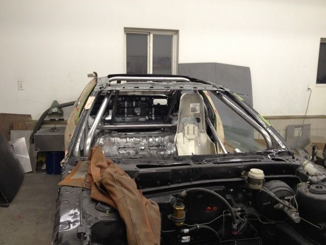

Hello, First off I would like to start off by saying that I started off my last build thread on the wrong foot. I was arrogant and cocky. I had no right being either, but its my turn to take that all back, start a new log from scratch set zero goals and just get it done.
The car is a 1990 TSI AWD, a very clean car and a perfect starting point as it was a bare roller when I got it. It has had lots of weight removed, a new paint job and a new lease on life since I bought her roughly 3 years ago. I wont lie, I go through stages of working my butt off for weeks at a time then get bored and start something else. This time that will not happen. I am planning on weening down my litter after this car is completed. I will start off with a list of things that have been done to this point!
Chassis-
Sunroof to non sunroof roof swap
10 point NHRA certified Roll
Tons of weight savings throughout the car
Stitch welded every seam of the car
Suspension-
KYB AGX with megan springs (not permanent)
Poly bushing front subframe
Poly bushing rear subframe
Rear custom made upper and lower control arms
Rear RM sway bar
Rear Toe links welded
Transmission
Evo III 1st
Welded center
Magnus Forks
Liberty Faceplated gears
Transfer Case-Rear diff
Stock Transfer case braced
Custom Chromoly Drive shaft
LSD 4 bolt rear
Engine- Bottom End
2.0 Long Rod
R&R Aluminum rods
Manley 10:1 Pistons
New OEM Crank
ACL Race Bearings
Kiggly Girdle
All OEM Oil and Timing Components
Rods Coated with Thermal Dispersant Oil Shedding Ceramic
Piston domes coated with Thermal Barrier Coating
Piston Skirts Coated with Cermalube.
All Bearing surfaces Coated with DFL
And of course BSE
Engine- Head
6 bolt head
Heavily ported and polished
ENGNBLDR Valves, Guides and lifters
Kiggly HLA
Cams are to be determined yet
EVO Rockers
Manley springs and retainers
AEM Cam gears
Fuel
10 Gallon Cell
Single Weldon pump
2 Injector banks, still unsure on size
Magnus Intake manifold
-8 Feed from cell to rail
-6 Return Rail- Cell
Tuning-
Have yet to make any decisions.....
