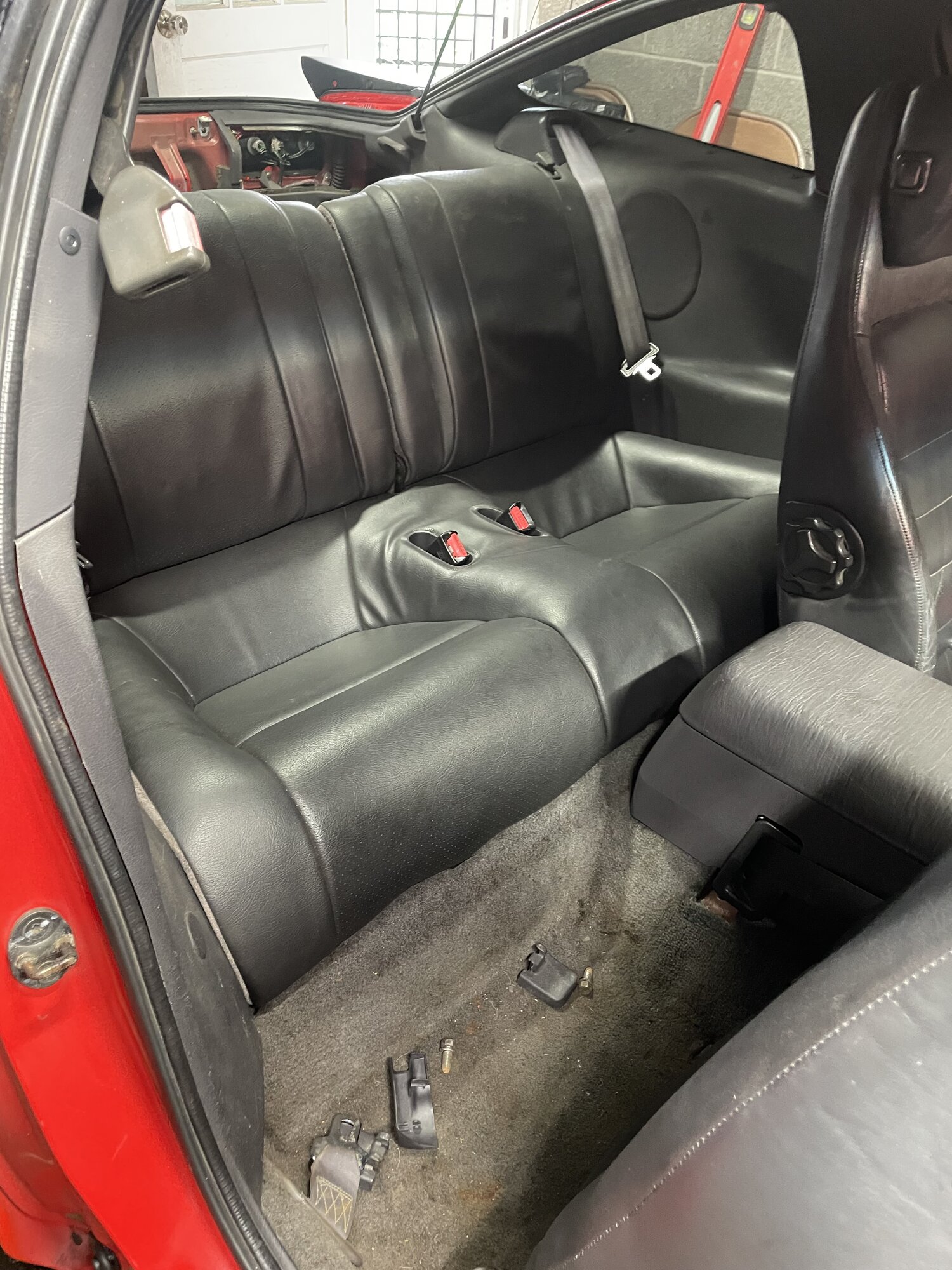

I know it's cost prohibitive, but it would be so cool to see someone reupholster some 1g seats with some perforate Alcantara center sections and headrest with leather bolsters. Would look so cool. They're not bad looking OEM seats.

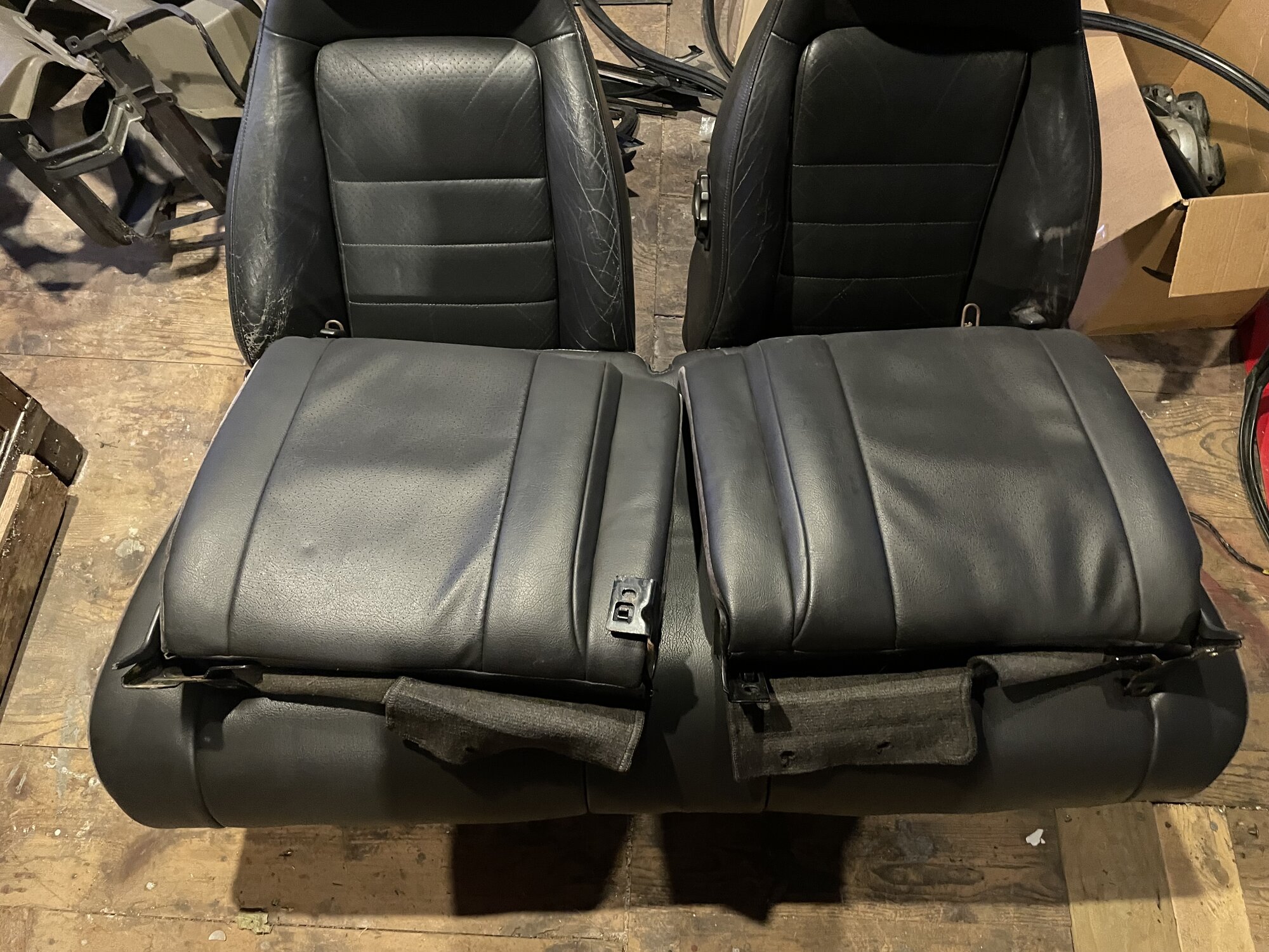

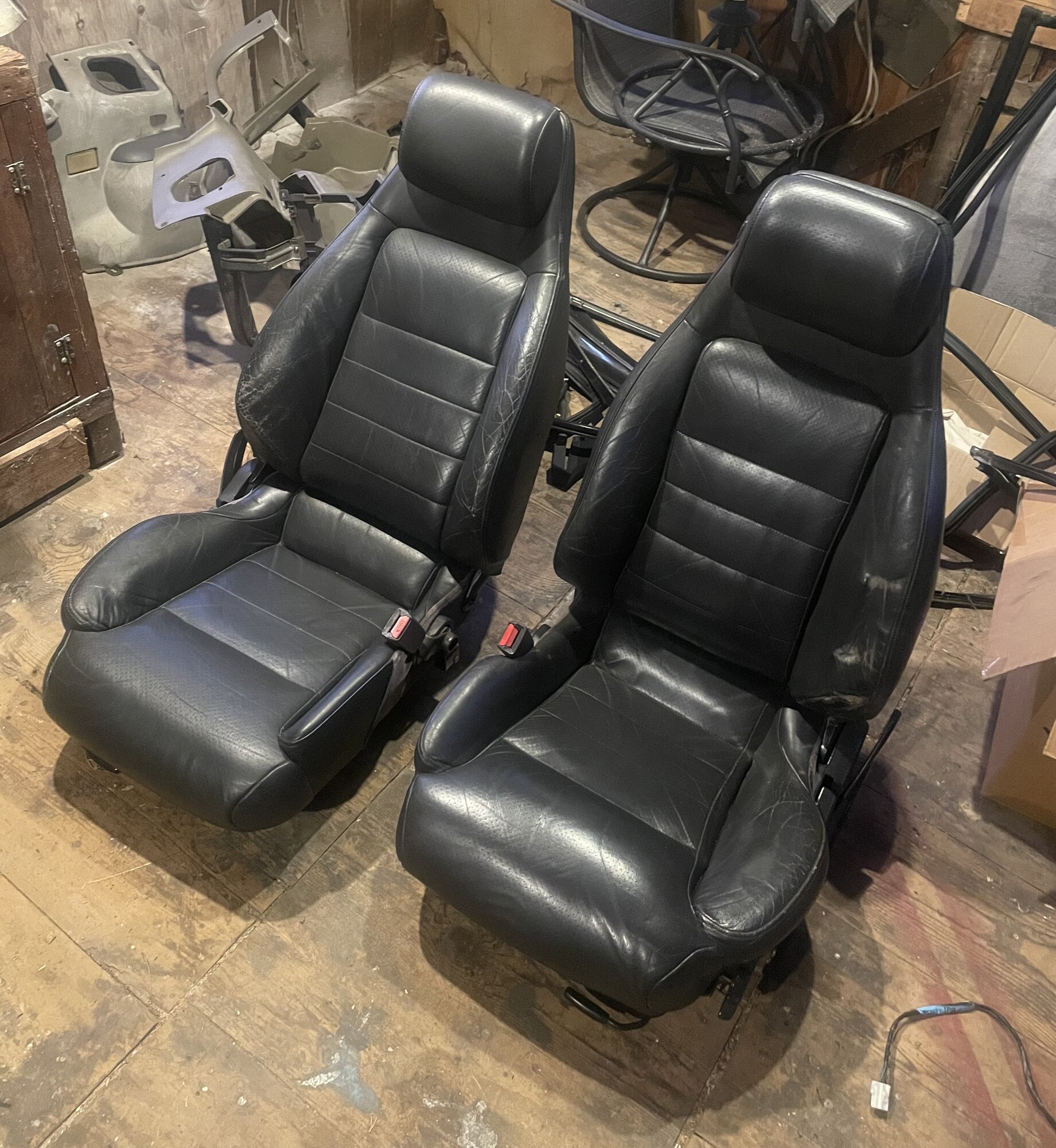

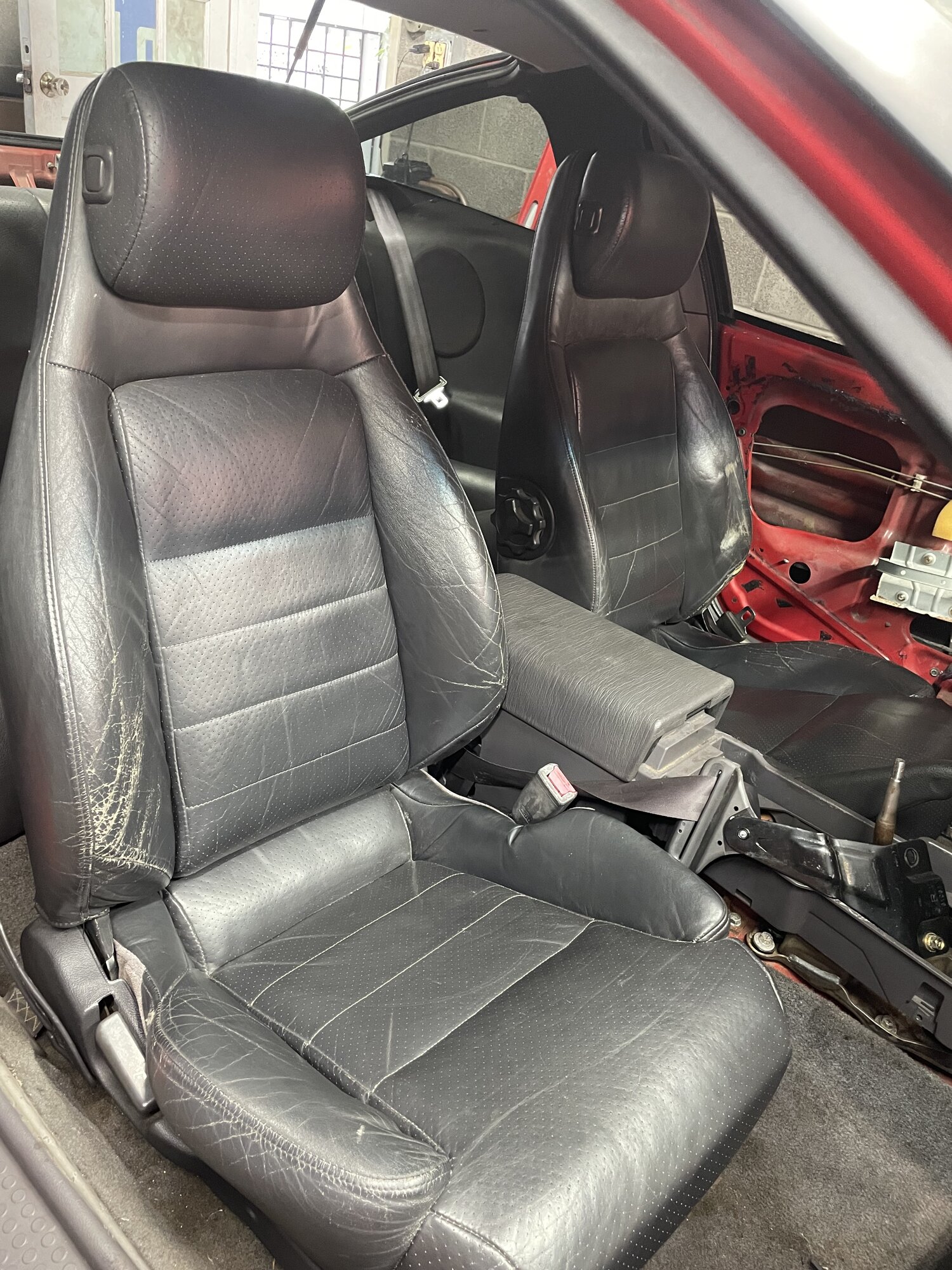

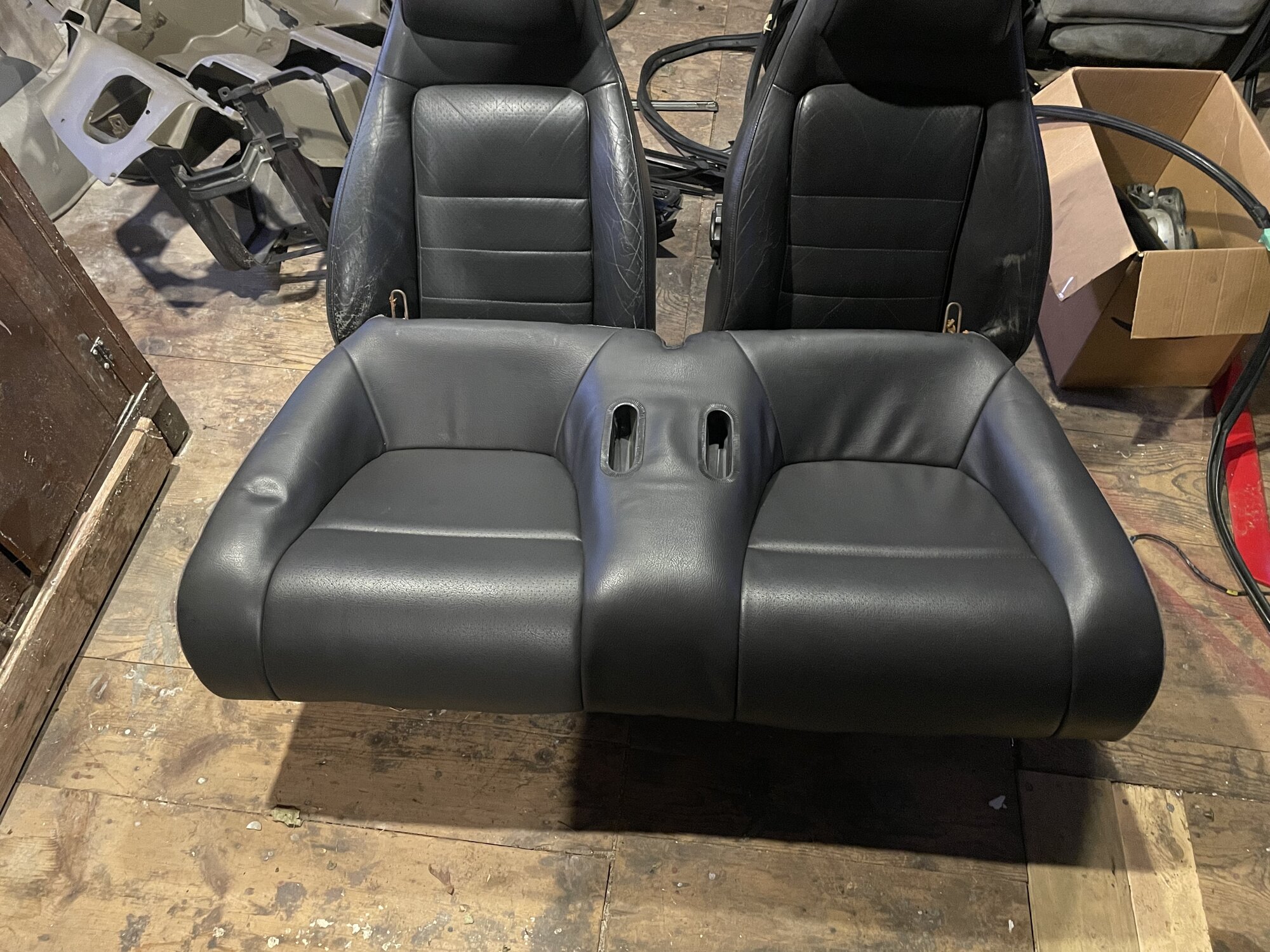

So I’m actually getting two full sets of black leather seats. The second set of front seats are not in good condition. I think i will take apart the worse set, and cut the hog rings out that hold the upholstery to the seat cushion, and try to send it to a shop to have them duplicate it.
Drove from Philly to Long Island to get these bad boys. I’m so happy to finally have a set of black leather seats. Not in perfect shape, but what more could you ask for a 30 year old set of leather seats
Nice! I always liked the black leather sets in a 1g.
Black leather, and the cloth checker board are my favorite. Used to have them back in the day, but never imagined i would find a set worth putting in this car.

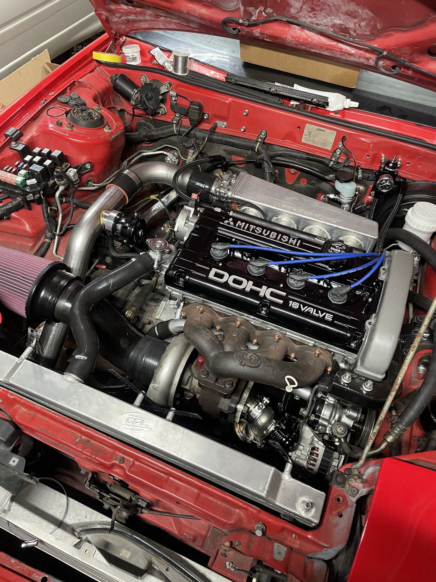

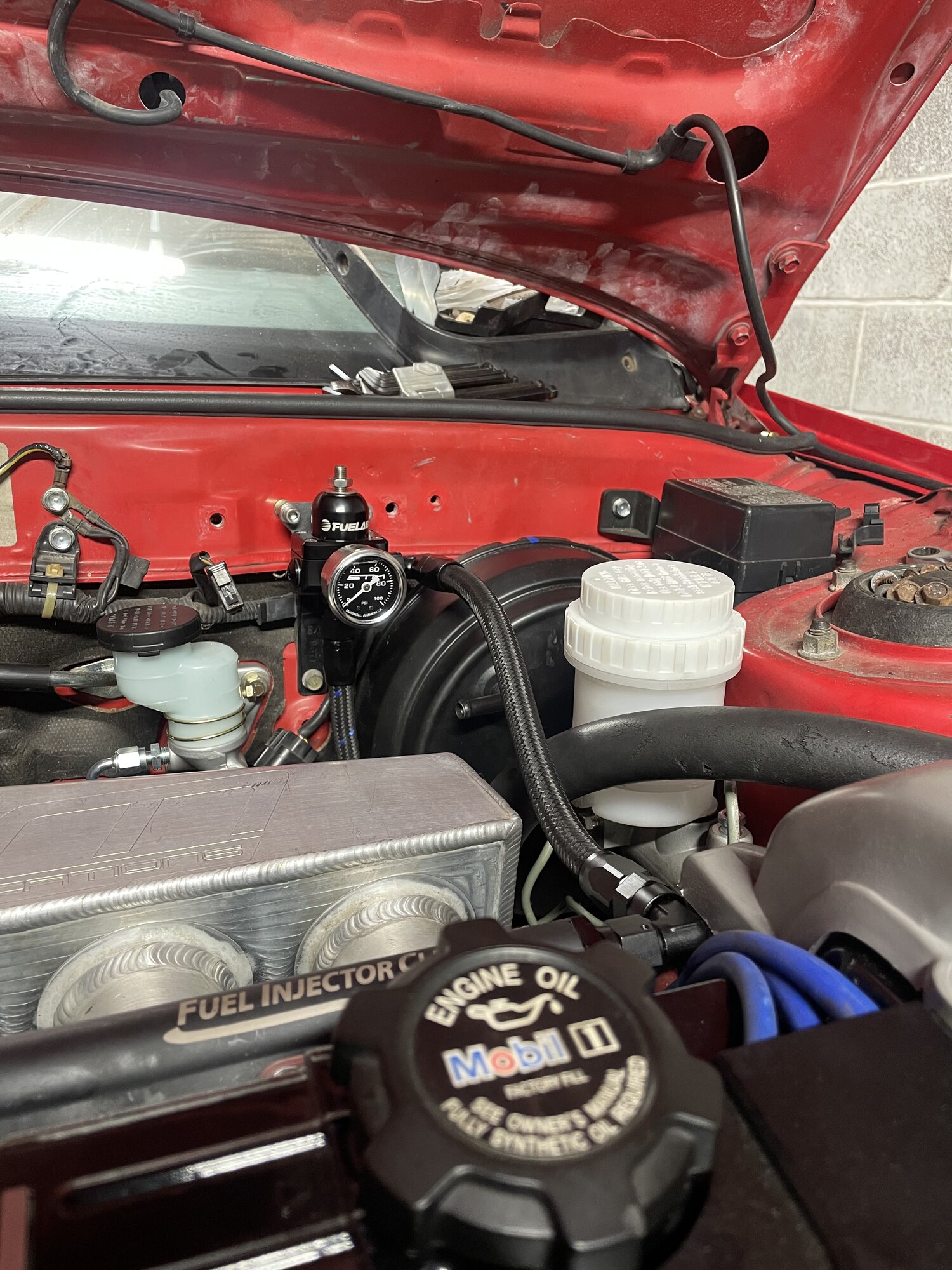

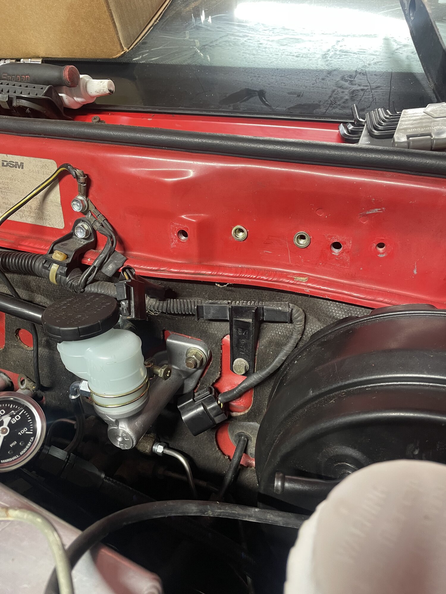

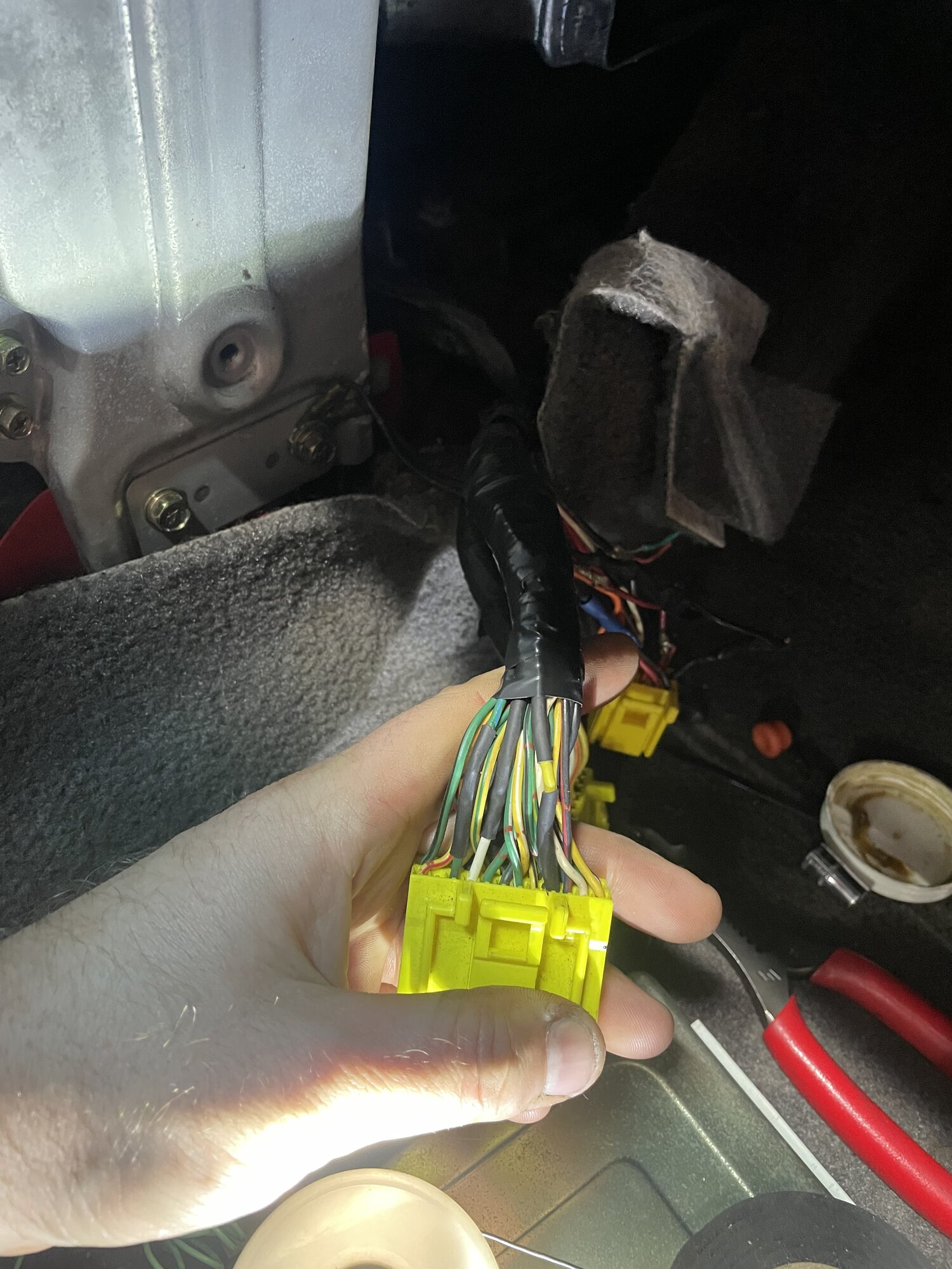

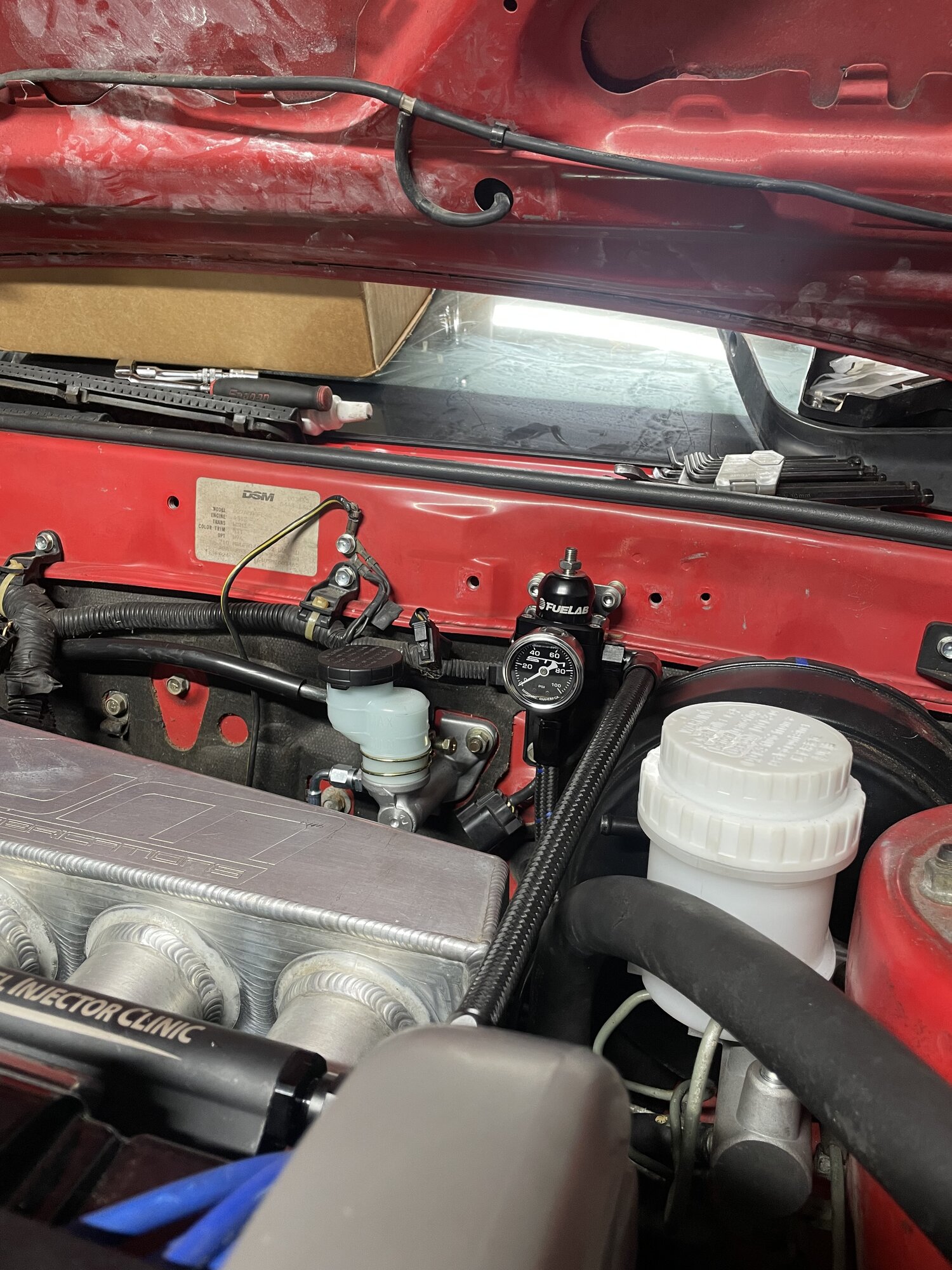

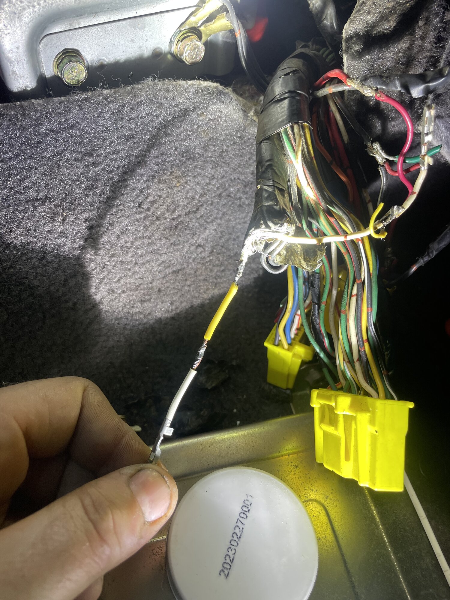

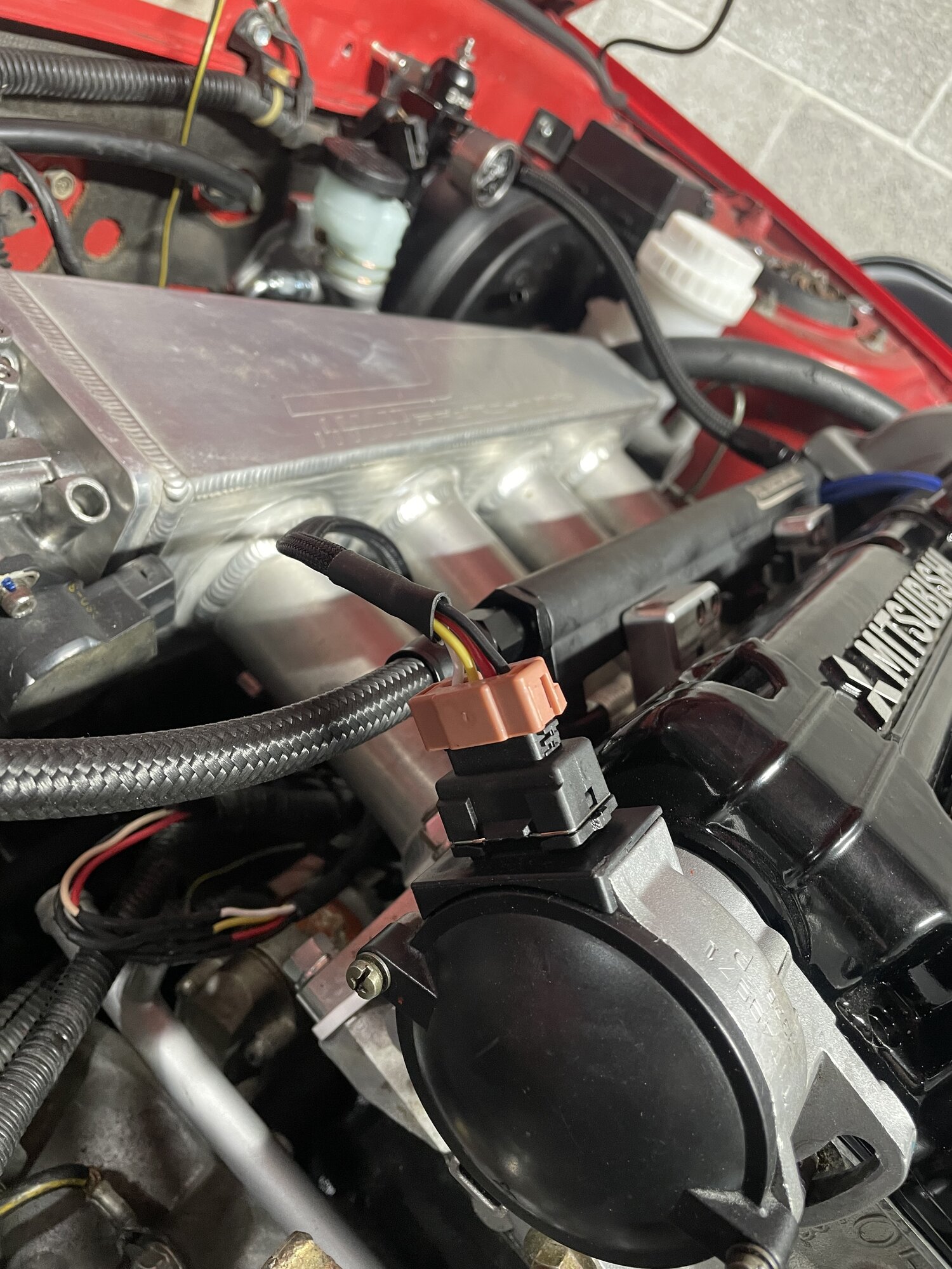

Couple small things done this weekend. Finished mounting the fuel regulator, rebuilt the power steering pump, and got it on the car, and added a new pigtail for the CAS. I’m slow, but it’s getting there.

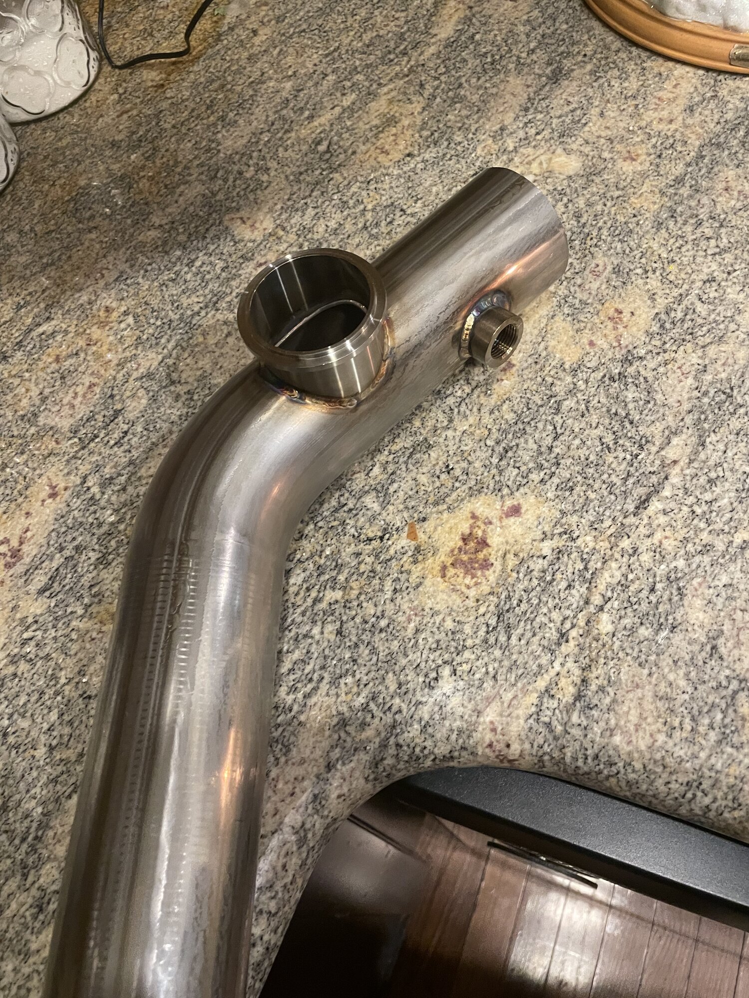

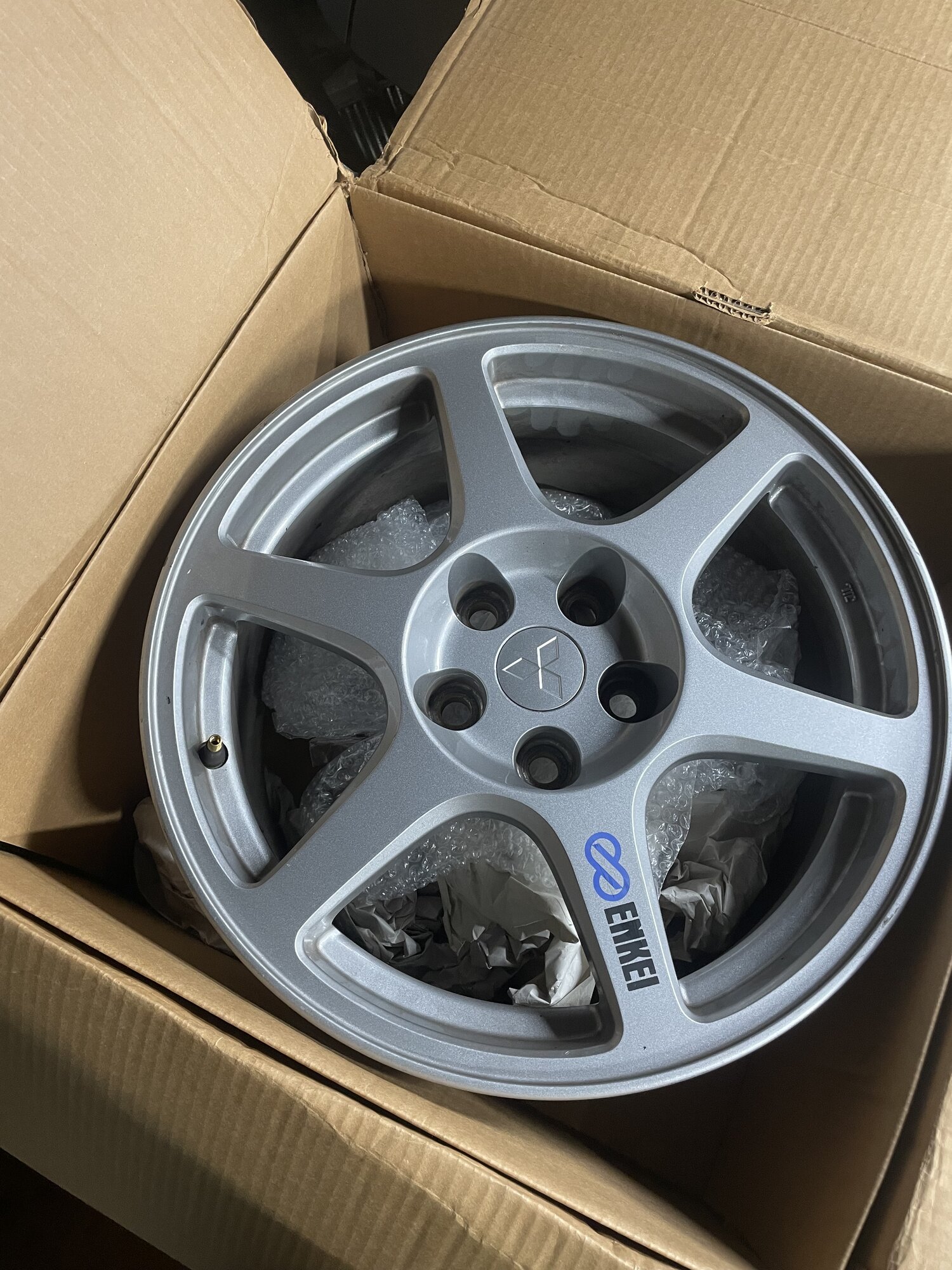

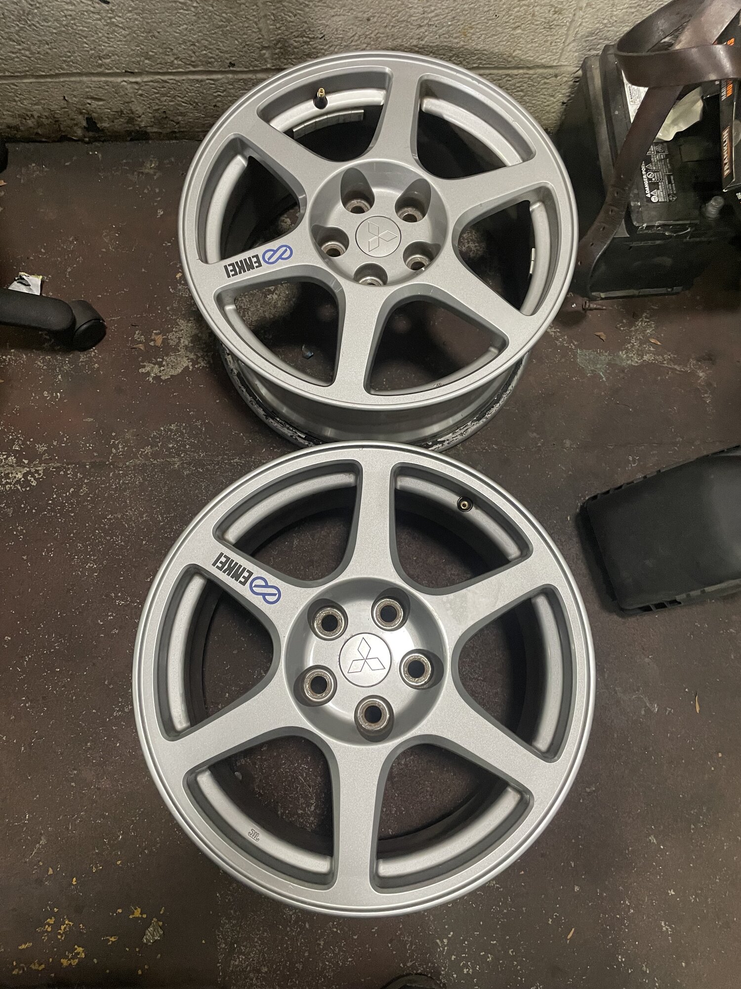

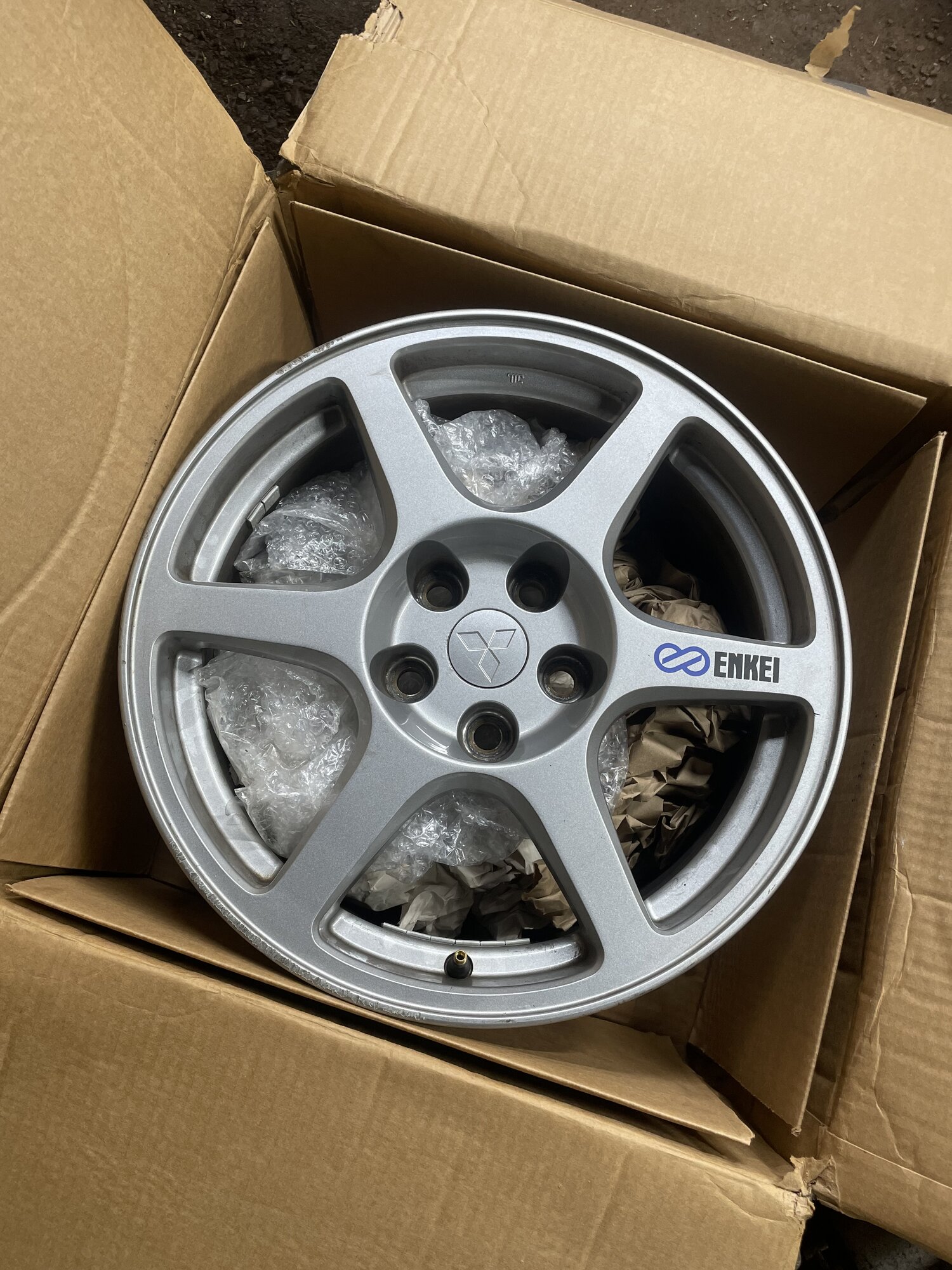

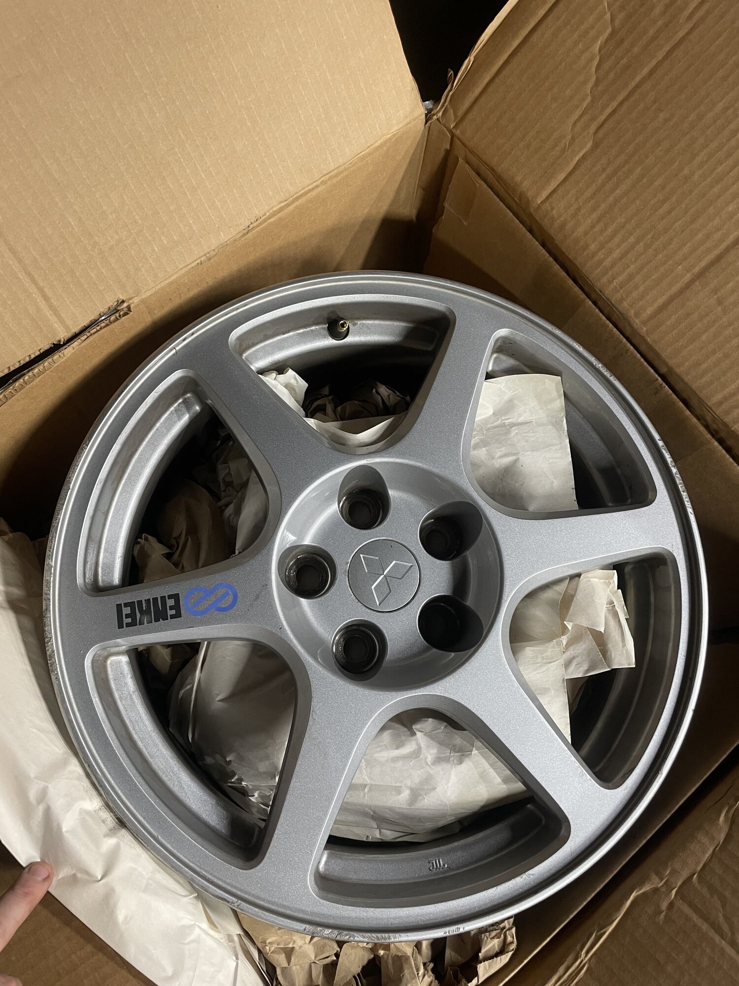

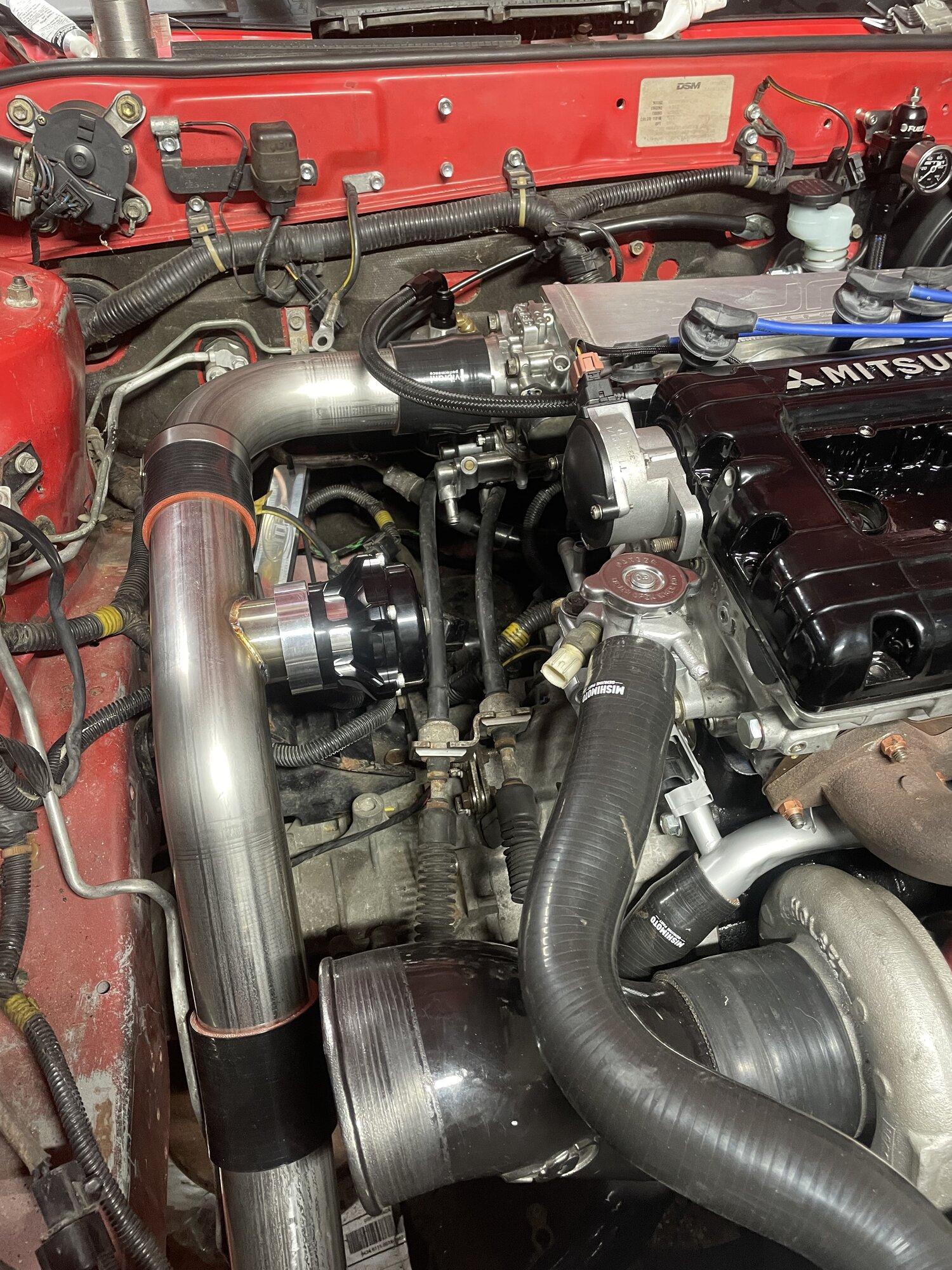

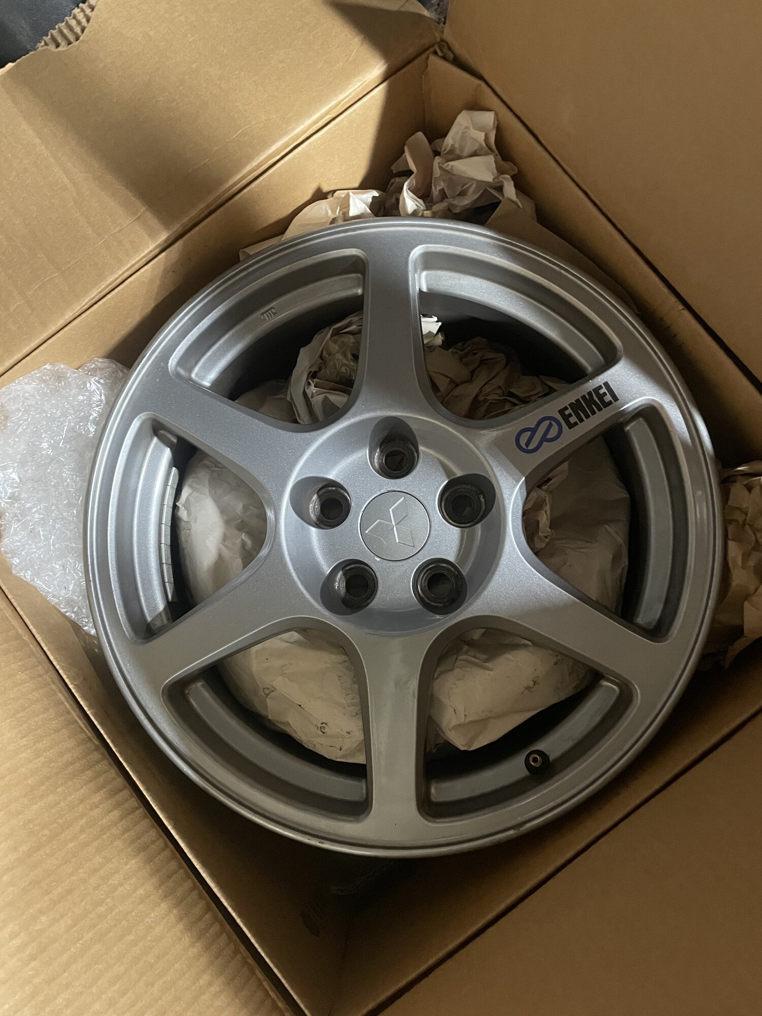

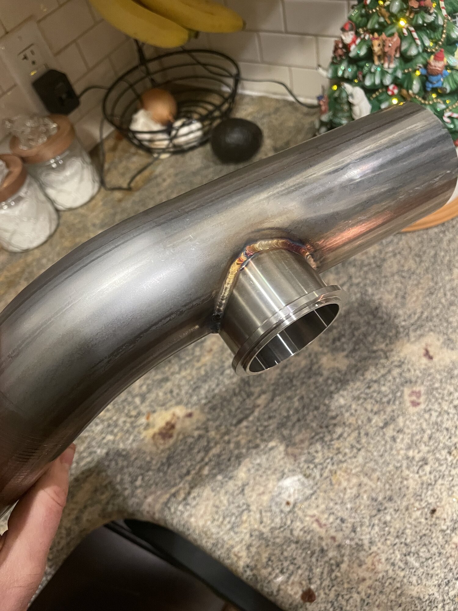

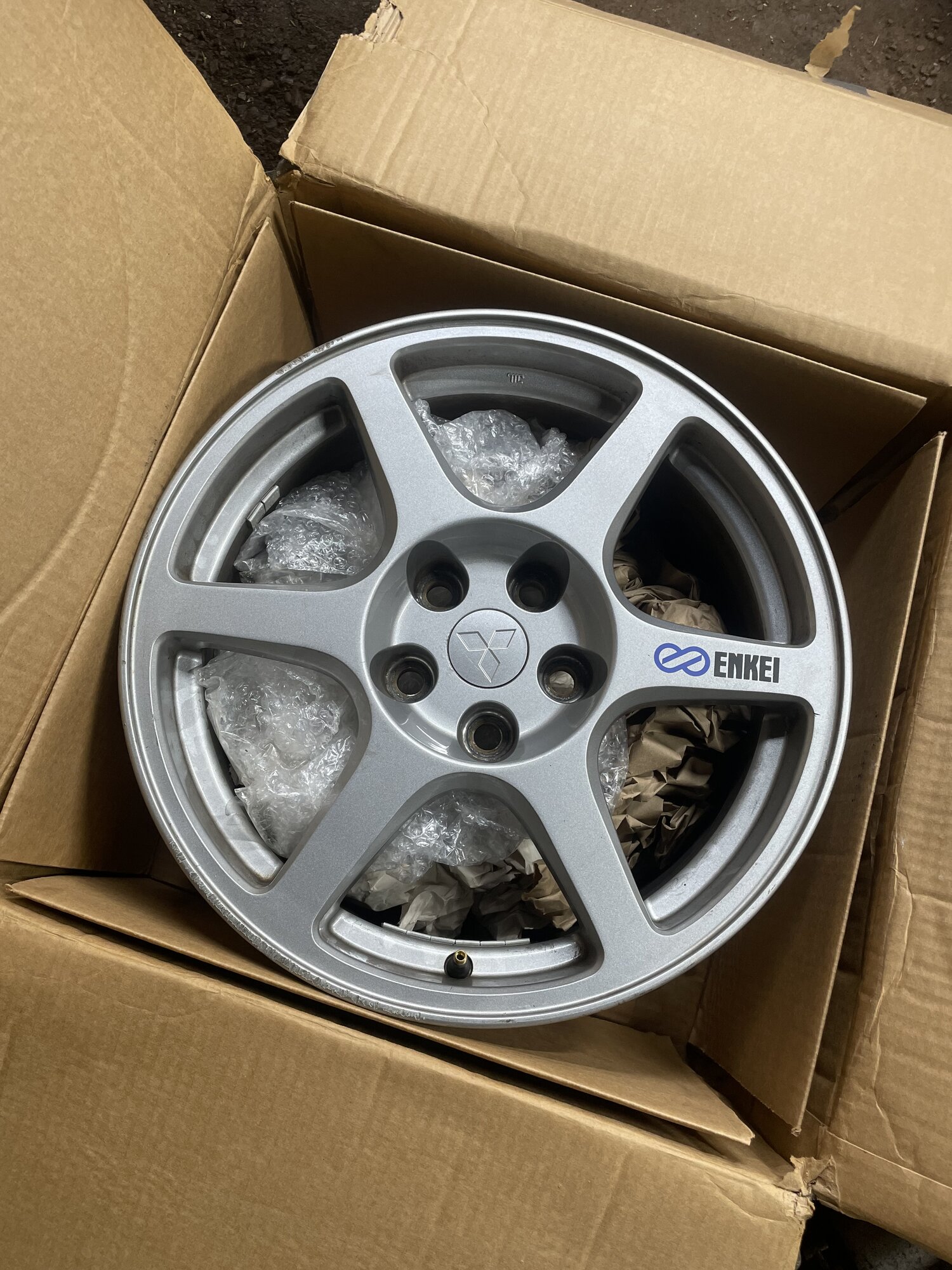

BOV flange, and intake temp sensor bung welded. Was fortunate enough to find these evo 8 wheels my buddy had in storage after selling his evo. Got them for a pre Covid price of 500$ 🤘🏼only question is best tire brand!
Nice score. Best tire brand? You must be looking to start an argument :)
Personally, I've been happy with the Continental Extreme Contact Sports when it comes to a mix of performance and price, with at least some winter capability. It comes in a wide range of sizes.
Lol...yep...thems fightin' words!
Continentals have never let me down and have been my "go to brand" for decades.
I wish I had the disposal income to throw at Michelins, as they do seem to be a better tire, but alas, I'm not at that level.

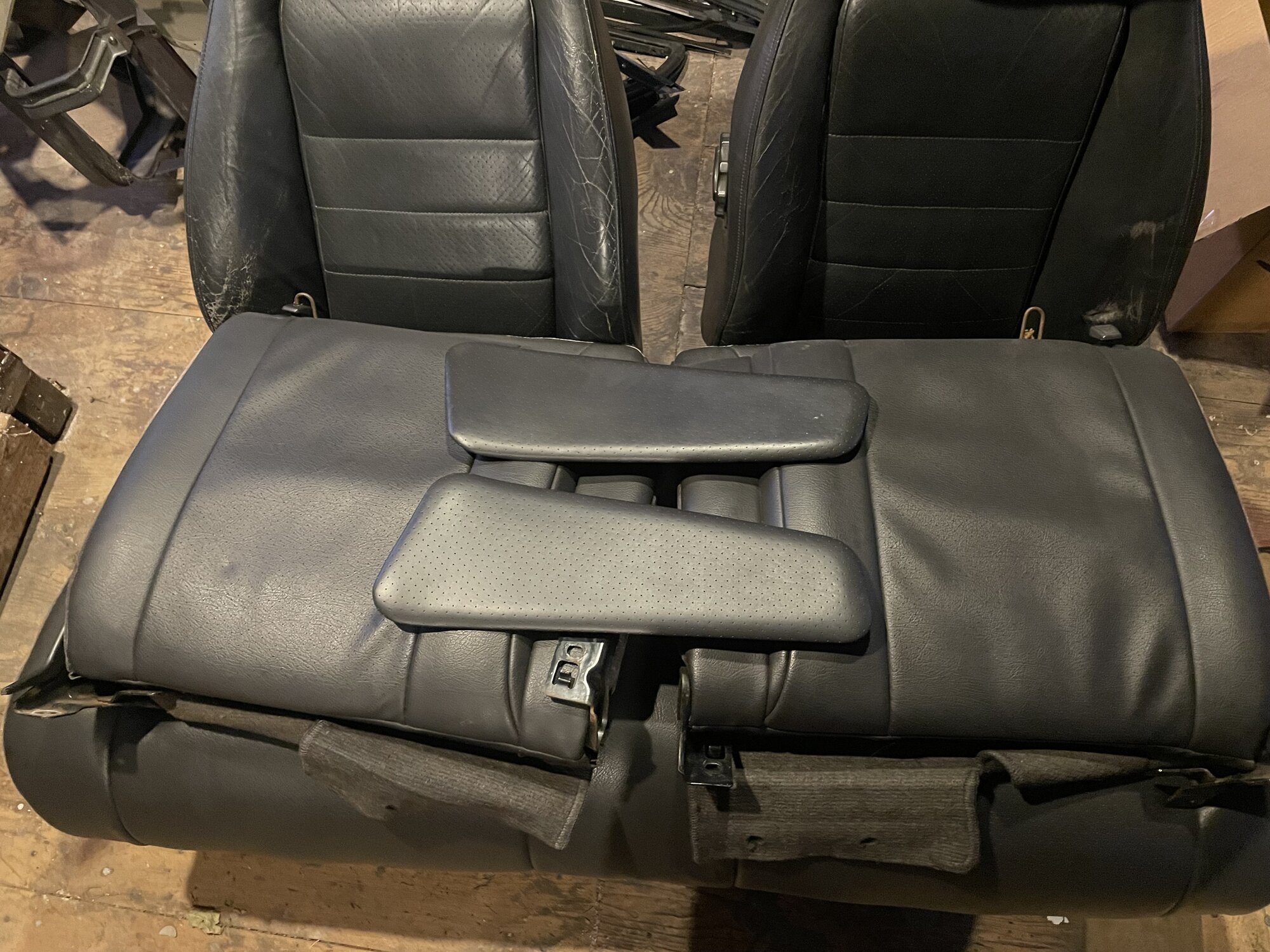

Damn, that is in very good condition. Nice find.
Sent a message to the seller after seeing it in person, and they said it was removed from their car at 10k miles a long time ago. It will look great with the black leather seats in the car.

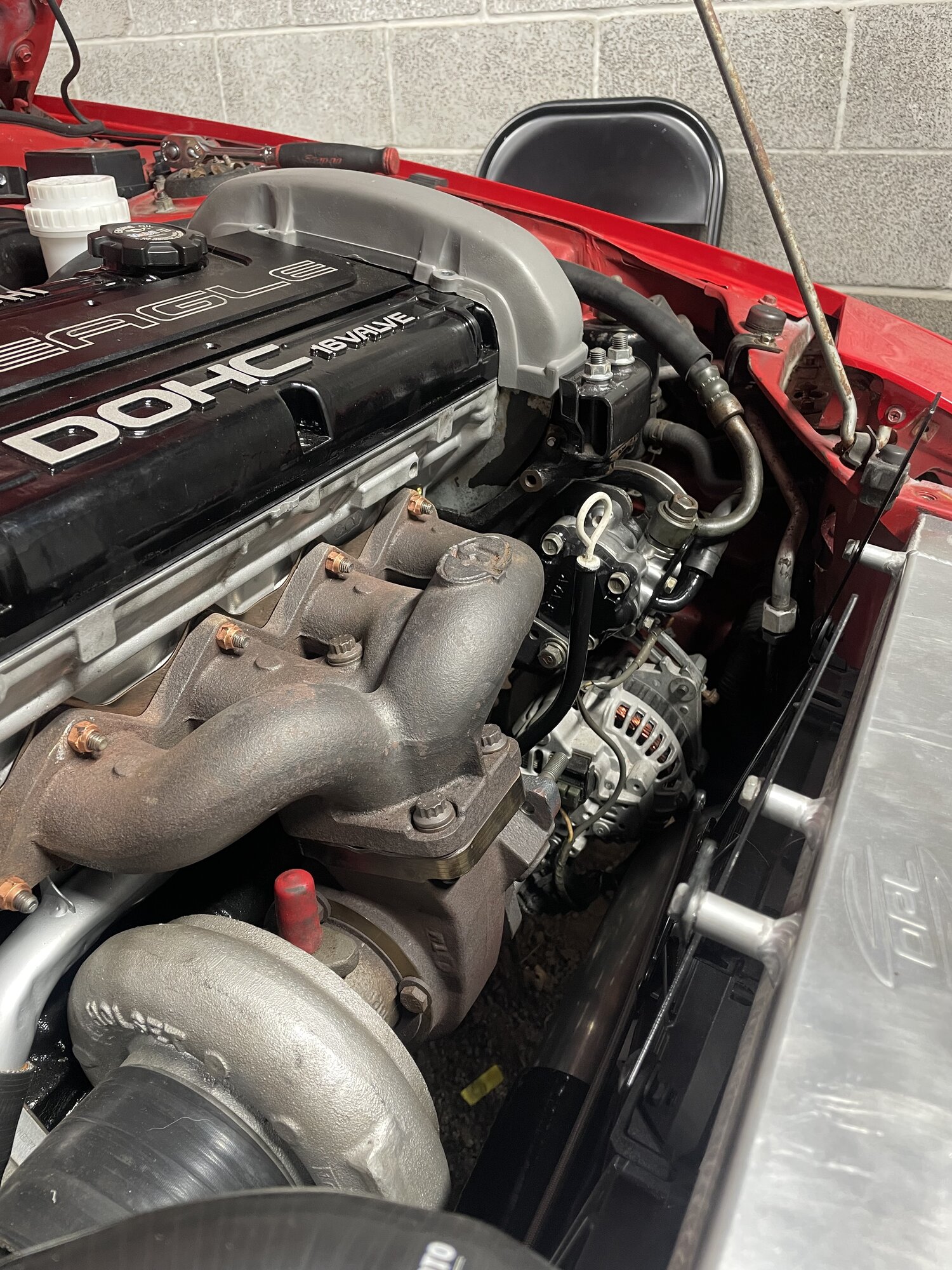

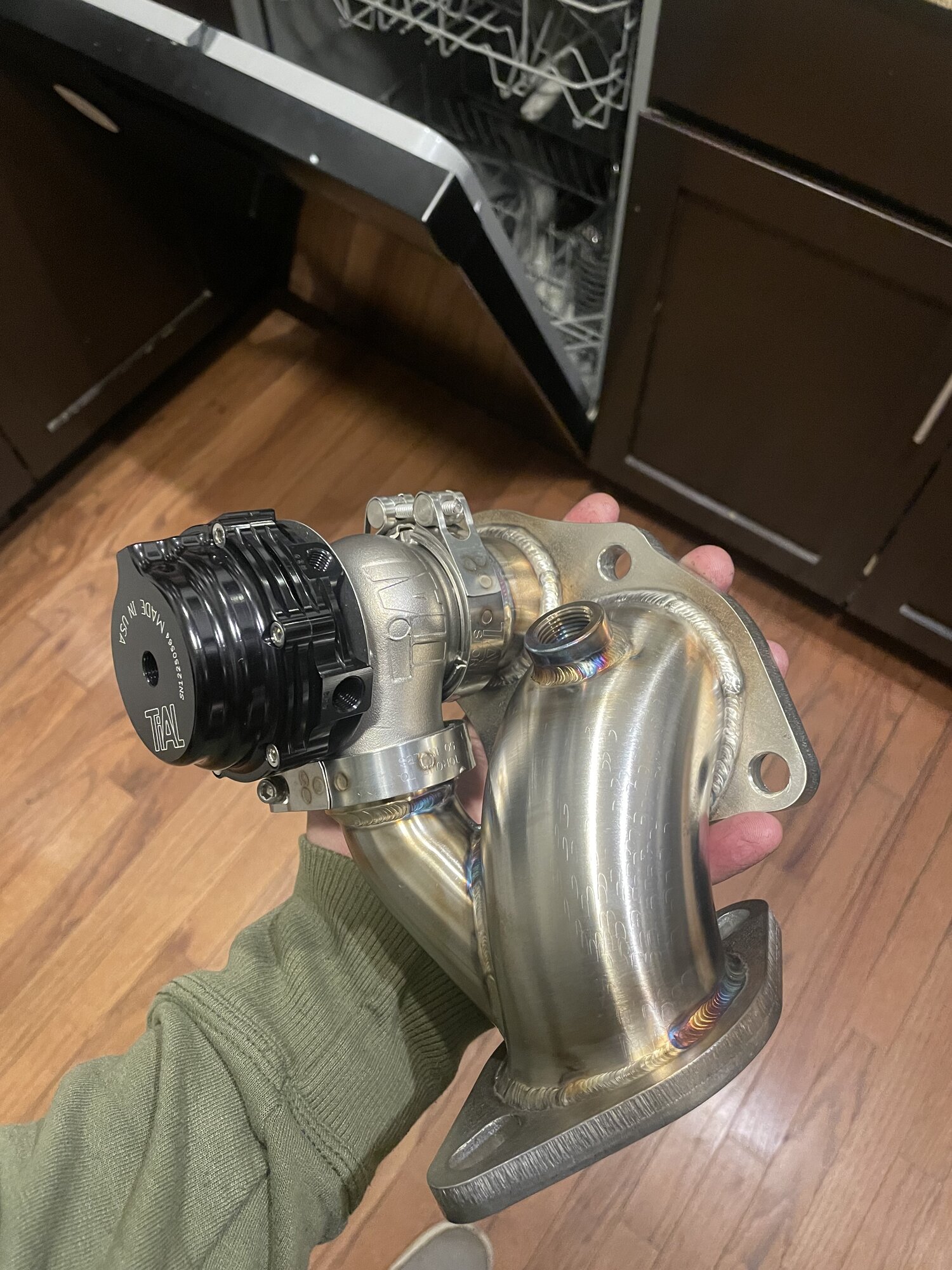

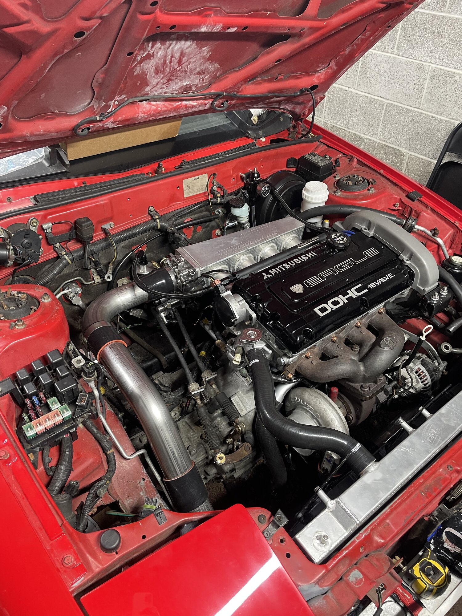

Still just stacking parts. Havnt had a lot of time lately to work on my own cars, but the time will come. The o2 housing and waste gate have arrived
Looks like it fits together real nice but clearance to the alternator, how is that?
Will you be able to put an O2 sensor in there or would it run into something?
Clearance is pretty good. I might have to bend the dip stick tube a little, but i believe the o2 sensor will fit. I’ll have to try that later. Good call
