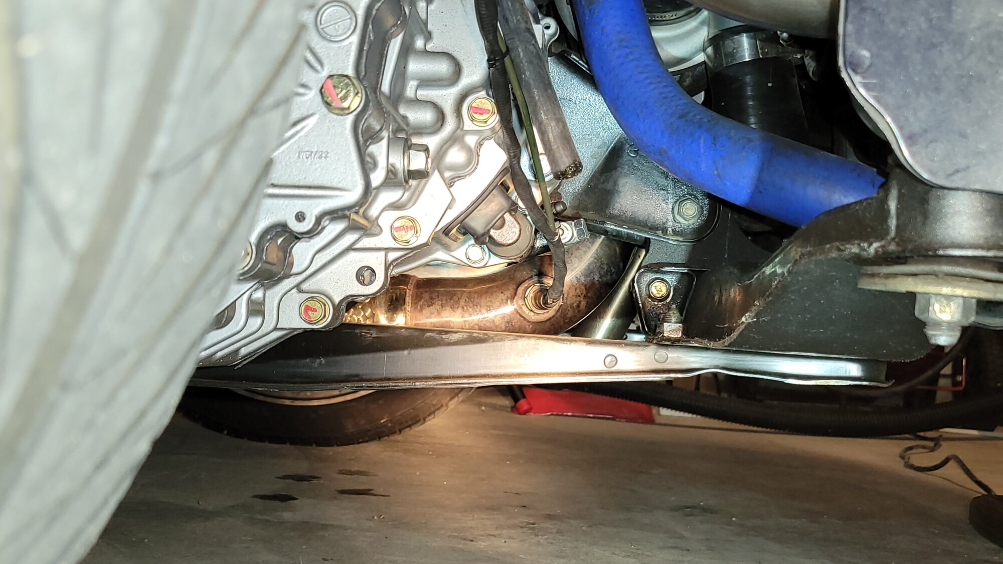

The bung for the wideband shouldn't go too far aft. Usually a best place to put it is like this on my car:
