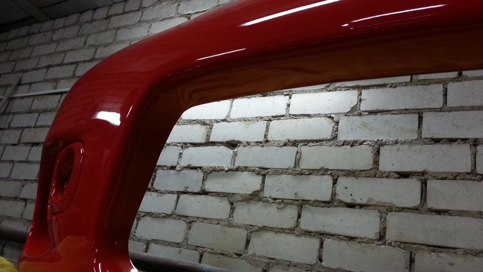

Painting a car red with black roof and wing (rosso nero)
JDM halo projector headlights
Painting rear panel

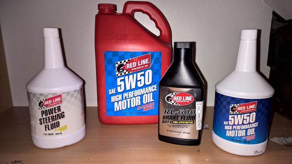

Fluids & Lubricants
Red Line 5W50
Red Line MT85 Manual Transmission & Transaxle Lubricant 75W85 GL-4
Red Line 75W90 High Perfomance Gear Oil (for LSD)
Red Line Power Steering Fluid
Red Line RL-600 Brake Fluid
Red Line Water Wetter

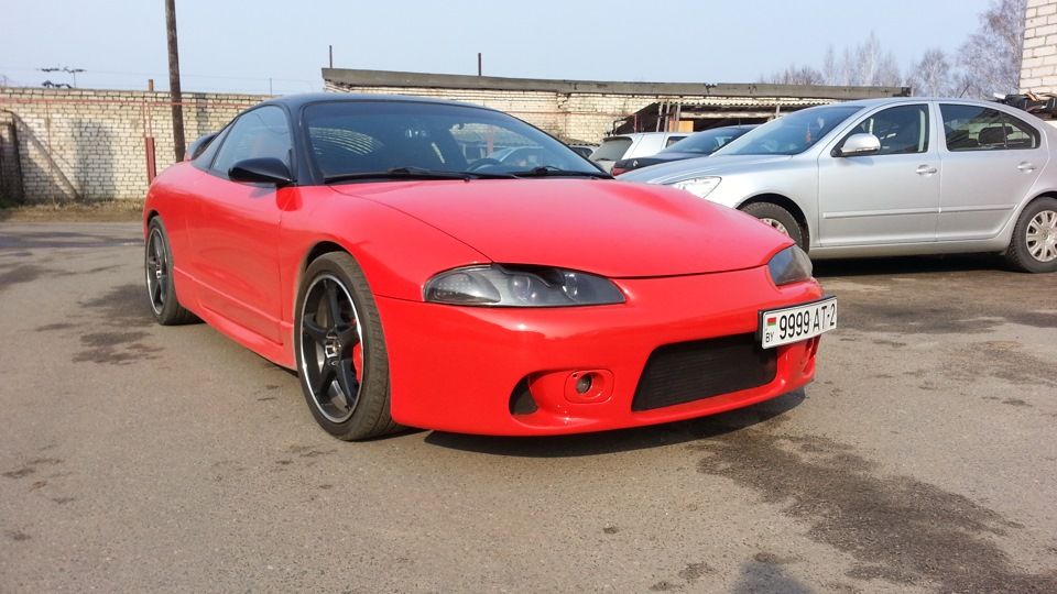

PS Exterior now changed :) Photo lay out later.

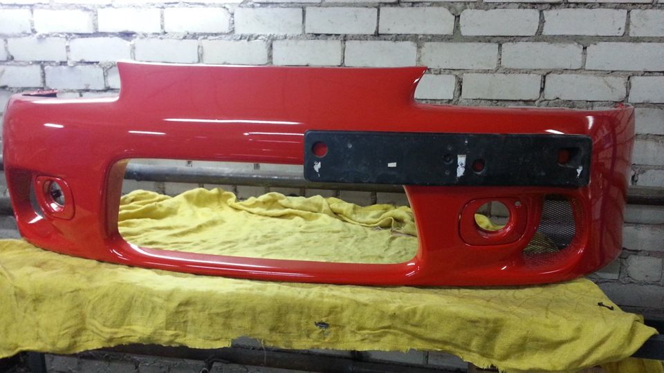

New painting a car red with black roof and wing, removed rear lights, painting rear panel.

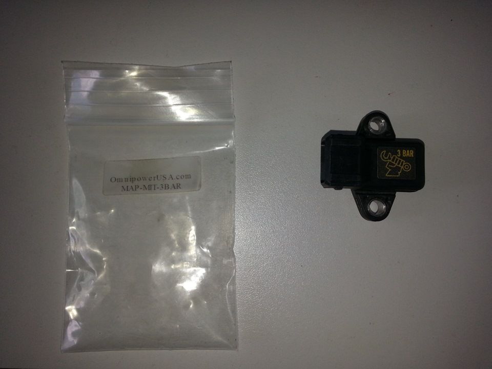

Omni Power Mitsubishi Universal Map Sensor 3 Bar

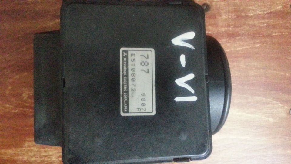

MAF OEM Mitsubishi Lancer Evolution VI

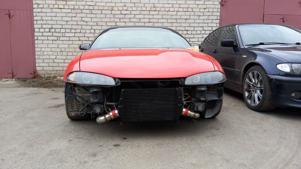

Intercooler Koyo OEM Mitusbishi Lancer Evolution VI

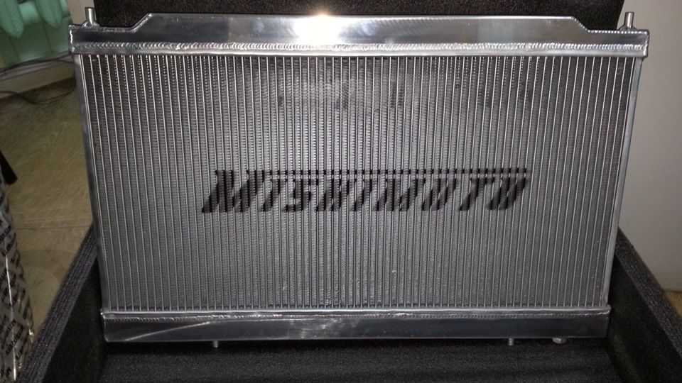

Aluminium performance radiator Mishimoto

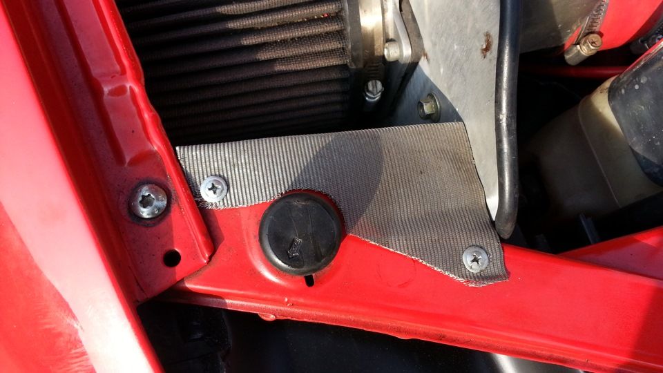

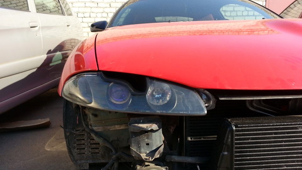

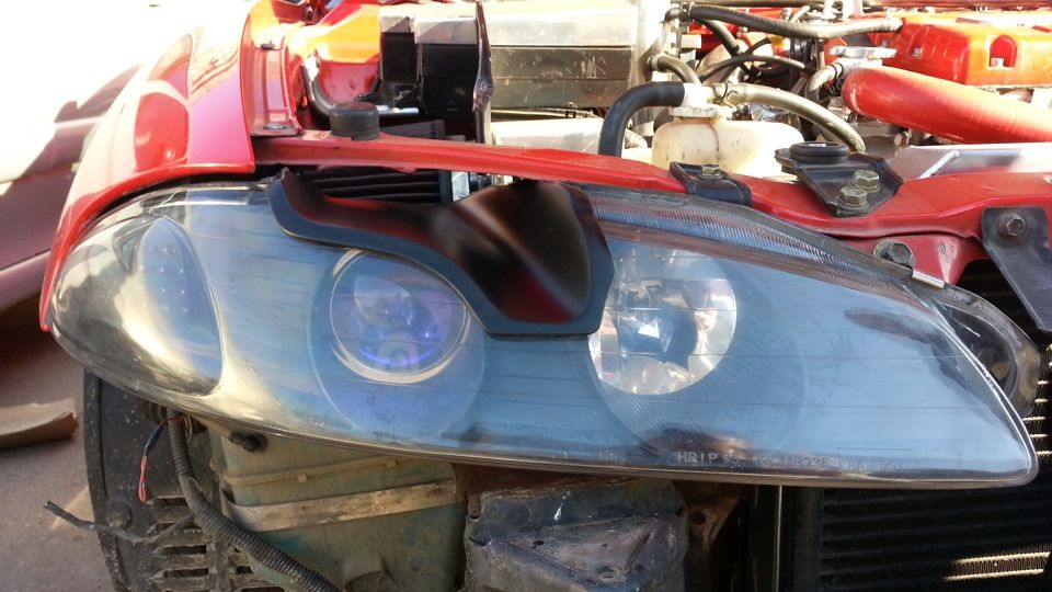

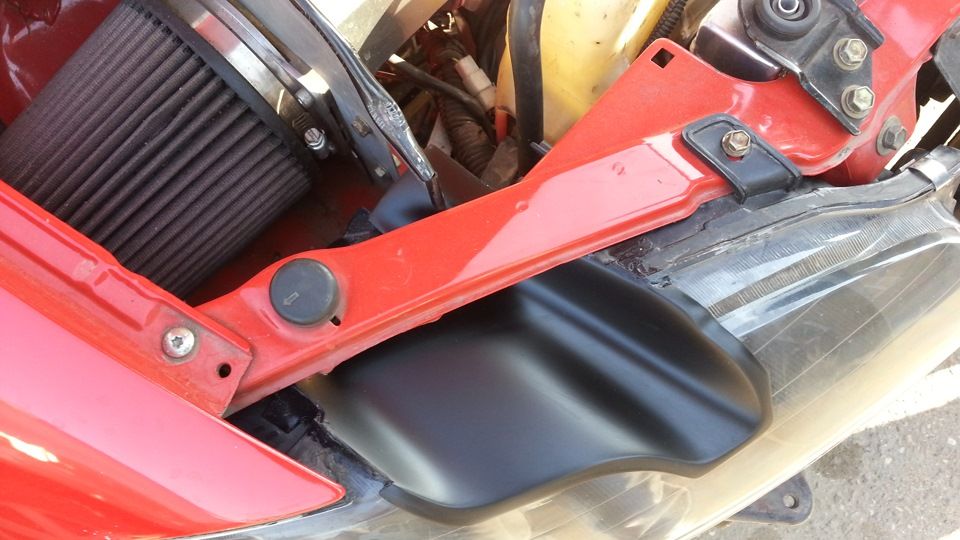

Remastering the front right's headlight for Cold Air Intake
