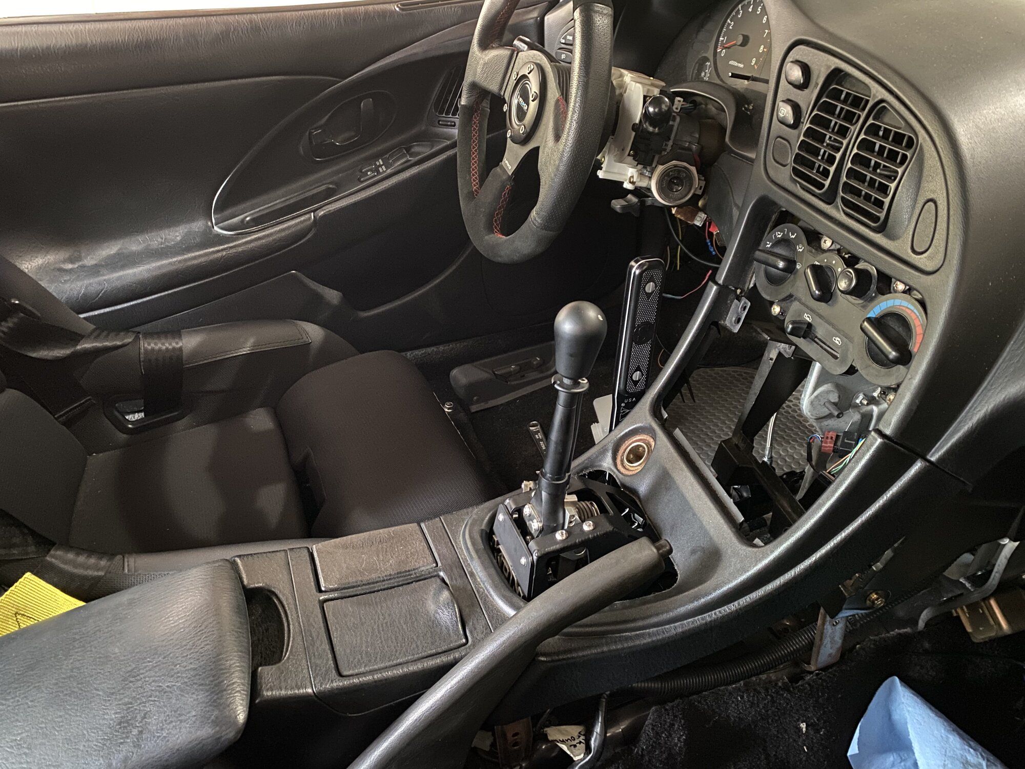

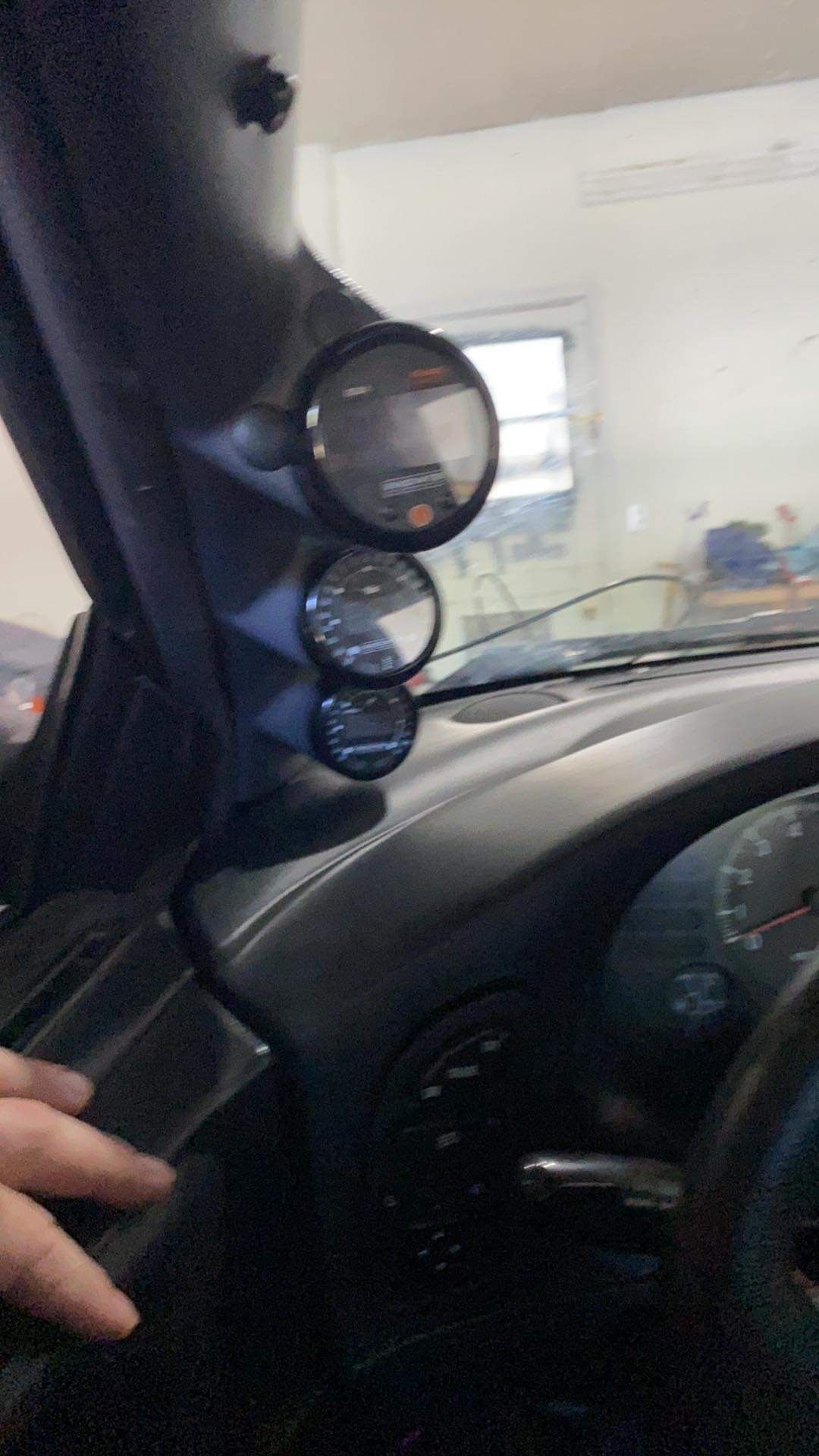

Will be installing these items when I receive them as I figure out the issue with the trans. Got the Innovate oil pressure gauge wired in and installed over the weekend. Fitting all the wires from that gauge and the ECB-1 behind the A-pillar pod wasn't an easy task, so many wires, HA.

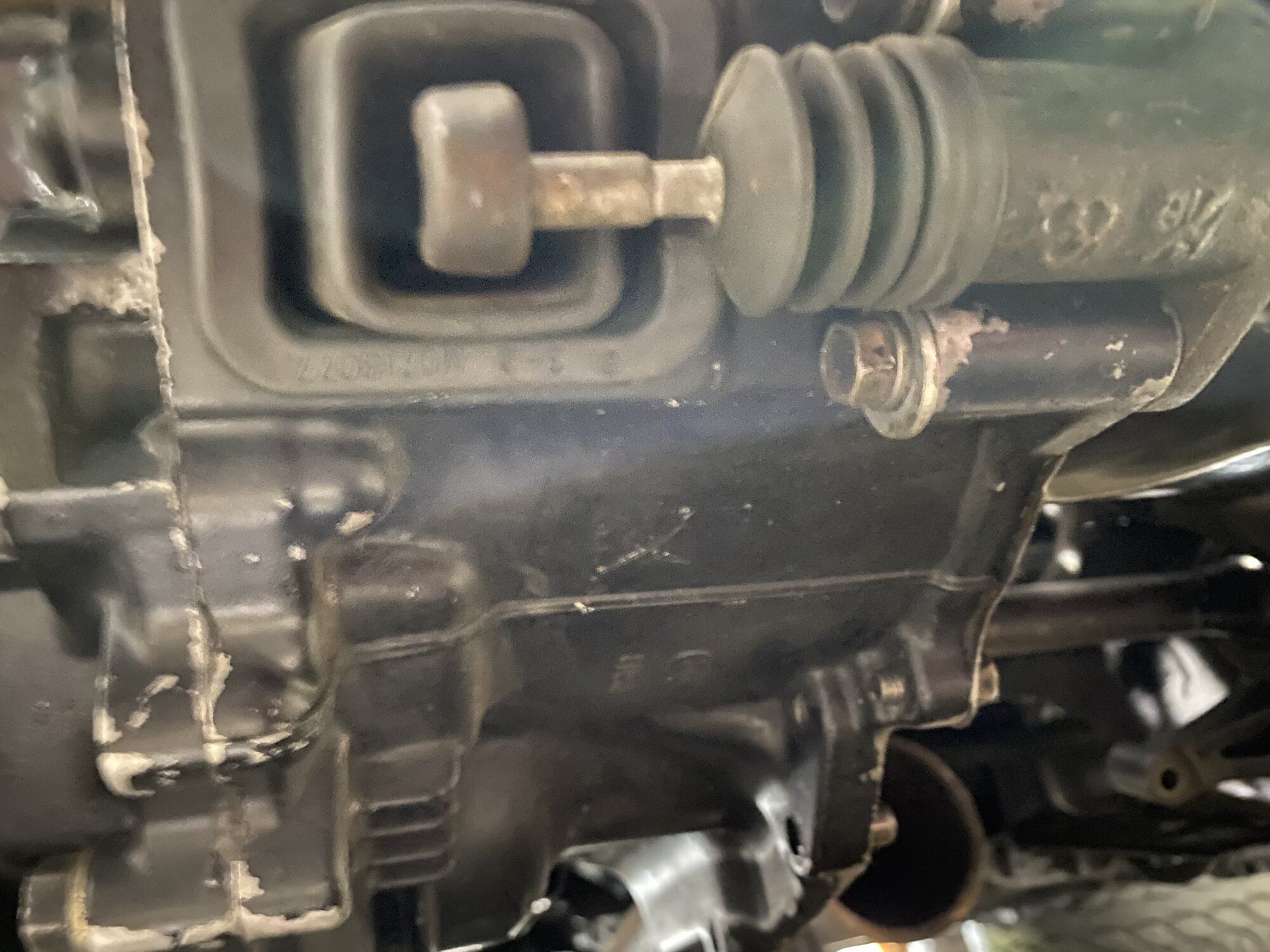

Based on the position of the clutch fork; something appears off, I was under the impression it should be pointed slightly towards the slave cylinder. Twin disc has 3k miles on it, ToB and pivot ball are new OEM, and previous owner said the clutch fork is the original one in the car.
I'm pretty sure Tim recommends using a Competition Throw out FORK when you are using a twin disk.
How do you like your clutch? I am wanting to put my QM 7.25 in my Red 90 when it goes back together.
I'm not the best source for giving my opinion on clutches and how I like this one versus that one. I picked up the Galant in October of last year, and before that it had been like 13 years since I had driven a stick. Since then I've only driven cars with twin disc's - Comp twin disc + jacks trans in the Galant and Southbend twin + dog box in the Talon.
Oddly enough I just ordered that fork and a new OEM TOB from him this morning. Will also be ordering a new OEM slave and master cylinder to have on hand.
I also feel like the dog box I have, and the first few times I drove it, it was "louder" than I thought. I'm leaning towards clutch engagement issues + dogbox but we will find out once I get the trans pulled and it all back together. It would "clunk" like I expected based on reading, but then it also felt like it would grind a little as well. Hoping it's just a bent clutch fork.

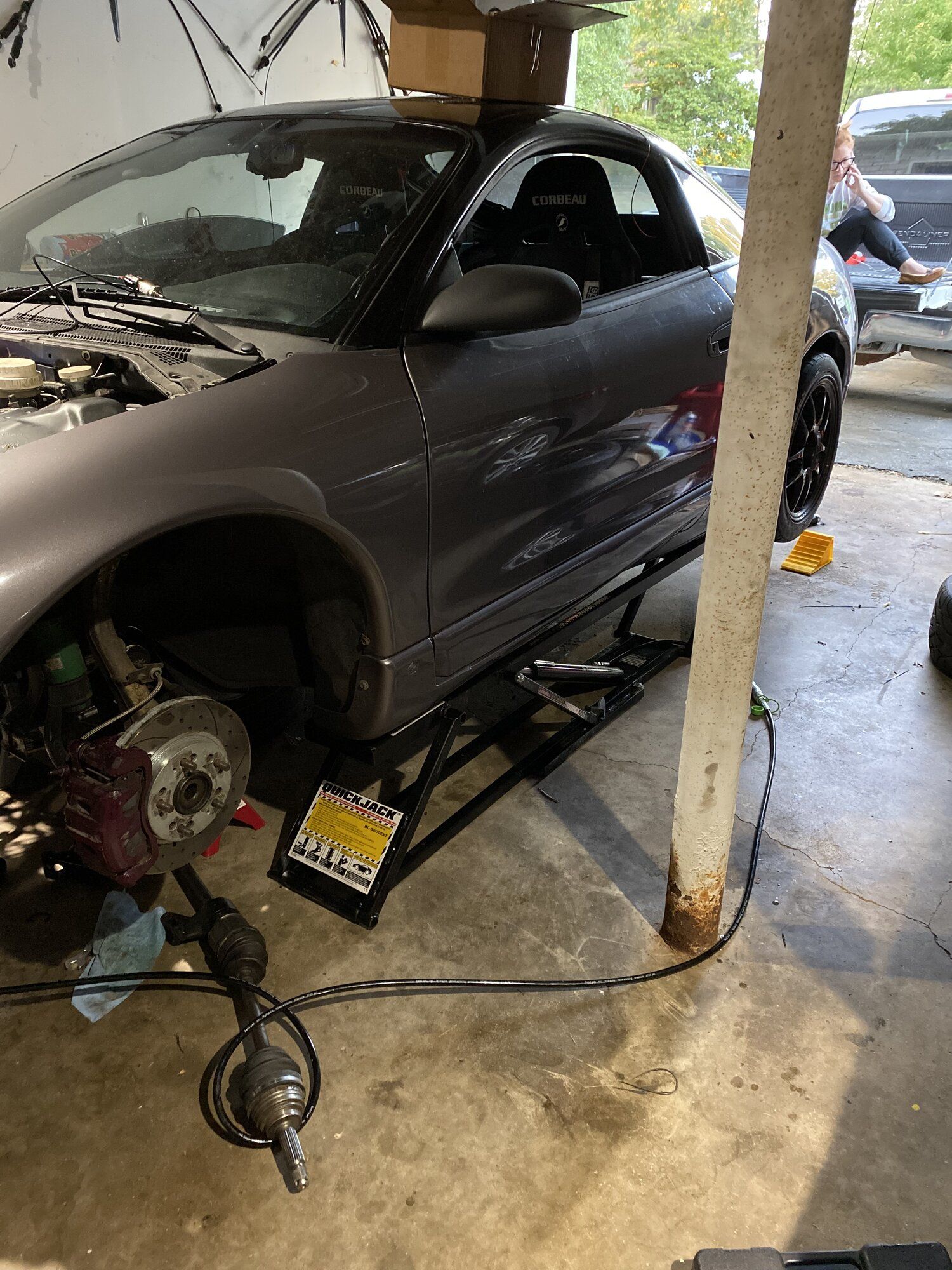

- borrowed some quick jacks from a buddy… and I’ll be buying my own pair ASAP. This is so, so, so much better than traditional jacks and stands. But, price tag is 1200-1700+ Depending on model and shipping.

installed all new gauges on the A-pillar. Innovate Ecb-1. Oil pressure. Fuel pressure. Waiting on a fitting for the fpr so I can screw in the npt fitting for the gauge

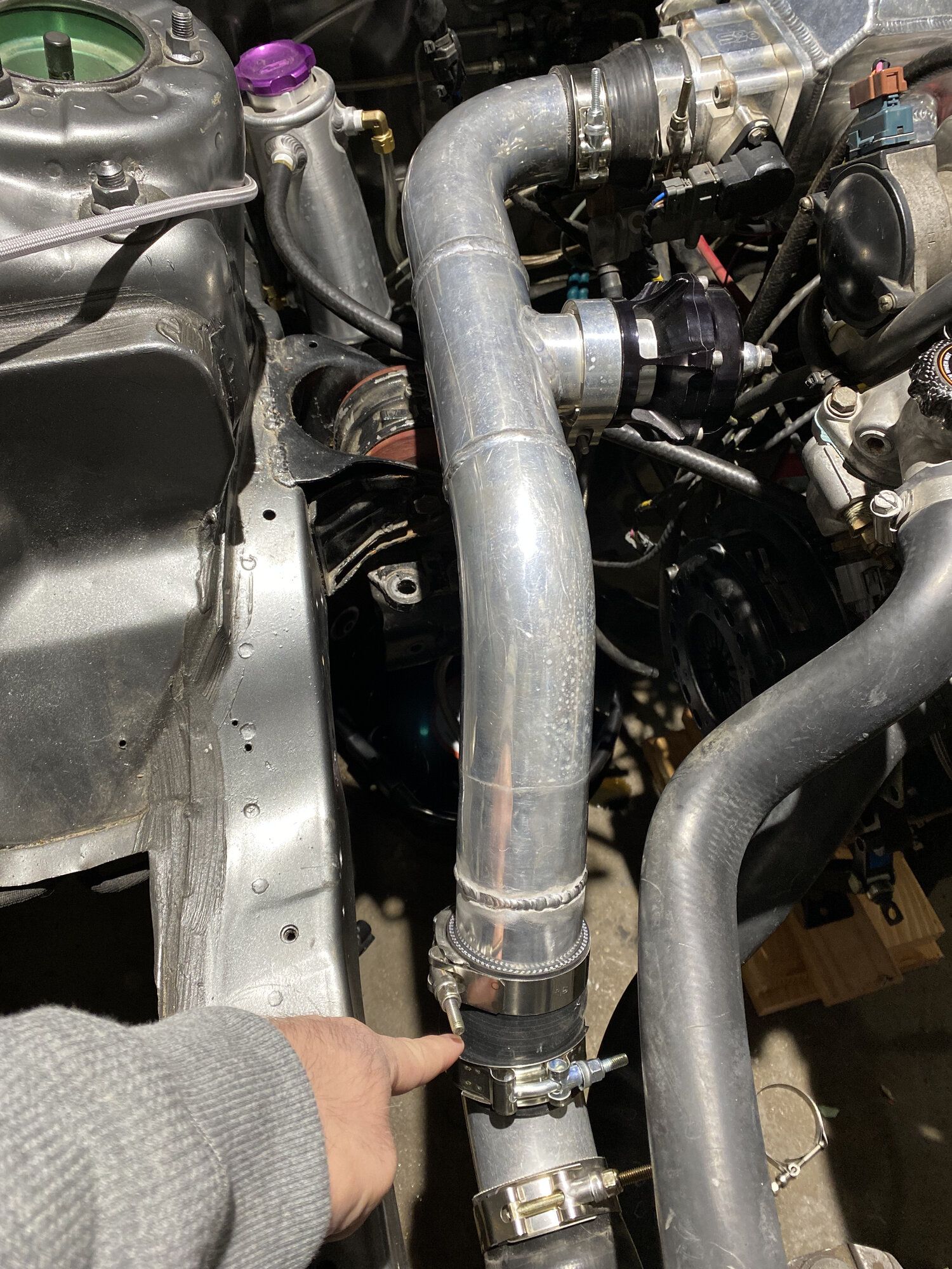

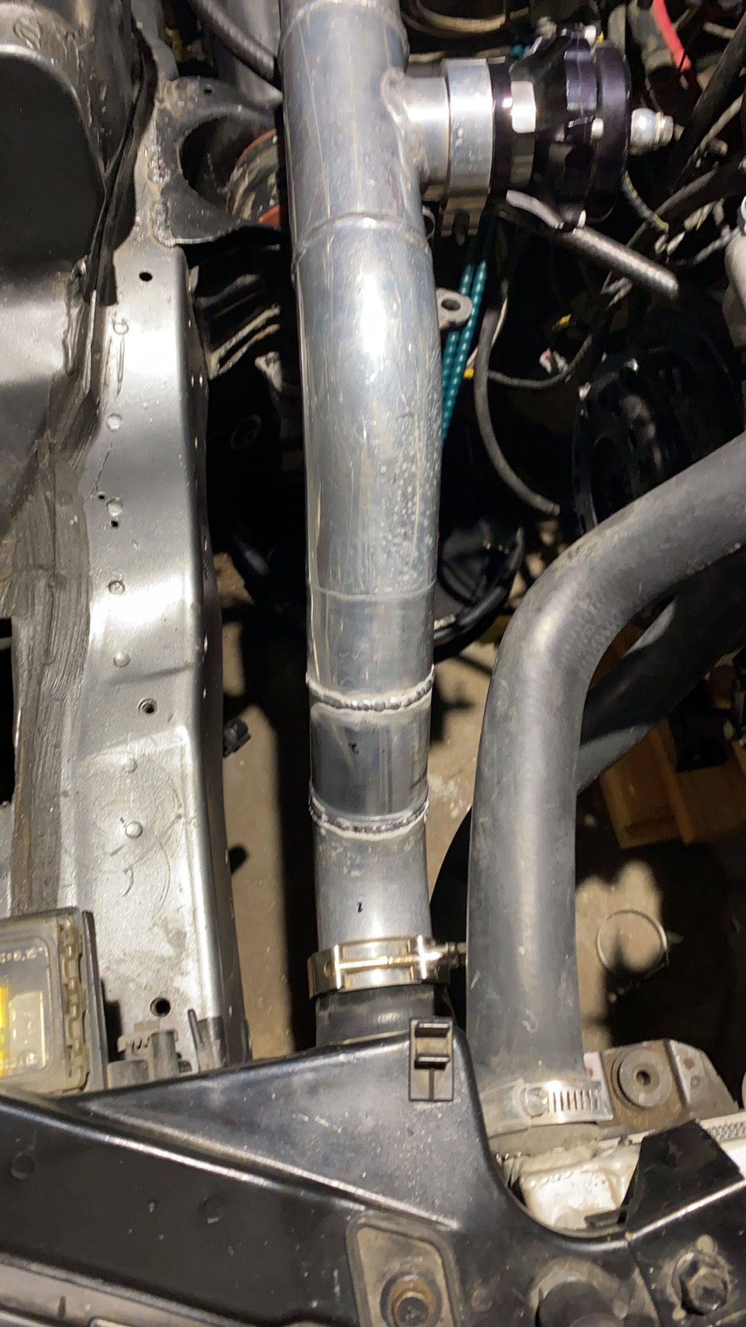

got rid of a coupler on the cold side of the IC piping, less chances/risks of boost leaks.

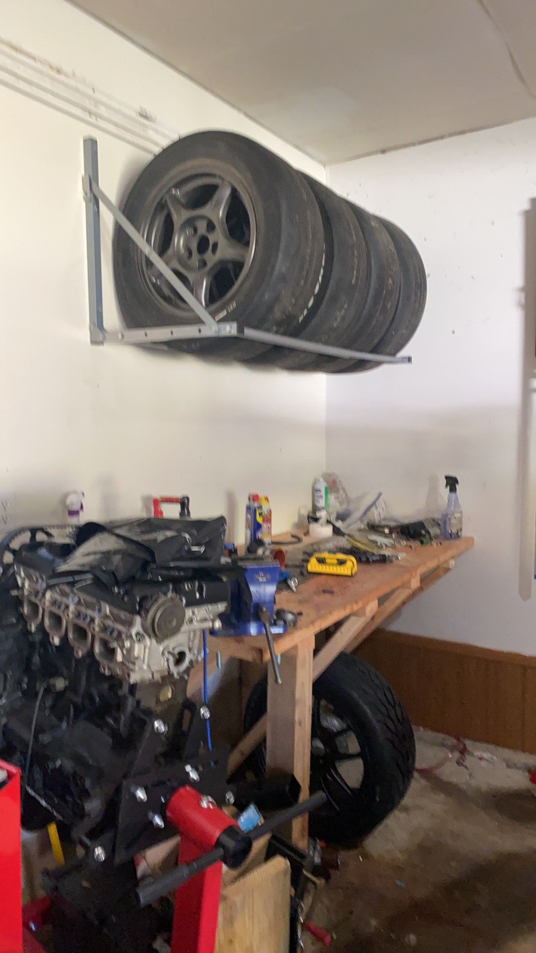

Also got a little tire rack that seems to work well, but I will be moving this.

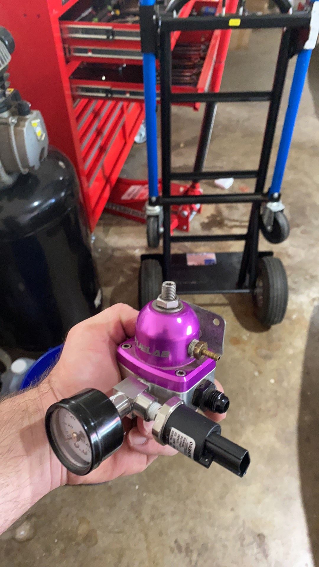

Moved the tired rack and got around to finishing the install on the Innovate fuel pressure gauge, was waiting on the fitting to attach the sensor and gauge.
Now thats an FPR! Im also very envious of that rotating engine stand too. I can't imagine around 700 whp in these cars. Mine is floating just under 400 and it makes me very nervous LOL, sounds like an excellent game plan though. When the time comes be sure to post some drag videos.
That stand has the motor out of the Galant, it's drop in ready for when this one blows up. It made 552 with the previous owner of the Galant. I like to keep moving forward so I'd like this car to take a step up above the 552. It's without a doubt lighter, so should feel damn good.

You know pretty much all engine stands do this.
