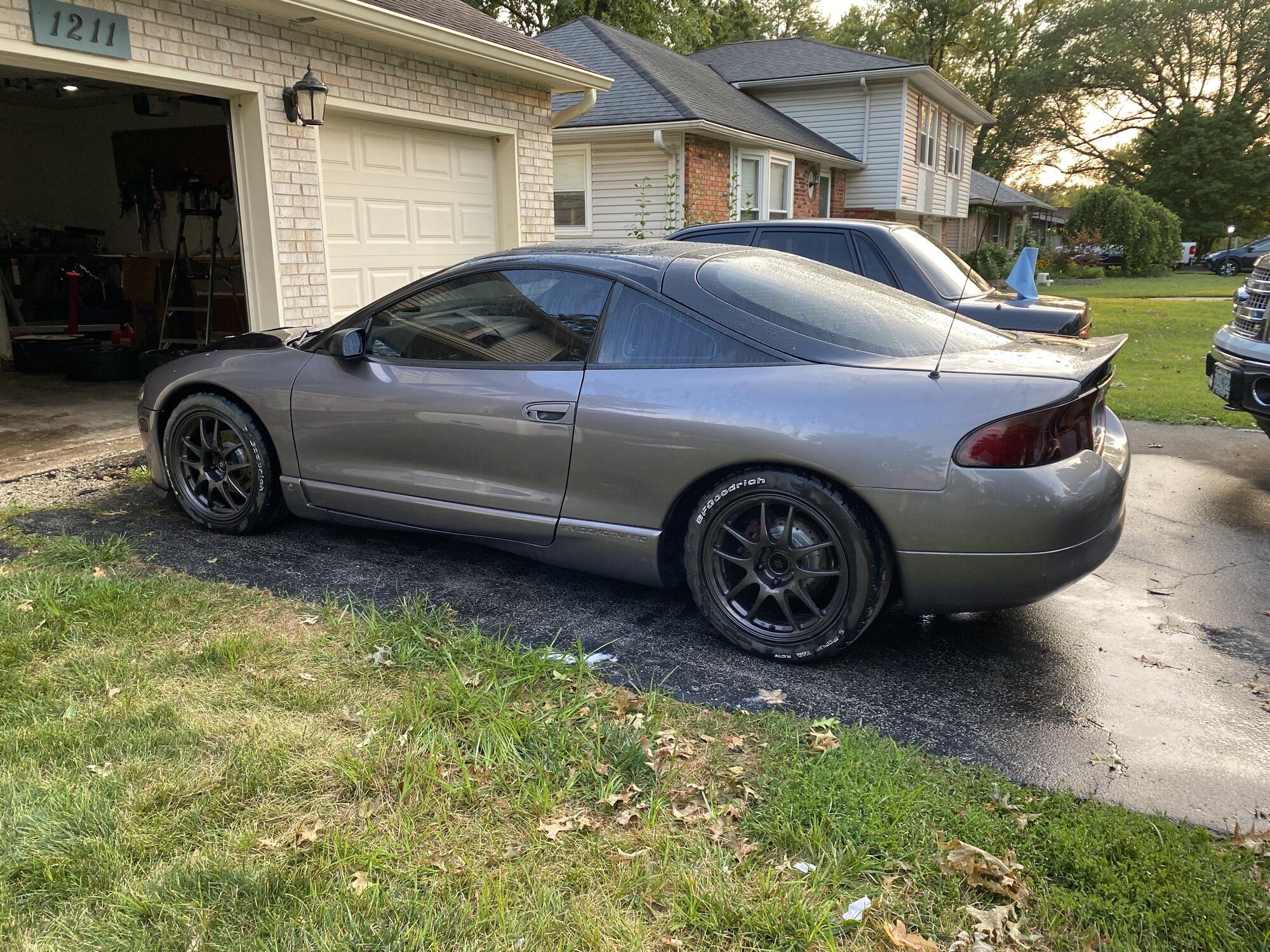

Just paid for the car a few mins ago, waiting on wire transfer to go through. I'll take ownership of the car August 12 or so (waiting on a shipper). A guy I've known for 15+ years is selling this car, andddddd had to have it.
Car is fully built - SBR stage 3 motor, dogbox trans, tubular rear, e85 car.
Issues -
Trans has a small leak from the case - they had to investigate why 5th wasn't engaging and it didn't seal 100% when they put it back on
Car has a completely new/custom wiring harness - only wiring issue is the car doesn't shut off when you take key out (hoping for a faulty ignition switch here)
Fingernail sized hole in the strut tower - but that will be repaired
Two owners ago... that person cut the e-brake lines - I've already ordered new ones and will be fixing that first.

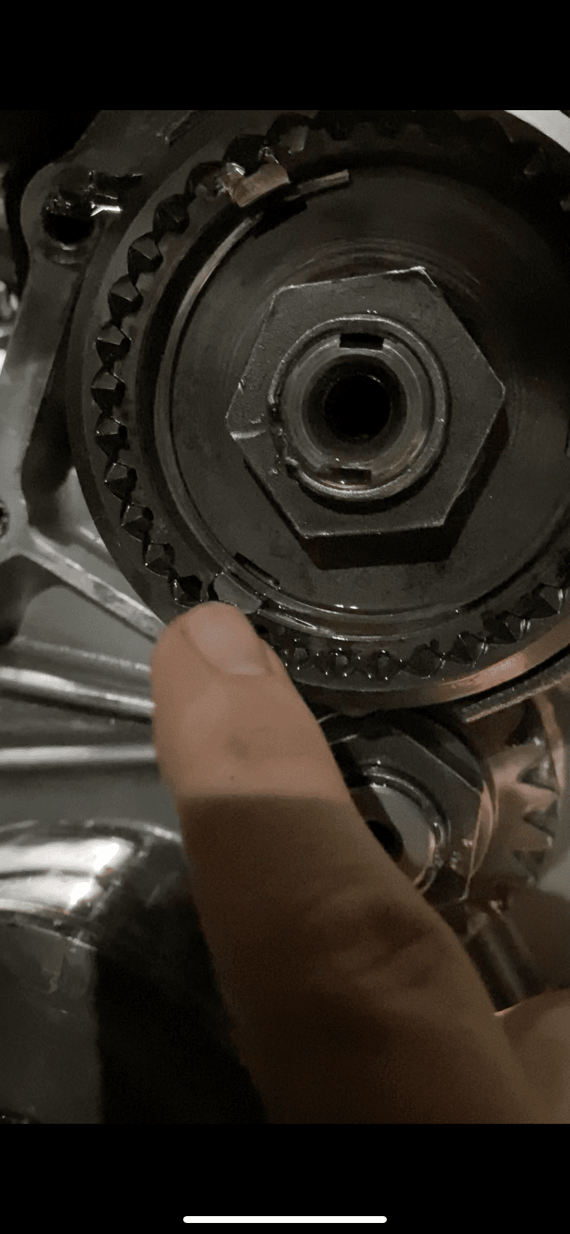

I took off the end case to fix the RTV and reseal it, it was leaking.

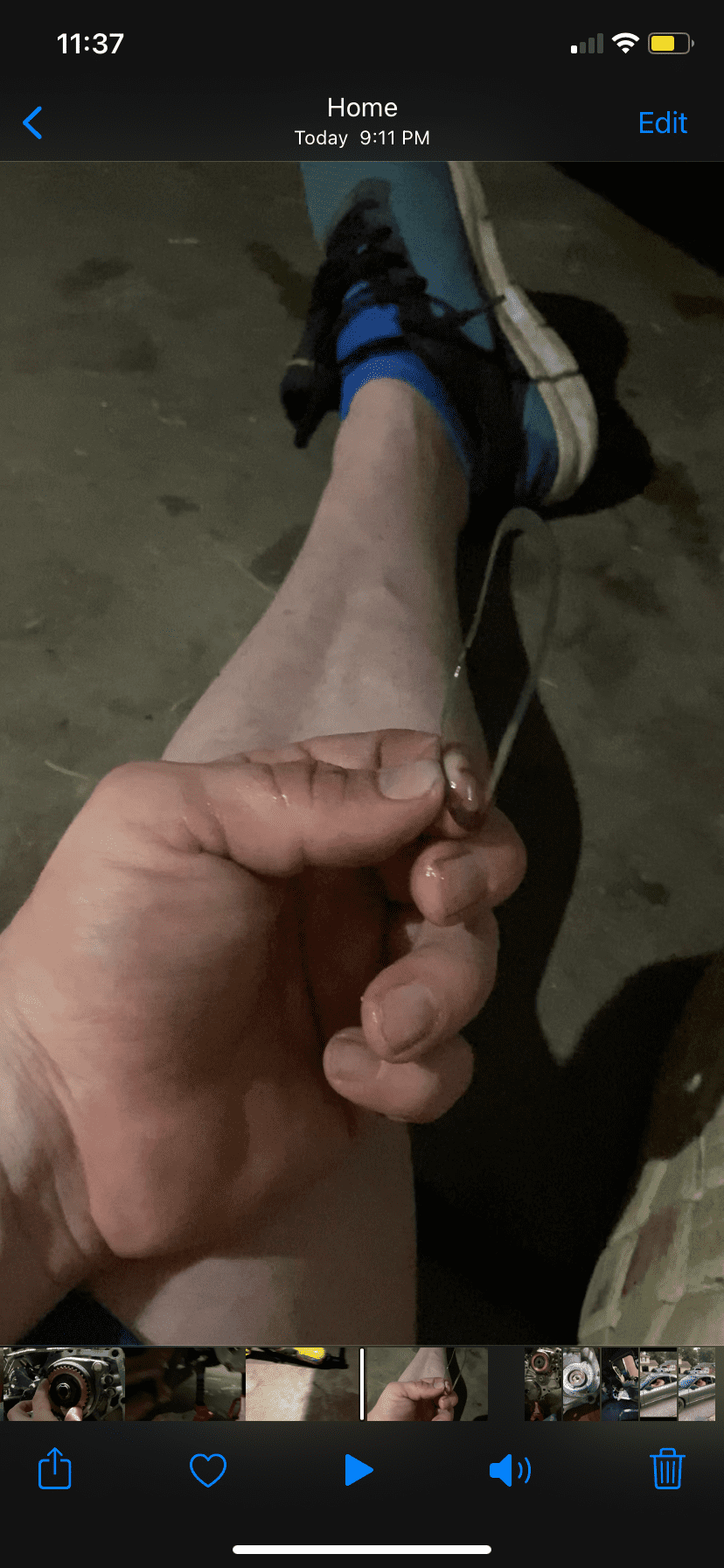

when I did so, a synchro and another little metal ring fell out. The synchro appears to have its place and pops back in, and lines up with these 3 tabs, the first and second pics.

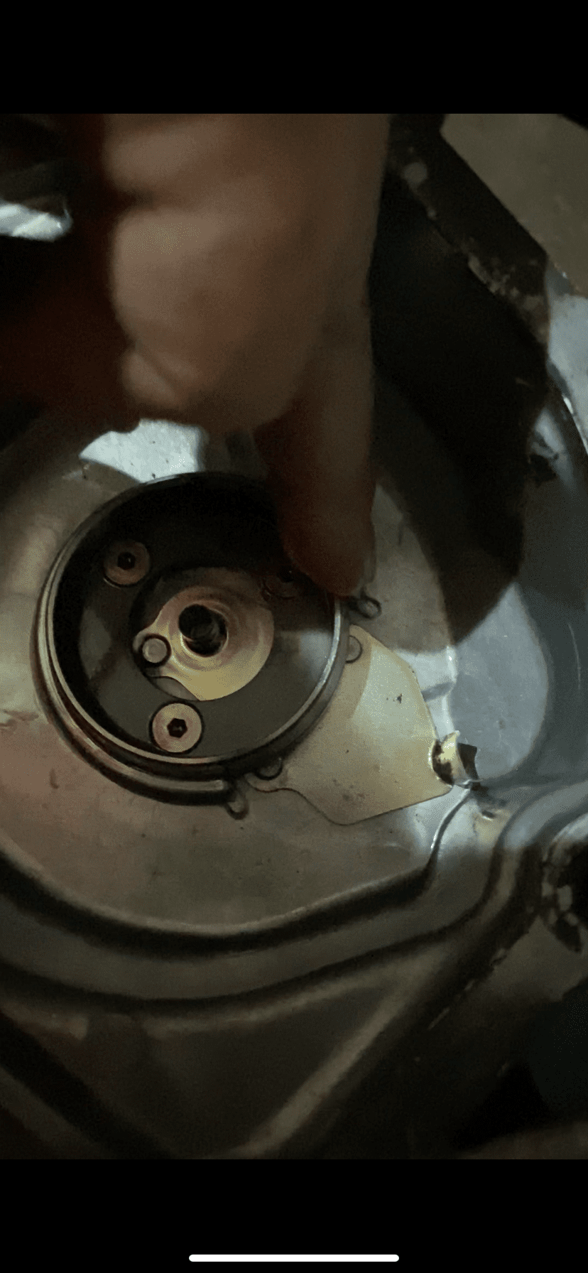

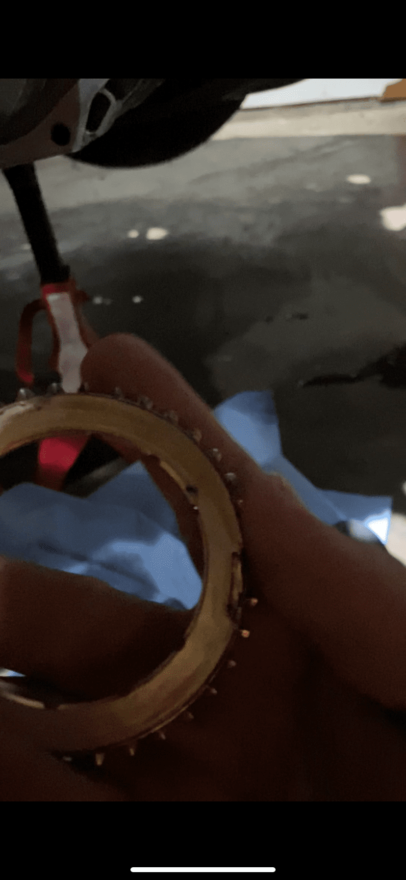

my question is on the third pic, is this ring supposed to be wavy? I’m also trying to line these up with picture 4, looks like it should be placed and aligned with the housing side of the end case.

Well I hear a twin disk with new disks in it, and I hear a dog engagement first, and you are inside a garage with a loud exhaust. Push the clutch in, give it a second to slow down, click in to 1st gear. It will have a clunk, try letting the clutch be disengaged a bit longer, then do a gentle quick shift into gear. It just takes some time to get used to driving with a dogbox.
As for that reverse wave spring you showed in the picture before, it should have two retainer tabs on it that face down towards the reverse cone, and are oriented to the gap in the casting for it to "click" into place and retain itself on the reverse cone on the 5th gear cover. If the tabs are missing it will not lock itself into place and can cause some reverse synchro rattling. I couldn't see clearly the picture of the keyways on the reverse synchro but they do look beat up, which WILL happen with a twin disk clutch assembly. Typically expect it as a regular replacement part, along with 5th synchro. Ways to make it last longer are smoother clutching and shifts into gear.

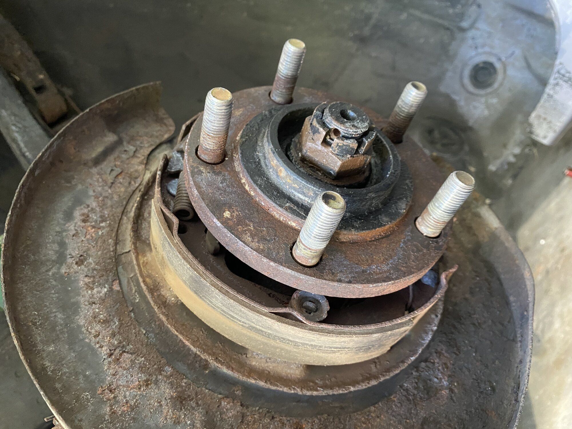

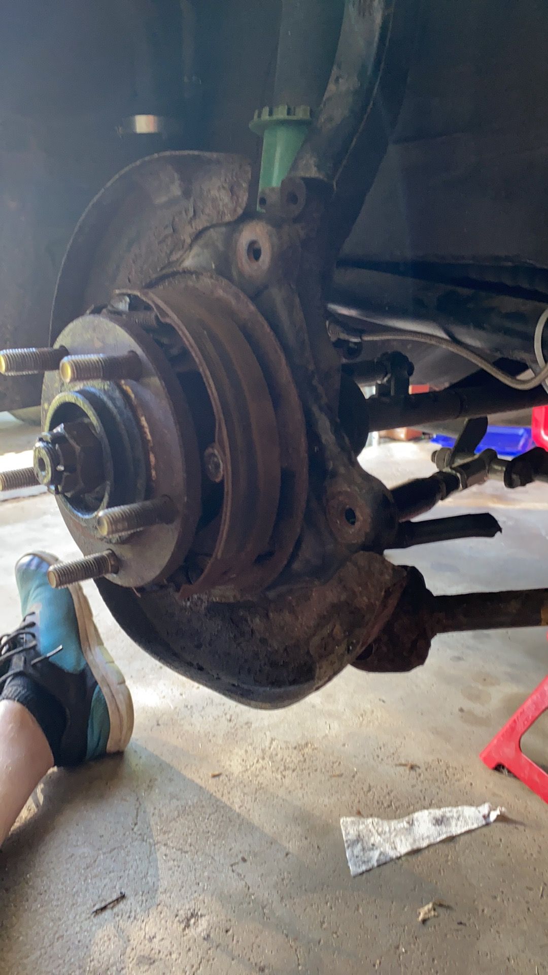

How does one replace the e brake cables from this point. The only guide I’ve found, pics no longer work, and not sure how I can get inside to detach the cable from this point.
the hub/32mm but will not come off, entire can of pb blaster, 1/2 inch impact wrenches, nothing.

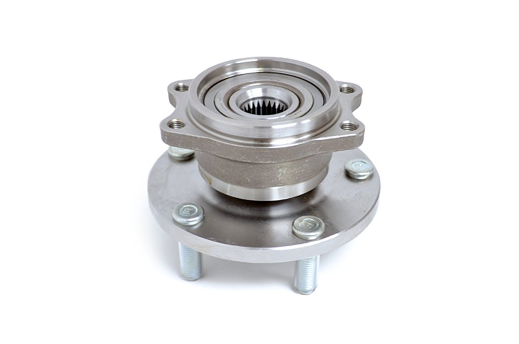

One end of the e-brake cable attaches to the caliper mounting plate. The other end attaches under the center console, inside the car. They are mounted to the underside of the car with some clamps similar to p clamps.
That nut is only for the axle. The hub assembly is bolted to the knuckle from the backside of the knuckle (4 bolts). You will still have to remove the axle nut in order to get the wheel hub off.
Also the caliper mounting plate is sandwiched between the knuckle and wheel hub.
You can see in the image the 4 locations where the bolts go.
Yea, may have to turn this into a winter project (the e-brake part), since I'm going to have to remove the whole suspension and take it a machine shop and hope they can remove the nut/press the hub out; appears seized but I'll try a couple more things.
Thus far I've tried whole cans of pb blaster, rubber mallet wacks, heat, impact wrench, cheater bar, etc.
