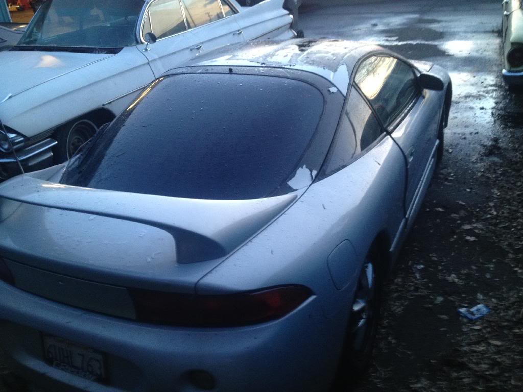

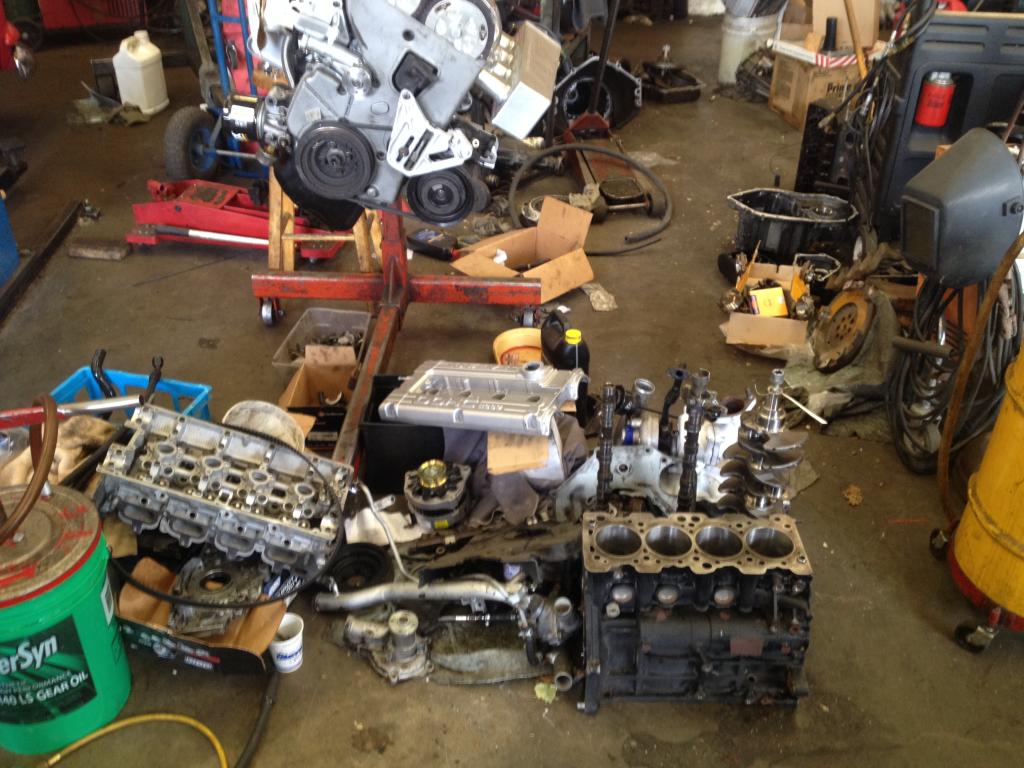

So Ive owned 3 1Gs, which my GSX is getting tough to drive everyday with its mods, been needing a nice clean daily to leave relatively stock, with more room, but still show my DSM pride. Of course I needed my first 2G. I got it thinking it was a shell with a trans, then he threw in rebuilt head for a little more, then when I got there I was greeted with a complete longblock in the car, rebuilt head already on! Ok. Mods I saw were a catback, it obviously had a FMIC in its past, was lowered on GSX rims. I drove on a work night, there and back, left at noon, was back at 7am, and went straight to work! Was totally worth it! Im going to do a running total on everything to keep track, I personally think Ill come well ahead getting an incomplete project car rather than a running car that may have god only knows how many issues, at least this way I know many things will be new and done right :)

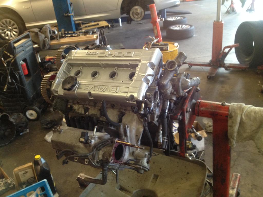

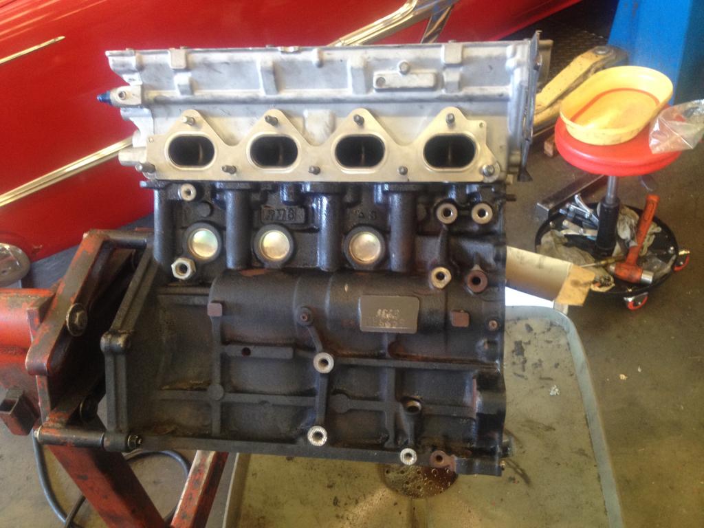

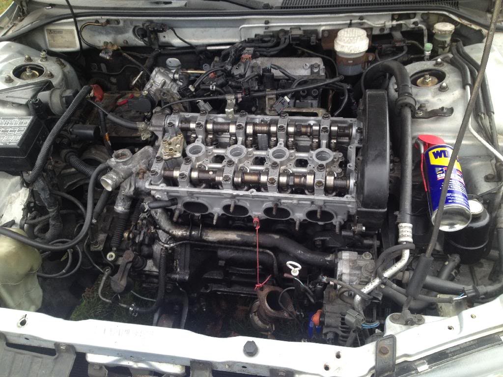

As you can see the engine was stripped of a bit of its bits, but I was more than happy with what I got. First step was try and figure out if the head was put on and rebuilt correctly. Leakdown test showed 10-18% cold, which showed head sealing and fresh rings! Awesome!! I got an array of parts and started getting things together.

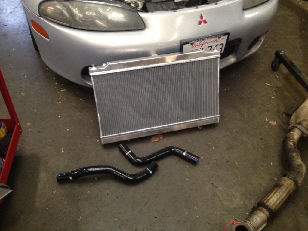

alum radiator/fans/silicone hoses- $163

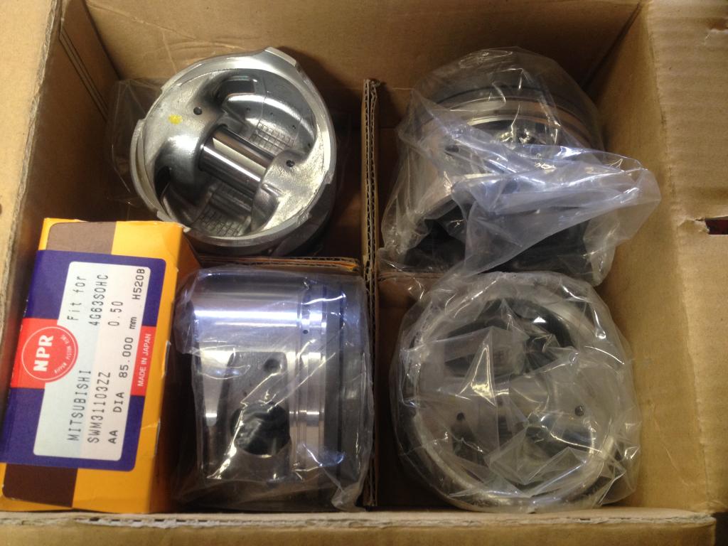

NPR pistons/rings- $190
Machine shop- Bore +.020, hone, resurface, polish crank, resize rods, resurface FW- $280

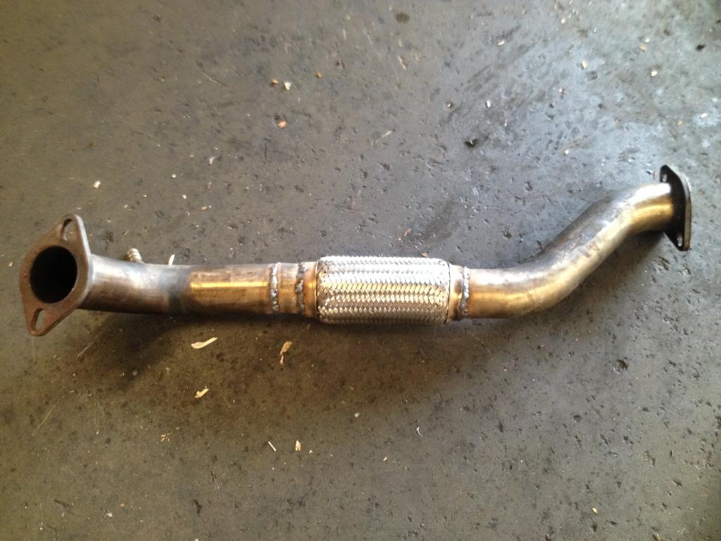

2.5" flex section to fix downpipe- $17

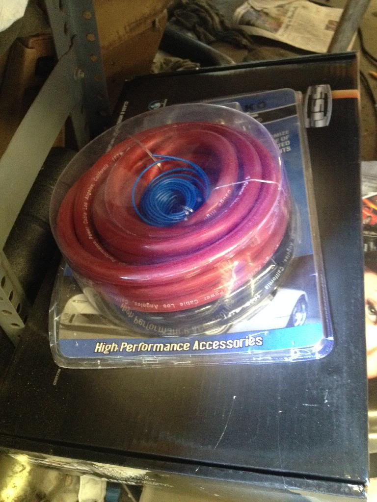

0 ga amp wiring kit- $35

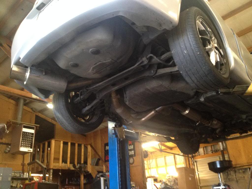

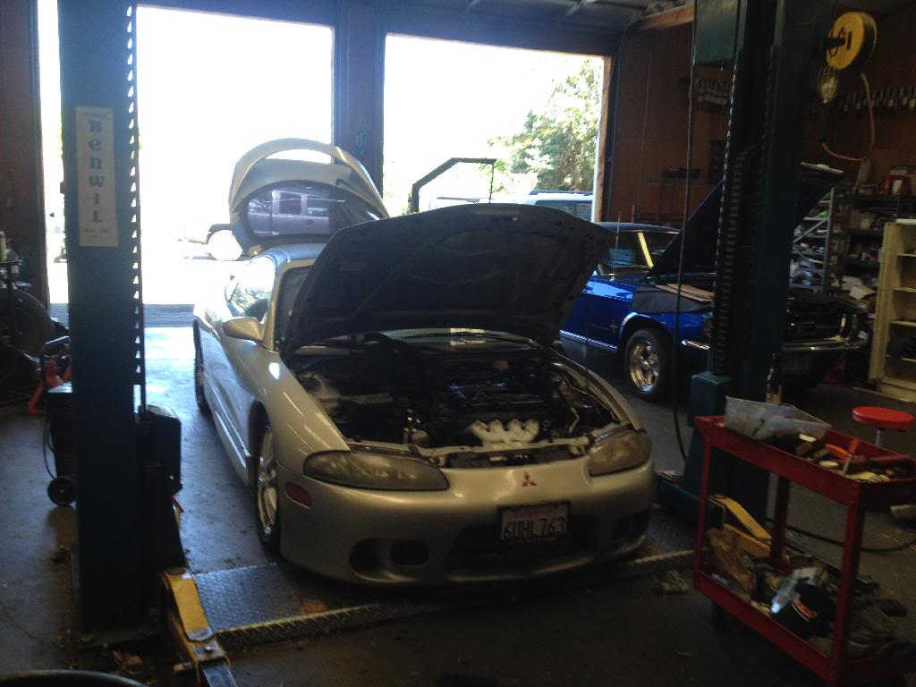

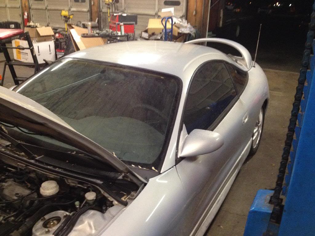

Had the car up on the lift for the first time
No idea what catback this is, but itll work if it doesnt sound too ricey

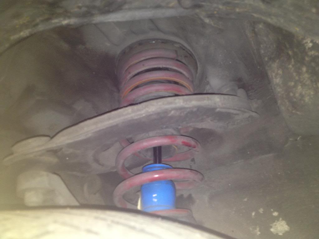

It has tokiko blues and ST springs, but with how low the thing sits, Im suspecting they its seen the torch, I had to sneak a floor jack under both ends just to get the legs of the hoist under it

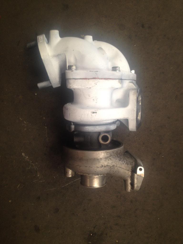

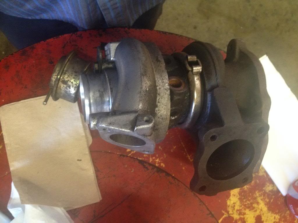

Rebuilt the 14b turbo for it

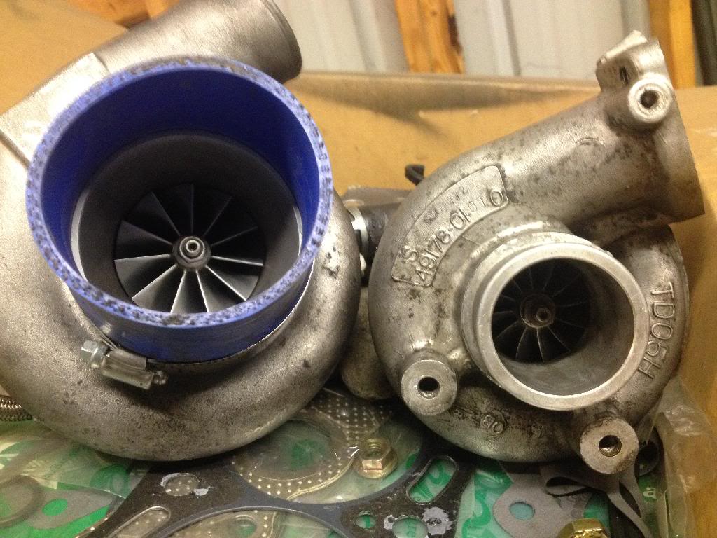

Here are the two dsm turbos Ill be running this summer :)

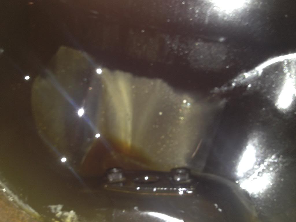

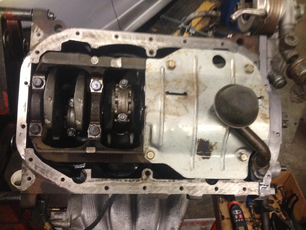

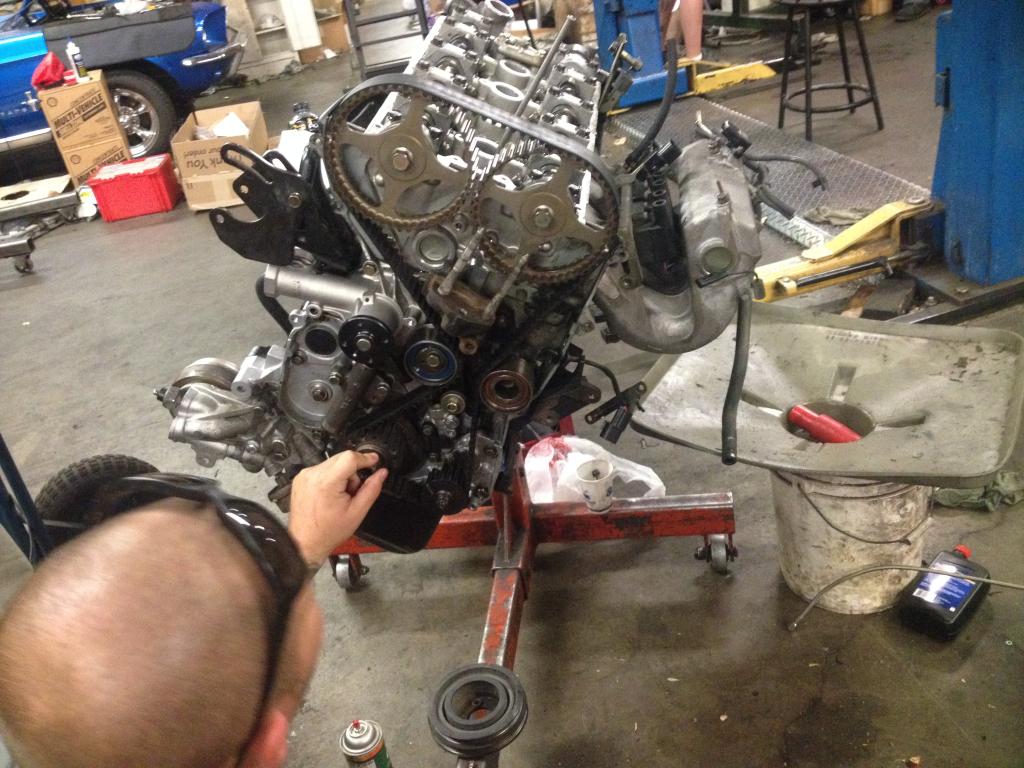

I dropped the pan to check out the bottom end. Near as I can tell it had a turbo or a bearing go out in its past, to put a lot of debris in it. The bearings looked okay, journals looked pretty good, it just had a lot of chunks from a past failure in it
No idea why somebody would put a new rebuilt head, on a damaged bottom with all this shit in it, but oh well whatever.

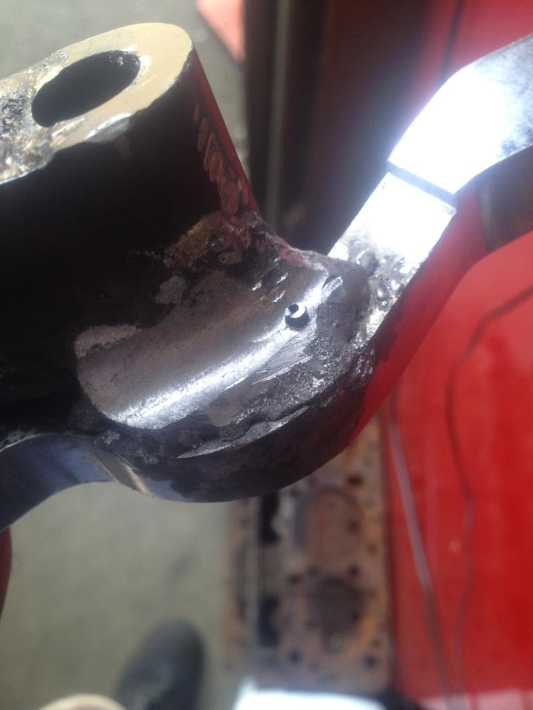

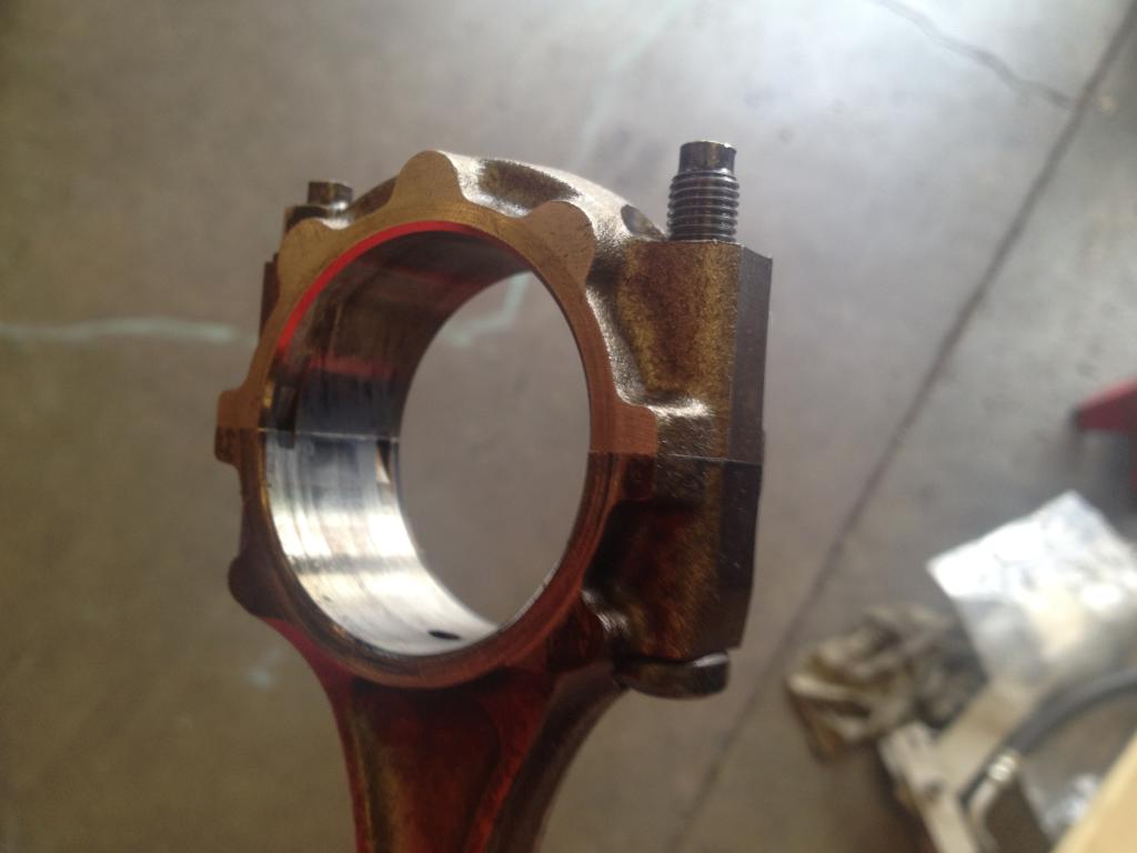

This is rod #4, the worst of them all, still totally runable

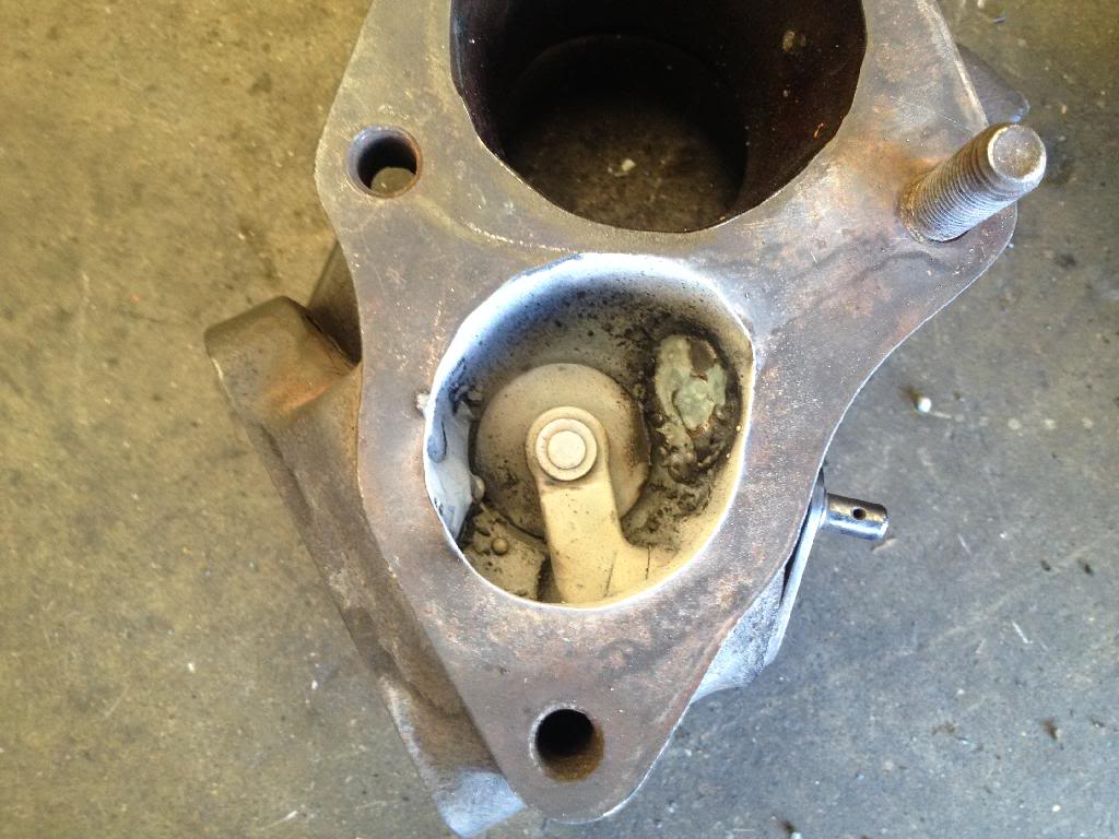

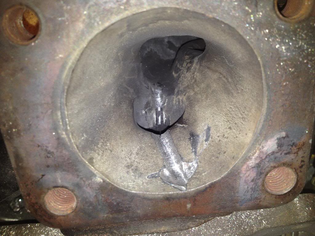

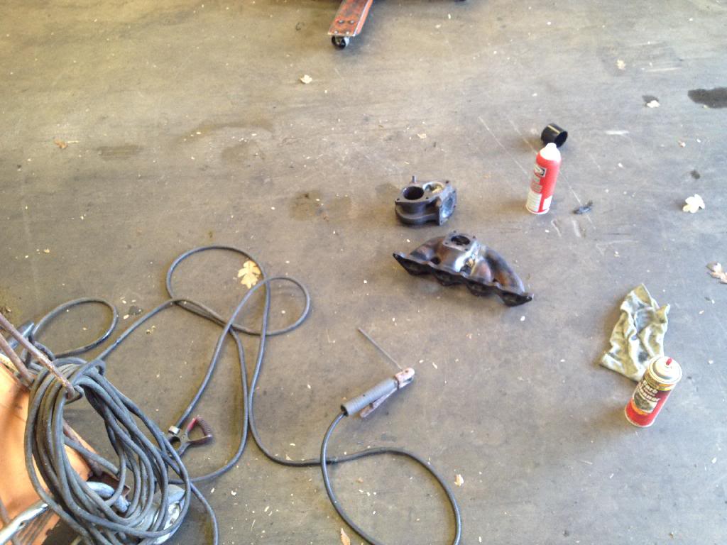

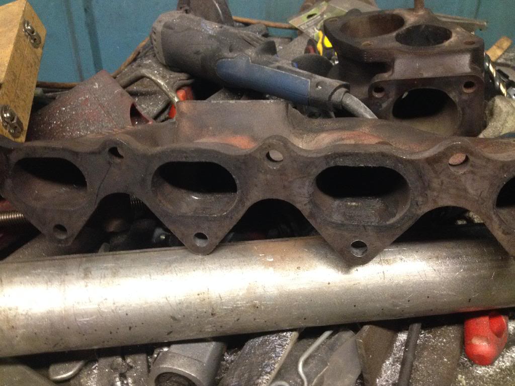

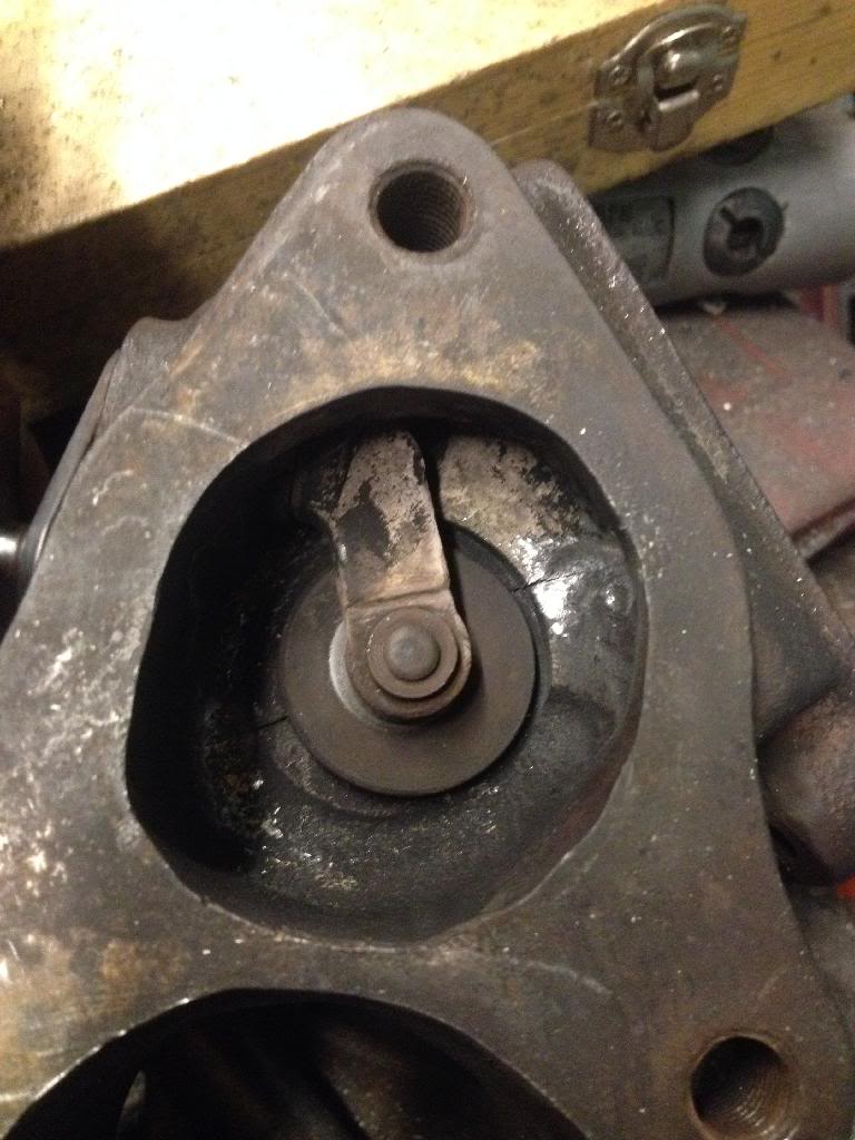

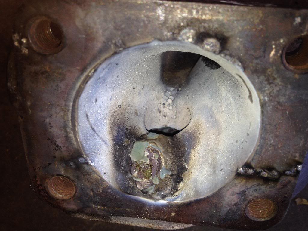

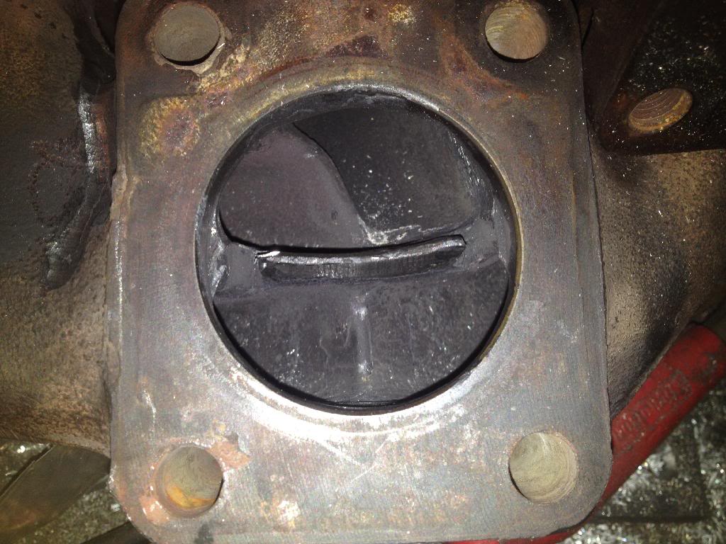

Got a lot done tonight. Fixed all the cracks on the hot parts

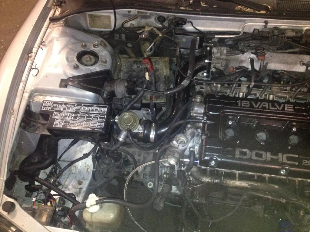

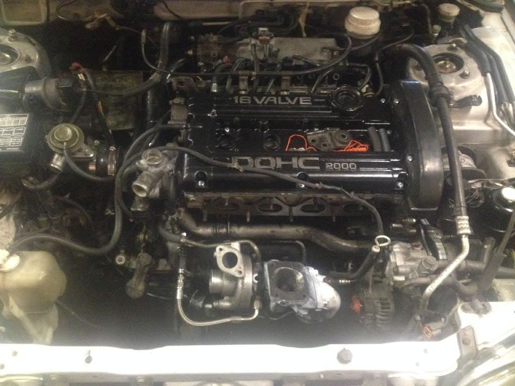

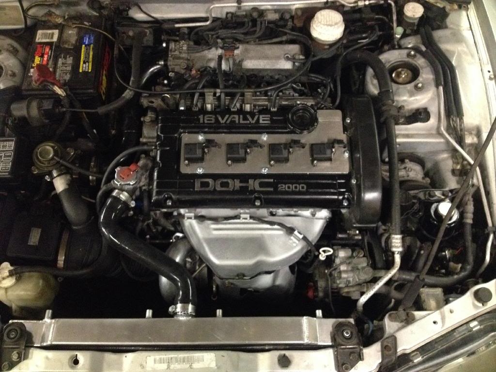

Got the turbo on and mostly plumbed, replaced the coolant hoses, went softline on one, turbo drain, stock rear coolant line, getting more pieces for the feed line.

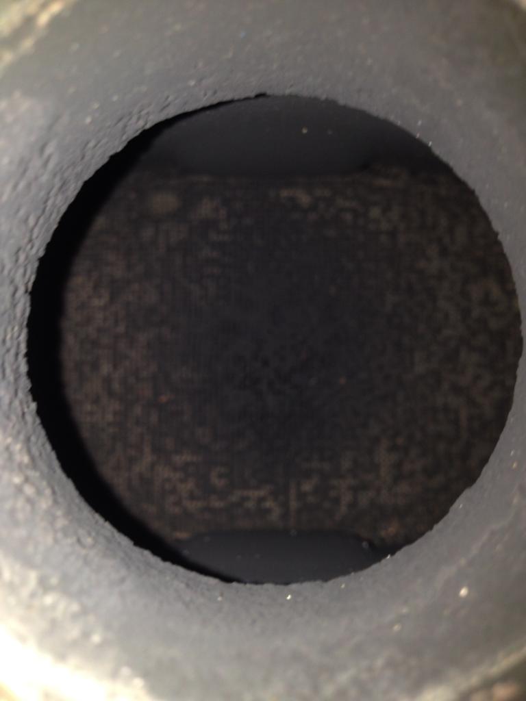

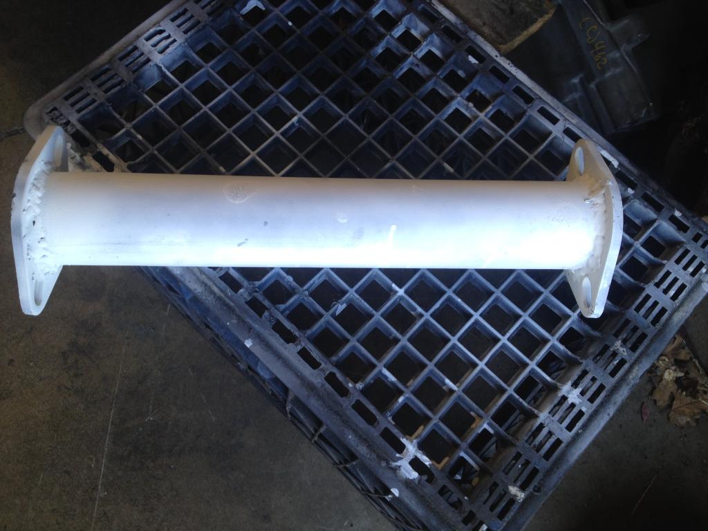

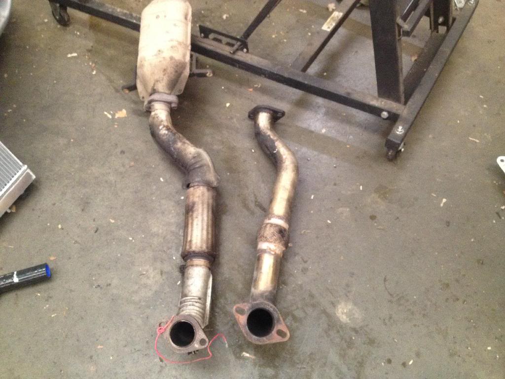

2.5 downpipe is on, mated to stock cat for now until it passes smog, then a test pipe will go on. Getting close now

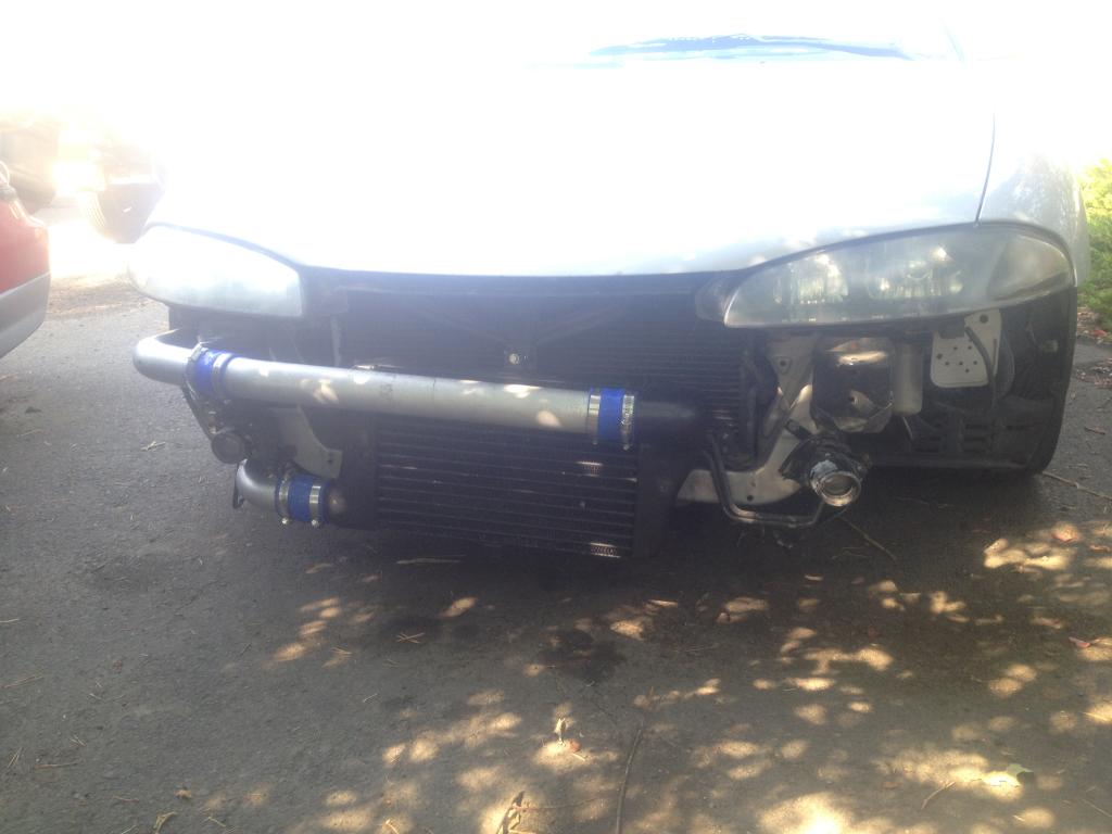

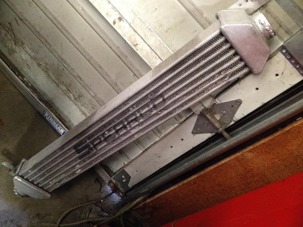

Got a FMIC from a buddy

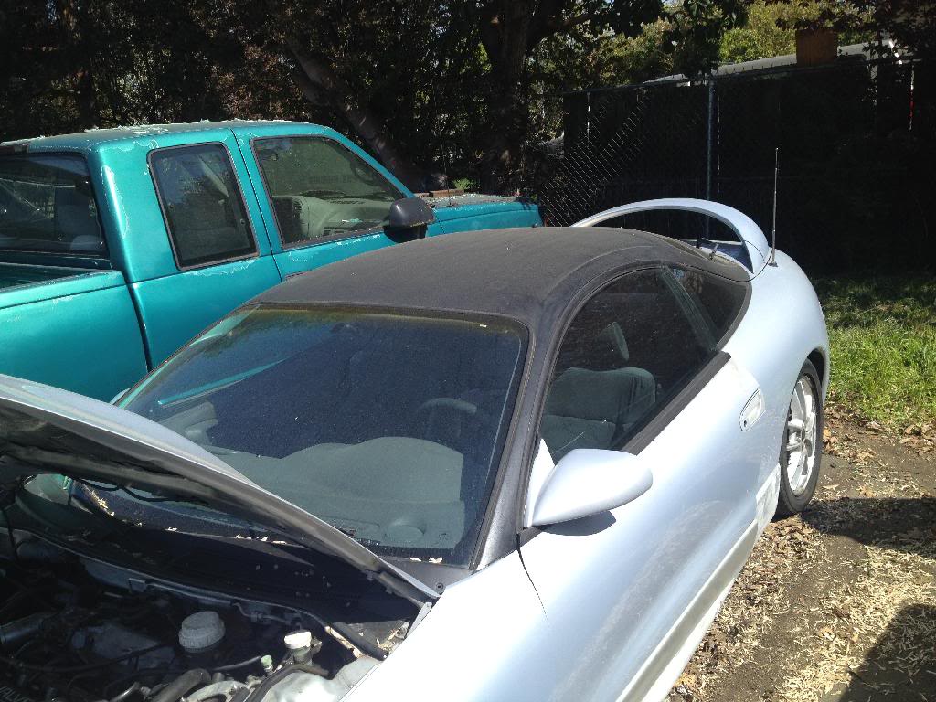

Spent OVER 3 HOURS with acetone getting the rest of the plastidip off. So far this was the best but it still totally sucked

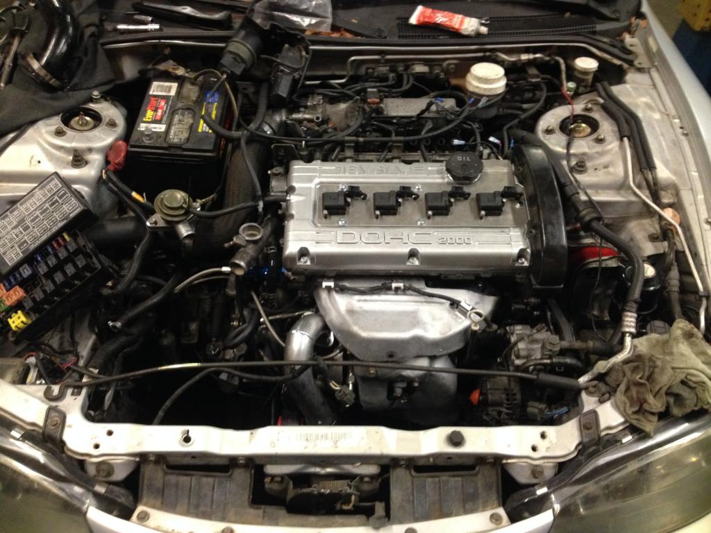

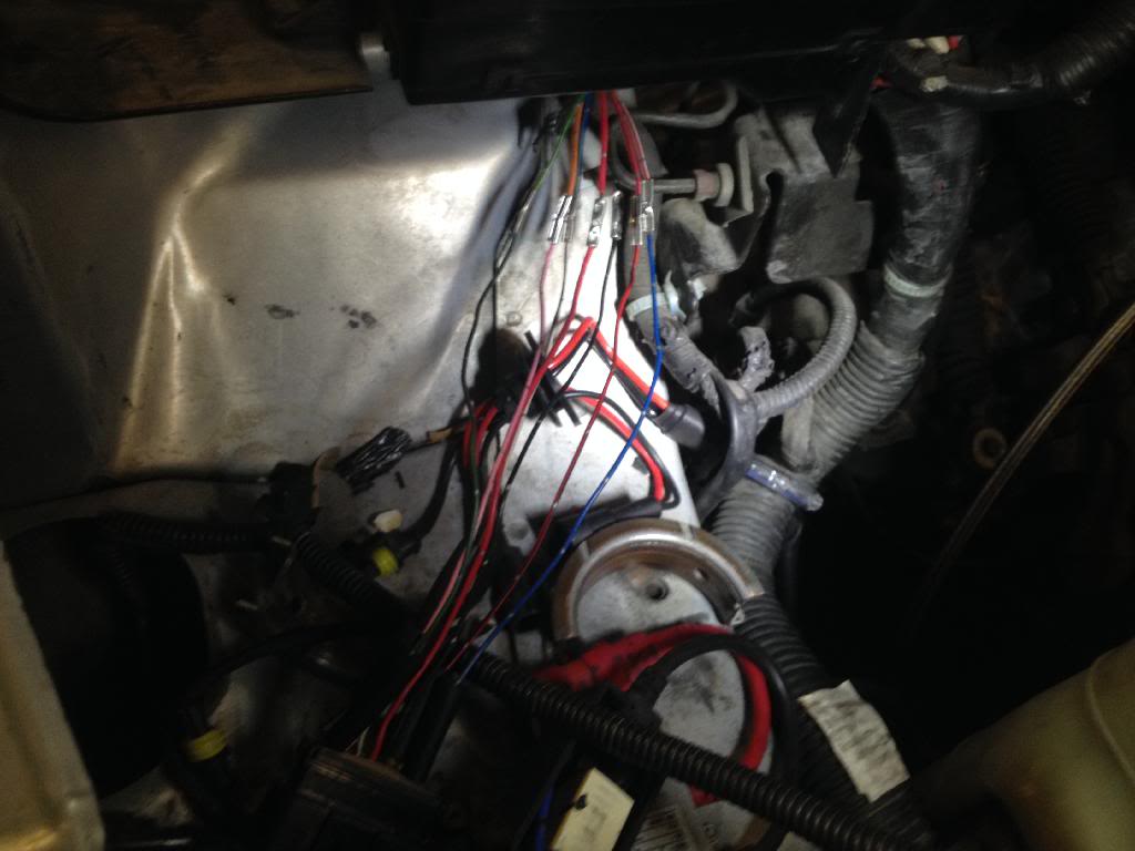

Got a COP setup
....and after a shitload of work...

Needed some random things, radiator cap, air filter, intrepid coil boots, oil filter. Ill update pricing on the first post but Im pretty freakin ecstatic, If I dont include the sound system then Im barely into this thing a grand, and I have a running dsm

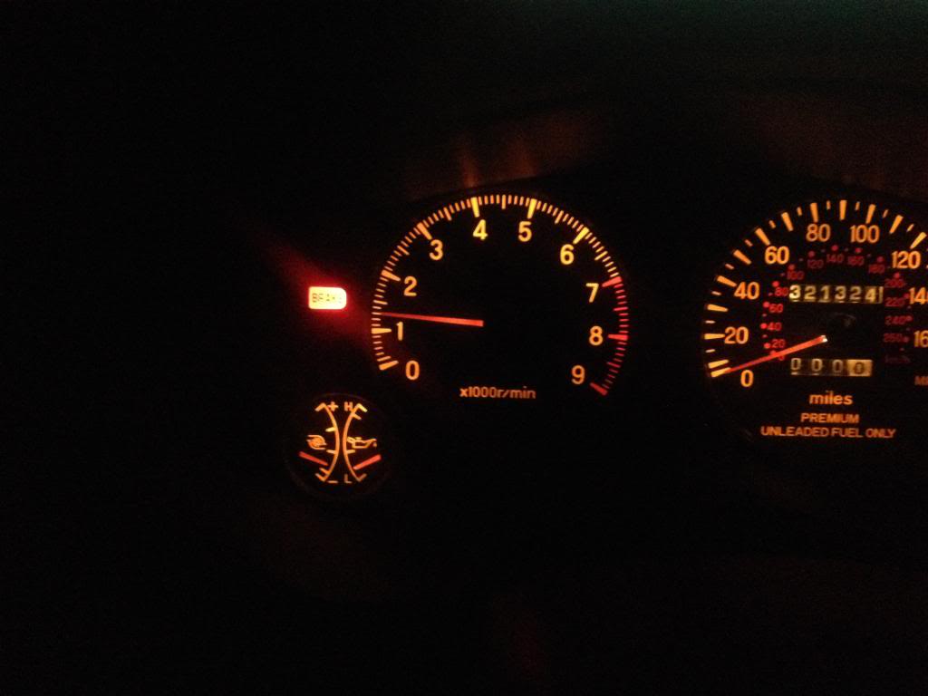

And the part of the DSM game we hate... shit didnt work out. I put insurance on it, took it for its first spin around the block, and noticed rod knock on decel. I tried the band aid fix of rolling in new bearings (rod/mains) motor honey, and an oversize oil filter, but it knocked exactly the same. The prev owners just had their untrained hands over too much shit and I obviously need to go everywhere to make it right. They actually tried to fix one of the rod bearings with sandpaper! It had cross hatching that only that could do. This is all the oil pressure I got on a cold start

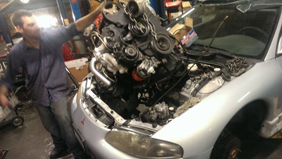

Pulled her in

Bet you all thought I lost interest in this one huh... The machine shop has been a little behind, but the verdict is in about the rod knock...number 4 rod was, .011 under...the rod bearings had crosshatches in it which could only be hand made, not rotational like a crank, and the rod cap was mismatched from another set LOL... on top of that the bores had taper, so got some 85.5mm NPRs

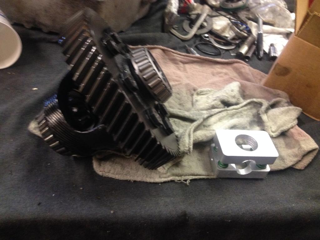

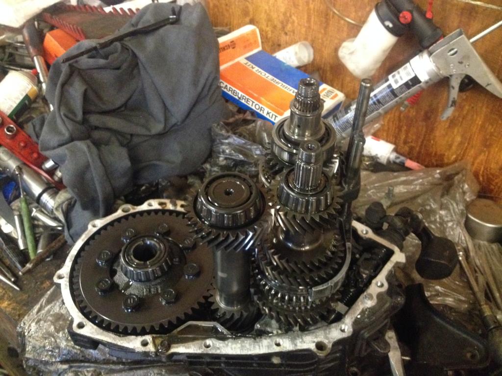

Got a cheap LSD insert (I know I know theyre risky and dont handle a lot of power, but screw it why not)

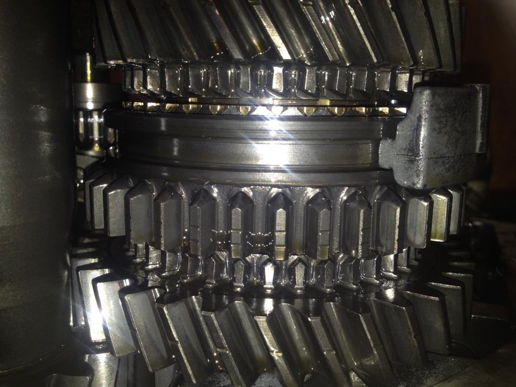

Yeah I know, I was on the fence about it but after seeing how 4th gear in this trans looks its kinda easier, but I hear good things about lower power levels on them, it could work :) Thanks for the props tho

mismatched rod cap

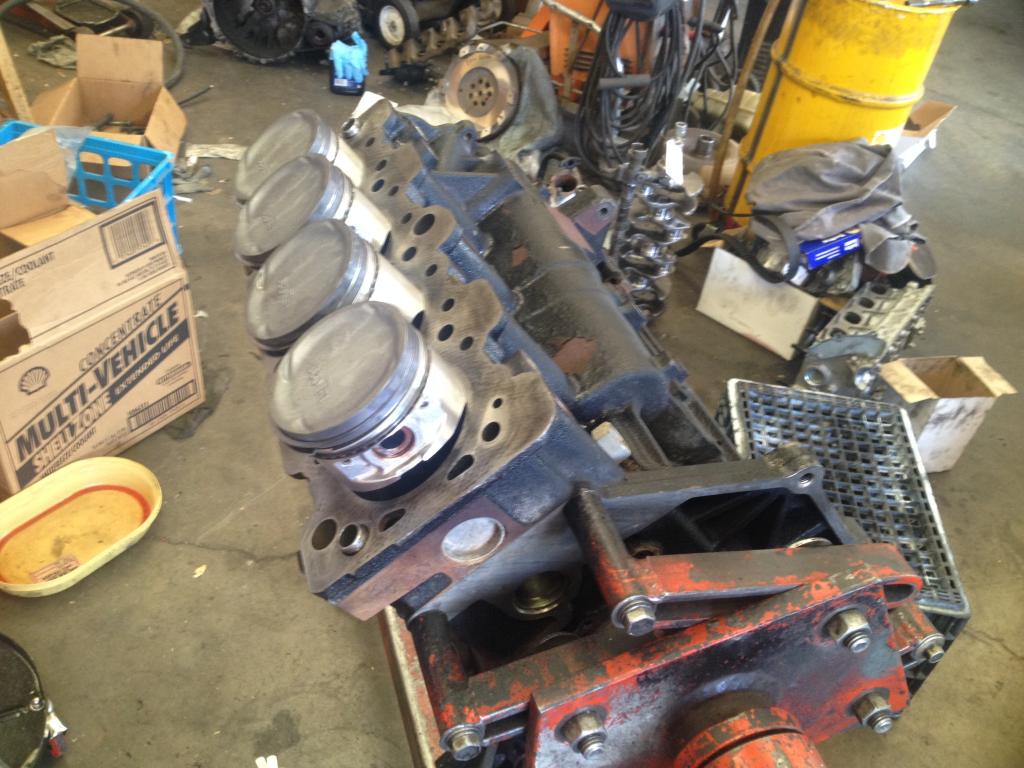

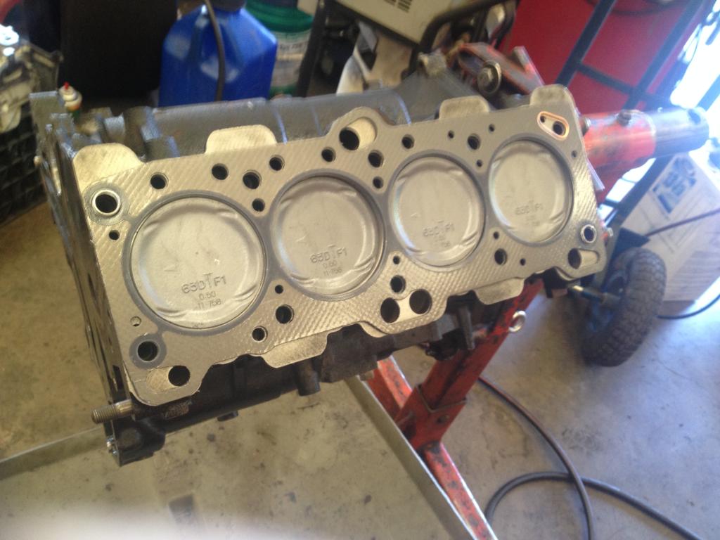

So assembly began! Ring end gaps all checked out
Pistons in their bores
Head on

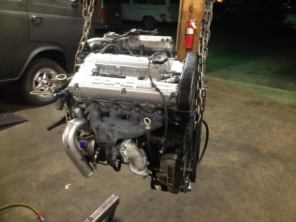

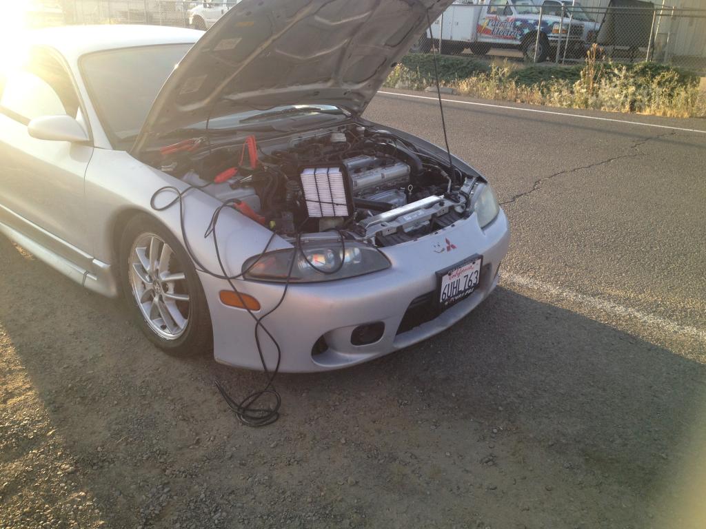

What a crazy busy weekend...did a 19.5 hour work night on friday, then of course all day sat sun, got it running sunday. Everything went great, seated the rings under low boost, got some gas, fixed some boost leaks, did a fuel filter.

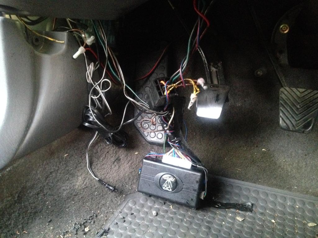

Started getting rid of this ghetto BS....

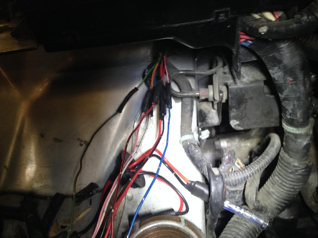

Had an electric short to fix on the side of the road...yay dsm

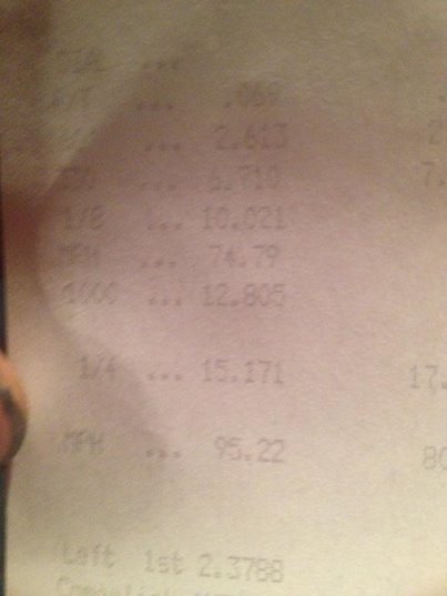

It was fun racing my buddy in his 1G gst, very evenly matched since were both super mild in our builds so far
Gonna start running each friday night race, and show how each mod helps in the 1/4
