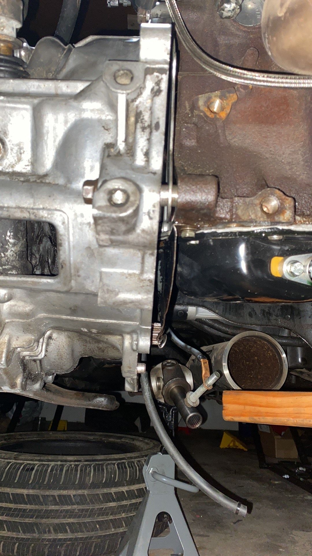

Bolted in this extra trans so I can put the car back on it's wheels and have it towed to storage while I move. Had a question on these dowel pins and their fitment. Right now it has all 4 mounts attached, rear has 2 of the 3 bolts attached, trans side has 2 attached, front is attached, drivers side is fully attached.
The trans that I took out of the car, didn't have this sort of spacing, I would NOT race/drive/or even start a car that has the trans mounted like this, I expect these to be flush, correct? Does anyone put any sort of grease on these to help them slide on ?

Keep wiggling the trans and it should slide on unless a dowel or hole is damaged. Do not force it on with the bolt. You can snap an ear off that way.
Noted. I won't be touching this for awhile, goes into storage for a few months while I move and get things situated at the new house.
I did put the bolt in that hole, but I did not tighten it to the point of it pulling the trans closer to the block, didn't want to risk the breakage.
I'll loosen everything a few turns and see if it will wiggle on further. Thanks!
Remove the trans mounts and bellhousing bolts and get the transmission aligned. It should literally slide on, or you will damage a clutch disk or other components.

Trans is flush no, but now the upper intercooler pipe doesn't fit as well as it used to. Will have to find a fabricator in the new city to cut and weld so that it's perfect.

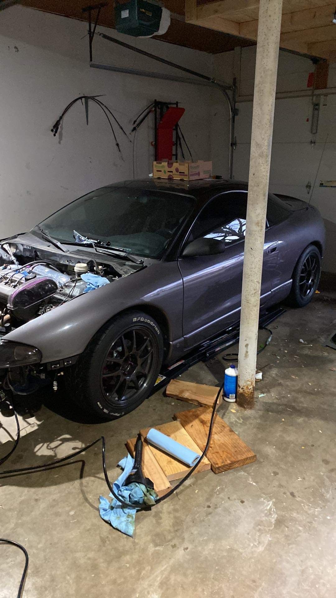

Well, back on the ground and almost ready to be towed into storage. I forgot how low this thing sits...
Also forgot how good it looks; can't wait until I can get it moved and finished up, and drive the damn thing.
