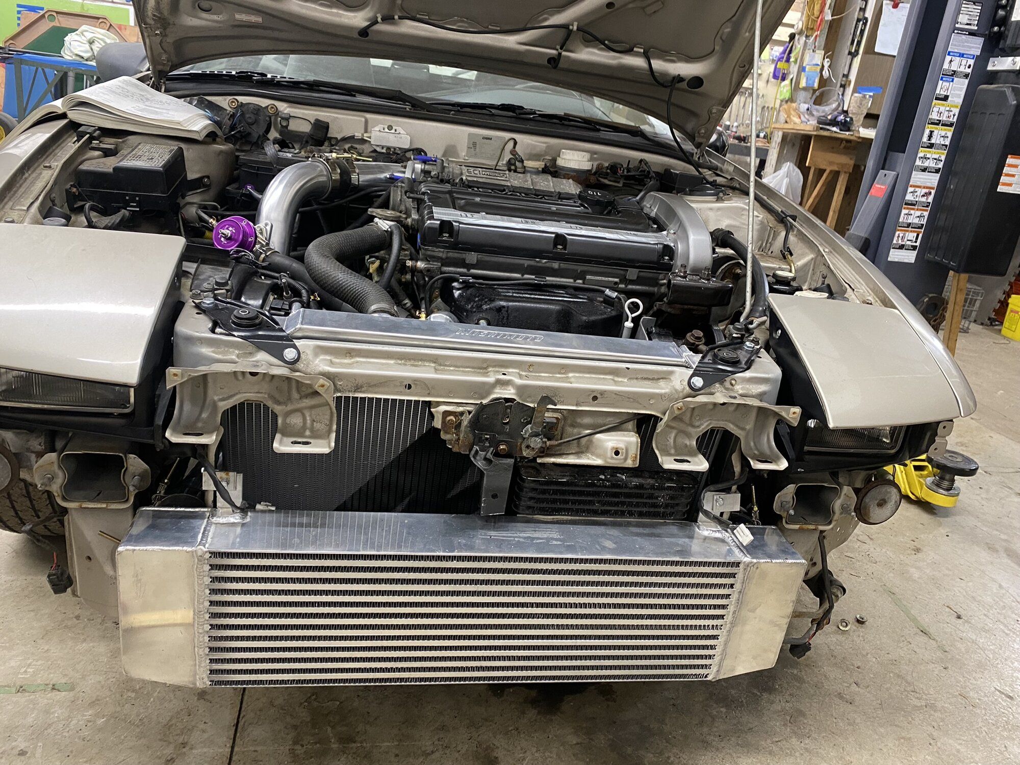

So since the last major update, the engine bay has pretty much been buttoned up. The existing turbo exhaust housing had a couple hairline cracks forming, so we bought a freshly rebuilt turbo (big thanks to Spleen8urLSX!!)
I installed the intercooler and fabricated some brackets for it. I went with the CX Racing kit, but I think it was designed for a 1gb instead of a 1ga because the mounting points didn't line up properly. The overall quality of the kit was very high though, with really thick wall pipe and decent silicone boots. I also installed a shiny, new Mishimoto radiator. I decided to take the power steering cooler out because it was in the way of the installation for the intercooler. I was able to find a way to keep the oil cooler by re-bending the lines, coping out some of the sheet metal and tucking it back in it's original location between the FMIC and the radiator.
Cruise control was taken out after deciding it was taking up too much precious space in the engine bay, plus it was in the way of the blowoff valve and I didn't want to re-fabricate the intercooler piping to move it. Plus primitive cruise systems always look ugly.
It drives pretty well and I've taken it out a couple times now since getting it started. I ordered new tires (super excited to reveal those), but realized that I had ordered the wrong size. Initially, I thought I would buy new wheels, but ended up deciding to keep the existing wheels since they're in pretty good shape and could just use some sprucing up. However, I accidentally ordered tires to fit the 17" wheels I had originally planned on buying, so I guess new wheels it is for me! I placed the order today and went with Whistler KR1 in machine finish. I'm really looking forward to seeing how the 17s will look, I think it'll be a nice little visual upgrade. And I love the way they look on the Supra, another boxy popup headlight car so I think they'll be a good fit.
Thrilled with how it runs, so much faster and more responsive than expected even with probably super gross injectors that sat for years. The shifter action feels cheap and shitty though, vaguely plasticy and likes to go halfway into gear instead of all the way sometimes. Will definitely have to play with the cables, but I'm sure some lubrication and use will improve it quite a bit. It's really coming back to life well for how long it sat.
The next project is reassembling the front bumper with all the freshly refinished parts!

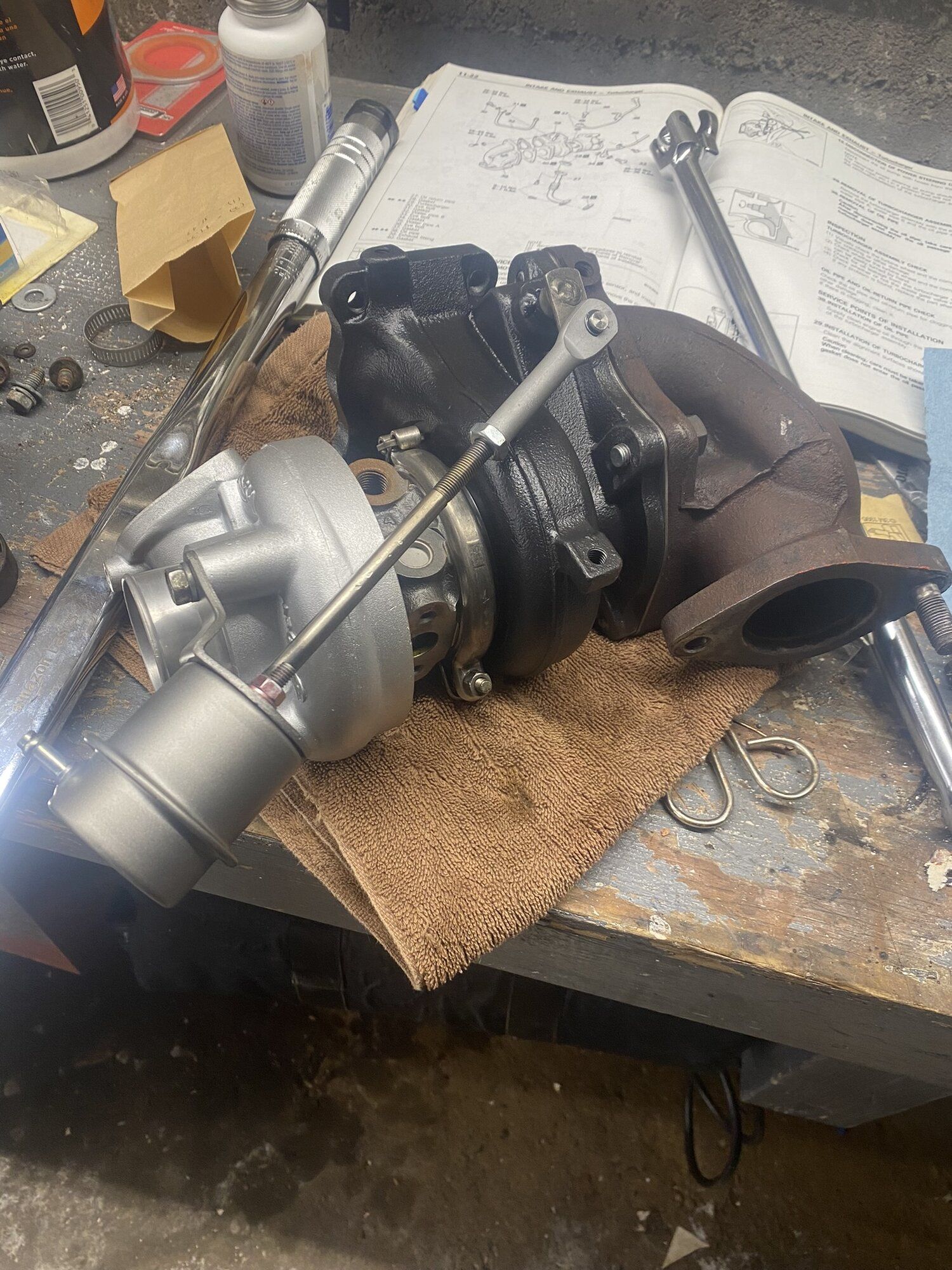

What kinda turbo is it? Just a 14B w/ eBay 16G housing or something else? Love the stock housing turbos! Especially on a street car/lightly modded car.
Everything looks great! That’s a lot of progress in the recent months and I’m glad that turbo is working out well, living a much better life than boxed up on the shelf.
For the cables I’d imagine the rubber bushings where they attach to the levers on the trans are all oblonged and fatigued from age. Torque solutions offers a nice polyurethane bushing kit. I have the Buschur metal bushings in mine and it made a night and day difference but I plan to switch to the polyurethane ones as a few of the well versed transmission guys have come to find they suspect the metal bushings or skateboard bearings in place of the bushings can cause over extension on a hard shift resulting in breaking a shift fork (would make sense on how I managed to do so on the good 90 trans I had).
I'll order up some of those poly bushings asap, thanks for the suggestion. I can do that with the braided clutch line once I rehab the fuel system.
That's good to know. I planned on going solid/brass shifter bushings on mine, but I'll go torque solutions instead.
Its just a stock 14b. I'm shocked at what a great little turbo it is for a stocker!
It's better than just a stock 14B, it's got a 16G turbine housing on it, which means it flows better and wont crack(as easily) as the OEM one will. Also an aftermarket(looks like a holset?) WGA which will hold boost better. You scored a great little turbo there! I bet it rips.
Shows how much I know. Figured those were basically negligible gains more “refreshes” than actual upgrades. Once again, thanks to Spleen. Good transaction, fast shipping, super helpful.
It is indeed a 14b in a 7cm housing and Holset gate actuator Justin Whitesell built. I was going to use it but the less I’ve messed with my car the more time I’ve had to change my mind numerous times and scrap going back to a j pipe turbo, so instead sent it to a better home for what I had into it for a car it suits perfectly.
And no problem at all for the smooth transaction, I’m just glad to see it perfectly suited for what you’re looking to do!
That’s one of the main reasons I went with a green(among many) was to get rid of a j-pipe setup and hopefully keep both my stock fans.

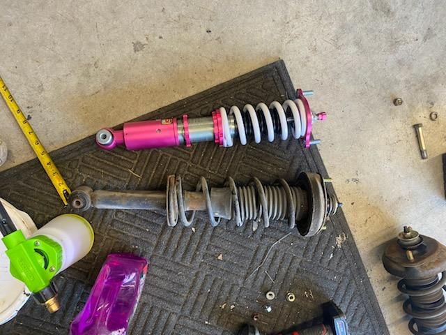

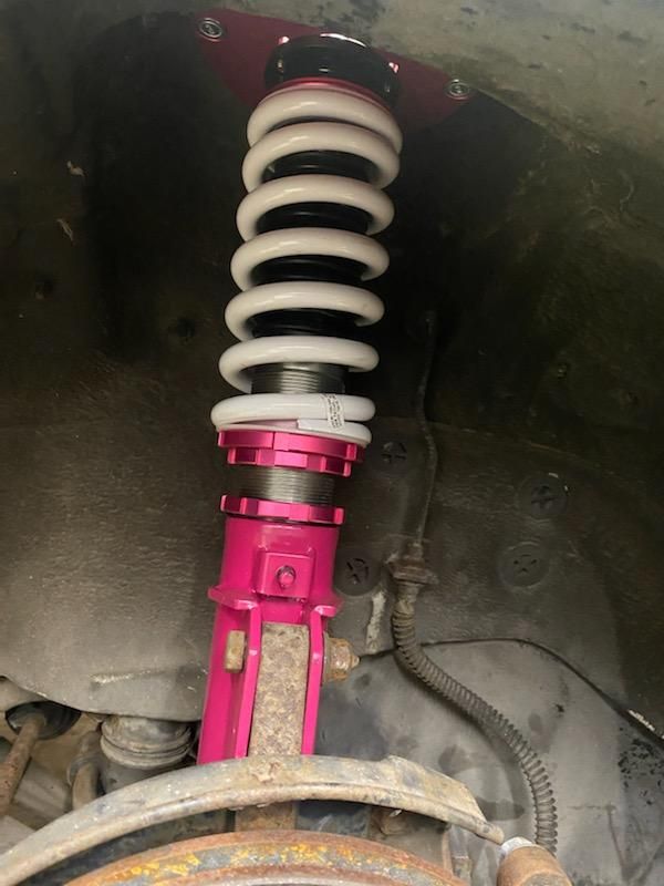

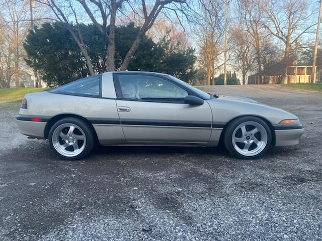

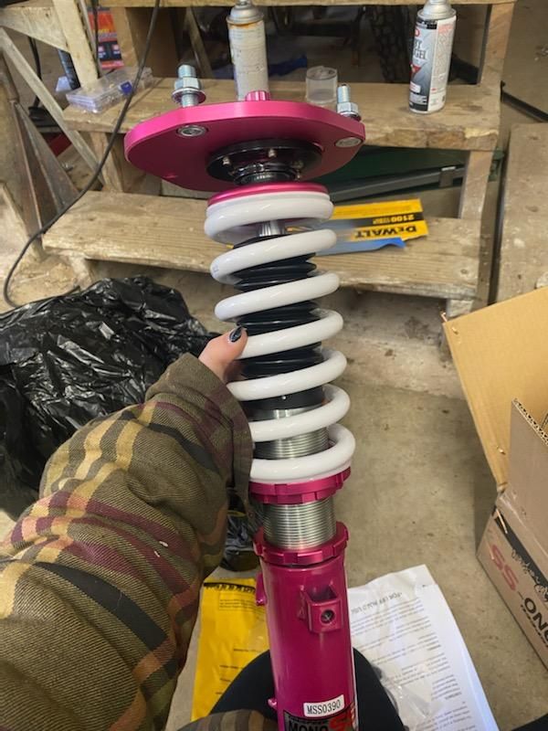

Some shots of the new coilovers and how she sits now:
Thrilled with the way she sits and rides. Body roll is almost nonexistent through moderate corners.
wow !!! looks so good with these wheels and coilovers !!! amazing ! what spec of wheels ?
Whistler kr1, 17x8, they only came in one offfset, believe it was +25 or thereabouts. @Ludachris had a great wheel fitment comment or thread that I referenced and these happened to be the exact specs he said worked best on 1gs. Plus I wanted a 90s looking directional wheel. I have the same exact setup on my Supra and love it so I just copied and pasted onto the laser. I will be lowering the rear more though, I’m at maximum drop in the rear and the car still has too much rake for my taste.
Federal 595 rs/rr. 235/40/17. Super loud but grip like hell and look awesome!
totally agree, these wheels are perfect, fitment AND style !!!! blade type wheels fit so well on a 1G , i love it. what kind of coilovers are those if you dont mind ? gonna get some eventually...
Godspeed mono ss. The cheapest “quality” coilover available (in my opinion). And they happen to be pink which looks sick and fits my eventual color scheme plans. I highly recommend them for street driven non-track cars if you’re just looking for lowering/stiffness adjustment/handling. $675 shipped from redline360.com
