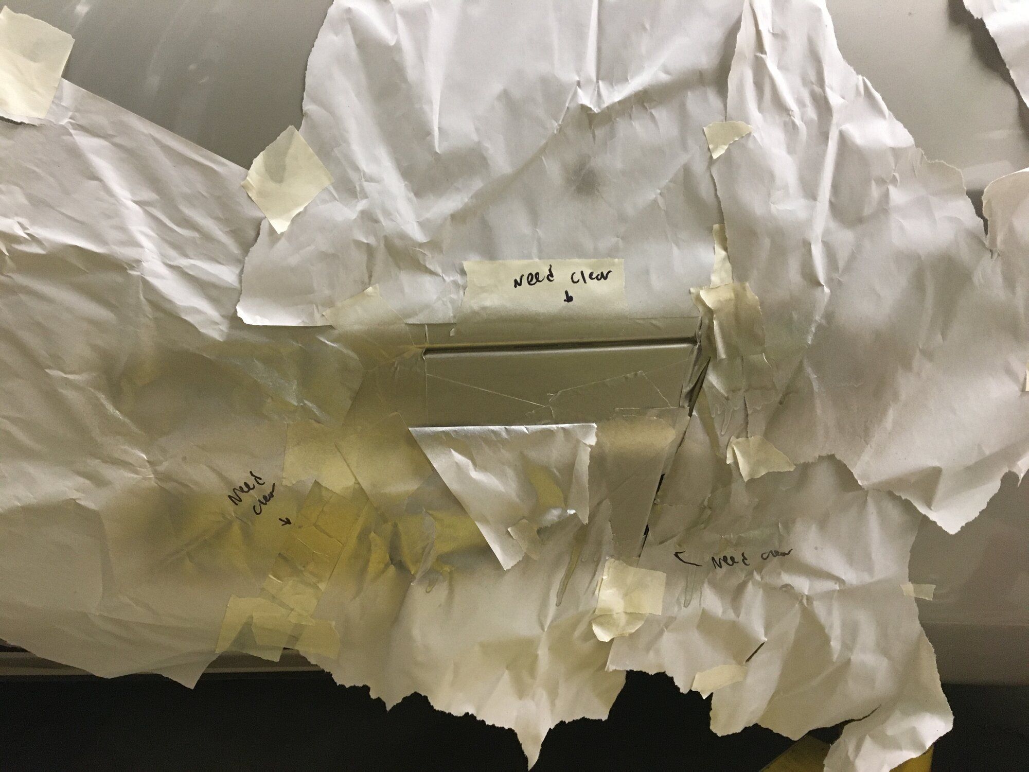

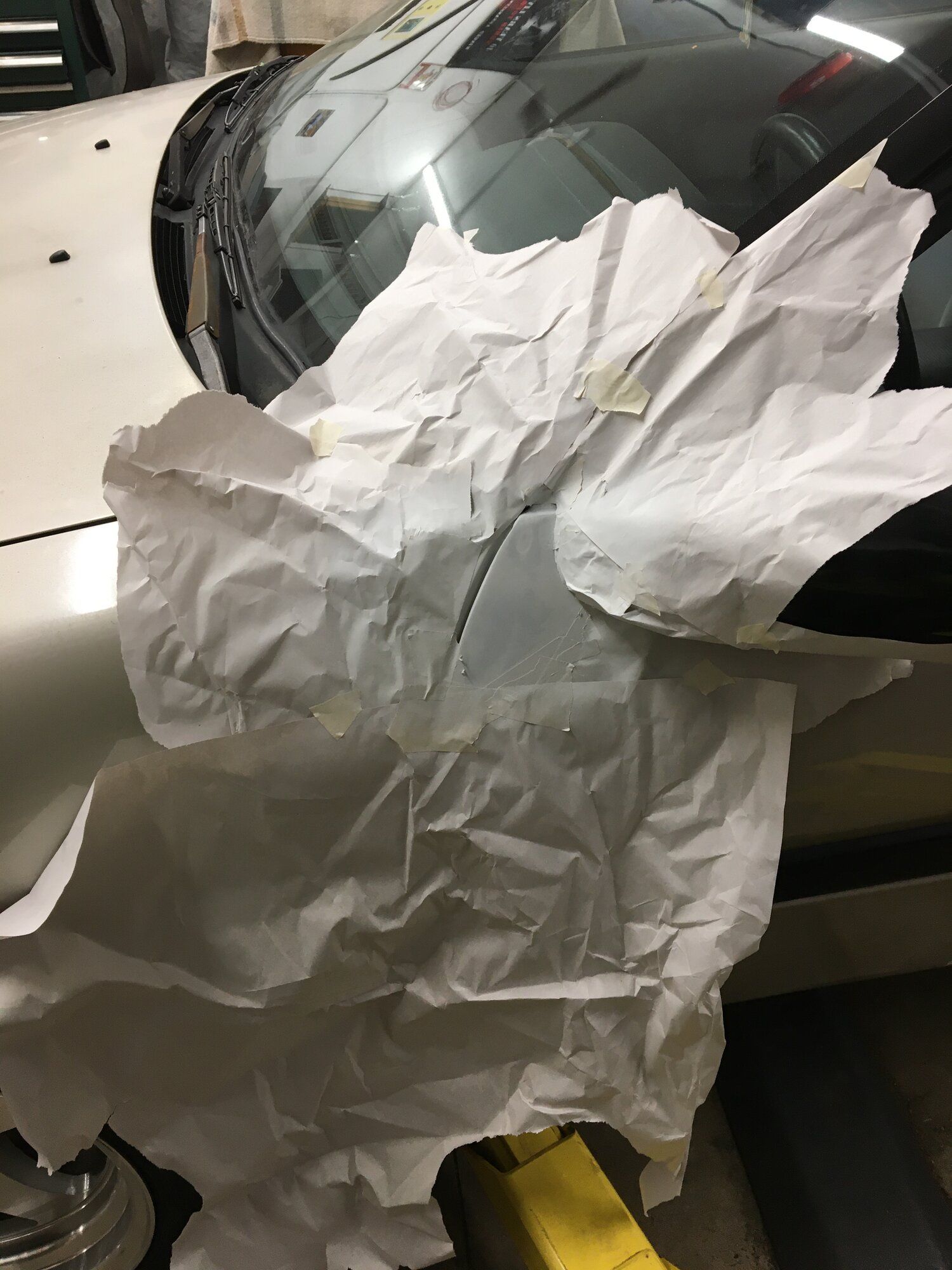

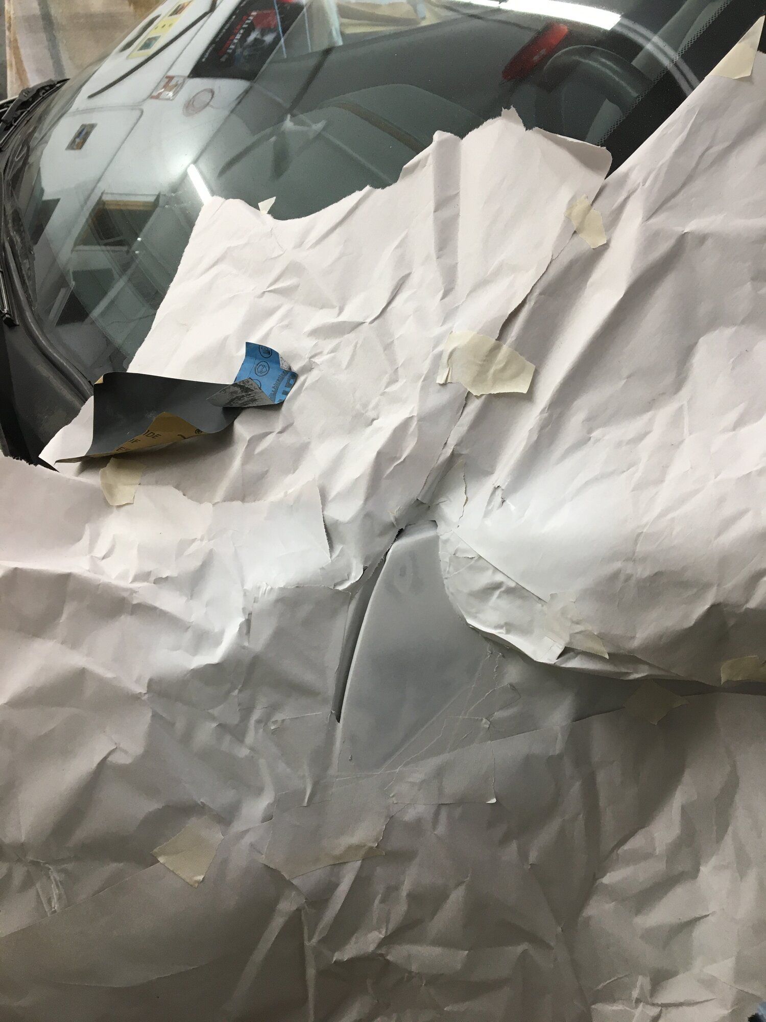

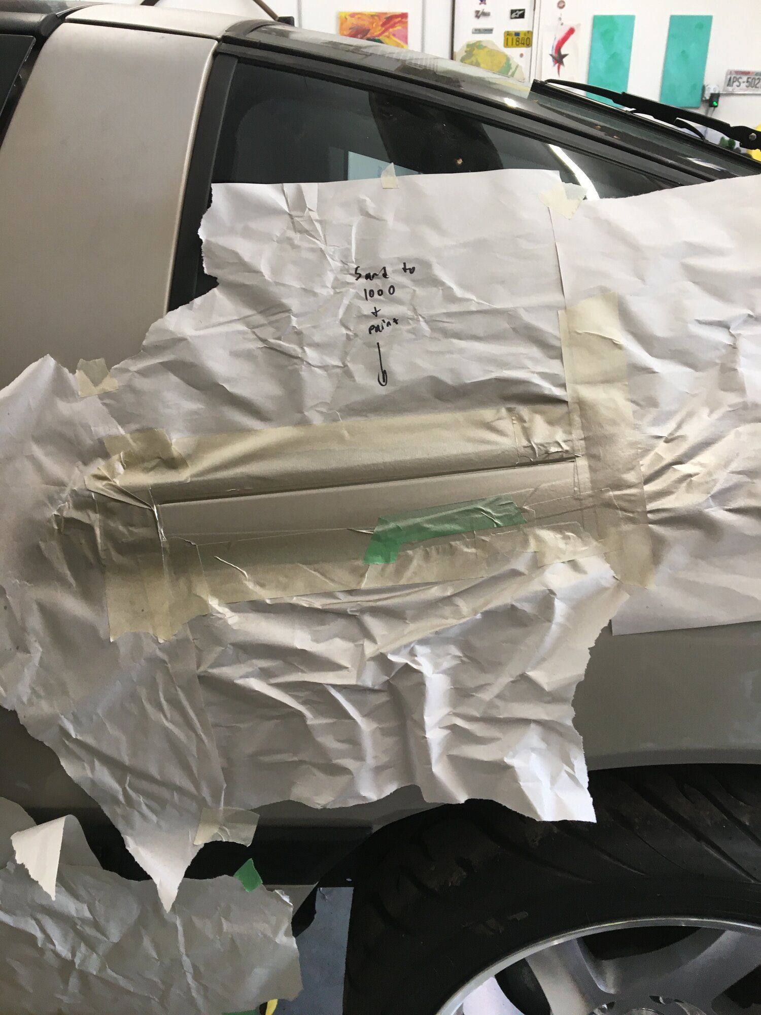

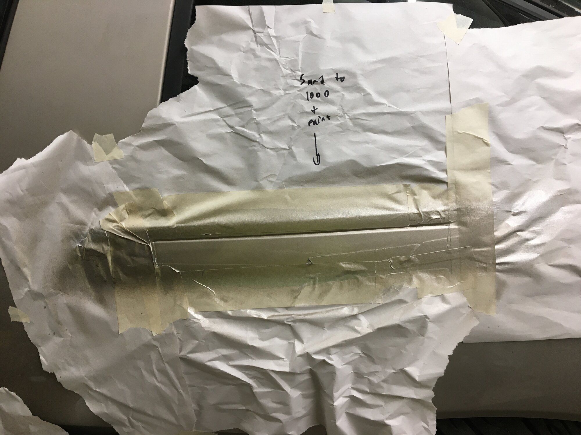

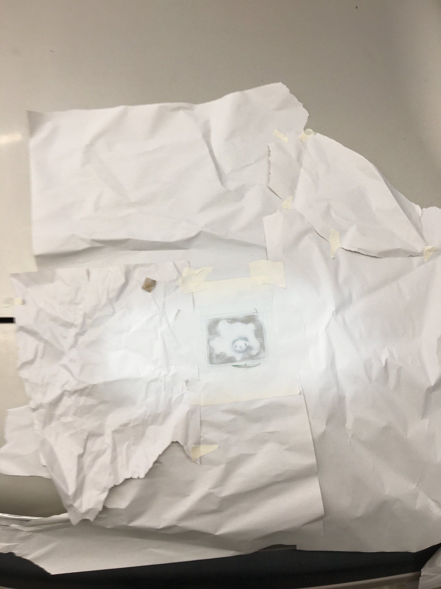

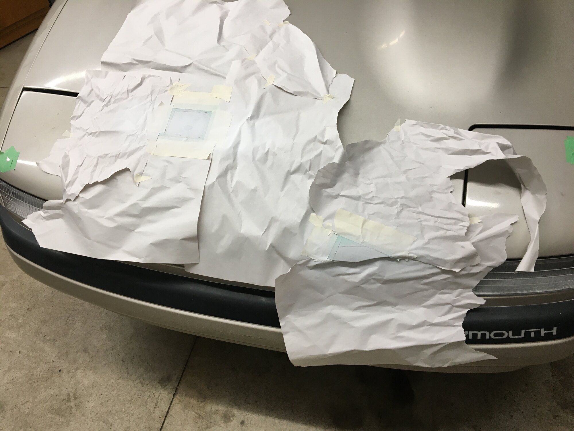

Some (very) amateur bodywork. Sometimes the only way to get over something scary is to just dive right in and learn as you go. Bumper to Bumpers paint is a little off but will work well for base coating. Hoping automotive touchup’s is a closer match
good progress ! cant wait to see the end result

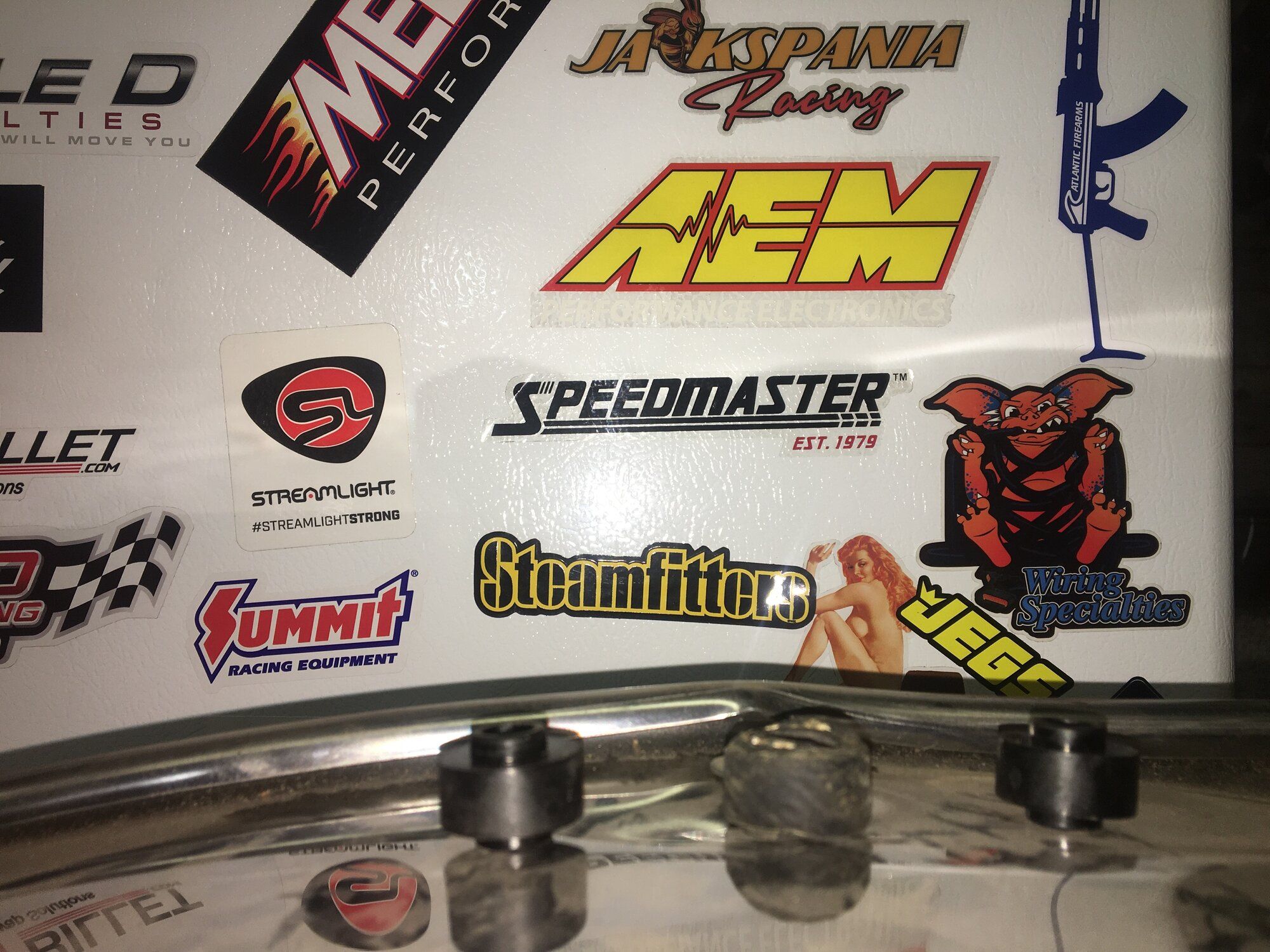

Got an adjustable timing light to time on the cam gears since I couldn’t see the crank marks to use my regular light. It was running at a whopping 22* btdc at cold idle. Let it warm up and then adjusted to 5*. Car is stumbling/surging at idle now, wondering if I should trust this harbor freight adjustable timing light...
Anyways, I slowly and gingerly revved the engine to see what it would do and it died coming back to idle, like it has a horrible vacuum leak.

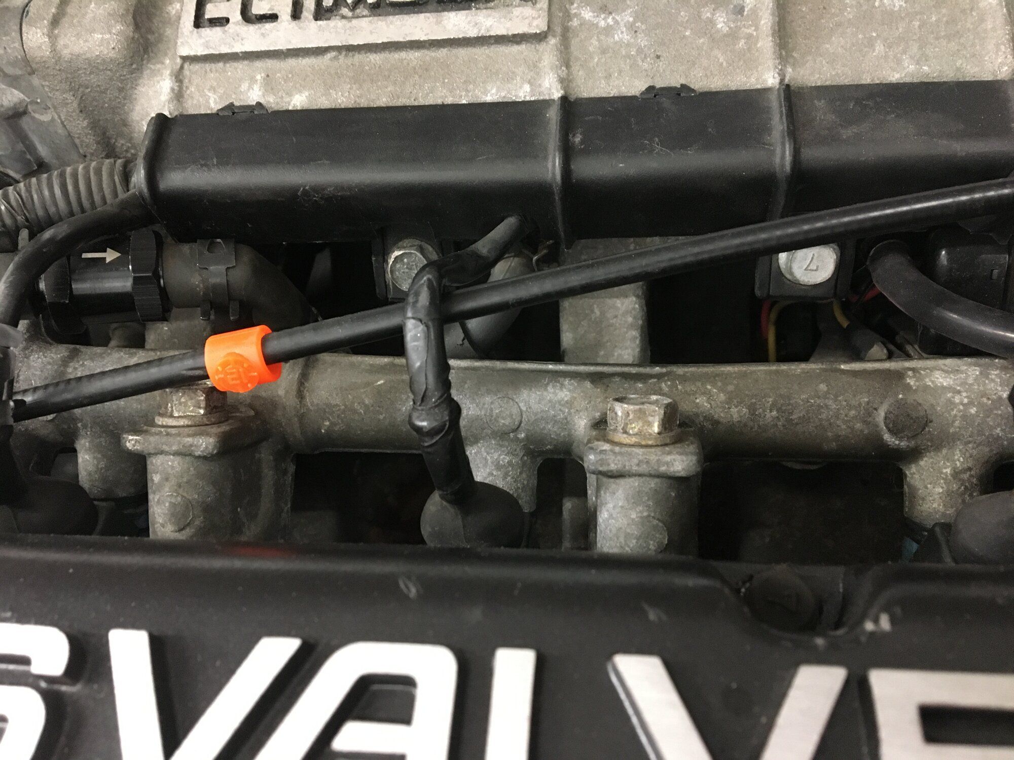

Then I noticed this

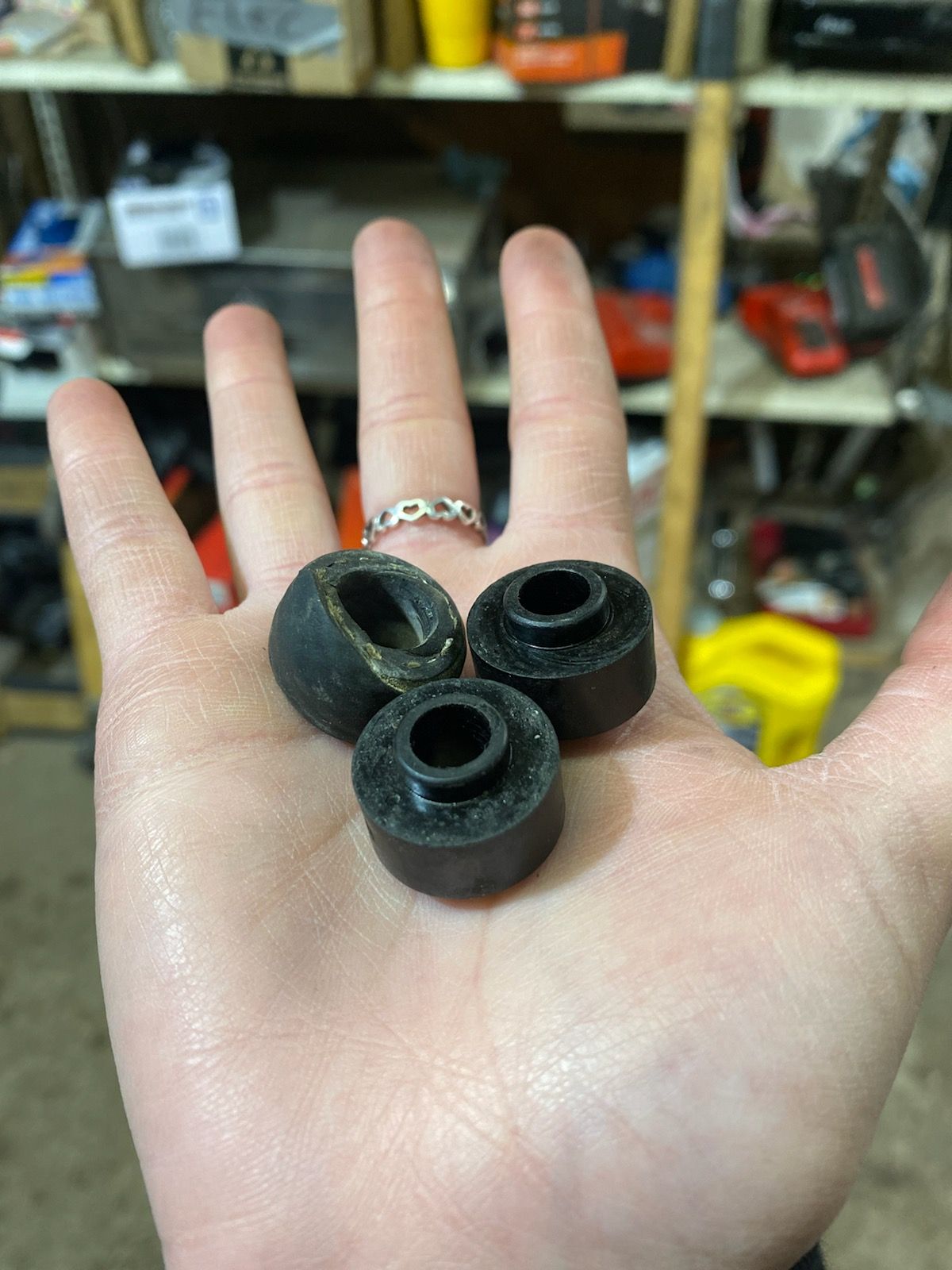

The fuel rail is bent. All the bolts are torqued to spec but for some reason the rail is bowed. Injectors 1 and 4 are loose and can be rotated with almost no effort. 2 and 3 are locked in tight. I was needing to send the injectors out for cleaning anyways, so now I’ll just put it back together with a new rail. Weird. The bolts were super loose so I torqued them when I did the non cruise throttle cable. Then double checked the next day after a heat cycle. Then checked again today, still exactly at spec from the fsm. So I know for a fact they were torqued correctly, no idea how the rail just completely warped.

That’s a new one seeing a fuel rail do that! I have a few on shelf but they might be for a 2g as my cars set up to use a 2g rail now, did have a few 1g ones including a 90 one but I may have tossed them a few years ago when I moved but I can look. Did you have the plastic spacers in that go between the rail and the head?
Hmmmm plastic spacers... I’m not at the barn now to check. I’ll look through my photos and see if I have any pictures of it
I was thinking of the spacers too. If the middle one fell during assembly (super easy to happen) torqueing the bolts to spec could bend the rail.
Shoot, maybe that's what happened. Better find a set now just in case. I never had the fuel rail off though...
I slept on it and came up with a theory: I think this car has been f***ered with despite its super low mileage and one owner status. I think the PO had a mechanic work on it who didn't know what he was doing.
The exhaust cam was off by a tooth when I did the t belt. Since I dialed in the base timing, the car has ran like crap. I have never pulled the fuel rail but it really sounds like its missing a spacer.
So that leads me to believe the car wasn't idling right due to any number of leaks and the exhaust cam being off so instead of fixing it correctly, he advanced the timing to make it idle. Now that I fixed the cam issue and timed it correctly, the issues that the advanced timing were previously hiding are now coming to the surface.

We have some answers.
It turns out the old man in his $600,000+ house in the affluent Milwaukee suburbs with his extensive 20+ car collection couldn’t afford the little plastic fuel rail spacer for a 1990 Plymouth Laser. So he cut a JAGGED f***ING PIECE OF RUBBER HOSE AND CRAMMED IT BETWEEN THE RAIL AND THE HEAD. This is why the rail felt loose. This is why the rail bent when I torqued it to spec (or maybe it was bent all along?). This is why half the injectors weren’t really sealed at all. LOL. LOL. LOL
Like I took several pictures in different light trying to capture just how smushed and jaggedly cut this thing is. It’s not even a diameter that could possibly ever work for this purpose.
I know that sounded mad but I’m legitimately amused by this. Like a rubber hose? Not even a stack of washers or a plastic bushing of some kind? Something with zero rigidity whatsoever to replace a hard plastic piece specifically designed to not compress and to -space- the fuel rail at a specific distance from the head. LOL
Wow. I’ve ran wires through firewalls without proper bulkheads. I’ve gooped in a bunch of filler to make up for poor fitup on pie cuts. All sorts of hacky stuff. I’m no saint. But this... this takes the cake. LOL

Have you made a boost leak tester yet? The injector seals are a common leak point, might as well change them while you’re in there.
That’s a bummer. I guess with a collection like that, you’re just bound to have cars that take a lower priority. Its in better hands now.
Yup, it’s hard to stay on top of everything.
Not yet. That’s the very last thing because with constant taking stuff apart and putting it back together as I iron out the kinks, I’d just have to keep rechecking it. Might have to go to a 91 throttle body because I can’t find an FIAV bypass for the 90 and I’d like to do that when I take it out for the shaft seals and biss o ring. Injectors are packaged up and go to FIC today. That leaves the intake manifold gasket as the only seal that isn’t new from the turbo to the head so fingers crossed!
