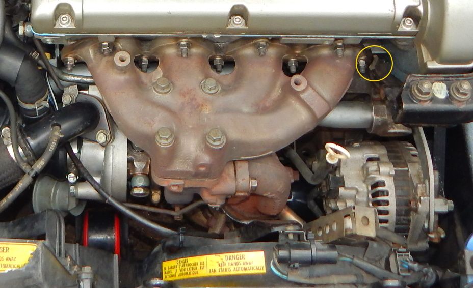

If you are able, a nice upgrade is to replace your stock 1G exhaust manifold with a 2G- it's a much better casting, less prone to cracks, and I think the runners are somewhat bigger. (The manifold shown in the photo is a 2G) Either way, while you are in there it's nice to use a die grinder and carbide burr to remove the obtrusive ring lip in the casting for the sealing ring between the manifold and turbo exhaust housing, and knock down the center partition somewhat. There is a picture of what mine looked like after I did that.
In addition to replacing the long stud in the turbo casting with a bolt, another simple mod that made my life easier was to use a cutoff wheel to remove the tab from the engine mount bracket that is directly above the right most corner of the manifold. (circled in the manifold photo). It's nice in allowing you to slide the exhaust manifold in and out without removing the turbo or the studs in the head. Take lots of care with the banjo bolts for oil and coolant around the turbo cartridge- they are hollow and fragile, and the copper washers love to get away.

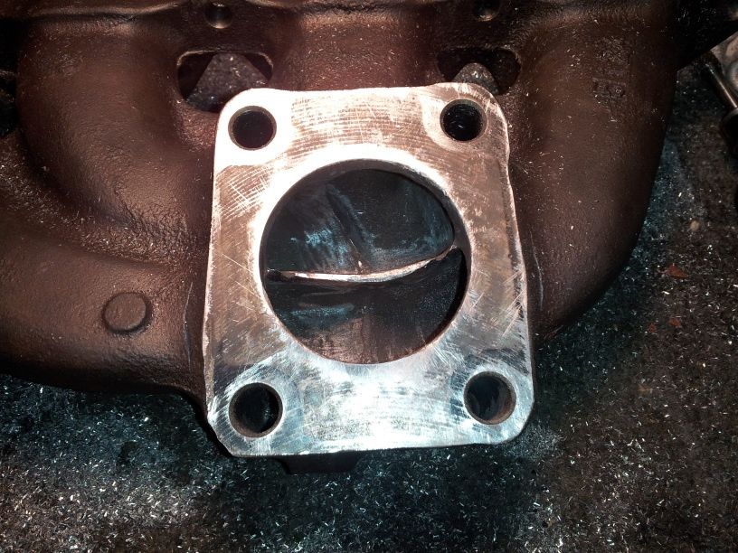

I do have a 2g manifold that I plan to port. Thanks for the pictures- I wasn’t sure what to do about the center partition thing.
And that tab has to go. Haha, I ran into the same issue with this one damn turbo stud. If I could just get the manifold out, I could start cleaning the head and extracting the last two manifold studs while I wait for the turbo stud to soak in some more oil (I already snapped the stud once after welding a nut on to it and trying to force it out).

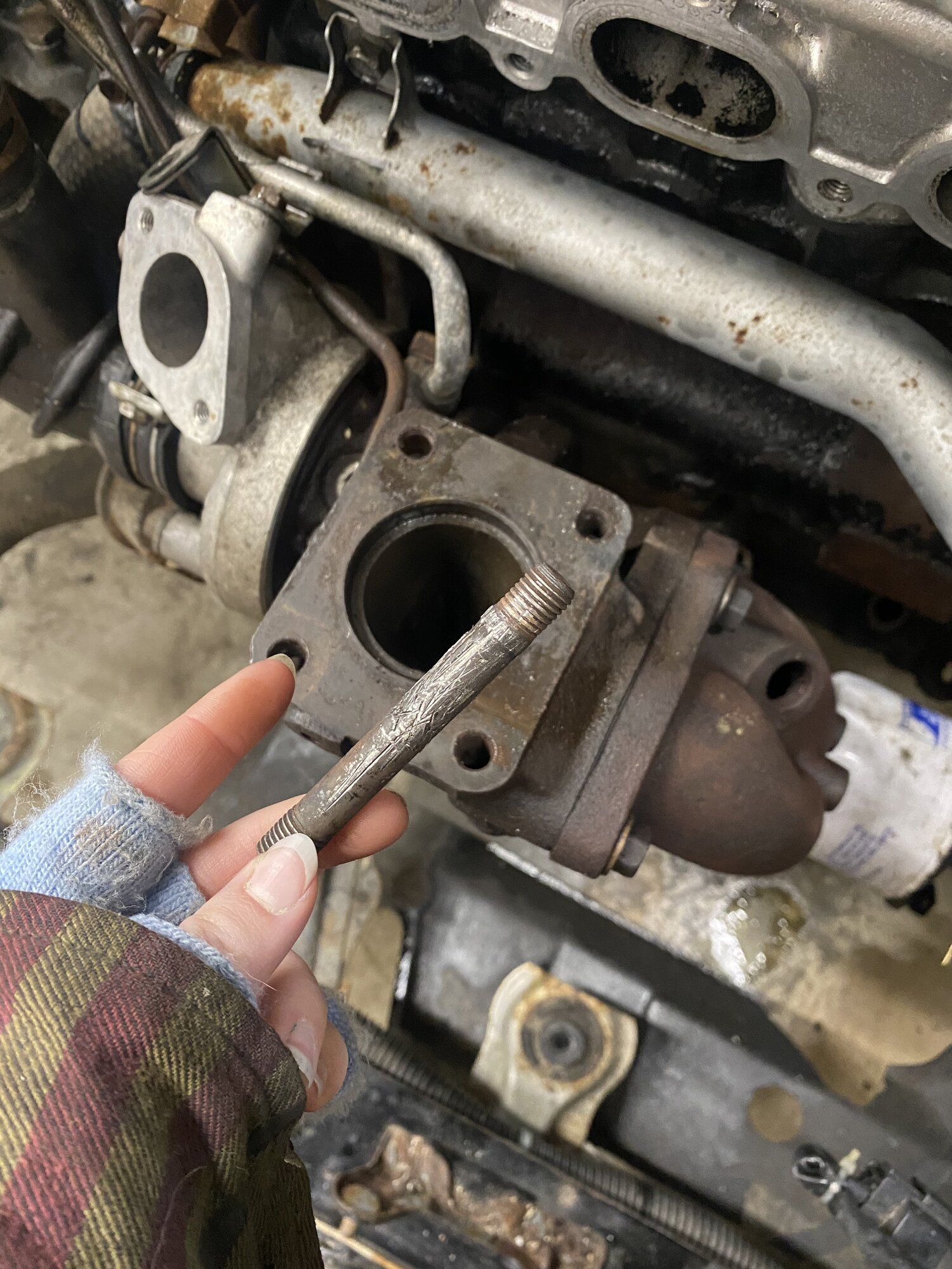

With the stud still there you almost have to remove turbo. I've found that once the stud snaps you almost always have to remove everything and to date I haven't been able to remove one that's stuck. I didn't use heat though. If you get it out that's great.
It's great that the turbo shaft is tight- sounds like you are good to go there for a long time. Yes- pauleyman is right, you will probably have to remove the turbo for that stuck stud, but with the head studs out maybe cutting that tab off of the engine support will give you enough clearance to remove the manifold vertically if you loosen the connection between the O2 manifold and down-pipe. You will most likely need to use heat to get that stud to budge. Oil will likely not soak deep enough to help.

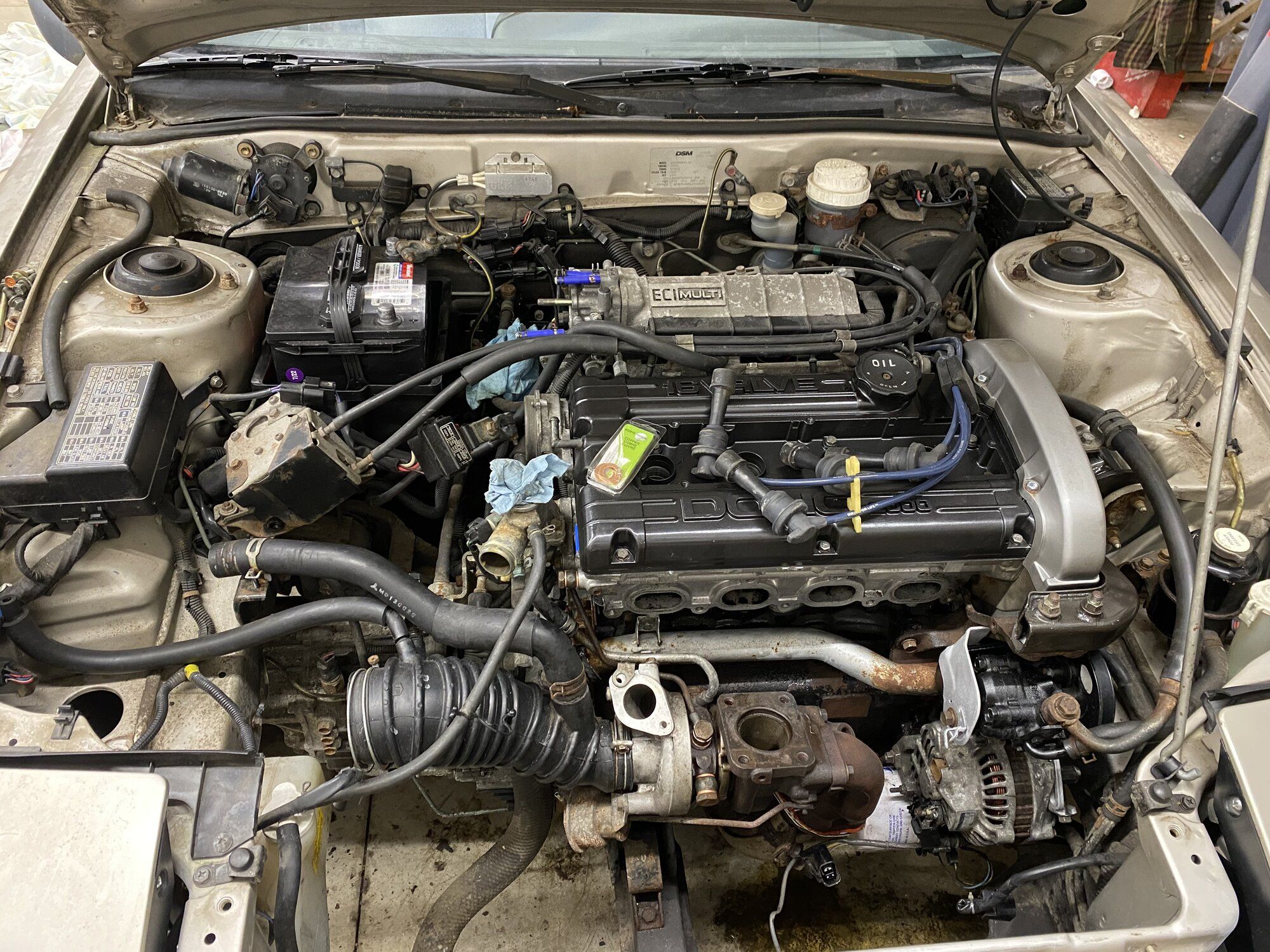

I’m finally to the point of getting parts back into the engine bay after cleaning them up and doing a lot of repainting. The timing is completely done and back together (finally) which was really the biggest chore on this car so far. The alternator, belts and power steering pump are put back on. Valve cover is put on as well in addition to new spark plugs. There are a few other parts that still need to go in, but that will be at a later date.
Our biggest project was getting out the turbo stud when taking off the exhaust manifold. It was stuck in there and took a lot of heat, oil and two people’s manpower to get it out. We ended up using two of the turbo bolts with a prybar as a holdback and then a 24” pipe wrench to spin out the stud after multiple rounds of acetylene and penetrating oil. Got it out with the turbo in the car though. Disconnected all the lines to be safe and replaced the crush washers.

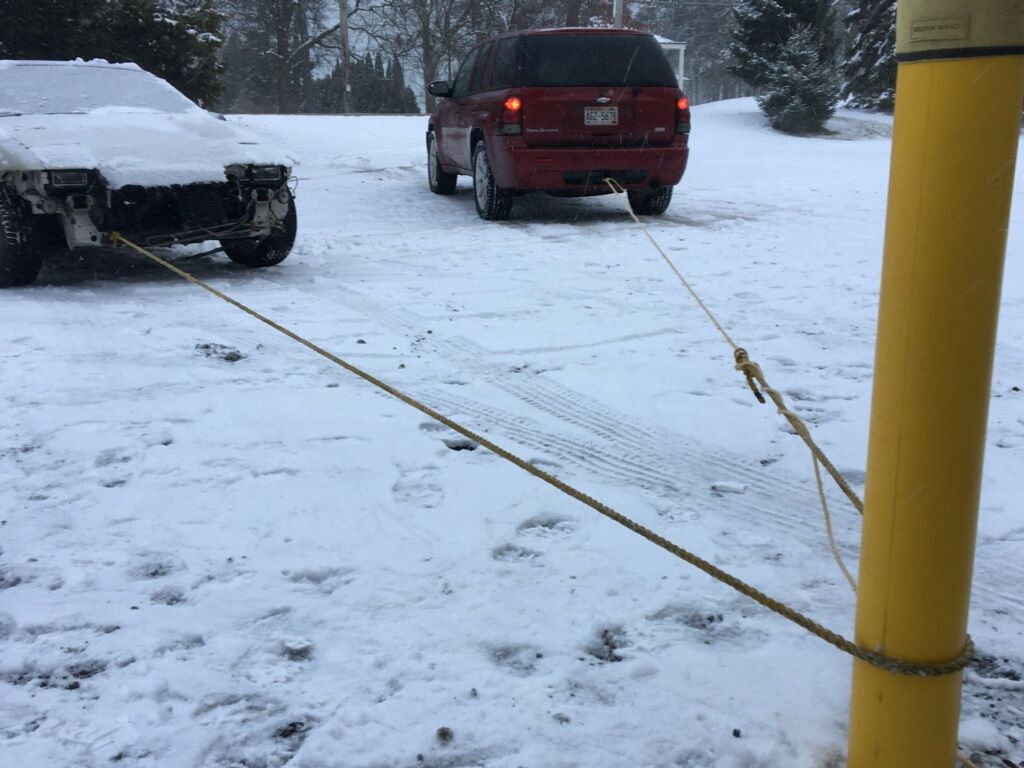

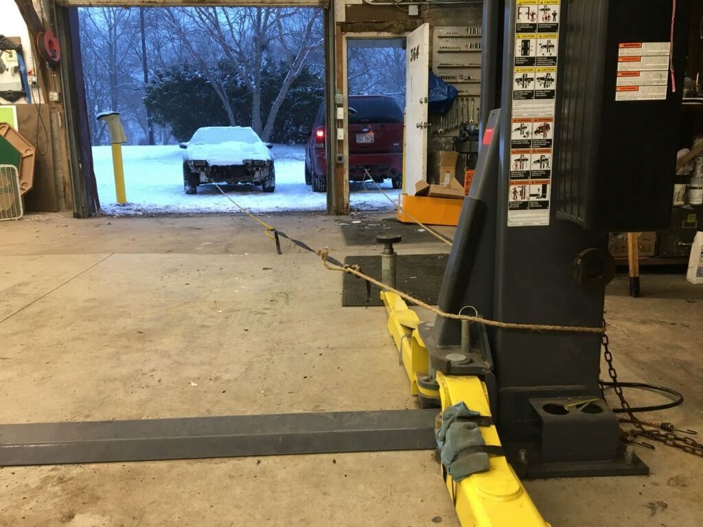

The most fun, however, was moving the car around in its disassembled state. Had to do a cat delete on my Silverado and wanted the lift. No sooner had I gotten the Laser outside, than our insanely warm and snowfree winter changed! So the next day, alone, I had to get the car from the lot in back of my barn around front and uphill to the inside. Here’s what I came up with:
Then:
Pro tip: be sure to use the shittiest possible grade of natural fiber rope tied together so that it breaks over and over and you have an excuse to yell and throw shit. That’s how it works best haha. Once the angle got too extreme, it was just raw leg power slipping and sliding in the snow. But after an hour and a half, I got it.

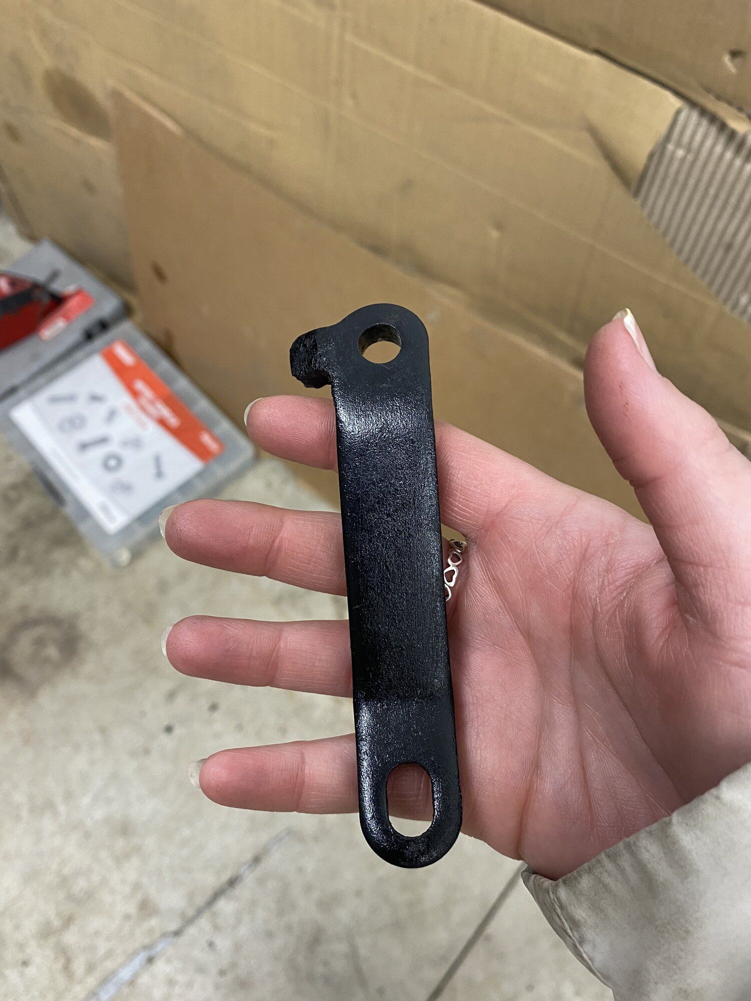

Finally, what’s this bracket? Everything’s back together and it’s still lying around. Can’t find it in the service manual.

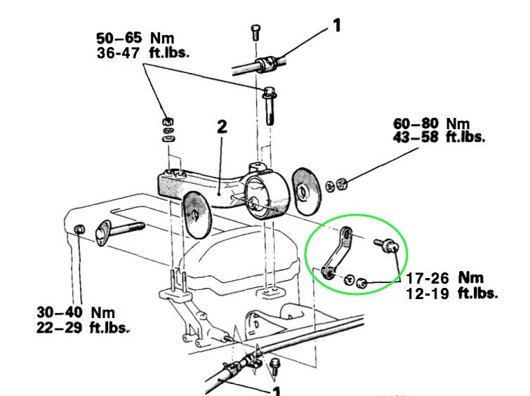

Finally, what’s this bracket? Everything’s back together and it’s still lying around. Can’t find it in the service manual.View attachment 685841
That goes from the motor mount bracket down. I threw it away 30 years ago.

Yeah the rest were easy, just welded nuts and spun them right out. The 2g manifold I bought was about 1/16” out of true so it’s at the machine shop getting surfaced but the head is all prepped. I’ll probably clean that valve off as good as I can and then send the injectors off to FIC. Was planning to do that anyways, but now their before and after results should really show some important data. Getting damn nervous for the compression test.

I assume you will be doing 4 bolts on the turbo instead of the stud. They are specialized. Buy oem. Get the oem washers too. 8 total. They are actually Belleville springs and you face them cup to cup to keep the bolts tight.

I’m really glad you said something, I was just going to use grade 10 since I couldn’t find arp and I wasn’t impressed with the oem material strength. The stud itself was breaking as I tried to remove it, not my weld. So I figured if my wire weld on an unclean stud and galvanized bolt was holding better than the base material itself...
But I’ll take your word for it and order brand new oem tonight.
Feel like it’s starting to really come together, managed to avoid some pitfalls thanks to everyone’s help, and now have basically every part I plan to install. I owe you all a beer.
Just a matter of finding time to put it together methodically and with attention to detail now.
