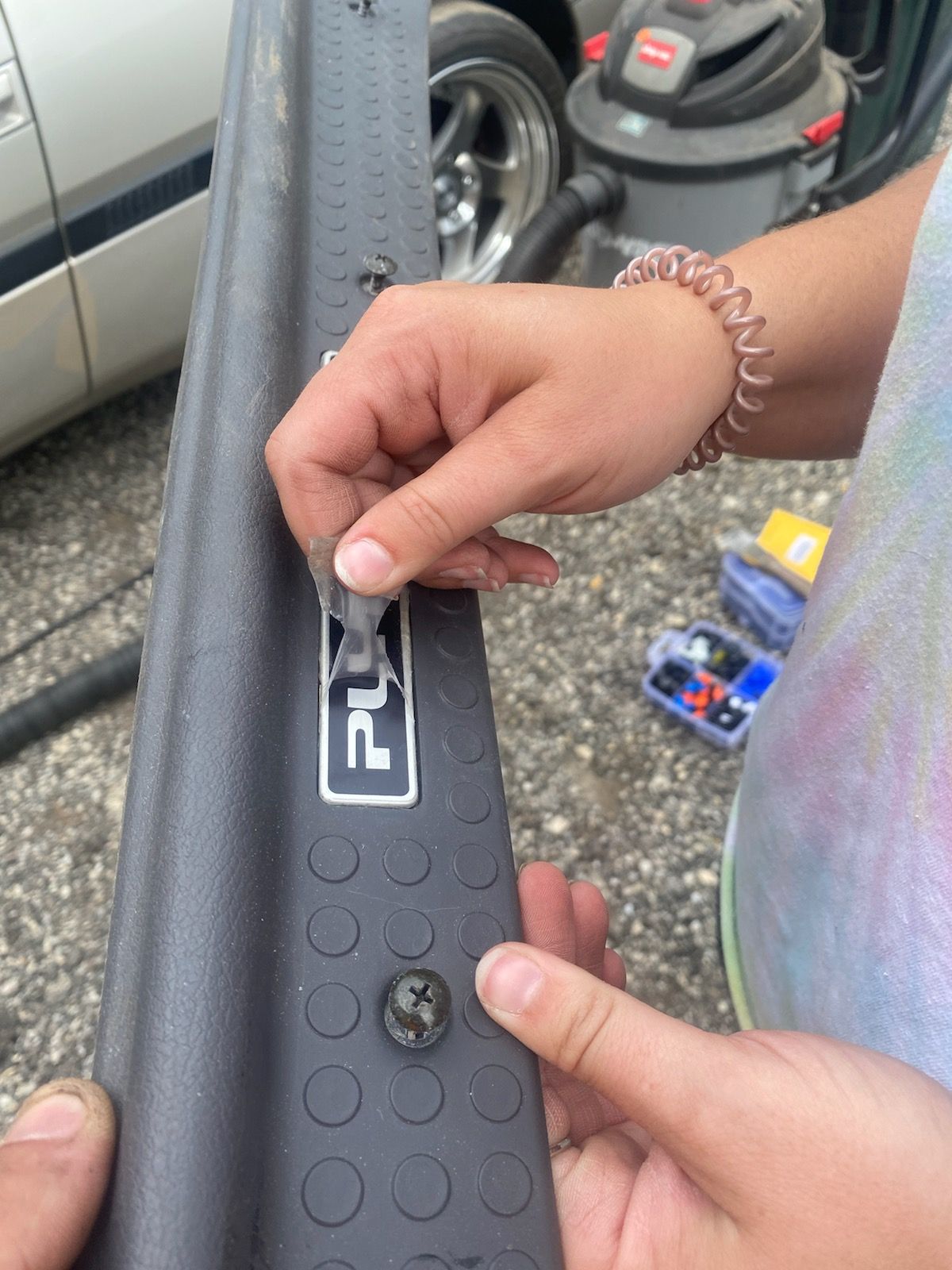

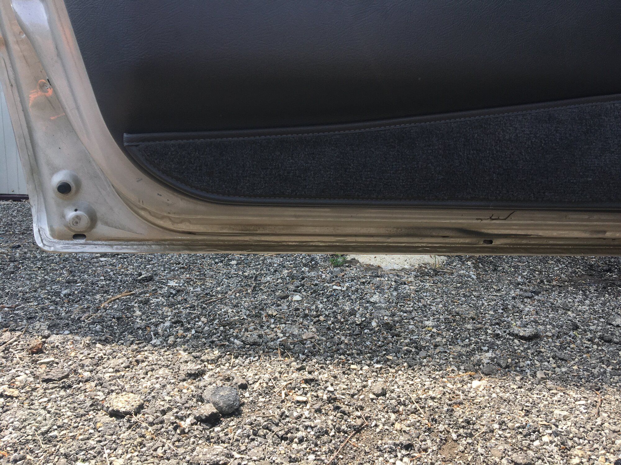

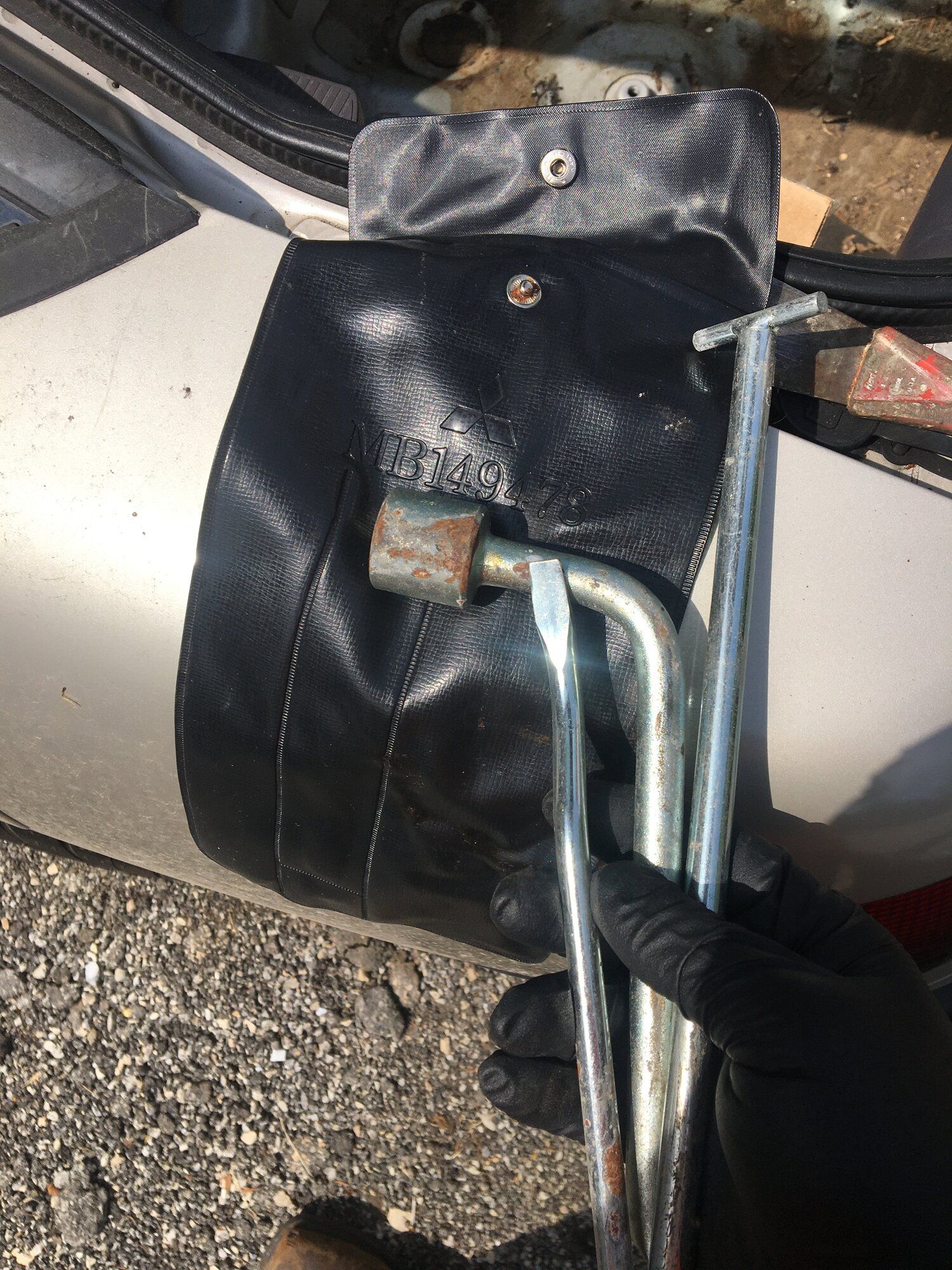

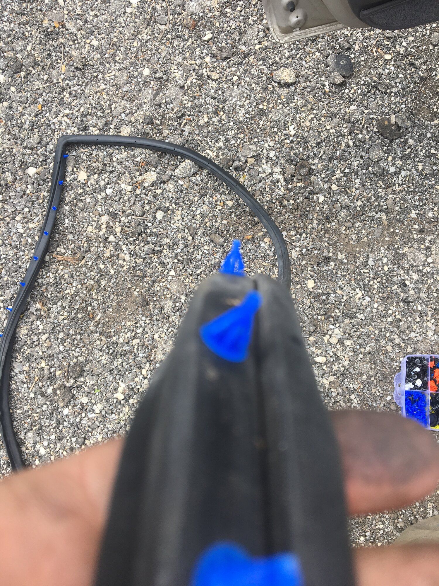

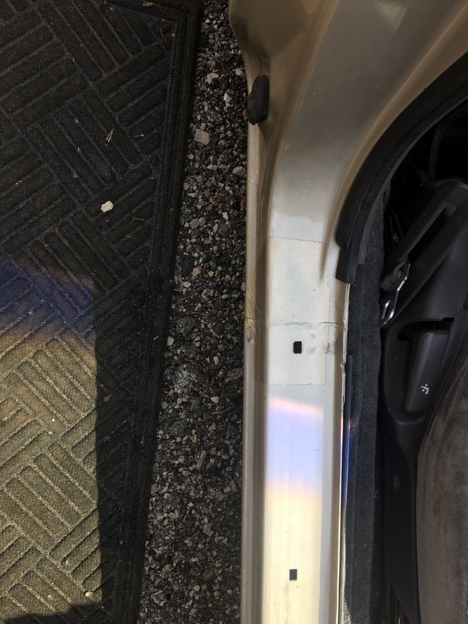

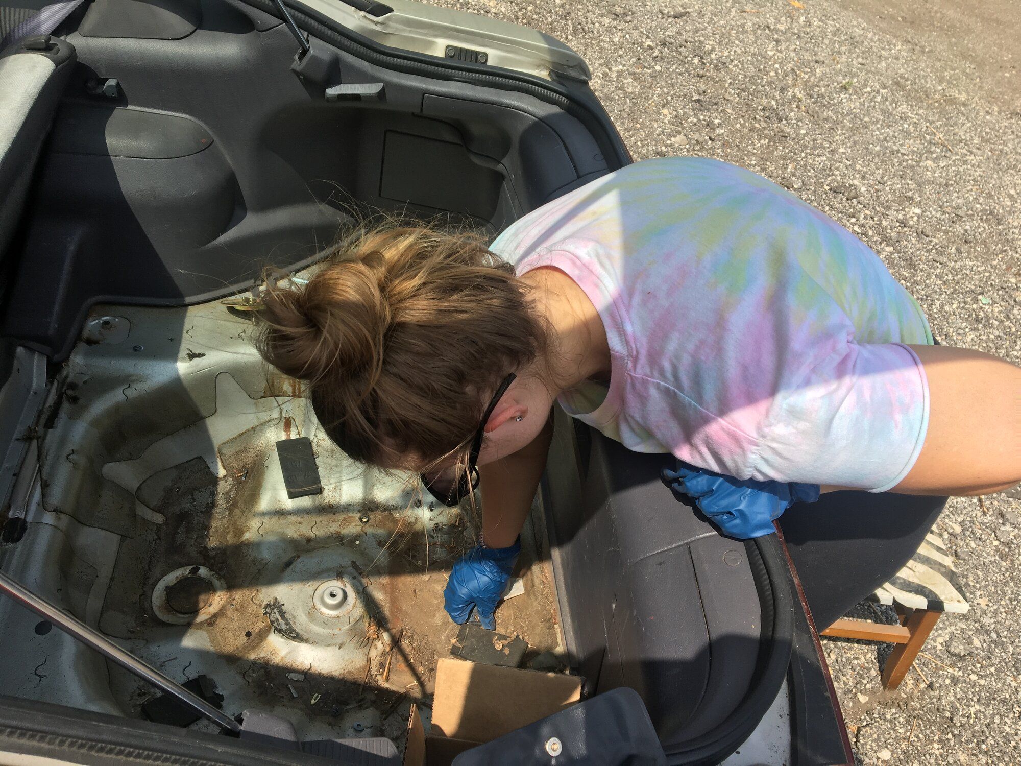

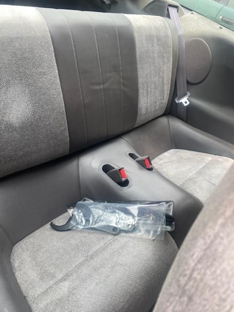

We got the trunk cleaned out, all of the peeling clear and paint patched temporarily (the paint isn’t a perfect match but it’s better than peeling paint/clear until we get the car professionally painted or wrapped), interior vacuumed, and drivers door weatherstripping reworked with new clips. Found and rehabbed the original Mitsubishi toolkit too. Progress is slow with other projects going concurrently but we’re making progress.
Clear plastic covering FINALLY coming off the passenger side door sill after 30 something years!
Interior is cleaning up nicely considering it hasn’t been detailed or anything yet.
I need some of those Plymouth door sills to match my horn pan! Been rollin the past few years with my horn pad saying Plymouth and my door sills saying Mitsubishi, wonderful progress you guys are making.
Also I really like the look of the Plymouth font. It just looks so period correct
Something so satisfying about peeling that plastic off. What a cool gift from the previous owner.

Hey Tina- Could you post a source/link for the blue plastic clips for the door weatherstripping? How well did the work? Did they work for those holes that have been ripped wider in the rubber? Thanks!
If they're still there, there's a laser in my local junkyard. I don't think they're gray though, I think they're tan.
I'm curious as well!
Ok so the blue clips came in one of those no name variety packs from eBay or something where it’s like $60 for 500 pieces or whatever. They worked great on the holes that had been ripped wider. The part that goes inside the hole and grabs the weatherstripping is actually wider than the oem clip and that’s why I chose to use them over the oem ones. They fit the holes perfectly and retain the weatherstripping tightly. Definitely better than the oem fasteners and certainly cheaper. Plus the rest of the clips on the kit are super useful as well.
Plus the prong design that grabs the door is much more robust than the stock Christmas tree style
