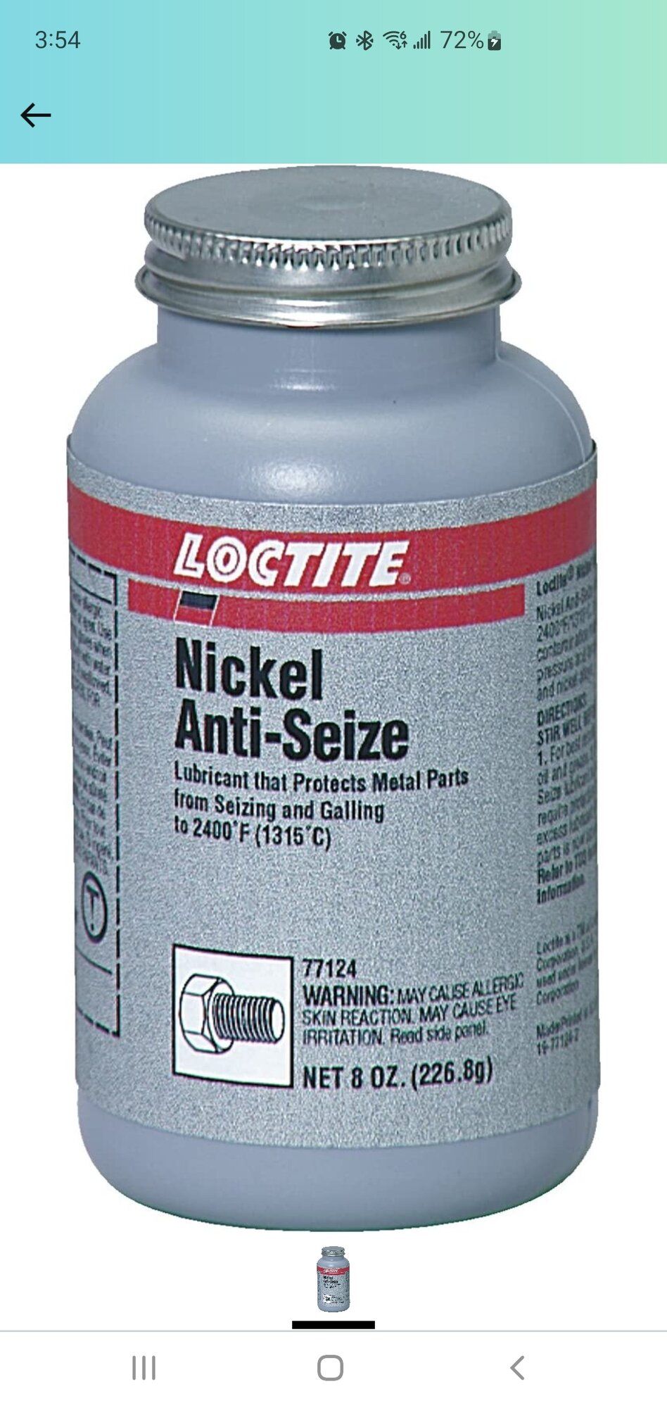

Meant Nickel, had been using zinc stuff all day at work so that’s what was on my mind, zinc antiseize is definitely not what you want to use there. As far as the housing goes it’s a td05 turbine wheel, direct change over.

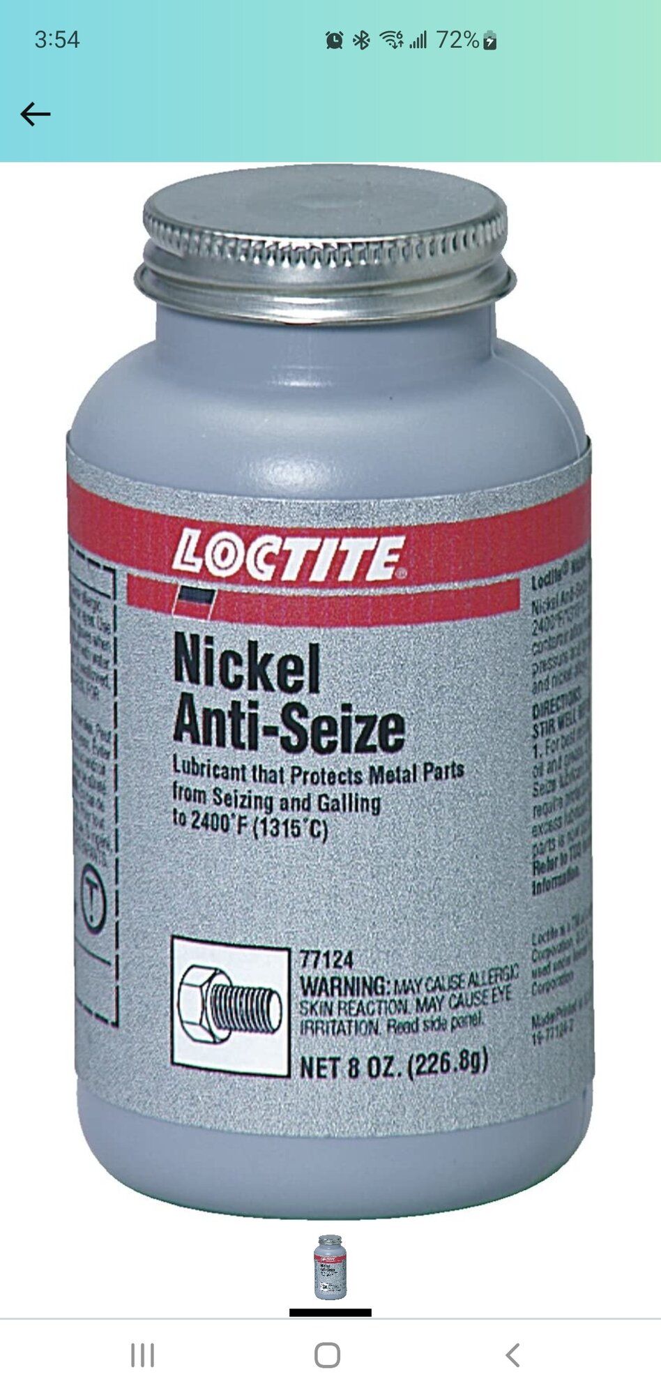

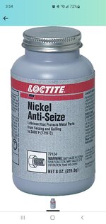

Exactly.
This stuff.

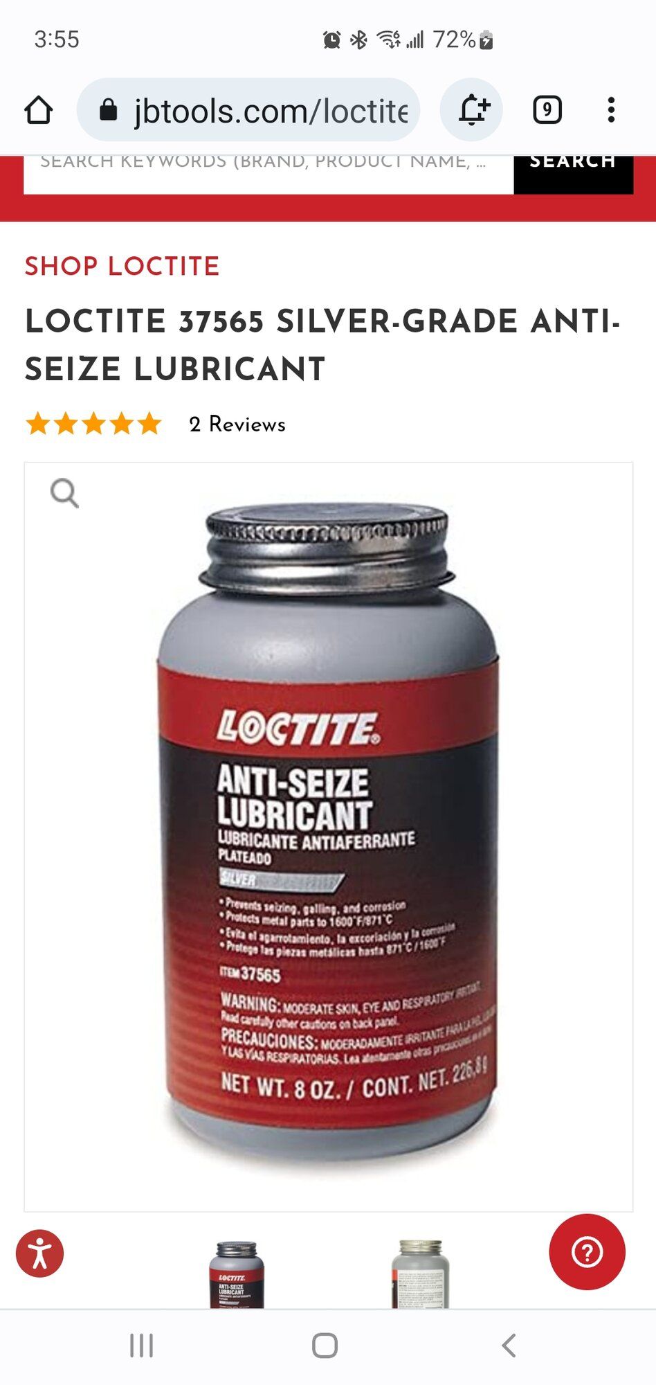

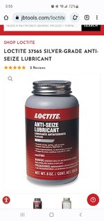

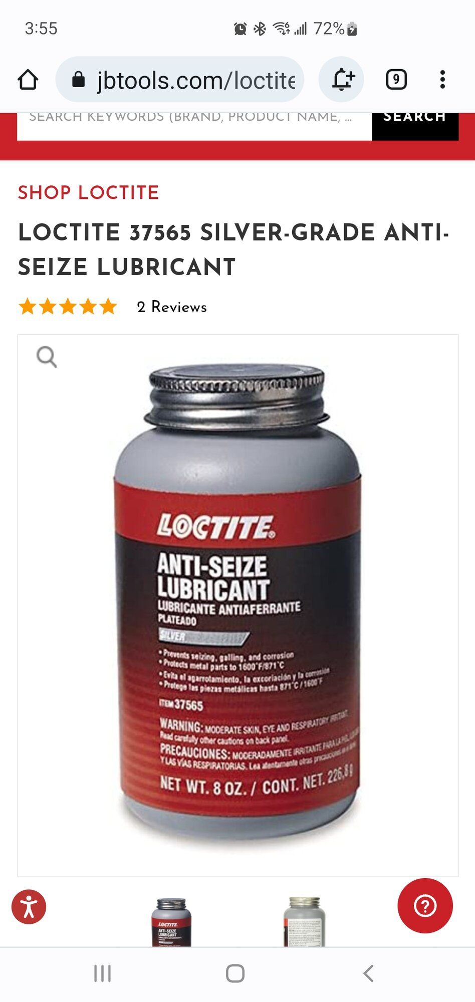

Not this.
You like the nickel? I feel like I’ve had better luck with copper but that’s on steam systems that don’t get anywhere near exhaust temps. So my experience may not be relevant to such high temps.
Yes. The copper won't cut it on a turbo bolt. Silver either. Look at the temp limits. You don't have to buy a jar of it. I did because I'm lazy and that's what I found.
They have something that's called like "nuclear proof" antiseize as well that I've used in the past on the ARP turbo to manifold bolts, and they were awesome. It's such potent stuff it stayed in the housings threads for like 8-12 years in the elements, and was still there when the new owner of the turbine housing got the turbo housing from me. Lol. It's a high temp anti-seize with a radiation/nuclear symbol on the front of it, is about all I can remember. It worked amazing.

I feel obligated to say it again. That antiseize wont cut it. May as well not use it. I know firsthand. Use the nickel.
