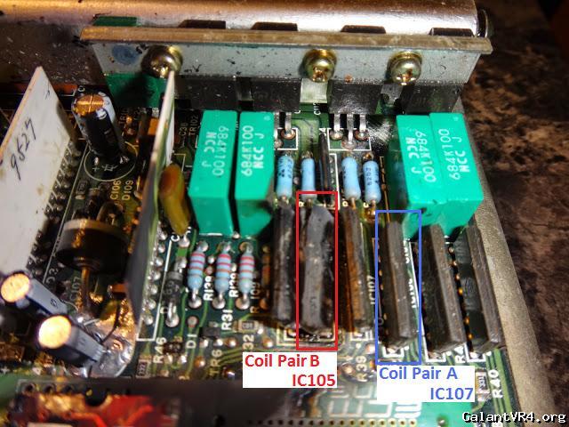

Coil Pair A
-When looking into the ISC, coil pair A is pins 1, 2 and 3.
-ISC Pin 2 is ground for coil pair A
-ISC Pin 1 is a coil and goes to ECU pin 58
-ISC Pin 3 is a coil and goes to ECU pin 59
-IC107 is the ECU driver that will blow if coil pair A is bad.
Coil Pair B
-When looking into the ISC, coil pair B is pins 4, 5 and 6.
-ISC Pin 5 is ground for coil pair A
-ISC Pin 4 is a coil and goes to ECU pin 68
-ISC Pin 6 is a coil and goes to ECU pin 67
-IC105 is the ECU driver that will blow if coil pair B is bad.
Would appear that coil pair A is bad in my case. IC107. I will verify this weekend. It was way too cold today to try doing anything on the car.
