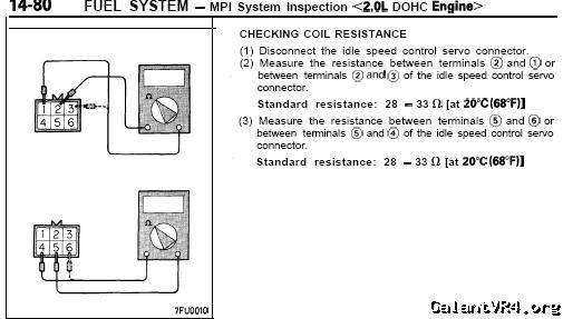

Blown ISC driver, which means the ISC is either bad, or going bad.

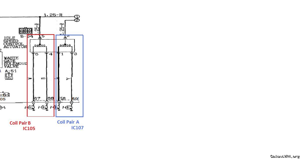

I had an issue much like this a short time ago. I'd like to explain a little bit about how to correlate which ECU driver is responsible for running which ISC coil (this is for a 1G ECU). I had to cross reference a wiring schematic because this is not clearly spelled out in any one place, so hopefully this saves someone the trouble in the future.

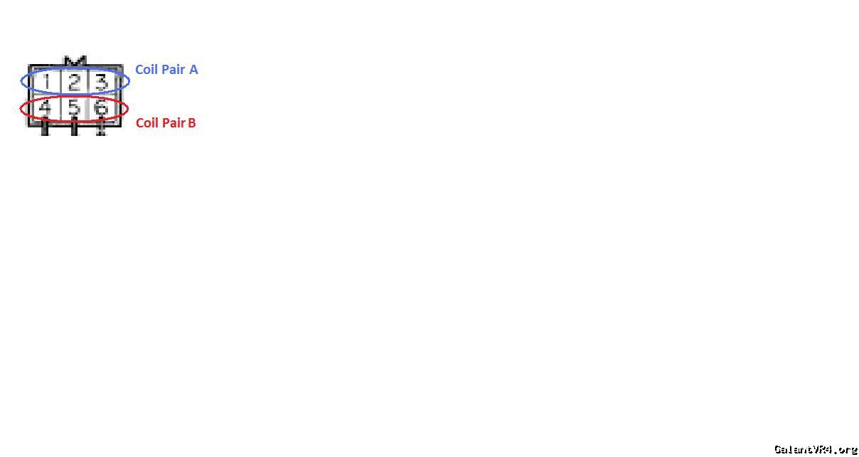

The ISC has 2 coils. They are referred to as coil pair A, and coil pair B.
Coil Pair A
-When looking into the ISC, coil pair A is pins 1, 2 and 3.
-ISC Pin 2 is ground for coil pair A
-ISC Pin 1 is a coil and goes to ECU pin 58
-ISC Pin 3 is a coil and goes to ECU pin 59
-IC107 is the ECU driver that will blow if coil pair A is bad.
Coil Pair B
-When looking into the ISC, coil pair B is pins 4, 5 and 6.
-ISC Pin 5 is ground for coil pair A
-ISC Pin 4 is a coil and goes to ECU pin 68
-ISC Pin 6 is a coil and goes to ECU pin 67
-IC105 is the ECU driver that will blow if coil pair B is bad.
