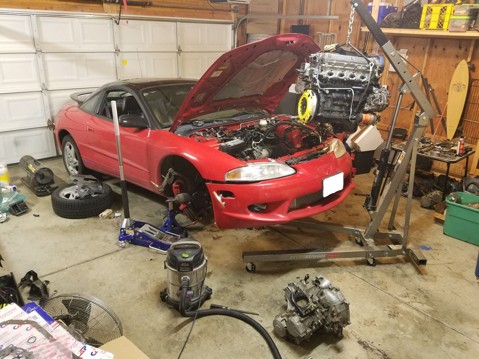

Red talon build

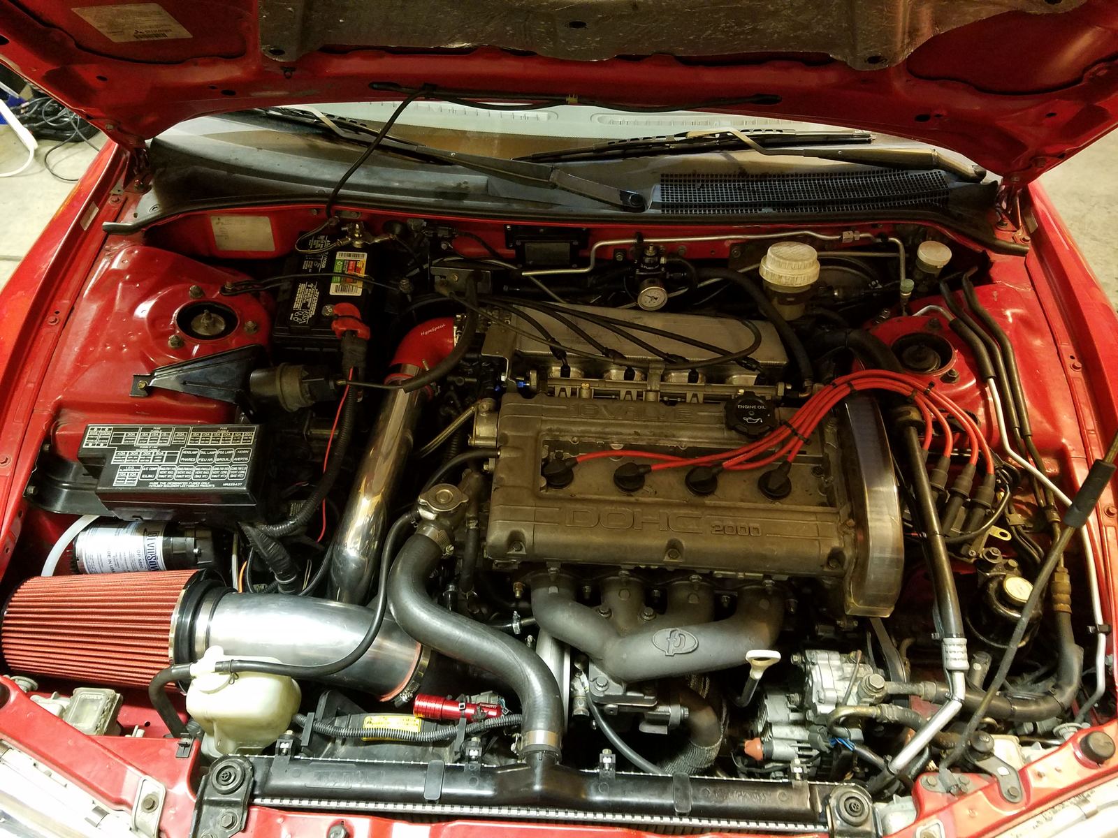

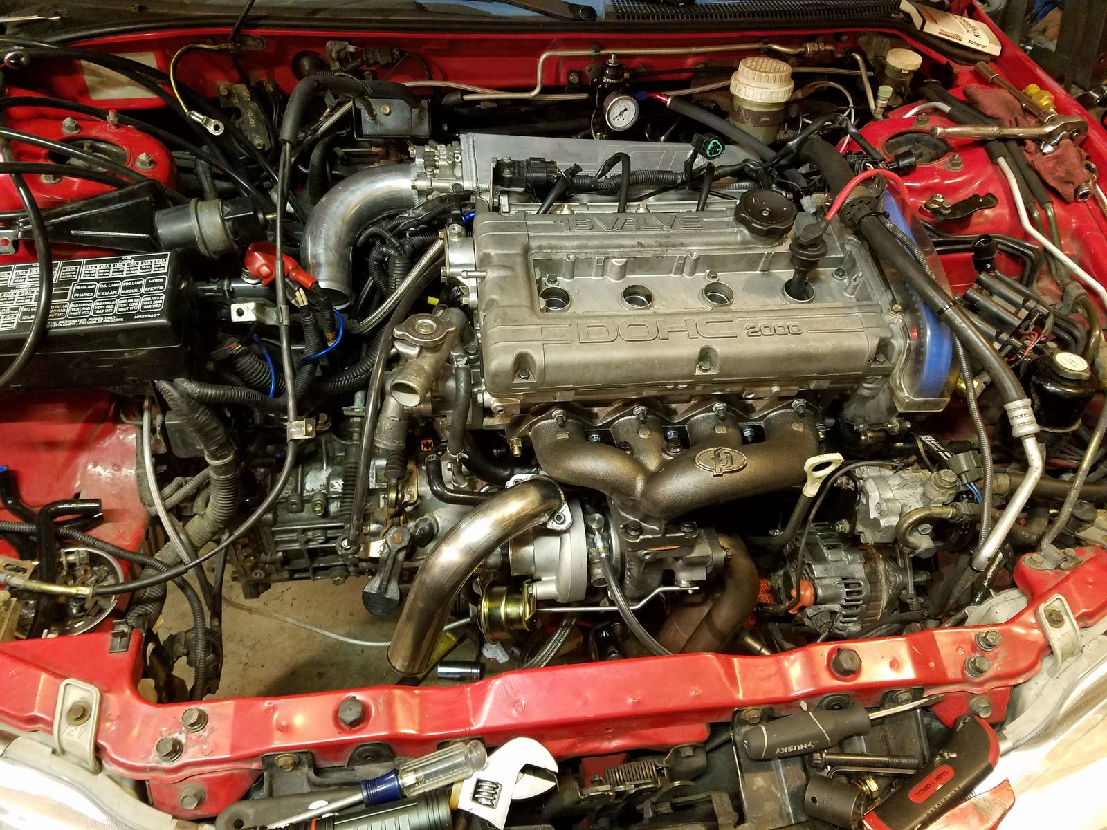

Break in is done and I started tuning. Had little over 8 degrees of knock retard that I couldn't get rid of past 5500 rpm. I had to pull 5 degrees of timing to clear it up. 11.0:1 AFR

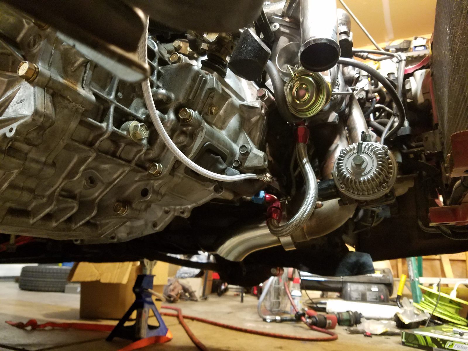

Found that dumping the exhaust under the oil pan was actually causing the knock sensor to trigger. I was also having issues controlling boost. With the HKS 40mm external wastegate (16 psi spring) and the boost line connected directly to the turbo. It would hit about 14 psi at 5000 rpm, then creep to 29 psi by 7500 rpm and hold 29.5 to 9000.
Reconnecting the exhaust resolved both issues. I added the timing back in, now using stock timing tables. Boost holds at 14psi to redline.

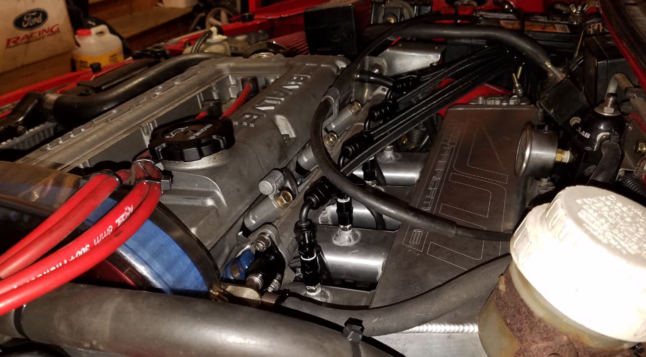

Installed hallman MBC, turned boost up to 30 lbs, turned methanol pump on after 3800 rpms, after every pull, the car would go down to about 400 rpms and want to die unless I held the throttle open for about 10 seconds. This is my first time tuning direct port methanol and I think my jets are too big for their location. I started out using a d04 nozzle (440ml/min) in each runner from devils own. Methanol is controlled by dsmlink.
I swapped the d04 nozzles to d02 nozzles (320ml/min) which completely resolved the sputtering after WOT. Turned boost to 35.5psi. 2 degrees of knock, pulled 1 degree of timing. no knock at 35.5 psi.

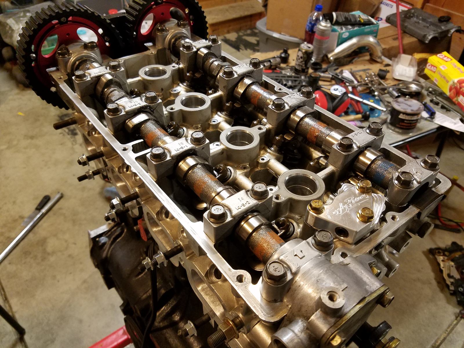

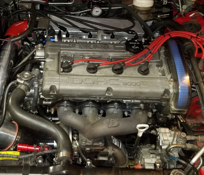

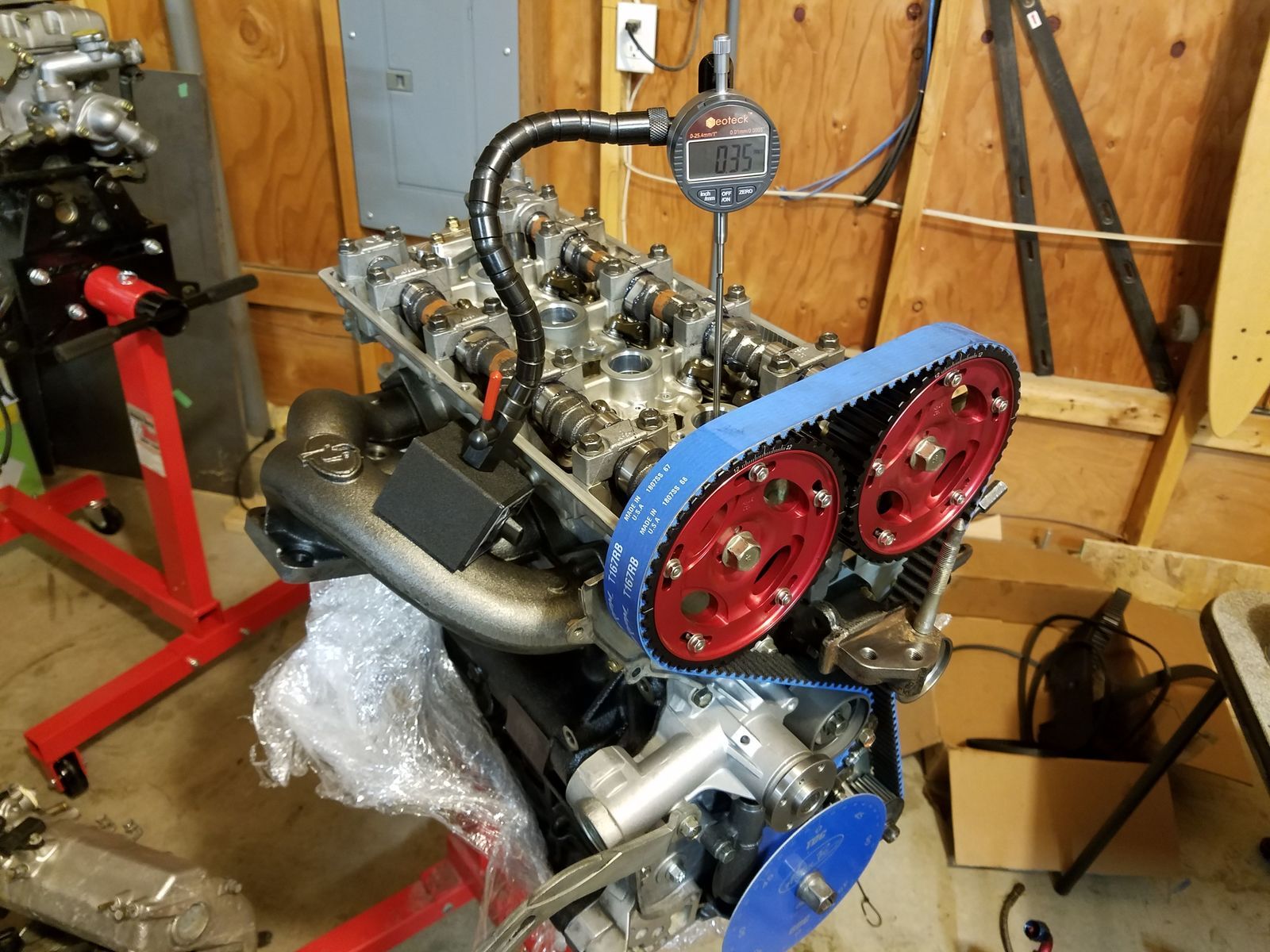

My cams might be too small for what I am trying to do, I dont think it can breathe well past 8300 rpms. I originally went with GSC S1 cams and a 68hta. I used the 68 hta during break in, but never had the opportunity to get into boost with it. Swapped it to an fp red at the 1200 mile mark.

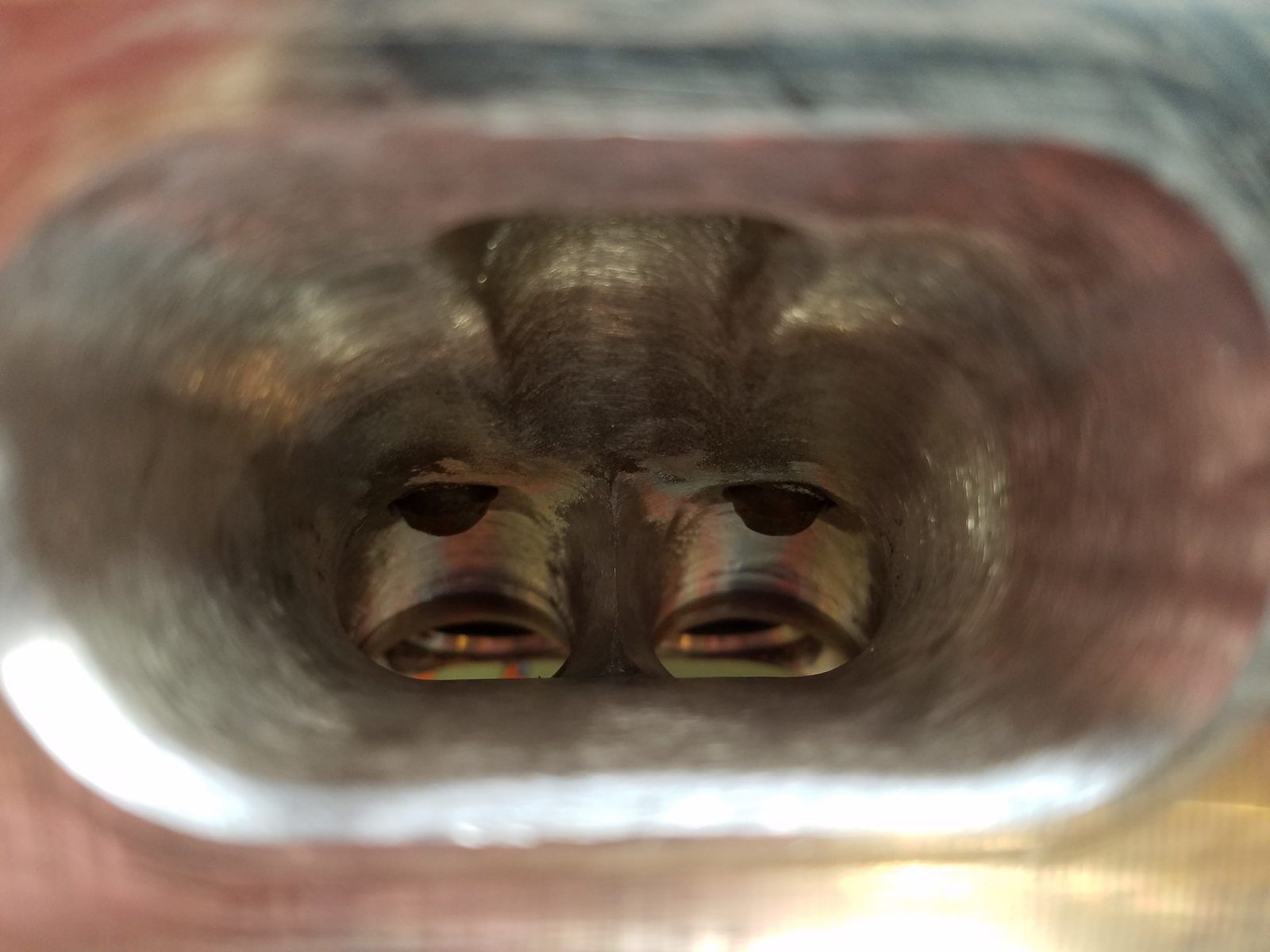

I want to try to get into the 40psi range, but 37 lbs seems to be my limit with my current methanol setup, and larger injectors in the runners seems to cause issues with pooling on the intake valves. The methanol calculator on their site suggests that I need their DO14 sized nozzle (1200ml/min) in order to run 40psi to 9000 rpm. With the 4 d02 nozzles at 320ml/min each, I am at 1280ml/min. I don't have access to e85, so hopefully others who also dont have access to e85 will find this part helpful.
calculator here: http://www.alcohol-injection.com/en/
I might try adding an additional do4 nozzle further down the upper IC pipe to see if I can squeeze myself into the 40psi range. This would allow additional time for the extra meth to dissipate into the intake charge instead of pooling on top of the intake valves. I am running 92 pump gas and -25 degree blue window washer fluid from walmart. I might try increasing the methanol content of my mixture prior to adding an additional jet. It's also 50 degrees out right now, so I might need the additional jet during summer anyway.

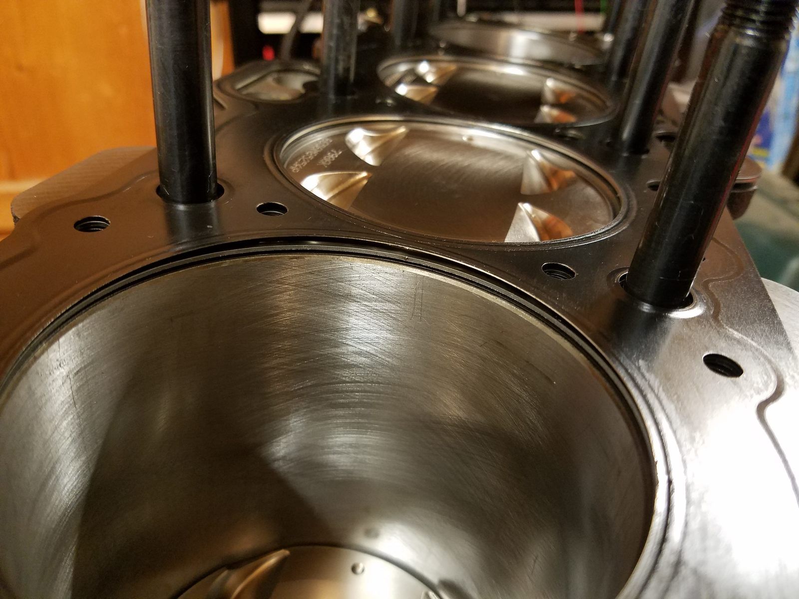

This is on 9.7:1 compression ratio pistons as well. Top ring gap at .021, 2nd ring gap at .024

Removed the hallman MBC on the bottom port of the wastegate and installed an EBC. Installed a bleeder type (XS MBC) onto the top port of the external wastegate to raise base spring to 22 lbs. Since it's gotten hotter, I had to lower the boost to 35psi and reduce timing under WOT to 14 degrees. I experimented with running washer fluid, 50/50, 75/25, and 100% meth.
