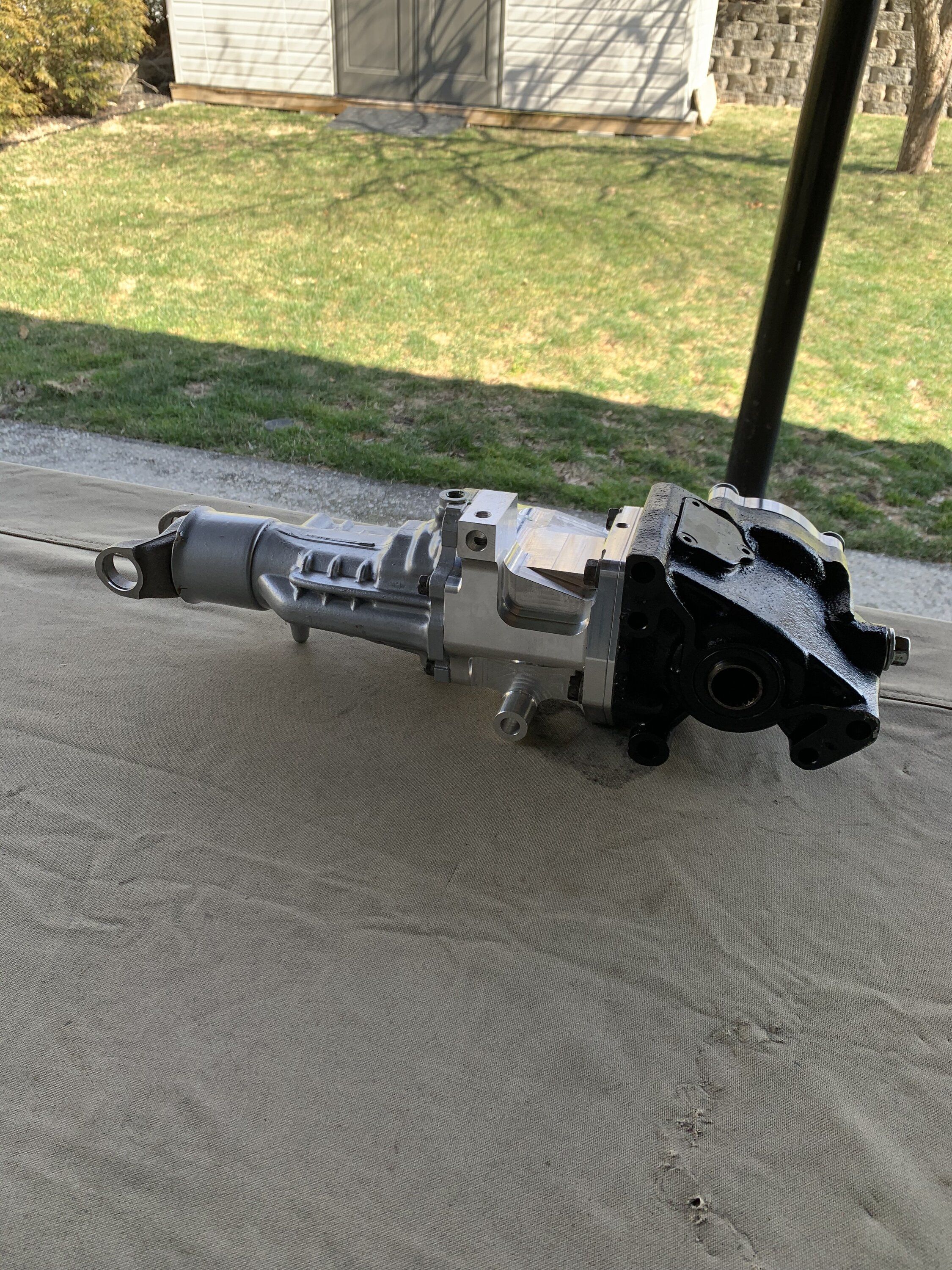

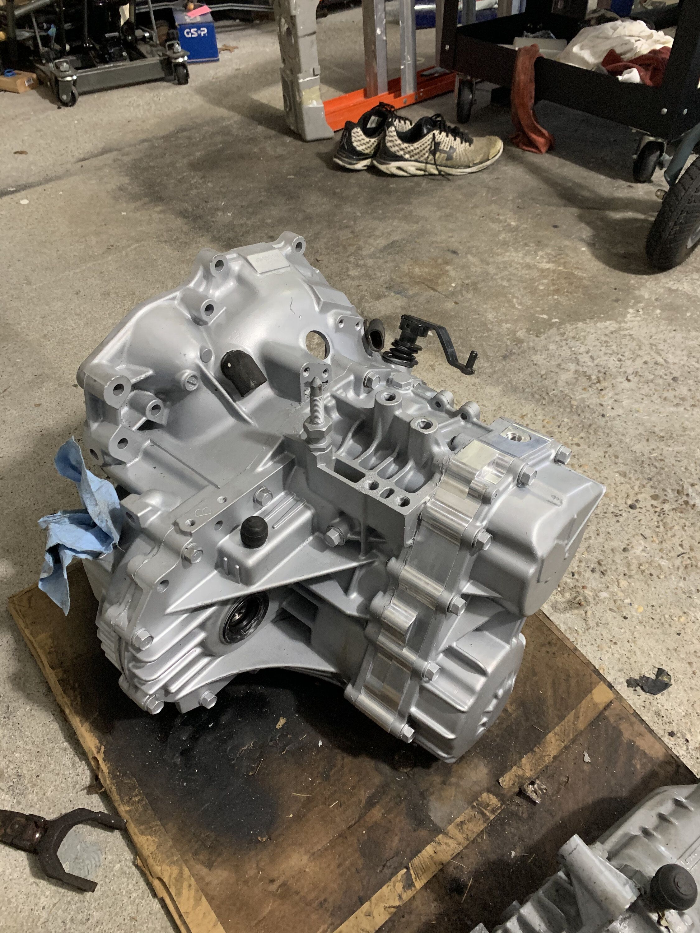

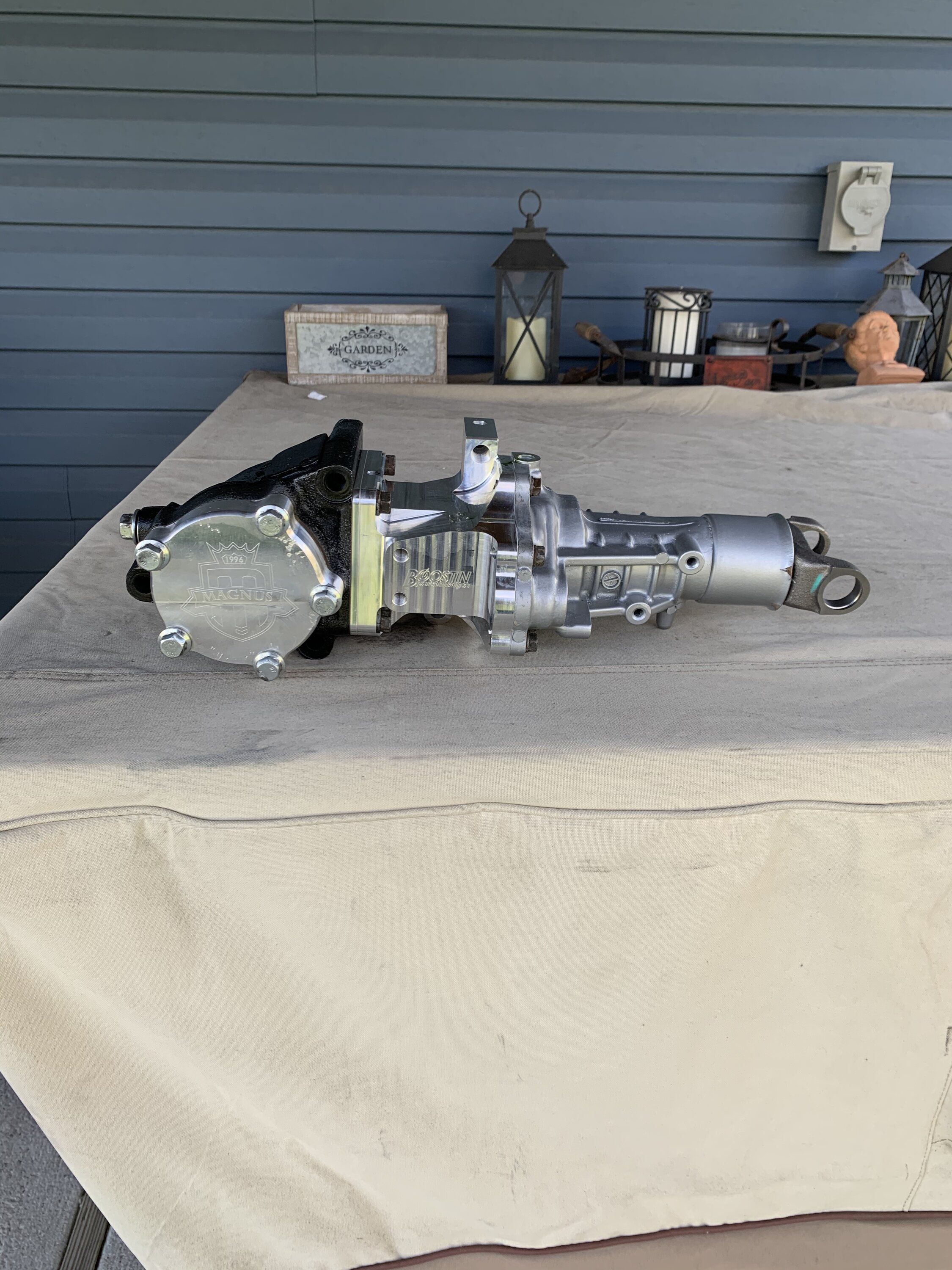

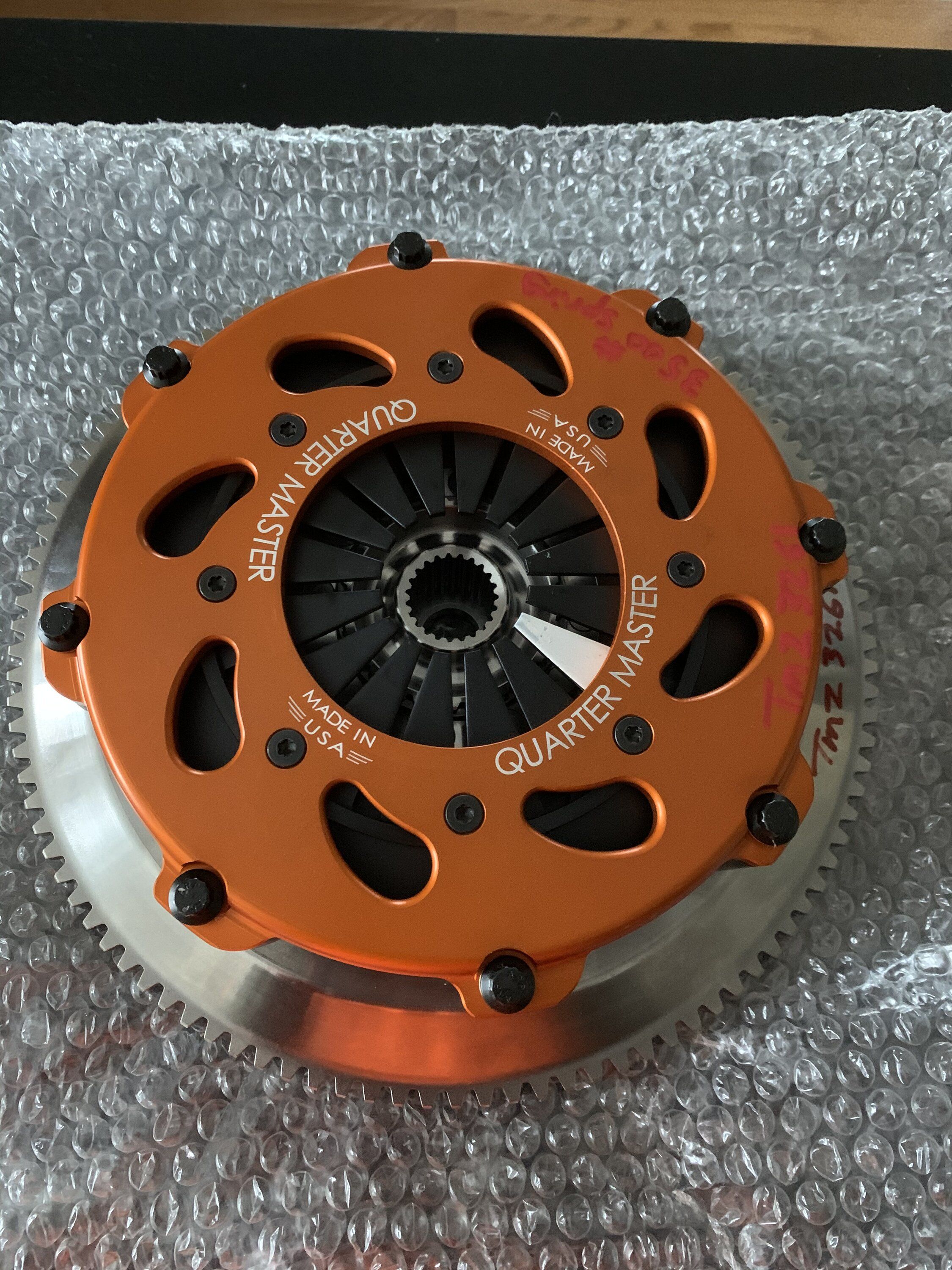

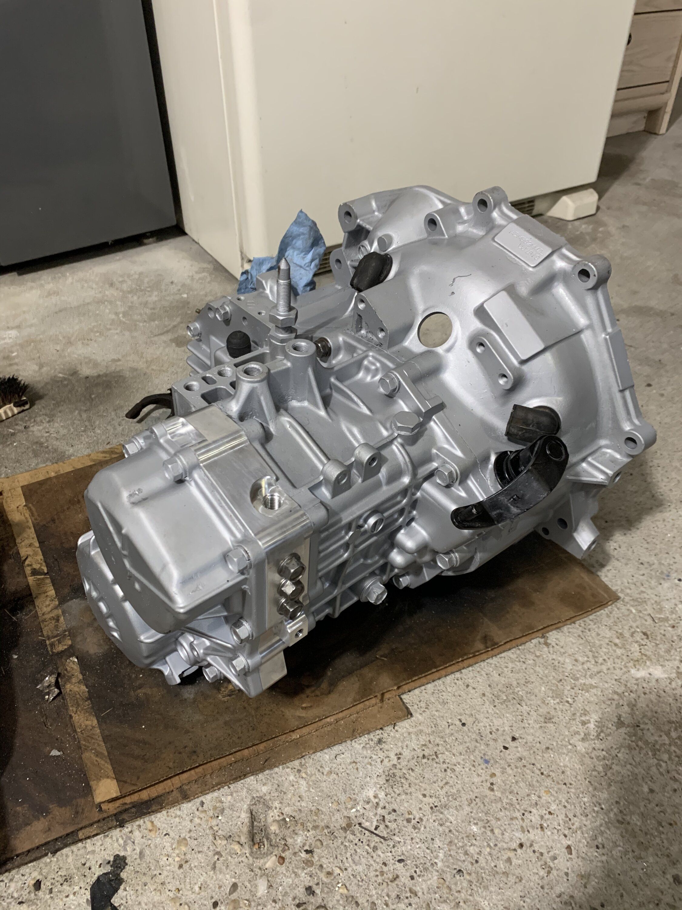

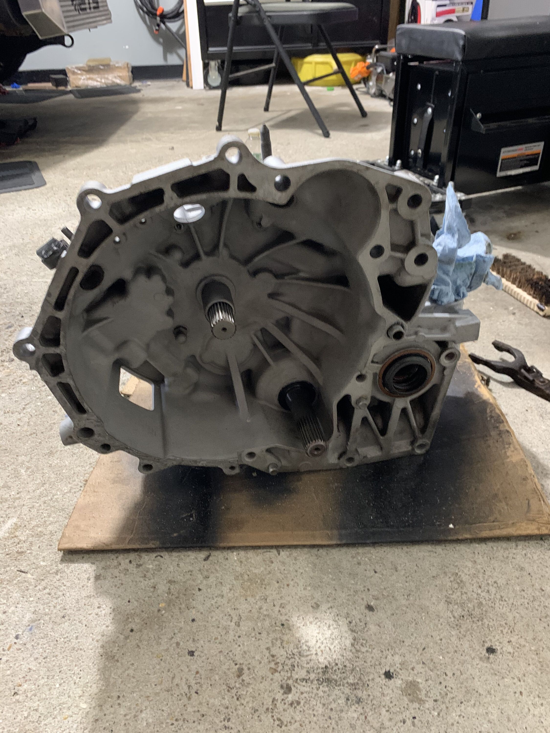

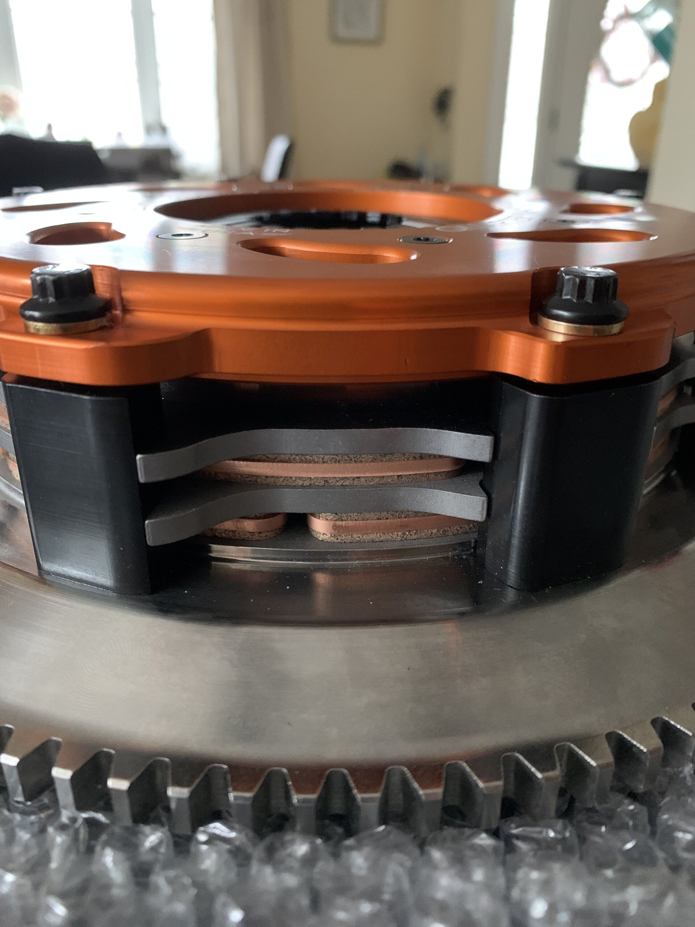

Cool, thanks. I was wondering who had built your dog box? I tried contacting a few shops in Jersey and they didn't really deal with 2g's. I figured I'd see what my local options were before having to ship the trans out. I was looking to run the same twin disc clutch kit, which I believe it does have to be out of an Evo 1-3, due to the PPG gears, right?

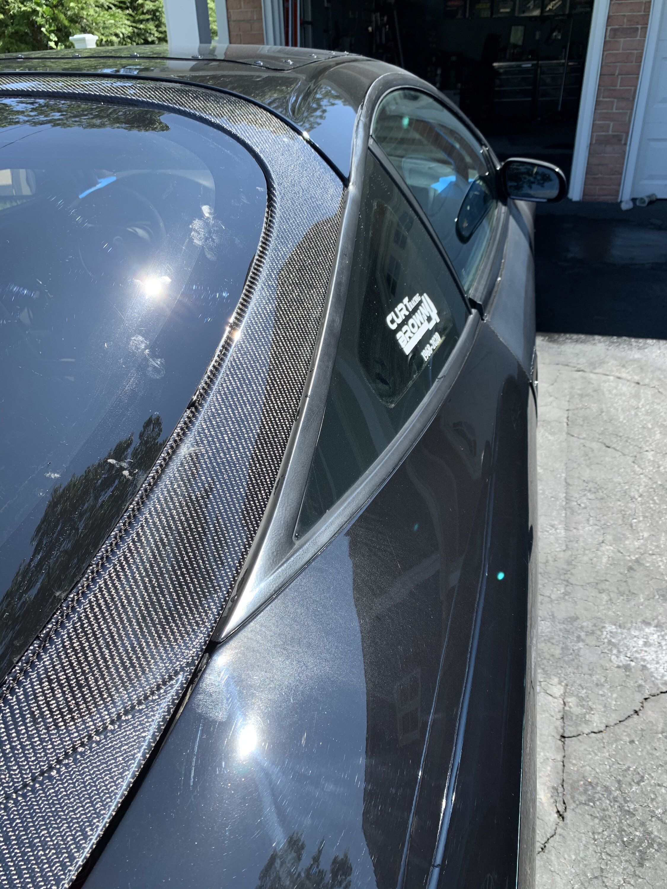

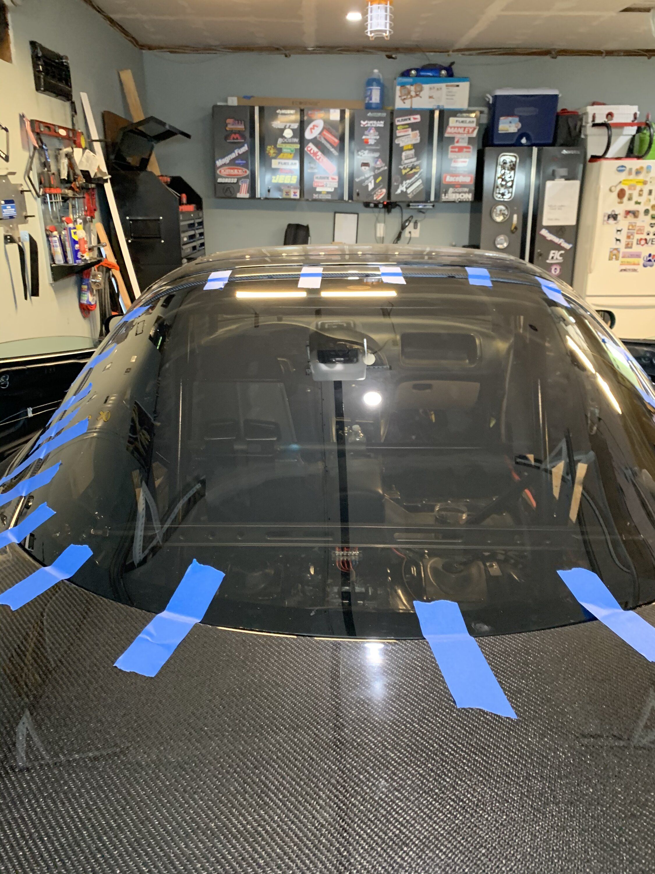

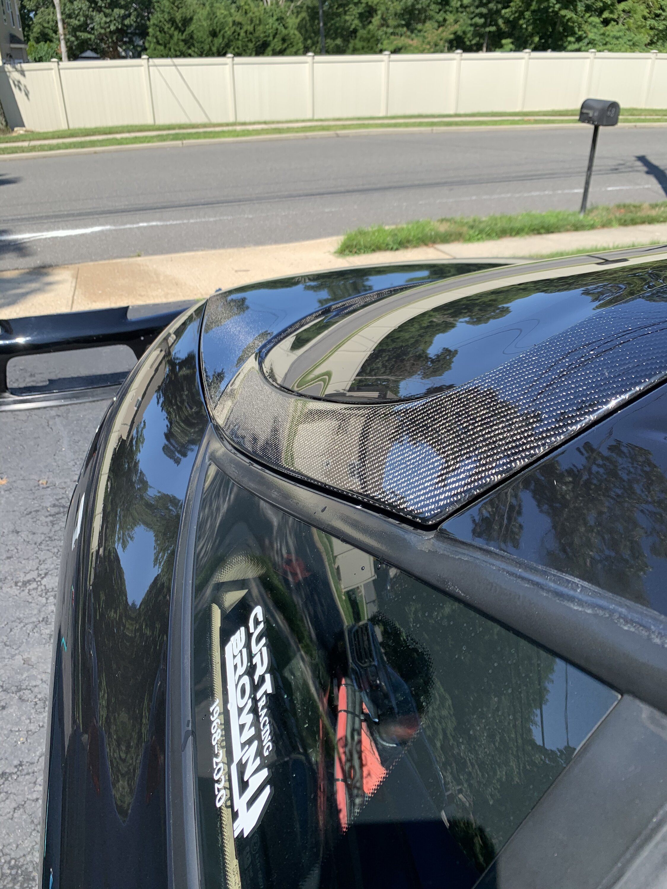

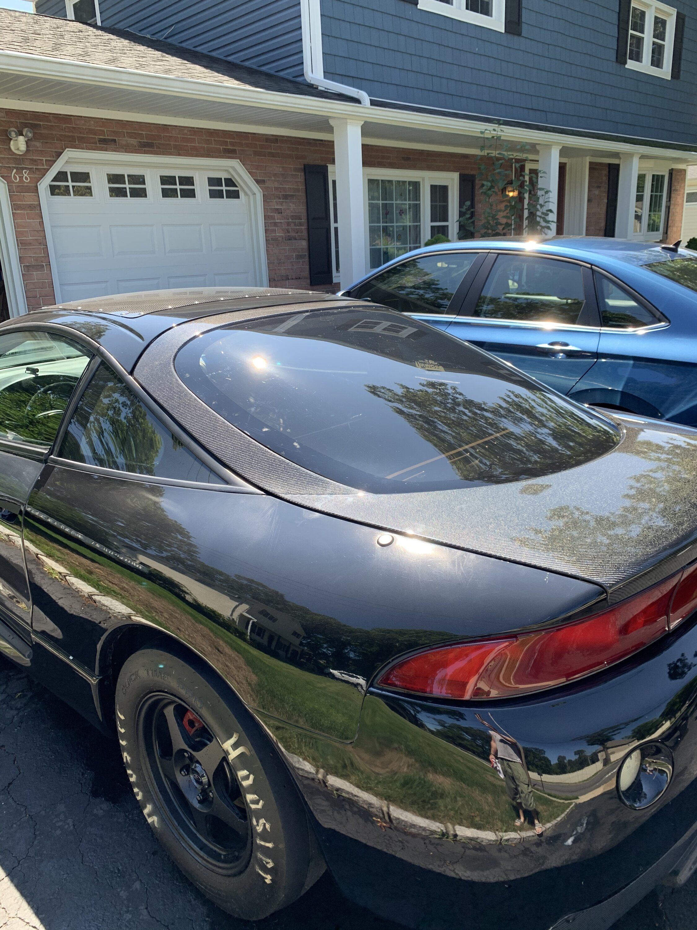

Where did you get your lexan rear window from?

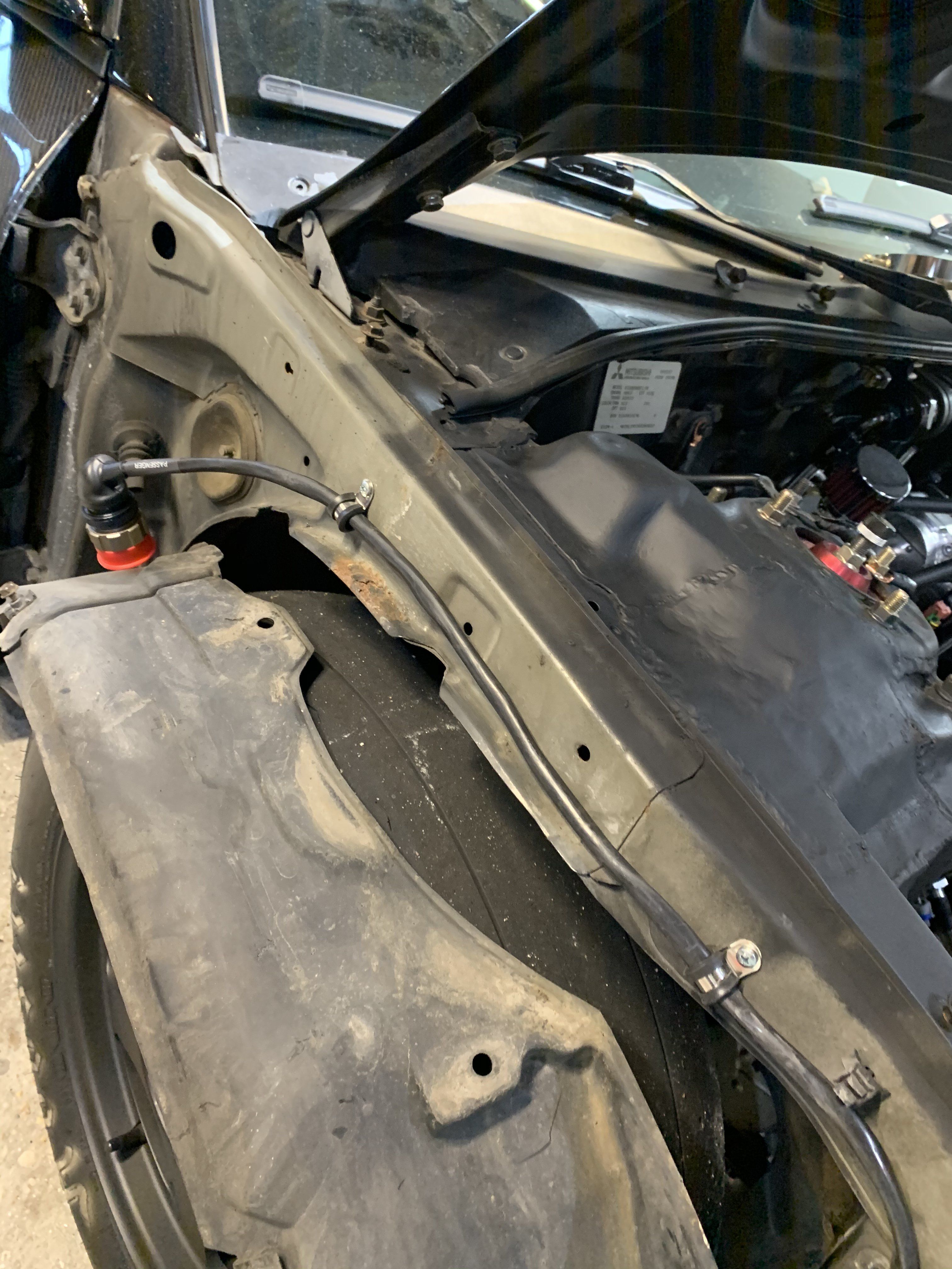

What's your opinion on the Ohm engine and fuse harnesses quality? I'm thinking of getting at least the engine harness. I'm also tempted to get the fuse box harness as well, but the options add up quickly and they seem to be the only option when it comes to custom harnesses for the 2g and honestly I haven't heard of them until my 2g build got serious. I was more familiar with Rywire and Chasebays.
Rrt in Connecticut built my dogbox. I supplied the ppg and a few of the parts and they did everything else.
The twin disc I got from tmz performance. They sell it for a ppg in a 2g. I'm pretty sure it's meant for an evo 8 and with a 7 bolt flywheel. It wasn't cheap but he sets everything up and tells you everything you need to make it work.
The lexan came from a company in Europe that someone on dsm tuners got the hook up with. There's a post here from about a year ago with the info. I'd have to search a little to find it. Defenitly worth the price and the wait.
The ohm harness and fuse box relocation was worth every penny. Really nice quality, great customer service and had no issues installing it. The car started right up after installing it. Everything is labeled really nice and if you have any questions they get back to you with answers very quickly.
Thanks for all the info. How long was it for them to build the trans? I'm going to look into that shop if I can't find one locally. Are you running PPG 5th gear, as well, or just sticking with the OEM one? I'm not sure what route to go on with the 5th gear yet.
I supplied most of the parts so it was pretty quick. It was about 3 weeks for them to finish it. I'm running the oem 5th just because I don't drive the car on the street and I don't shift into 5th in the 1/4 mile

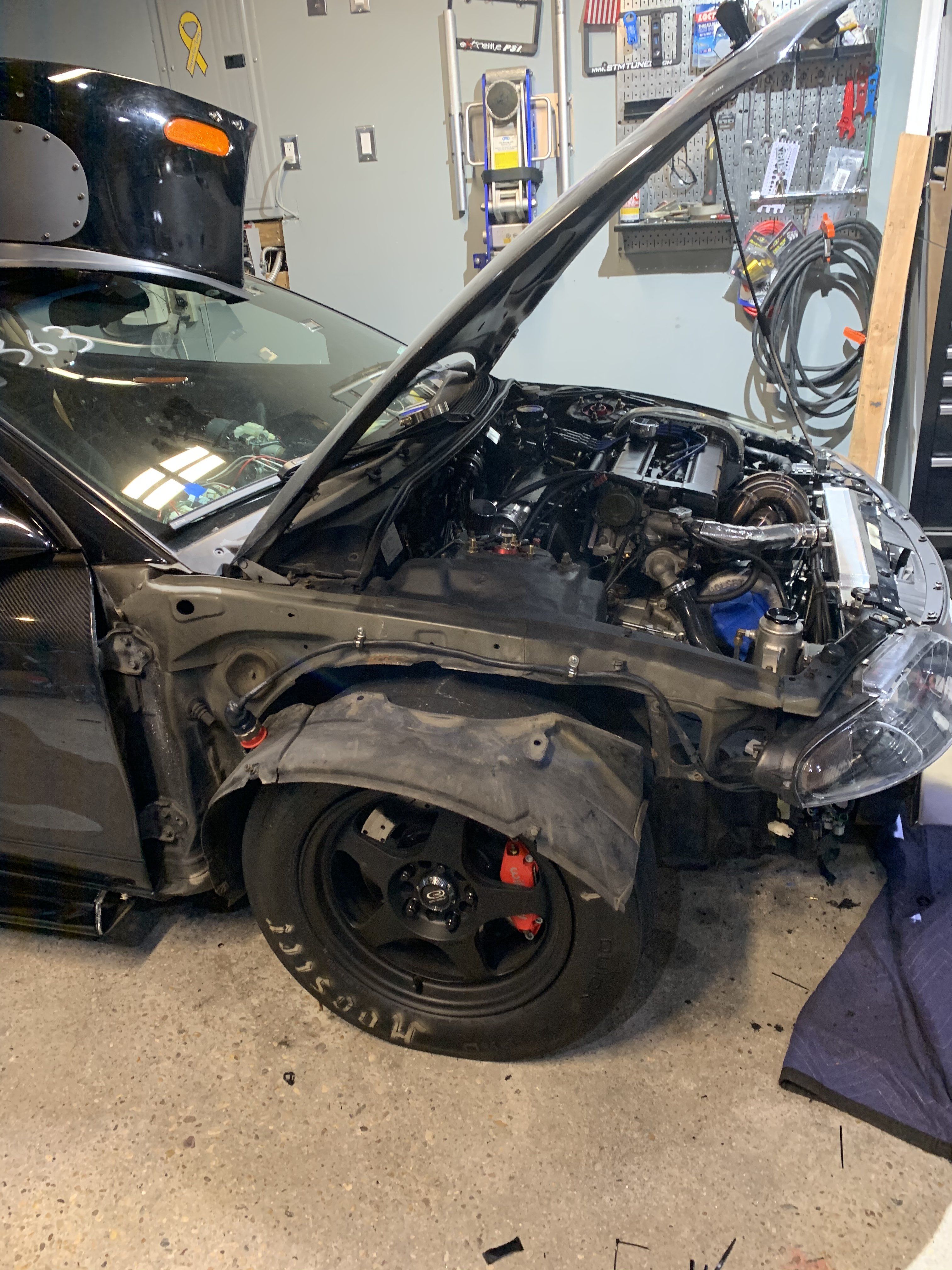

Haven't updated this for a while.
After last season at the track I was trapping close to 135mph so I had to let off the throttle early to avoid getting kicked out for not having a cage.
My last trip to the track I ran a 10.8 letting off at the 1000' mark so I knew I needed a cage.

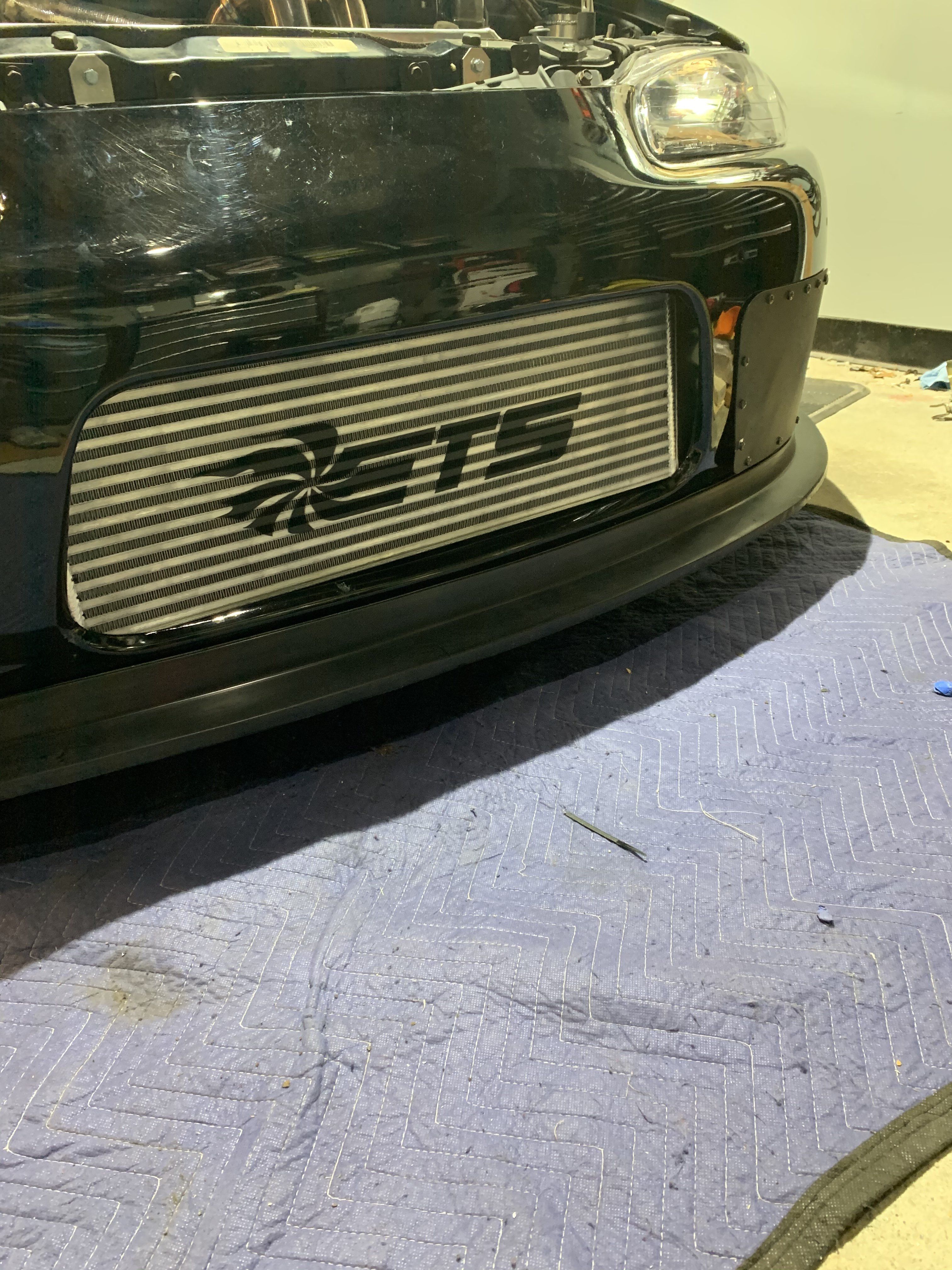

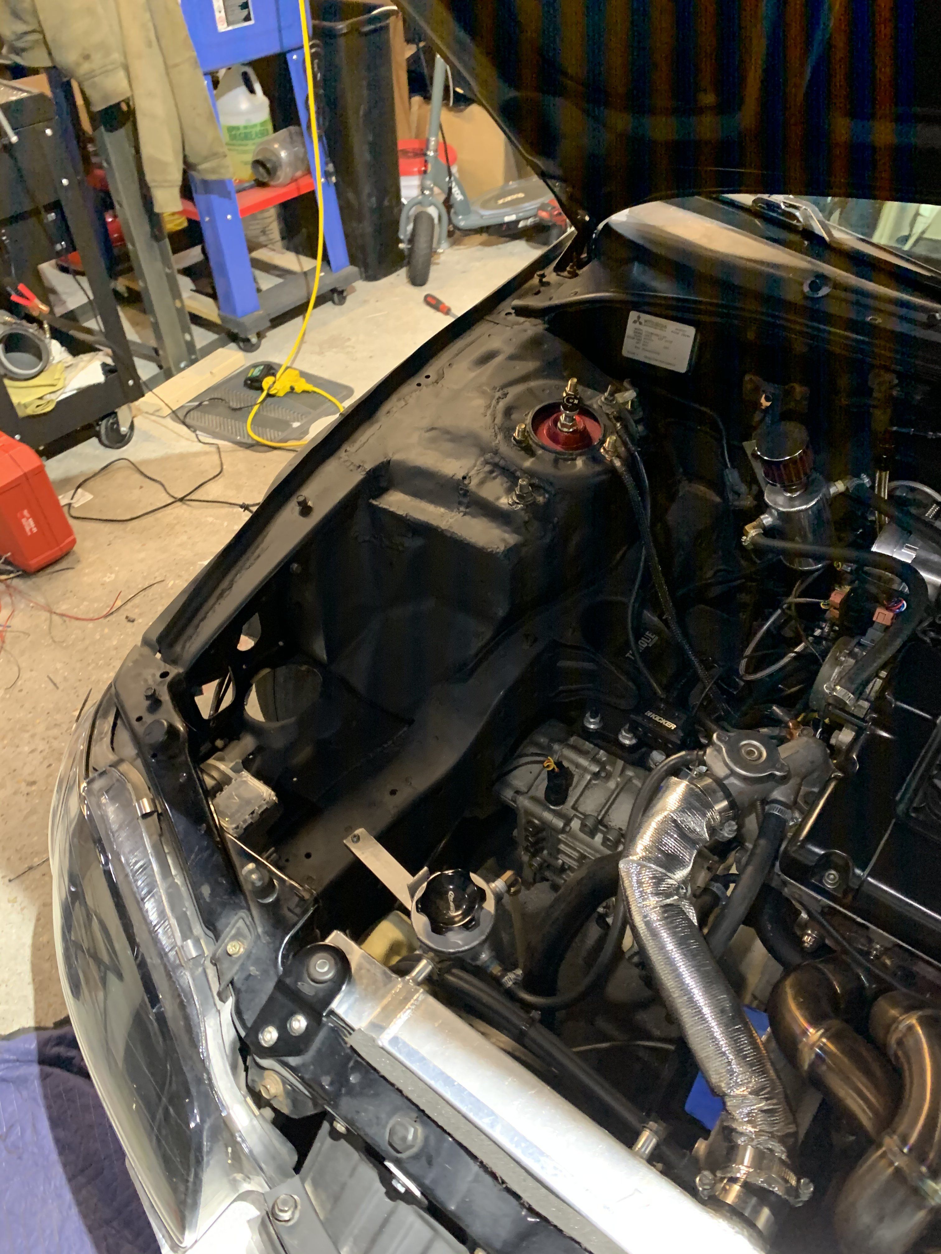

So first I ordered a 4" ets fmic

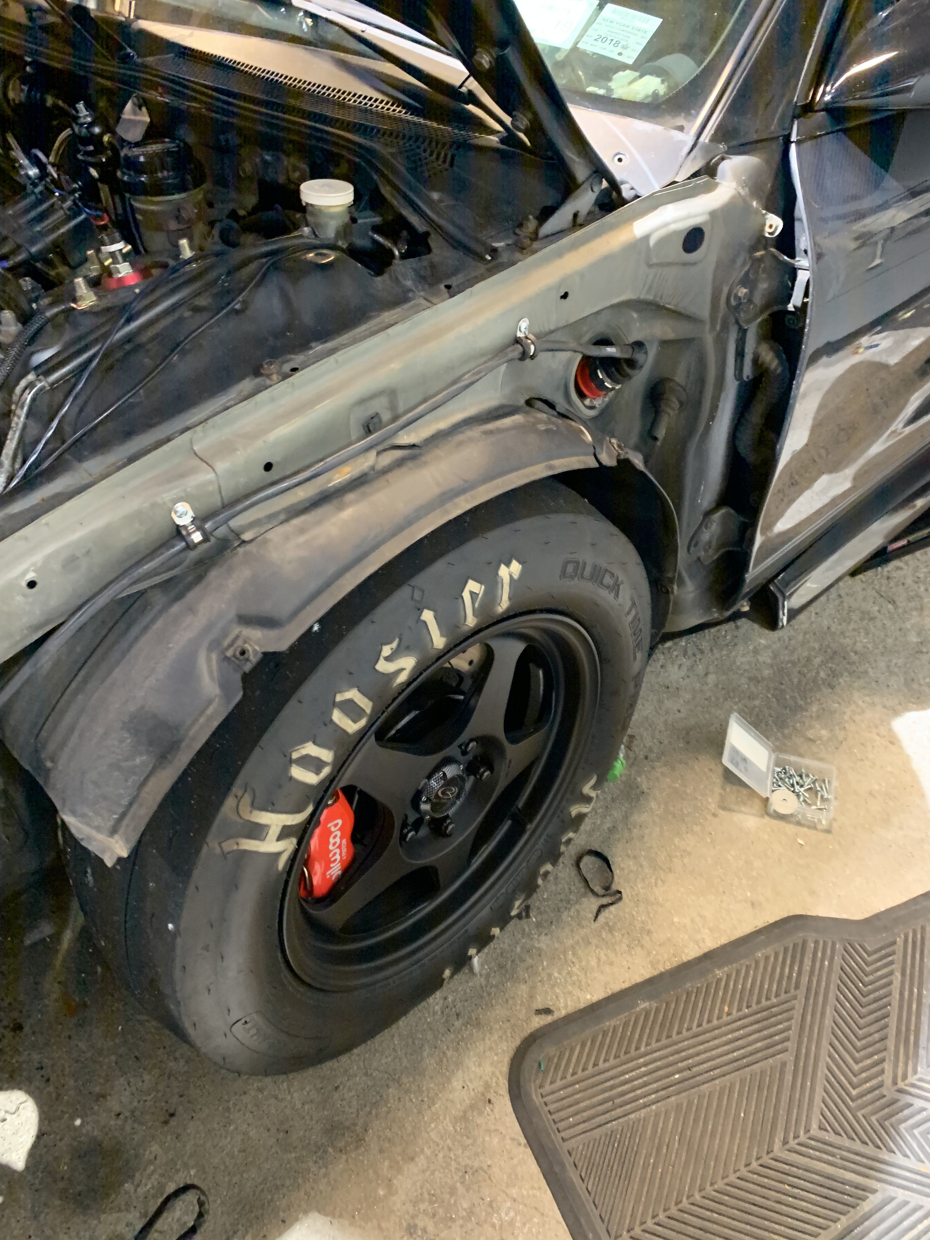

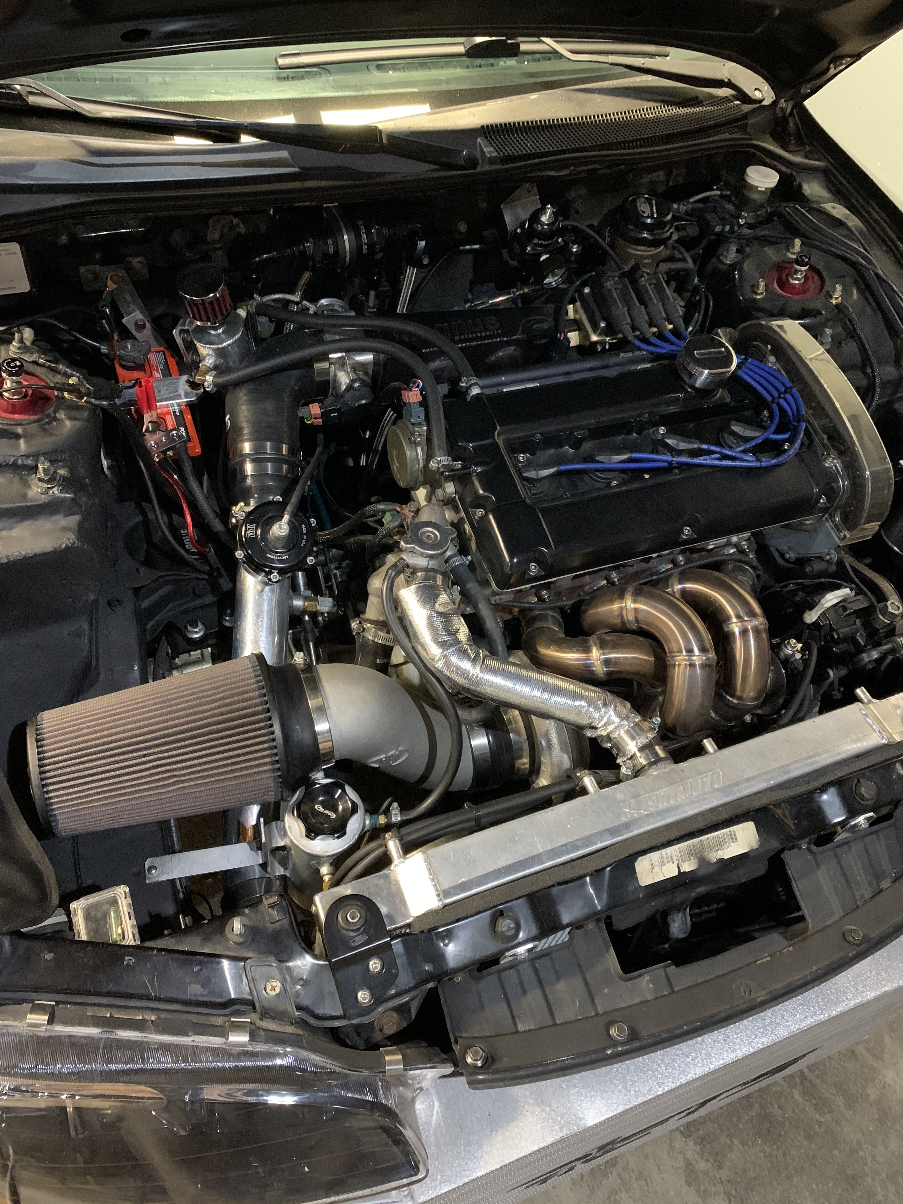

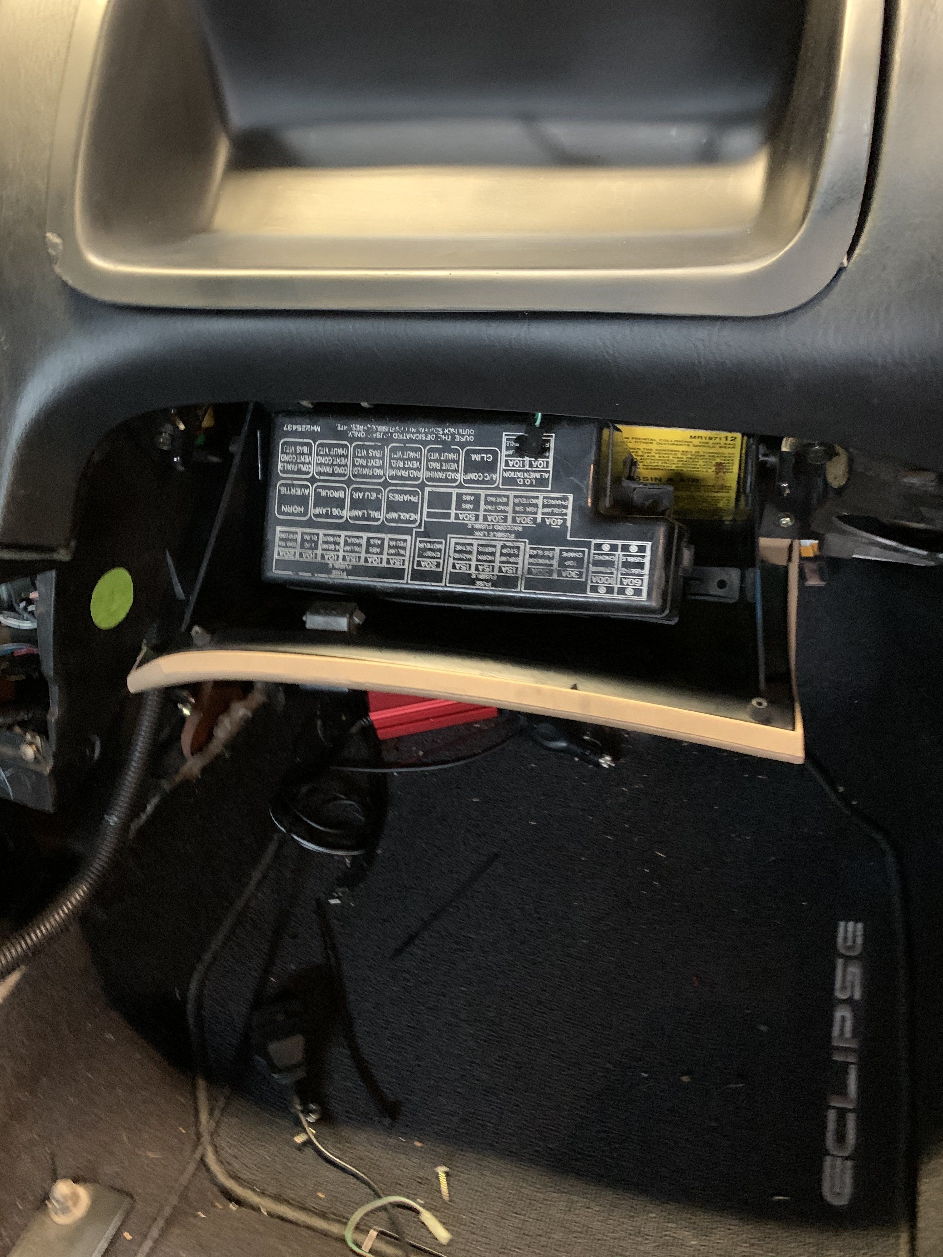

Then I ordered a new engine wiring harness and fuse box relocation from ohm racingView attachment 592188View attachment 592189View attachment 592190View attachment 592191View attachment 592192View attachment 592193View attachment 592194
How hard was the fuse box relocation install?

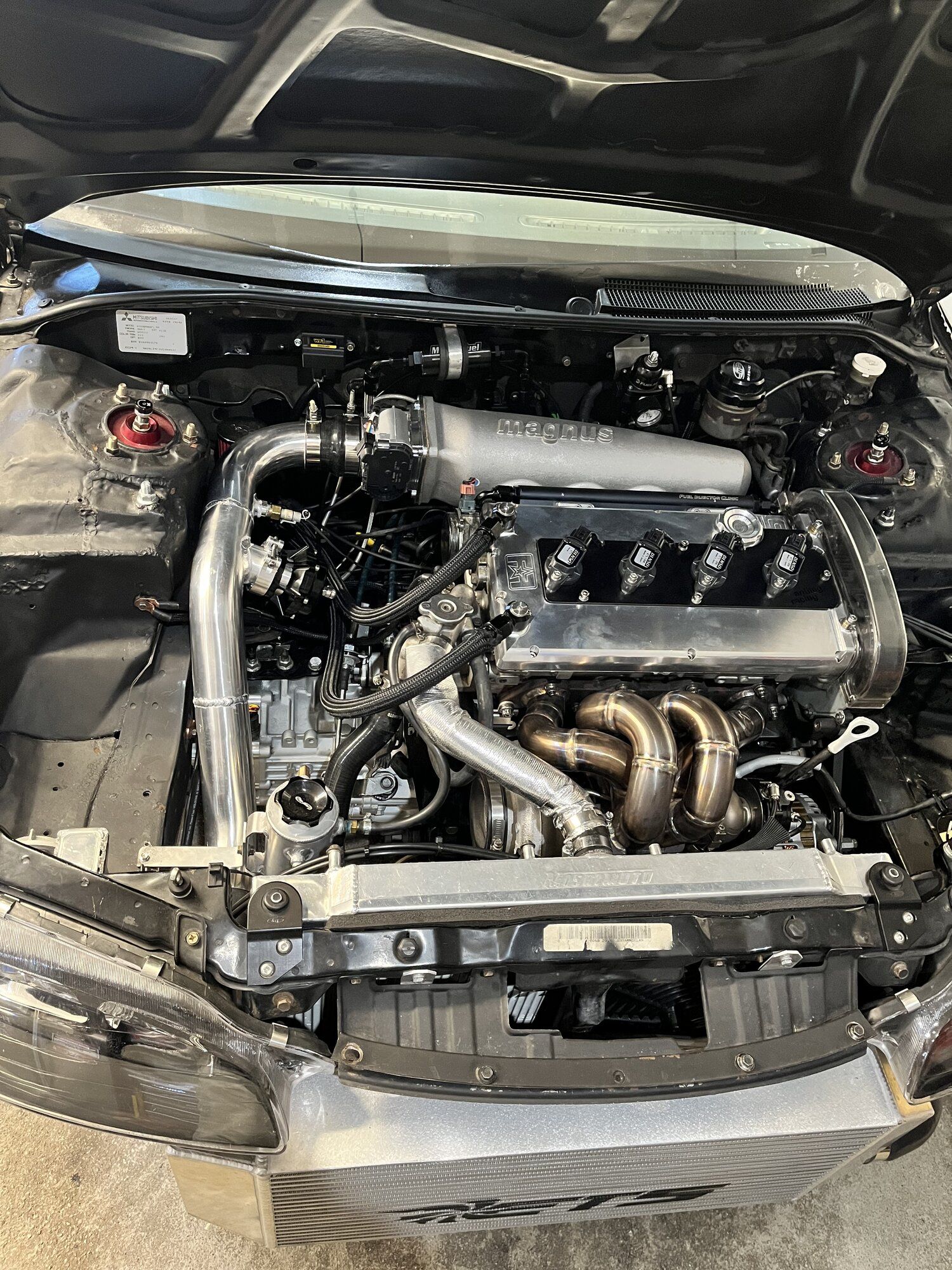

Did a little upgrading over the winter

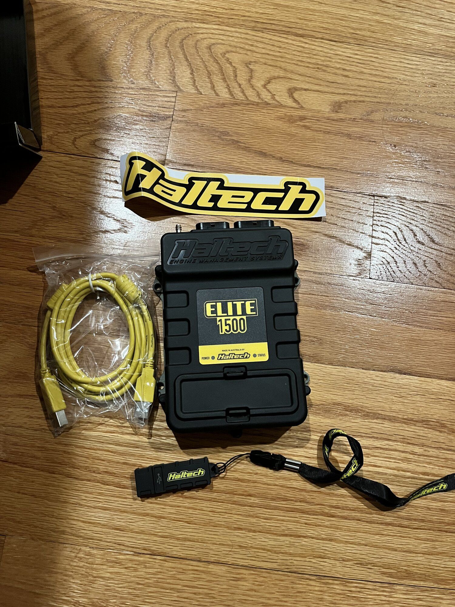

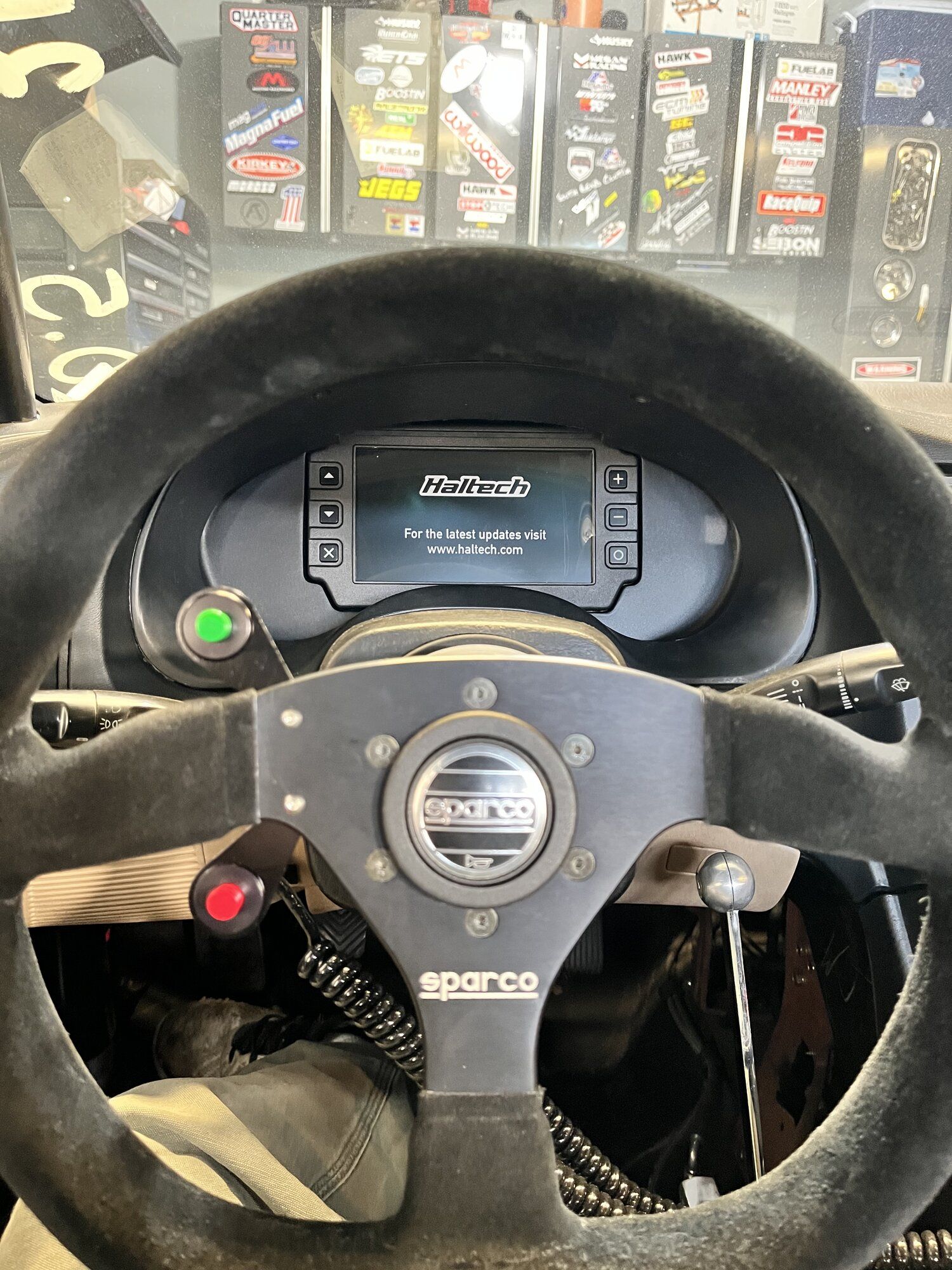

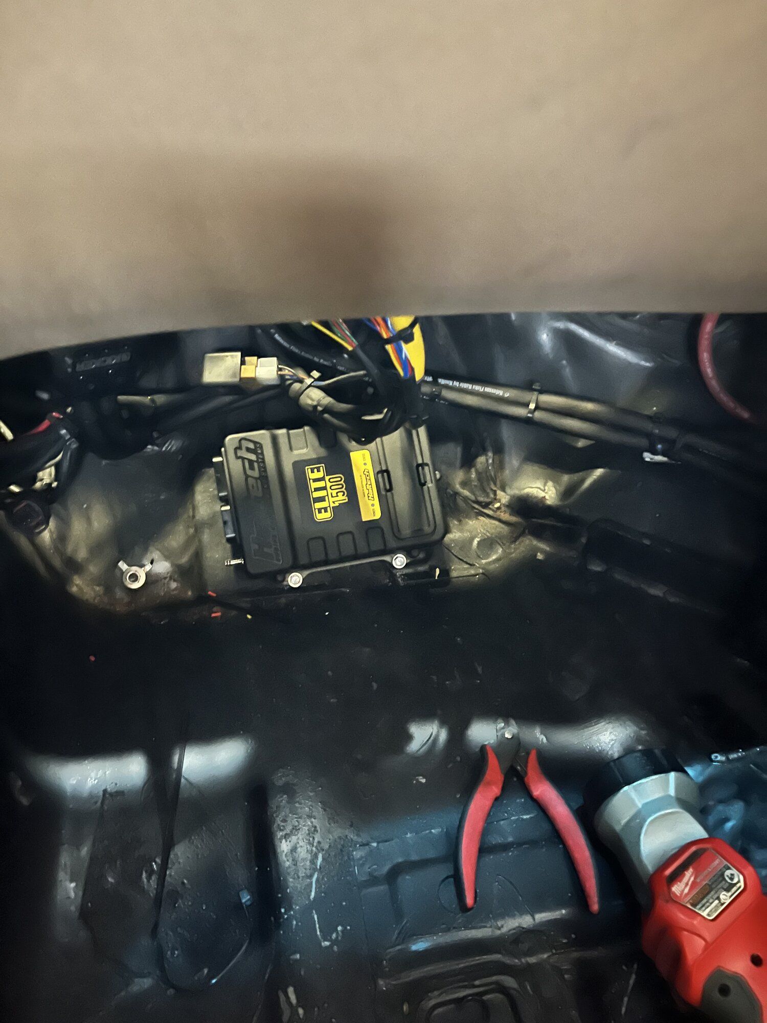

Haltech elite 1500 with a bosch 68mm DBW throttle body
Kiggly 12 tooth crank trigger
Magnus intake manifold and a haltech IC-7 dash
Question. I am using a Haltech 2500 Elite. Also going DBW. What Pedal did you go with?
