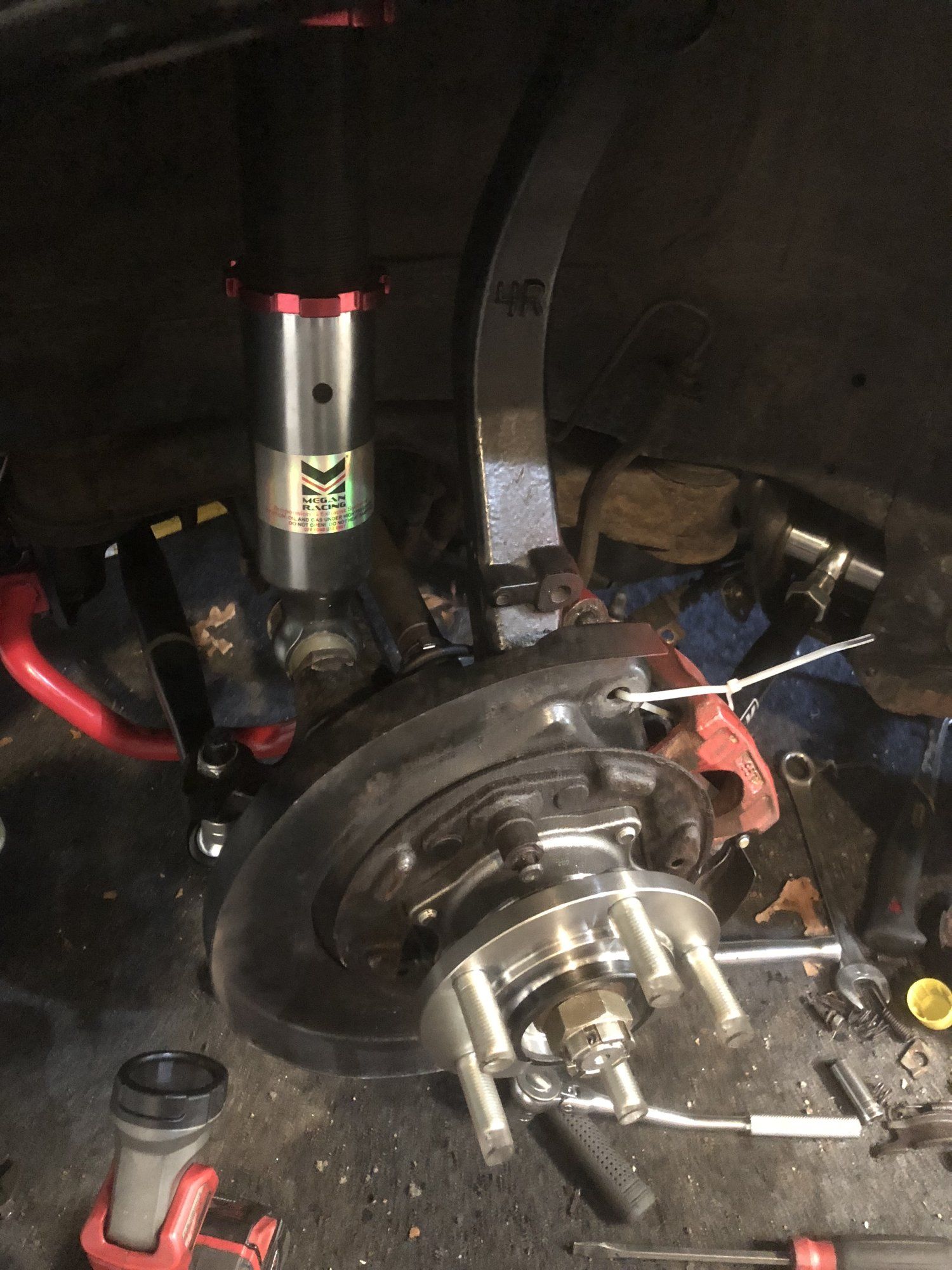

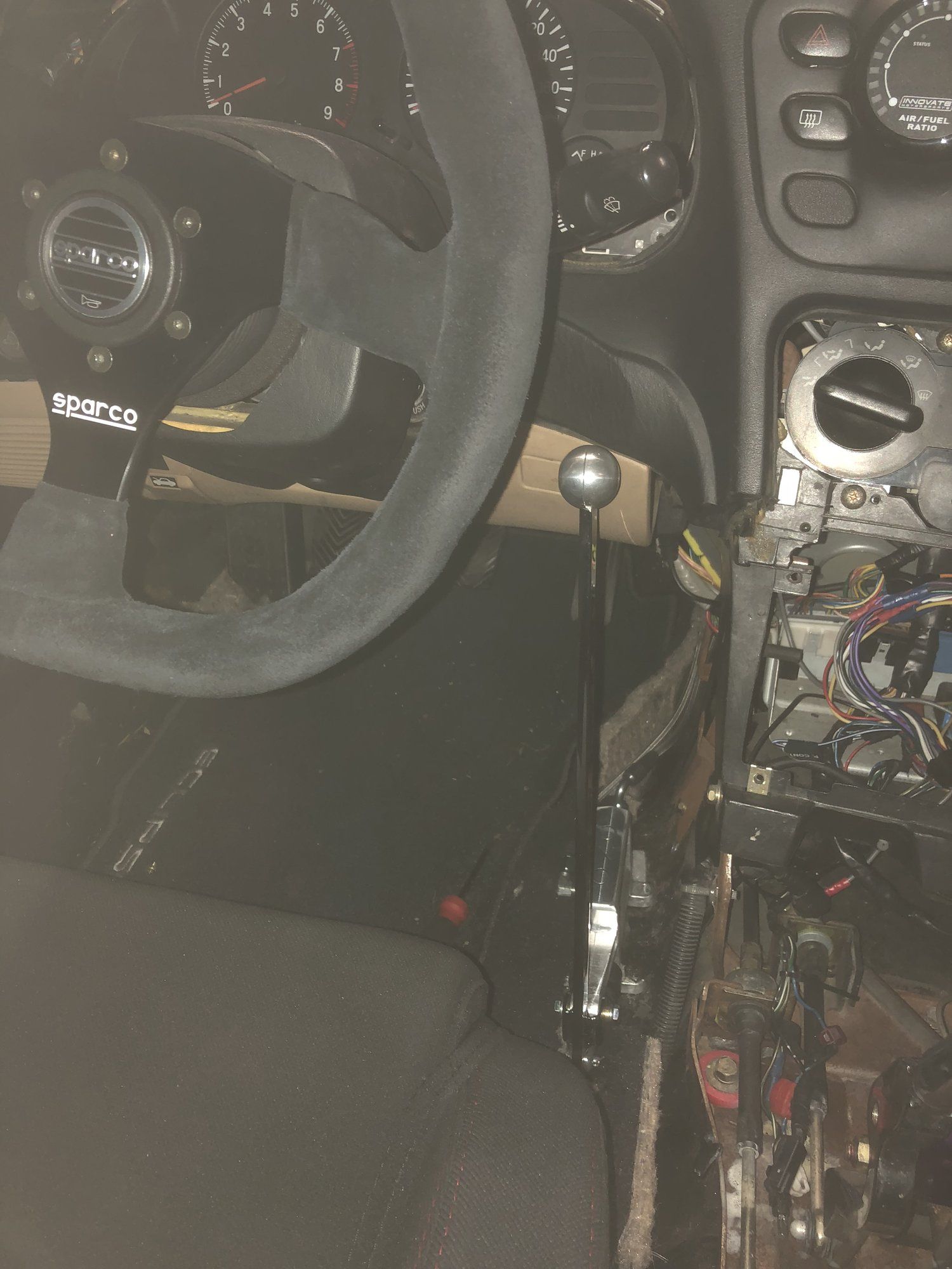

So after using the Ebrake last time out I decided to install a staging brake to try to get a little better 60ft time.
I mounted it on the drivers side on the flat spot and plumbed it to hold the passenger front and drivers rear brake.
I'll try to test it out July 1st on the next test and tune event

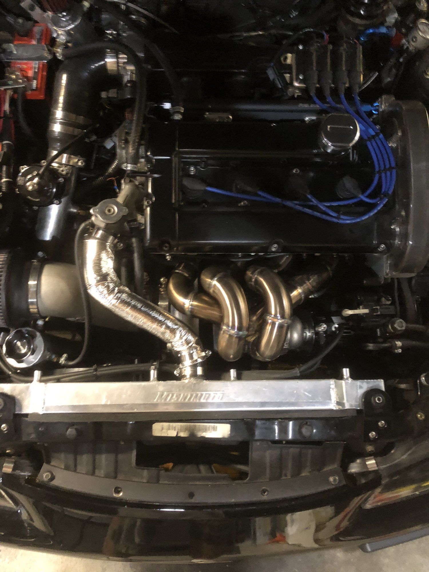

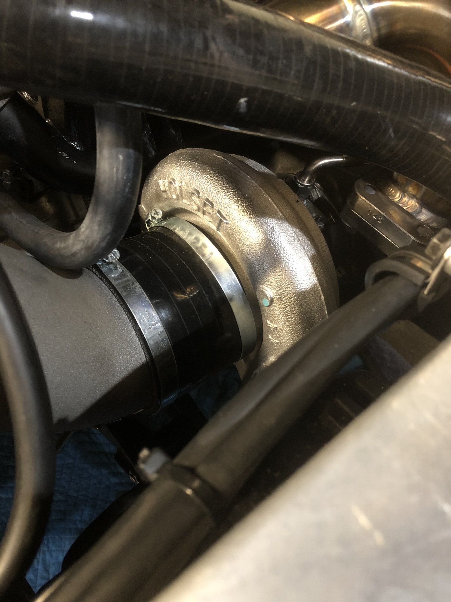

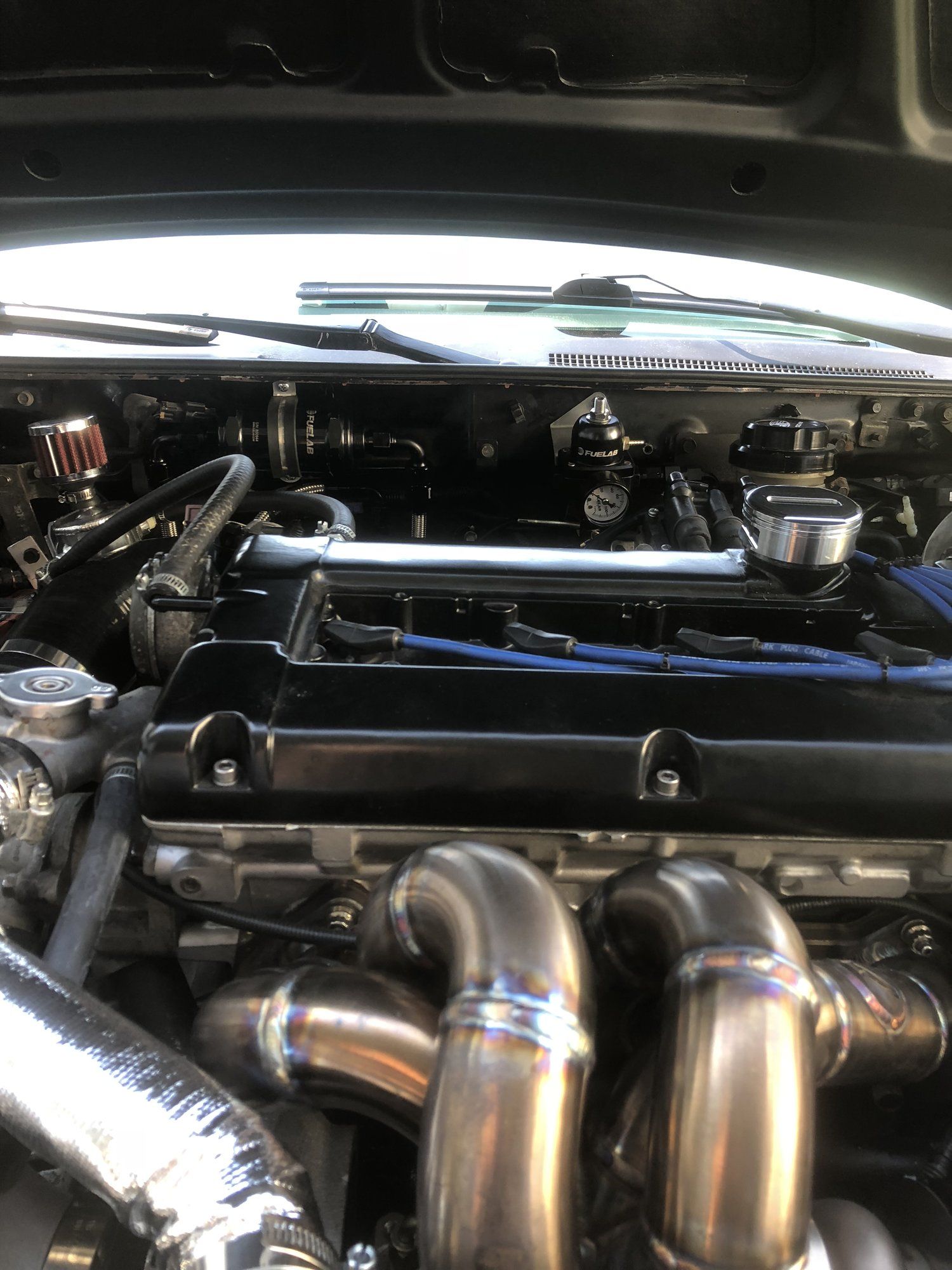

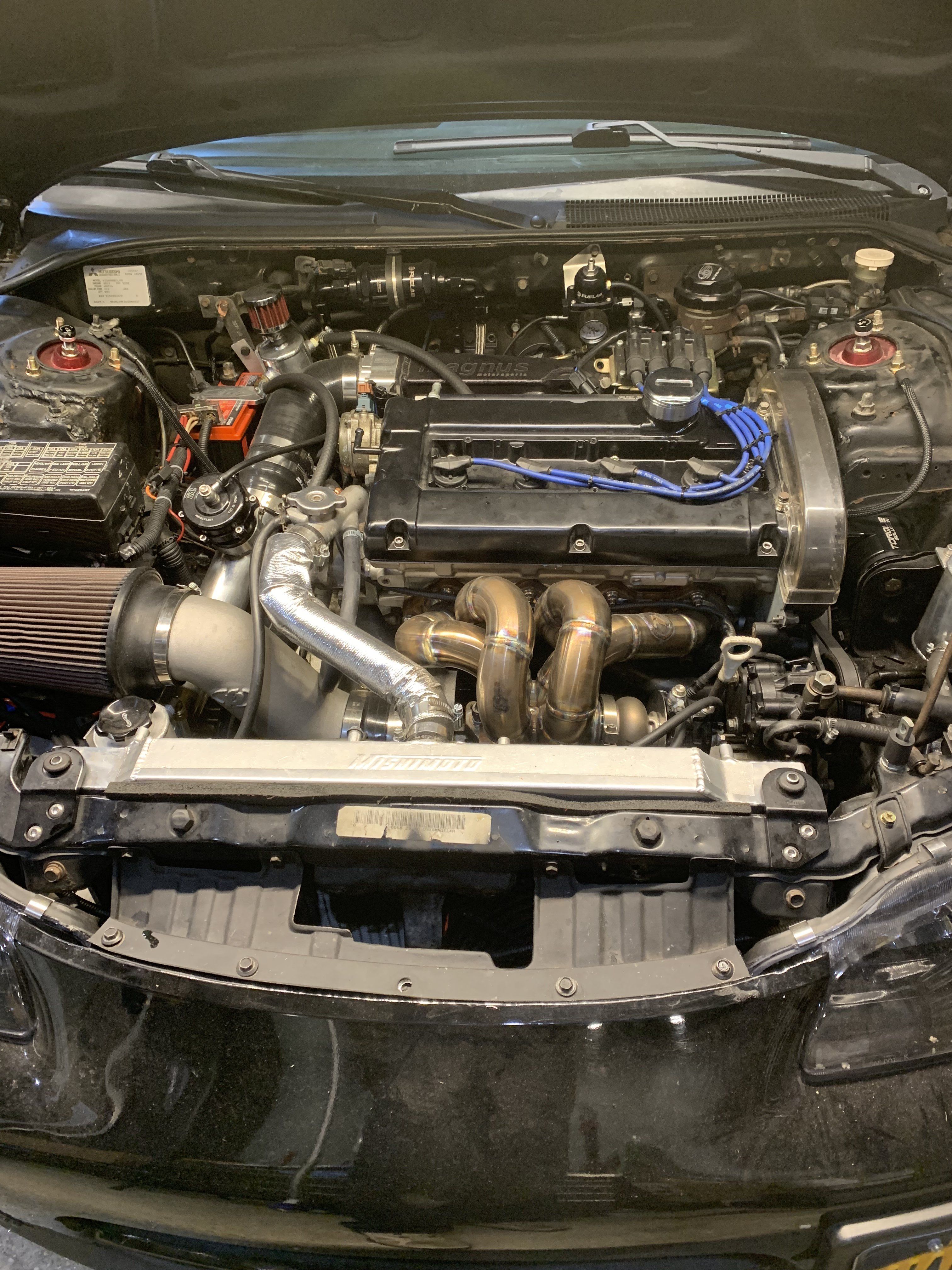

So I did hit my goal of 11s with the fp 68hta but like everyone I want more.

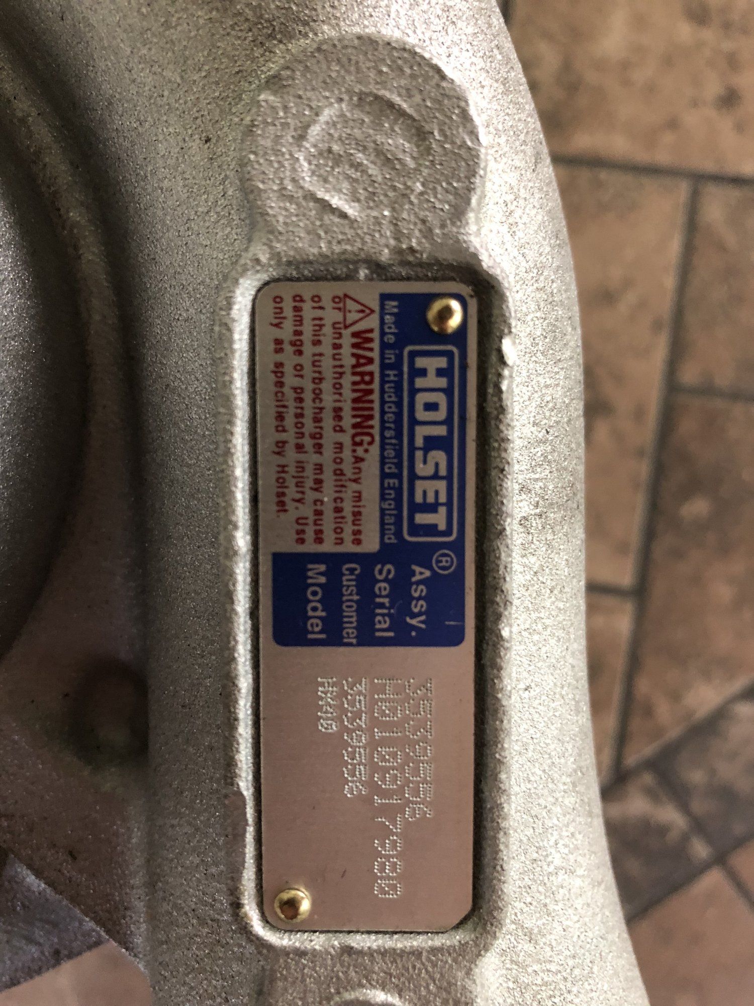

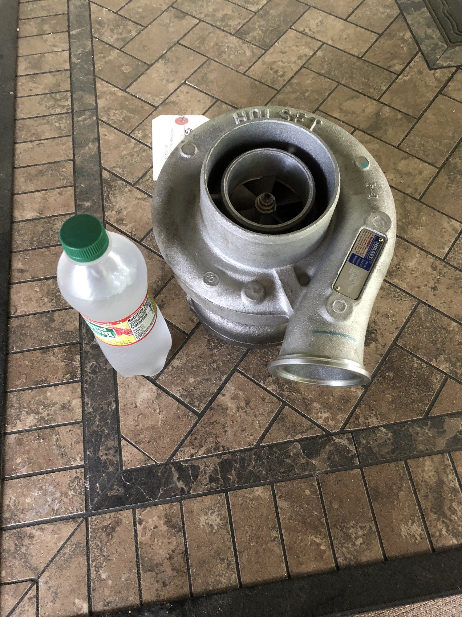

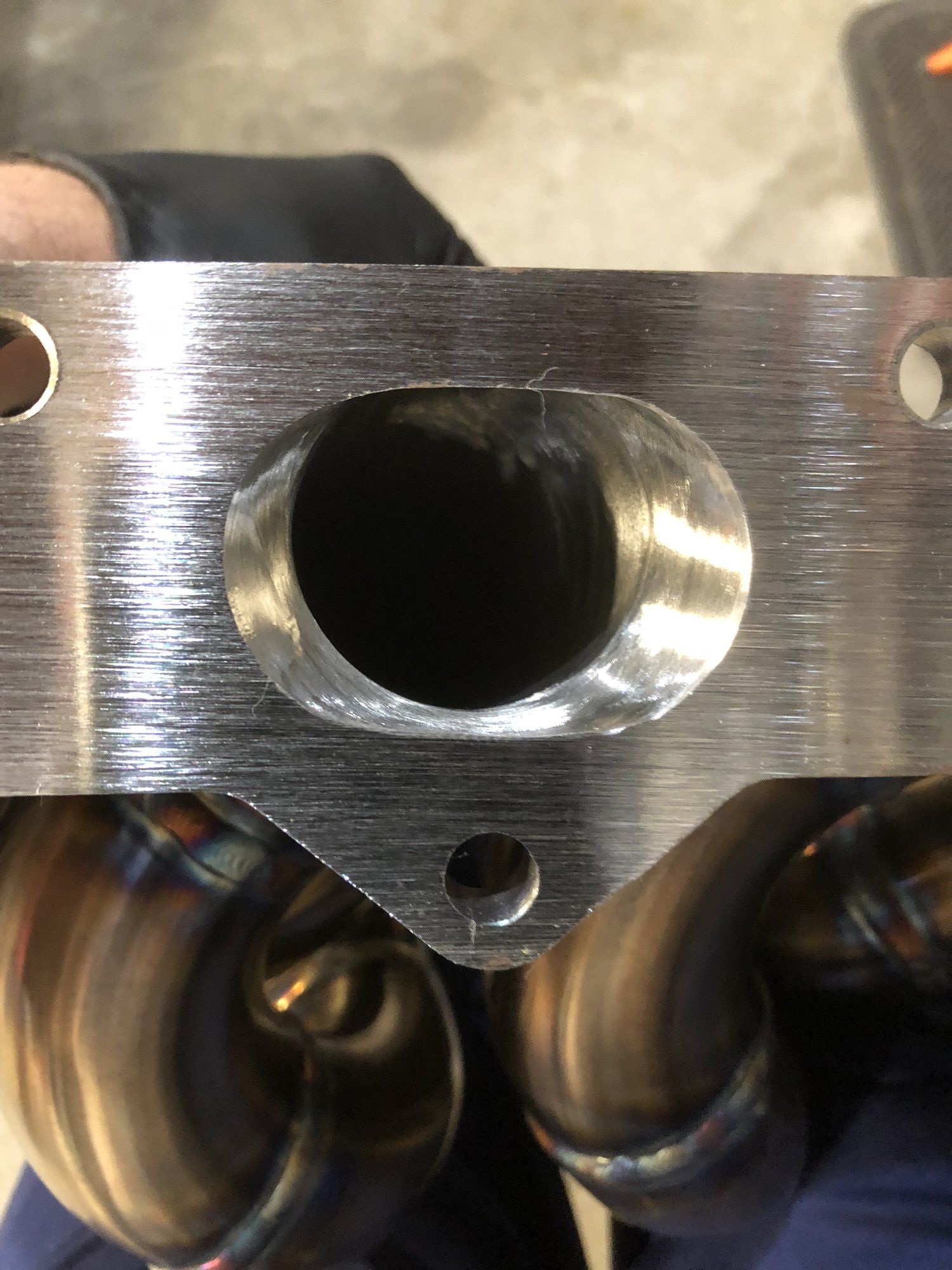

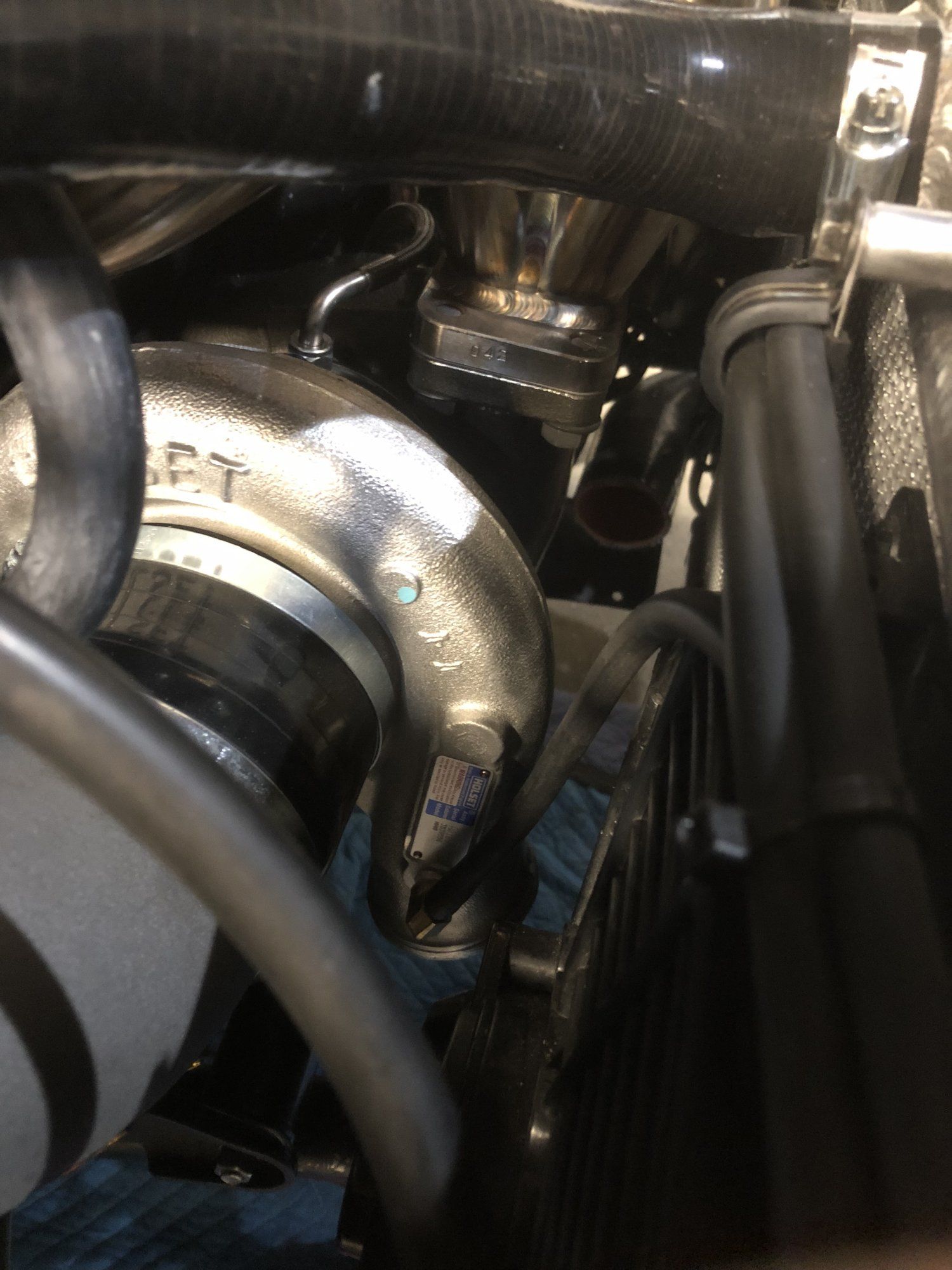

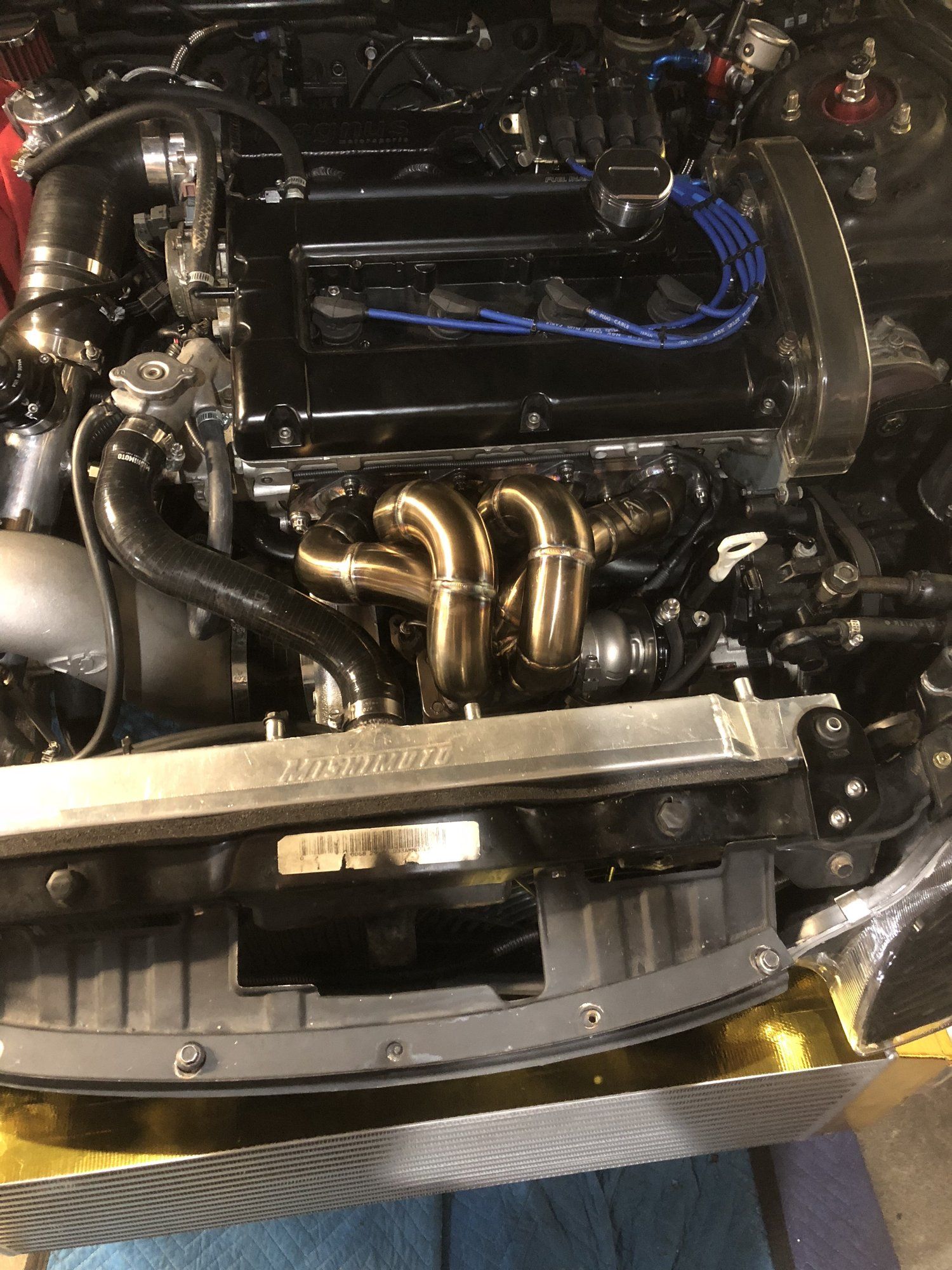

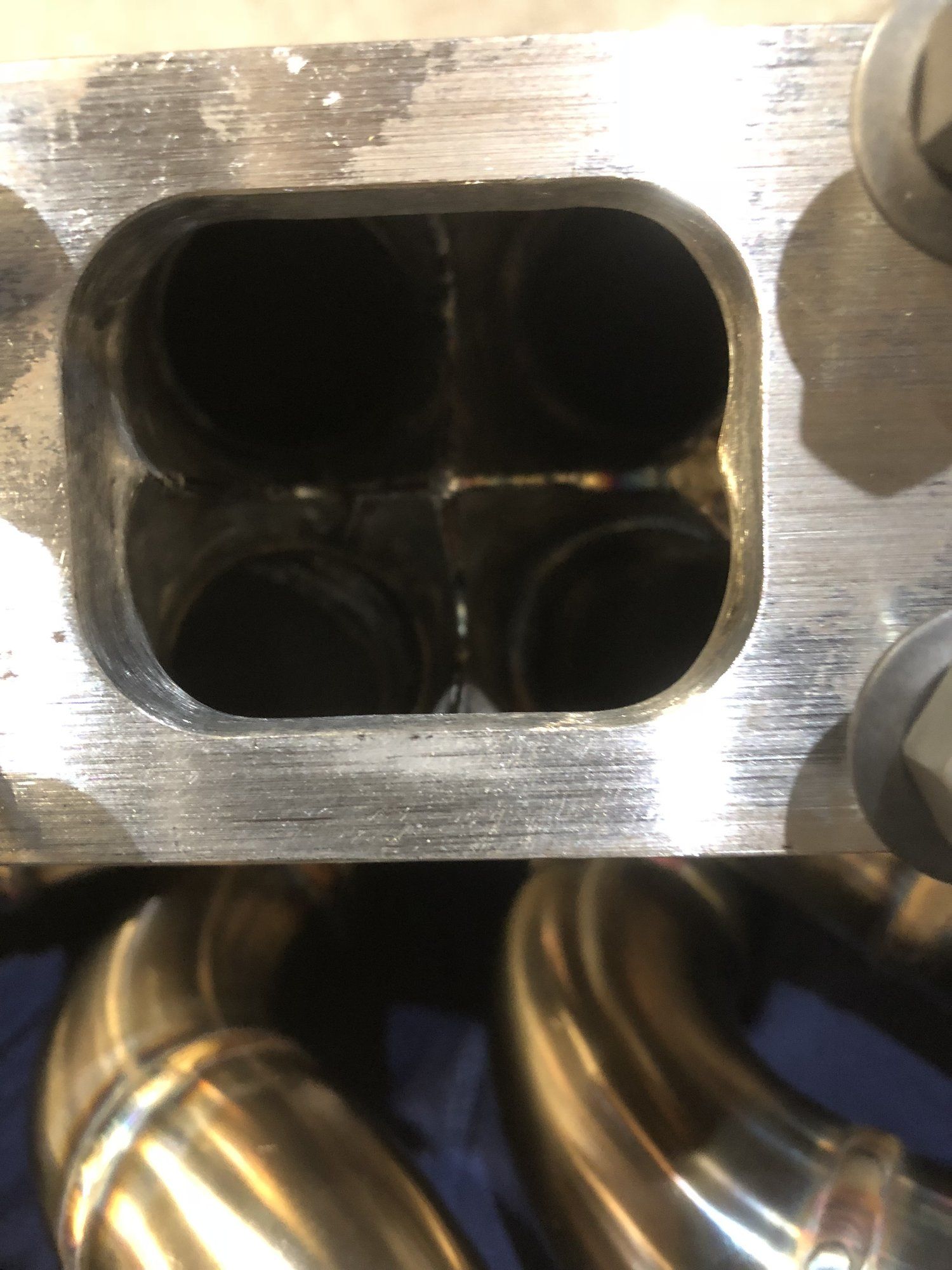

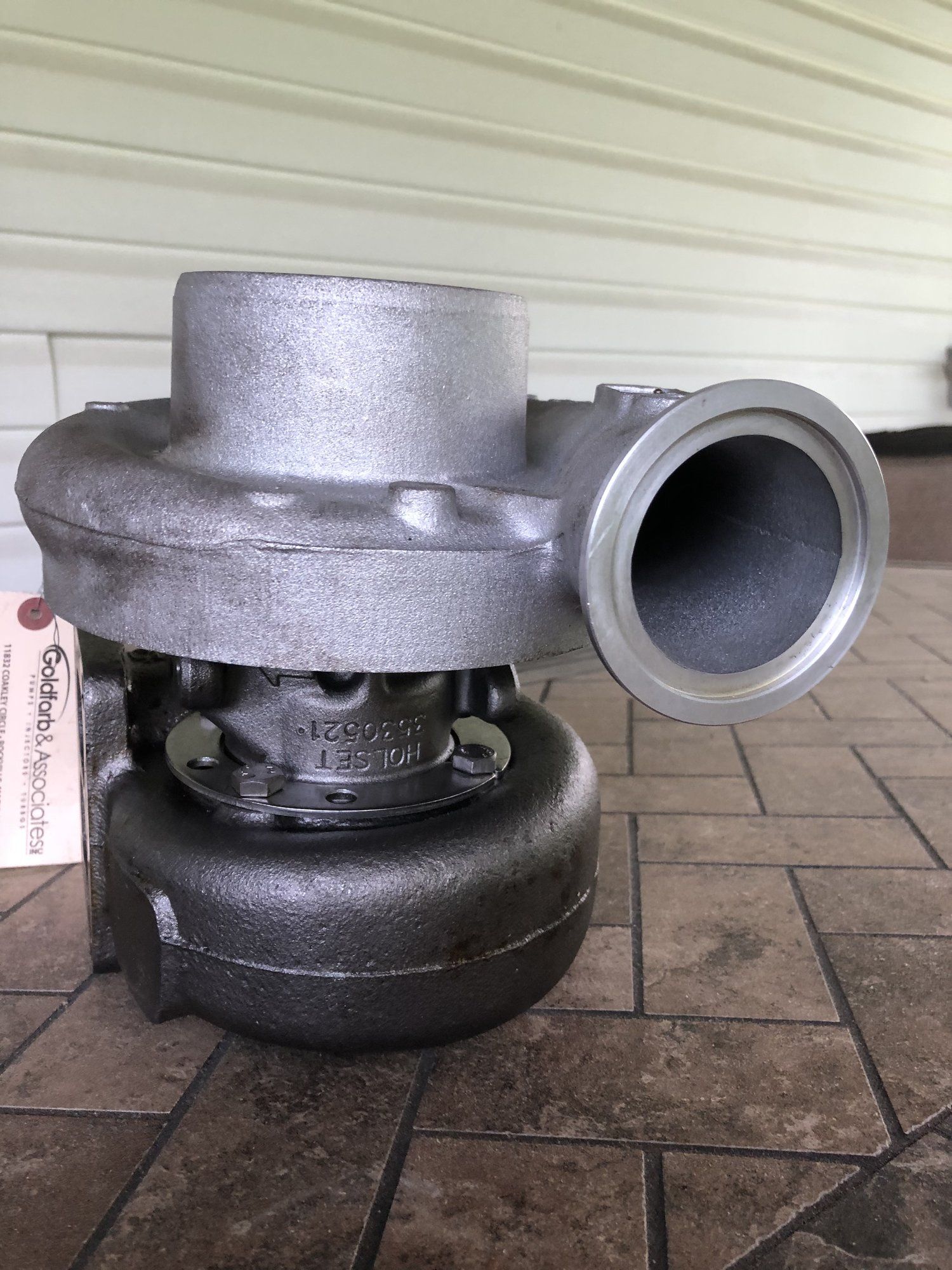

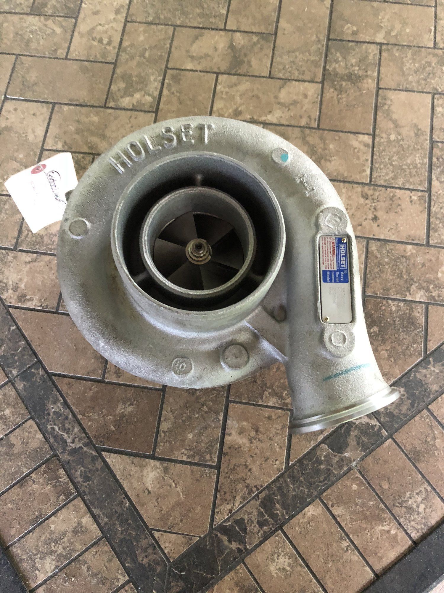

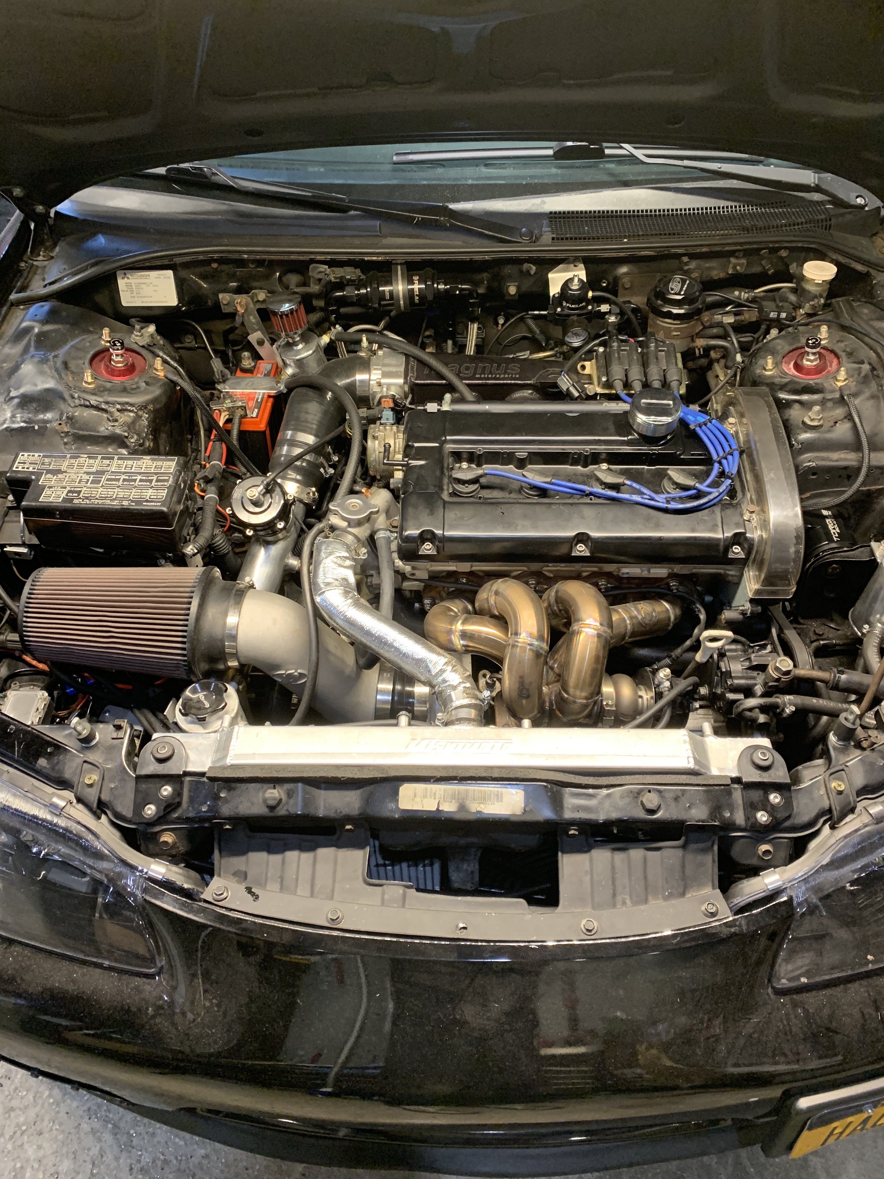

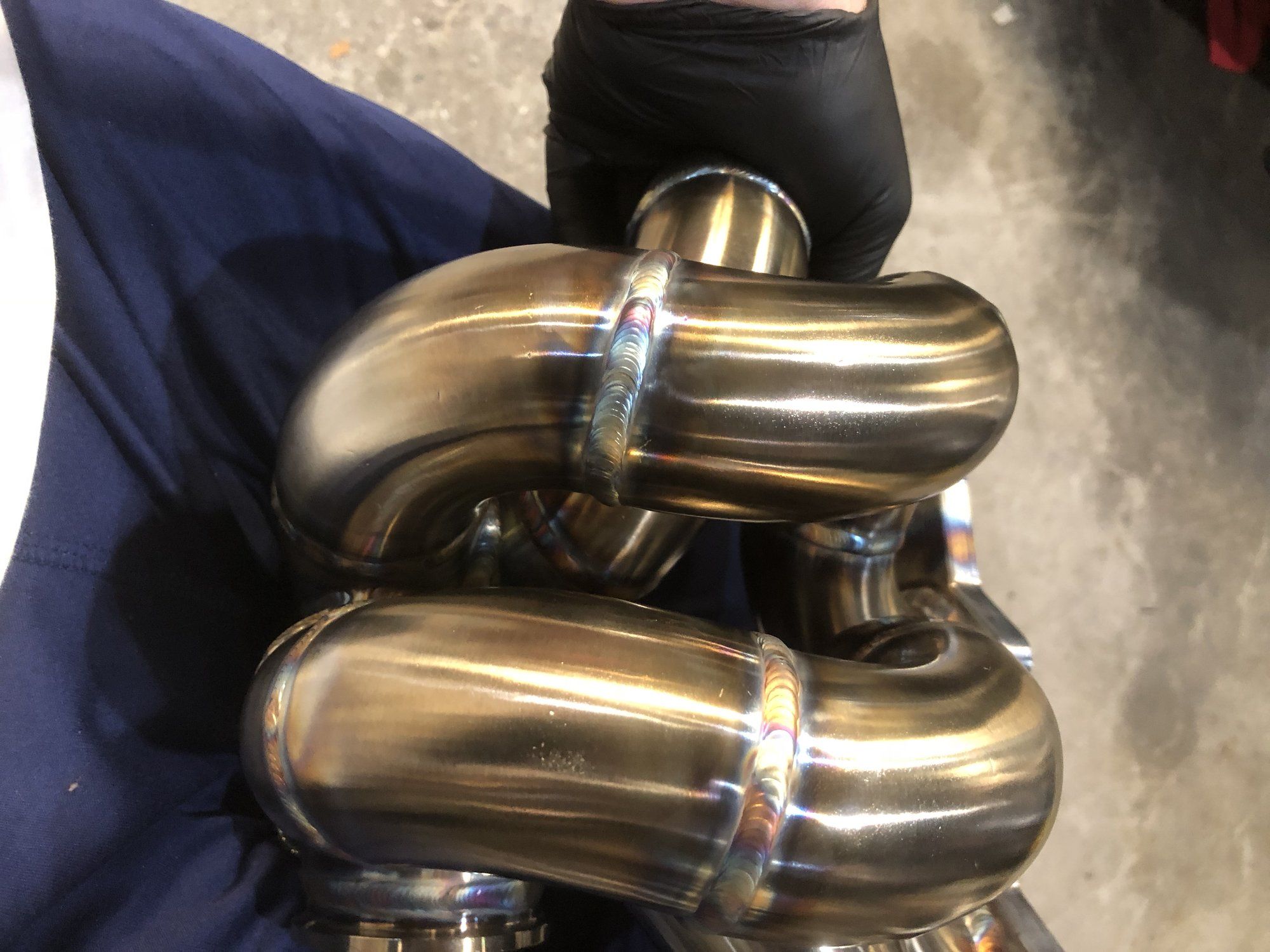

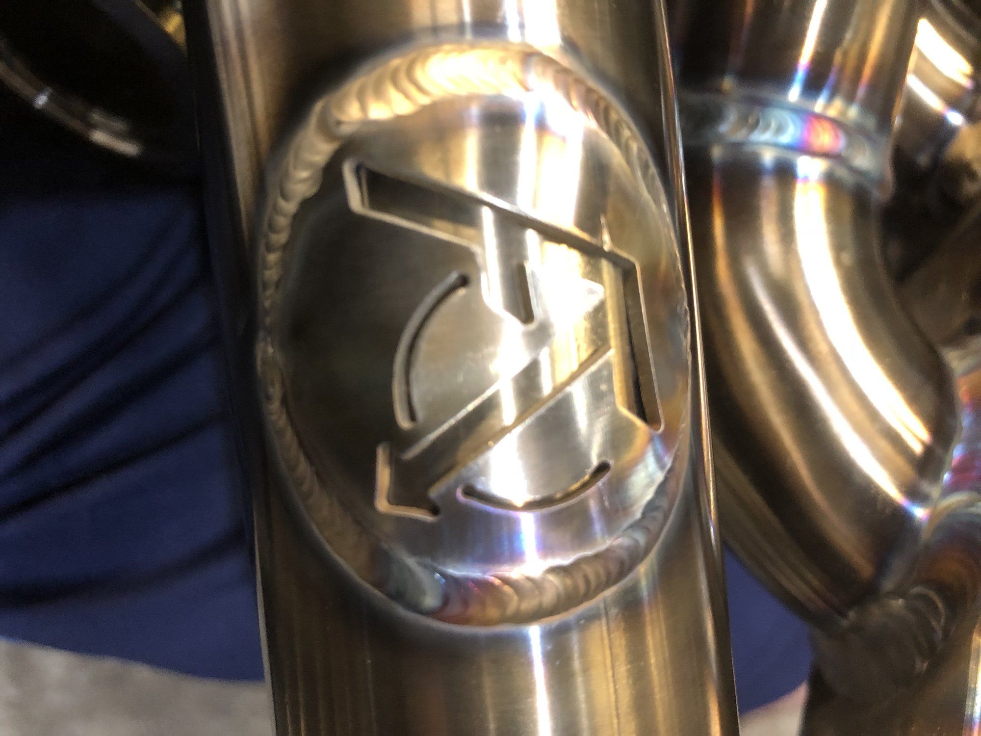

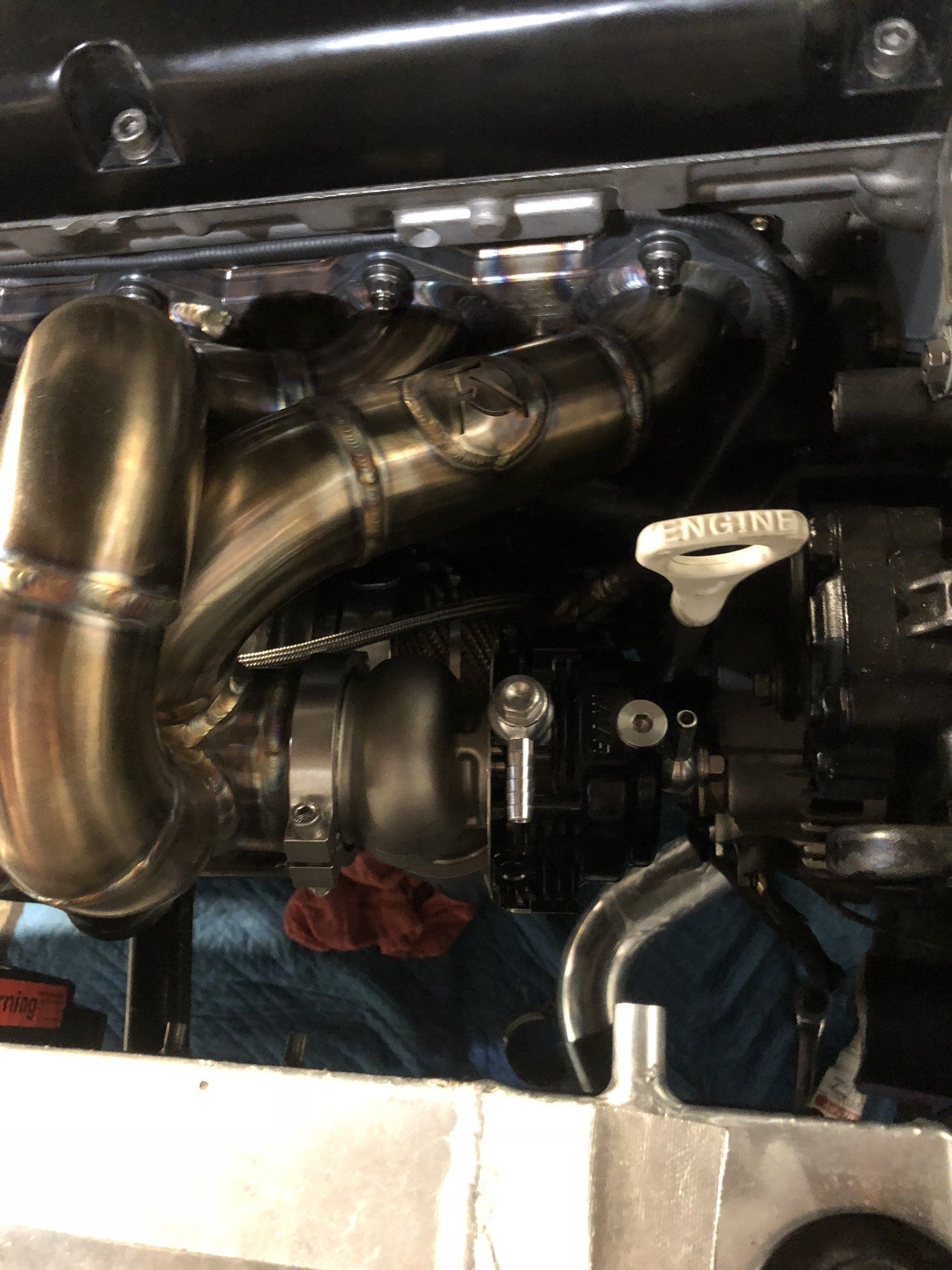

So I contacted archerfab to make me a manifold and picked up a brand new hx40 6 blade.
I'm now hoping for low 11s with this turbo. I am currently running small cams which will hurt my top end but I'll see how it goes.
I'm curious on how much faster I can go with just upgrading the turbo and manifold and leaving the engine the same.
I do see a transfer case upgrade in my future
should be able to go low 11s with ease. i went 10.80s my first time out on my dinosaur hx40 cast 60mm 8 blade on 26psi. granted i have an auto in mine but even still low 11s should be easy with a good tune.

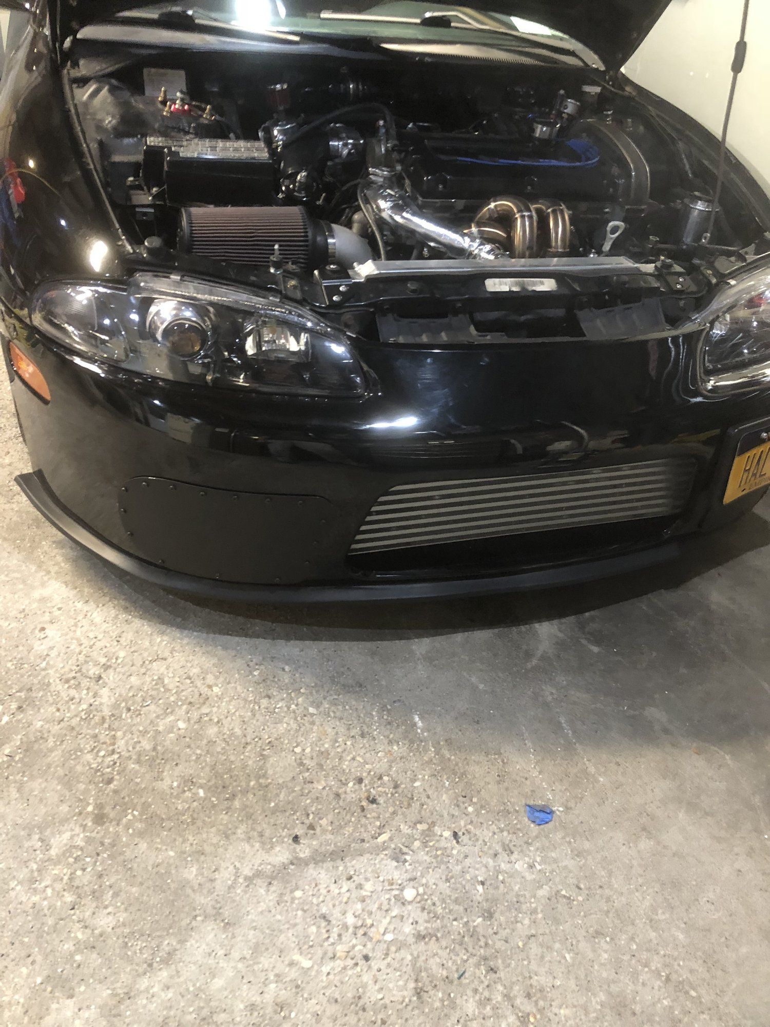

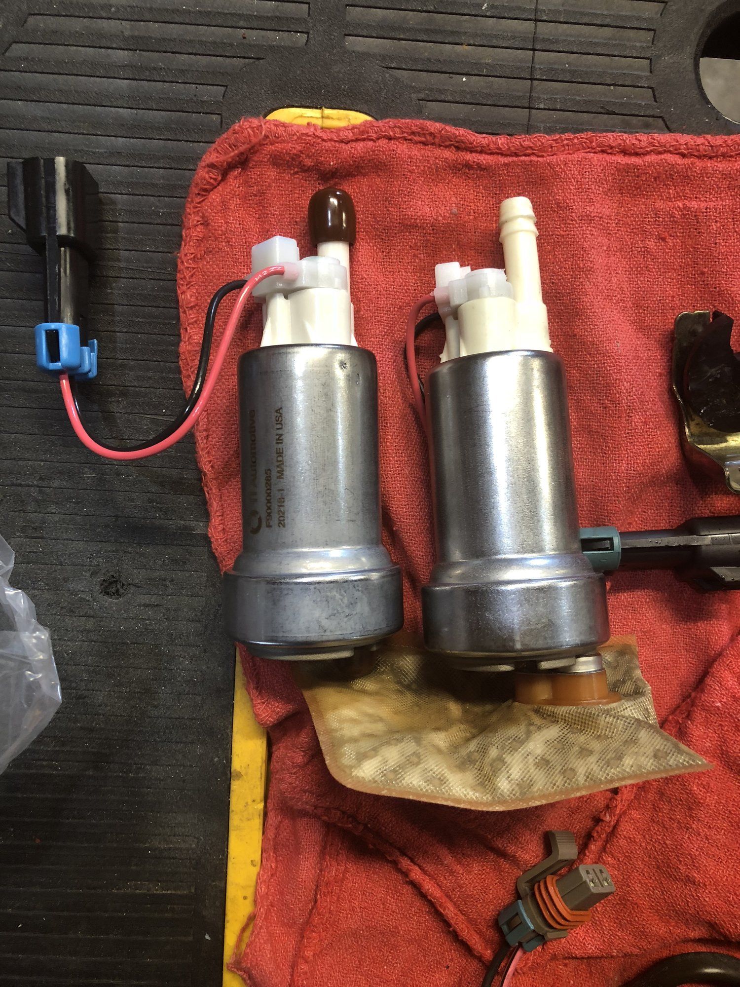

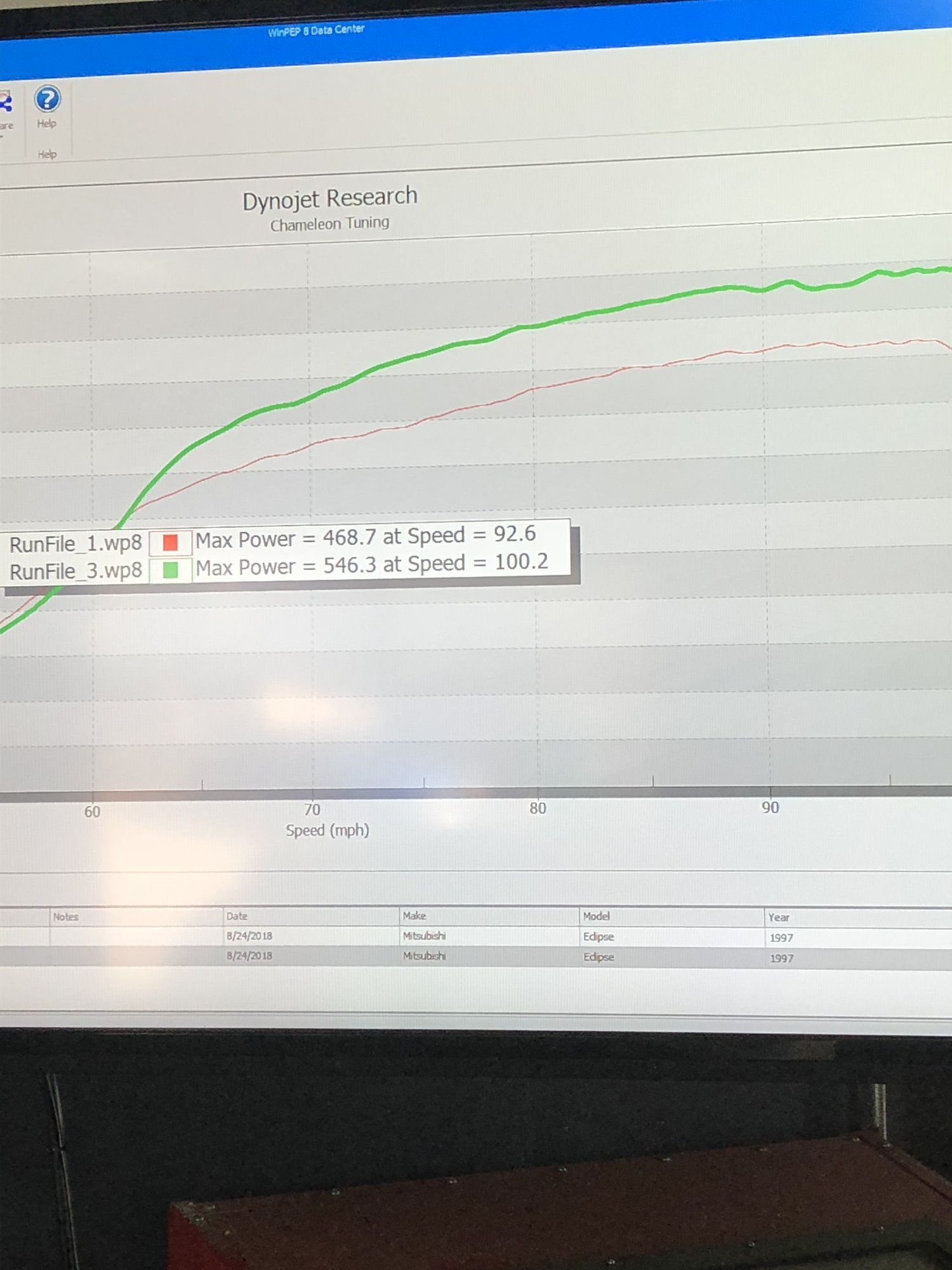

I upgraded my fuel system slightly. I took out the 450 and put in the new wally 525 and ran ptfe -8 lines from the fuel rail back to the pump.

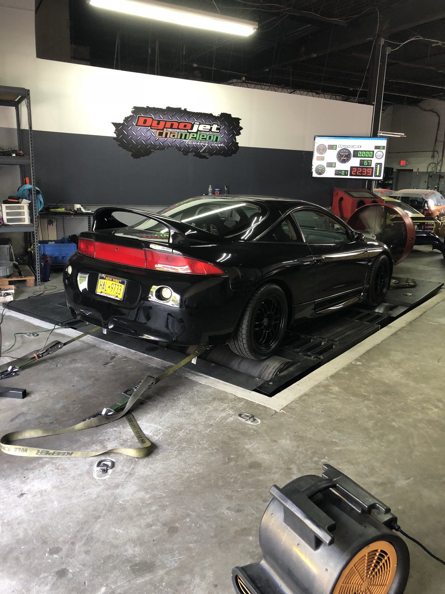

I haven't tested it out on the dyno yet but with just the bigger pump I was able to turn up the boost without leaning out so I'm thinking the problem is fixed.

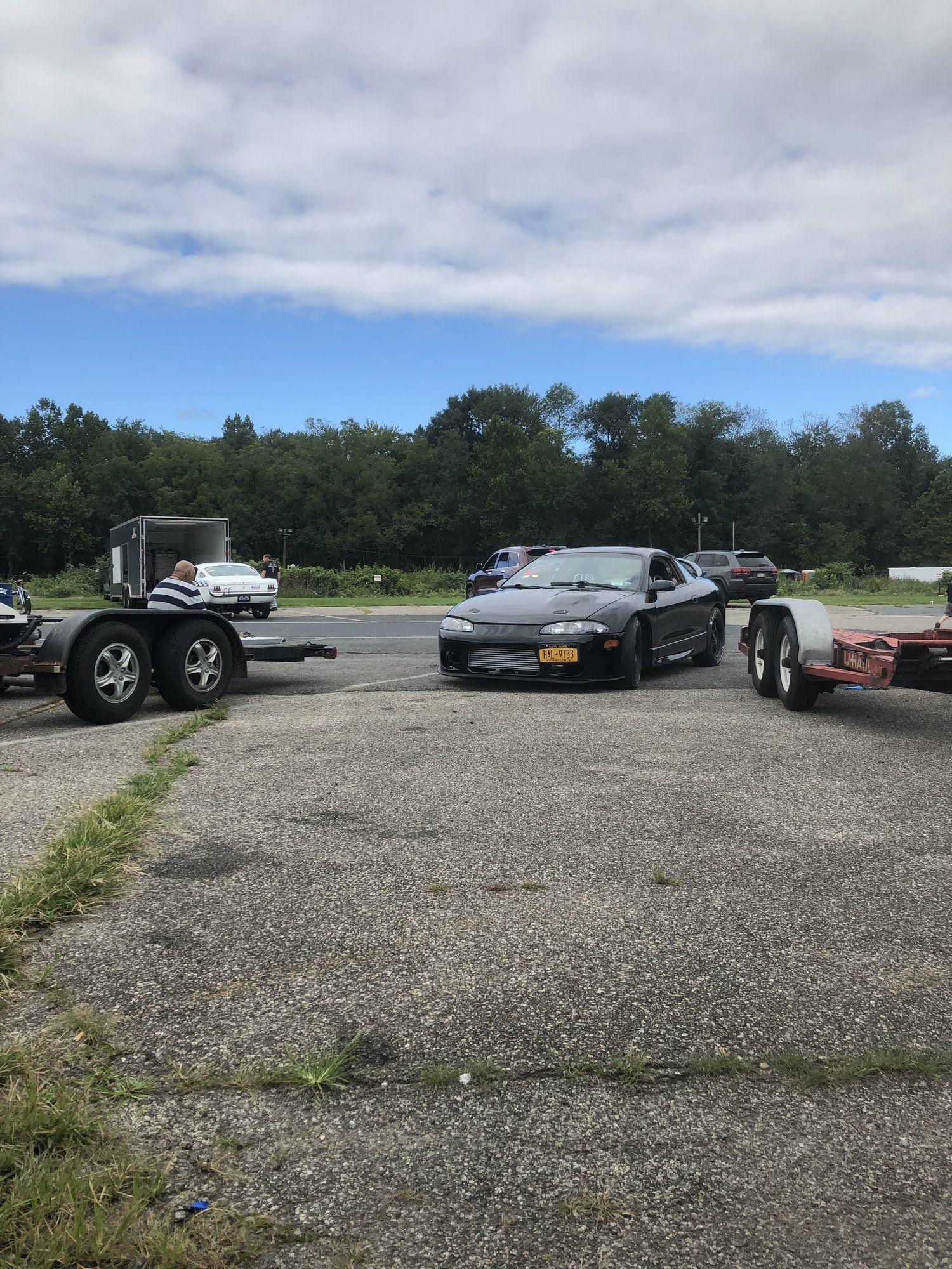

Before I changed to -8 lines I took it to the track and didn't run as well as I expected but it has a lot of potential.
At around 30 psi(lots more in it) I ran 11.7@125mph with a crappy 60 foot of 1.8, spinning in first.
I was shifting at 7500 max which now that my fuel is upgraded I should be able to Rev out each gear a little more and push more boost.
