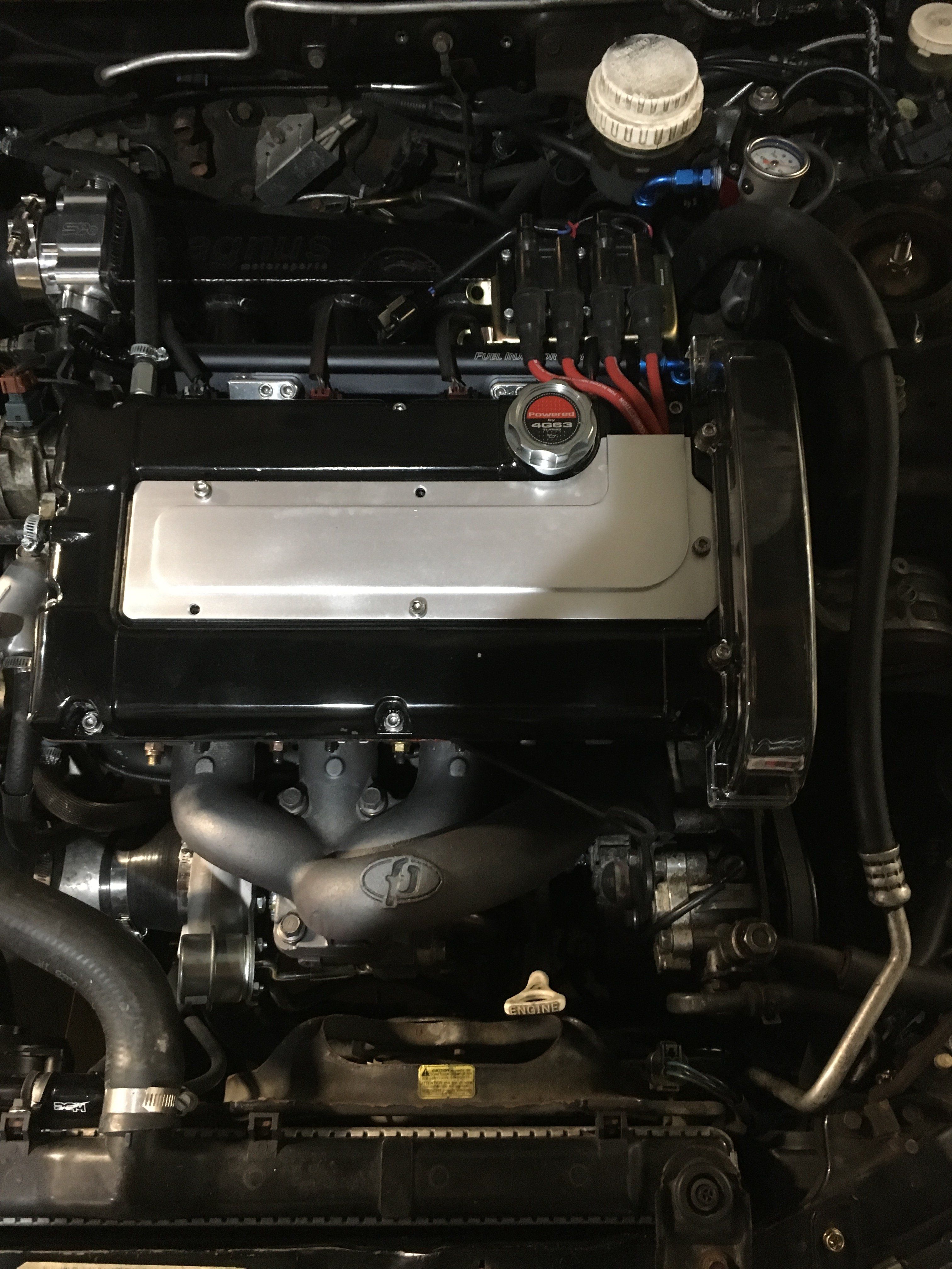

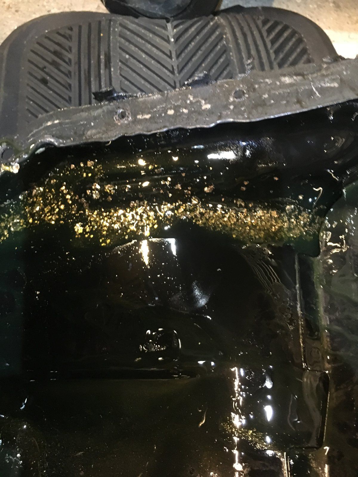

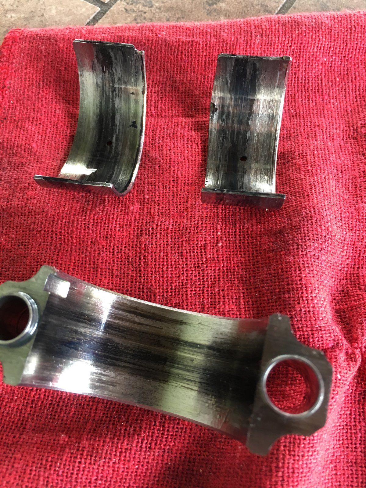

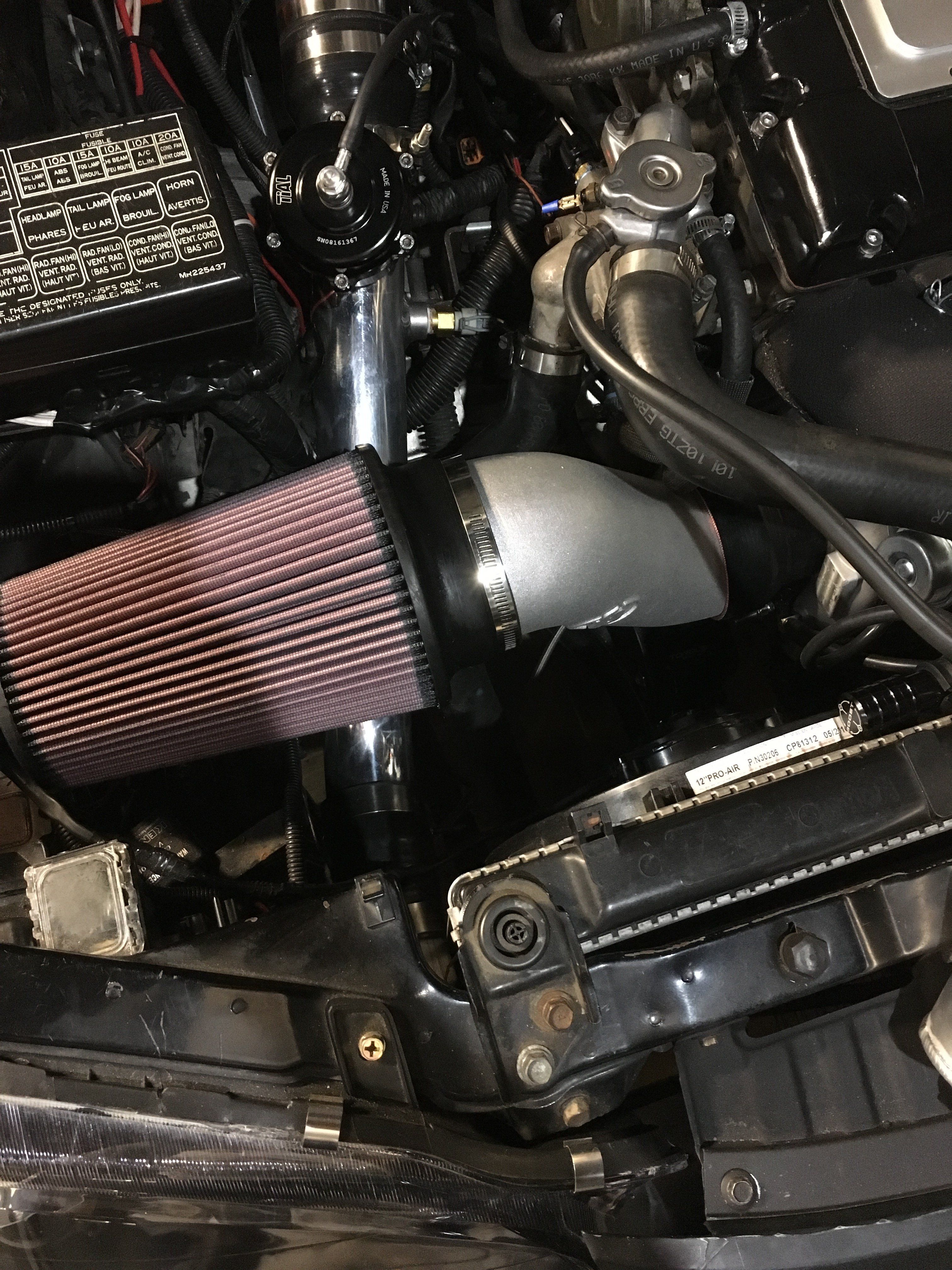

So I ended up spinning two rod bearings so I decided it was time to do a complete rebuild
Lots and lots of new parts
Stage 1 head port
Ferrea 6000 series intake and exhaust valves
Kiggly steel street beehive valve springs
Top line lifters
Kelford 264/268 cams
Manley turbo tuff I beam steel rods
Wiesco extreme duty hd forged Pistons 8.5:1
Arp main studs
Gsc bse
Oem oil pump
And a bunch of new oem parts
Also a bunch of machine work
