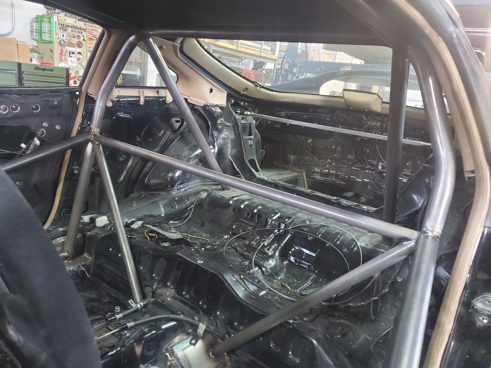

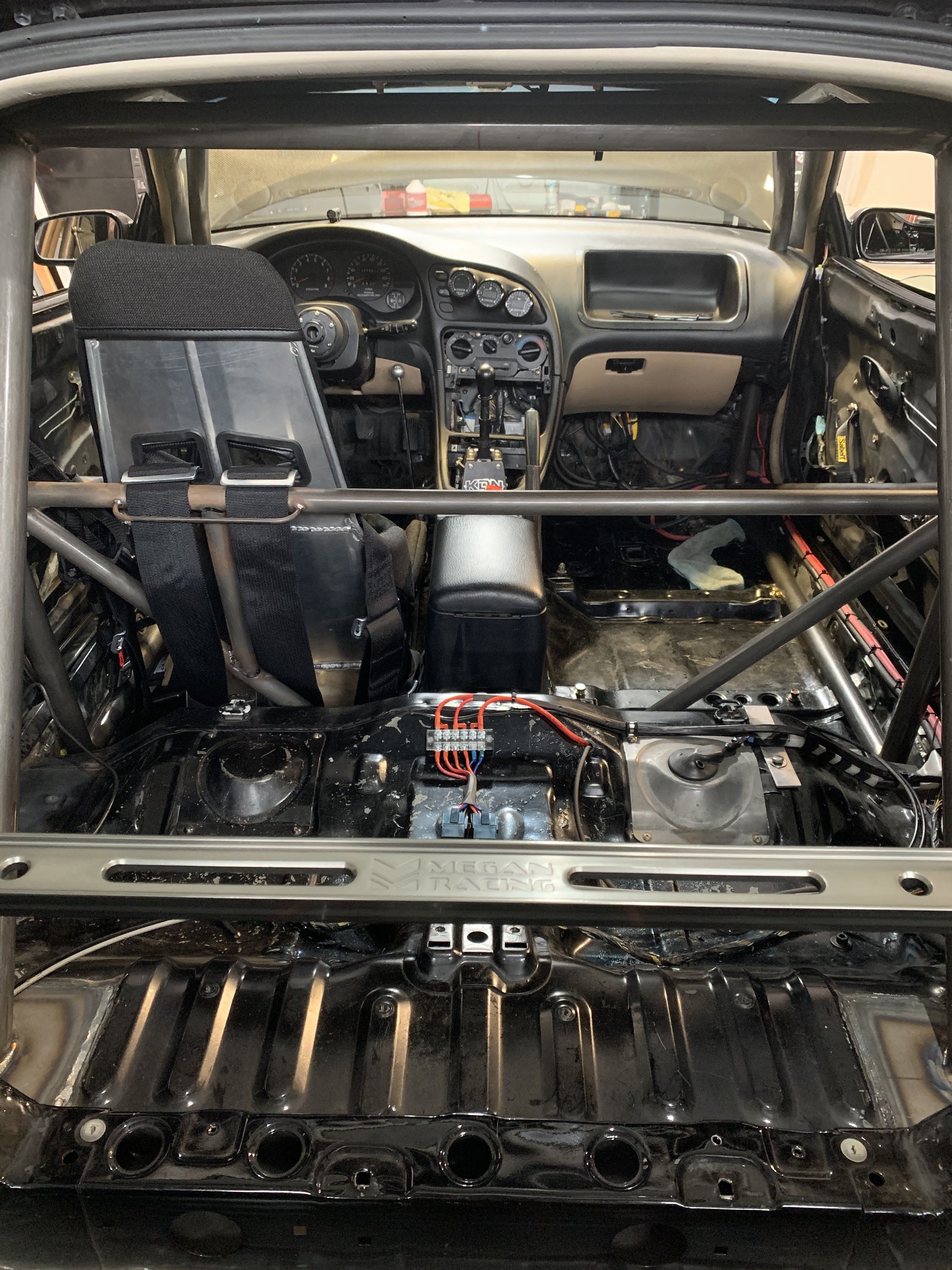

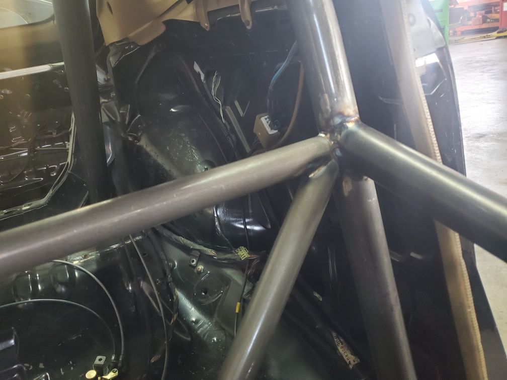

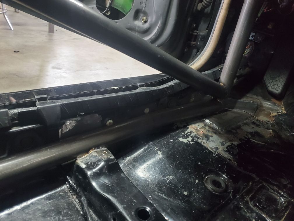

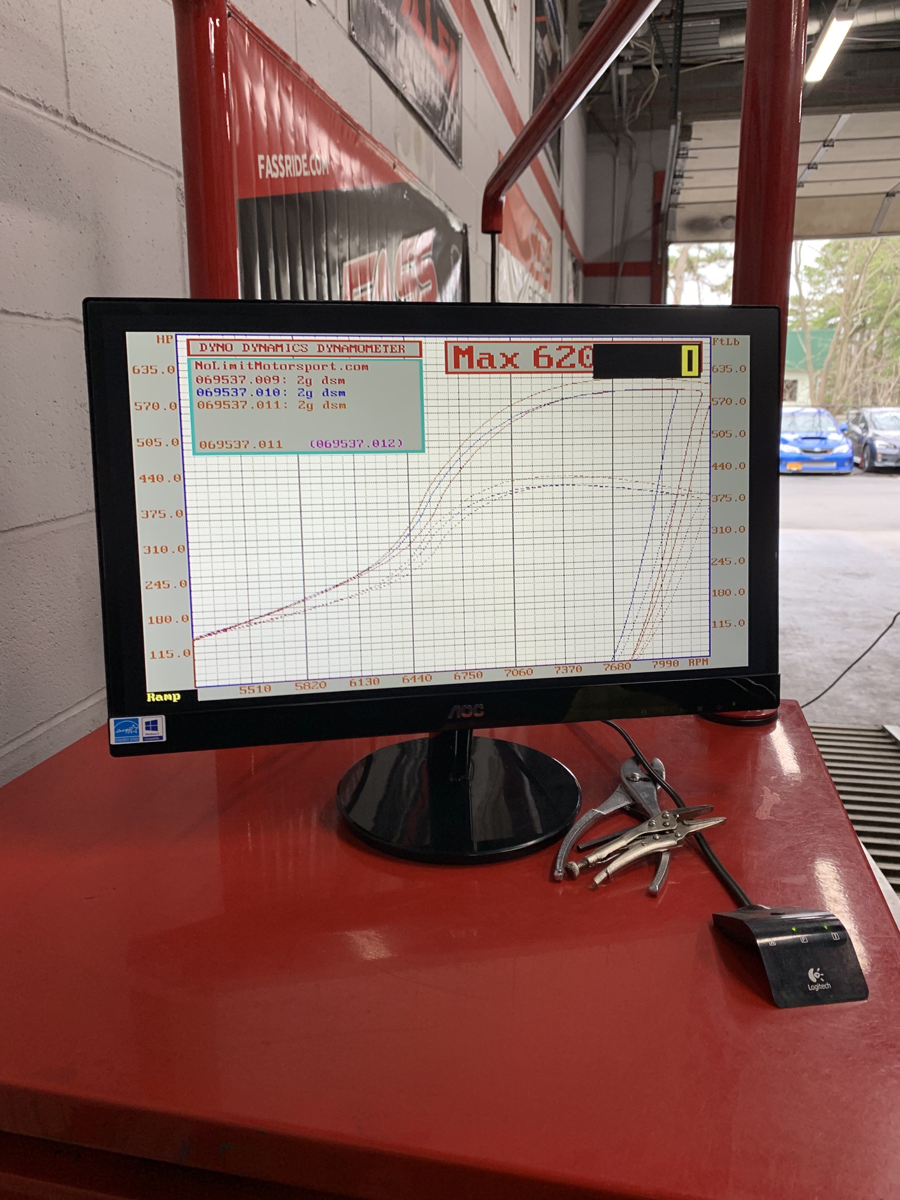

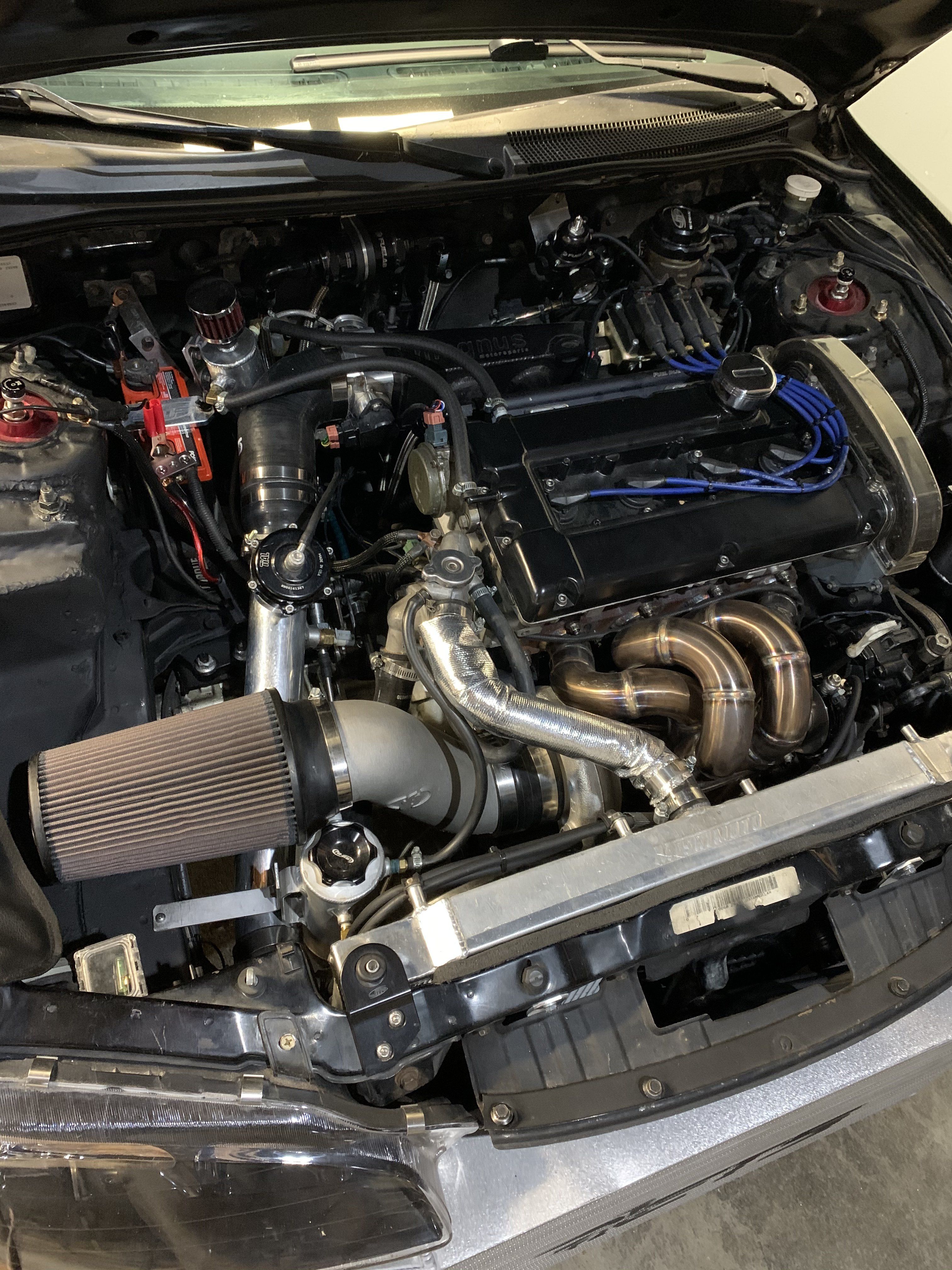

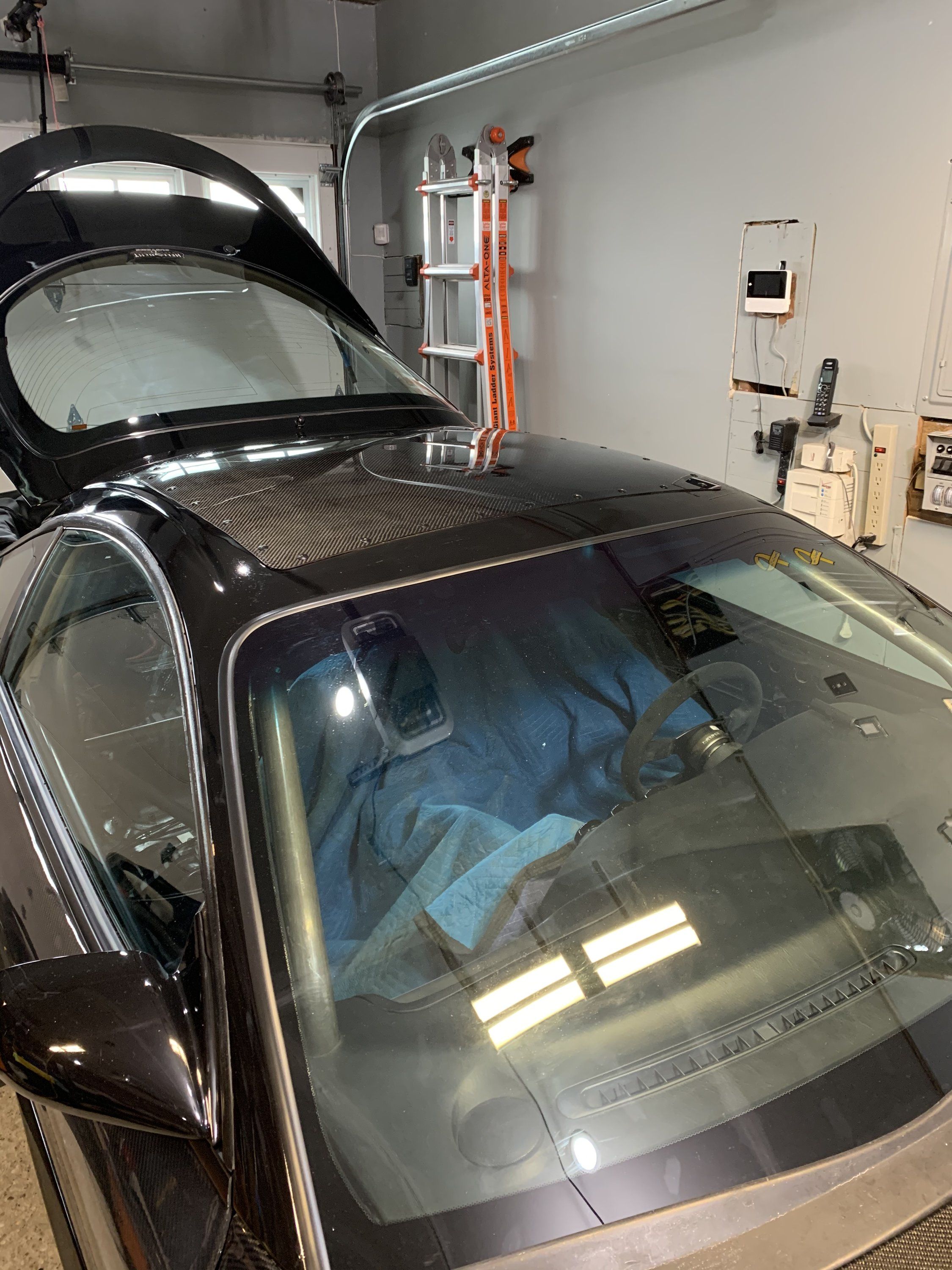

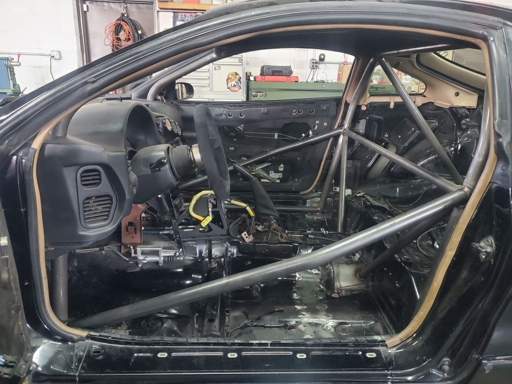

After last season at the track I was trapping close to 135mph so I had to let off the throttle early to avoid getting kicked out for not having a cage.

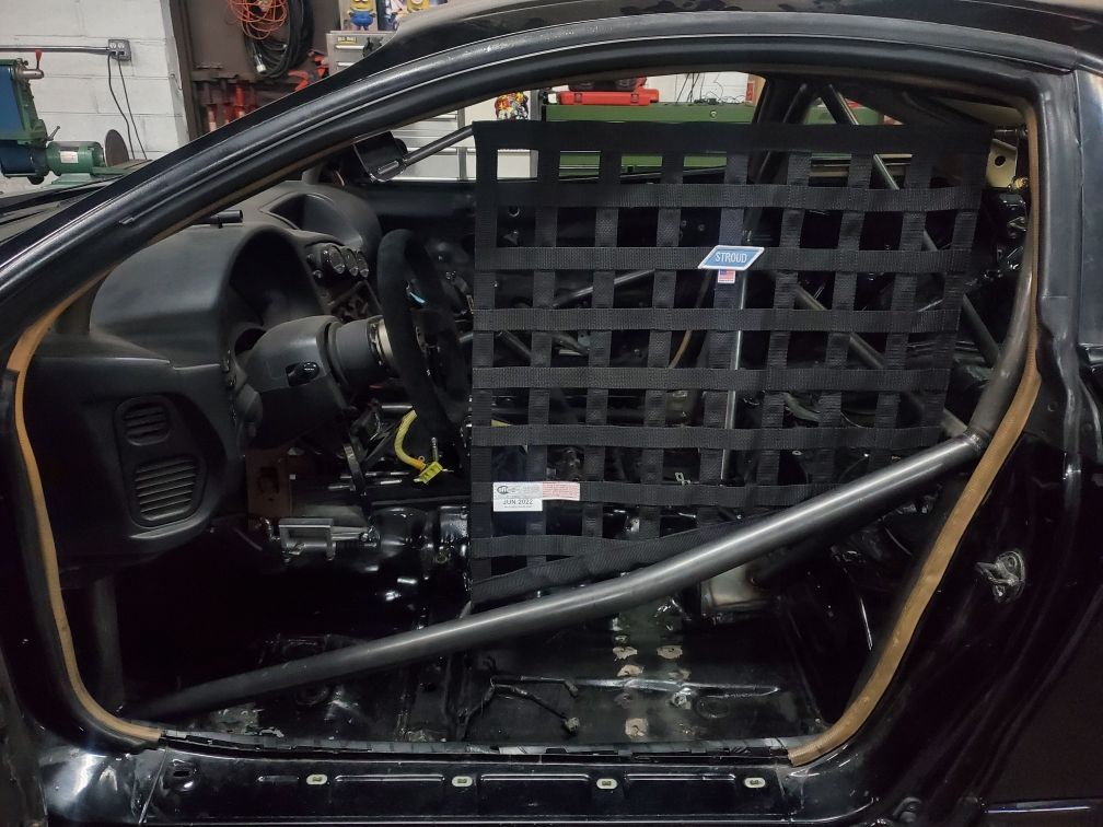

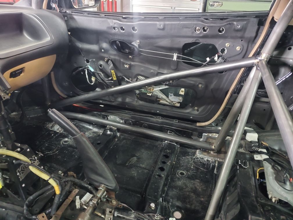

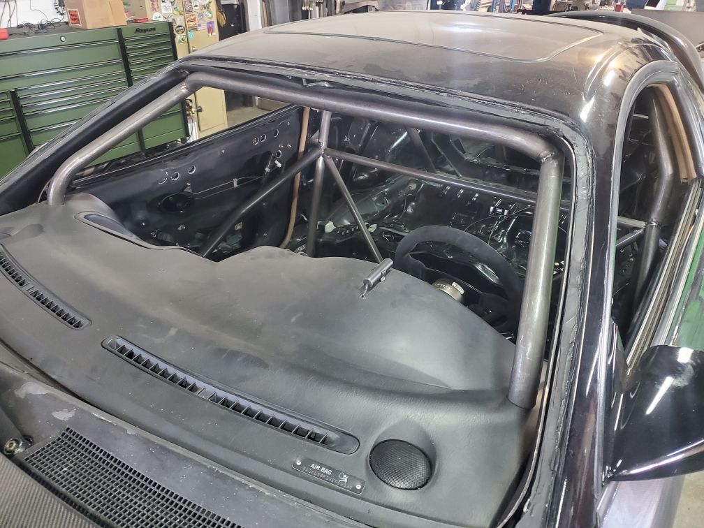

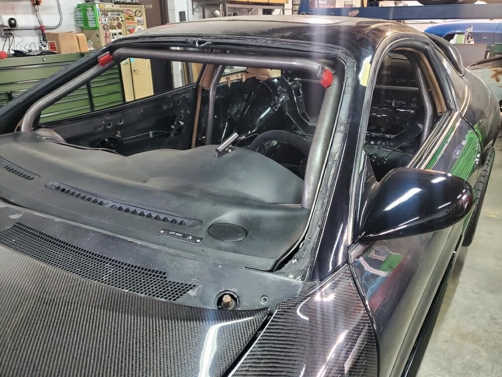

My last trip to the track I ran a 10.8 letting off at the 1000' mark so I knew I needed a cage.

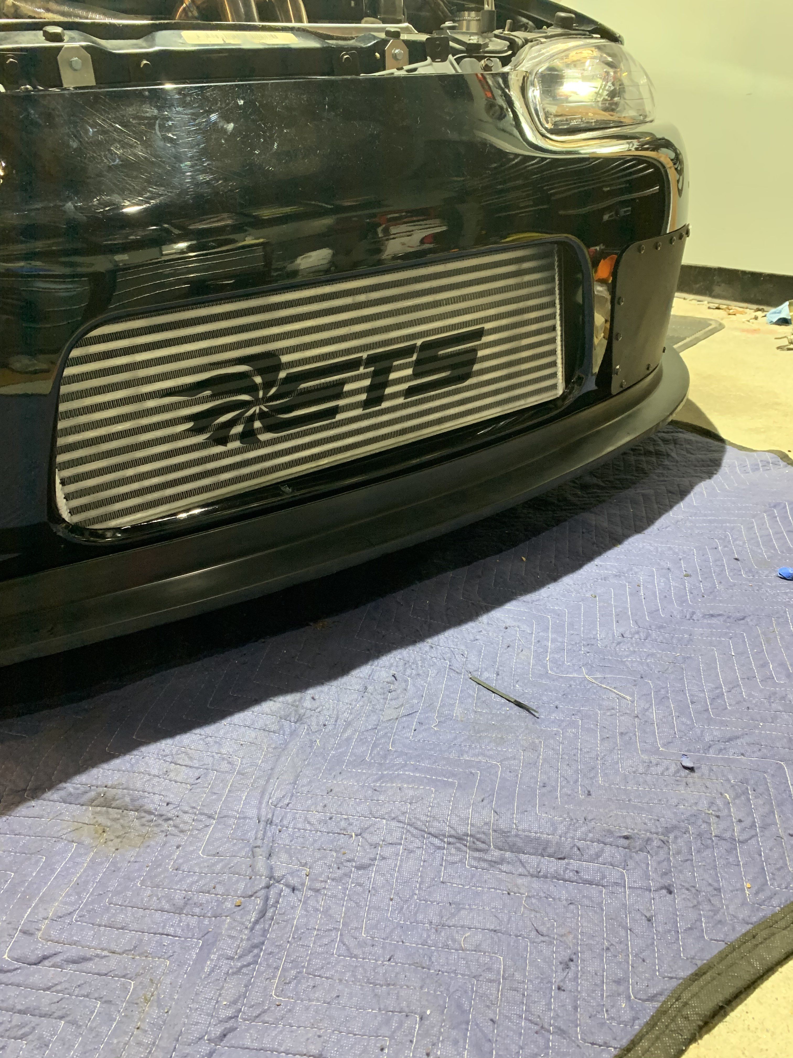

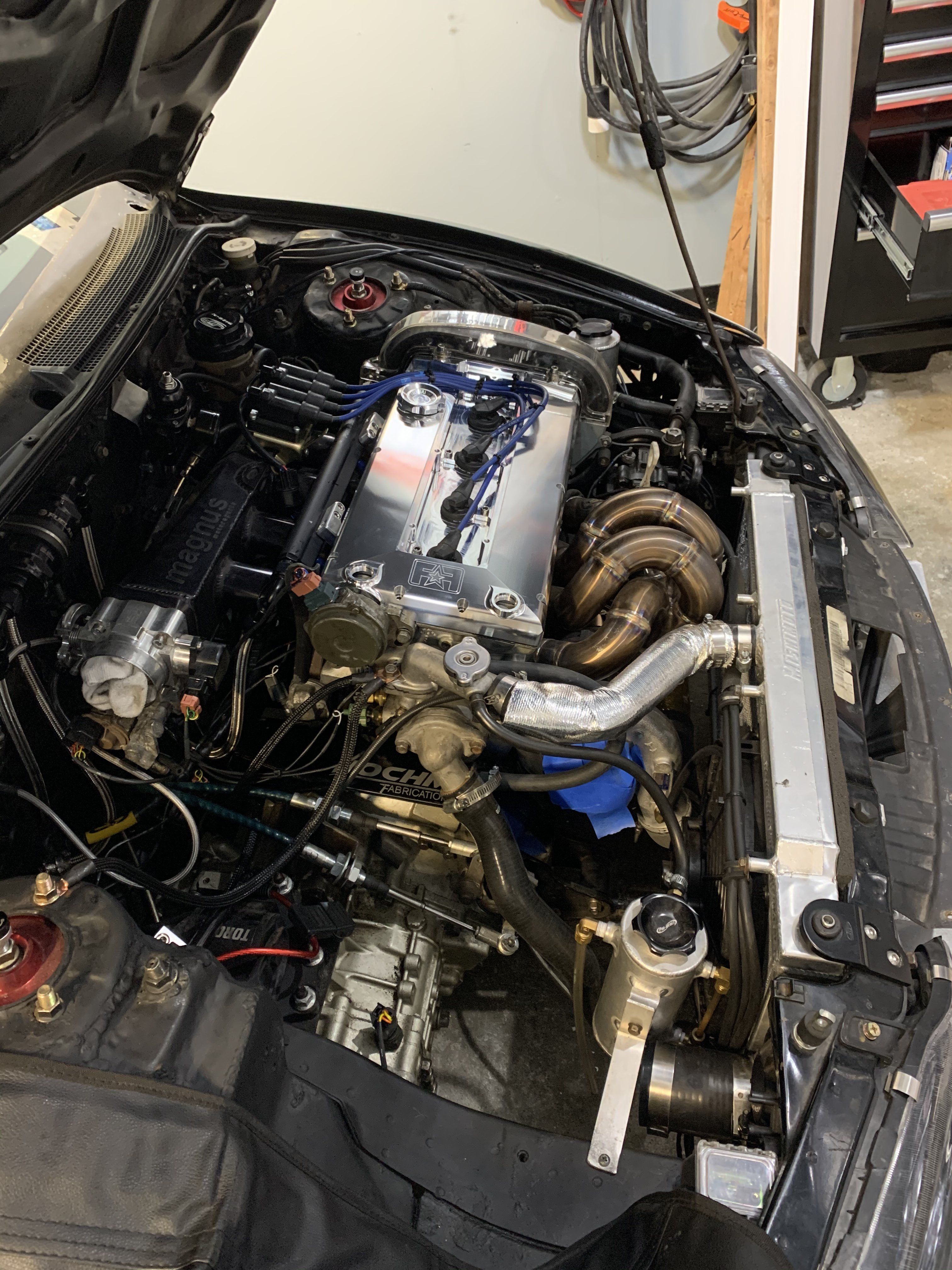

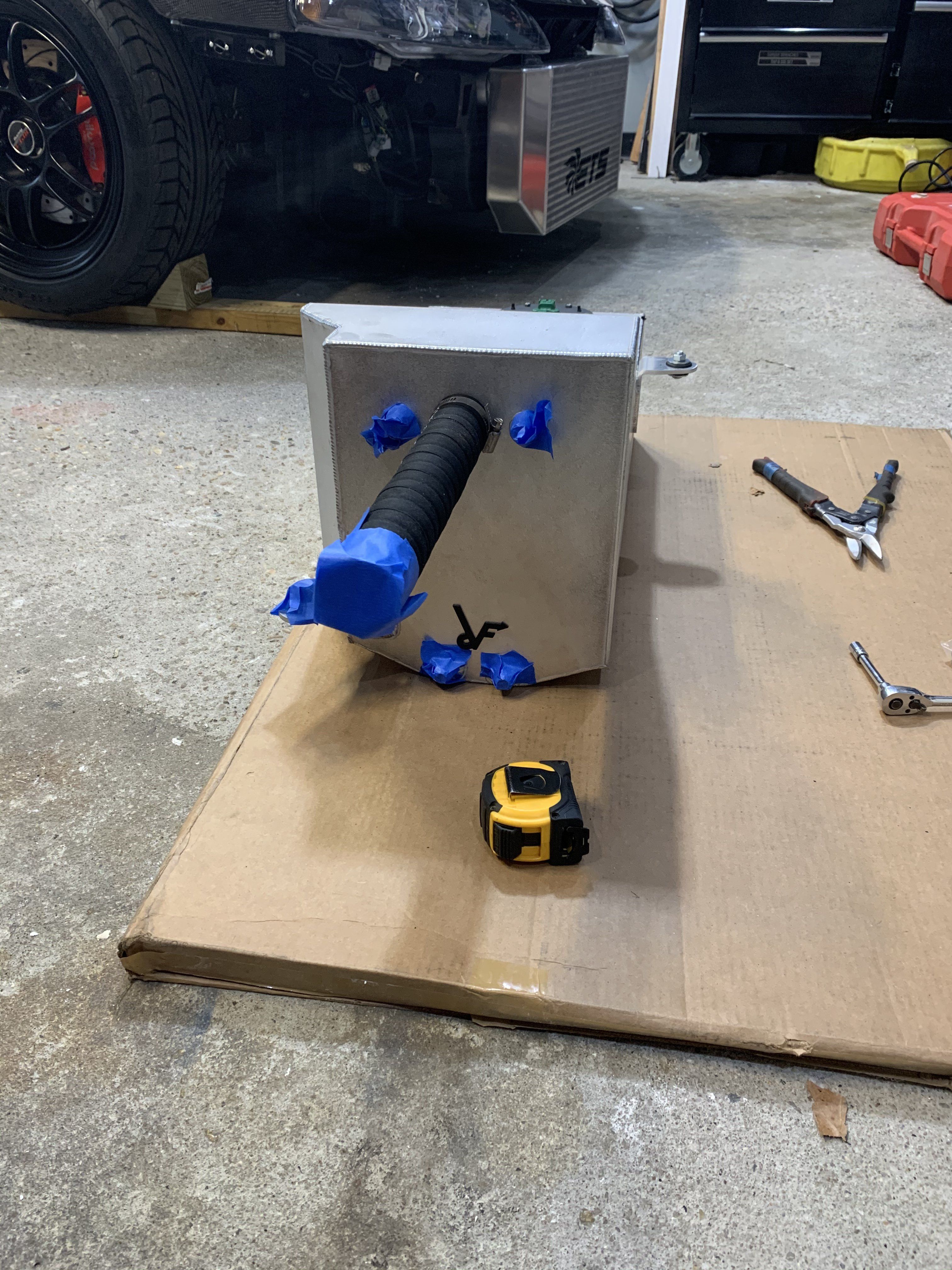

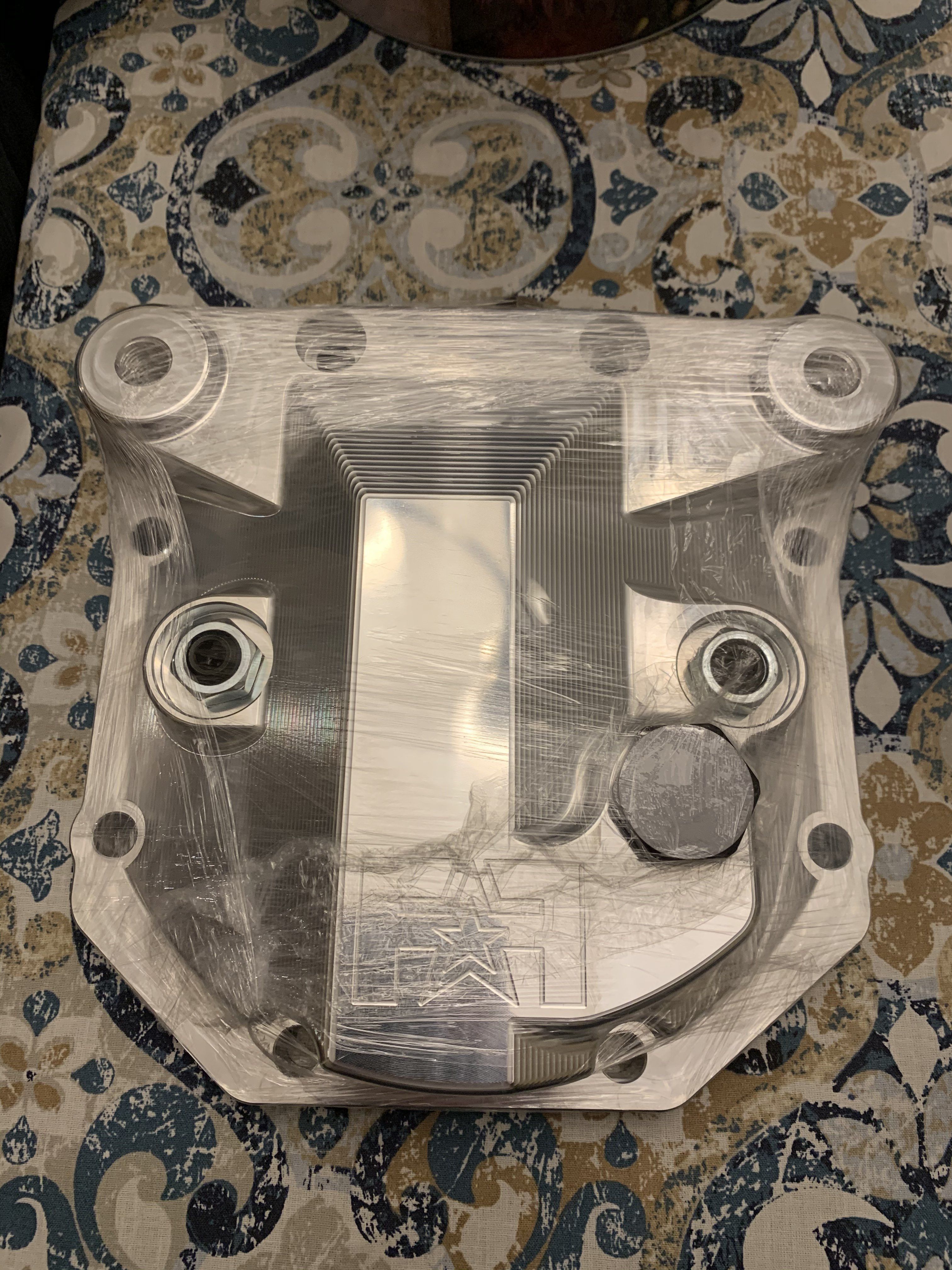

So first I ordered a 4" ets fmic

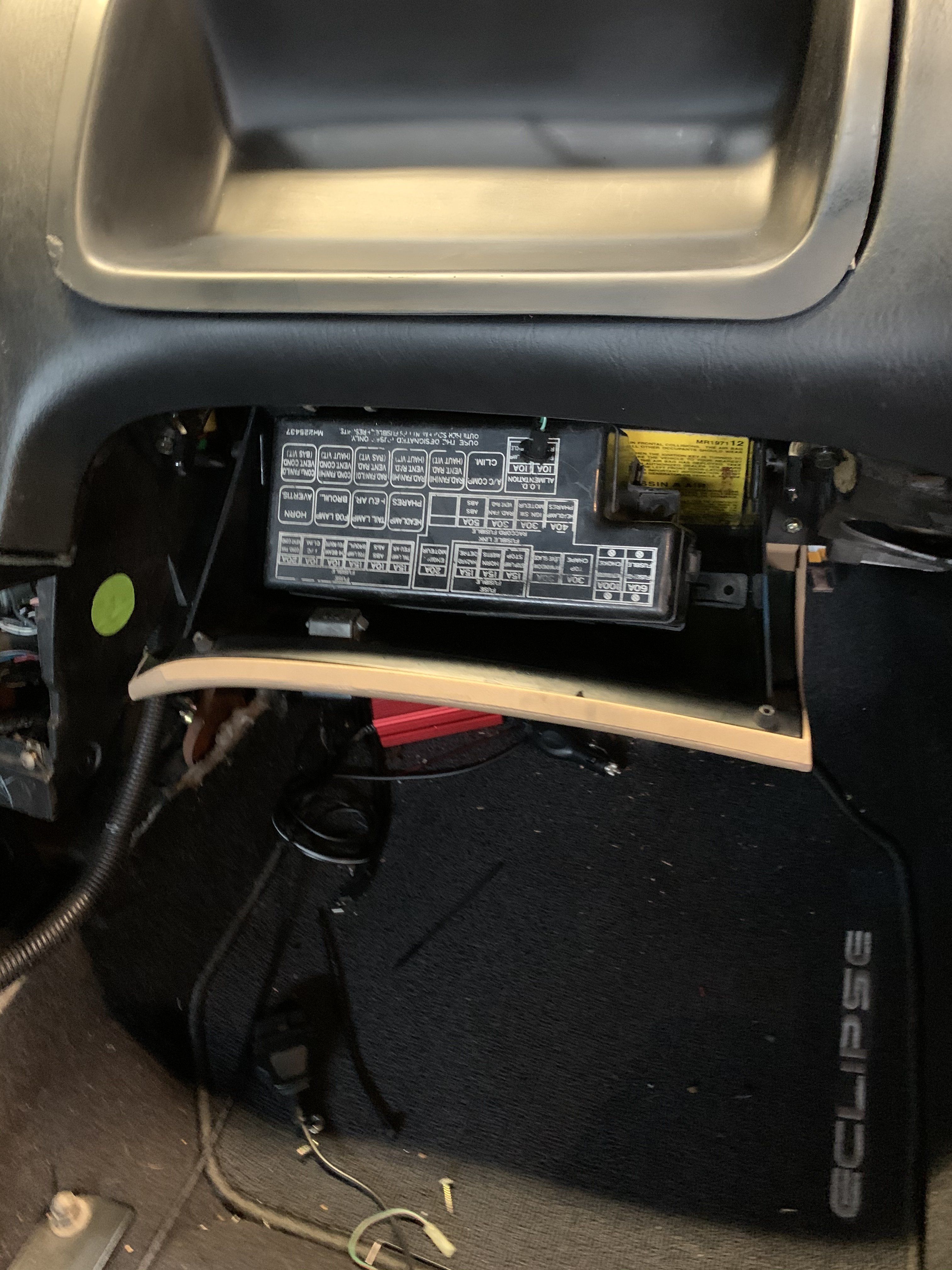

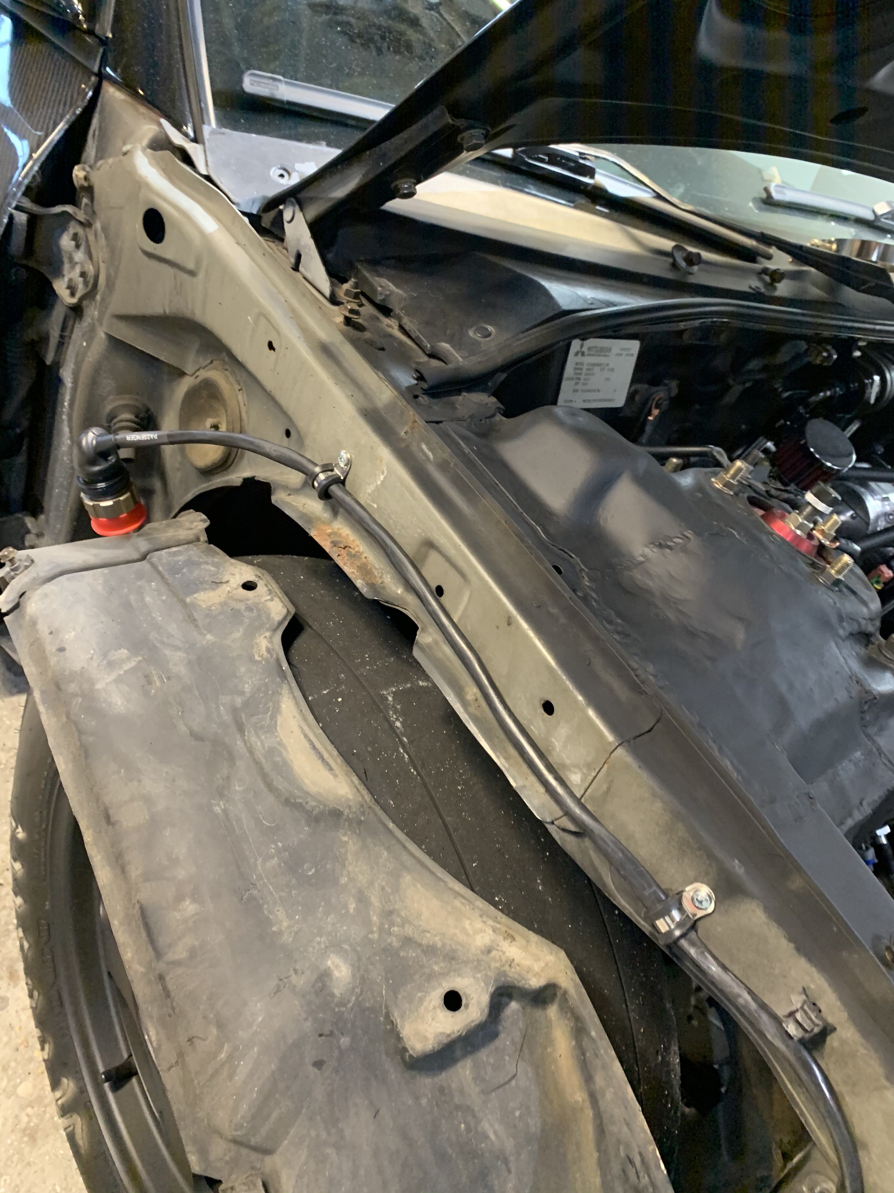

Then I ordered a new engine wiring harness and fuse box relocation from ohm racing

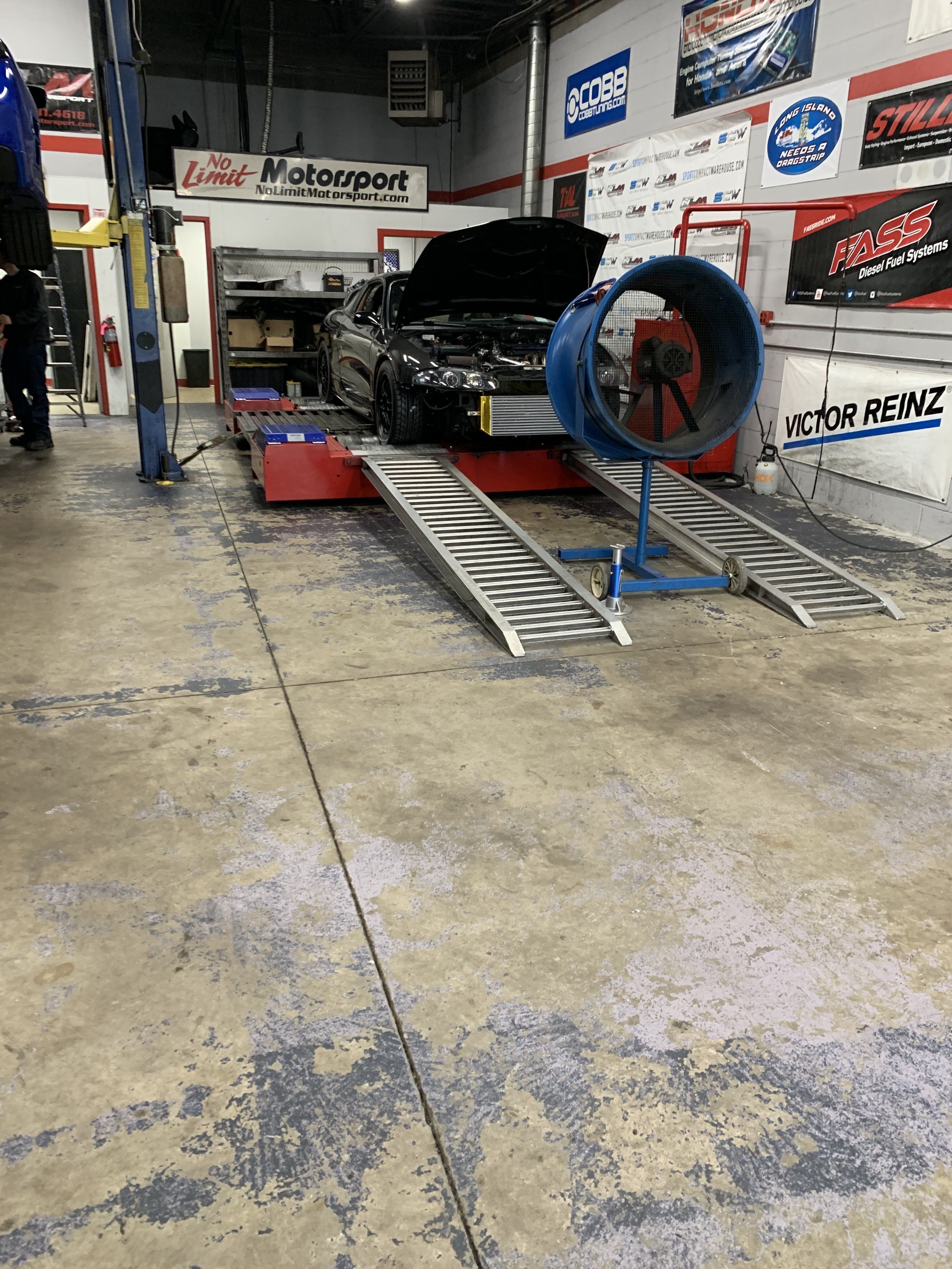

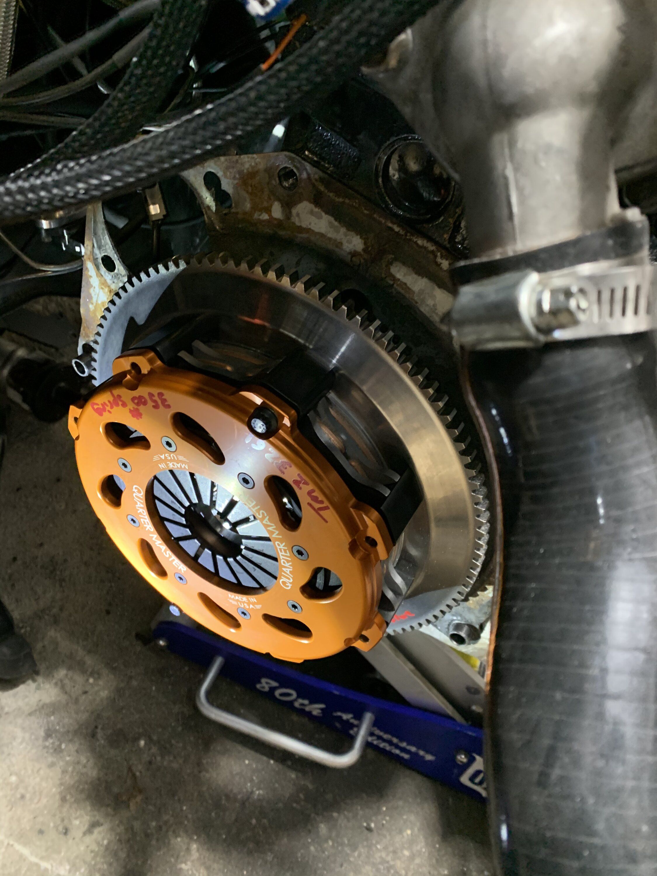

WHAT!!! On stock gears! I have been threw 5 transmissions. Boost by gear? Or just a soft launch? I’ll shoot you a personal message. Don’t wanna ruin your thread with all these questions.

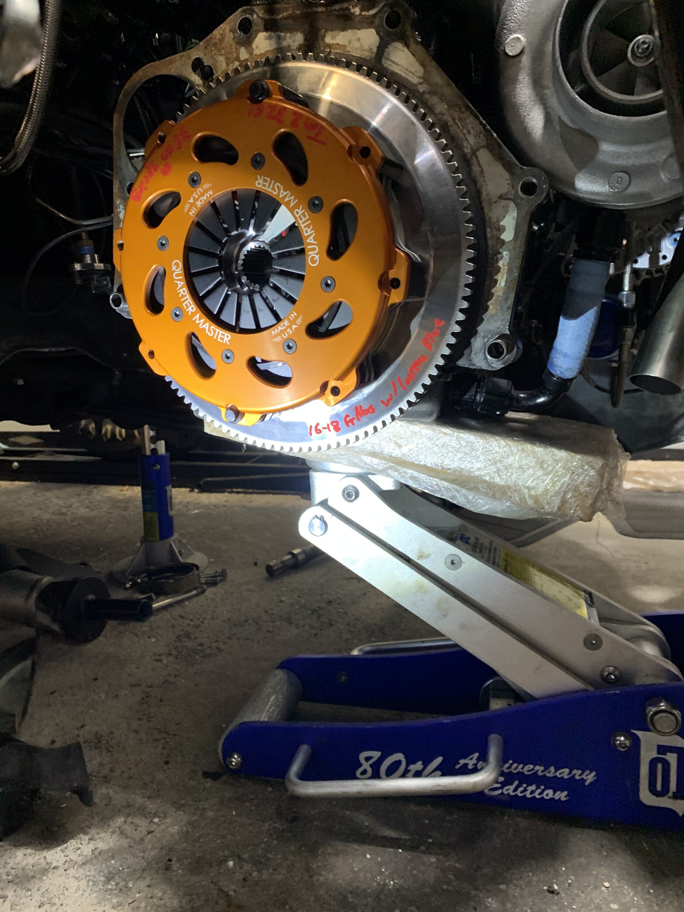

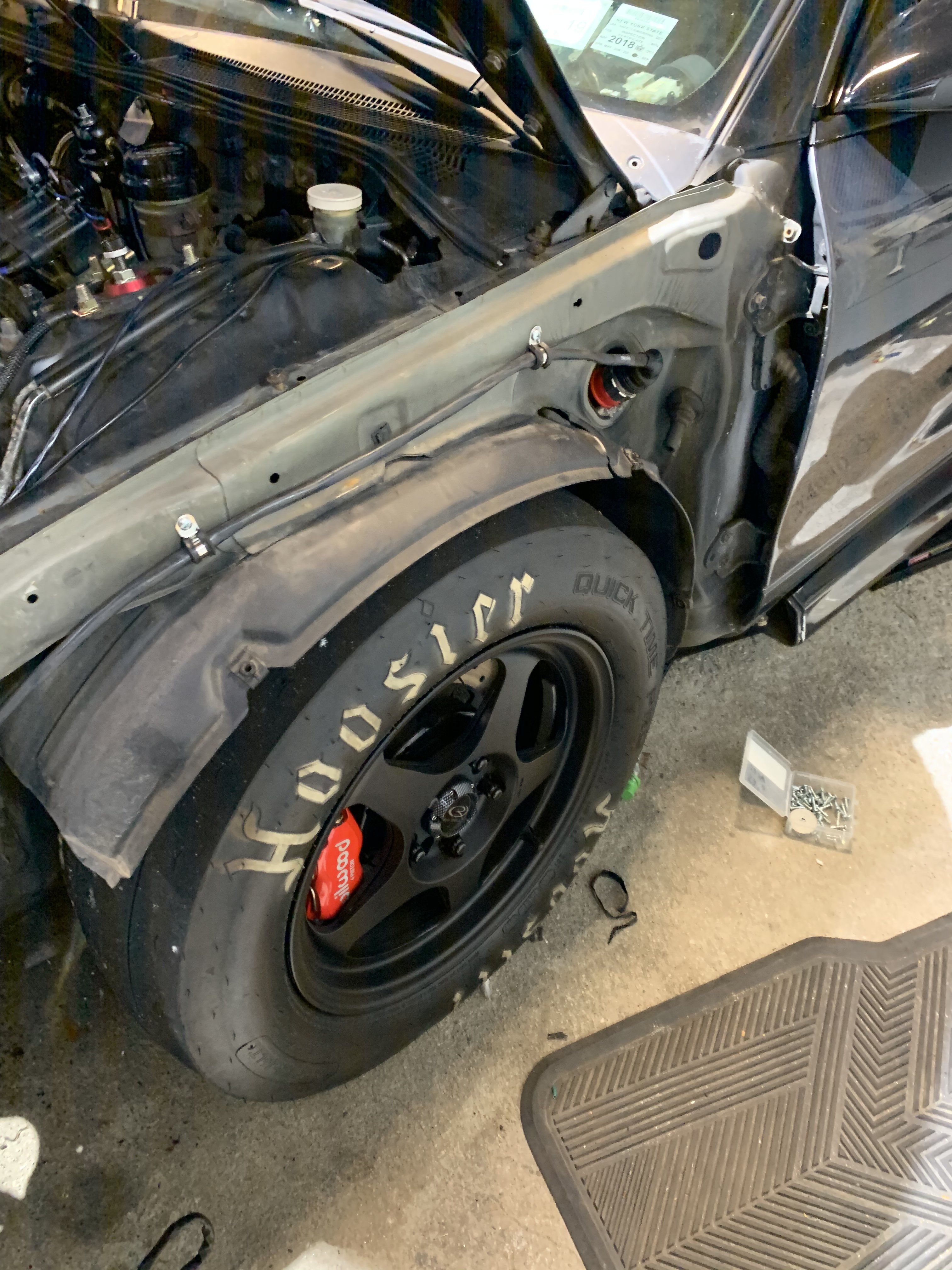

Well I believe that Jack's transmission, treats the gears, but they're still stock gears. I really don't launch soft. I usually have a 1.4-1.5 60 foot. I do use Hoosier qtps and a staging brake. I use ecm link anti lag at around 5500(dont remember exactly might be 5250) and use boost by gear. By 3rd gear I'm hitting 32-34psi.
