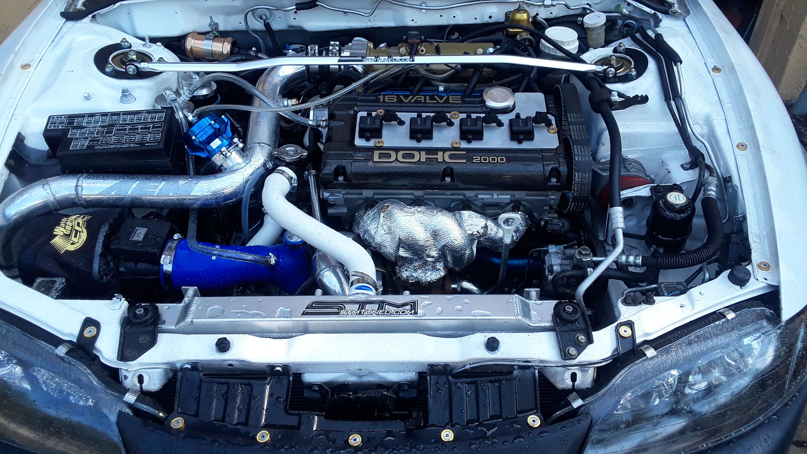

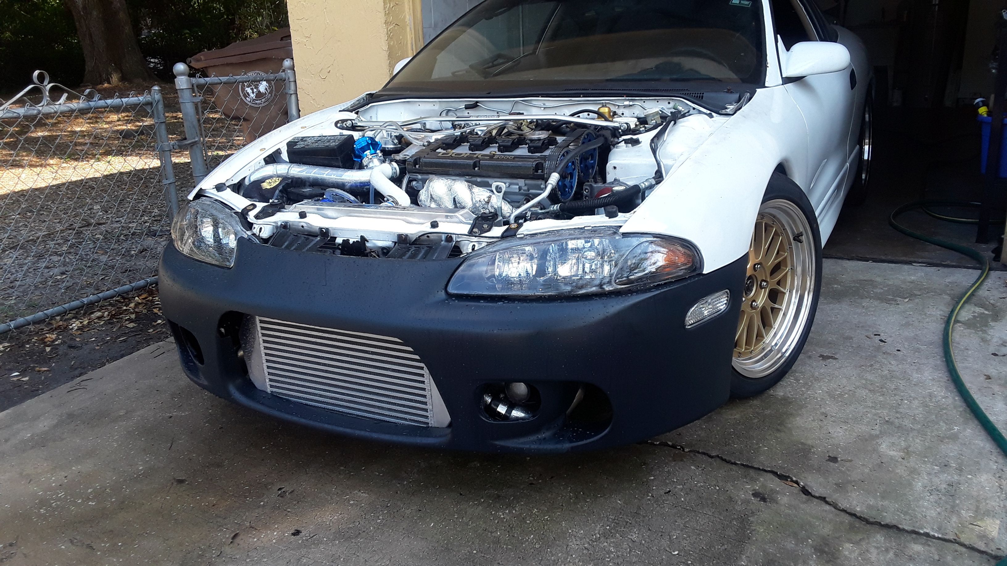

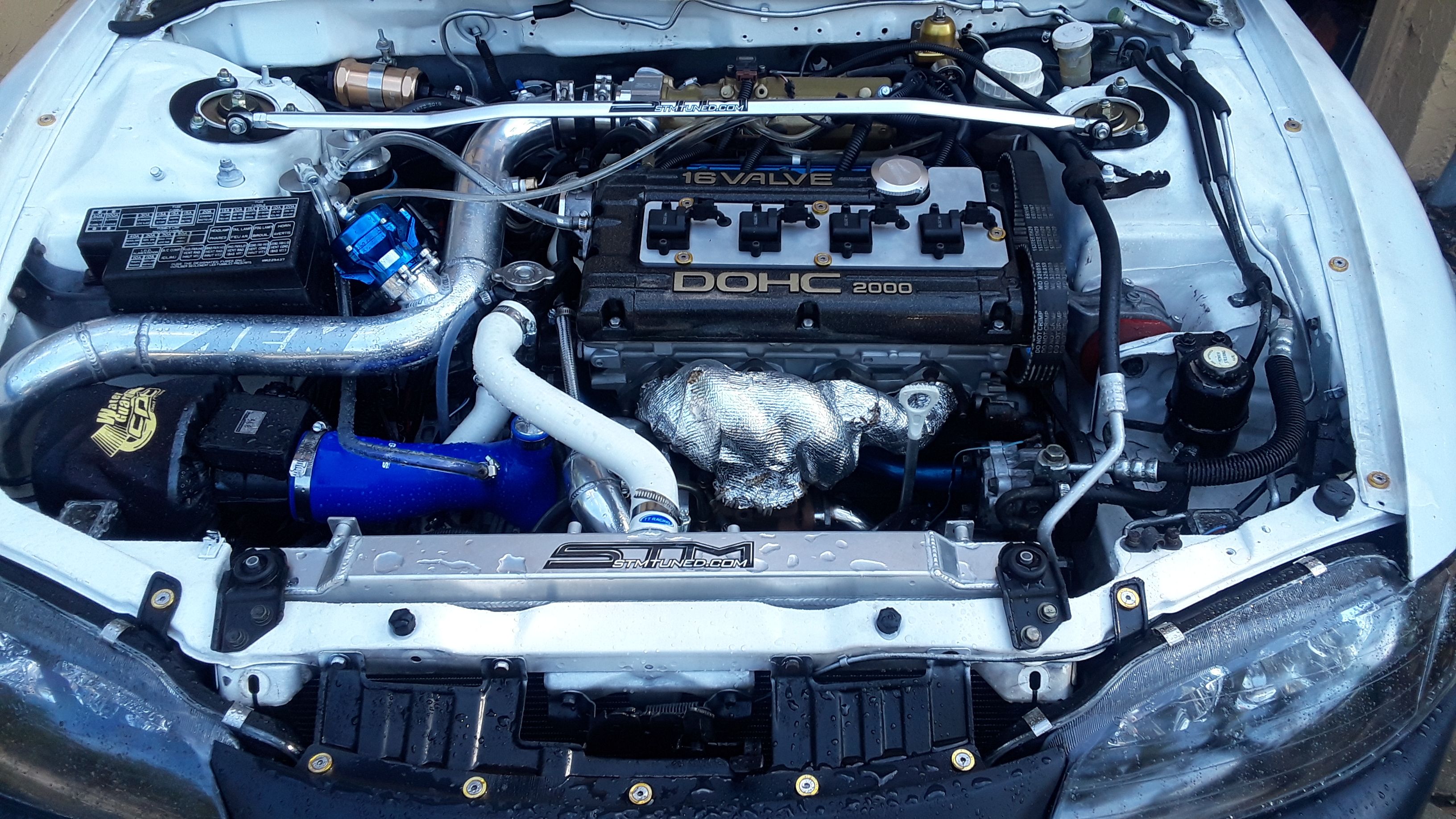

Fully built 2g
Trans: lsd insert red line gear fluid
Engine: kiggley racing oil regulator 264 intake came 272 exhaust cam bc single coil springs stock retainers cam gears +1 retard -3 arp studs ported stock intake mani and ported Tb flange. MLS head gasket evo 8 stock pistons with extra ceramic coatings on dome side skirts and ring grooves fill float scat forge rods arms bolts arp mai. Studs stock crank acl rod bearings and coated main bearings oil gallery Mods all 3
Bs delete new oil pump water pump from GMb. Stage 4 clutch with 10lbs flywheel and arp flywheel bolts arp crank pulley bolt arp cam gear bolt ID 1000cc injectors 20g turbo freddy FM evo 8 intercooler 70m tb aem watermeth kit intercooler sprayer 2 catch cans with check valve salvo 400 fuel lab filter and regulator 2 row racing radiator all silicone hoses and slim fan shroud evo 8 stock maf blox air filter coated intake and exhaust valves from super tech and valve seals 2g black box ecu full coilovers and strut bars to rear and bottom TSX front calipers with Outlander 14in drill slot rotors and new ac system and upgraded fuel rail and gaugea
