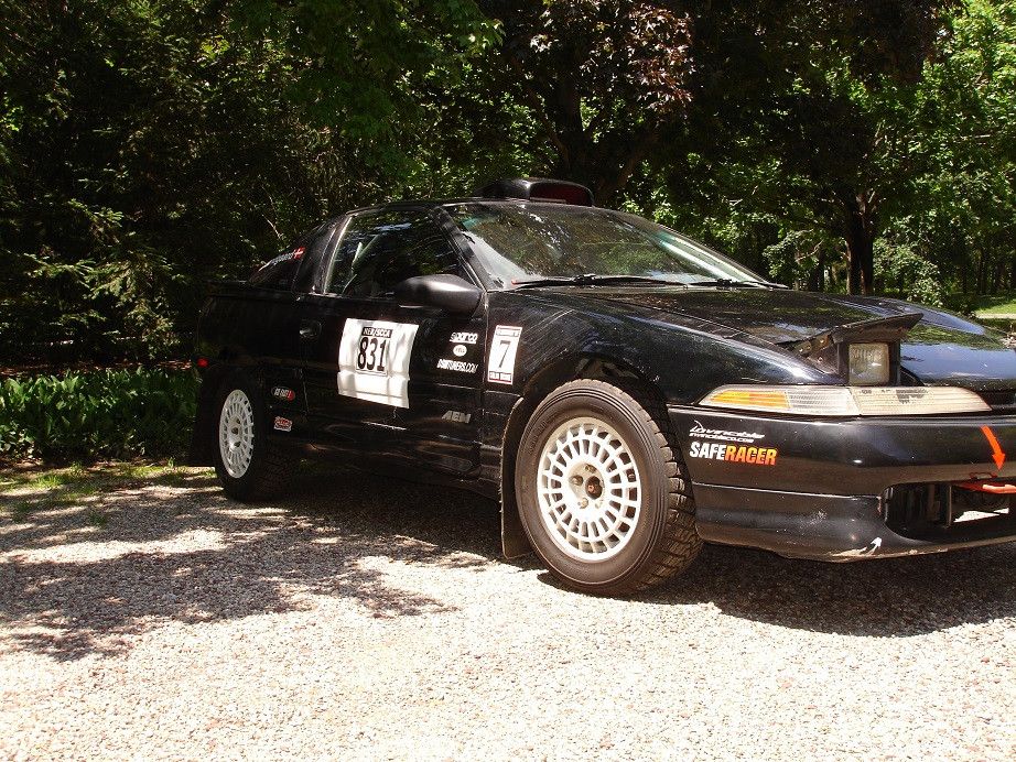

Got her out in the sun for a little bit, not good lighting for pictures... But since I just got my DSMTuners.com stickers, I had to take one!

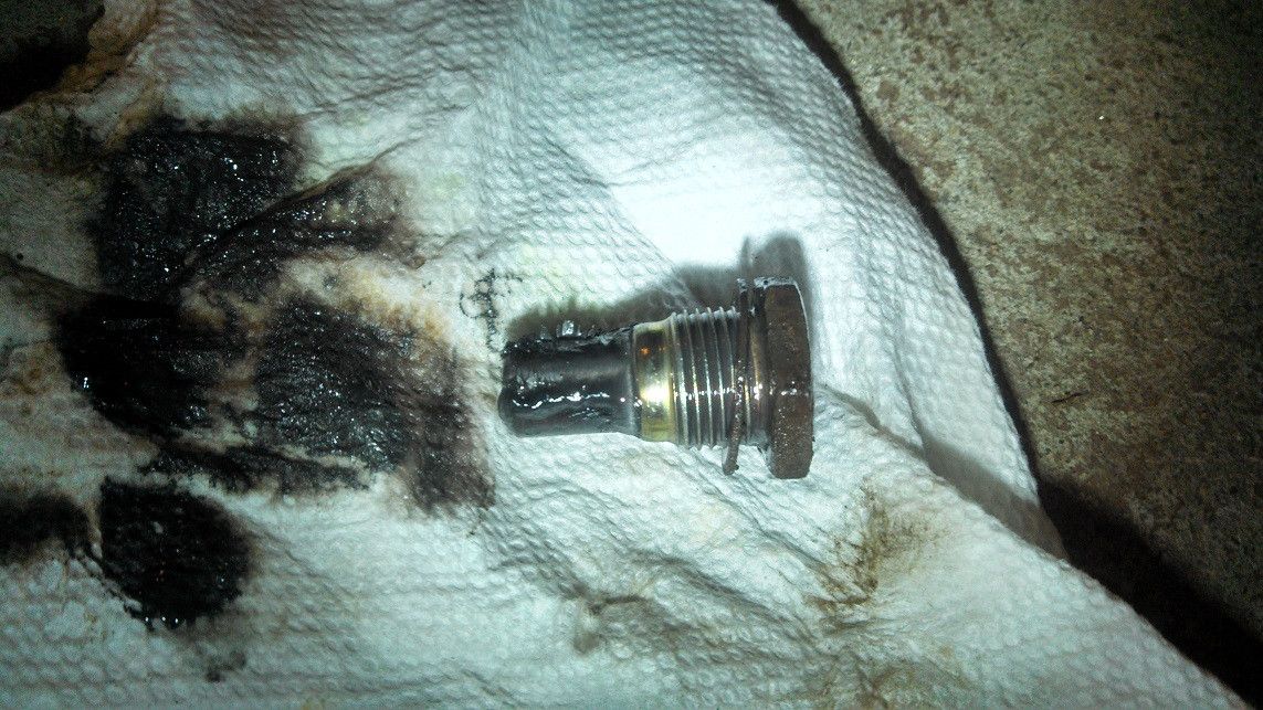

Nasty magnetic sludge on the drain plug.

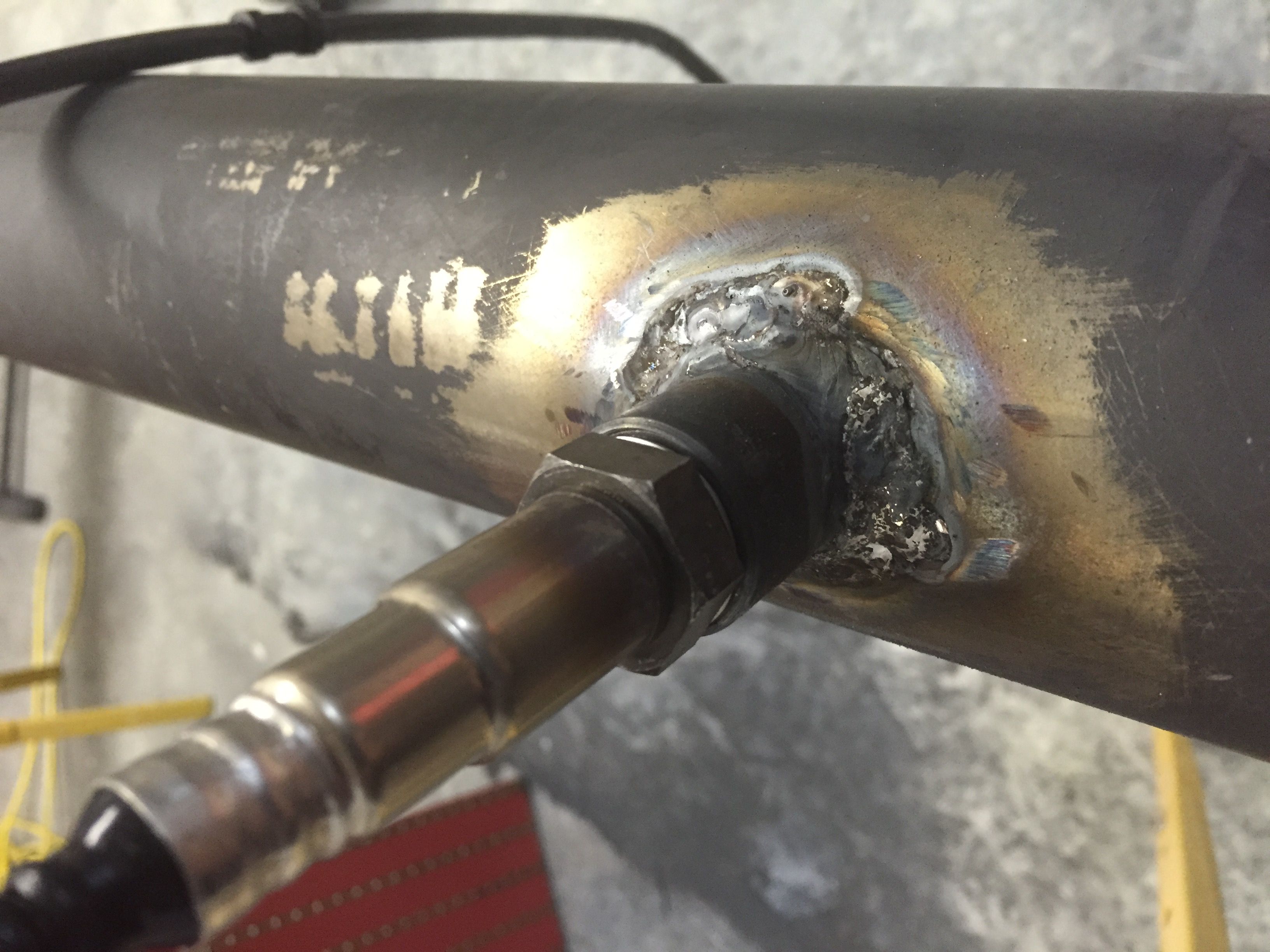

Wideband o2 bung welded.

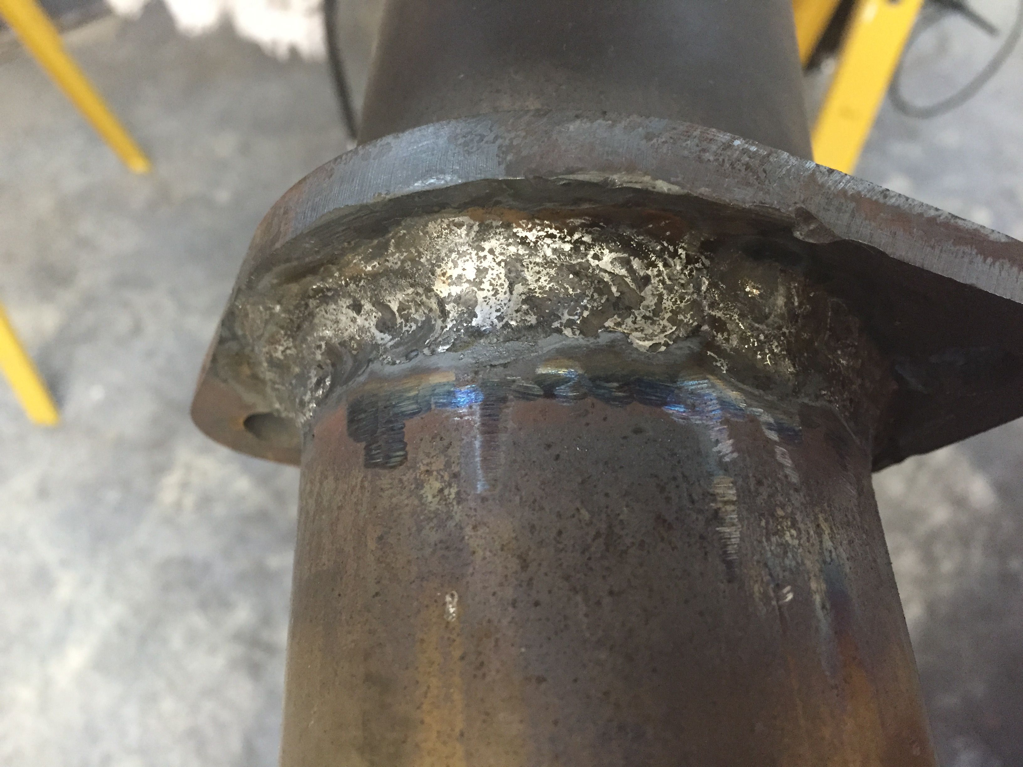

The exhaust on the car was done terribly by a shop when the previous owner had the car. The shop gave him his money back and refused to fix it. It looks like it was their first time welding. I did a leak check on the exhaust system by jamming my boost leak checker into the down pipe and taping a plastic bag to the exhaust tip. I could only put a few psi into the pipe but that is probably enough to find major leaks. What I found was swiss cheese.
I priced out new exhaust parts and was around $250-$300. Since the exhaust could probably be fixed and I'm trying to fight my tendency to put too much money in cars, I decided to fix the welds. I used 309 wire since the joints were stainless to mild steel. I used my new Everlast iTig-200T which I'm very impressed with. It's working very well and the price versus features is unbelievable. The only problem is that there is a gas leak inside the unit so it leaks a little Argon when I'm not welding. It's a bit of a problem because the Argon isn't free and there's an Argon shortage.
I'm teaching myself to weld and I'm fairly happy with the results. They're not professional looking but they aren't leaking.

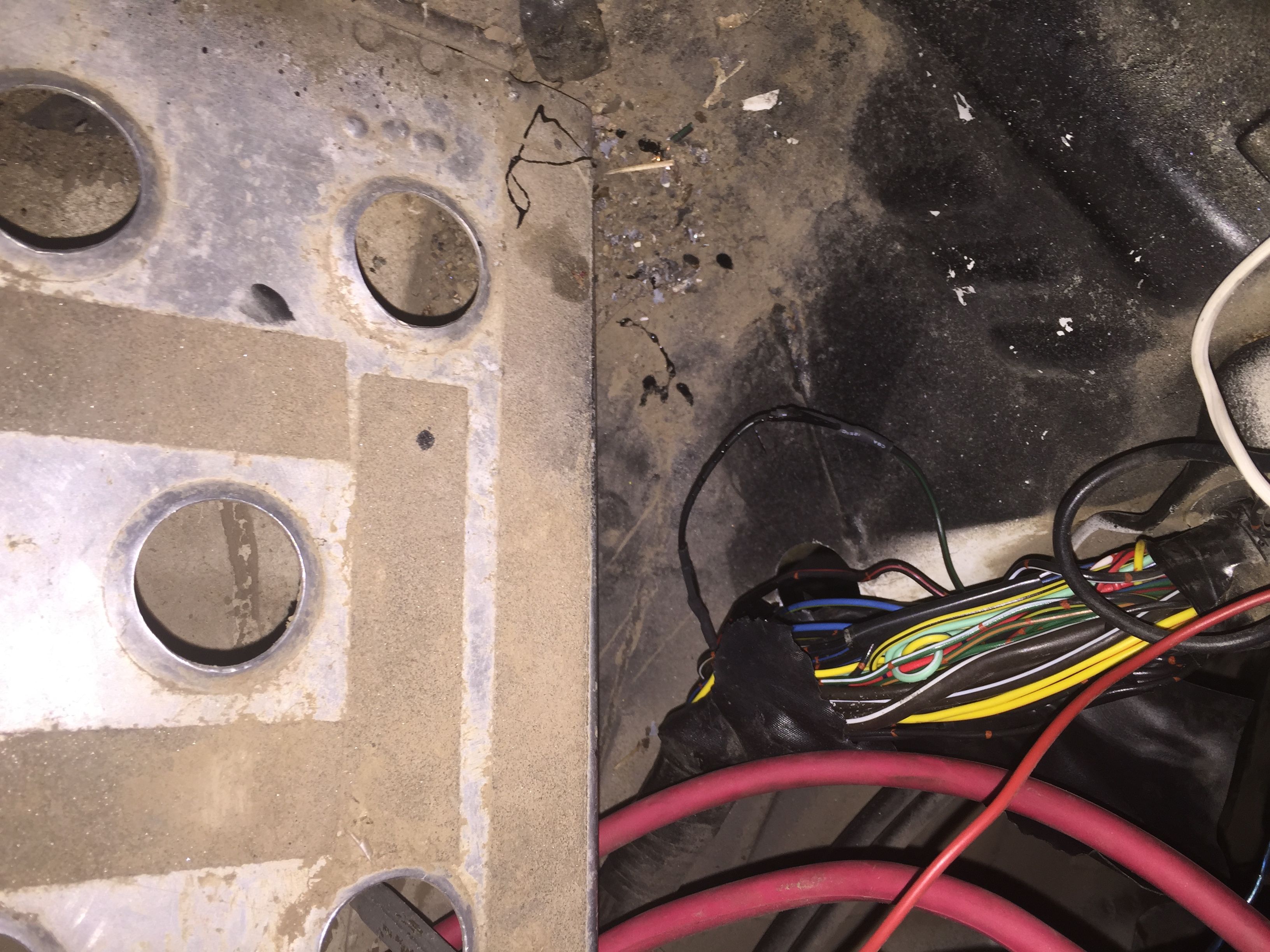

I cut a 1.25 inch hole into the passenger foot well. I should have checked where my pilot hole ended up when I drilled it from under the car. I ended up nicking the wiring harness so I had to repair a few wires head first down in the wheel well. A couple minutes of checking could have saved me a lot of headache.

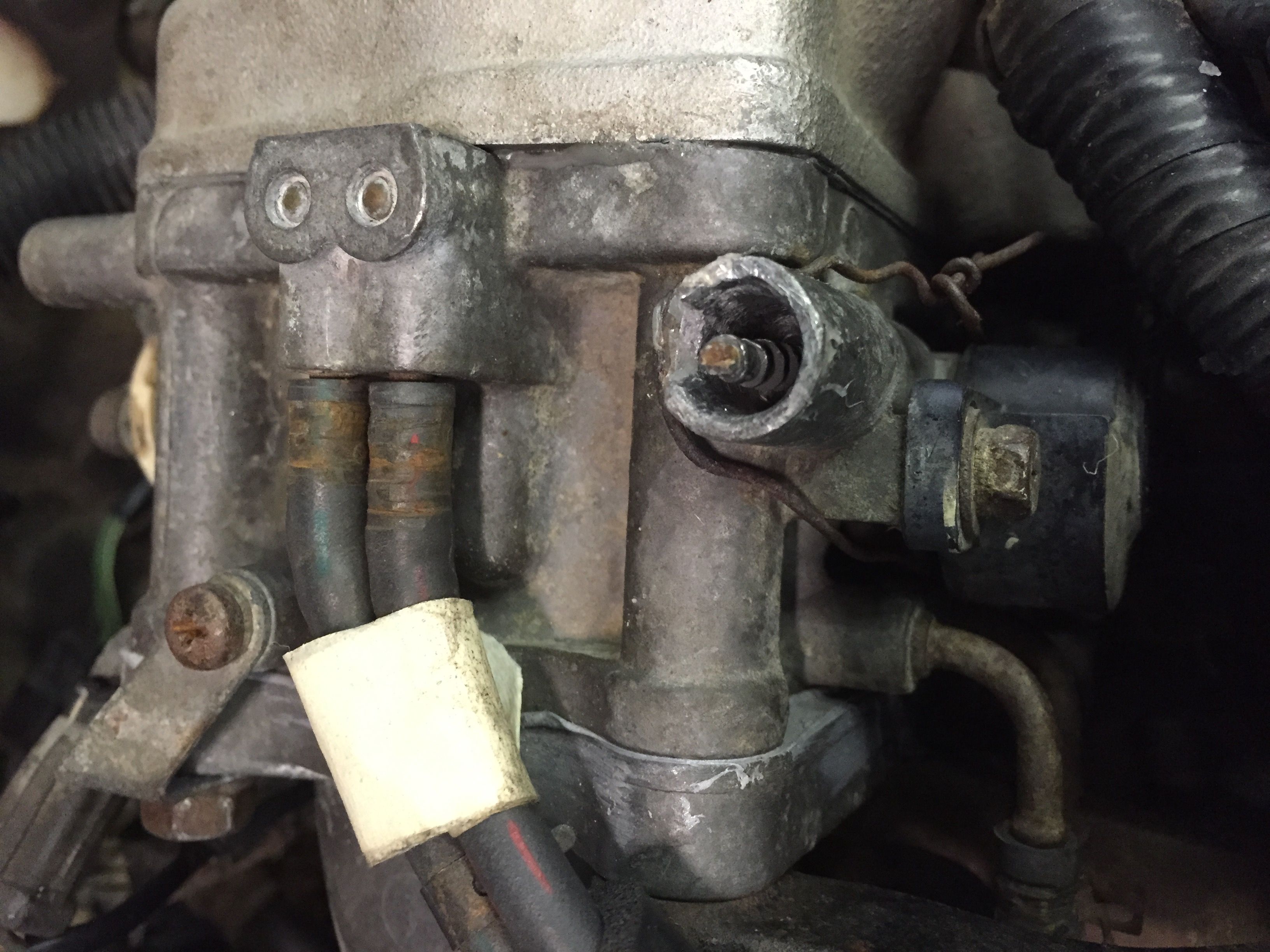

When I got home I looked into lowering the idle speed. The hole for the BISS (Base Idle Set Screw) was filled in with silicone and this is what I found when I dug it out:
I'm not exactly sure what I'm looking at but I believe it's a broken wood screw. I guess I'll try to remove it and see if a proper BISS will fit.

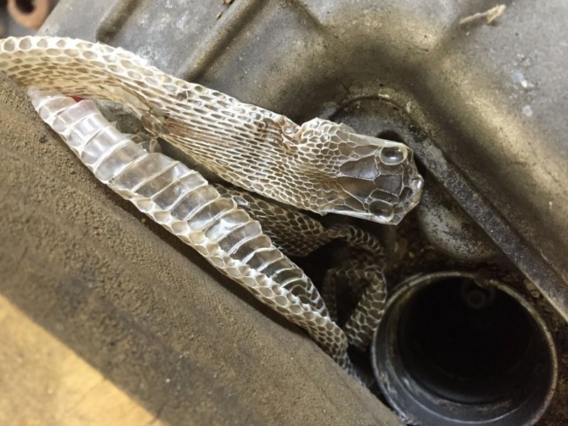

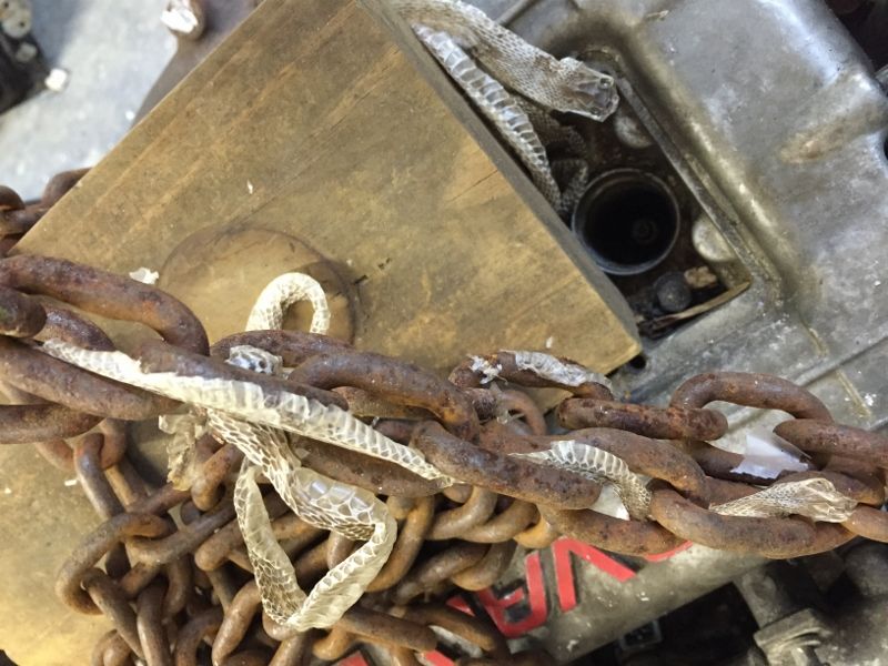

An ice racer friend of mine changed his race plans and sold me his Talon stuff super cheap. The stuff includes a complete car, hood, hatch, two doors, front and rear bumpers, rims, and a motor. Since I need to fix the throttle body I took tarp off the motor and this is what I found:
It's the most bad-ass spare engine ever!
