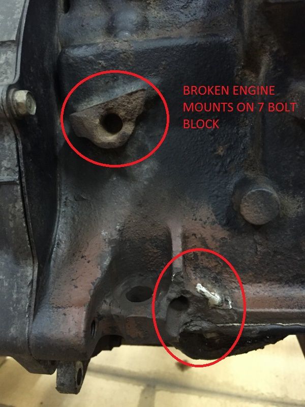

I'm wondering what to do about the broken front engine mount.

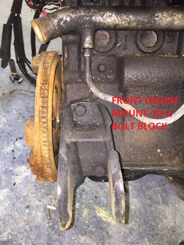

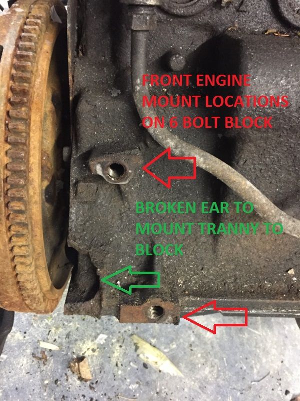

Here are pictures of the broken mounting locations on the block (it's a 7-bolt) along with pictures of how a 6-bolt looks.

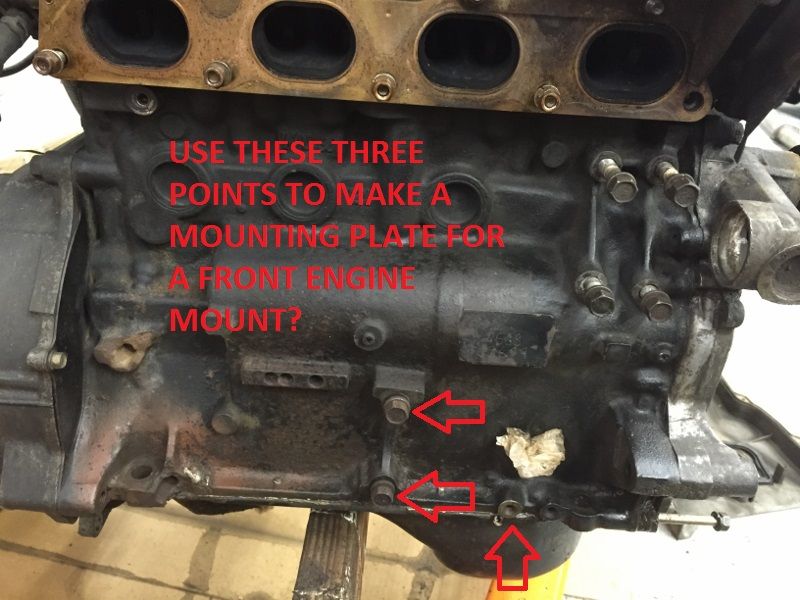

I was thinking of using the three locations in the picture below to make a plate extending towards where the engine mount should be. I talked with a rally friend who has done this before to a Talon block but it was a while ago.
Has anyone done this modification before?

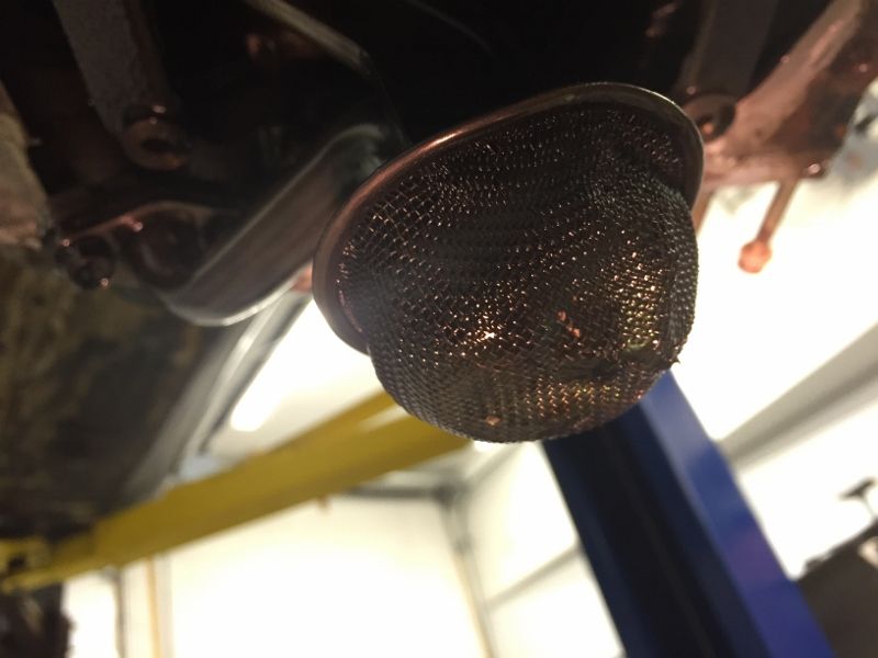

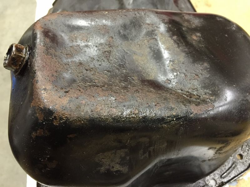

The oil pan was bashed in pretty good so I pulled it off to try to bang it out.
The pan was deformed enough to hit the oil pickup screen and wear a hole in it. I found a couple metal shavings and RTV stuck in the hole of the screen. I'm convinced the screen is important.
I ended up ordering a new strainer from STM Tuned who happens to be in New York State like me: http://www.streettunedmotorsports.com/parts/oem_dsm_oil_pick_up_strainer.htm
I'd get a new oil pan but the dealer wants over $200 and it doesn't look like any aftermarket companies make a cheap replacement for the 7-bolt engine. Does anyone know of one? I found 6-bolts but no 7-bolts?

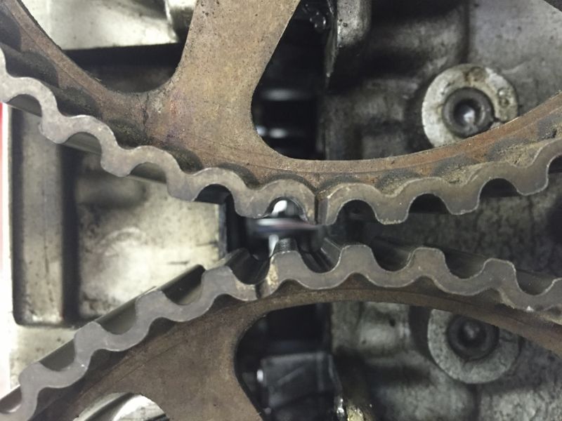

I found that the timing was incorrect when I checked it:
One interesting side effect of this timing error was that the engine would not rotate smoothly by hand. There were hard sections and easy sections when rotating it. I reset the timing with the same components and the rotation was much smoother.
