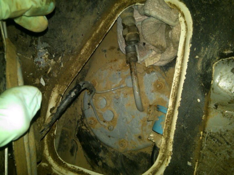

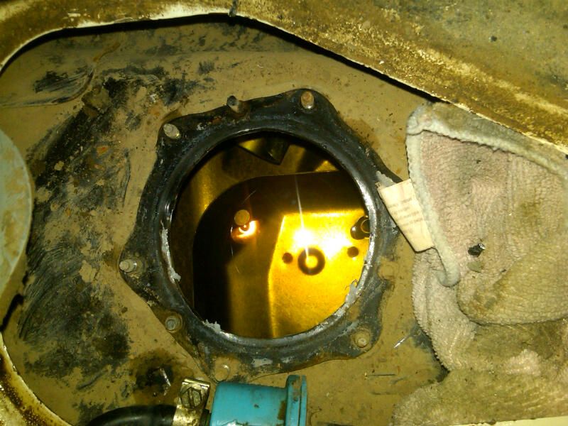

Decided to tackle the Fuel Pump yesterday.
Everyone always has mean words to say about the Fuel Fitting... Mine was surprisingly easy to undo
Naturally, this being a much used Rally car the only logical conclusion is that someone's already done the hard job of undoing it for the first time.
Fuel looks clean, no debris down there

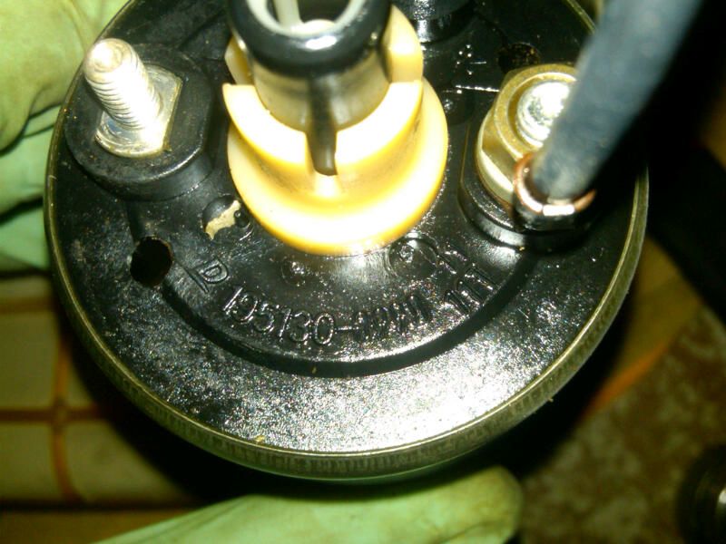

Looks like there was a Denso 150lph pump installed. Don't know how long its been in use, but I'll be carting it around to races incase the new Walbro 190lph fails.
