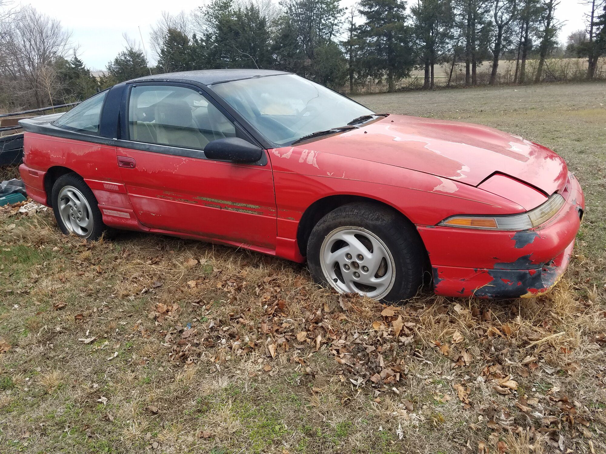

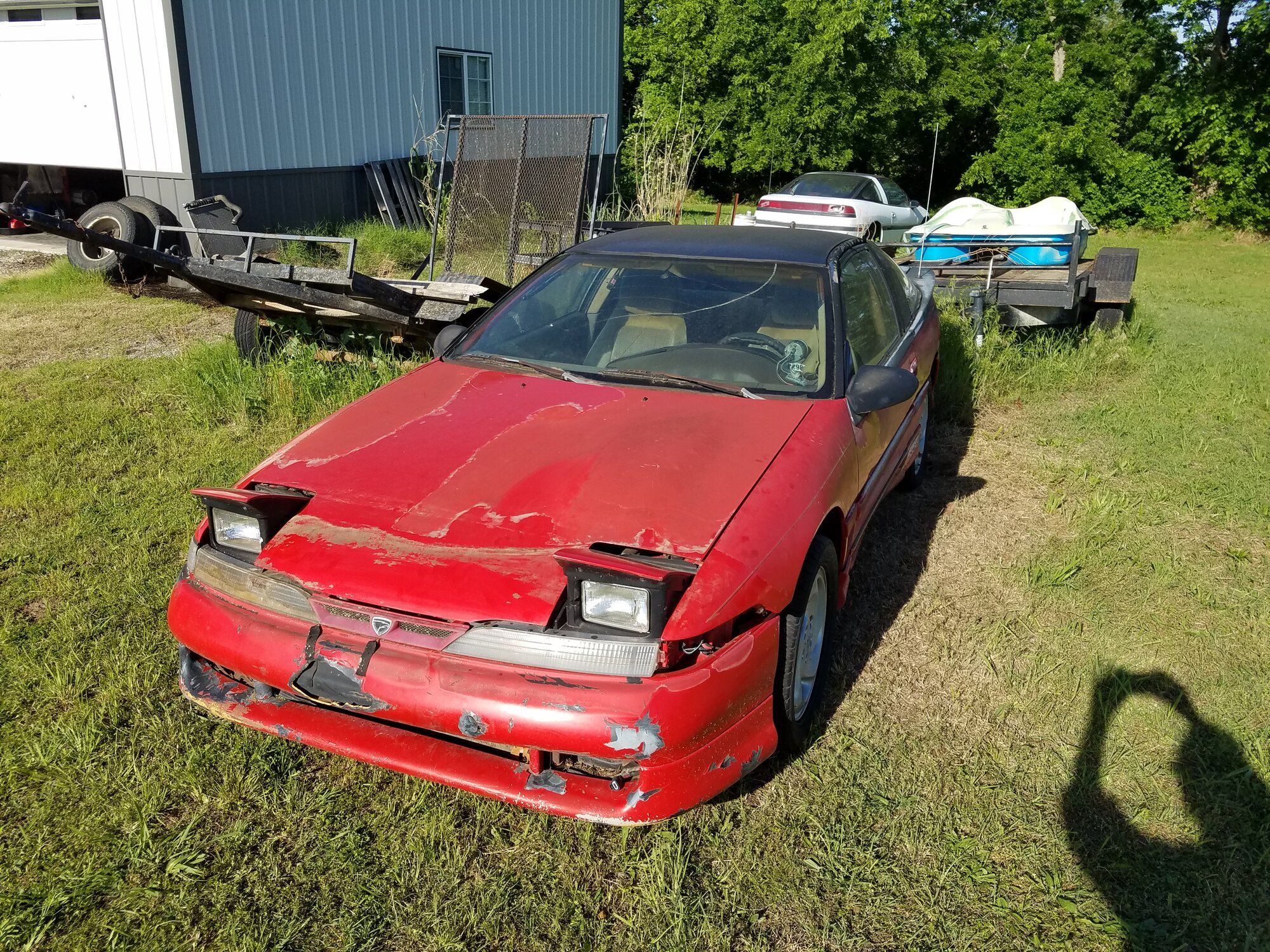

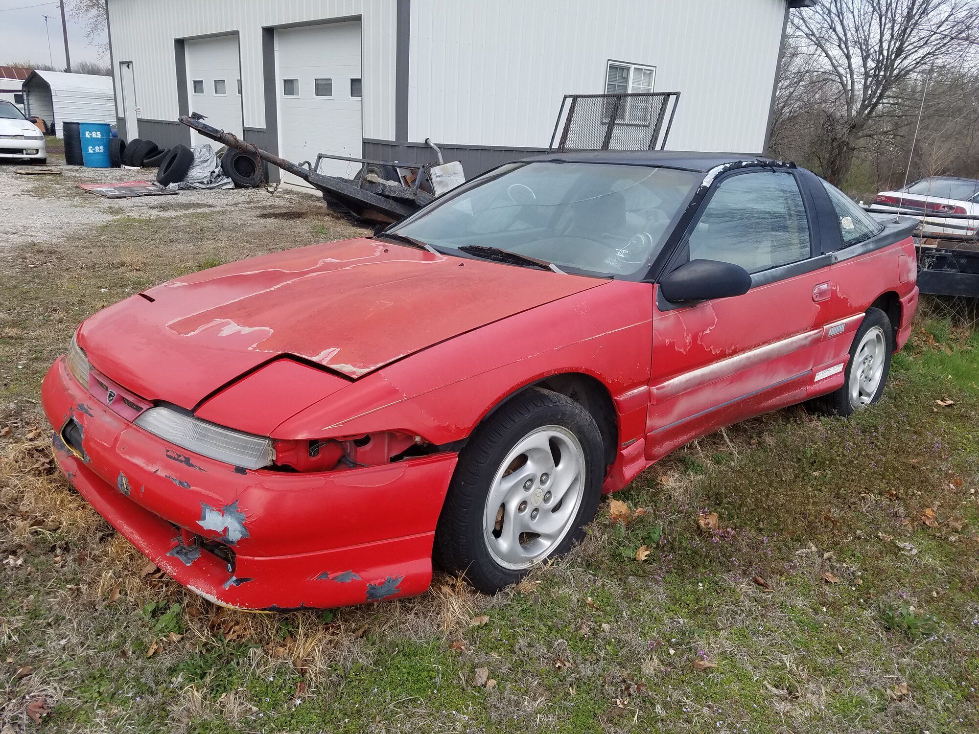

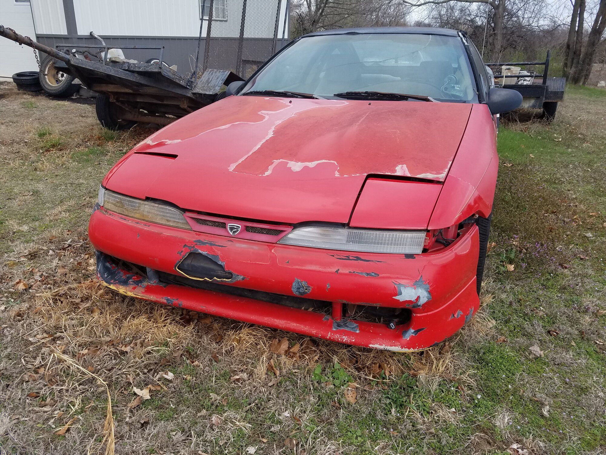

I picked up this car from a local man. He said it ran, just not good when he parked it 10 years ago. Ahe needs a bit of TLC and rare parts but I think she can run the streets again!

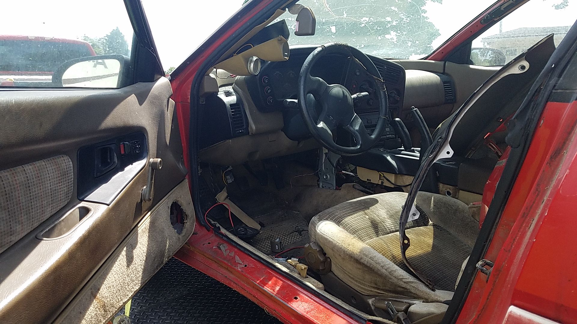

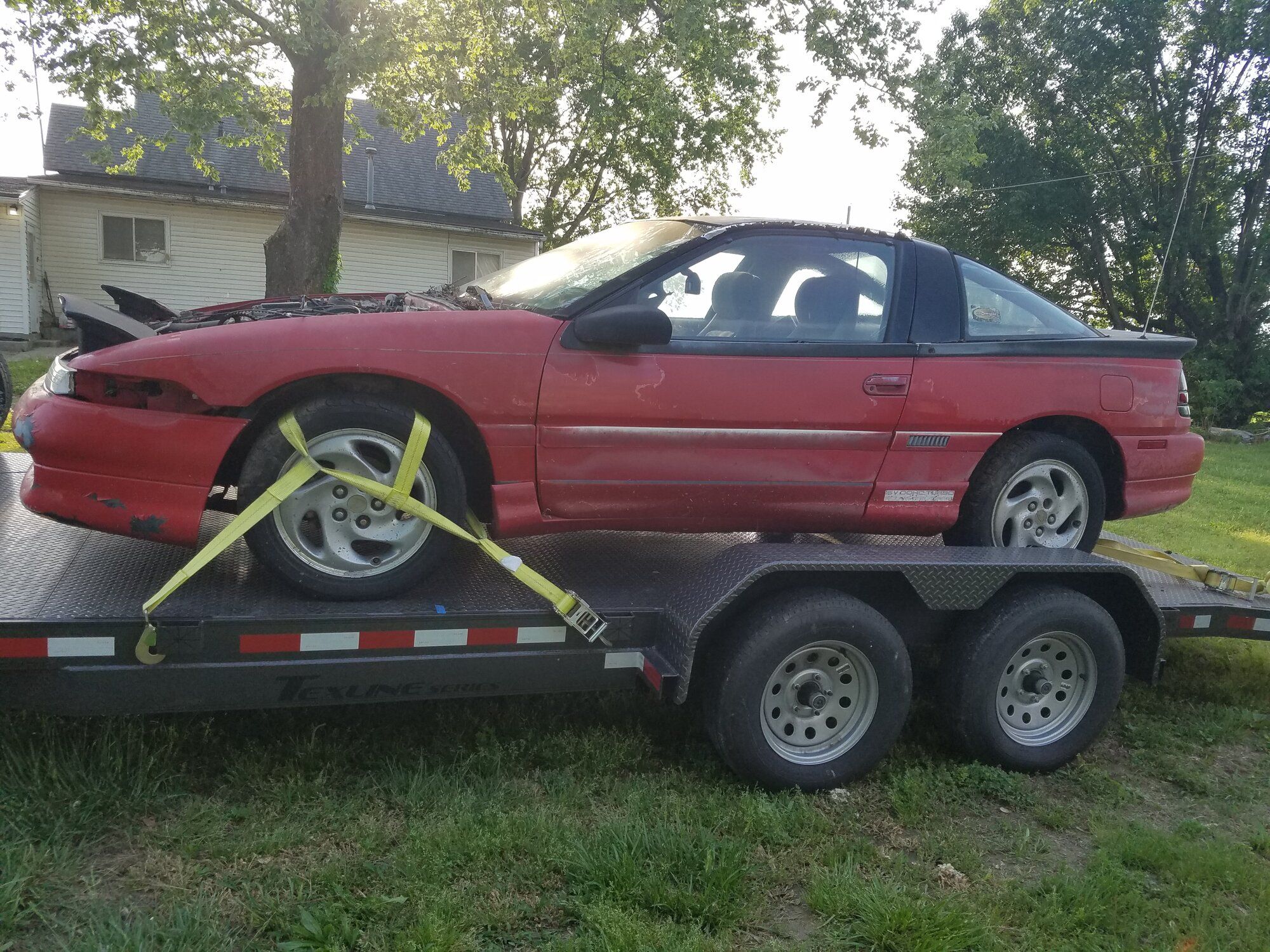

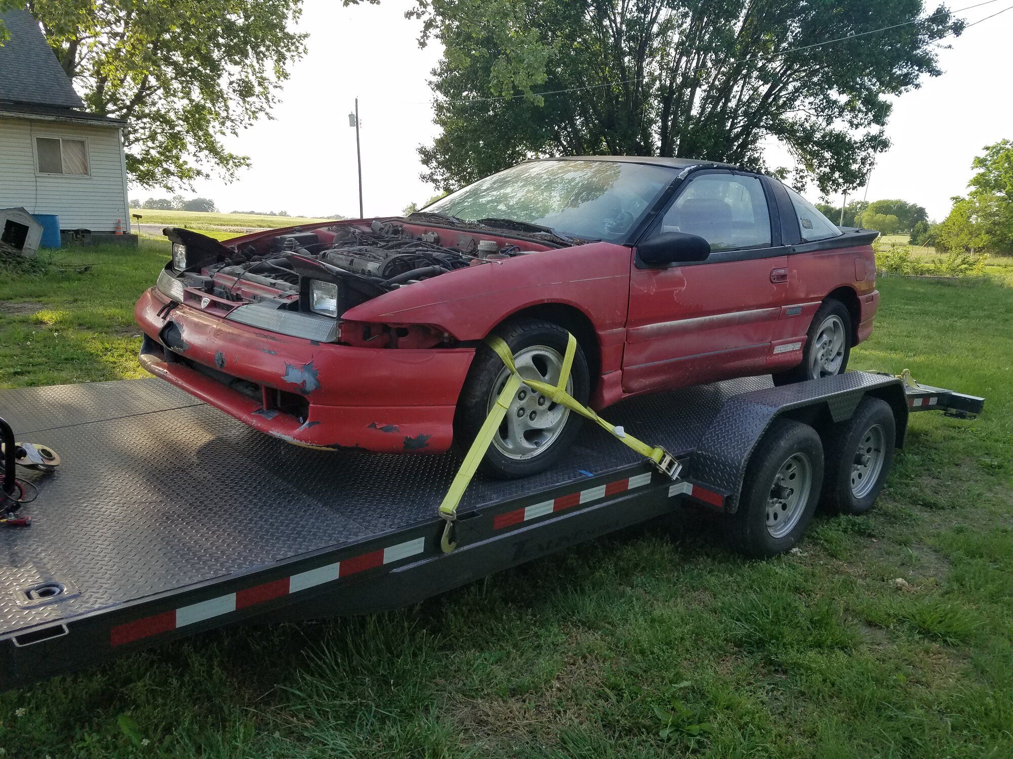

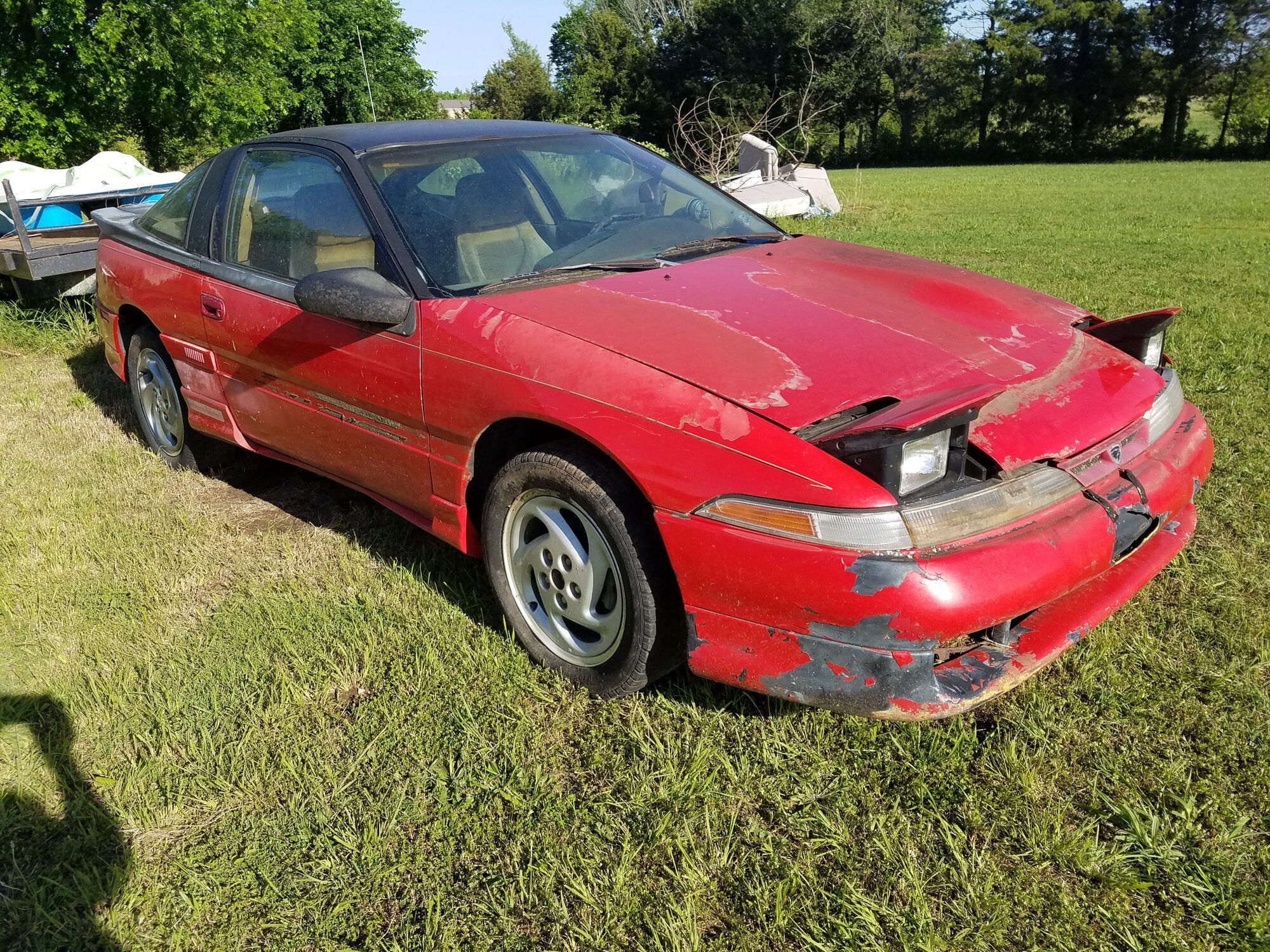

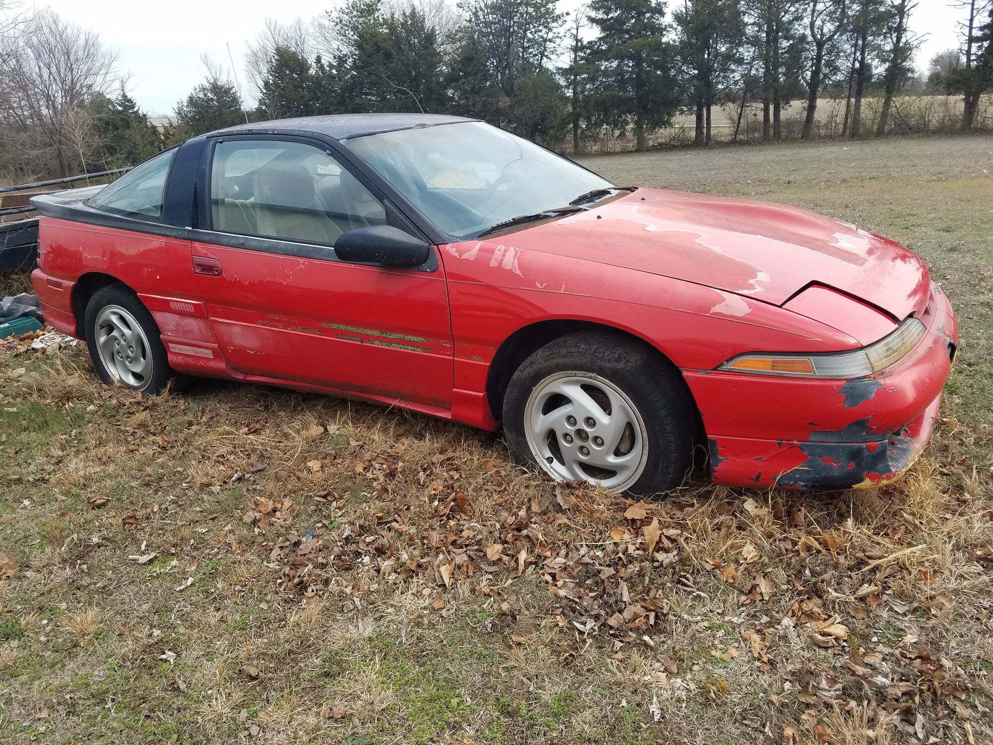

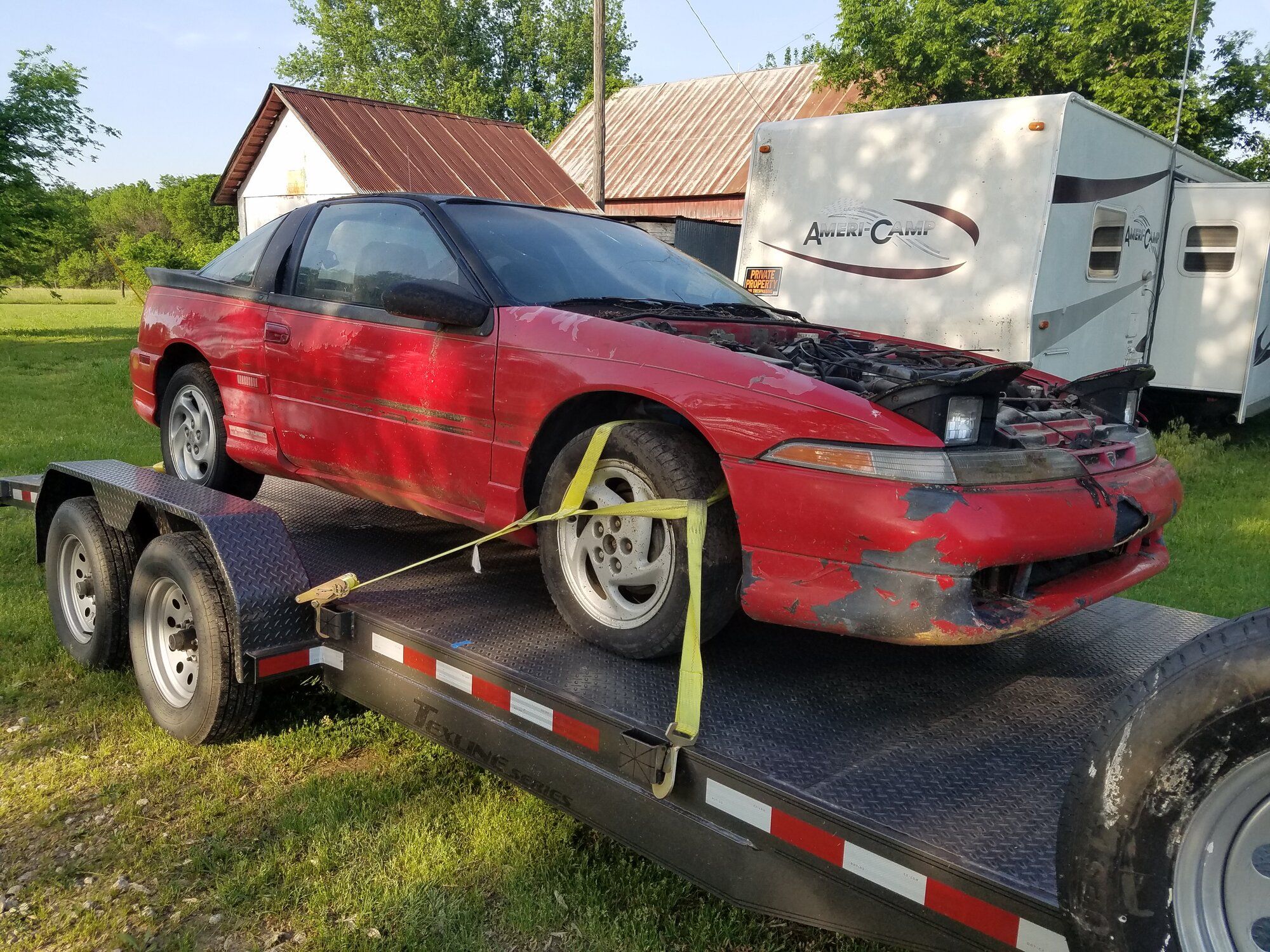

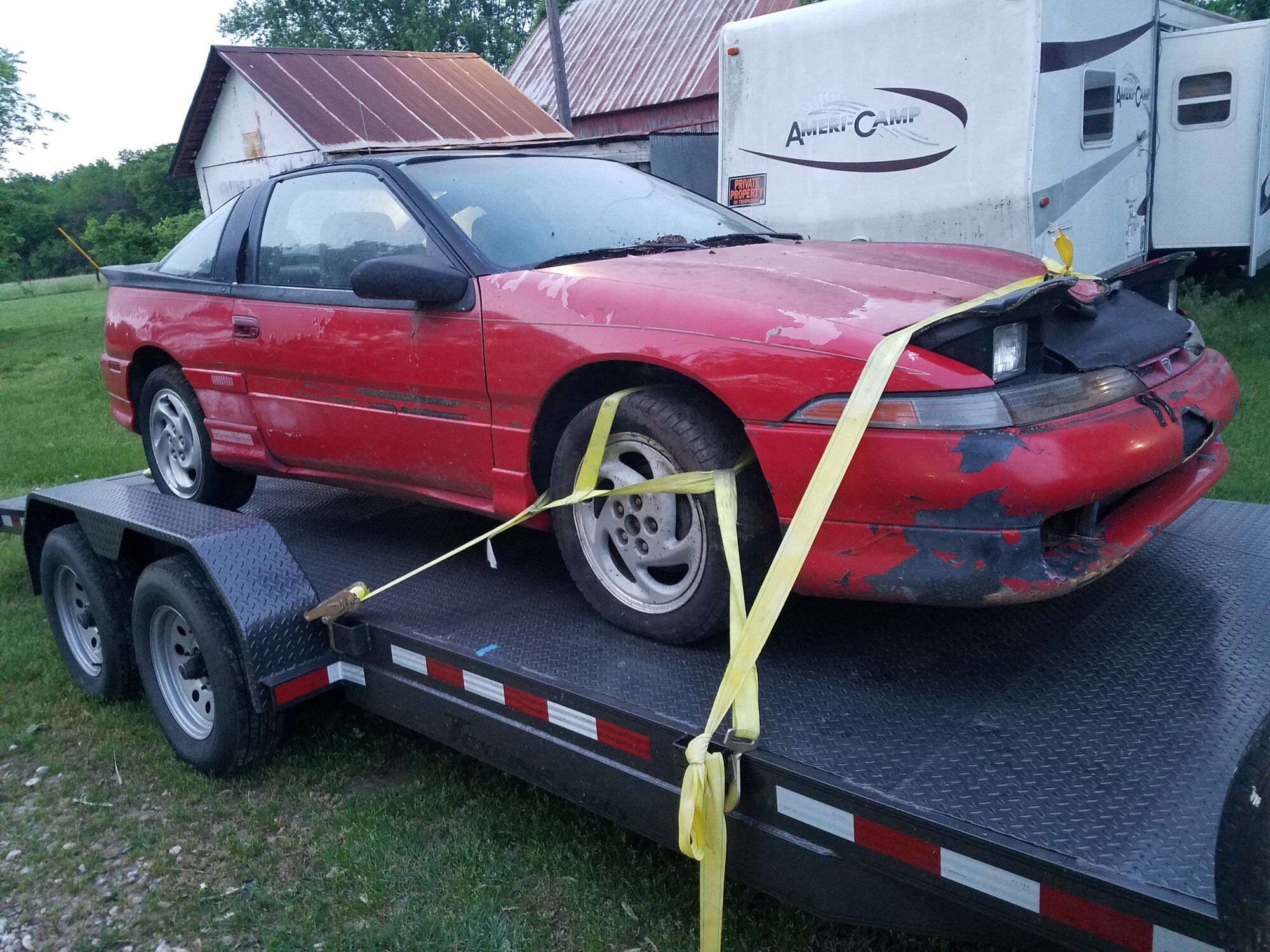

Had a person get ahold of me and asked me if I would be interested in this and after some picture swapping and talking, I went on a short trip with the trailer and brought her home. 1990TSI AWD.
She needs TLC.

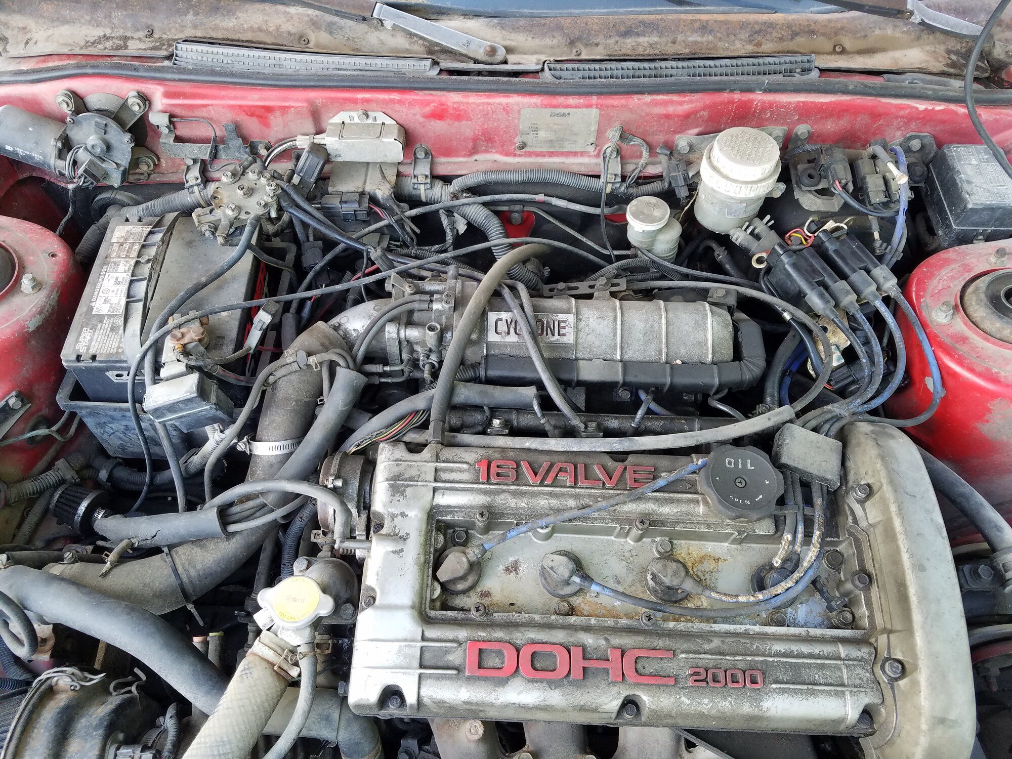

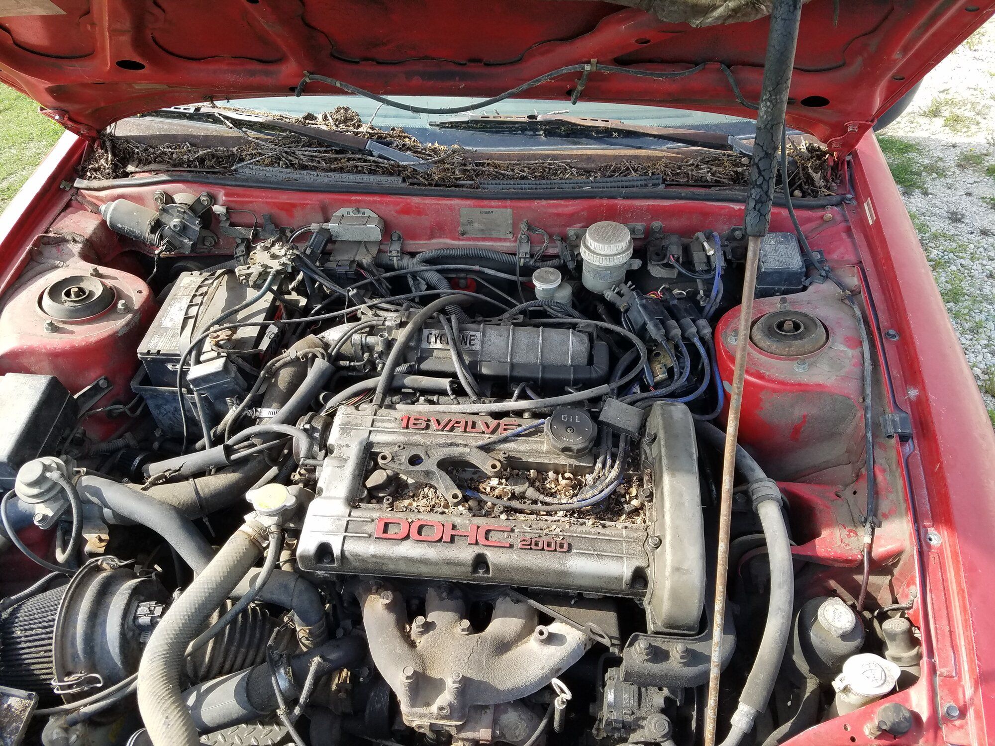

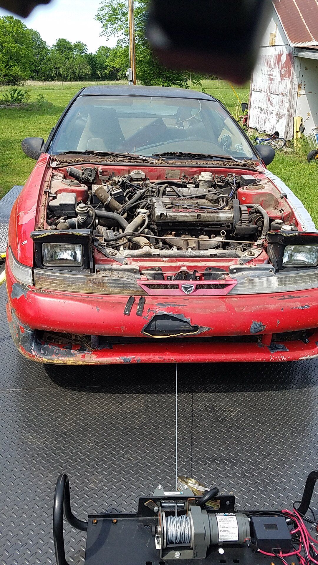

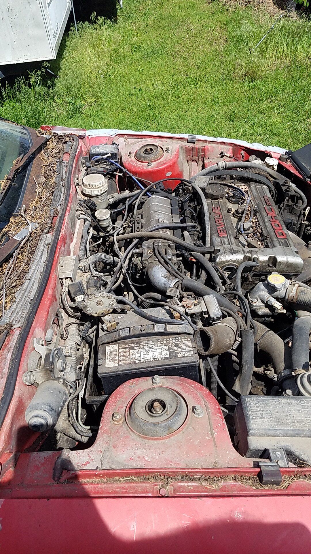

PTU, TPS, Intake cam gear were all missing but I am finding parts from other members to try and put her back together and get her to run. The PO stated it ran 10 years ago when parked but it didn't run good. I found the Knock Sensor completely void of the black goo and it has a non-functional Cyclone manifold on it. As I get time, I am putting all of those parts back on and plan on a timing job since the cam gear has been removed. Fingers crossed I can get her to run or I have wasted precious time.

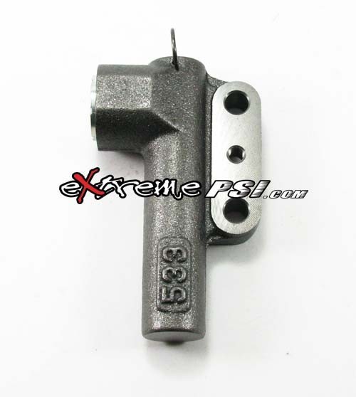

If it would quit raining here, I could START to take the front of the motor apart to do the thing that a lot of ppl hate to try. I did a timing/water pump job on my 90 GSX in the car and it wasn't as bad as I imagined. Not easy to get to but manageable. I bought a timing kit today, just need to get a tensioner and since they are MIA, I have to go with a aftermarket one. Do you have any opinions on 6 bolt timing tensioners? I have always just used OEM but now we all have to figure out something. :idontknow:
ExtremePSI has OEM 6 bolt tensioners in stock:
Are the Hyundai tensioners still available? I need to look in to that. I saw one on eBay a week or so ago, it was a combo oem Hyundai belt with an oem Hyundai tensioner and had comparisons to the Mitsubishi parts in the pics. Definitely some differences but I believe the listing said “made in the same plant as the mitsu parts” or something like that. I wonder if that’s a better second option than Gates would be? Or probably they are all discontinued also. I know there must be a lot of folks out there that use Gates.

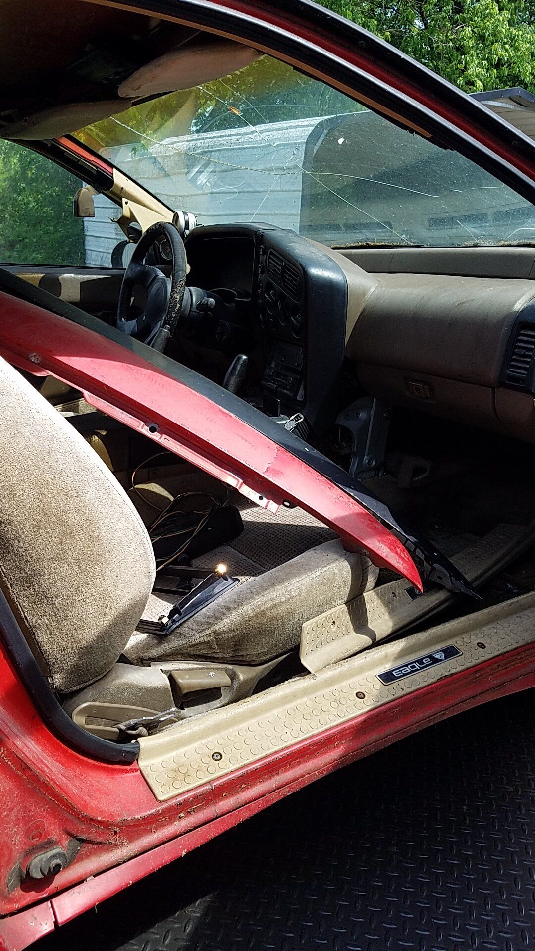

Well I got 1 red 90 Talon going again so I went out to check on the other one and had some water on the floor (where my timing components were at) so I sealed up the windshield (it is cracked) with silicone and took my parts inside to make sure they didn't get any moisture on them. Glad I felt like checking on her. She can be a good car too!!!
