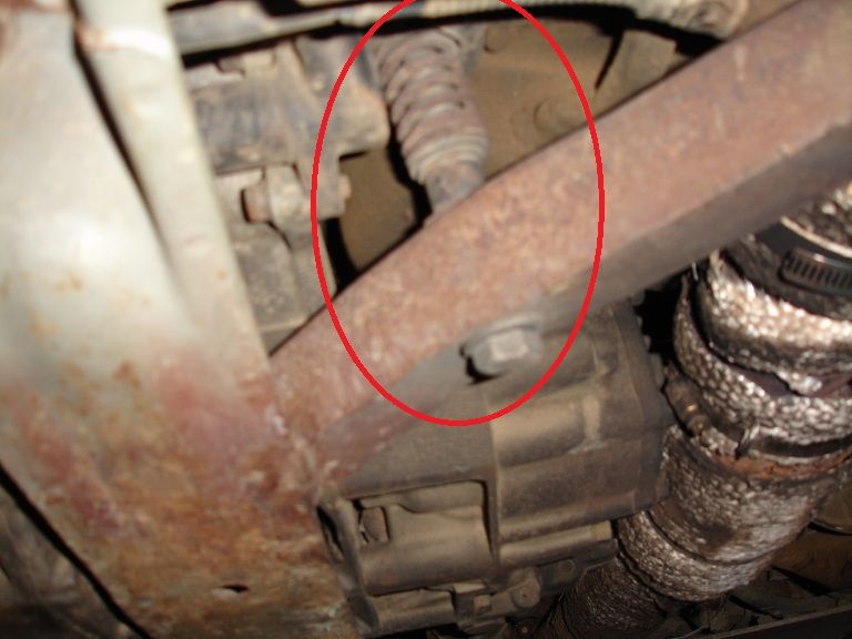

Oh and here's my "front motor mount".
I'll assume the PO did this;
[/QUOTE]
What the hell?
Oh your the rally car guy. looking at the 3rd pic down from the top of the thread, that looks like thats why he did it cause it must have broke something being the front subframe and core support looks really tweaked in that photo.
What the hell?
I know right? Lmao. ROFL
Seems about right.
Oh well. It'll do until it fails completely.

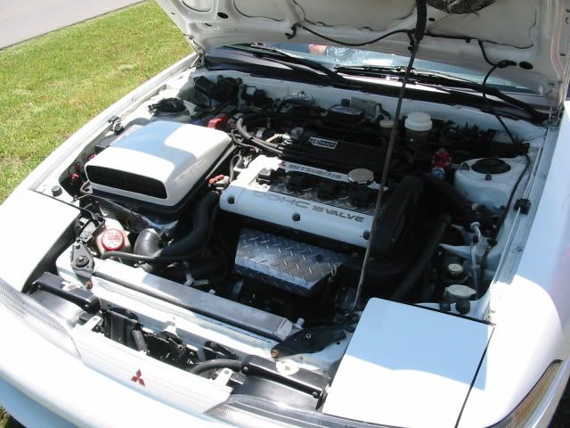

What about this? Better spool, and never have to worry about the fins clogging.
Yeah the owner is Mike, AKA JAXWHITE1G. He is a master when it comes to metal/mechanics. He fabricated the whole thing himself, IMO that's how they should have been from the factory.
I've only ridden in that car once, but I was impressed by how well everything was done. He was running a 20g at the time and it spooled like a mofo. I think he added a draw fan under it, but I can't recall. I know he's running it with the GM-MAF on the intake like my car, but I don't know if he recirc'd it. I could be wrong, but I think he just picked up a small core off of eBay and make it work.
Unique, functional, effective, and best of all better performing.

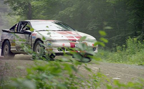

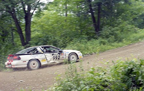

I have been wondering what happened to this car for some years now. I took these pictures at the Main Forest Rally in 2002. This car has got a lot of stage miles on it. How come I didn't see you at Rally New York this past weekend?
This was my first rally that I ever attended and also my first pictures. I've shot 20-30 rallies since then.
img015 by Drew84(PASCARPHOTO), on Flickr
img026 by Drew84(PASCARPHOTO), on Flickr
I was codriving that rally. Bruce Perry owned the car and I had some close championship competition against him and his usual codriver Phil Barnes. They would run on both sides of US/Canada border.

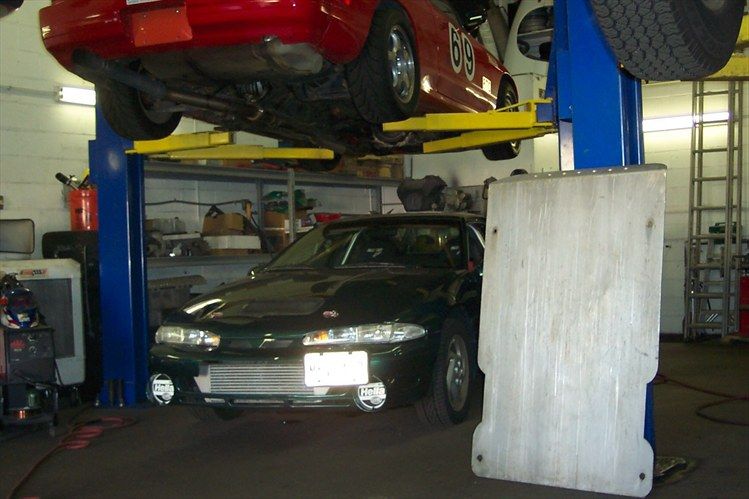

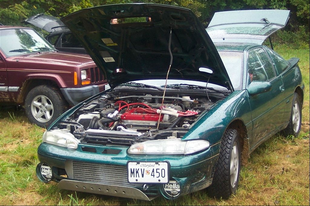

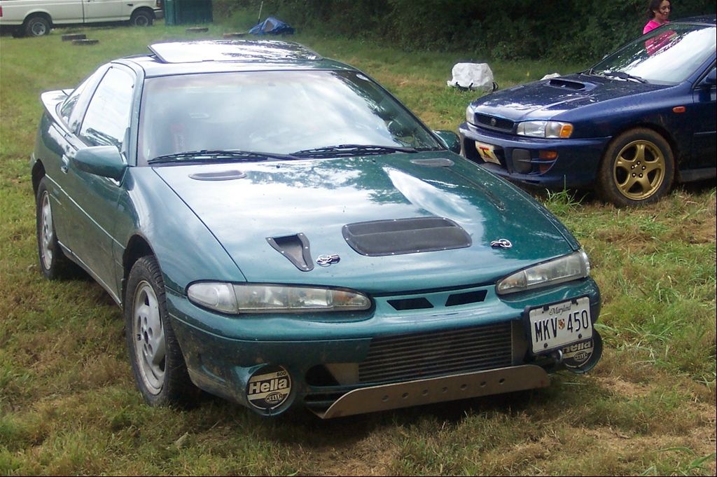

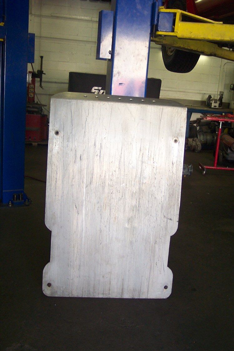

Here is my FMIC w/ skidplate.
You wouldn't happen to have pictures of how the skidplate is mounted, would you?
Here it is.
Closer up.
Bolts go thru upper/front holes and spacer w/ rubber into nuts welded into lower radiator support.
Bolts for bottom/back go thru spacer and replace a bolt that normally holds something (control arm) in the front suspension.
Its a good idea to stick your bolts thru your skidplate and configure any spacer and rubber insulator and then weld a large washer to the bolt to hold everything together as one part. Less stuff to misplace and quicker to reassemble during rushed service.
