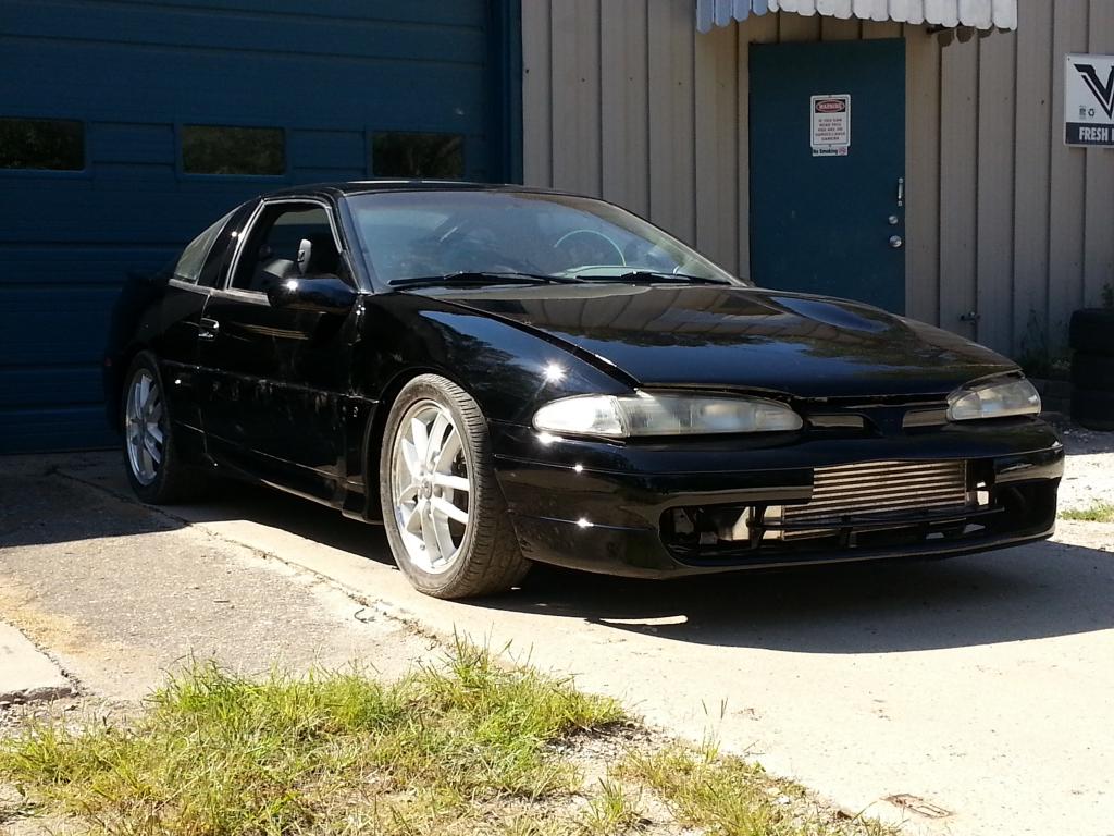

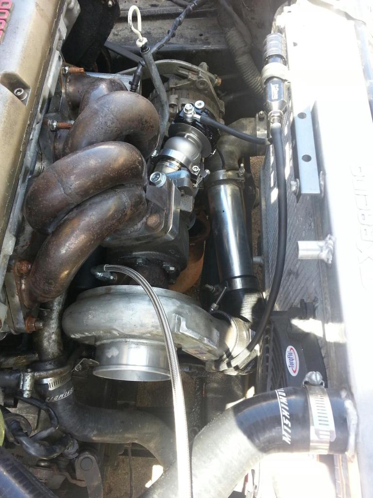

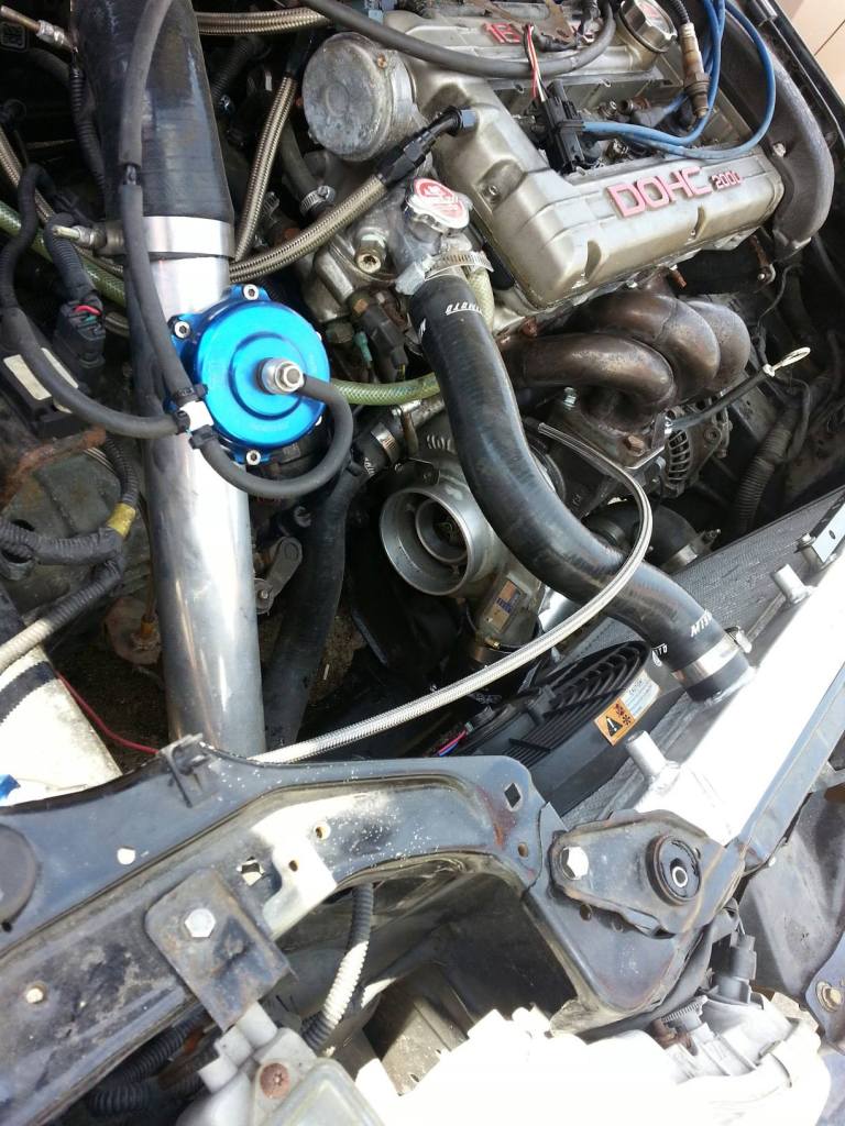

Jump forward to about april this year I put on a hx35 7 blade in a bep bolt on hot side and a 38mm tial wg and punishment recirc o2.
Drove it like this for a while then decided to throw some d2 coils on it
Shortly after this pic is when I ran the 12.8 quarter mile horrible 60 due to bad suspension setup on my part and blew the map sensor vacume off at 1/8 th mile

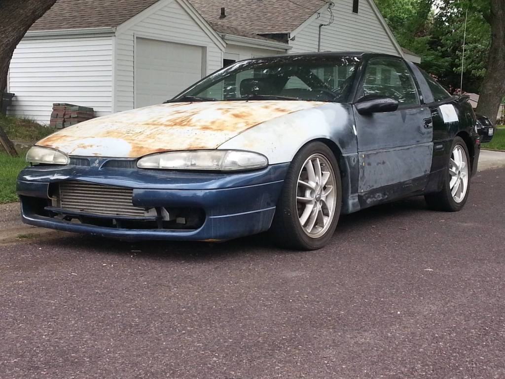

Now from here on is basicly where we are today there is a good amount of progress being made and I have taken pics but want to get a little more done b4 I update again.

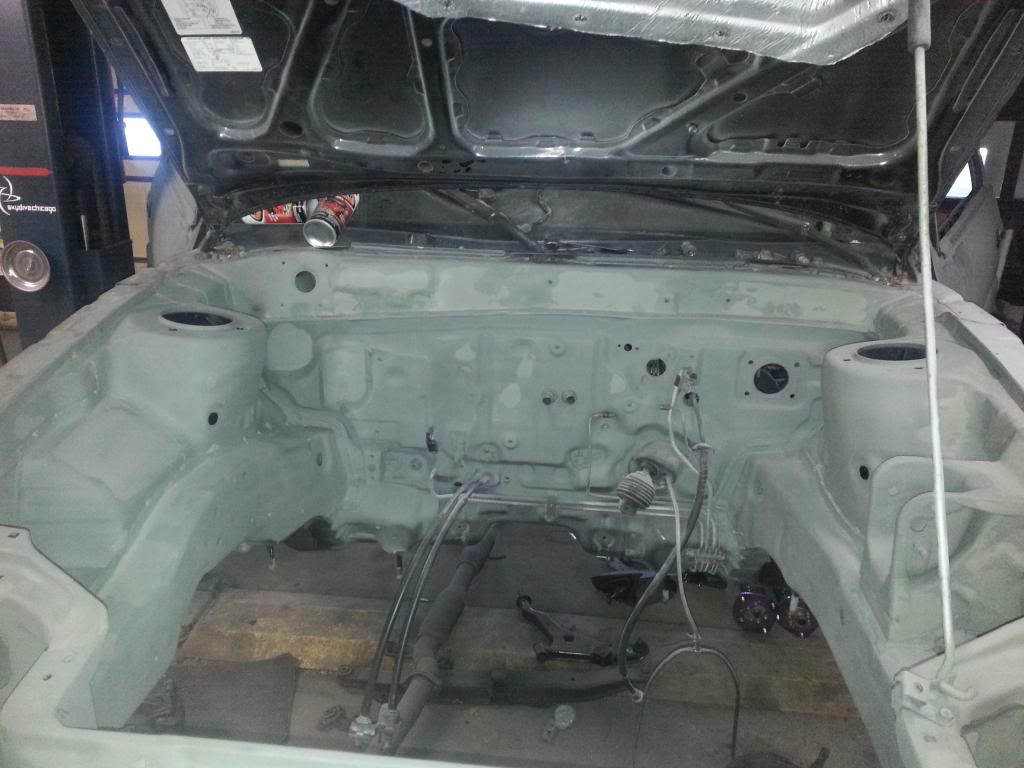

As of right now it is undergoing wire tuck, shaving and painting engine bay, painting the rest of the car, and building a motor. Aswell as some other smaller things I am upgrading.

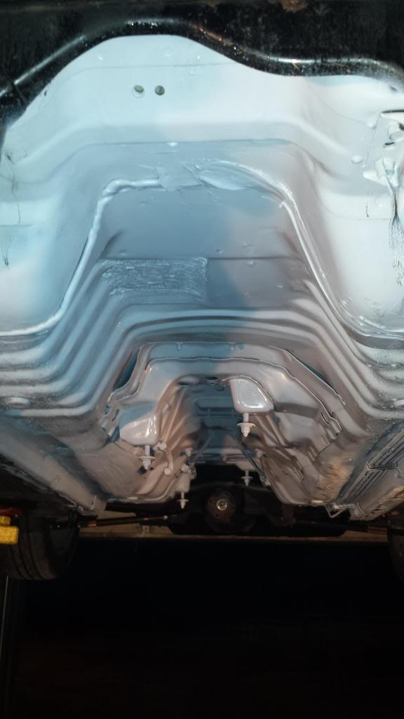

Also did a bit of cleaning and painting on the under side still have yet to install the 8am feed and 6an return to and from the tank

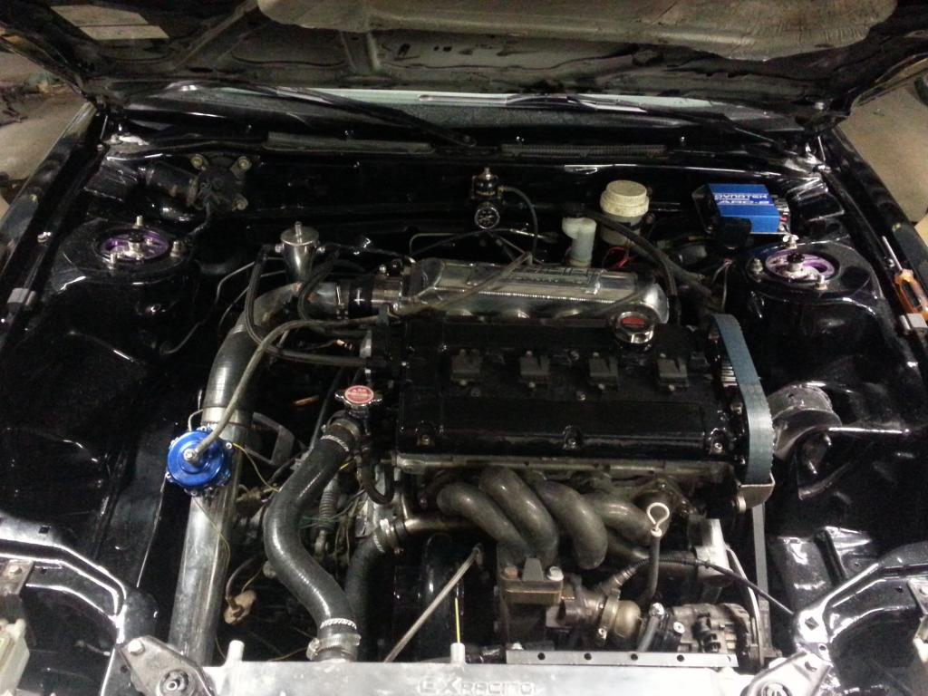

Also got some engine bay progress done
I have a buschur stage2 with welded center going with the wally 450 pump 1450 injectors kelford 280 cams kiggly behives fresh 9 to1 motor with scat rods all arp hardware and a main girdle going to see where the hx35 7 blade will take it with pans to put on a hx40
9s is a overall goal for the car but 10s are the goal for this comming year.
If your going with those cams you minus well get rid of the bolt on housing.
Im just going to hang with it untill I max it out on that hot side. Then the plan is to switch to a t3 housing hx40 with batmowheel. If I can hit a low 11 high 10 on the hx35 I will be extremely happy, and anxious to run the hx40.
It will probably make more power with milder cams on that housing. I used to have a bolt on hx40 with stock intake and bc 272's. It was trapping mid 130's. I switched to a smim and kelford 272's with more boost and it was a struggle to trap 130mph. Those cams will want to breath over 7krpm and that housing isn't going to flow shit up top.
If I have to go bigger on turbo setup I will. I guess this is more of a tentative plan for now I willl see what it wants for now these are the plans to stay on track for budget and future goals.

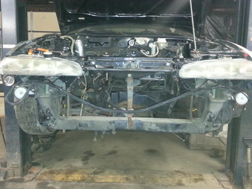

A little view of the wire tuck progress.
Deleting and sepperating wires
Fishing wires out for the lights
Lights all wired
Moving inside the car to mount the fuse box in the glove box
This is how much wire was deleted to make the fuse box meet at the glove box
This is where I decided to stop for the night. I still have yet to drill the hole in the firewall to run the alt. Wires out and the ecu wires.
Well I think I am going to take your advise and go with the 272 kelford mostly due to the fact that the 280s want to live above 7k and it isnt in my budget to get the frontline front case and have the assembly balanced right now.
