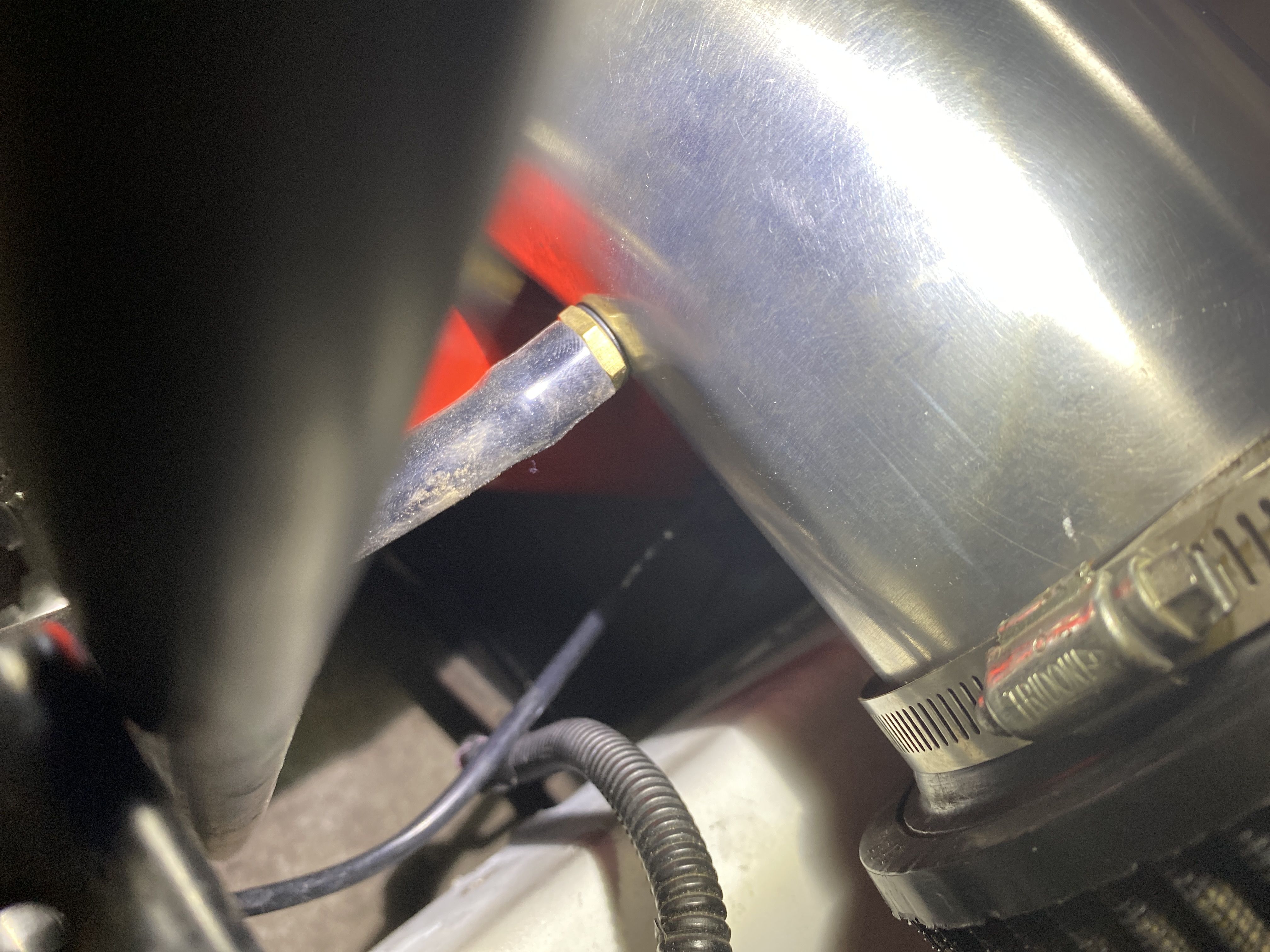

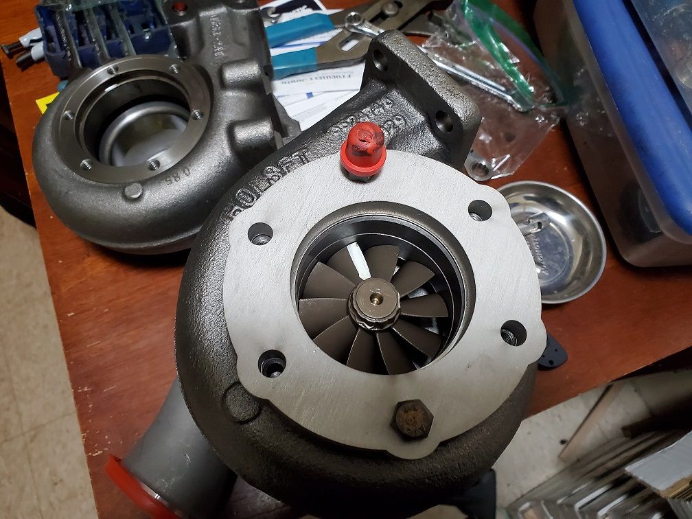

The HX40. I am not sure 3mm wall thickness gets me enough threads to feel confident. I run a -10 hose from the catch can to the intake pipe, so I will likely weld a small rectangular plate to the bottom and drill and tap that (worked great with steel on my dejon pipe).

I will probably end up waiting until I have the turbo bolted up before I make a final decision for the intake pipe.

found this cheapo 4" z-bend pipe on aliexpress for under $30. It is 4" longer which means more tube to hack if necessary, but at 1.8mm thick vs 3.0mm thick on the one from amazon, it may be a bit trickier to weld. on the other hand - weight savings LOL On its way now!
1.8 vs 3mm alloy is not a huge difference in weight, its barely noticeable. It should weld just fine if its nice material thats the main concern over thickness
@ec17pse , I know the weight is negligible, that was a joke!!
I assume both of the cheapo aluminum pipes will be garbage material. I have heard alumaloy rods work better on that crap that just about anything. Have you messed with that kind of thing before? Other recommendations for not burning thru trying weld a thick 10an bung onto the pipe?
I missed the weight part of the joke LOL
If you got a thick bung then can either turn it down to be a smaller base or weld onto the bung then flick the arc onto the pipe that way you wont blow a hole through it
It worked pretty well for the IAT bung on my thin pipes for VRSF FMIC. It goes on ugly but it cleaned up nice with a die grinder. (ill try to add a pic later)
Still curious if there is a better way. I don't have a tig welder so my options are pretty limited anyway.
