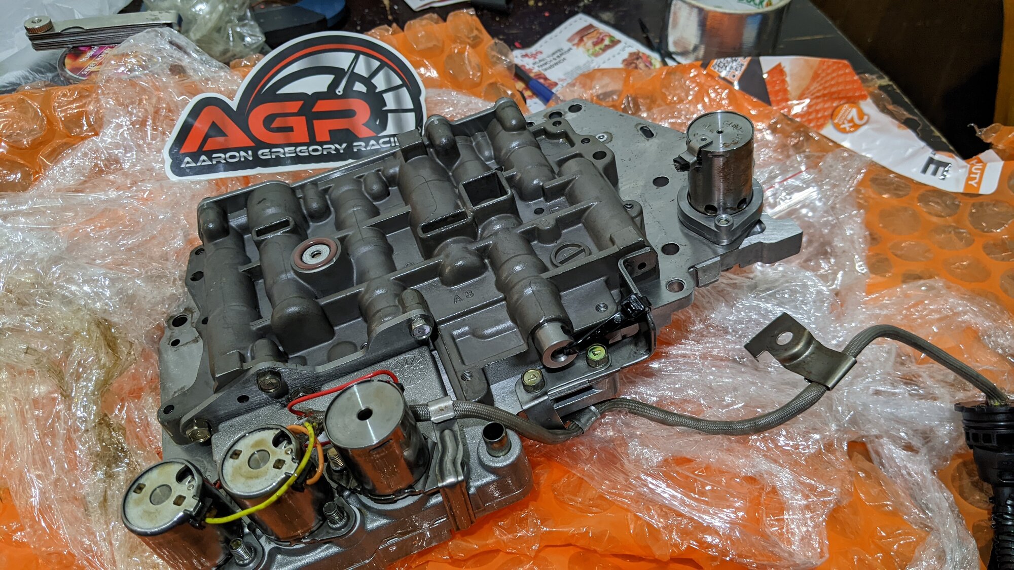

Dropped the auto trans pan and I didn't like the condition of the pan contents. I mean, I don't know what it should look like, seemed like a lot of material in there. Some of the valve cover bolts were barely tight and one was finger tight. I can't imagine that being good. The filter was dirty. Shipped off the VB to be checked out and I will order a new trans filter/gasket kit and fresh ATF.

It's been a month since the last update. I did send out my valve body out for service and it came back last week. I installed it last weekend but haven't added fluids or tested anything quite yet due to time. I hope my issue is fixed though! I will find out this weekend.
I drove the car around the block a couple times and looks like the transmission issue described in this post is resolved. I can't drive the car too far from the house because the car is very illegal at the moment with no lights, registration, real tags, insurance etc.:shhh::shhh: But I am happy with this current status. Thanks Aaron Gregory!

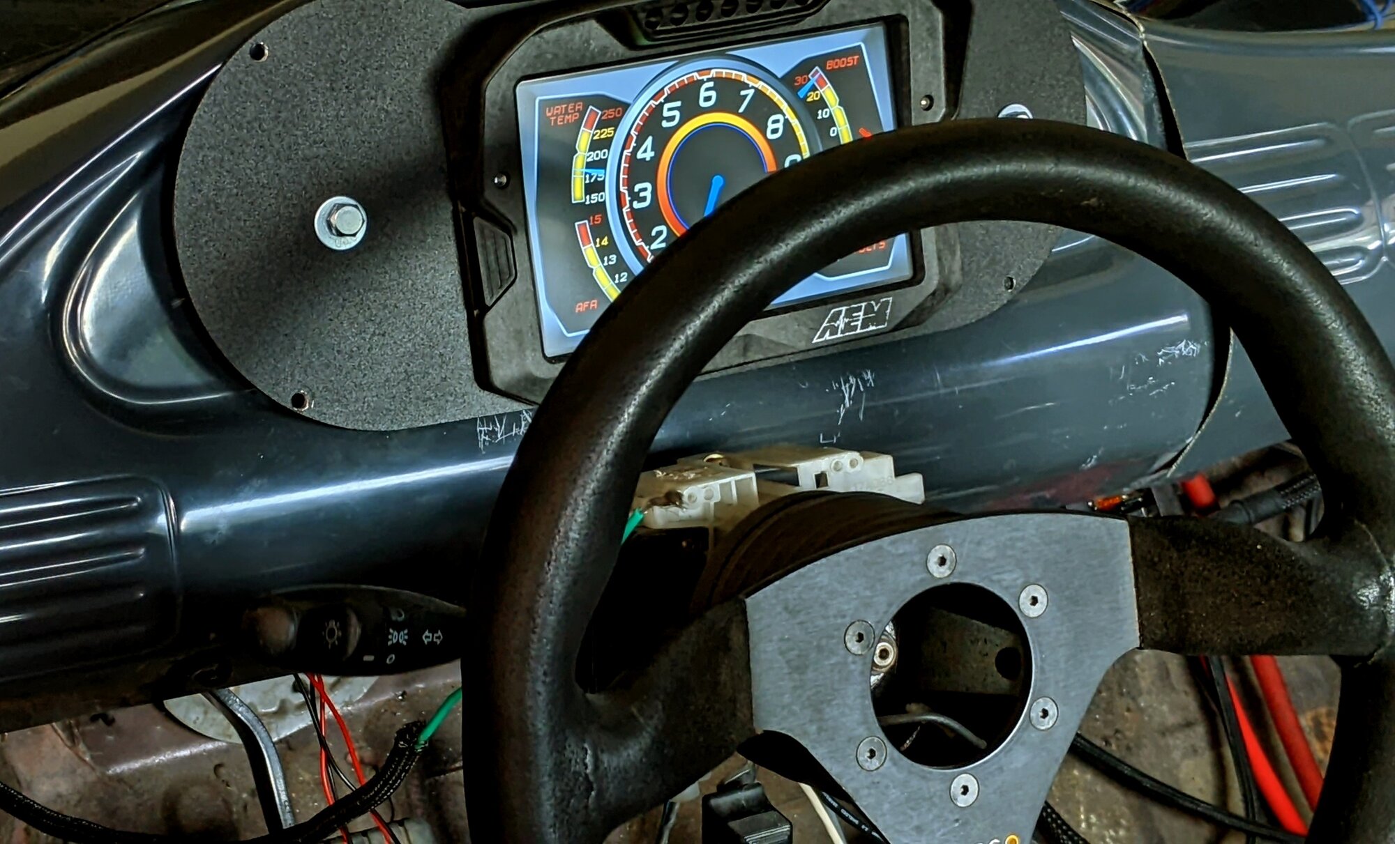

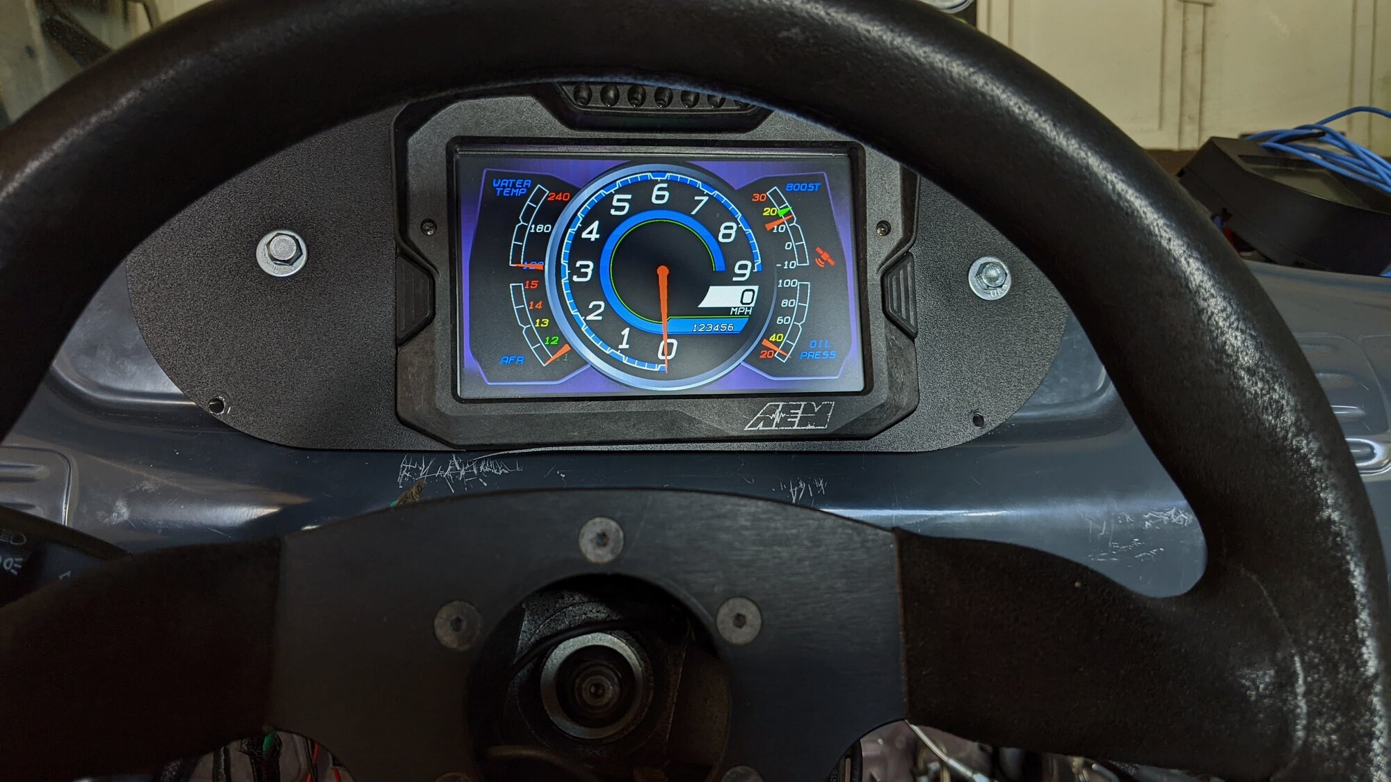

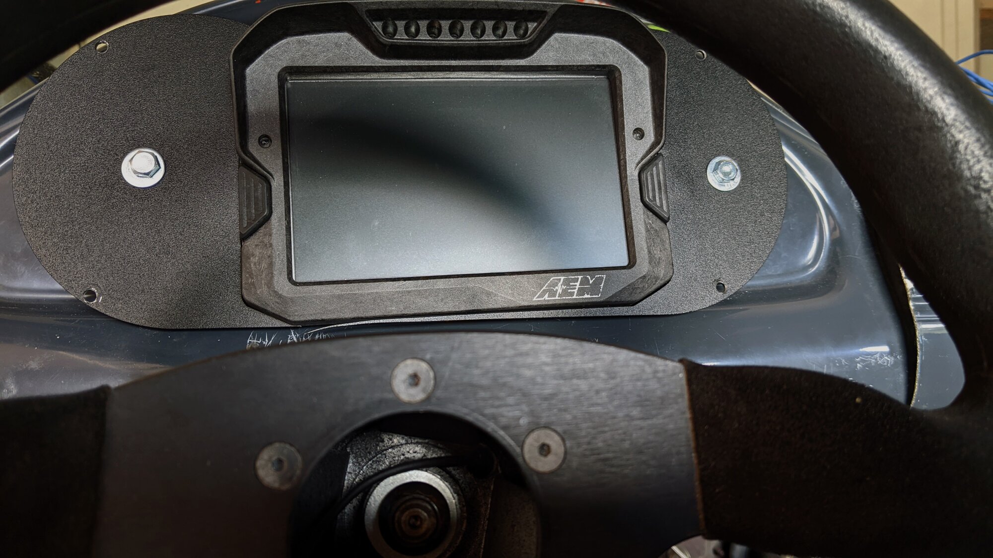

Almost a month without an update. I haven't messed too much with the car. I really need to tag it so I can legally drive it down the road. I did install a digital dash over this weekend and I like it. I figured since I was not using it in my other car, I may as well use it in this car that needed a dash. The IQ3 dash was useless to me since I didn't have the special cable it needed to transmit data from the ECU.

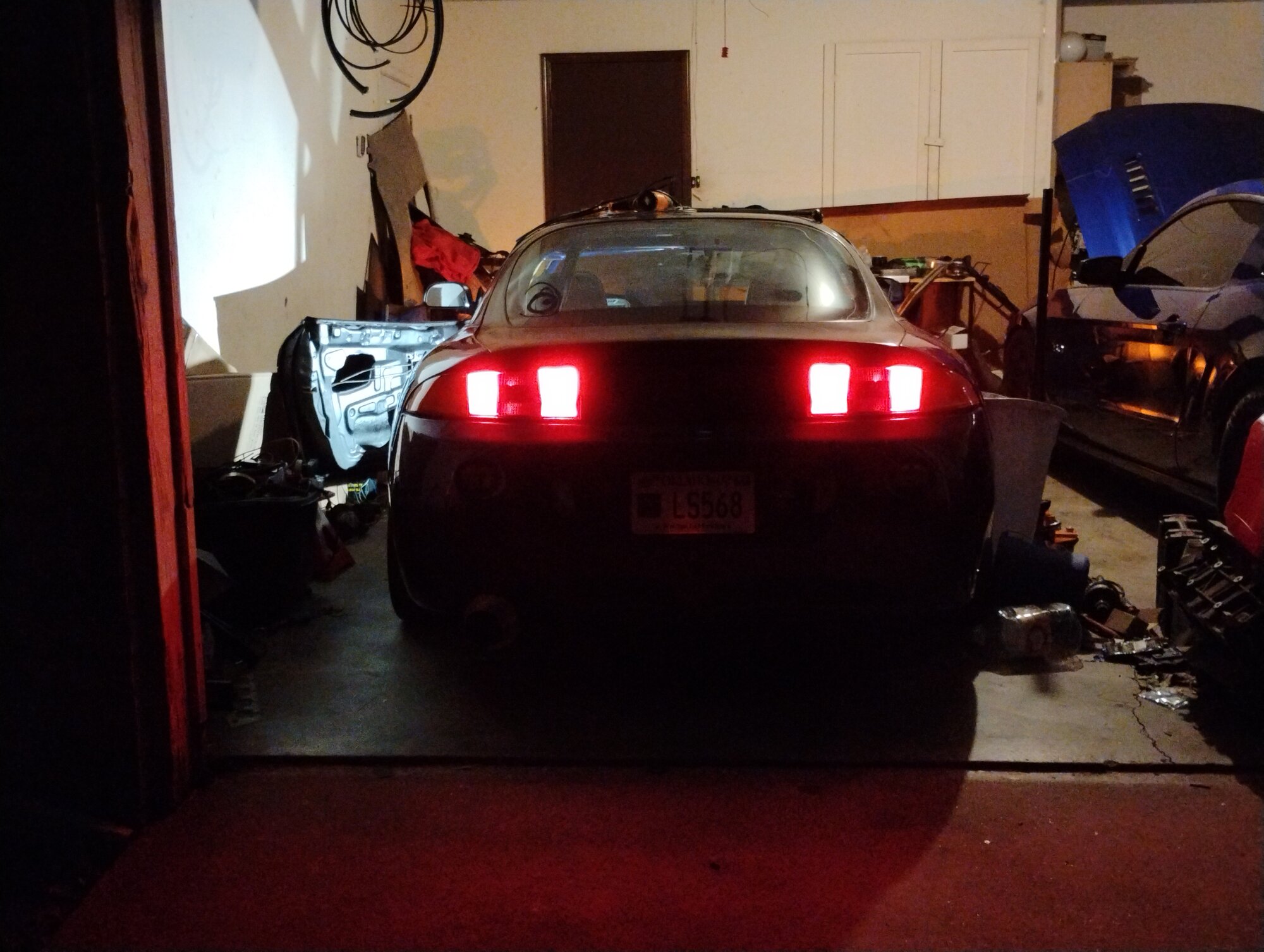

Wow...over 2.5 months with no updates. Sorry guys. Really nothing much to report but I am wiring the lights in the car because it had all the stock wiring removed. I hate wiring so it's a slow process...and I am messy with it so trying to clean it up. This will be wired to toggle switches. Easy for me to do than trying to redo the stock setup. I also haven't tagged the car so I don't really drive it more than a half a mile from the house but I promise to have some updates in the next few months as I get these tasks completed and actually get it on the road for some tuning.

Dude the AEM Dashes are the best IMO. My only complaint is I wish they had a few dedicated inputs for turns/highbeam/fuel gauge. I know they have turns or something maybe but it's kinda f***y to make them work.
If I ever get over wanting to keep a stockish interior in my race car I'll have an aem in it for sure.
Yes Sir, this was intended for my Mustang, but I changed my mind running the Infinity in it. The dash I got with this car (IQ3) does not work because I don't have its special communication cable so into the Eclipse the AEM dash went! This dash is the logger too. I will set it up some more after I actually start driving it around. I also need to add a few more sensors.

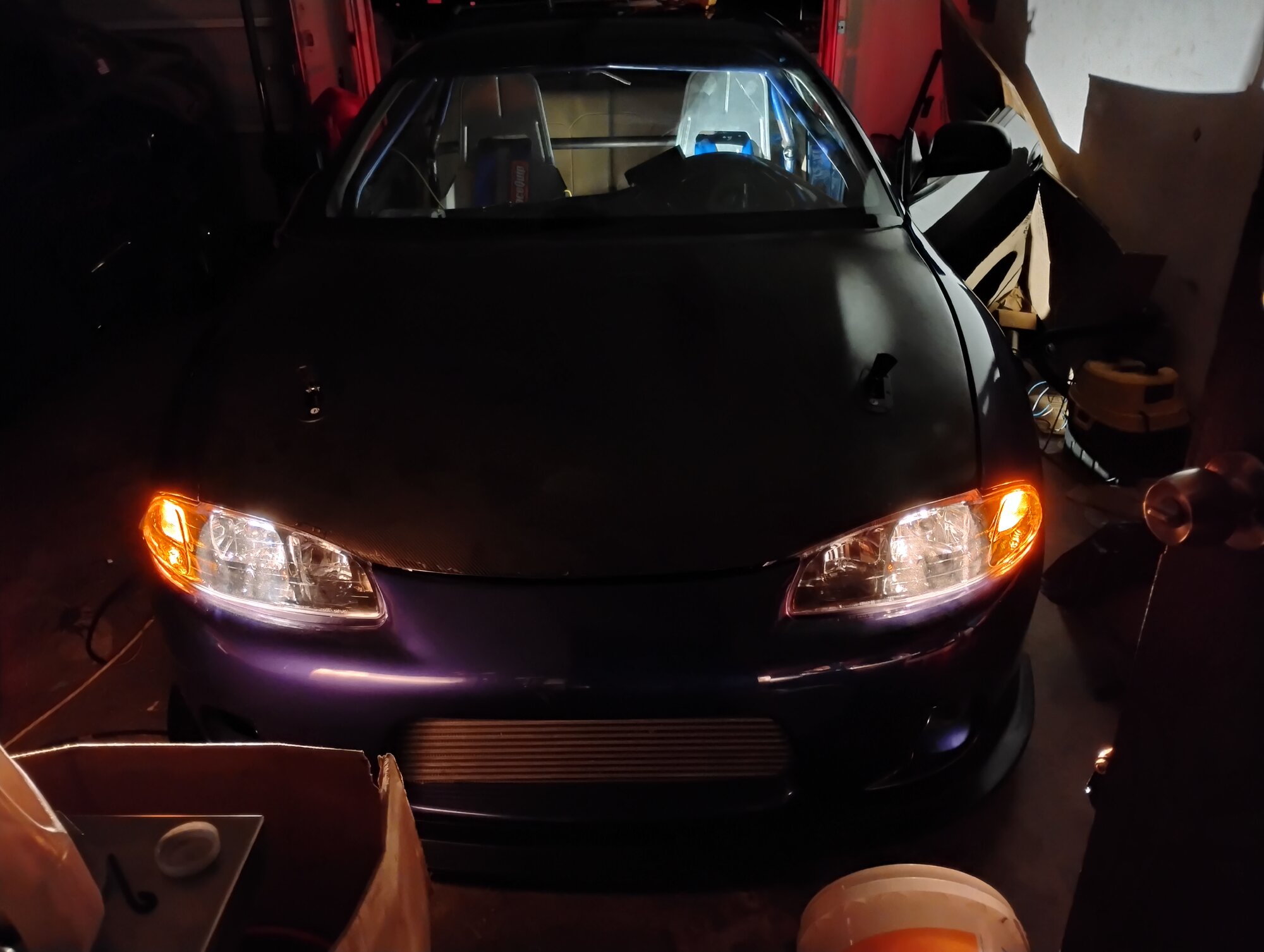

Finally almost all lighting has been wired up. I did LED bulbs all around, haven't done the actual headlights though. I forgot to do the license plate light bar that I have as well. Anyway, drove the car around the block twice. Runs and sounds good. Now, I just need a tag.

Did you find out what the valvebody pressure issue was, debris etc?
Per Aaron Gregory,
I did notice 2 things that could be causing the issue you're seeing. The first is the line pressure plug in the channel plate was lose, you may have done it when taking the VB out though. No big deal just needed to tighten that up. But also found the reducing pressure spring broken in half. Reducing pressure isn't being used with the shift control firmware, and the wiring isn't there to the solenoid on the VB anyhow, so it's not needed. I removed the spring and blocked that valve off to prevent it from moving.
Also, guys, can someone help me out with the turn signal wiring? The front blinkers do not work with the parking lights on. What modification do I need to do? Keep in mind I did all the wiring from scratch and it's powered by a toggle panel. No factory stuff.
I have the parking lights (front and back) on one relay, headlights on a different relay and obviously the left and right signals on different relays. Using a generic LED flasher from Amazon. Works great. I can control the blink rate.
I figured it out. The parking light needs to use the lower wattage circuit and turn, the higher wattage. I switched the wiring and it works perfectly now. Also installed the tag lights. I used an aftermarket LED bar. Kinda bright. Now just to clean up the wiring mess.
