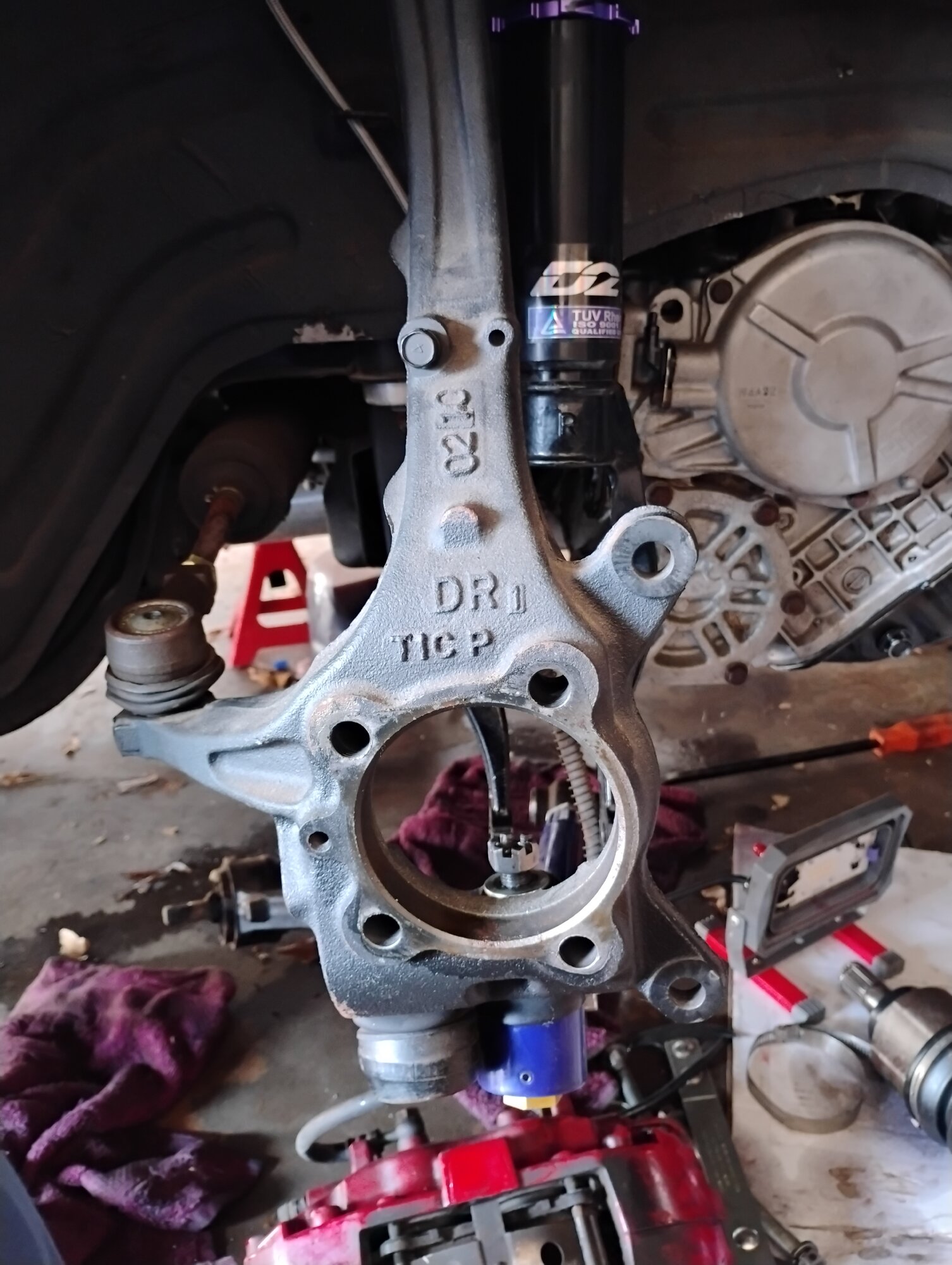

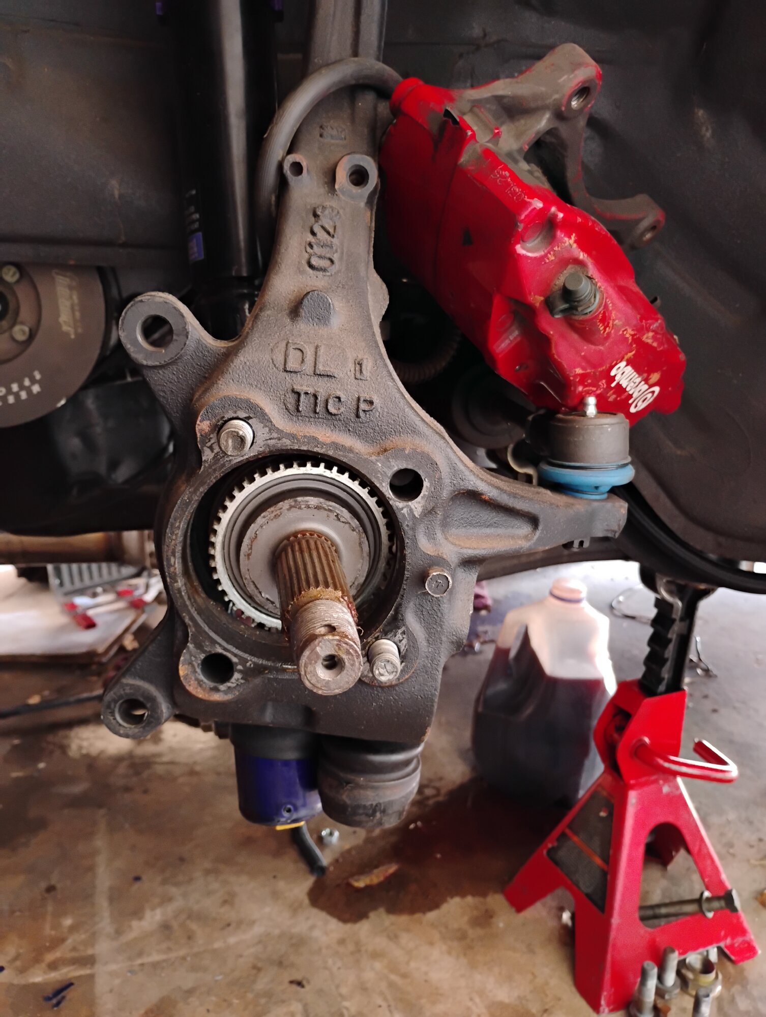

As all this was happening, I noticed that when the car sat for a few days, it was leaking ATF. Further investigation revealed that the leak was coming from the front passenger side axle seal area. I removed the axle, inspected the seal and it looked okay but I ordered a new one from ExtremePSI. I will install RTV on the outside lip when I install and seat it in the trans. I am suspecting it may have unseated itself just enough to cause a leak. The axle seemed to have been seated all the way so hopefully, this fixes the leak. As I was doing the above, I noticed the wheel hub bearing felt kinda rough spinning so, I am replacing both front hubs.

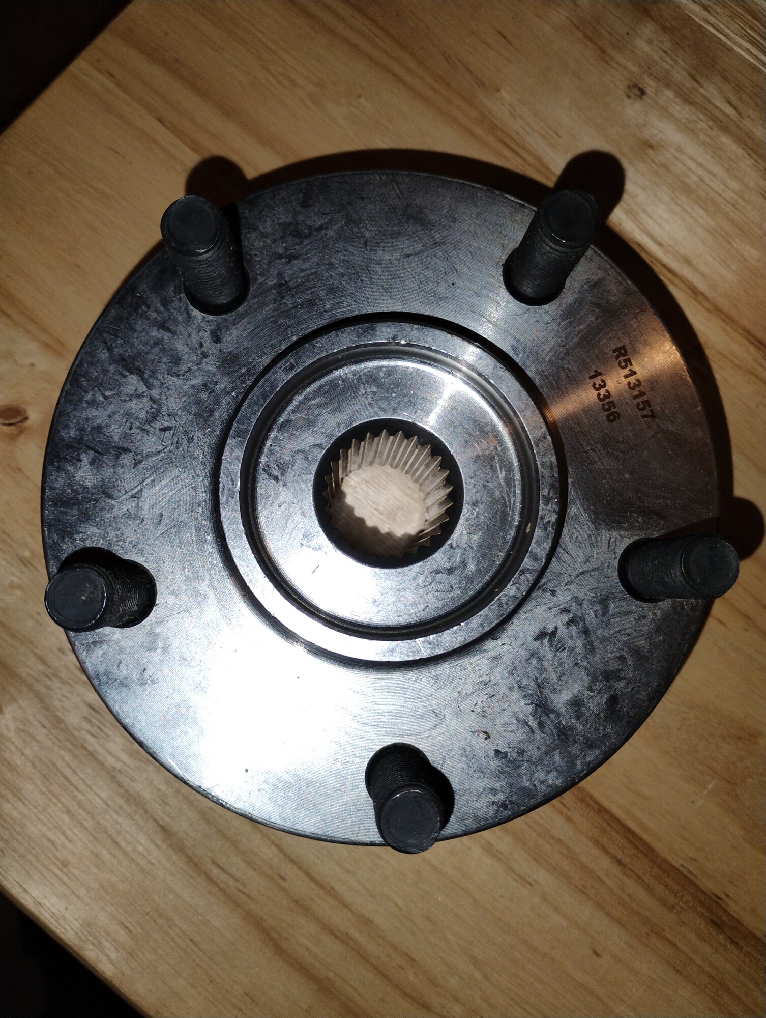

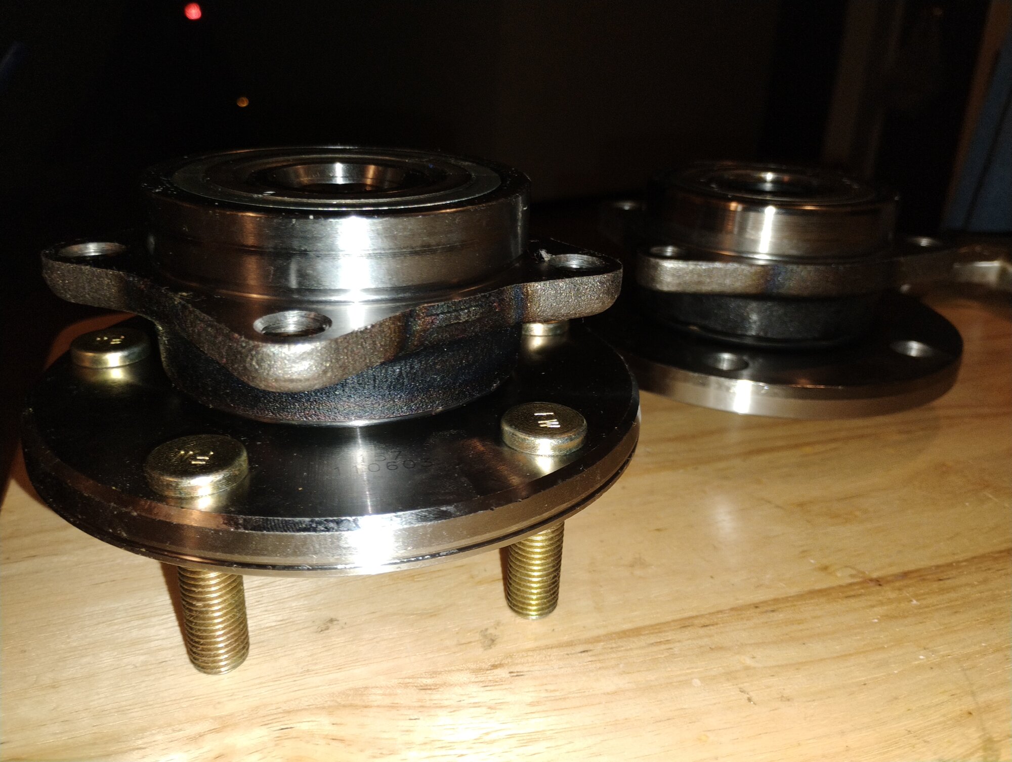

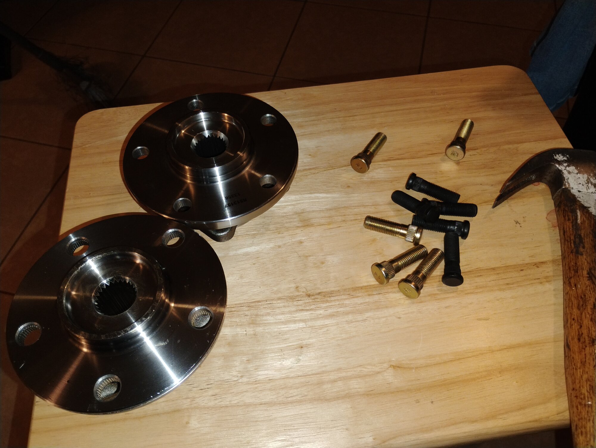

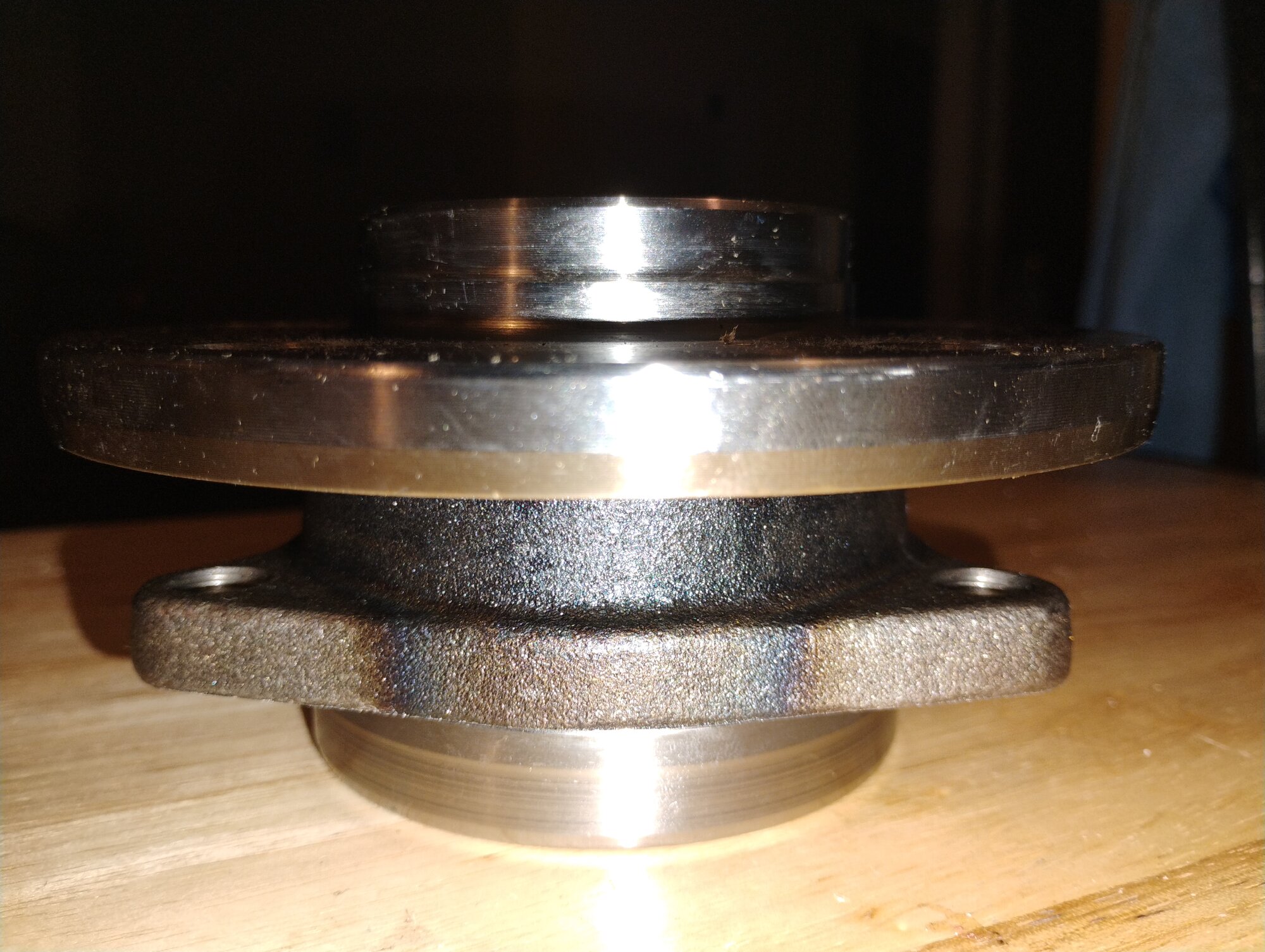

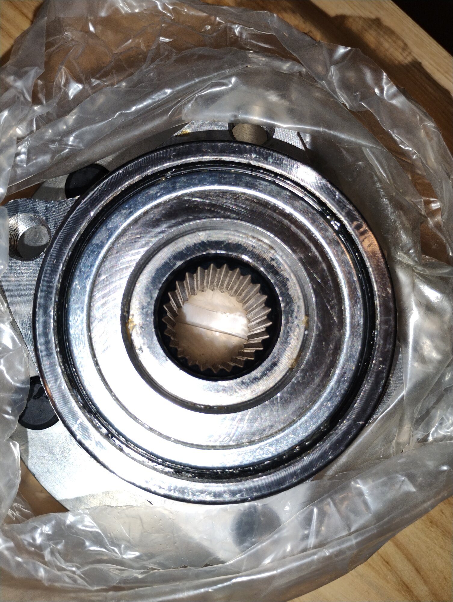

The hubs are pretty easy to do as long as the axles are not stuck in there. So, I ran into a small problem over the weekend. So, my hubs as pictured above, notice how they both came with different studs, one black and the other brass colored? I didn't think much of it until I tried to press in my ARP wheel studs. I noticed (after mounting the hub to the car :rolleyes:) that one hub had bigger studs on the knurl end....and I didn't have the correct drill bit to drill to size. Soooooo....had to remove it and place an order to Amazon to get the drill bit size since even my local ACE didn't have the size I needed ie. 39/64". However, good news is after installing the new seal, I don't seem to have any leaks after adding the ATF back into the trans but this will be determined after getting the car running and driving it again. I also bought a new muffler for this car but I am afraid it might be too big, width wise? Really, just avoid 4" exhausts on any lowered 2G. I am not even sure why people feel this is needed on any car making less than 1000whp.

3. Replaced the passenger side hub. I was going to replace the driver side hub as well but Rockauto sent me a hub with studs that were of a different size (smaller) and I didn't have the proper drill bit size to drill the holes out and install my ARPs. So the old hub which was not too terrible, went back in.

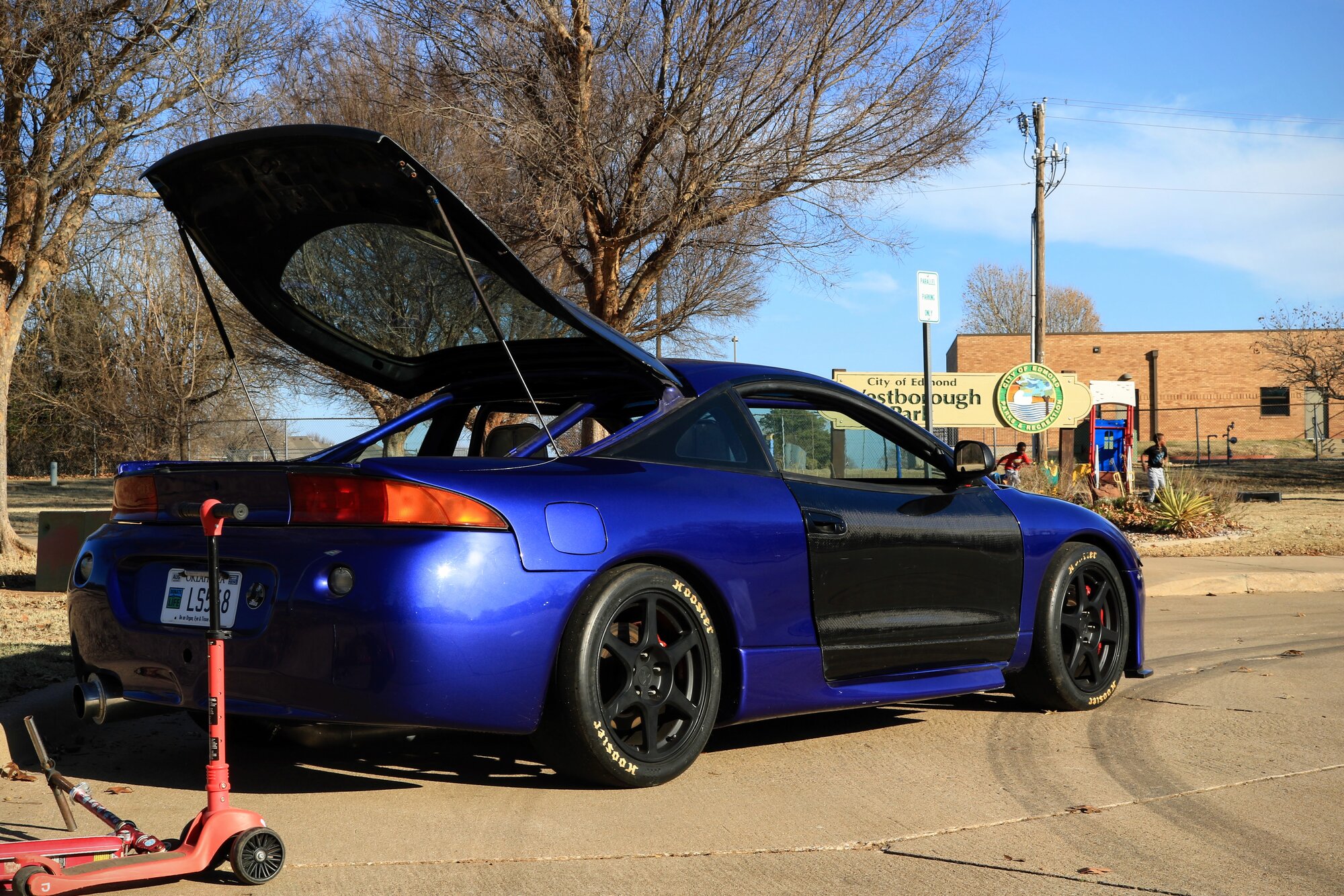

Switched the car to RX7 FD wheels and street radials. I made the longest drive to the DMV and everything almost everything went ok. I had a coolant leak when one of my plugs/caps at the thermostat housing failed...but I easily fixed it since I wasn't too far from O'Reillys when it happened. Should be legal very soon then there will be more driving. Car is super loud but didn't draw any cop attention today. It has 225/50/16 tires currently but I will most likely get 245/50/16s. I also can confirm 0 leaks!!!!! :rocks: :rocks: :rocks: :rocks: I hate leaks!!!!! :thumb:ROFL Should I do black on these wheels?

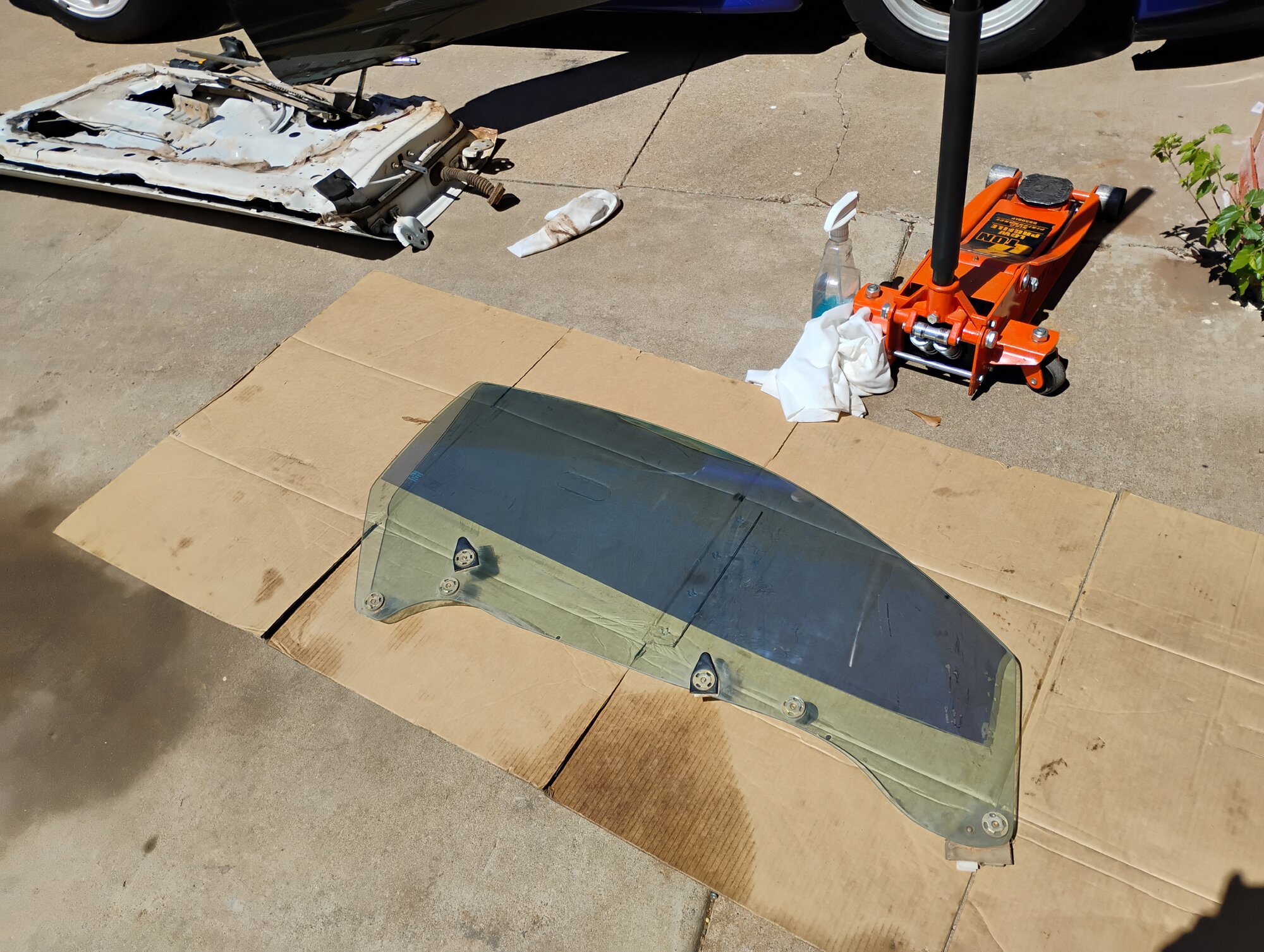

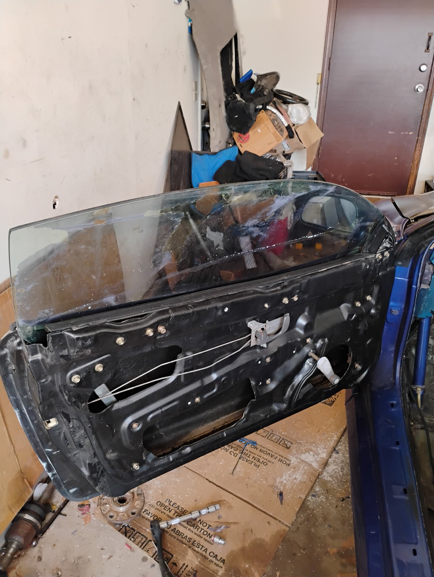

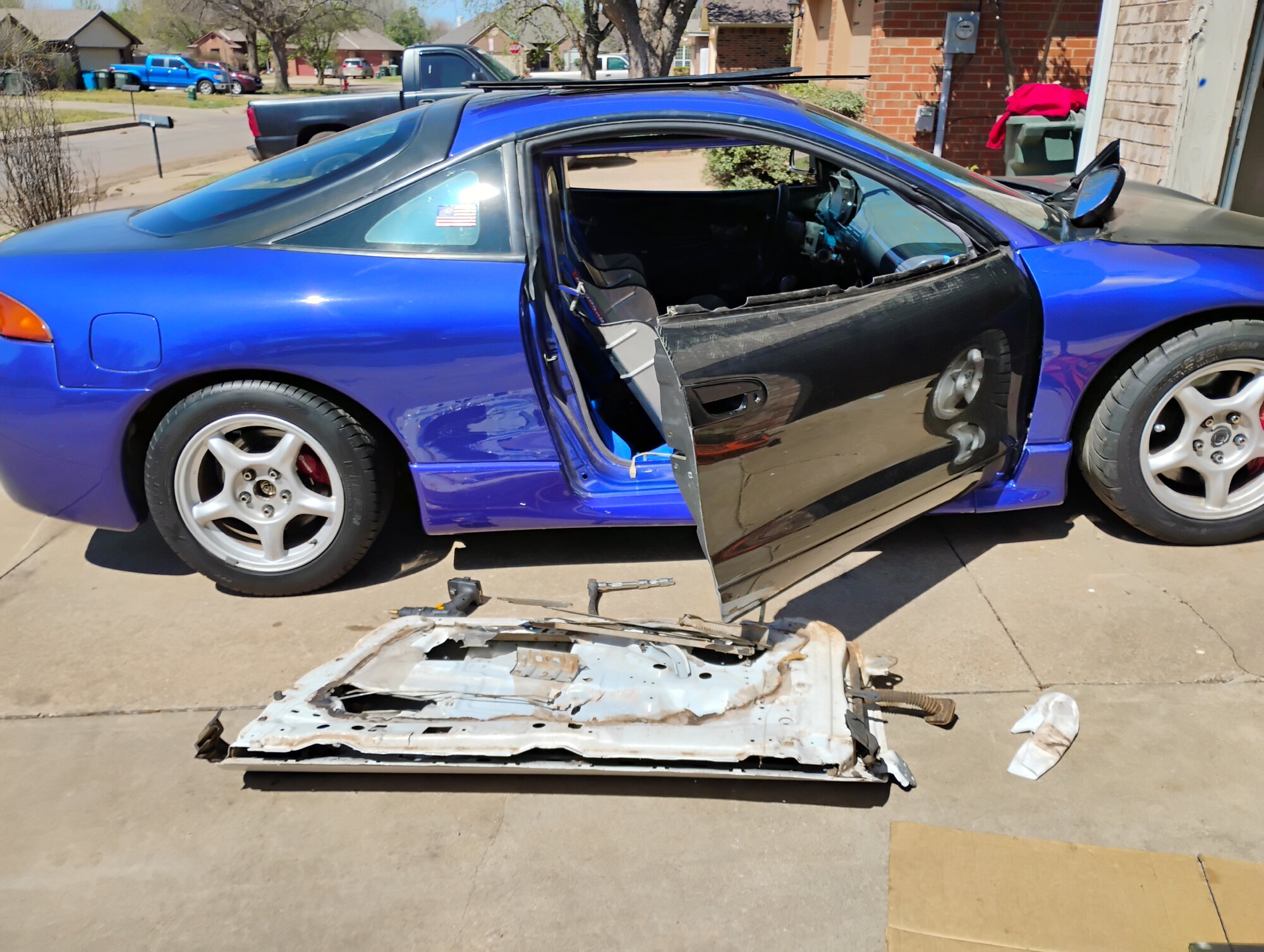

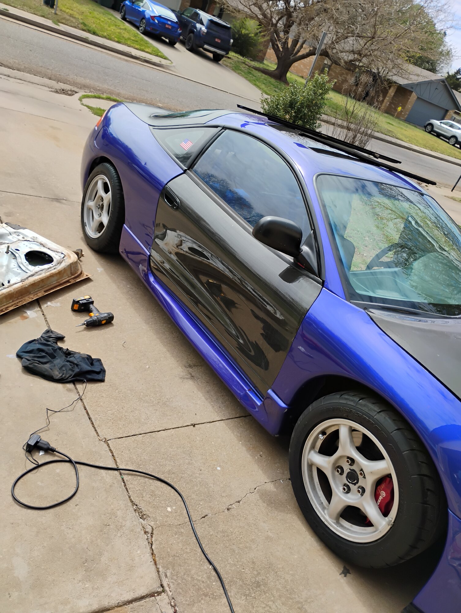

This weekend, I tackled the task of installing manual windows onto the carbon doors for my car. I picked up the doors with the manual stuff from Tony, previous owner. I didn't really know what I was doing on the first one and it took so long simply because I didn't know a good way to remove the the manual regulator, track and glass from the donor door. I was not too happy with my work here, but the second one took me less than half the time it took the first one and I did an excellent job on it. I intentionally did the passenger side first..ROFL. Then, I spent hours trying to scrape off the old tint that would not budge. I would scrape off maybe 1/2 a square inch of area at a time. I am not even done but got maybe 80% of it off, on one window. :rolleyes:

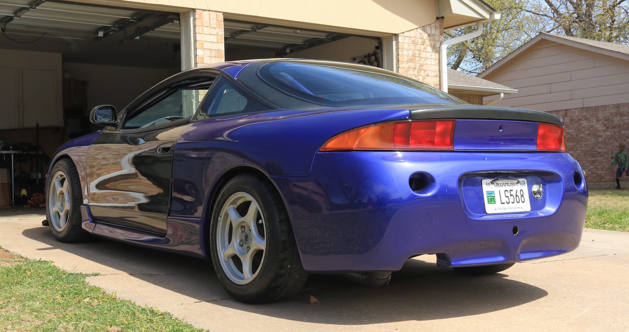

Then I cleaned the car after all my hard work to feel better about myself...:D. Next, is to do something about my loud exhaust. I also have a duck bill spoiler in my garage for this car. What do you guys feel about this? Keep the wingless look or add the spoiler? I am torn.
My vote is for the duckbill. A spoiler-less 2G just looks...weird. But man those CF parts are trick.
