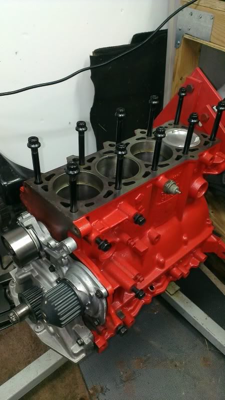

Current bottom end should be good to 550ish reliably. I'm probably going to run 450ish to 500 which is PLENTY on the street, but want to get another block to build a aluminum long rod motor, with a static compression around 12:1.

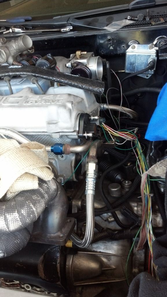

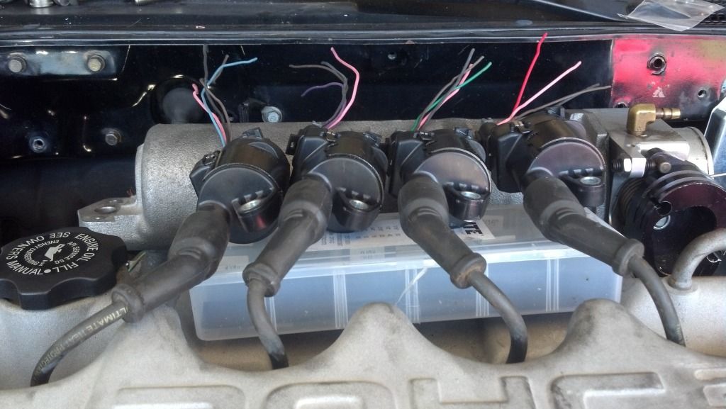

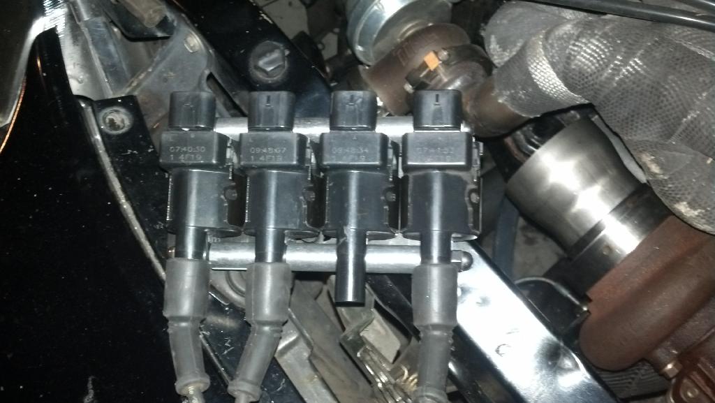

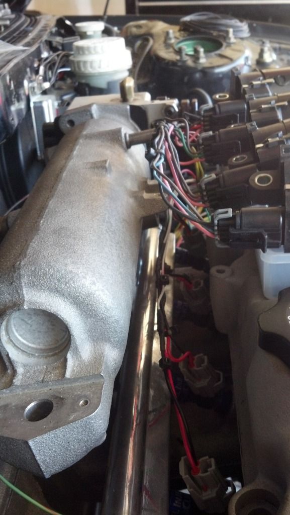

Got the injectors and coils wired up today for sequential, I know this is moving slow but things will start to pick up now that its nice outside most days...the coils are sitting where I plan on mounting them for the most part. I need to get some sheet metal to make the mounting bracket. Going to reroute some vac lines to accommodate for the coils being in the way of a vac line...

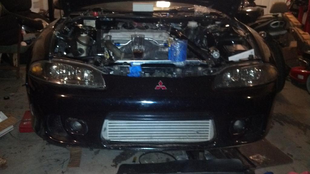

Got the FMIC on and bumper trimmed for it. Also got the 1g radiator secured in place. Getting closer even if it is at a snails pace :p

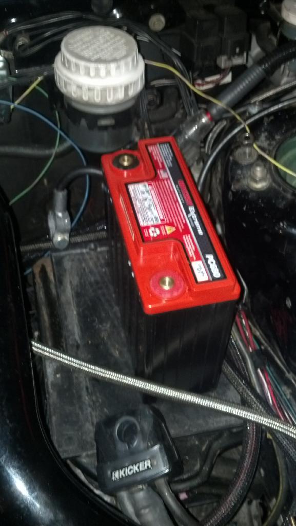

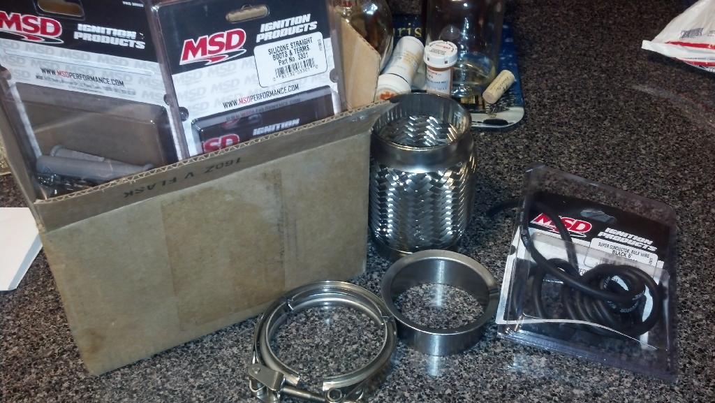

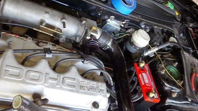

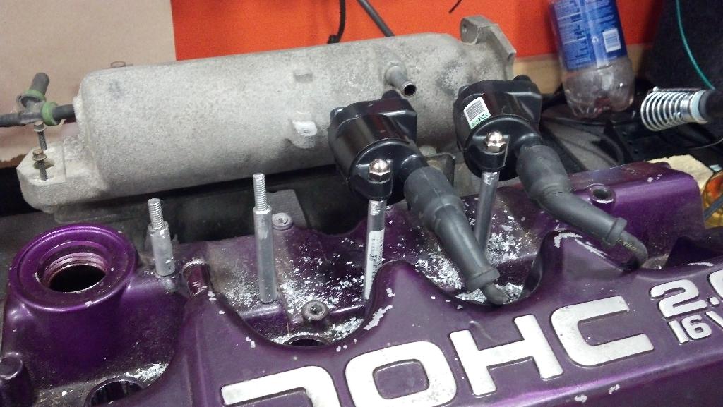

So I didn't like the way the previous coil mounts turned out so I got another type of coil mount and am going to mount them beside the new small battery. Now I just need to get some more MSD wire to make the coil plugs reach the further distance.

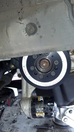

I also got the crank pulley in!

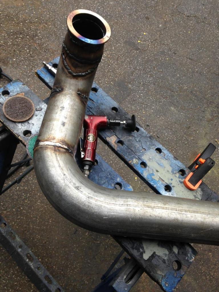

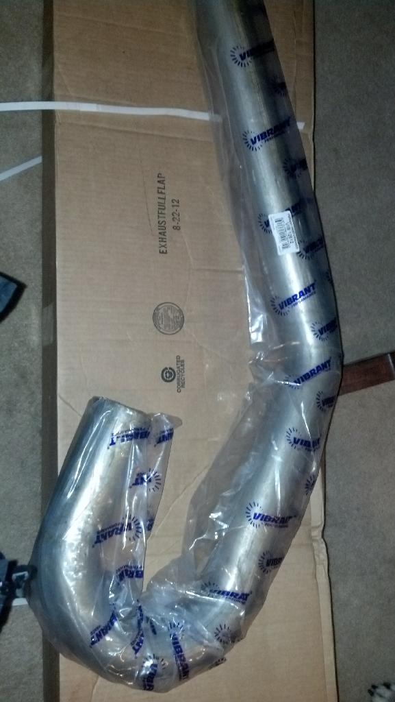

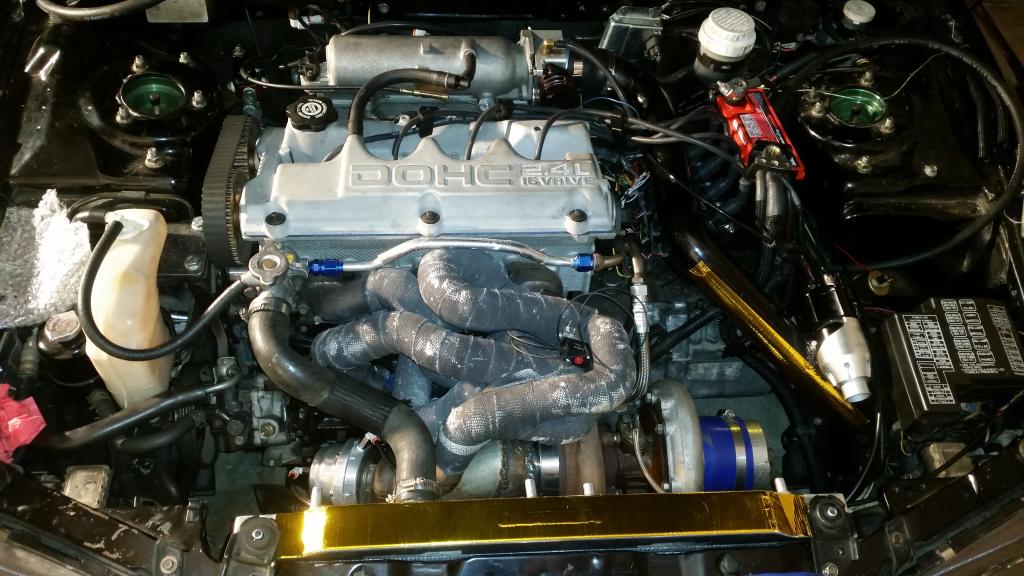

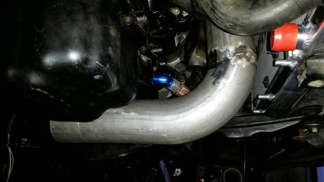

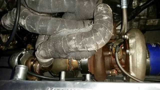

Got the down pipe done until I get the car mobile to finish welding the rest up(3.5")...

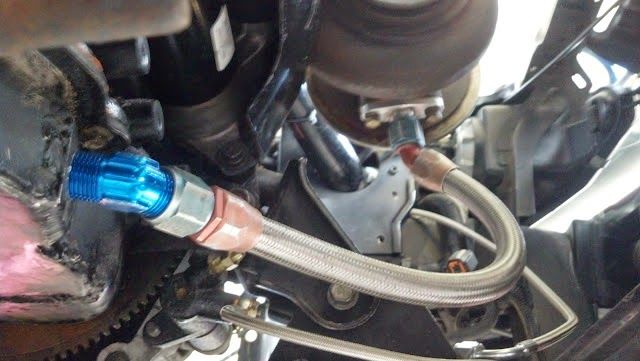

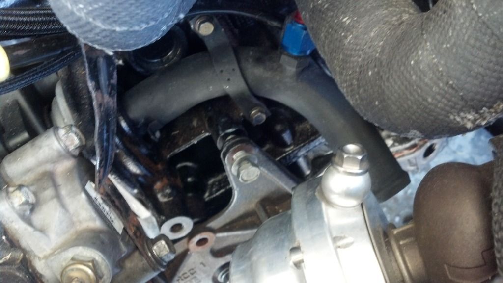

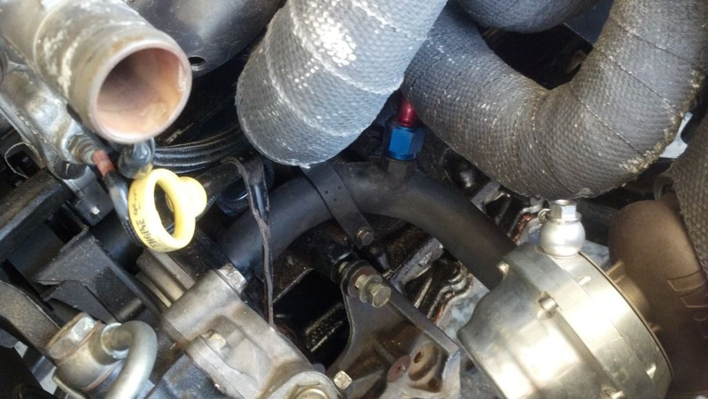

Oil Return is good to go...
Spark Plug wires and coil mount...

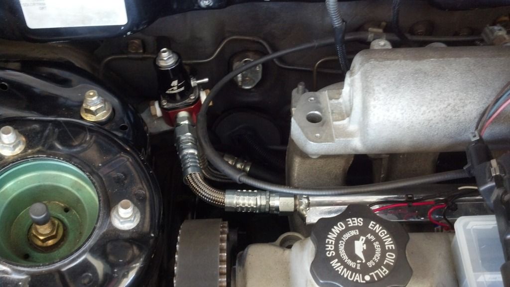

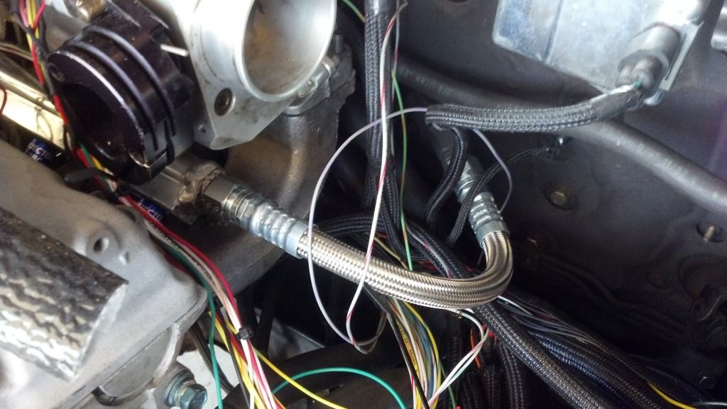

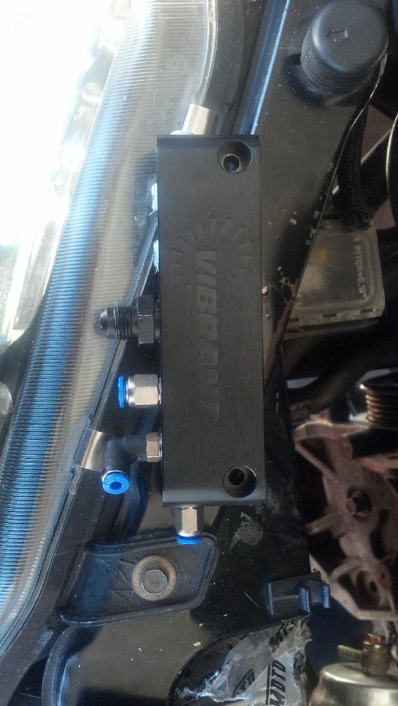

Push-Loc fittings started, I need a few more...

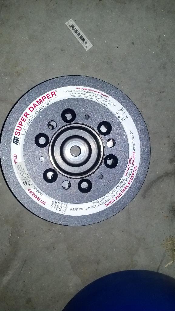

ATI Crank Pulley

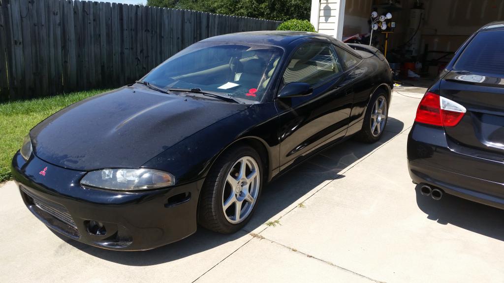

Pulled it out of the garage today under its own power! Now give it a bath and get a battery for the laptop so I can tune it on the road!

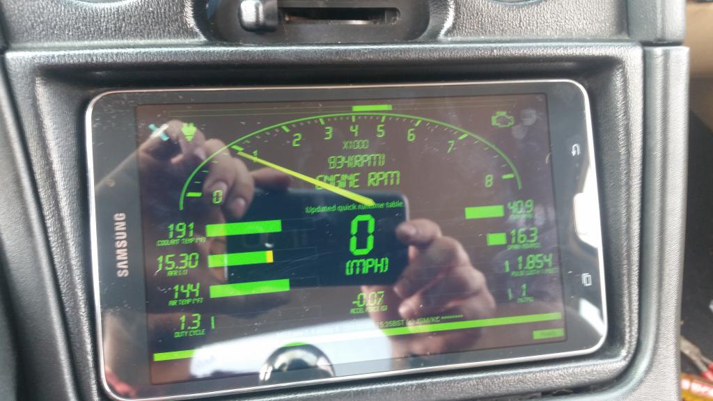

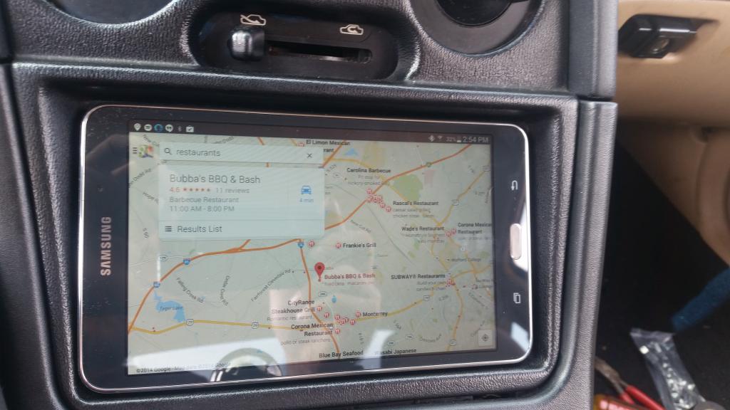

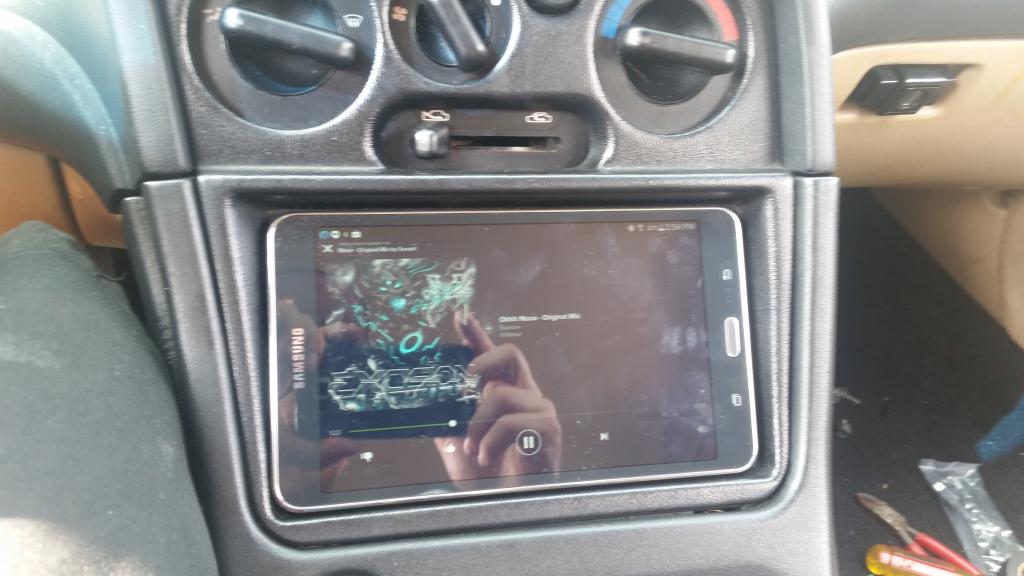

So I've been a little busy on getting Shadowdash hooked up in the car and instead of going with a CD play/Radio set up I decided to go with a Tablet...I couldn't tell you the last time I listened to CD's( I listen to records more than CD's) so I took the plunge.
Galaxy Tab 4 7.0" model...
Streaming data via bluetooth from my phone to my tablet and streaming Spotify from my tablet to a bluetooth audio device that then goes to the RCA inputs on my amp...
Also works with Google Maps...
and does so pretty nicely I think...
Tablet is secured in the dash via a magnet mount and is easily taken out of car when I leave and to stick back in. I'm working/deciding on if I want to notch the side of the dash for a charging cord to be wired in.

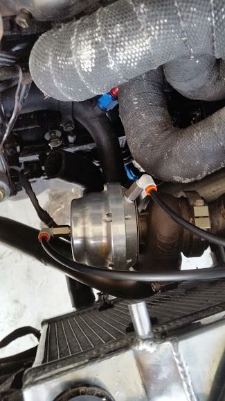

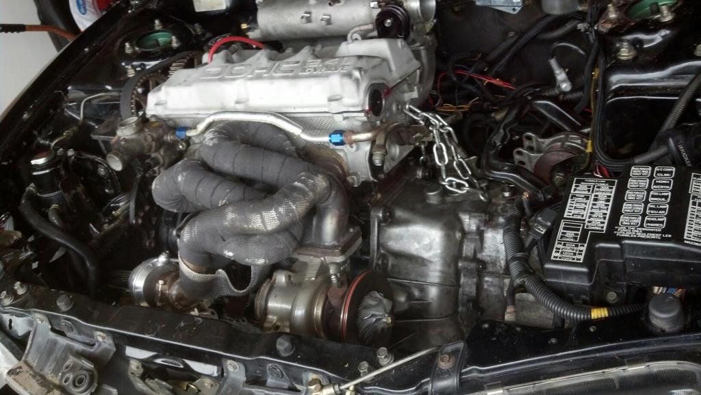

Other than that I heat wrapped the downpipe and whatnot today and tweaked on the tune some more. Still have a ways to go with it but its running better than ever and boost ok up to about 11 psi! More videos to come!
