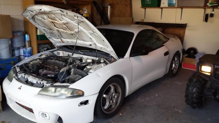

98 Eclipse RS Turbo conversion
jonathanfl
Supporting VIP
91
4
Feb 20, 2014
orlando, Florida
So i was thinking last week i needed something to do since i finished my Avalanche and i had way to much time on my hands, so i spent three weeks trying to buy a decent shell. I had 4 cars in mind specifically for their engines and yes a 420a engine was one of the engines on the list. After being blown off a few times trying to buy a car by different people i was lucky enough to find this shell that looks like the kid who owned it had no clue how to take care of a car. So since last Thursday my research and ordering started.

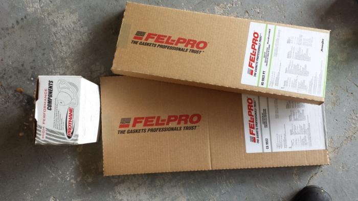

2/28/14
-Cimotorsports:
Felpro Lower Gasket Kit Eclipse/Talon 420a
Prothane Complete Engine Mount Kit Eclipse/Talon 420a
PT Cruiser Style Lifter Set Eclipse/Talon/Neon 420a
Felpro Top End Gasket Kit Eclipse/Talon 420a

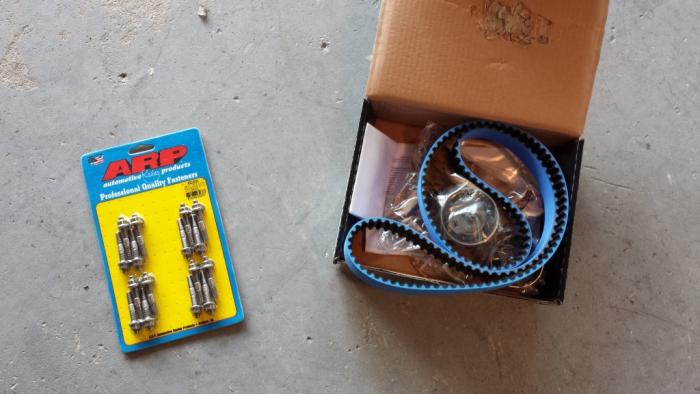

3/1/14
-Modern performance:
Pci mechanical conversion timing belt kit w/ gates racing belt

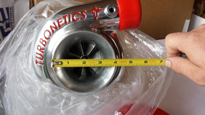

3/13/14
-Treadstone performance

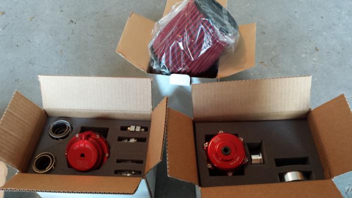

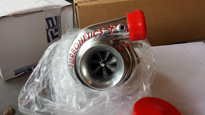

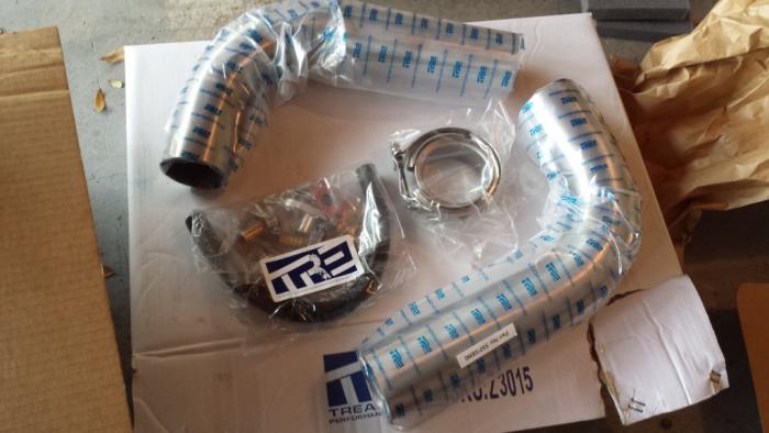

420a turbo kit (discontinued)
Turbonetics hybrid turbo 62-1 (63lbs min ar.63 oil cooled)
Tial Q 44mm waste gate w/ adapter
420a exhaust manifold ---------------------- SOLD
Trv 185 vertical inter cooler ------------ FOR SALE
Tial Q 50mm bov w/ adapter
3" Down pipe with dump tube
Air filter
Oil line kit, gaskets and hardware

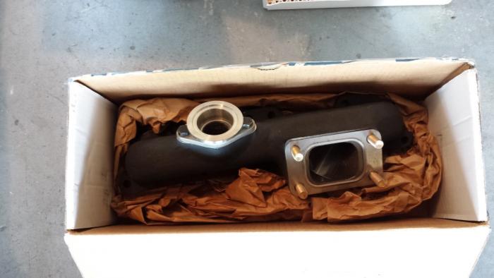

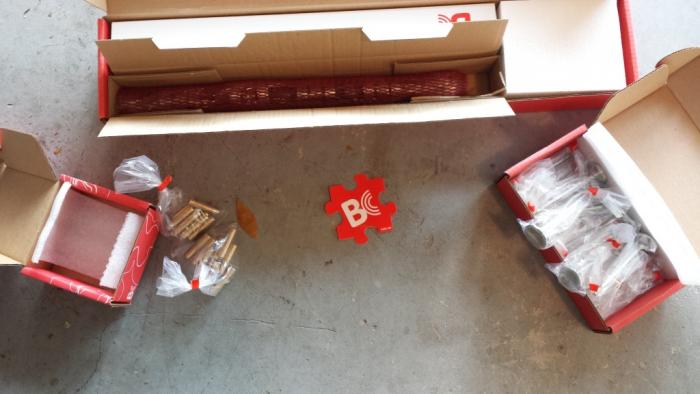

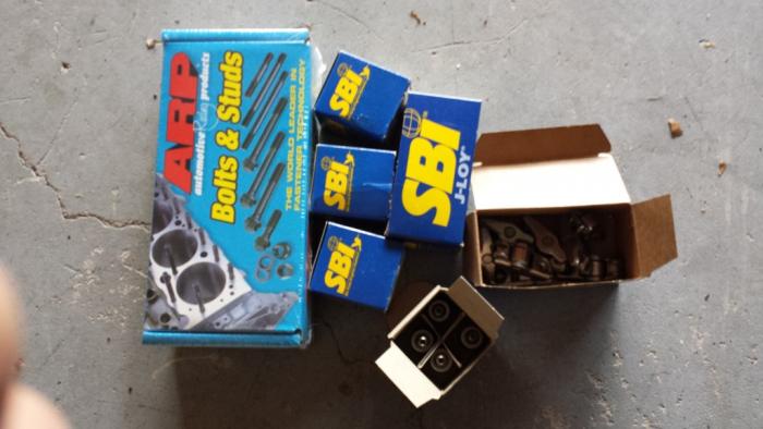

So after three weeks I've gotten in the mechanical tensioner cams and the arp intake/exhaust studs. Had some changes from who I was getting some parts from. luckily I have done so much research I already knew who had what in stock.
Now treadstone did discontinue the 420a turbo kit but luckily they had a few parts and were willing to keep the kit price for me as a base. I upgraded some of the components and came out a little higher in price but I'm thankful they did work with me to get this assembled. Props out to victor with treadstone performance.

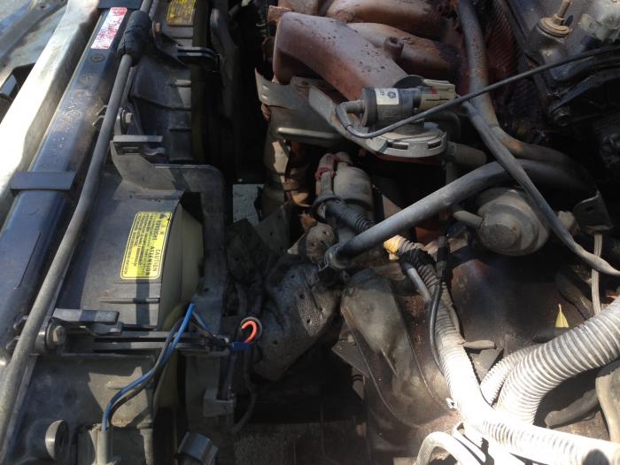

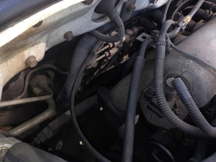

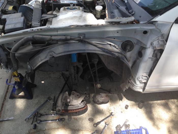

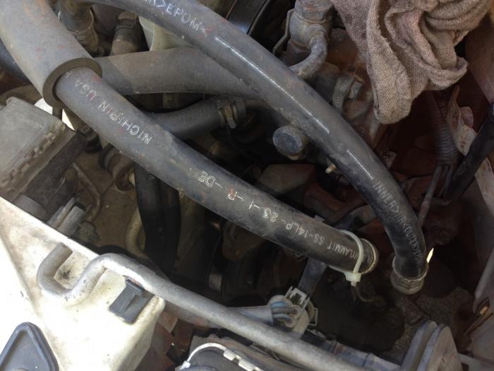

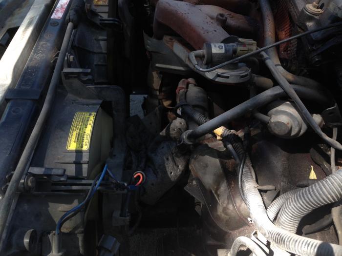

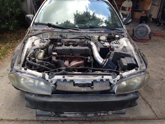

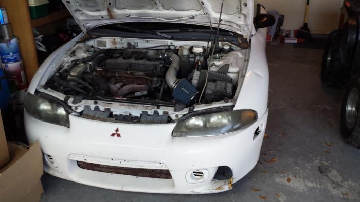

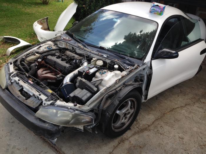

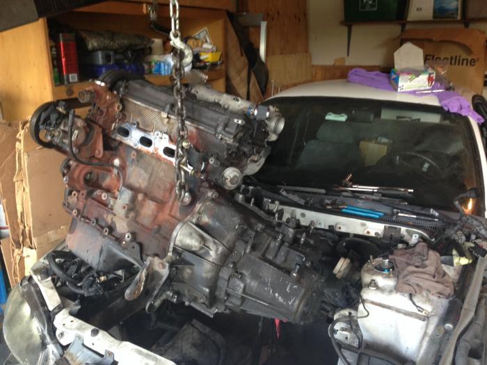

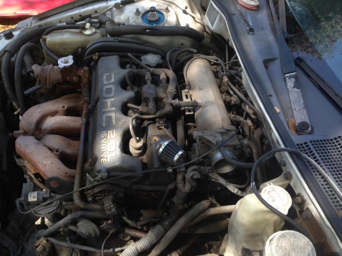

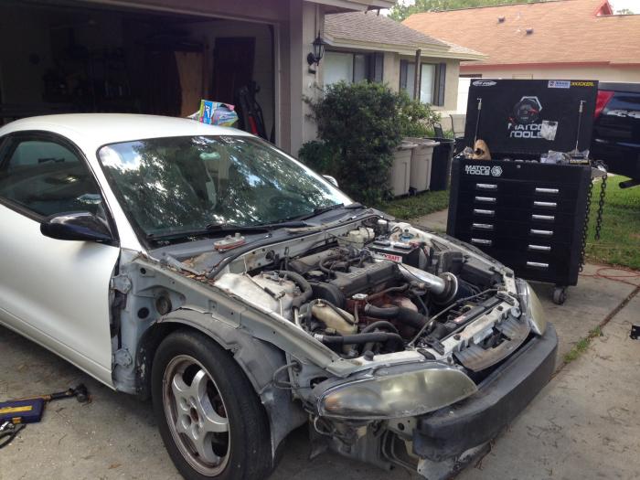

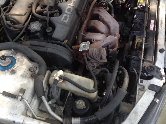

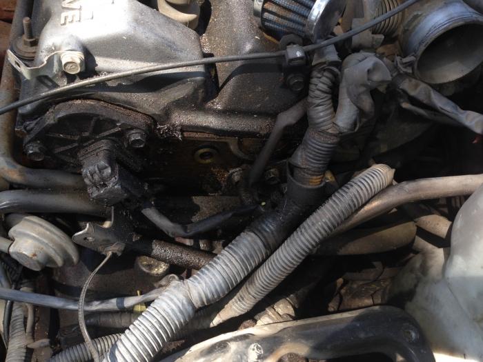

4/12-4/13

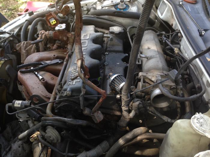

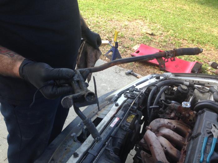

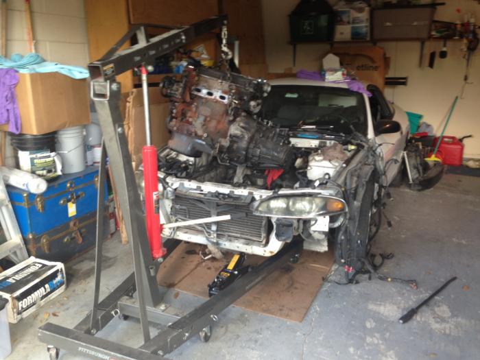

pulled the engine with the boy, finding what parts are beyond repair that i was unaware of. added more things to the list of parts i had to order and just had a fun weekend getting things situated.
Heres a bunch of random photos through the engine removal process.

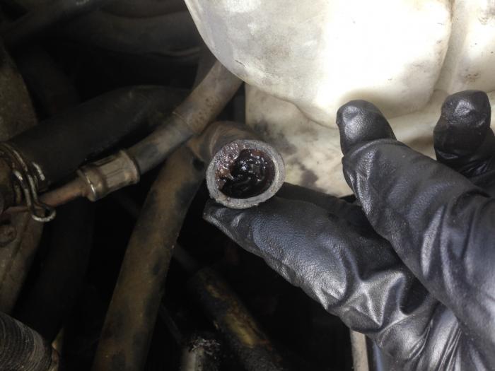

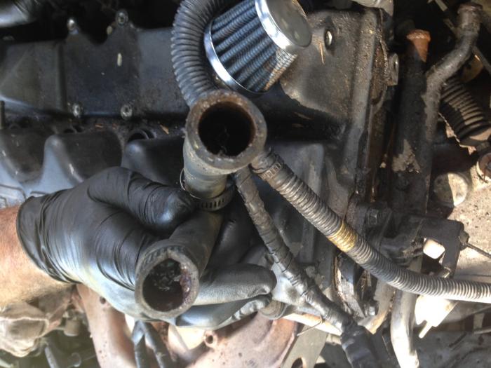

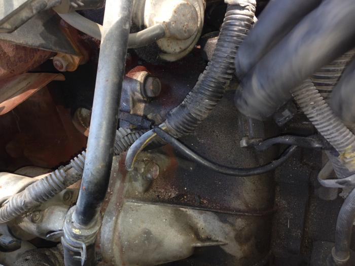

lookin good man, looks like you got things coming along nicely. btw if those heater core pipes look all clogged like they are i wouldnt be surprised if the heater core was clogged up too.
I have not even looked at the heater core im assuming its junk and will be replacing it. Those lines actually were looped together, the rubber hose was actually pinched in a v shape. The thermostat housing disintegrated when I tried to remove the rubber line, so a new housing is on order with custom black steel braided lines for the new heater core. Plan is by the end of the week have everything shipped out for the machine work and upgrades / paint. Wicked excited to see how it all comes out when everything comes back!
