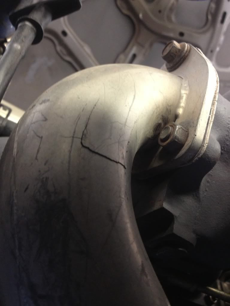

Down pipe was cracked

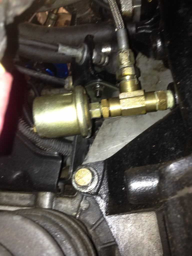

T'd off from the oil sending unit to lubricate the turbo (not a bad move - leaked like a siv)

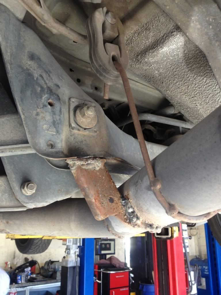

Tac welded (pretty s****y weld job :p) the exhaust to the frame of the car
No brainer that this is junk..

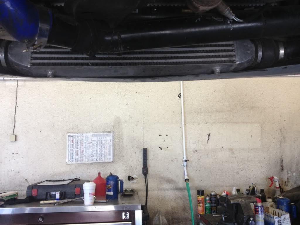

Intercooler just hanging on the bumper.. wasnt even mounted

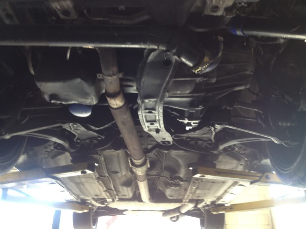

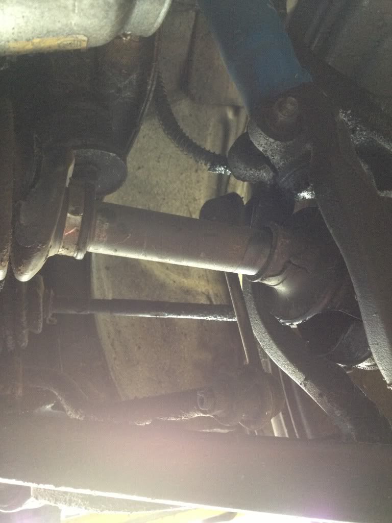

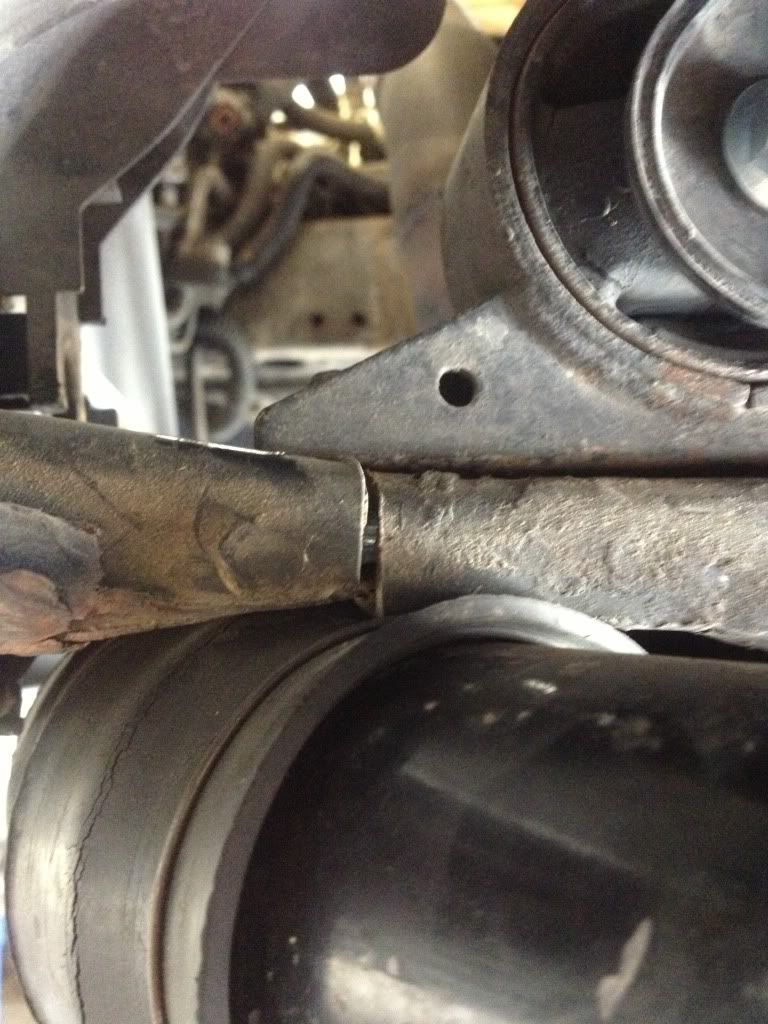

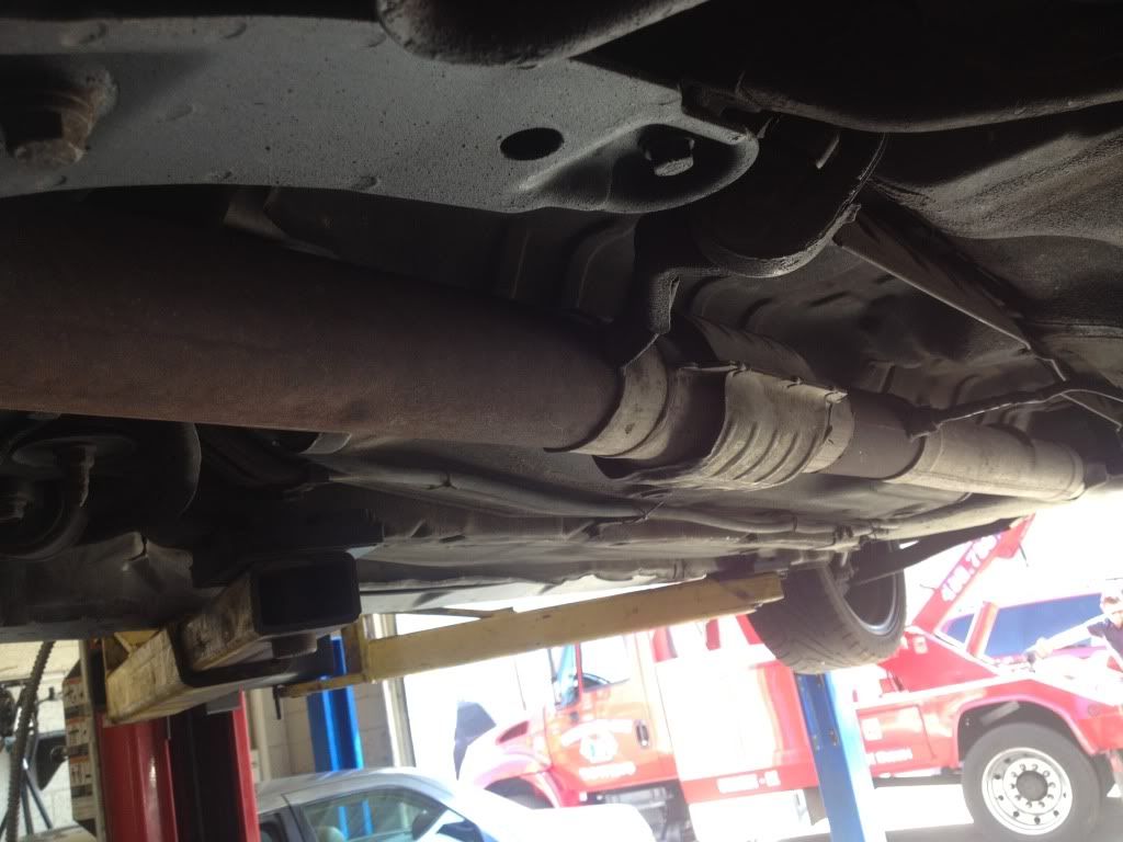

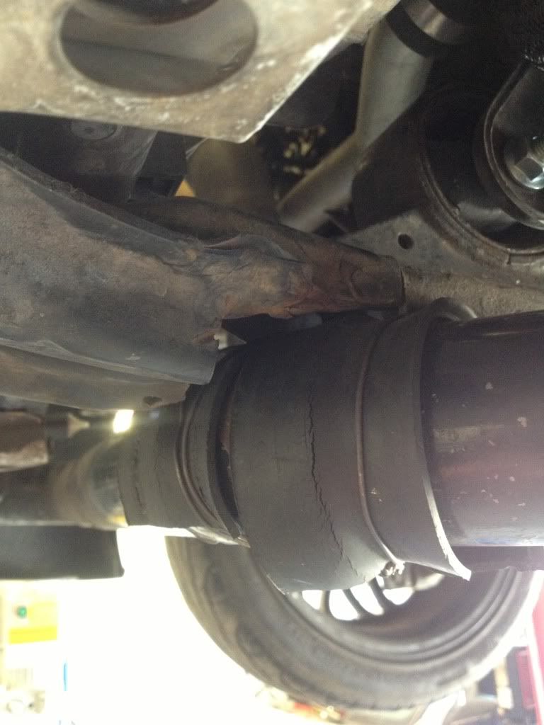

Look at the exhaust from the down pipe.. Not only was their a clear exhaust leak? But this guy knuckled the damn thing 3 times with two different sleeves..
Bad CAT - check engine light ;)

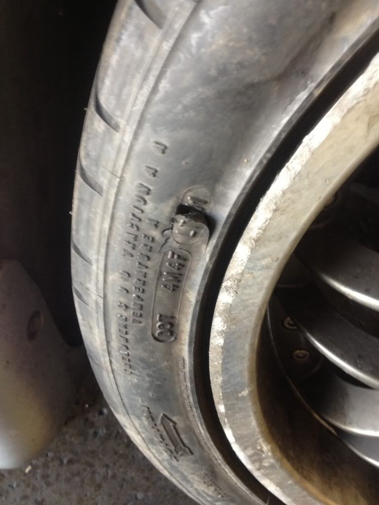

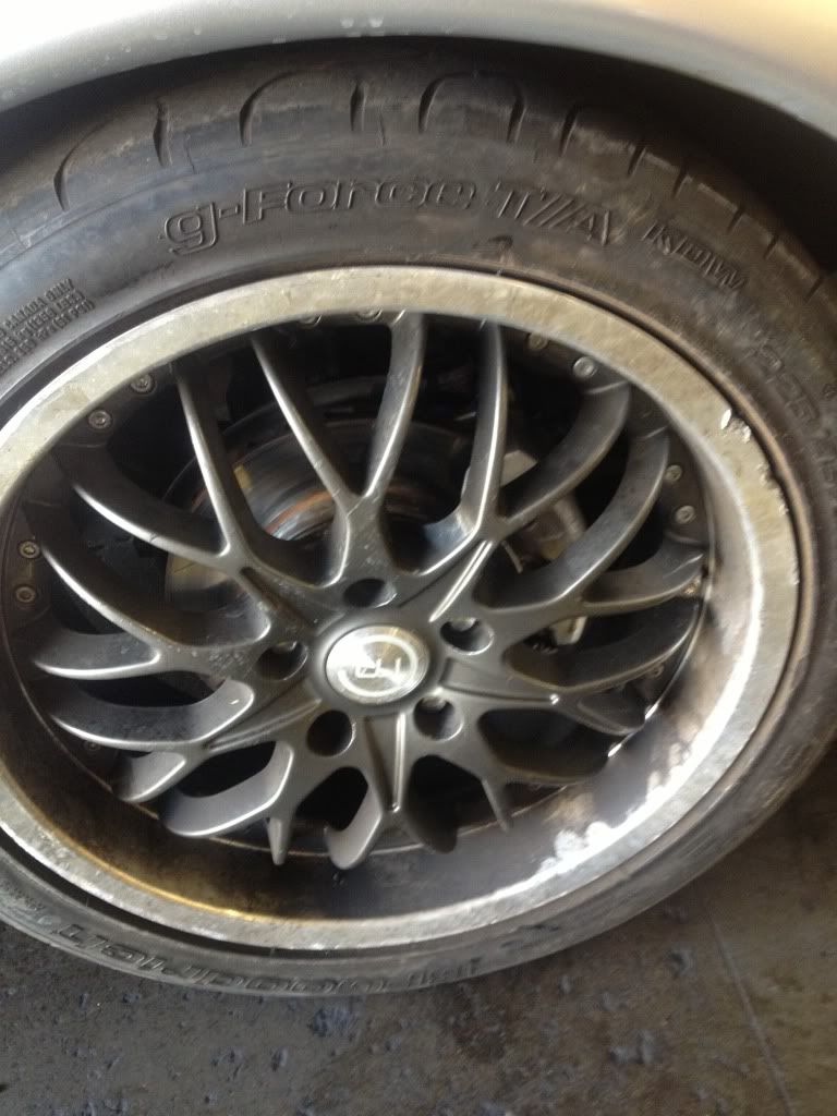

Mmmm that rear tire!
Another chunk hanging off on the front tire.. both passenger side.. and the walls of the rims are destroyed.. someone doesnt know how to drive and probably drove it like a AWD and not a FWD :p

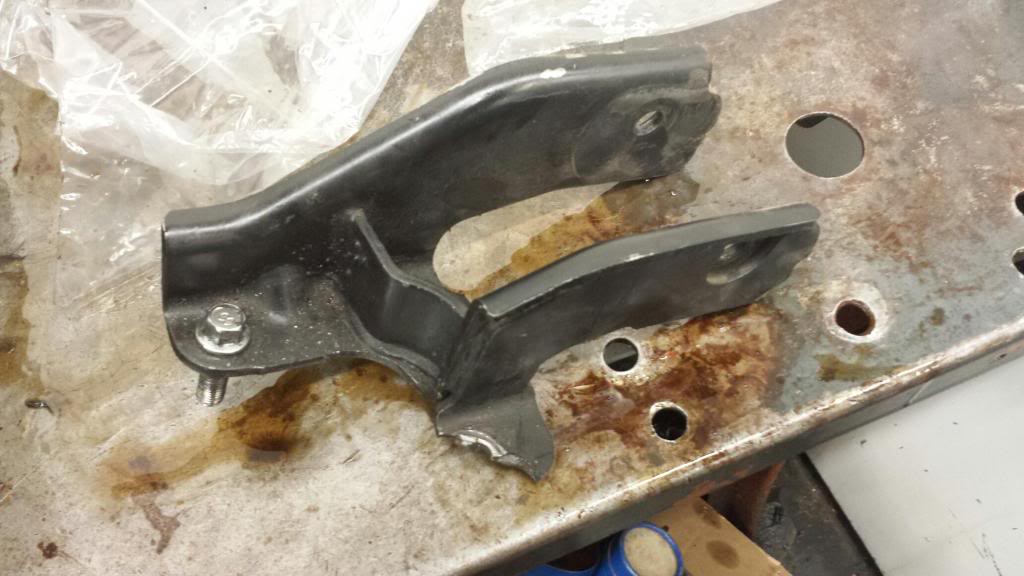

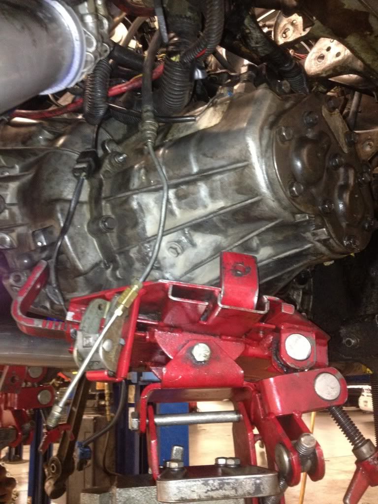

And the transmission bracket that goes to the mount on the sub frame.. clearly was broken and if you look closely.. the 1 bolt that was in there.. wasnt threaded all the way and there is a stud snapped inside the transmission <.<

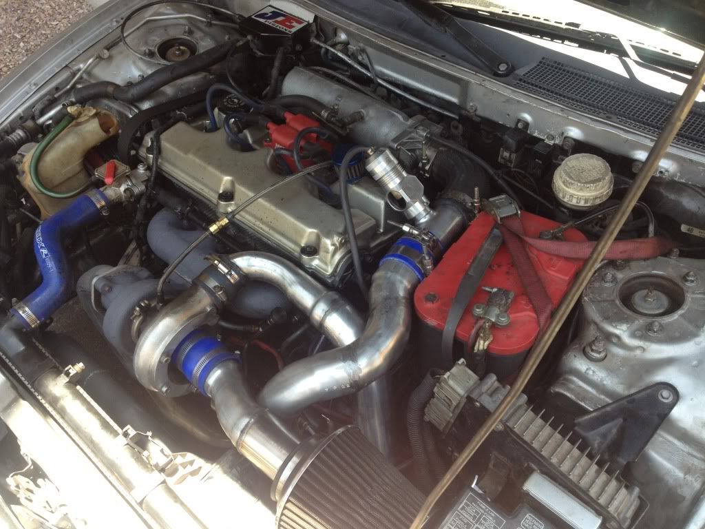

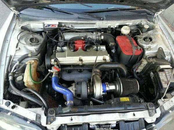

Over the last 2 months.. I have fixed, replaced, upgraded quite a few things mechanically

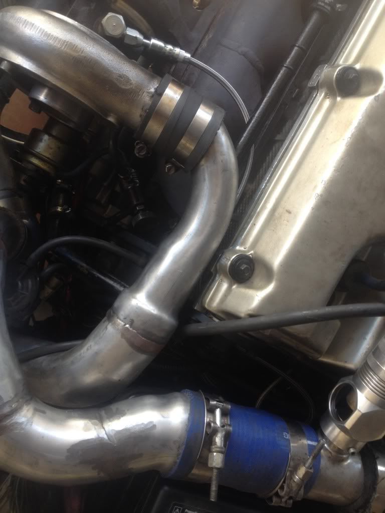

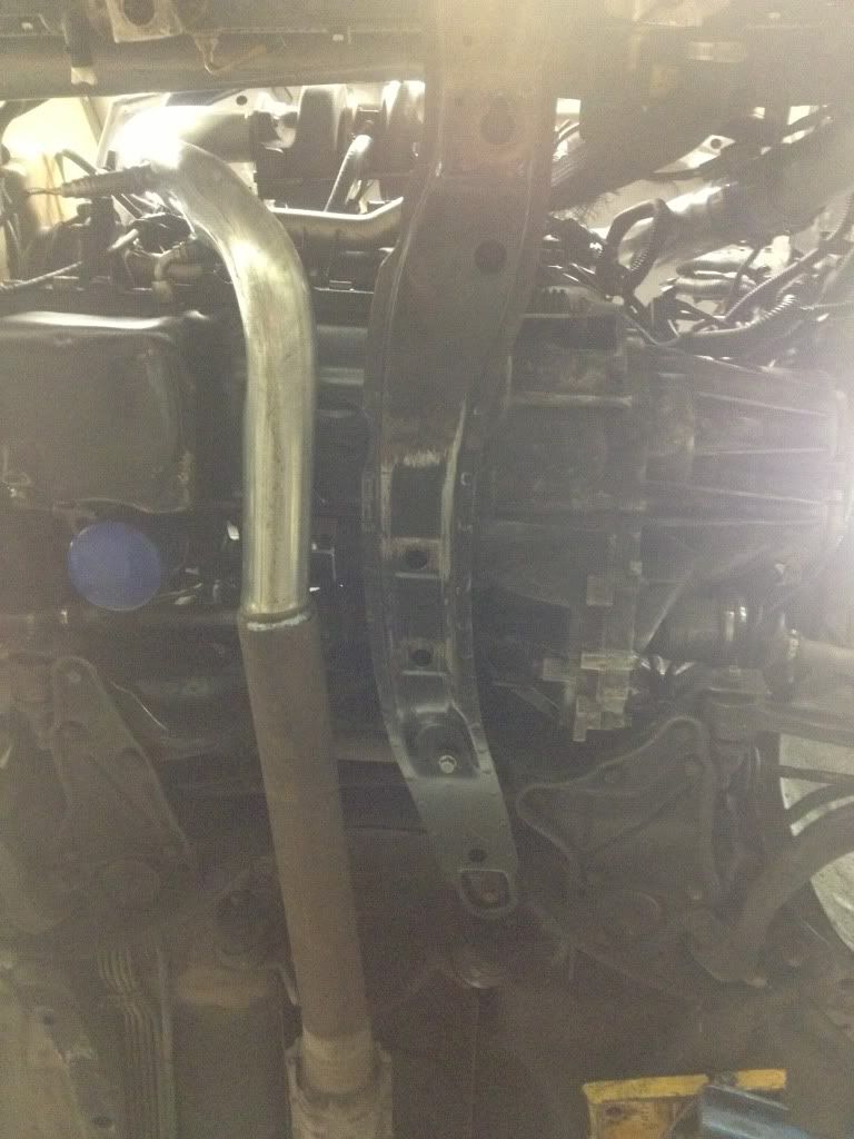

Custom 2.5" Tubing for the entire turbo system
Going to end up retubing the tube from the intake manifold and just do a straight pipe as the battery will be moved to the trunk of the car
Yay for clean welds! And no tripple knuckle / slip on sleeves or exhaust leaks! Like a B.A.M.F. !

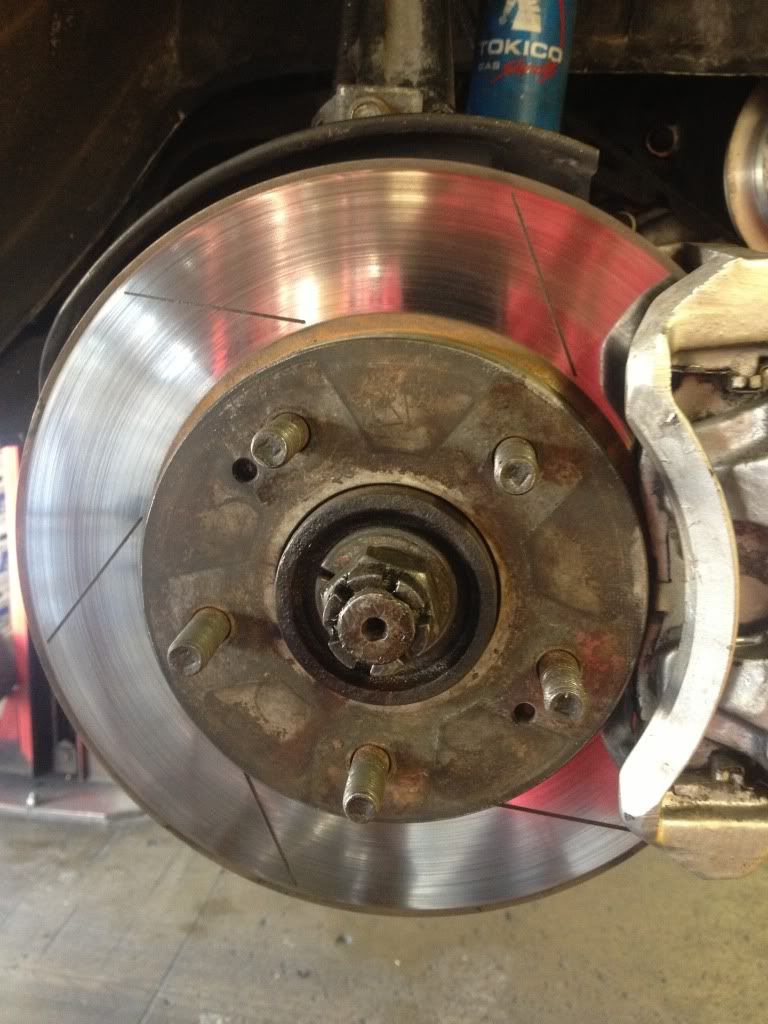

New brake system with Tokico Blue suspension all the way around with coil overs and adjustable cups on the shocks for easy adjustment for ride height :)

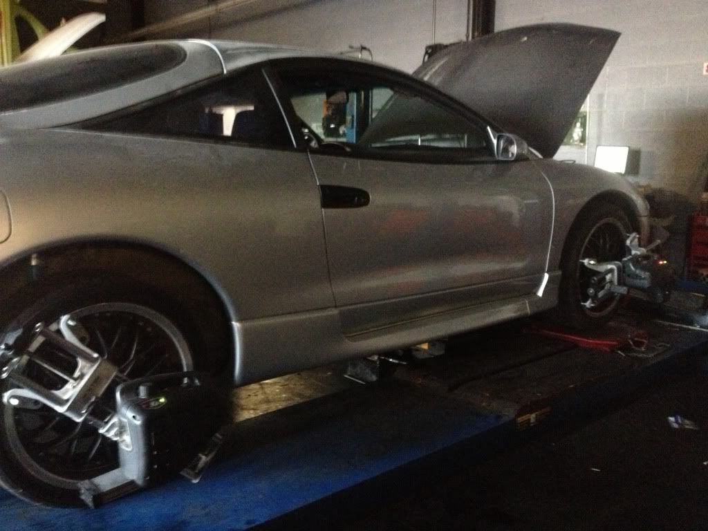

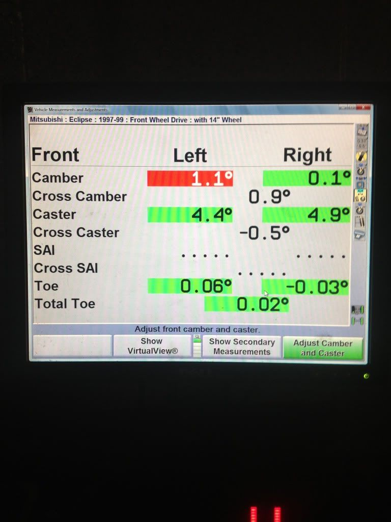

Did an alignment on the car ;)
Only to find out that I have a bad wheel bearing / hub on the driver side.. SO I am sure once this is fixed.. Car will be sitting pretty :)

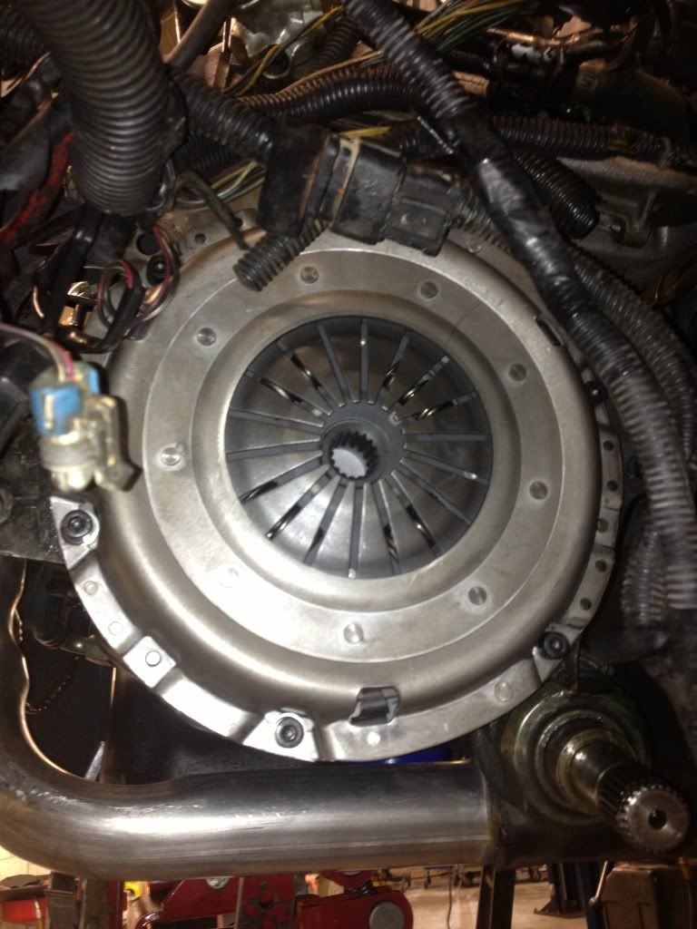

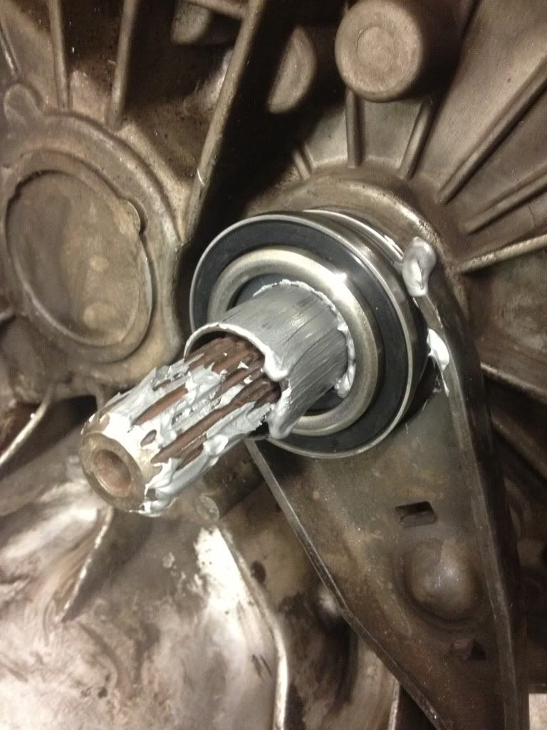

That rebuilt NV-T350 Trans with new syncros and upgraded 1st and 2nd gear for that launch at the green light! I mean >.> when I see some fart packing JDM sitting next to me and honey badger dont give a f*** about dem red n blues!

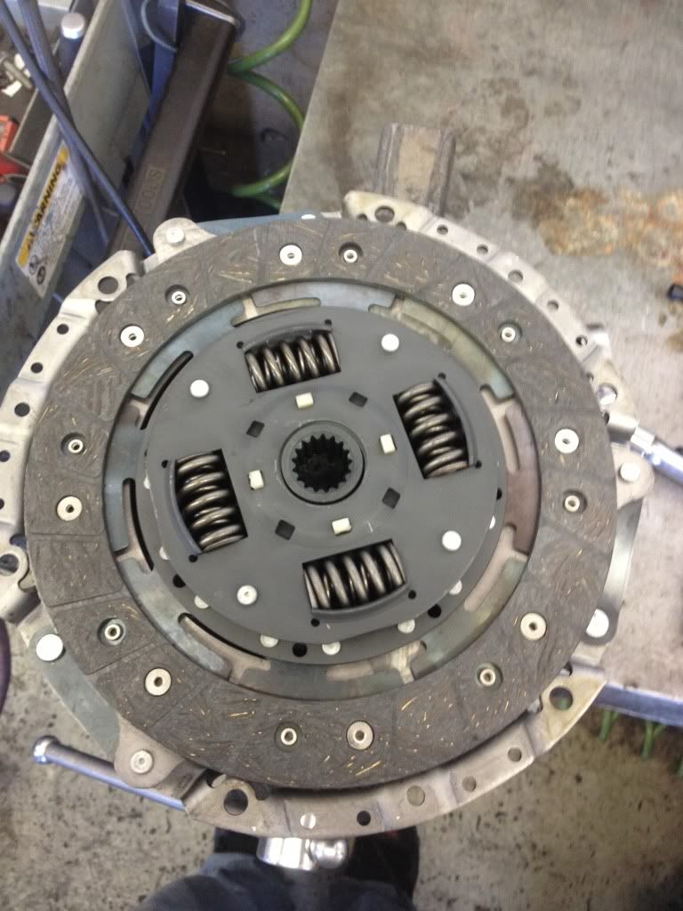

Some of that nasty grease to go with that new sweet performance clutch ^.^
New clutch (disc)
The new and improved s3 LUK Clutch

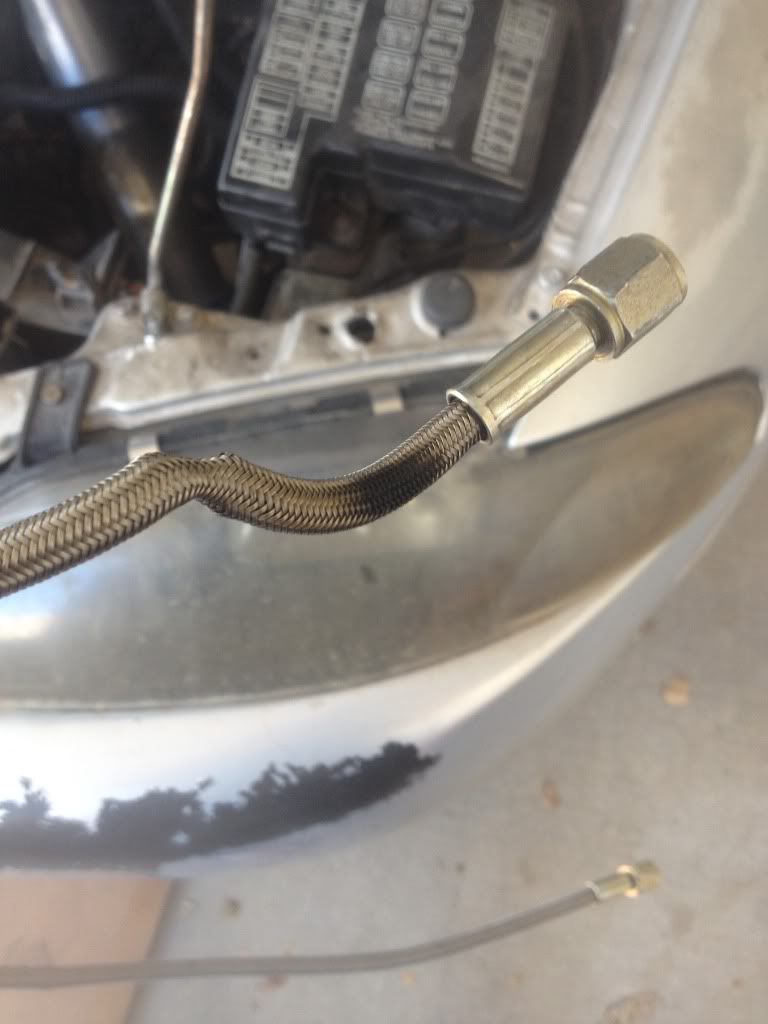

40.00 : New oil line for the turbo - 12" brake line

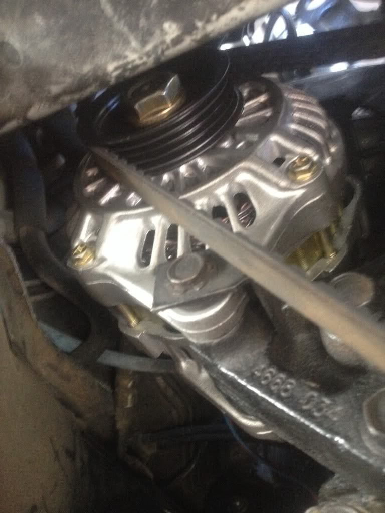

103.34 + 47.00 core : New alternator - bad charge system

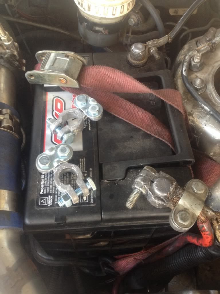

78.00 + 20.00 core : New battery - dead cell

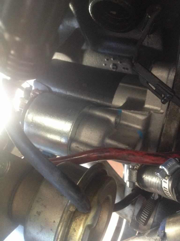

114.72 + 43.00 core : New starter - sylinoid stuck open and oil got into starter

23.50 : Patched rear driver side tire - plenty of tread life and the hole was from a small nail

You can see in this last photo how I wrapped it around the side of the block and down passed under the manifold to the sending unit :) so no more torquing the oil line and making the line brake and have one of these issues again
