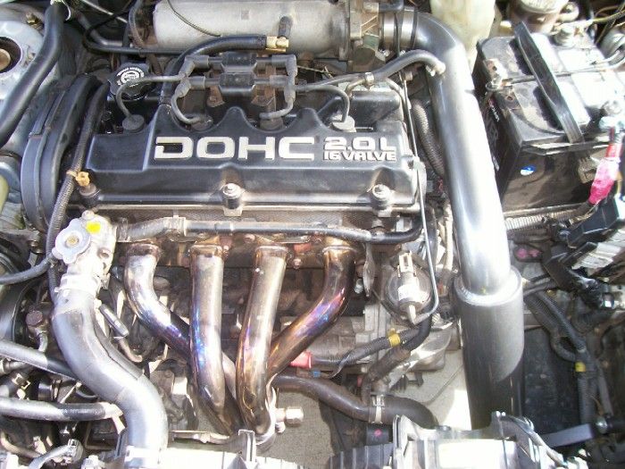

My first mod for the car other than sound was a AEM V2 cold air intake and an SSAutochrome 4-1 header...
<img src="http://www.dsmtuners.com/gallery/files/5/0/1/3/9/tunerspic3.jpg" alt="Gallery Pics for Slo2gen" />

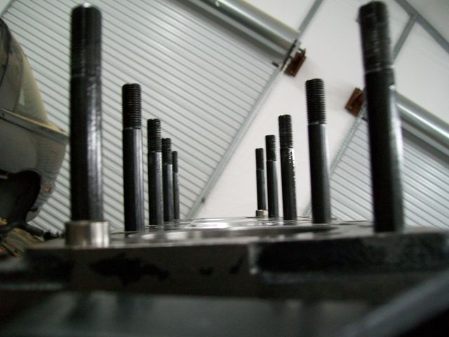

So, I don't have any pics of the next few setups but I'll at least note them in this documentation. I got the 8.8 bottom end in and also got a head rebuild kit from howell automotive that consisted of Crane 12
s, Crower Ti retainers, Crower valve springs, and PEP +1mm stainless valves.
EDIT: I found some pics...
http://www.dsmtuners.com/forums/attachment.php?attachmentid=70397&stc=1&thumb=1&d=1283290800
http://www.dsmtuners.com/forums/attachment.php?attachmentid=70398&stc=1&thumb=1&d=1283290800
http://www.dsmtuners.com/forums/attachment.php?attachmentid=70399&stc=1&thumb=1&d=1283290800
and the head...
http://www.dsmtuners.com/forums/attachment.php?attachmentid=72596&stc=1&thumb=1&d=1283291926
http://www.dsmtuners.com/forums/attachment.php?attachmentid=72598&stc=1&thumb=1&d=1283291926
http://www.dsmtuners.com/forums/attachment.php?attachmentid=72599&stc=1&thumb=1&d=1283291926

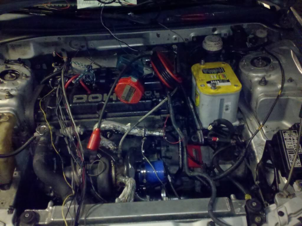

I got it all together and ran the car for a few thousand miles and said to hell with it, I'm installing a Zeitronix WB/EGT/Boost system and MS :D
http://www.dsmtuners.com/forums/attachment.php?attachmentid=76350&stc=1&thumb=1&d=1283293704
http://www.dsmtuners.com/forums/attachment.php?attachmentid=76351&stc=1&thumb=1&d=1283293704
http://www.dsmtuners.com/forums/attachment.php?attachmentid=76352&stc=1&thumb=1&d=1283293704
here you can see my fuel solenoid as well and new GM IAT gauge for MS
http://www.dsmtuners.com/forums/attachment.php?attachmentid=76353&stc=1&thumb=1&d=1283293704

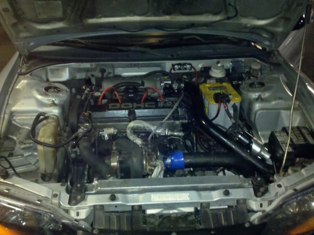

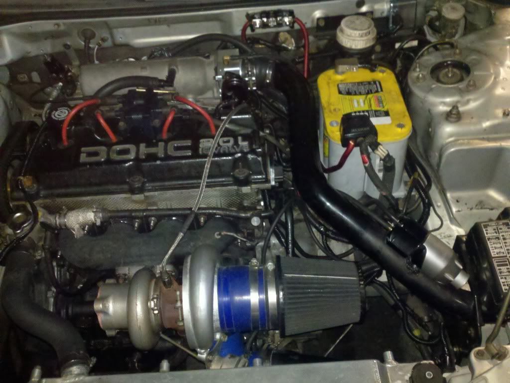

So about 15k miles after this I finally got a turbo kit(second hand) and installed it with a Hahn upgraded SMIC. Started it up and ran great for about 1k then I started getting a oil light flicker at idle when hot. Turns out the guy sold me a bad turbo and crap from the turbo got into the oil and then into the bearings....:(
http://img399.imageshack.us/img399/815/1007082056sr3.jpg
http://img393.imageshack.us/img393/3339/0909080904ww9.jpg
http://img399.imageshack.us/img399/1613/0724080052wn3.jpg

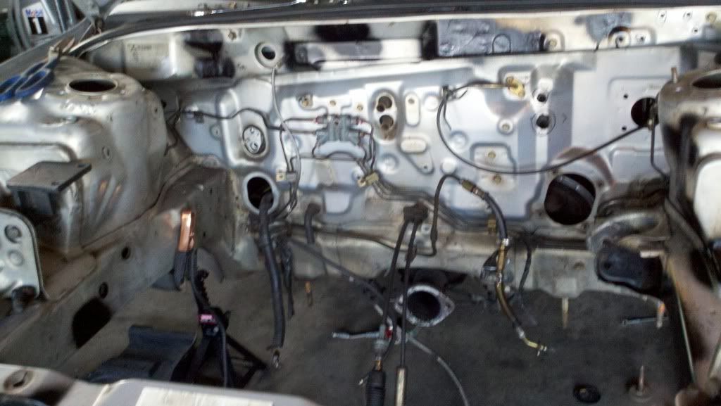

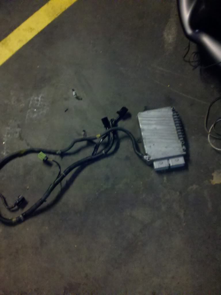

So I get a new MSnS and install it and finally I'm ready to go, but during all this down time I decided to remove my stock ecu and go complete stand alone with MS...

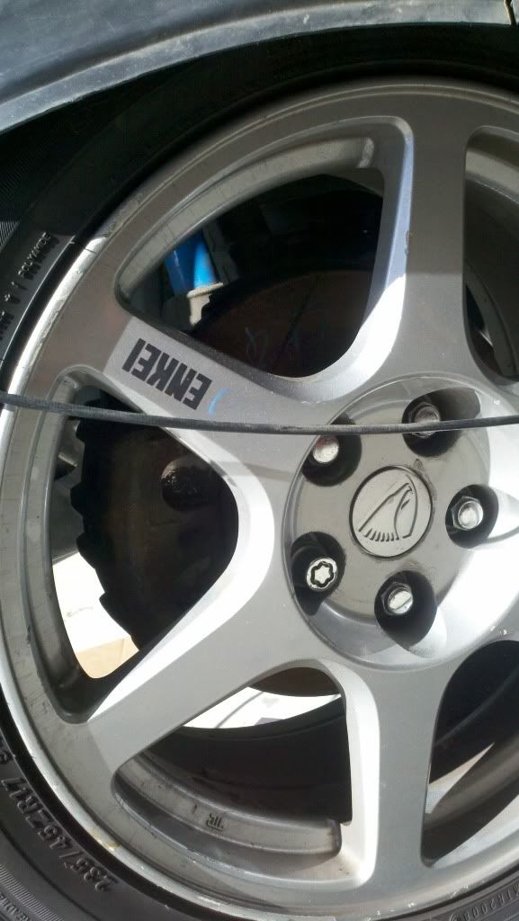

And get some Evo 8 Enkies and Tokico Blues and Prokits, and add a little Eagle touch to the Enkies
http://dl.dropbox.com/u/5658928/Enkie Evo 8 Talon center caps

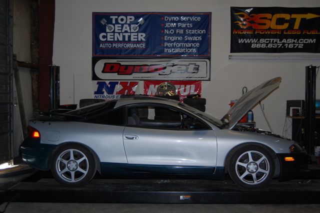

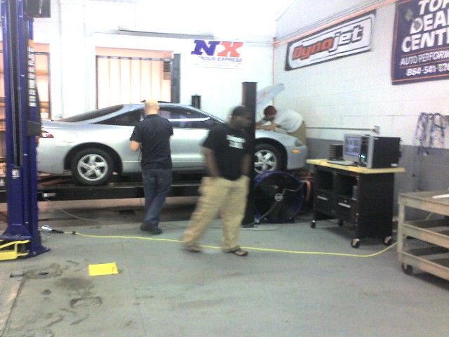

THEN I FINALLY GET ON THE DYNO!!!!!!!
http://i672.photobucket.com/albums/vv89/tdcweb/eBlogger/9-30-10.jpg
Video:
TDCauto.com - 420a Eclipse - 25g Turbo - E85 Dyno Tune - YouTube
Chart:
http://dl.dropbox.com/u/5658928/Dyno Pics/Zac 18psi wafr.jpg
The dip in the chart is from the internal gate and "homemade" boost controller.

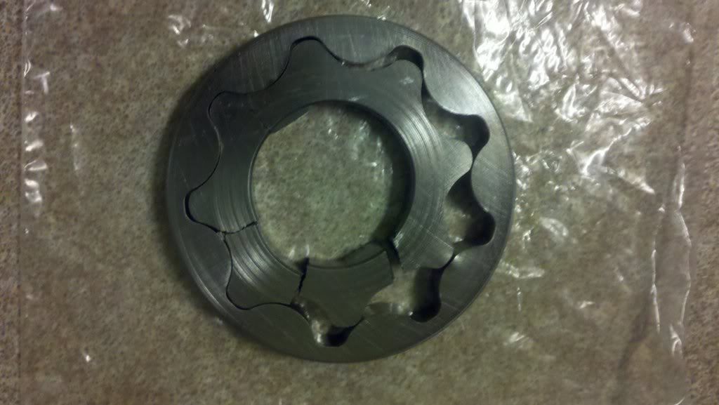

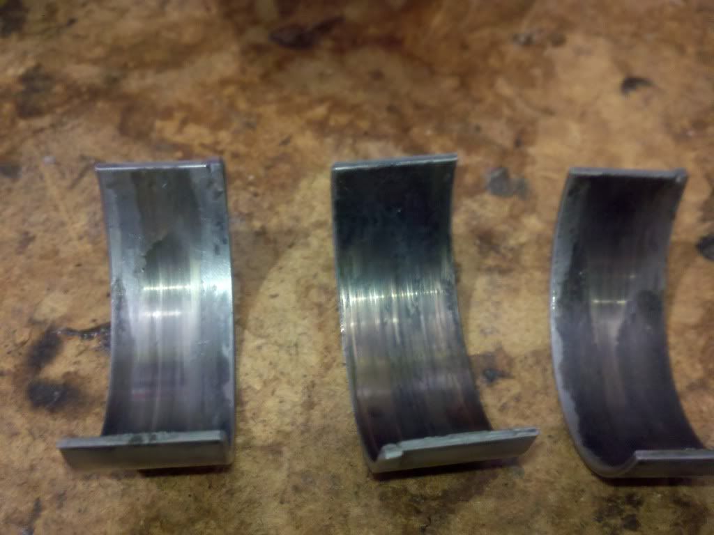

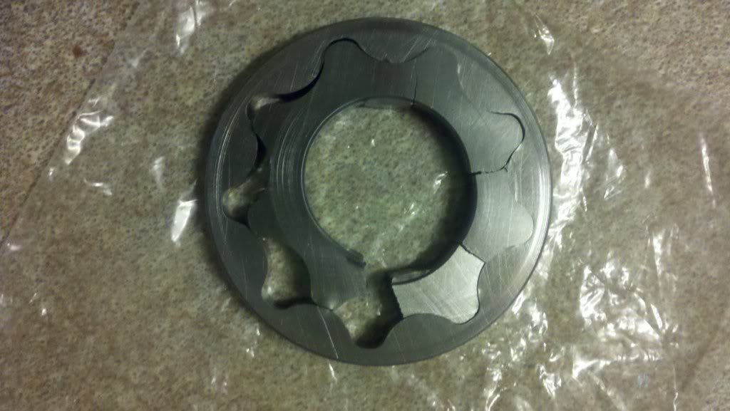

Then after that pull on the video I start the car to up the boost some more :D and I notice the oil pressure gauge didn't move :(
Ends up being a cracked oil pump ring gear in three spots...WTF!
So now its getting close to where I'm at currently!
I took the motor out and was going to throw some bearings in it...
But sold it to a friend and went with something a little bit bigger :p

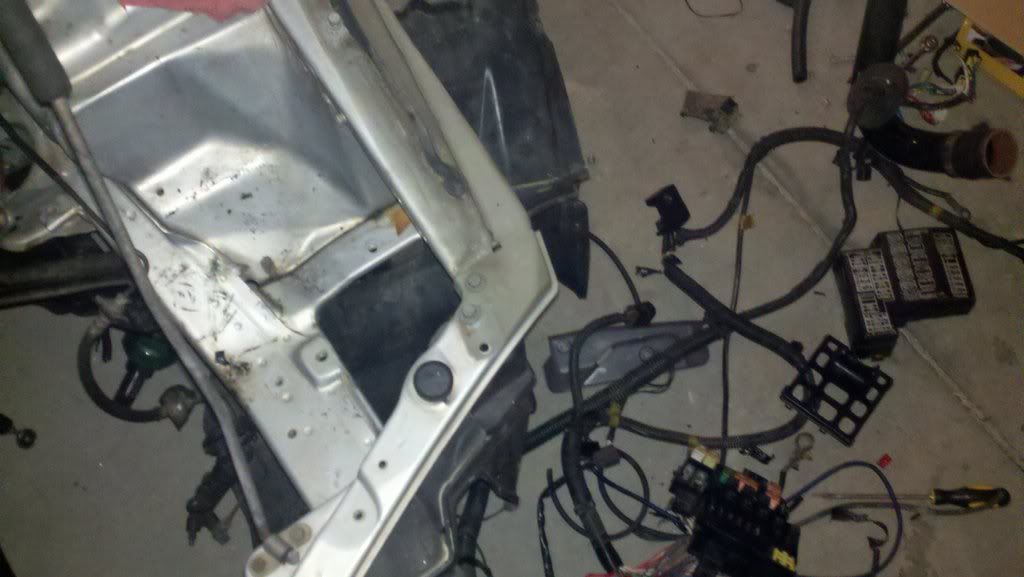

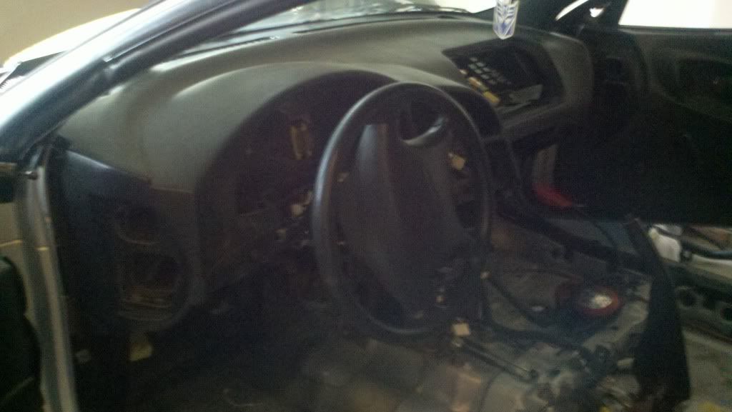

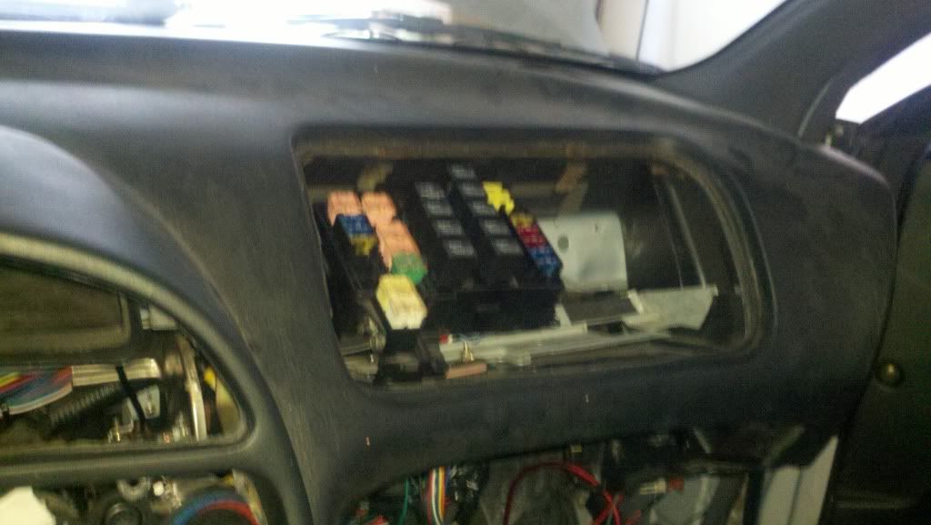

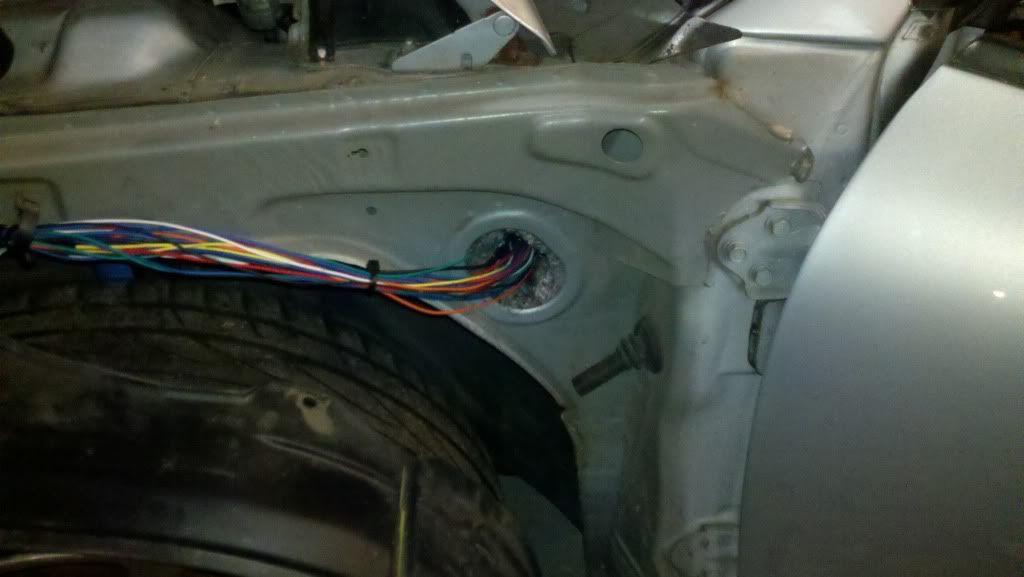

Took the dash out and started relocating my fuse box to where the passenger airbag used to be :D

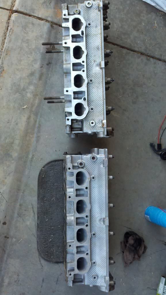

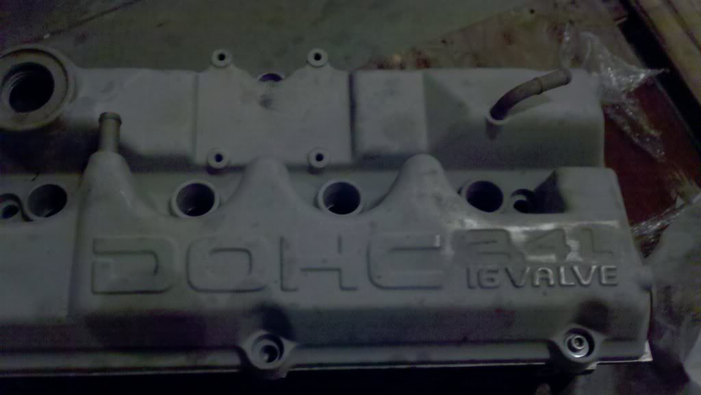

Also picked up a head that was just like mine as far as hardware but had been ported by Eddie Fierro!

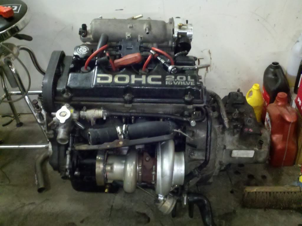

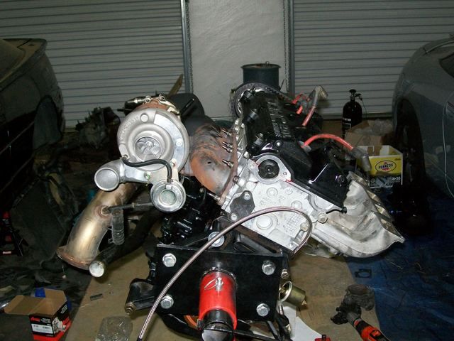

I got the motor sitting in the car but am going to have to remove it, its just in for mock up purposes :D

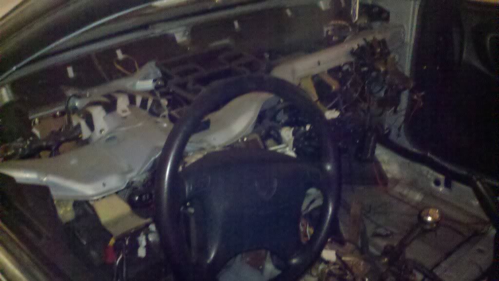

Got the dash back in the car!
And thats where I'm at now...planning on something a bit differnt and hopefully make over 700whp. What I lack is some injectors, my MS3X assy, some custom piping, pistons, rods, clutch, half radiator, a turbo rebuilt, buy a bigger turbo :D and an oil cooler.

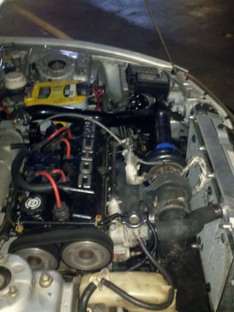

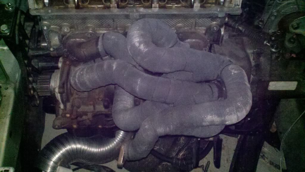

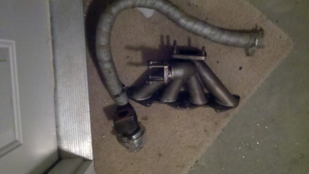

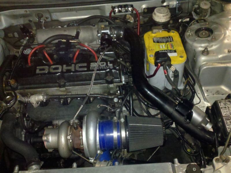

Well I got a bit of an update, I finally have the manifold I'm gonna stick with....

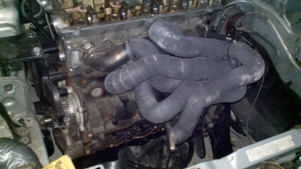

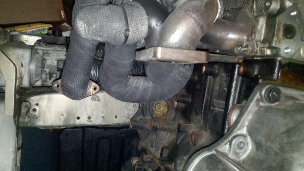

Finally got the wastegate flange changed on the manifold....
<a href="http://s1011.photobucket.com/albums/af232/slo2g/Eclipse%20Pictures/?action=view&amp;current=manifoldwastegate2.jpg" target="_blank"><img src="http://i1011.photobucket.com/albums/af232/slo2g/Eclipse%20Pictures/manifoldwastegate2.jpg" border="0" alt="Photobucket"></a><a href="http://s1011.photobucket.com/albums/af232/slo2g/Eclipse%20Pictures/?action=view&amp;current=GetAttachmentaspx.jpg" target="_blank"><img src="http://i1011.photobucket.com/albums/af232/slo2g/Eclipse%20Pictures/GetAttachmentaspx.jpg" border="0" alt="Photobucket"></a>

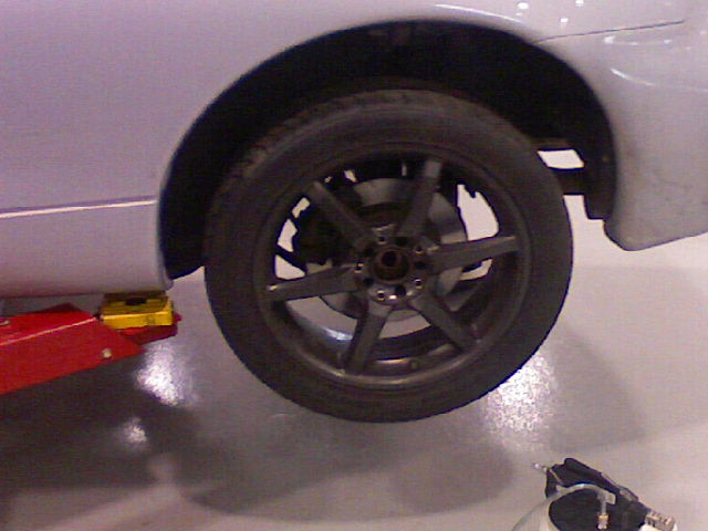

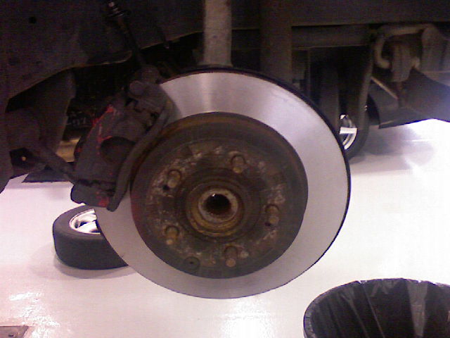

Test fit the 3kgt brakes, still need to get the RRE lines since they are a 1g style caliper

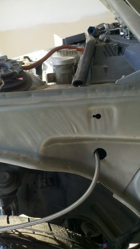

Routed my clutch line since the master to slave line is so LOOONG, figured I'd try to hide some of the line... still need to get a gromet and wrap the line so it won't chaff...

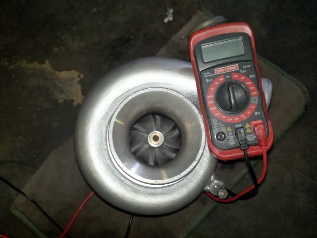

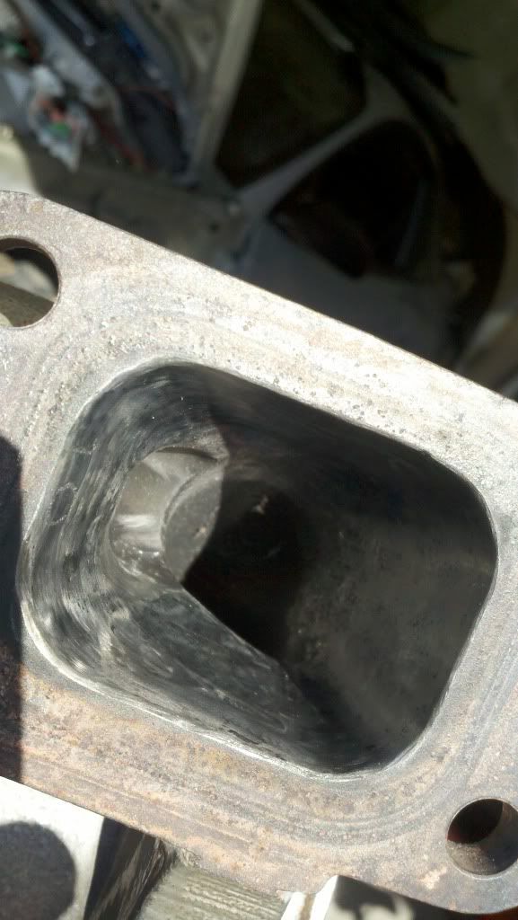

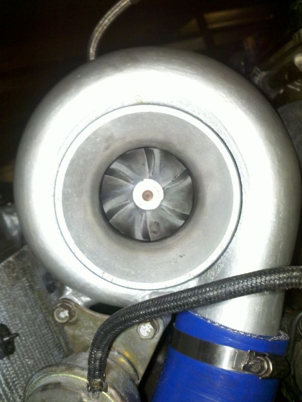

Cleaned up the casting on my turbine housing, want to get a carbide bit and port match it still...

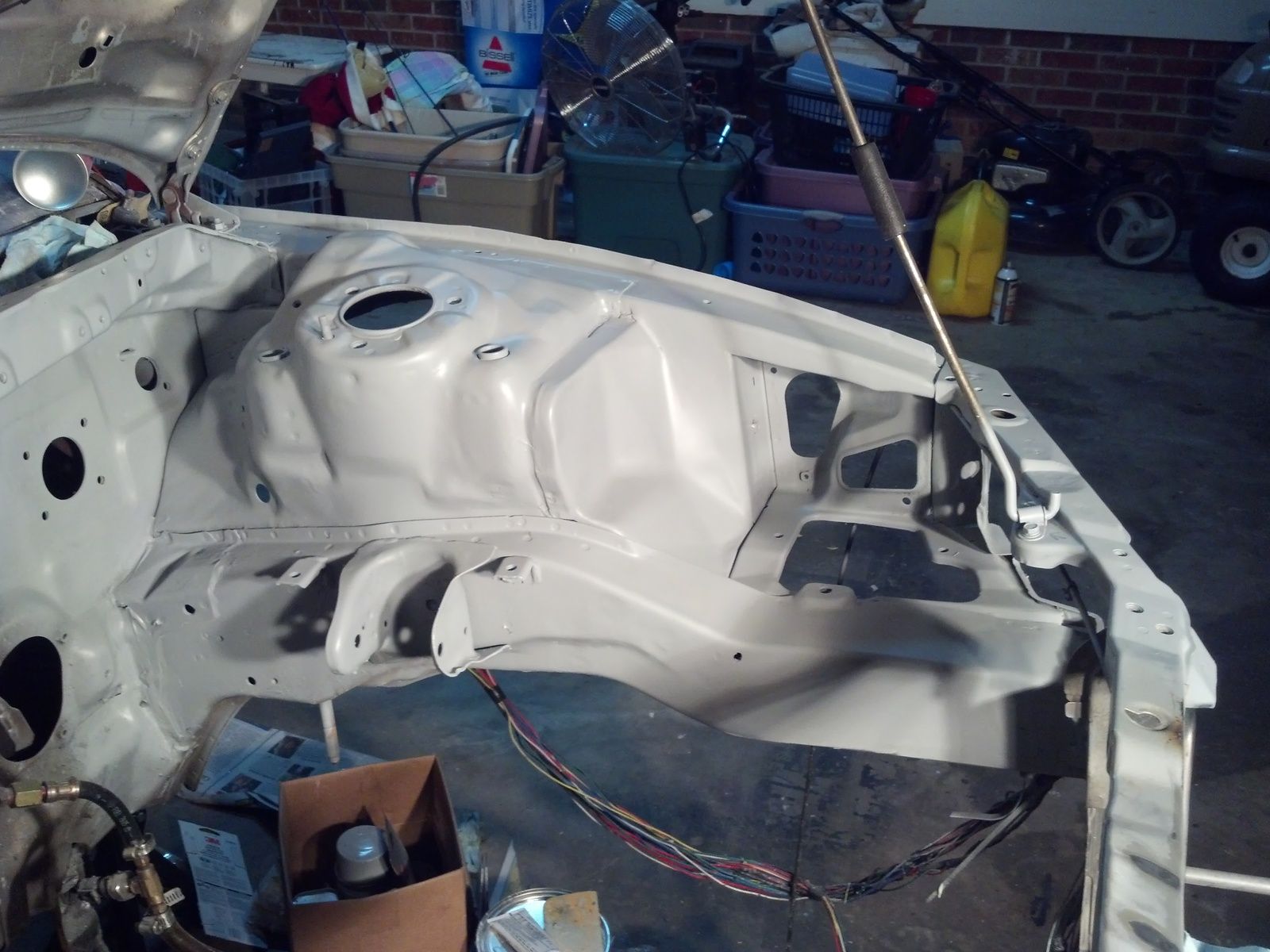

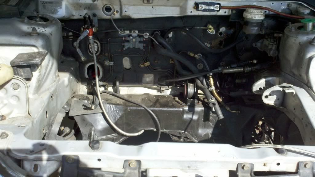

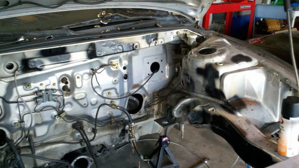

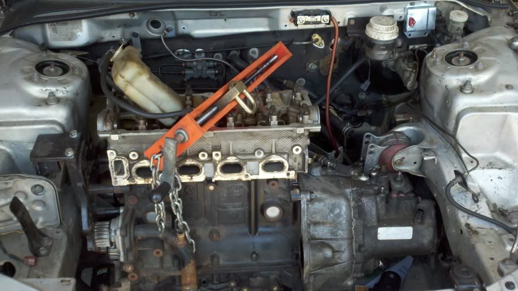

And pulled the motor to clean the bay and do the timing belt and what not(2.4 makes it near impossible to do a timing belt inside the car...
And thats where I'm at today...almost there!:rocks:

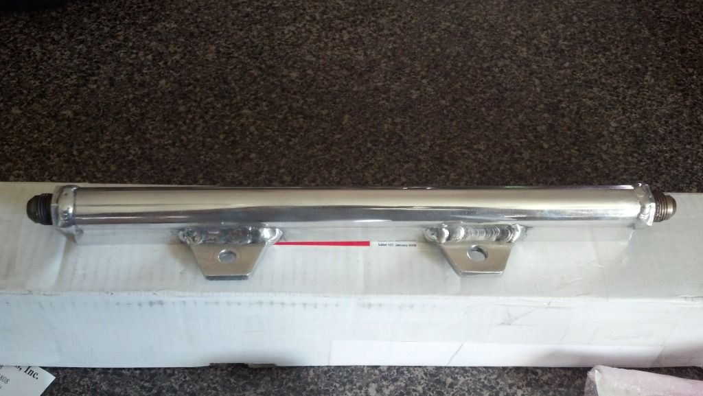

and an 8an fuel rail...

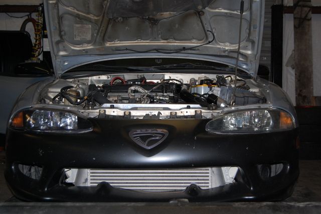

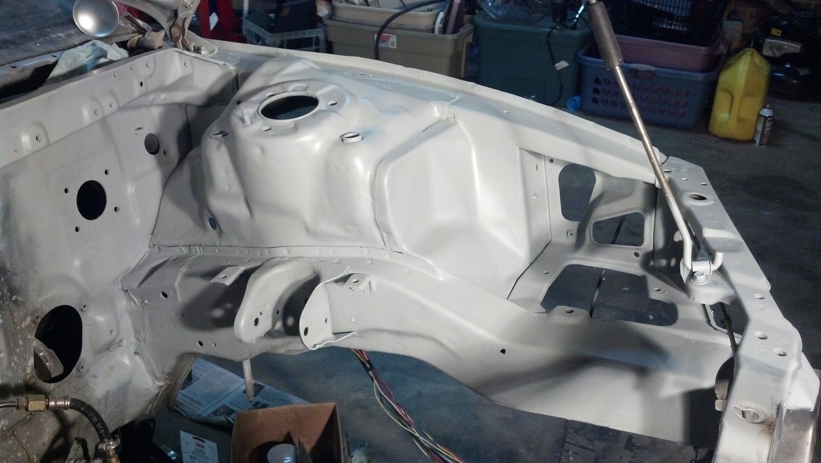

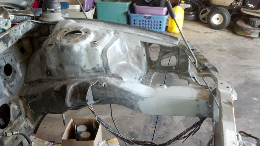

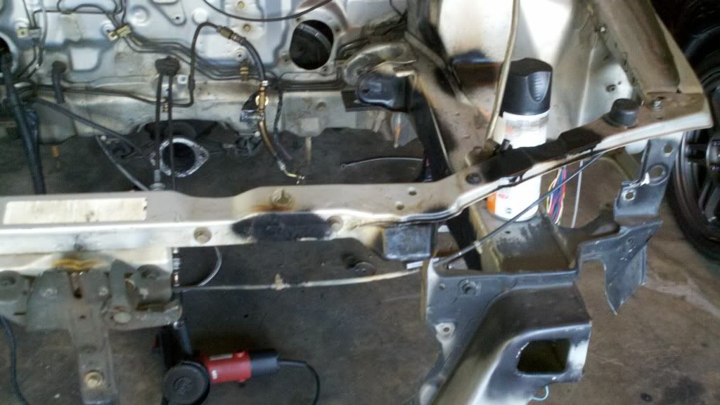

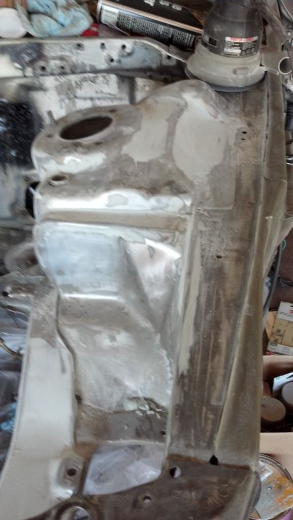

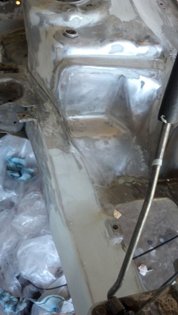

We did a little work tonight, still need to touch up a few places and then start on the other side!

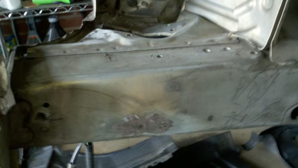

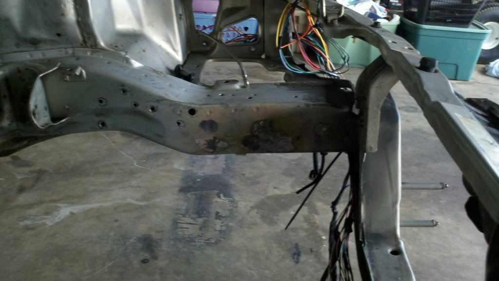

I'm actually tired of doing this crap and I'm ready to get the motor and what not in but I'm kind of in it too far at this point, it needs a hole rewelded up and then TONS more sanding. Then hopefully some paint!
So this project is officially over, I have procured another 2gnt with the plans of swapping all my parts into. So there will be updates again as I have just sent my MS3x out to be built and ordered the 2.4 headstuds, it won't be long till I have a running 2g again!
