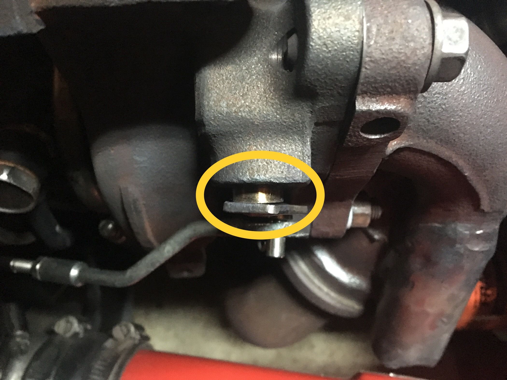

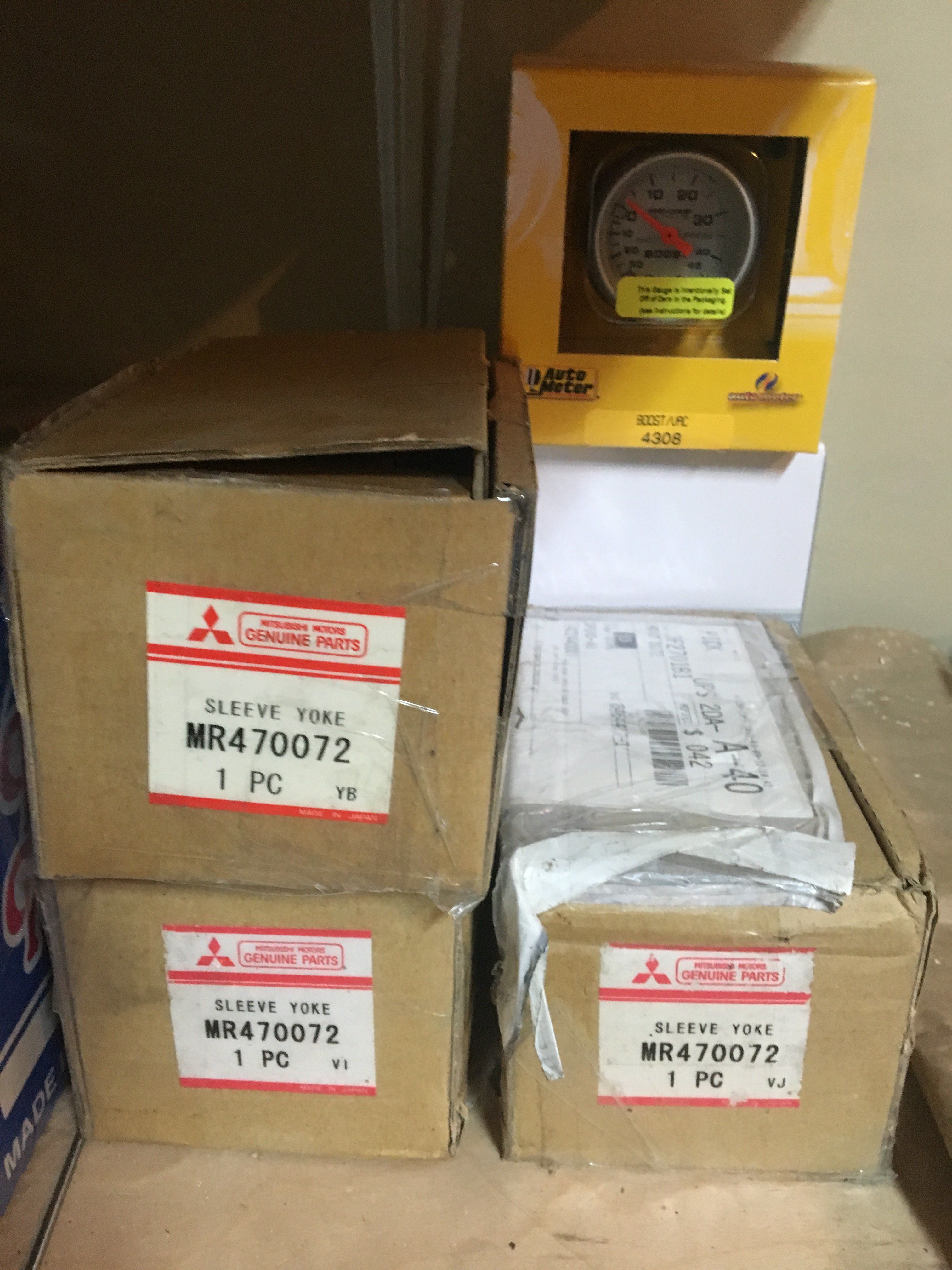

I appreciate it Marty! And yes, start at the last orange, it’s an old habit :hellyeah: Lol eating a sandwich. I’m no mathematician, but cooler weather + e85 + more boost + more timing should = 11.999999999. Haha. Also, my driveshaft needs a rebuild, so I was leaving 1/2 throttle until it gripped. It’s heart pounding when the rear end feels like it’ll be left at the starting line. They’re ordered, so I’ll be getting that situated in the next month. Gosh it’s so darn expensive. I got everything from amayama.com except for the three yoke kits. Total cost was $420 shipped, so I save $80. Oem of course.

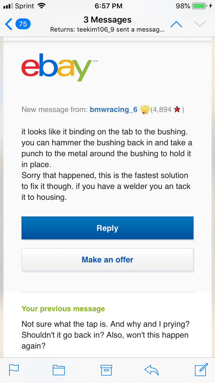

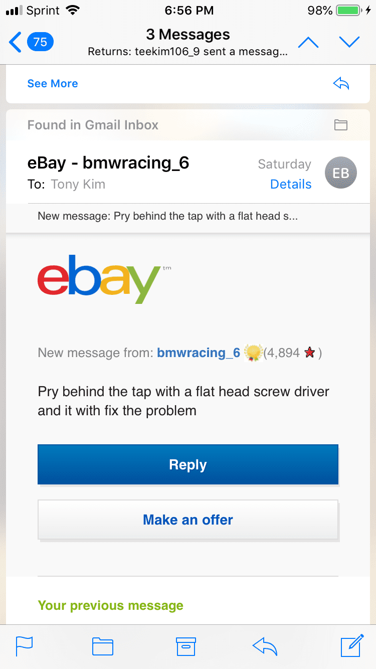

Funny you say that. I emailed them a pic and got a couple of wonky responses. Forgot exactly what they said but they wanted me to “pry” & “weld”:ohdamn::confused: I’ll have to find the message.

his reply actually does make sense.
stick the flat head between the arm and the bushing and try to pry the bushing back into the housing.
hes saying to drive it back in and then peen the edges with a punch to hold it from coming out again. or just tack it once you get it in.
shouldn't have to since its so new, but at this point, it is the easiest thing to do
I see. I ended up using the side of a hammer and tapped it back in place but it started coming out again plus it was sticking fully open or fully closed. Decided not to mess with it and let them deal w it.

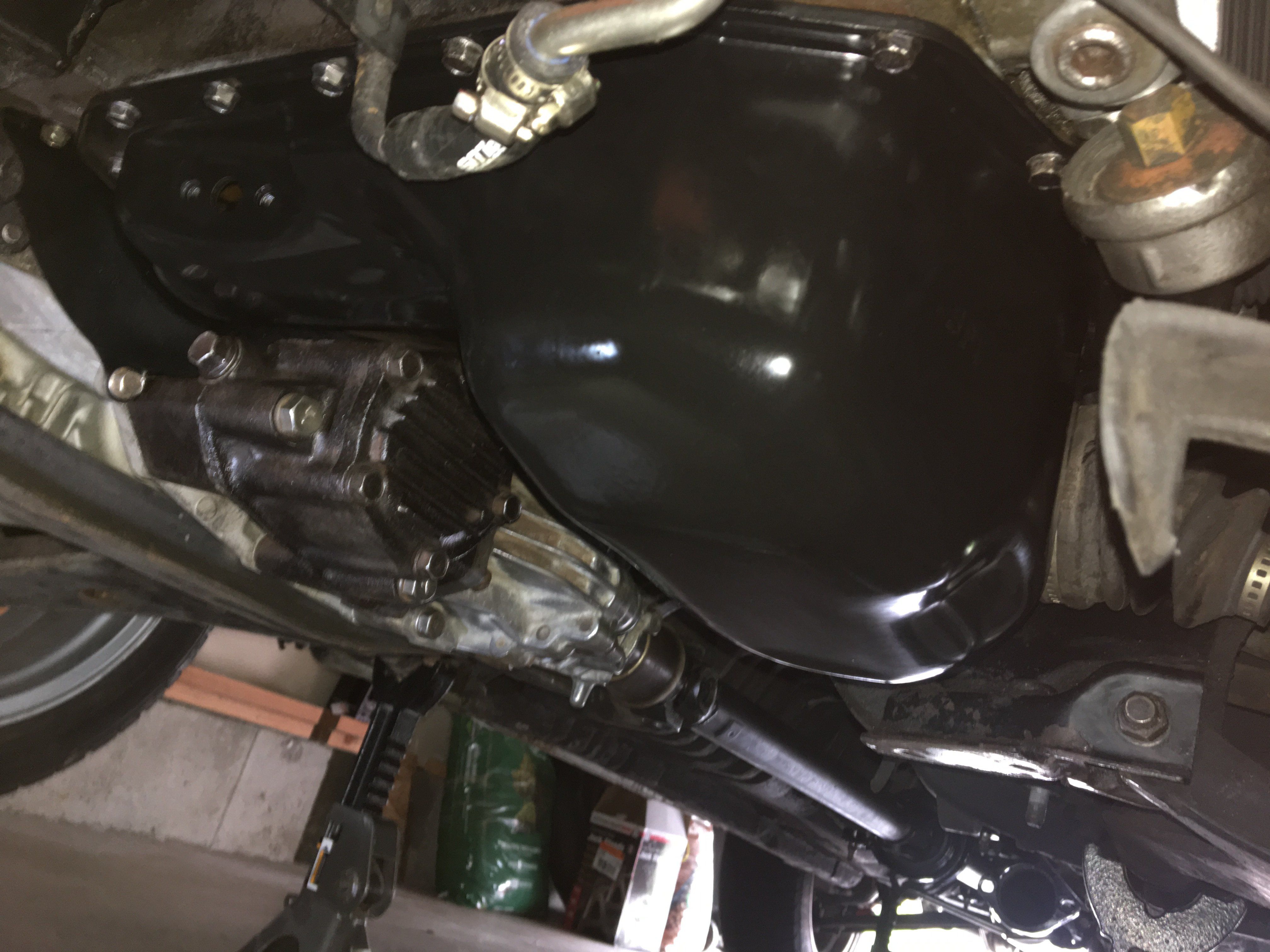

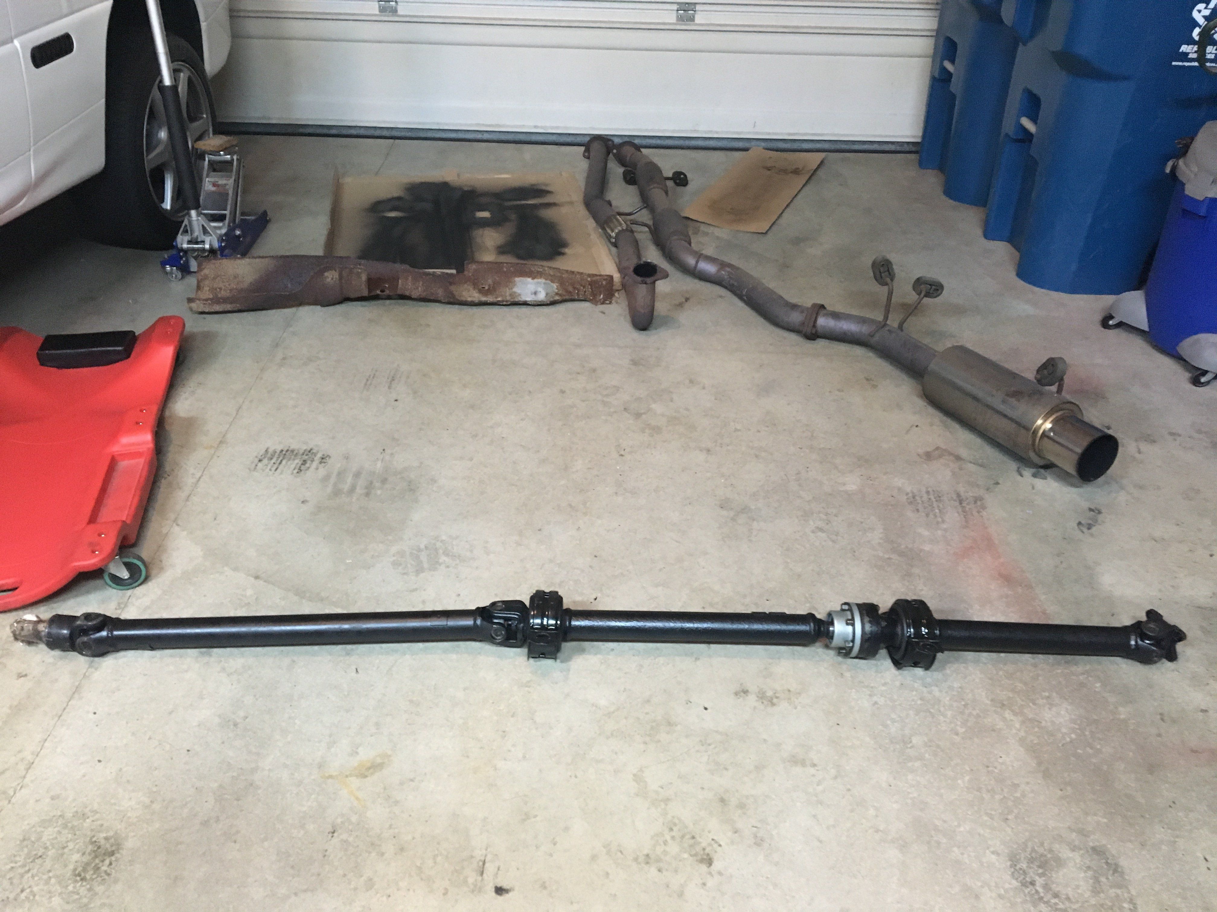

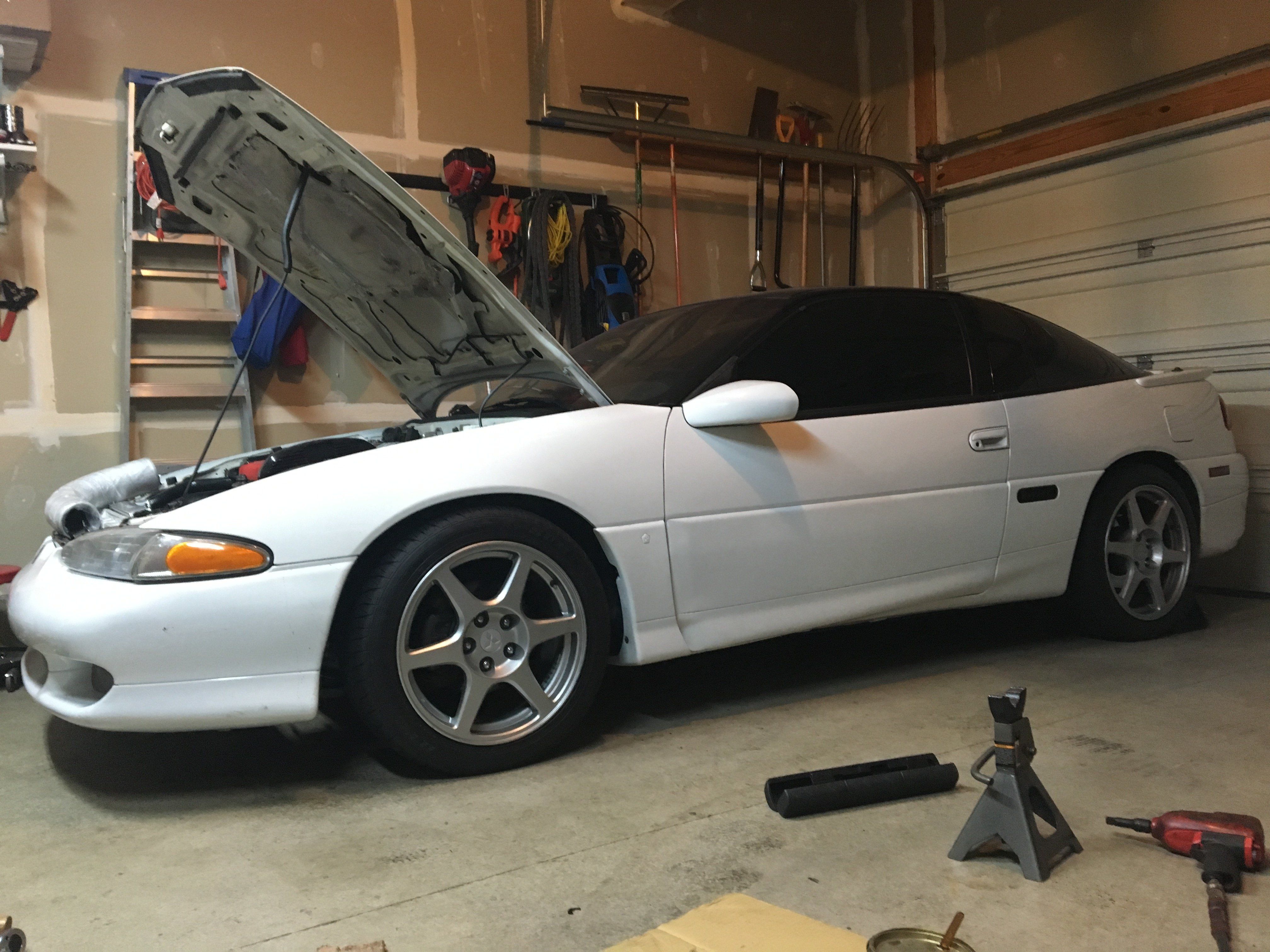

Driveshaft rebuild complete with only a few casualties. Today we honor my vise, cheap snap ring pliers and this heat shield that’s been shedding a pound of rust every time I was working underneath.

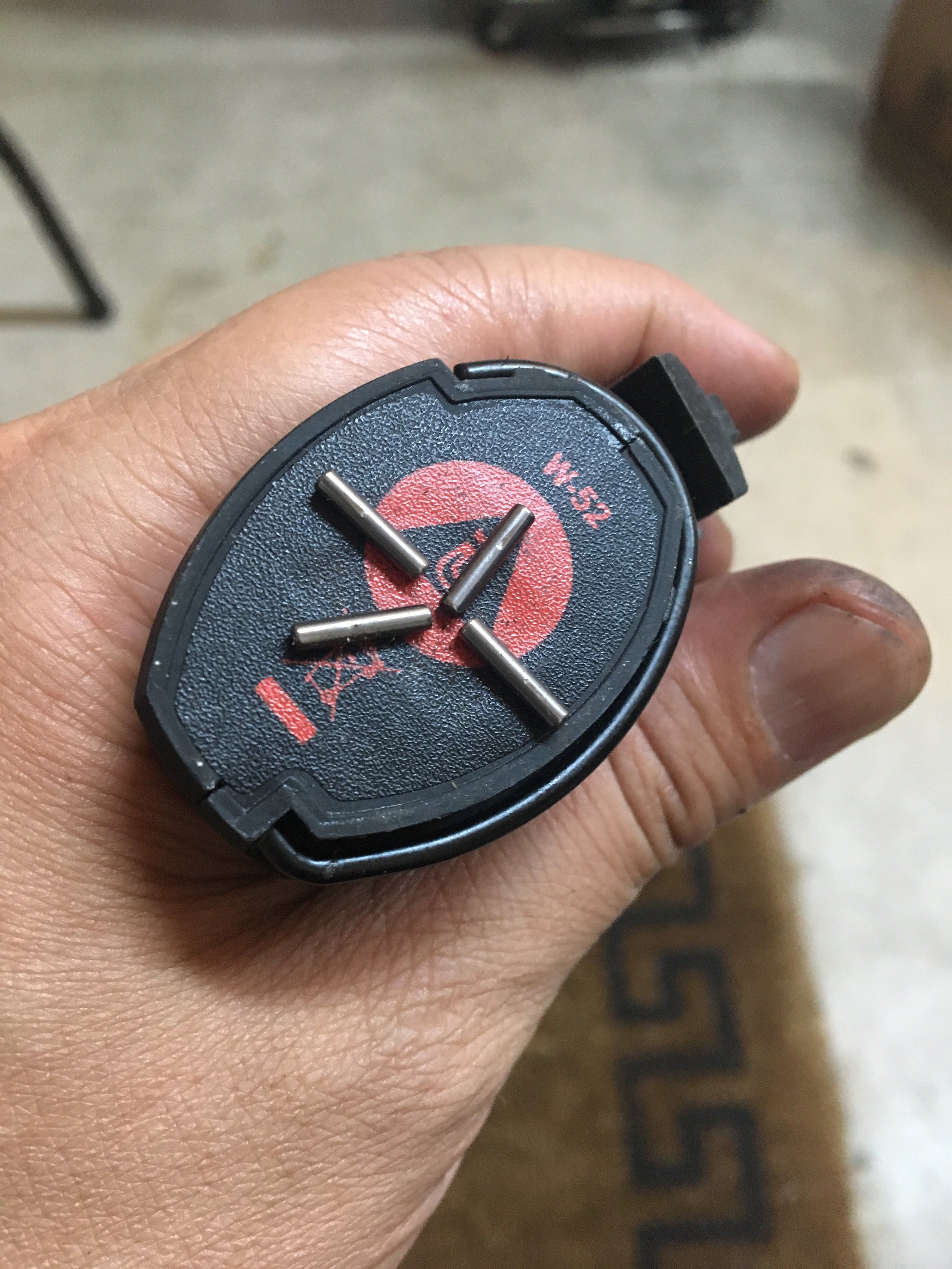

The last fing u joint didn’t feel smooth after I installed it. Found which cap was the culprit and removed all the needle bearings and found 4 that were defective. Wtf Mitsubishi??? Used 4 from the old set.
Just need a 6mm allen socket to torque and forgot to order new carrier bushings.
