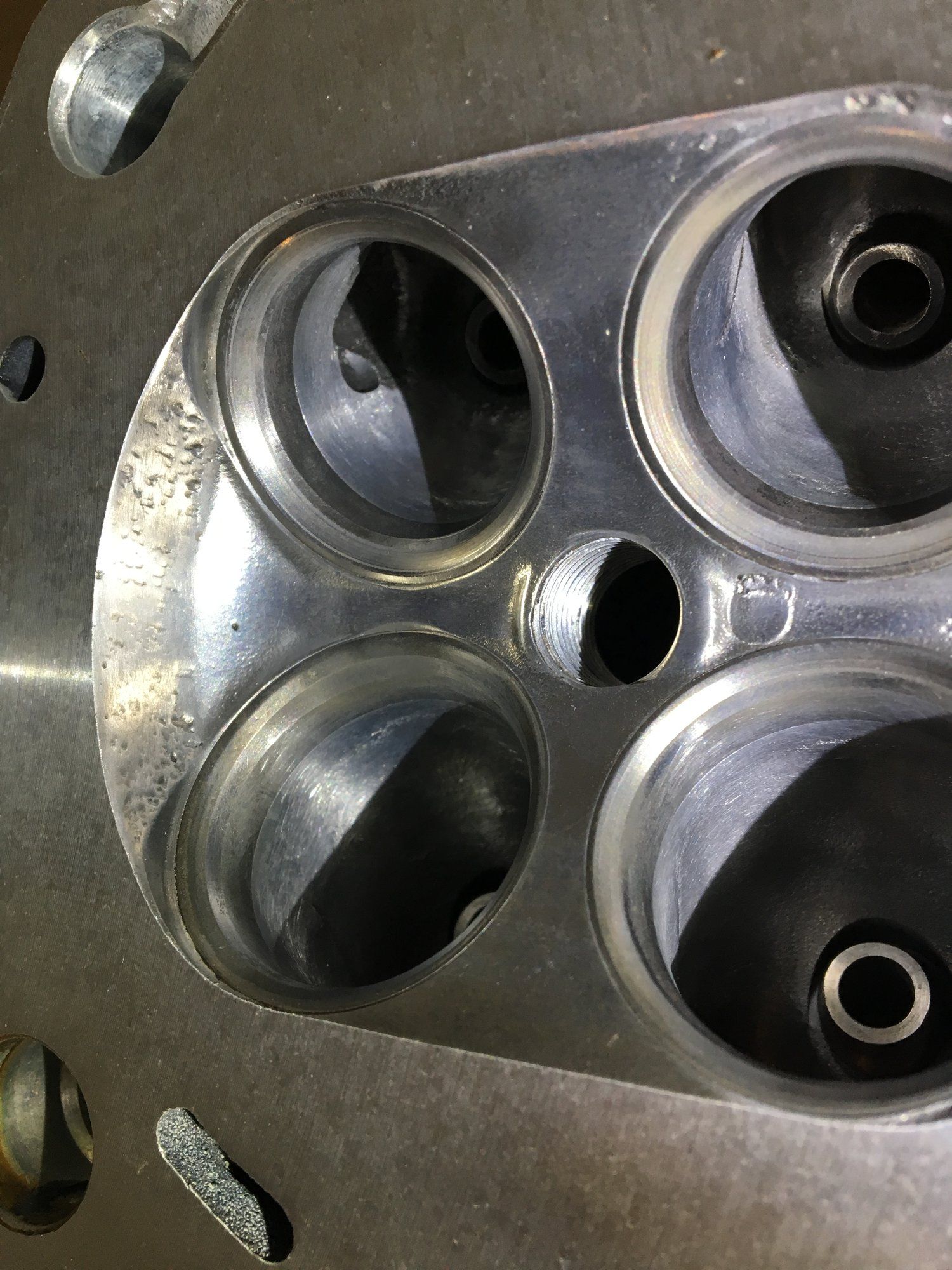

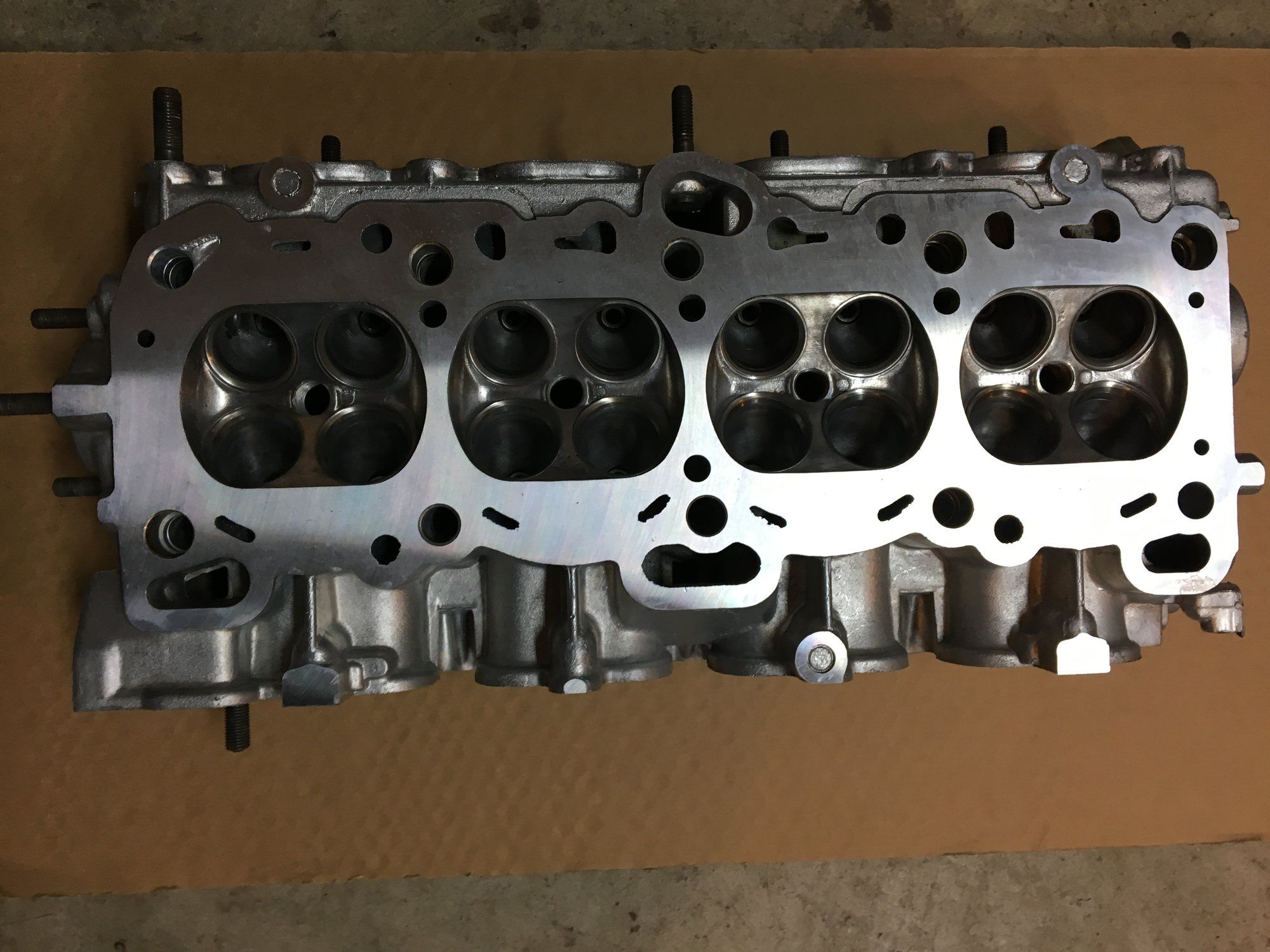

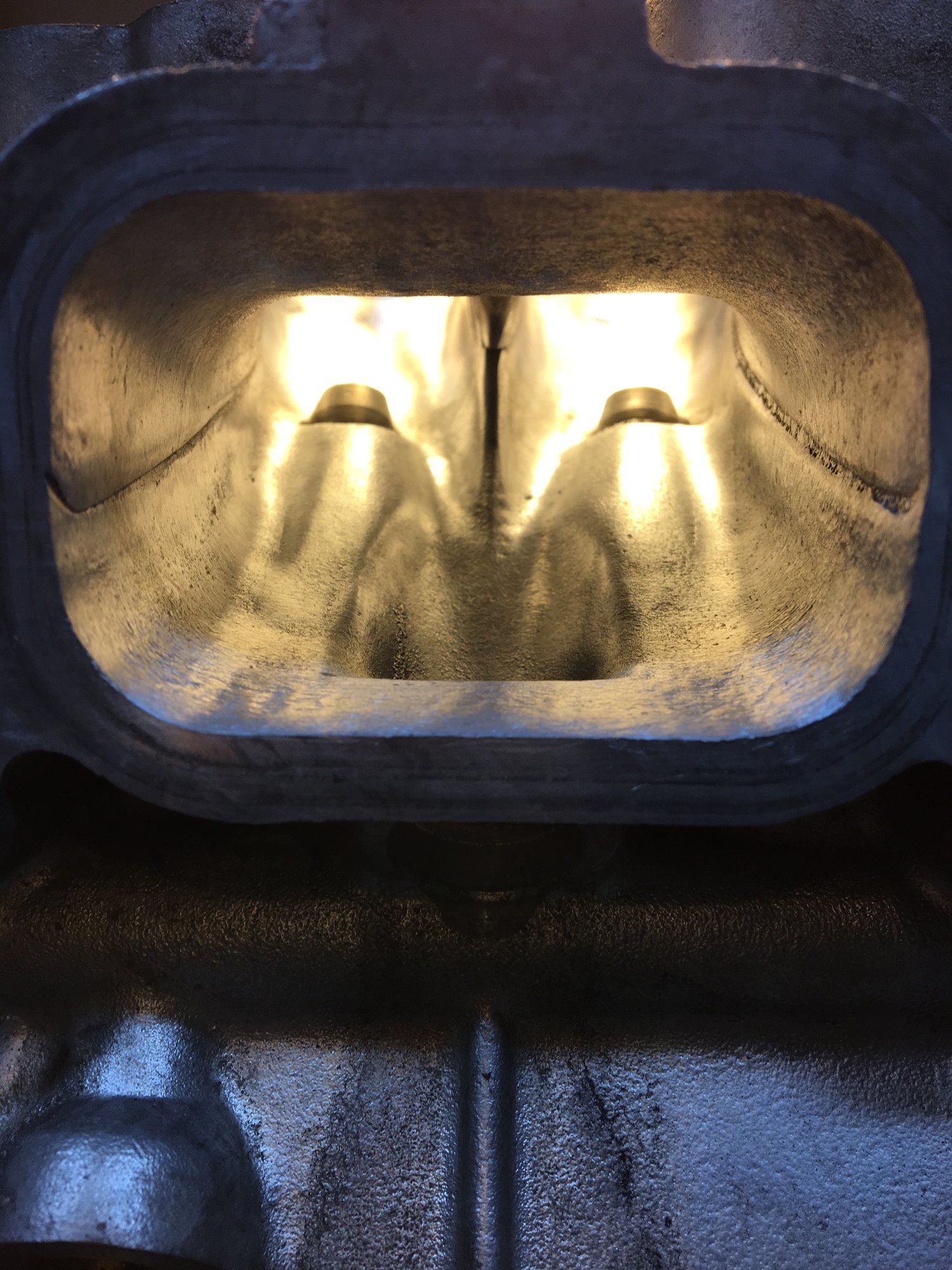

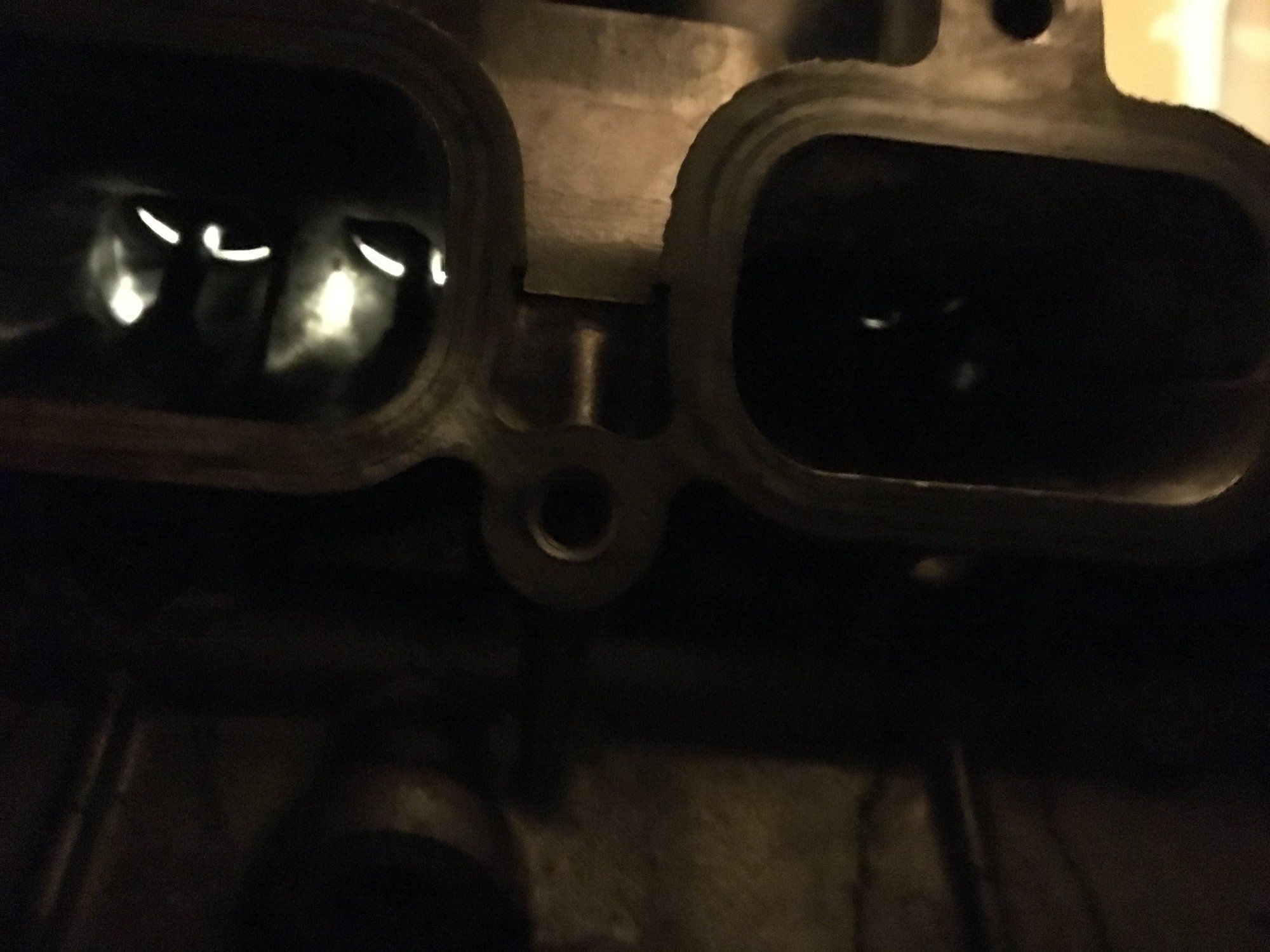

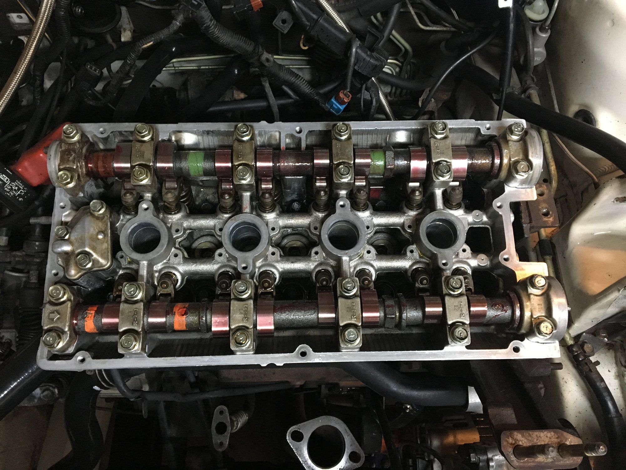

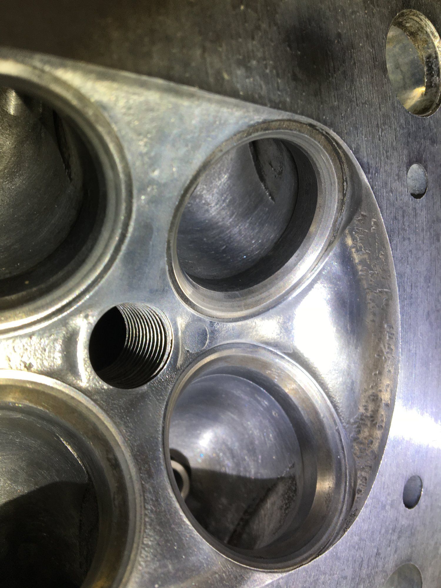

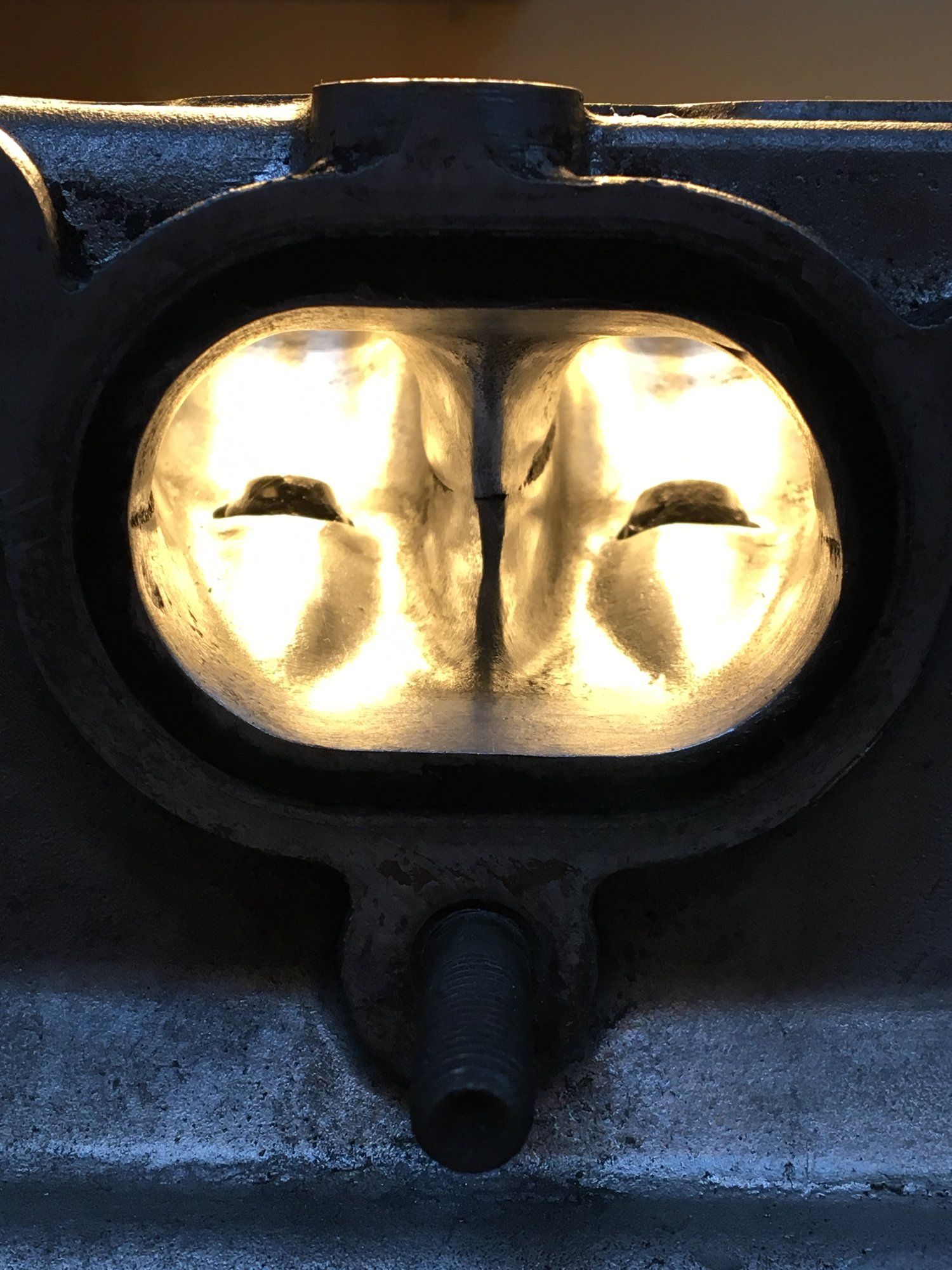

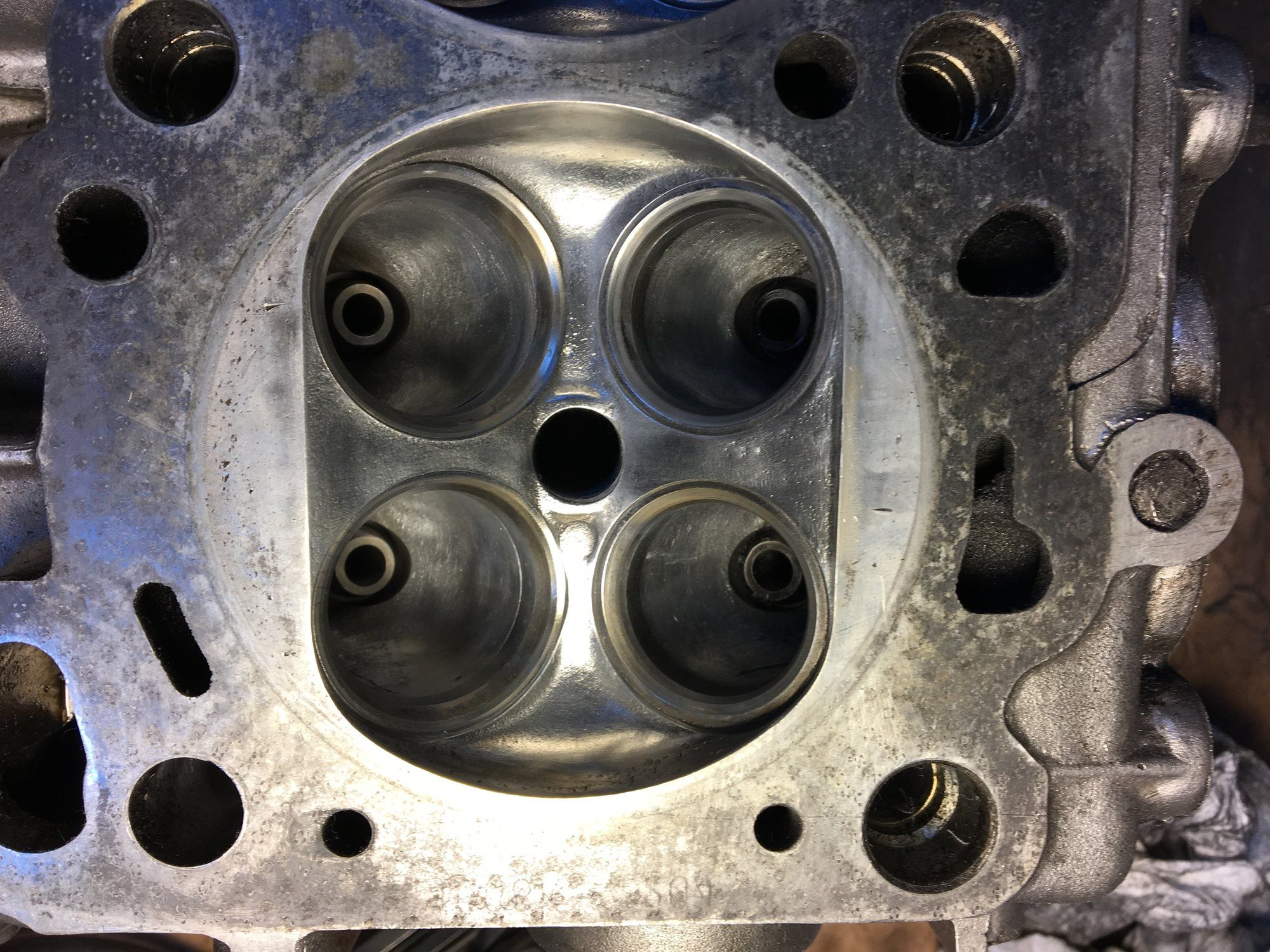

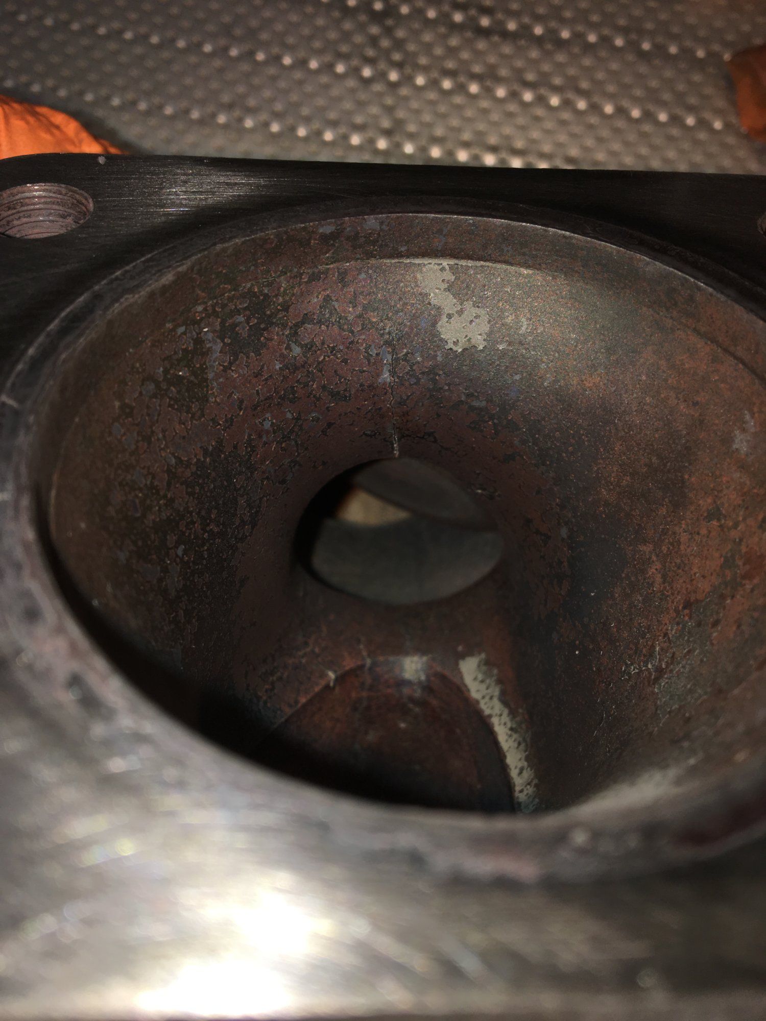

Stage .8 head port and gasket matched intake ports. Give me a break, it’s my first port job. Should flow a little better. Off to the machine shop tomorrow.

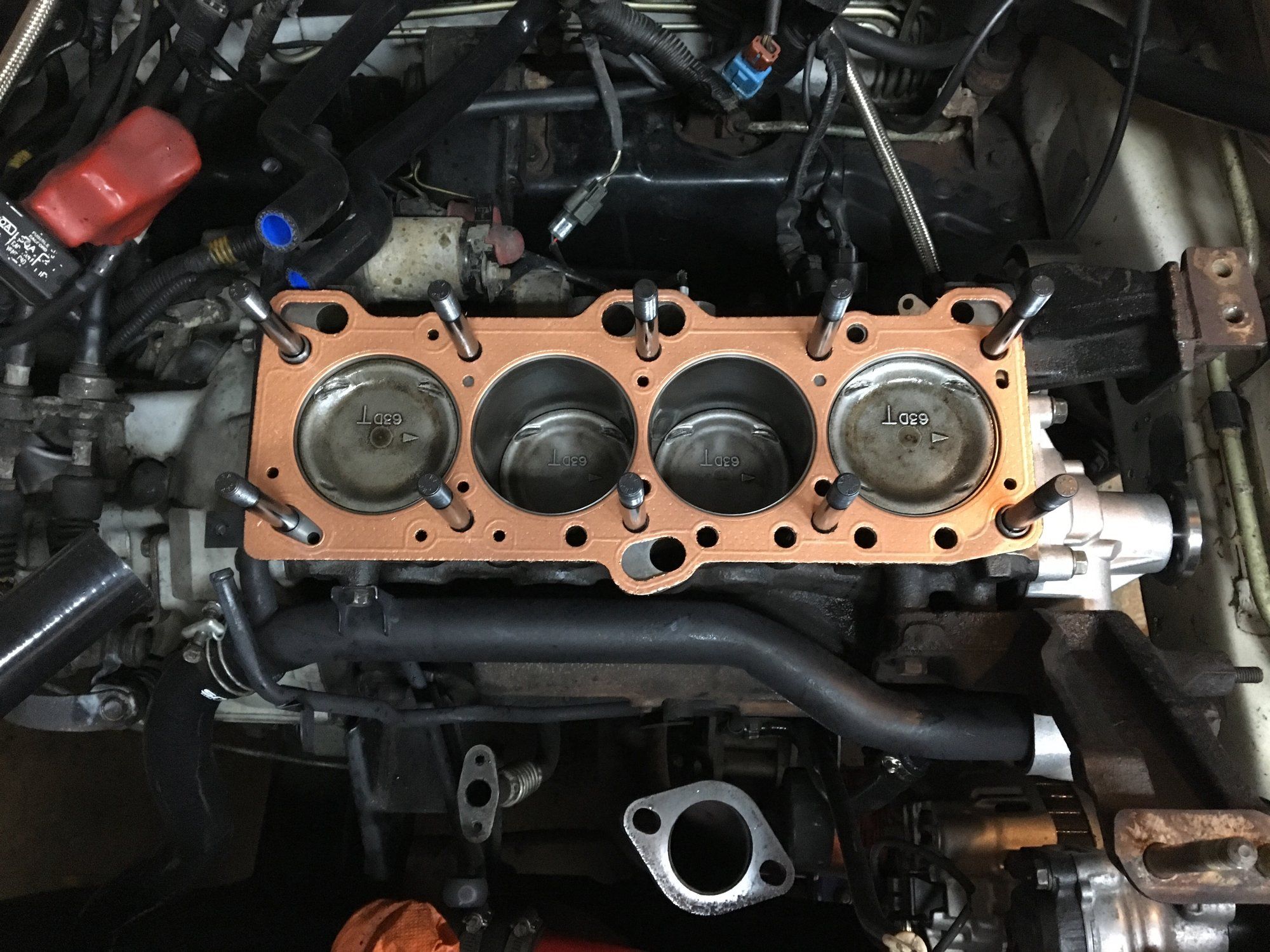

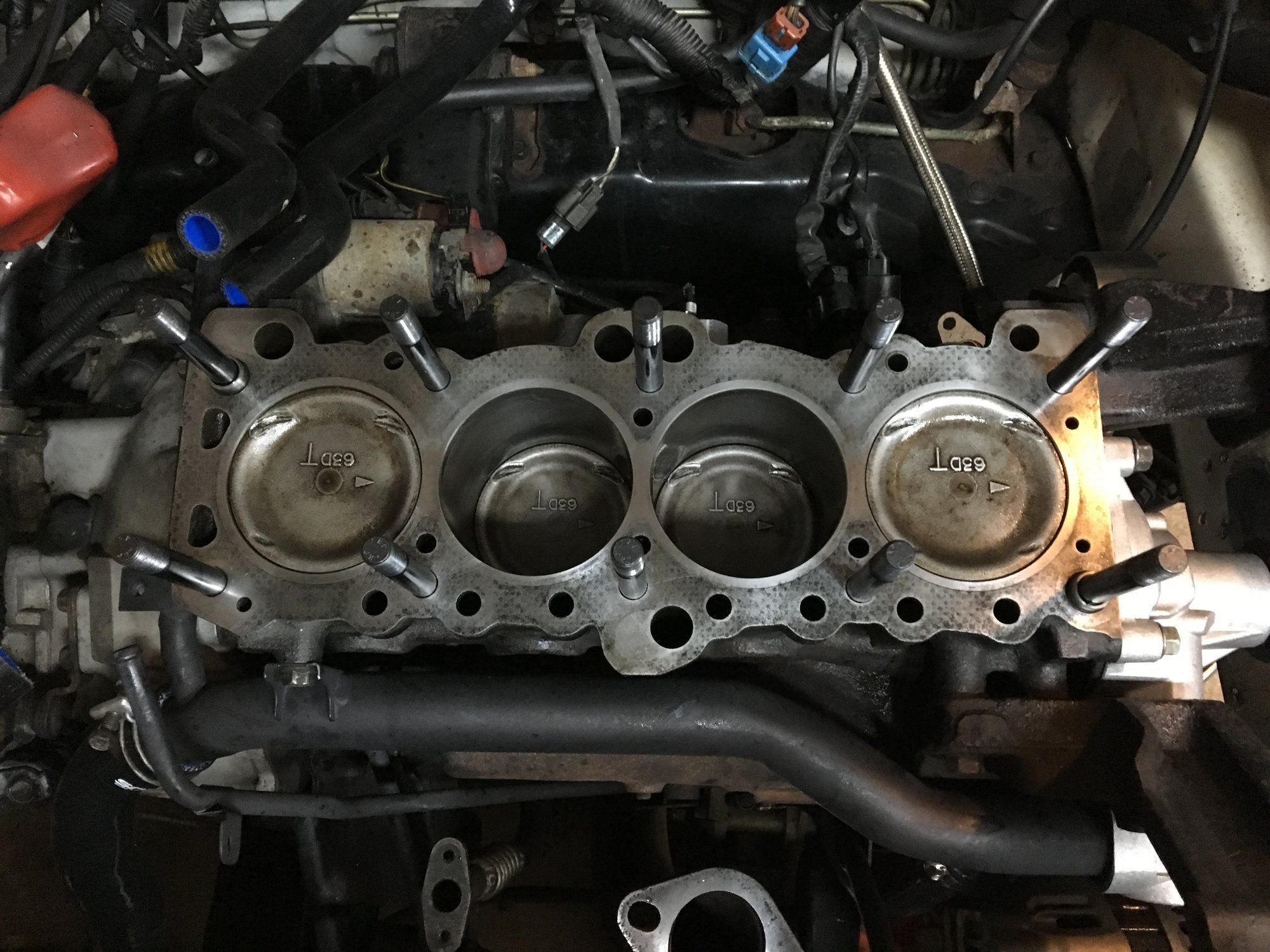

After a head mill, blow out all of the openings with compressed air to be sure there are no curly pcs of aluminum in it from the machining. I found some in mine, anyway.
Nice job on the chamber, was that the pitted one?

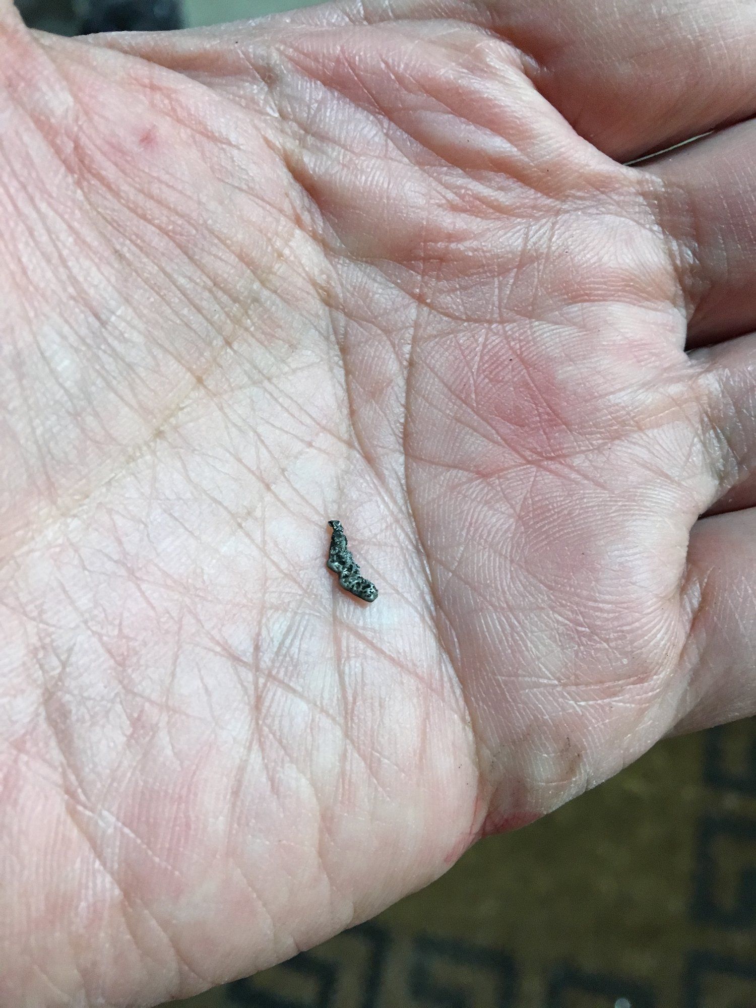

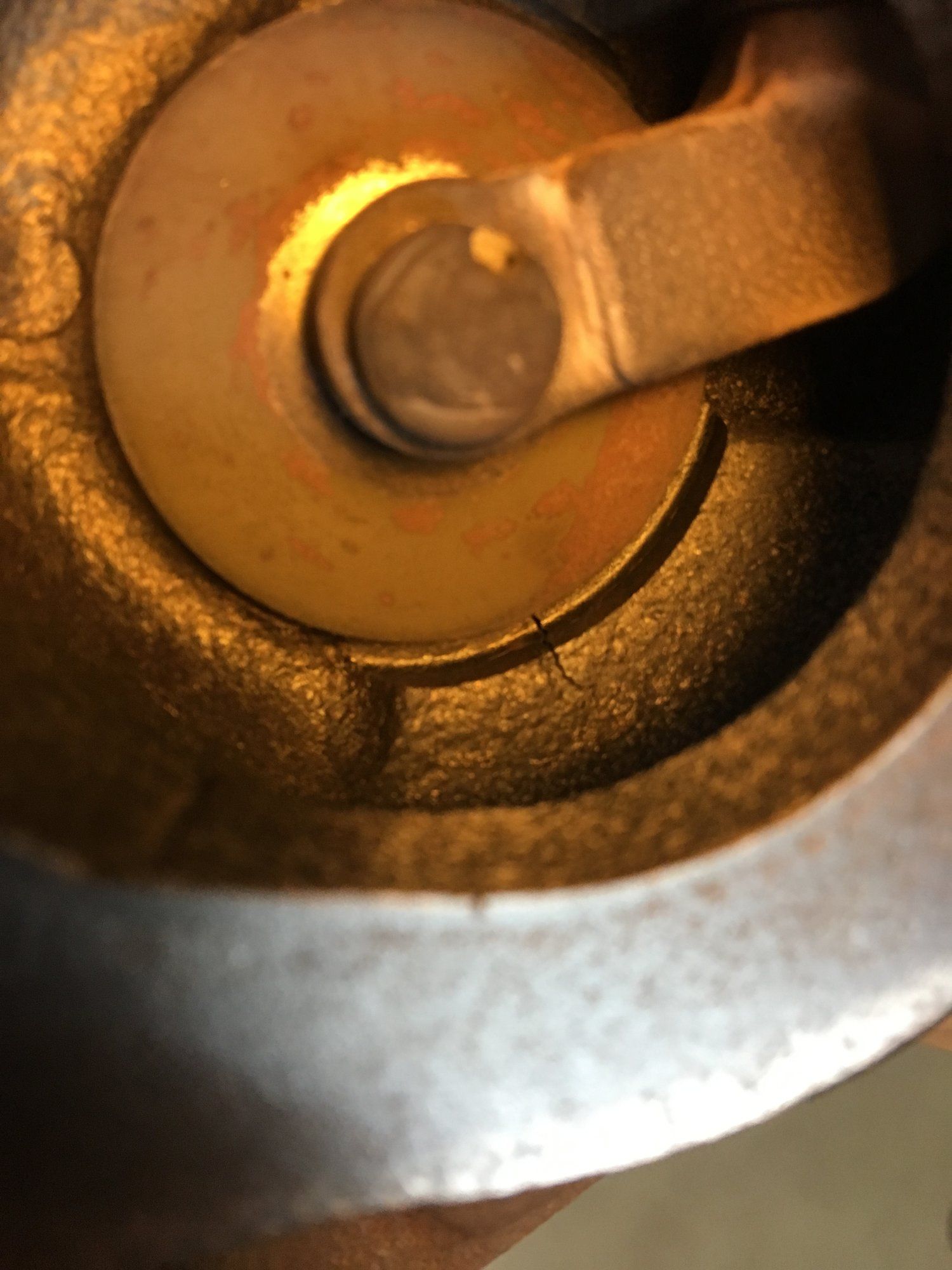

I blow out every crevice and when I turn the over this piece of casting fell out.
Just finished installing valve seals. I’m going in with a Qtip in each valve guide and airing out the whole head again. Not taking a chance.
That chamber was the cleanest. 1&4 were bad.
Cleaned up pretty darn good considering.
Don't leave any strands of Qtip anywhere. They come off and stick to stuff like you wouldn't imagine. Be clean and thorough and you'll be good. Can't be TOO clean for me.

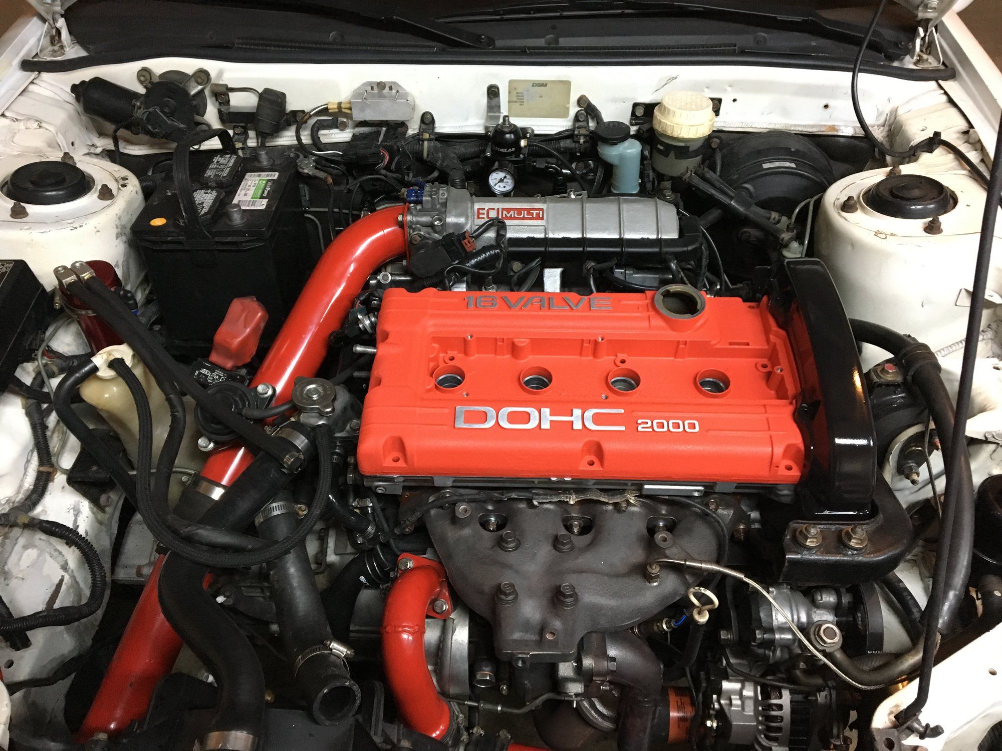

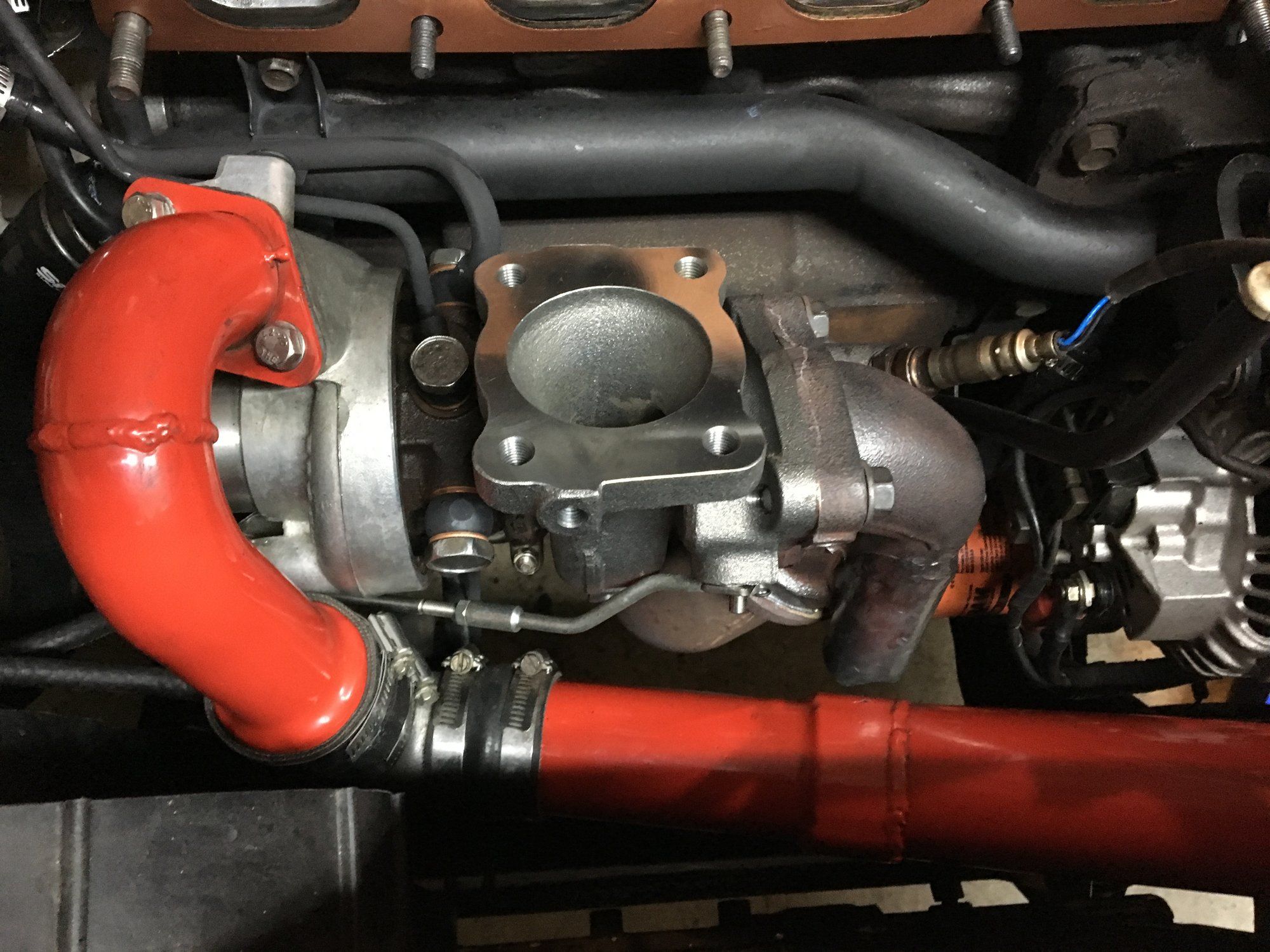

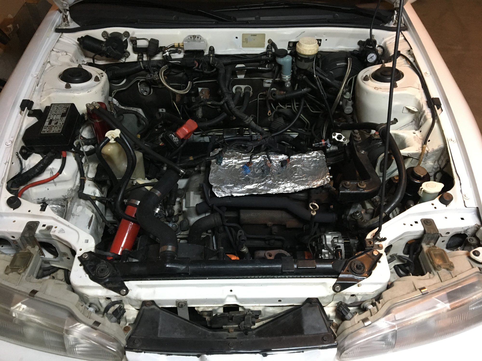

Installed 3 port EBC via link. It sounds so different getting into boost. Still need to fine tune afr and dial in WG duty. She rips 22psi flowing 40lb/min. I need a go pro
