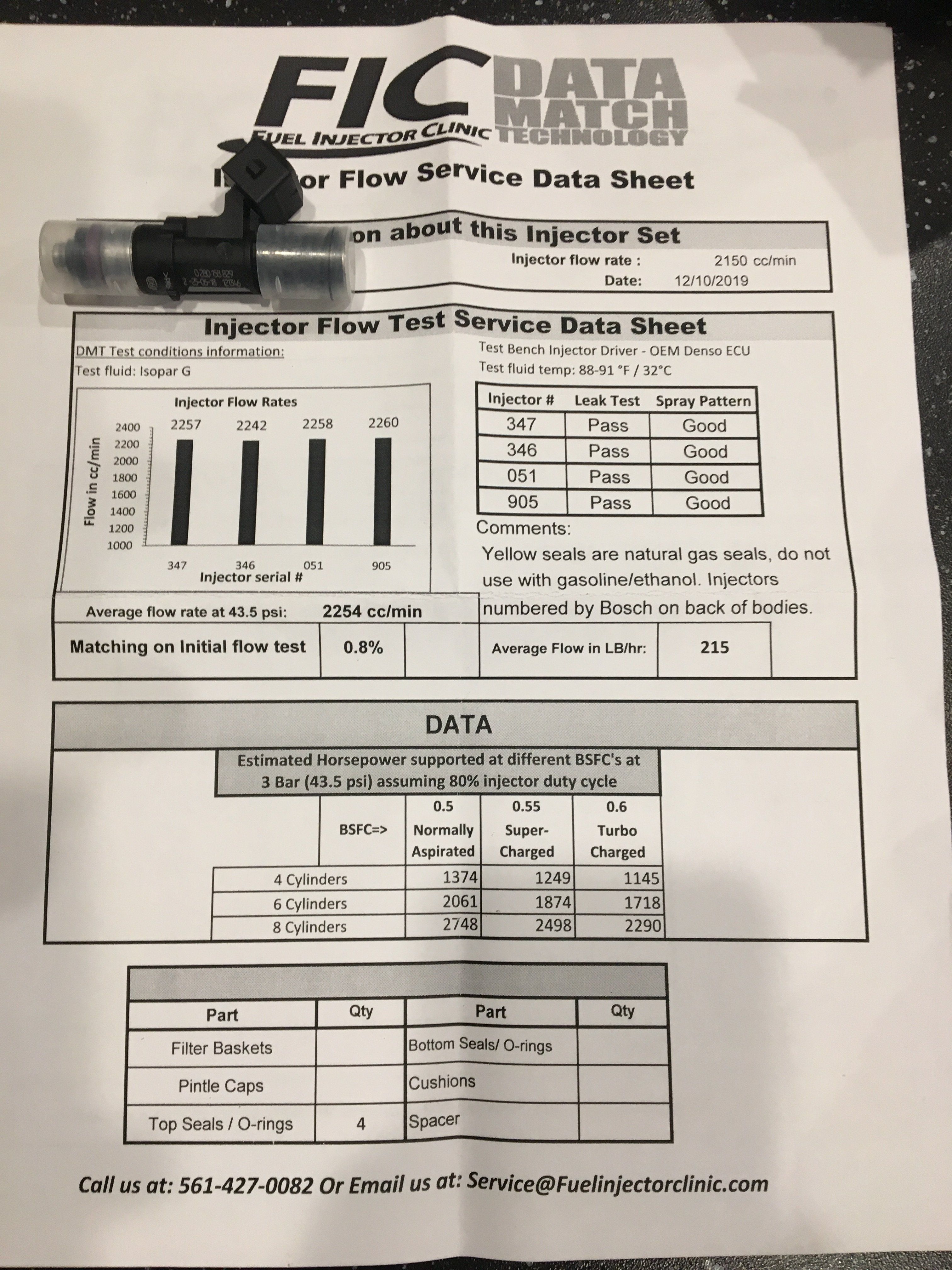

I put all of the Red car goodies into the Blue auto car. Red car gets bigger cams, JMF intake, 63mm TB, and Bosch 2150's as soon as I can get the head surfaced.
Go big or go home!!! I’m looking at Bosch injectors as well. Read good things about them and they’re priced well. Sucks that I bought 1000cc thinking i was going to keep the b16g on corn juice. Then splurged on the 68hta so now I need bigger. Ugh!! :banghead:

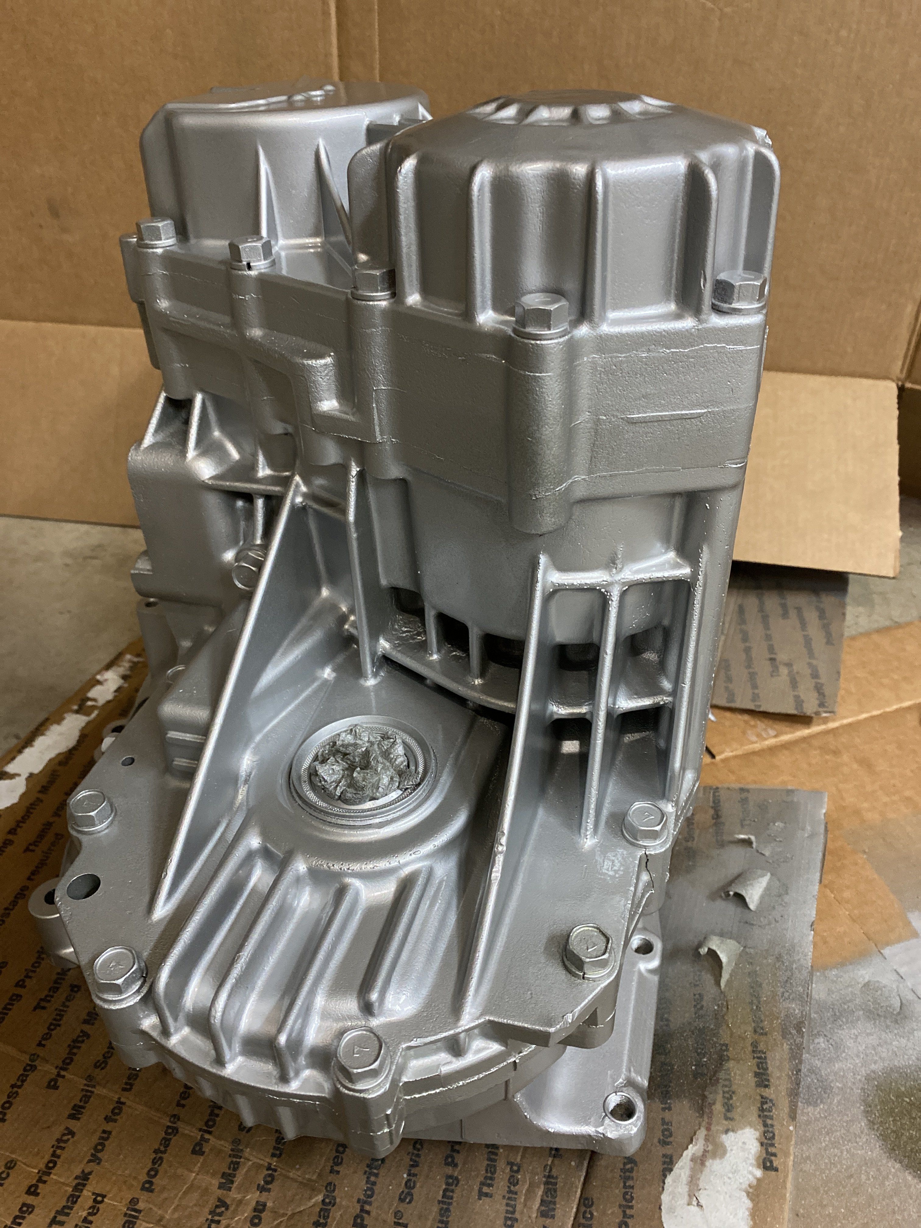

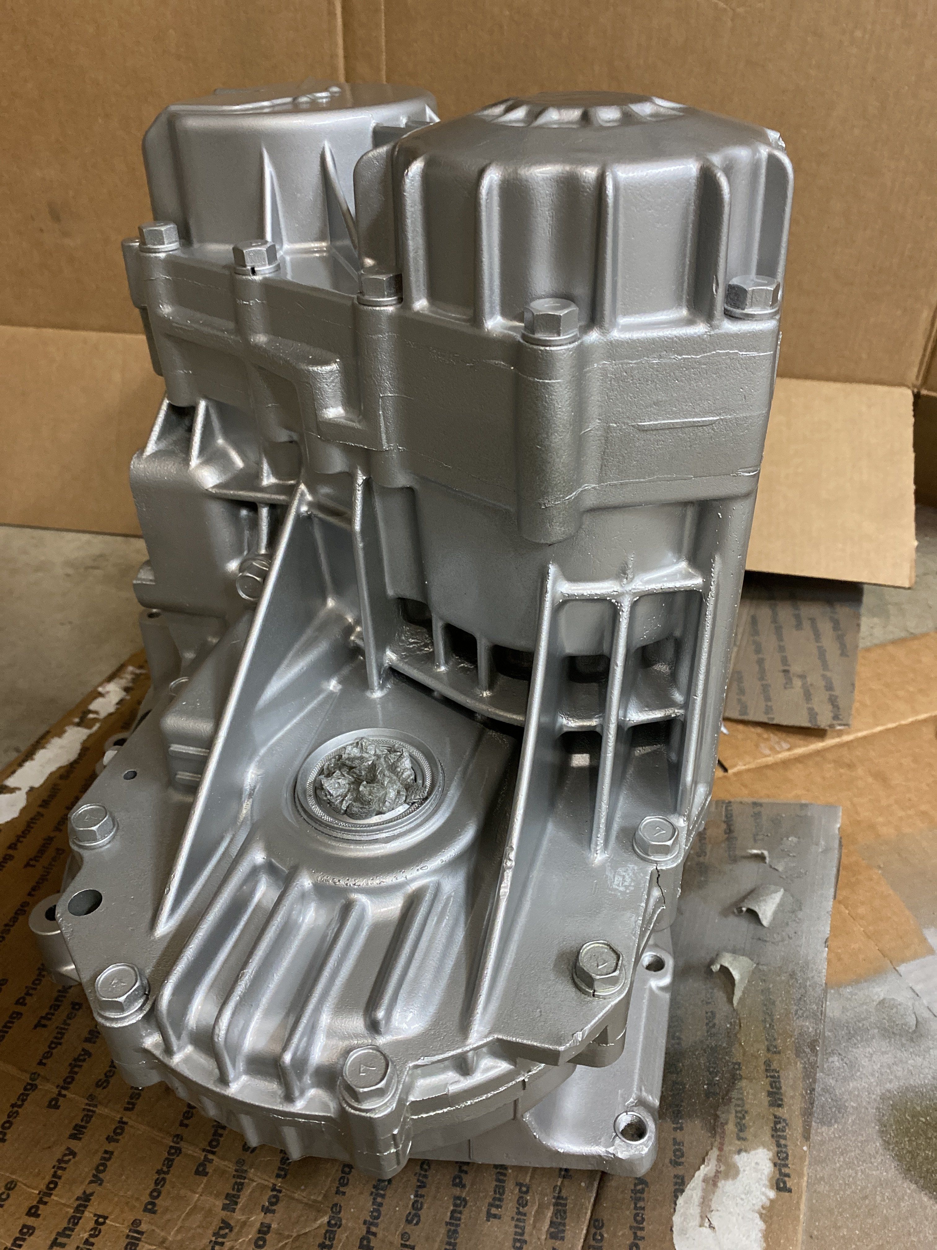

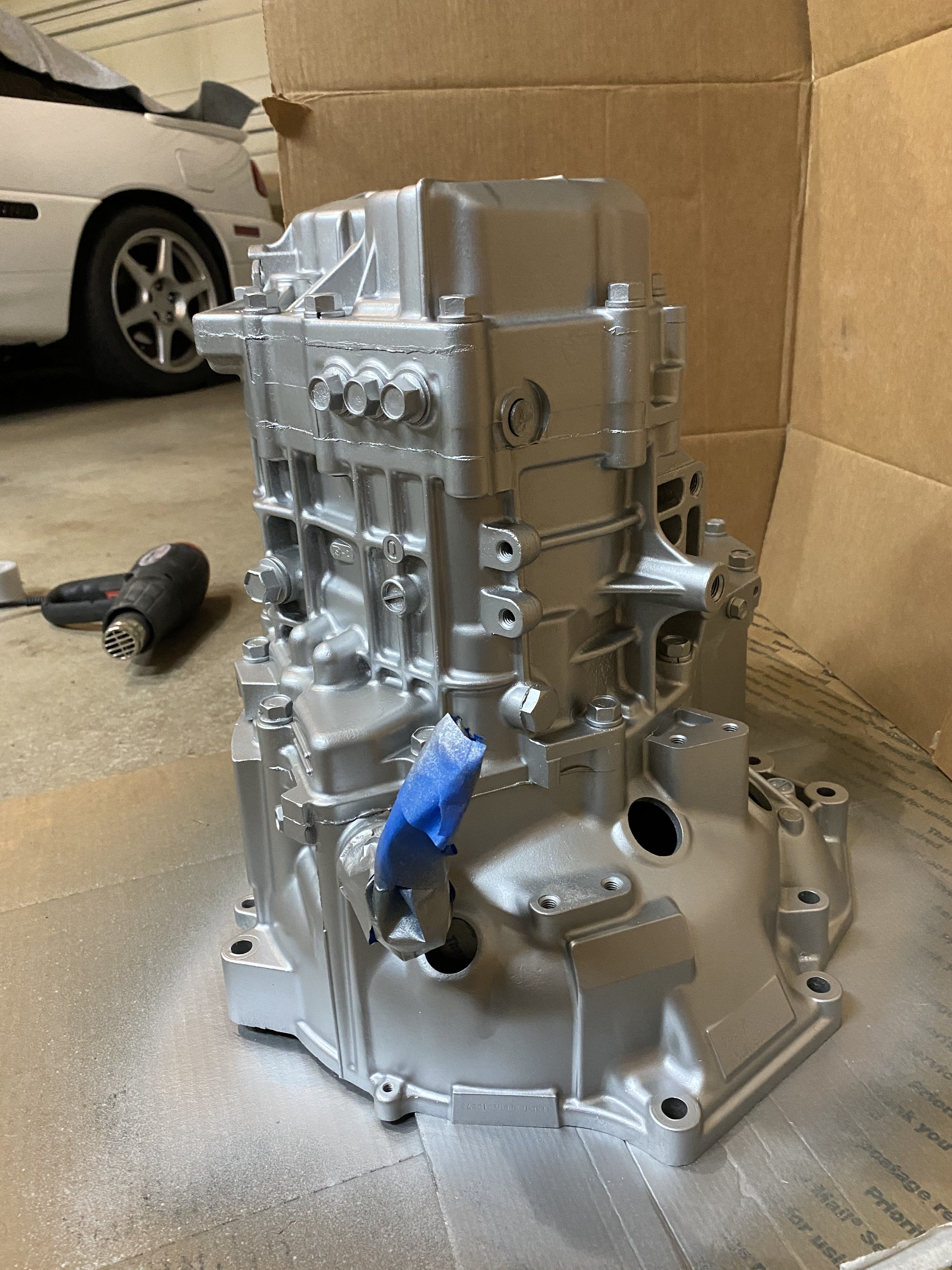

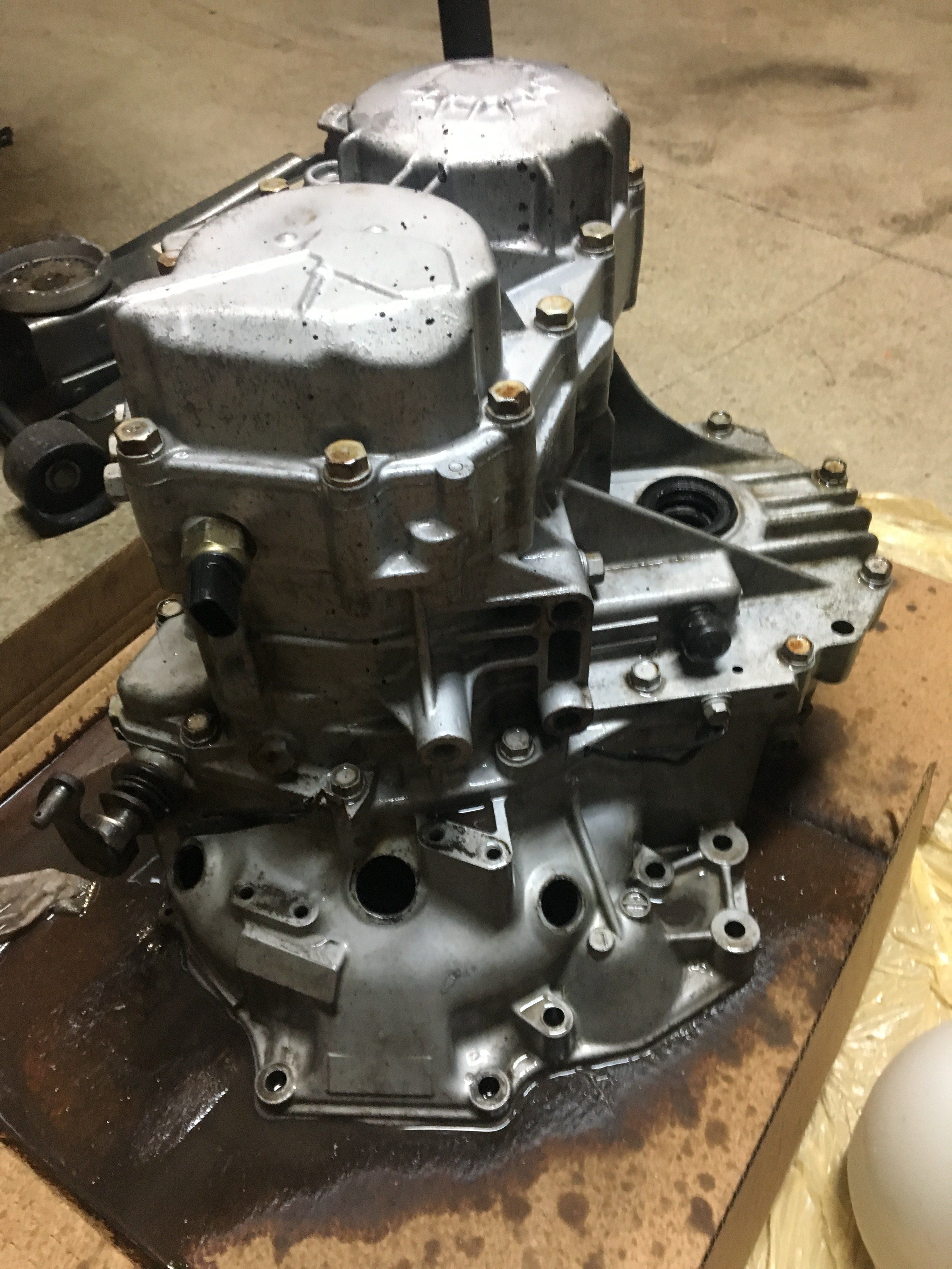

It’s not too bad but this is what I see from the engine bay. Why not paint and clear?
It was painted already by shep when it was built. I have the receipt and think it was in 2010

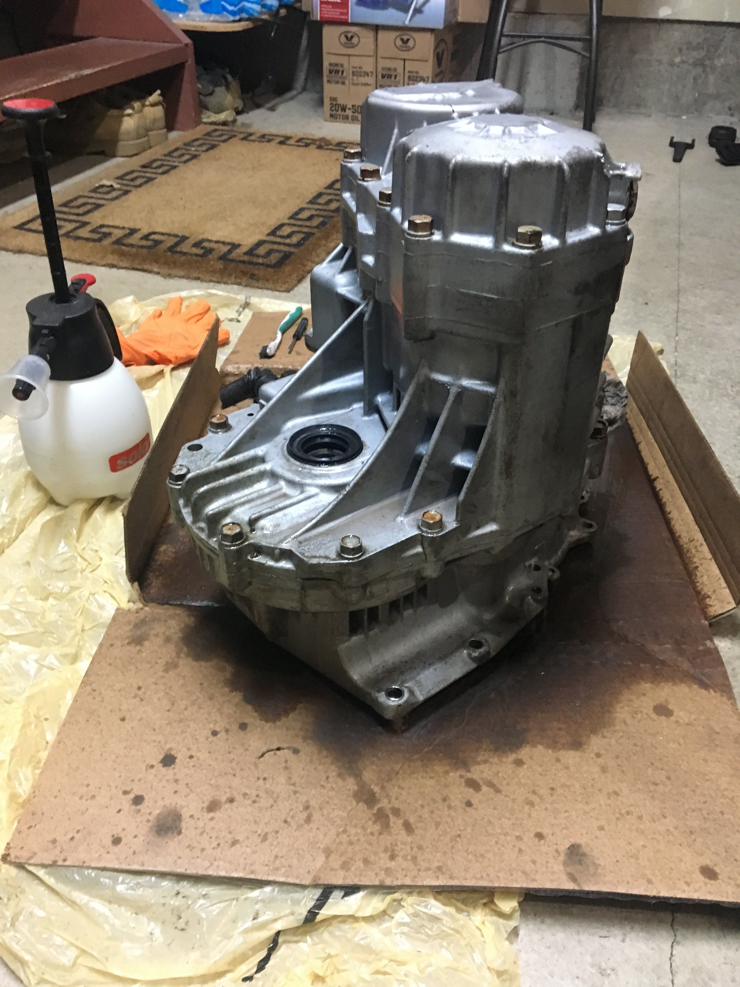

Yeah looking at the closer pic,I can see that it has already been hit with paint. You dont really have a choice without a full tear down at this point so proceed......... The reason I said this is because the amount of prep work that would go into a proper paint job on a trans, that will hold up and look good and NOT peel inside a year is insane. Almost unmanageable. I also hate to see all the bolts hammered, and the RTV from between the case sections as well.........ya know........
Ive been obsessed with anything trans related for the last 12 months. Ive beeen hoarding and building good units. I will post up some pics so you can see the difference.

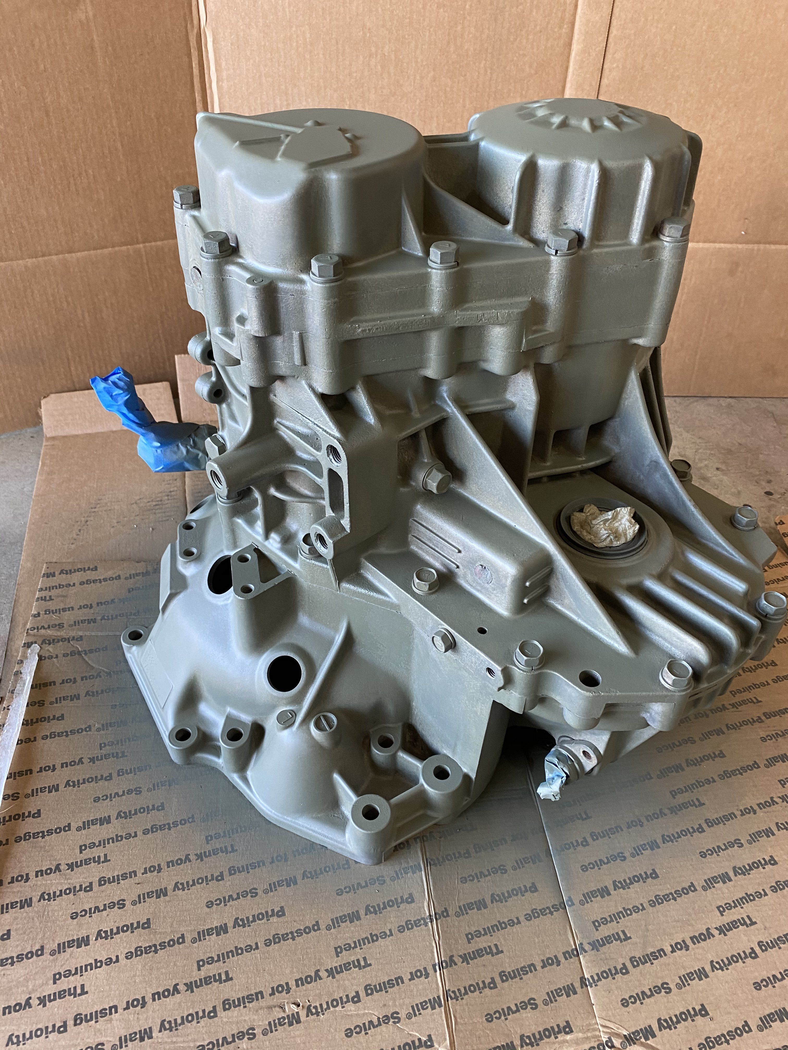

Yeah I know the best and proper way is to tear it down and really get it clean especially in the crevasse and under the bolts. I just put a coat of clear so hopefully it last a little longer. Just went over it with a wire wheel where I can and used sandpaper by hand in areas that needed cleaning.
It’s not a show car but I’m willing to put some elbow grease so I’m happy when I open the hood and/or work on it.
Ohh for sure, I think we all want to like what we see when we open the hood...............even if it was a show car your good. It will look fine for a while.

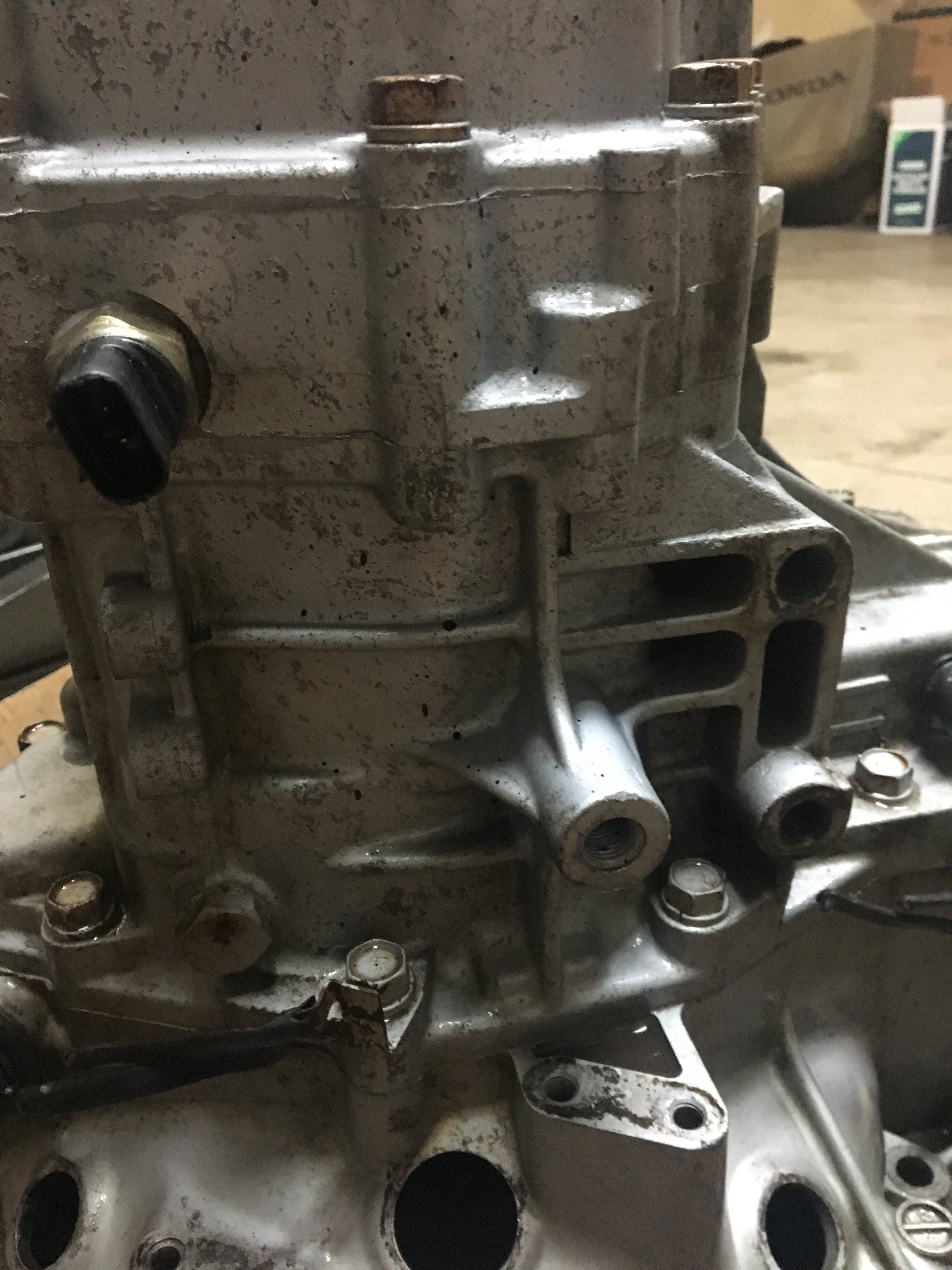

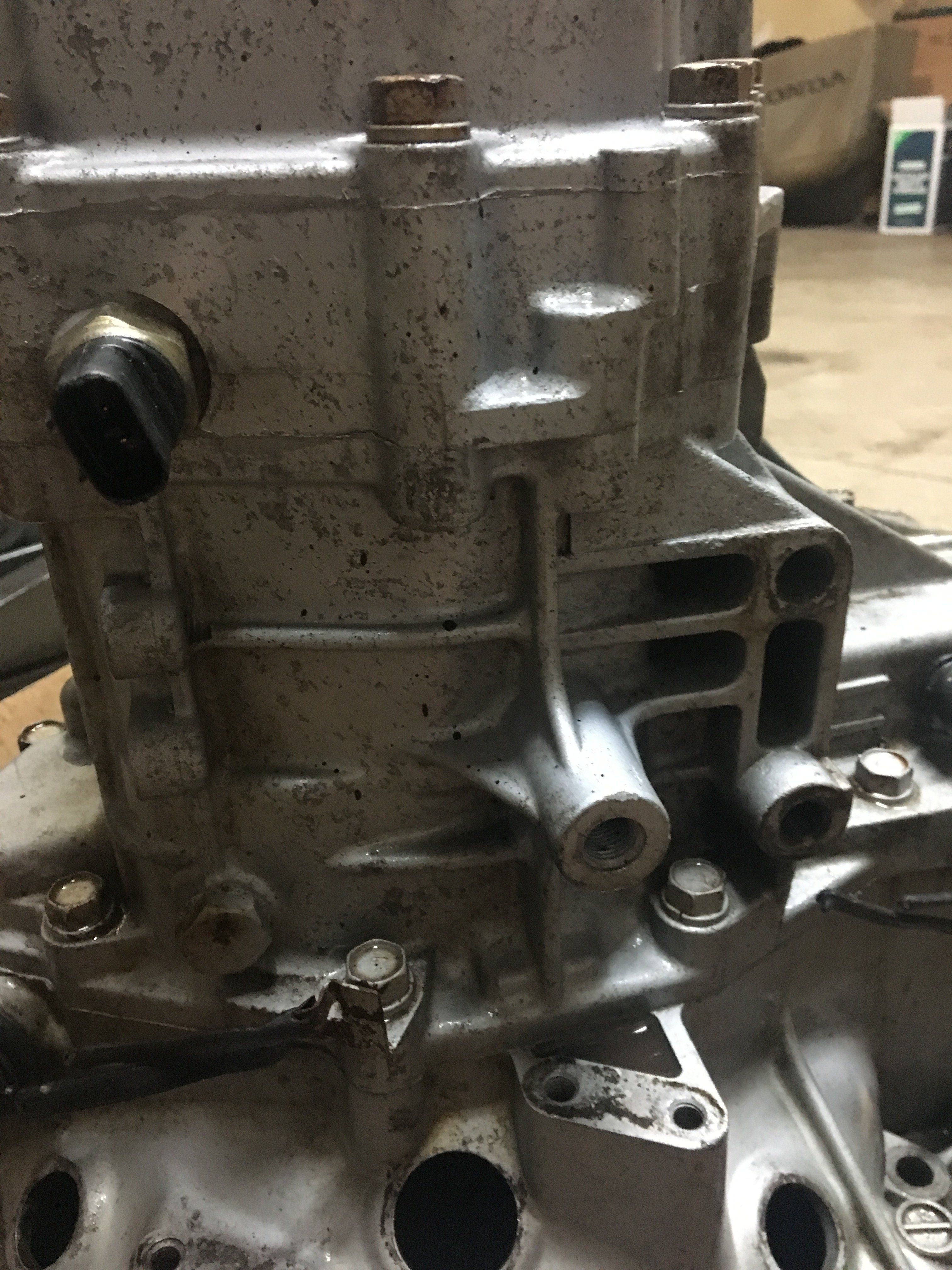

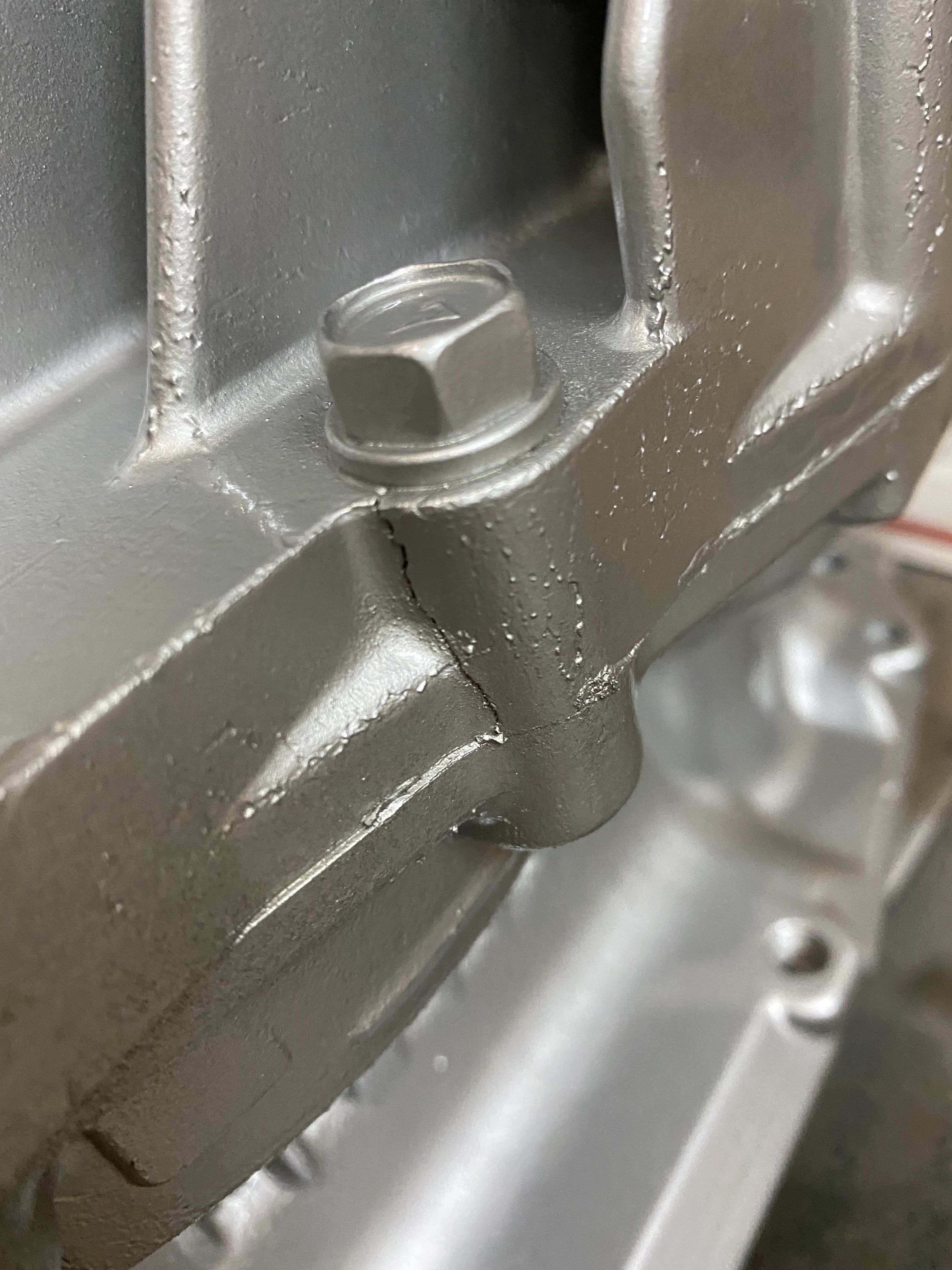

Is that a crack in the gear cluster housing? ( next to the bolt to the right in front diff area)
It is but it never leaked. I noticed that when I was prepping it. Dang shep trans needs to invest in a torque wrench
