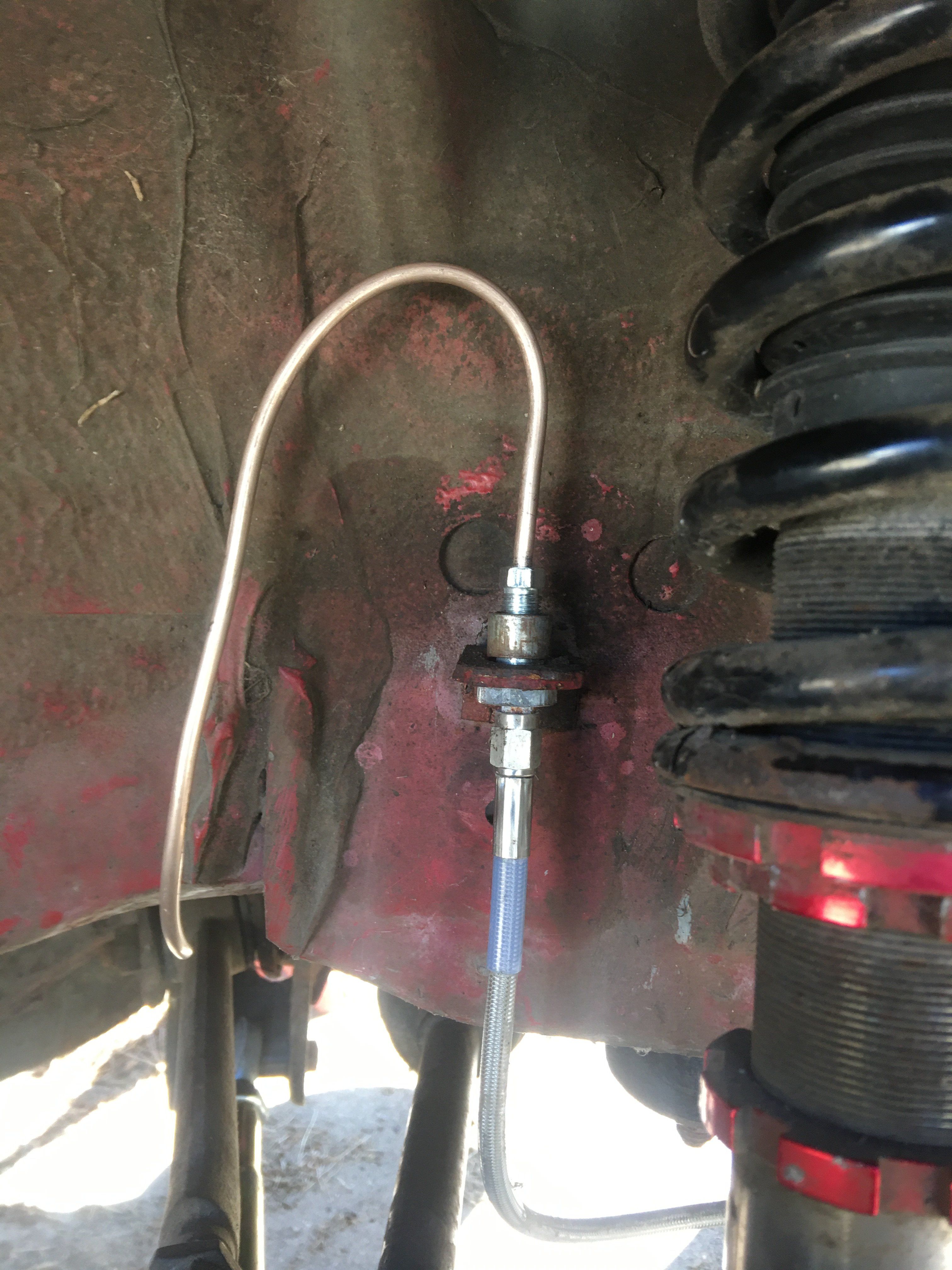

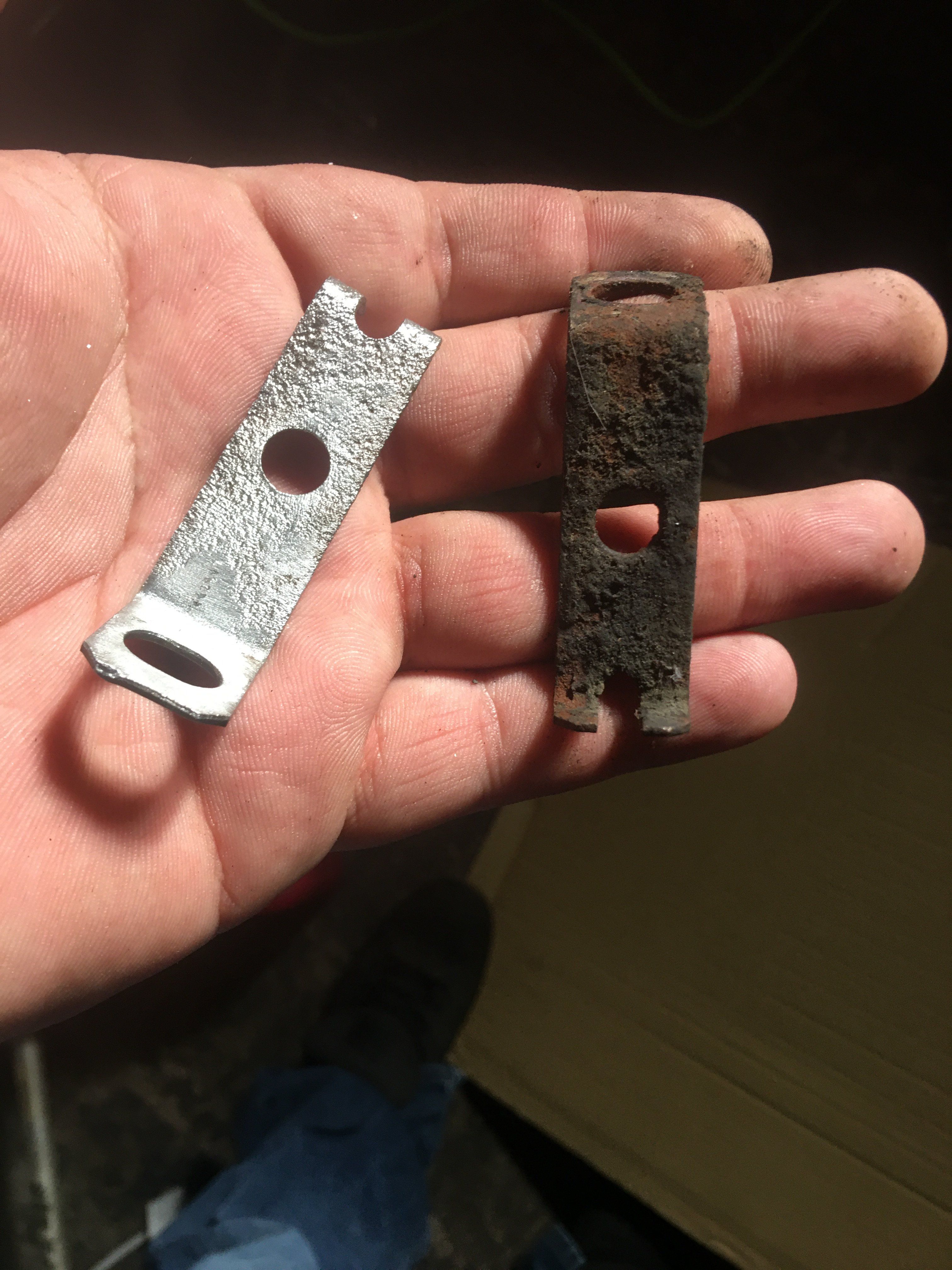

Finally got some time to work on brake lines. Started out by modding the old stock hold downs since there’s only two lines going to the back that will fit in them now LOL

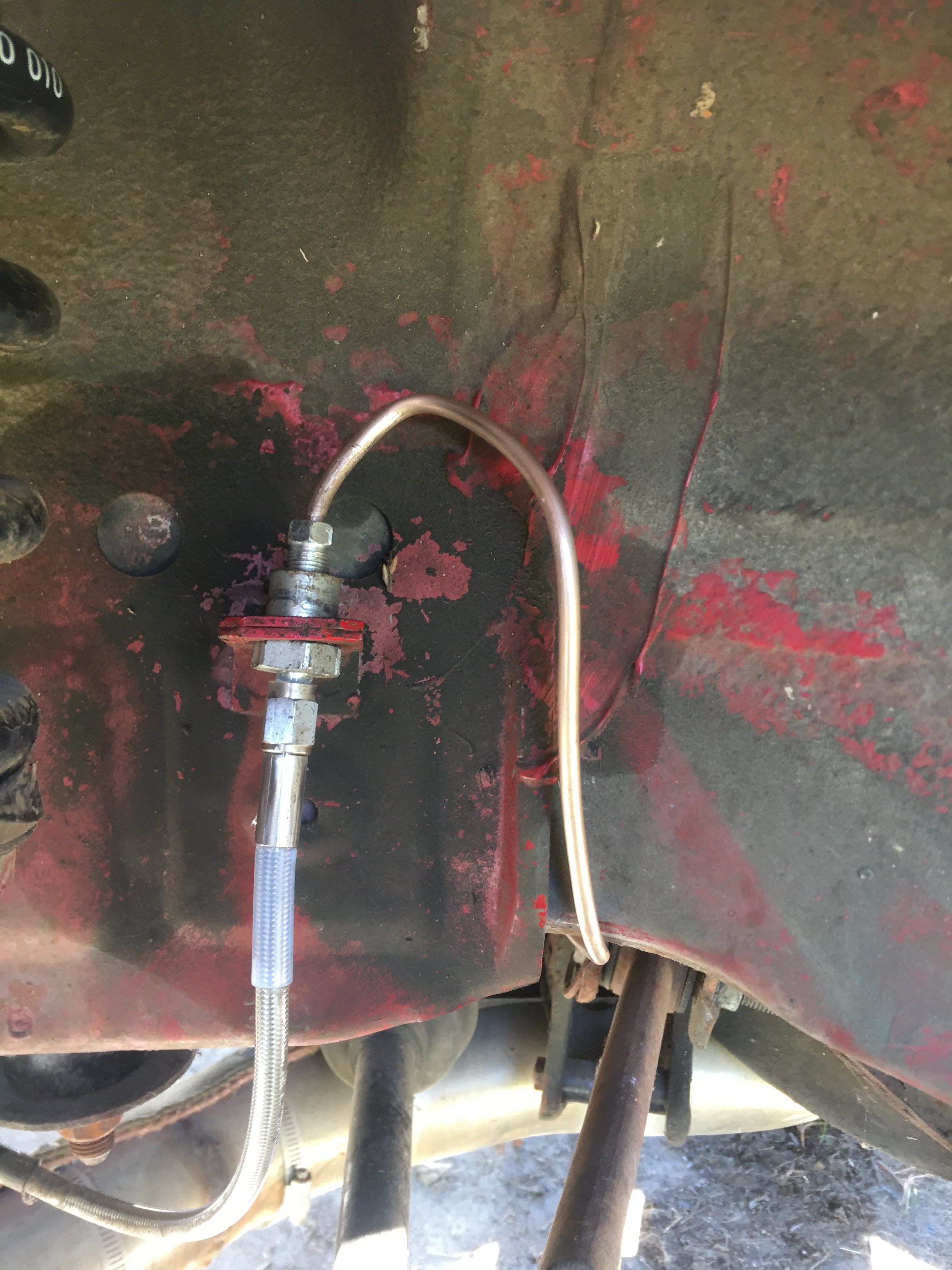

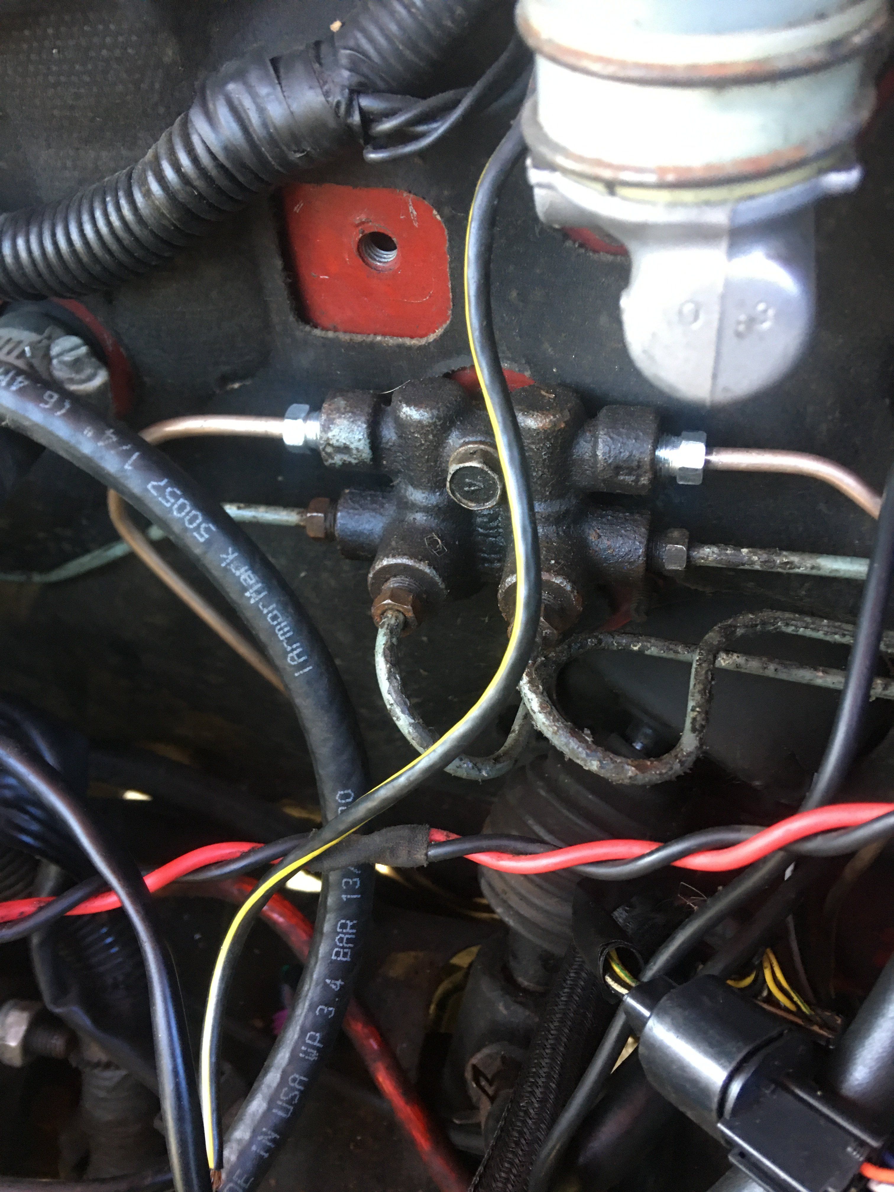

Once I got the brackets cleaned up and modded it was time to start running lines
The passenger side line I’m not 100% happy with so I’ll probably be re running it down the road but for the time being it will do just fine.

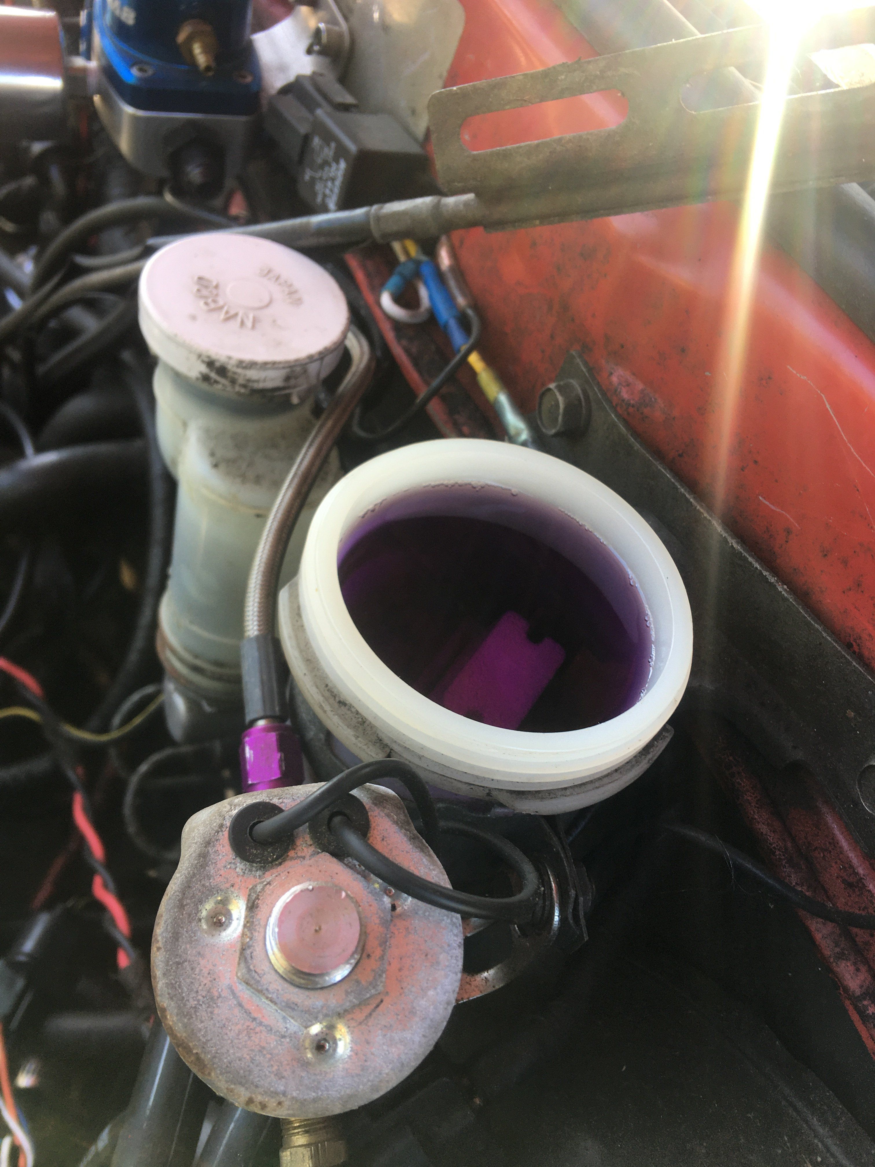

Filled the reservoir with some dot5 and began gravity bleeding everything. Thankfully all the flares I made didn’t leak LOL. I was home alone so that’s about as far as I got for the moment. Gonna bleed the whole system for good Measure and it will be done. Then it’s on to put the bat back together and then a couple interior things.
Dot 5? There's some compatability issues there, Dot 3,4 and 5.1 you can do, but not 5.
its been on dot5 for two years now and has had no issues stopping the car? i guess i should note that ive already flushed the whole system previously when we put the car together and ive been running the dot5 stuff.

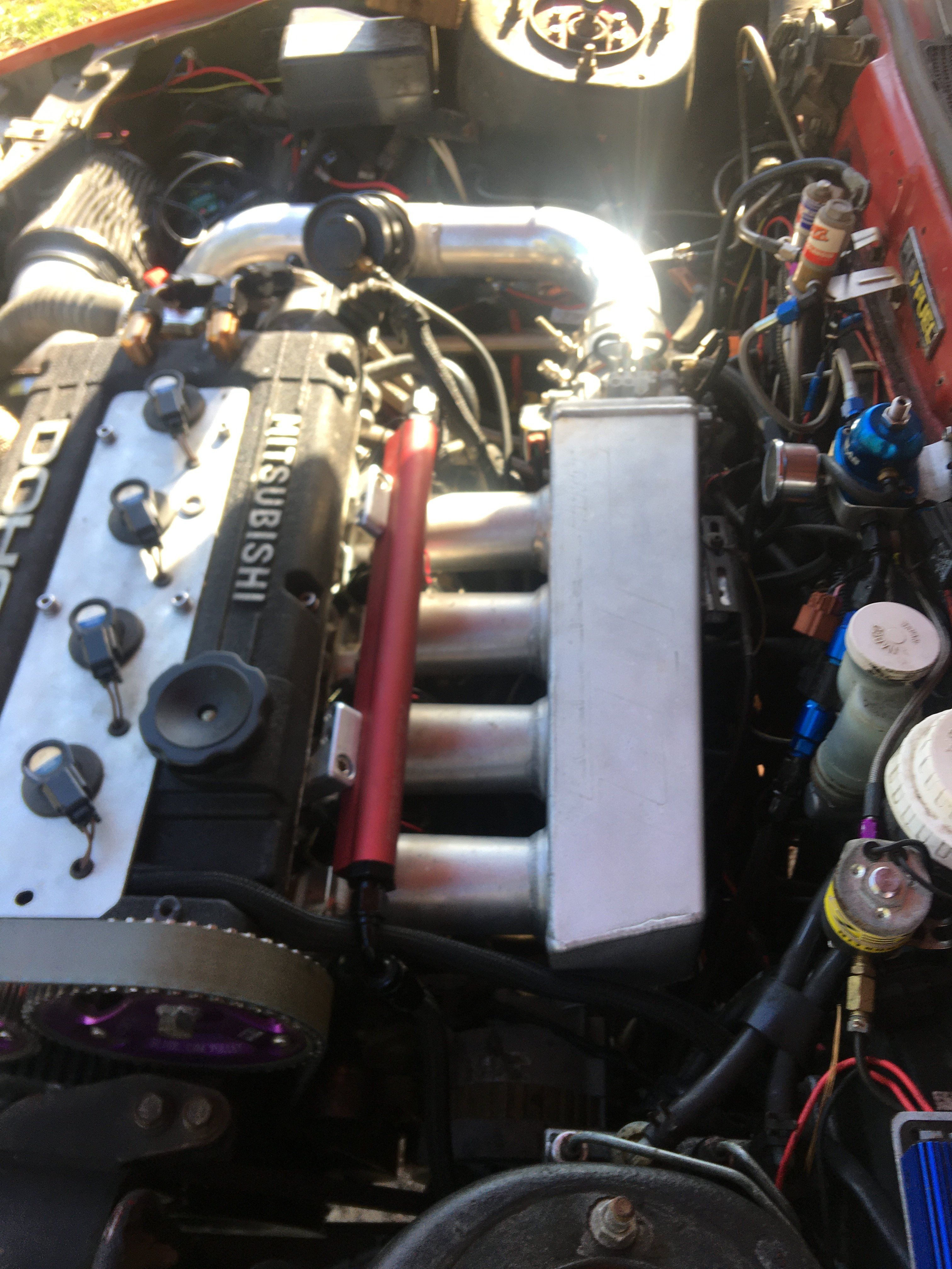

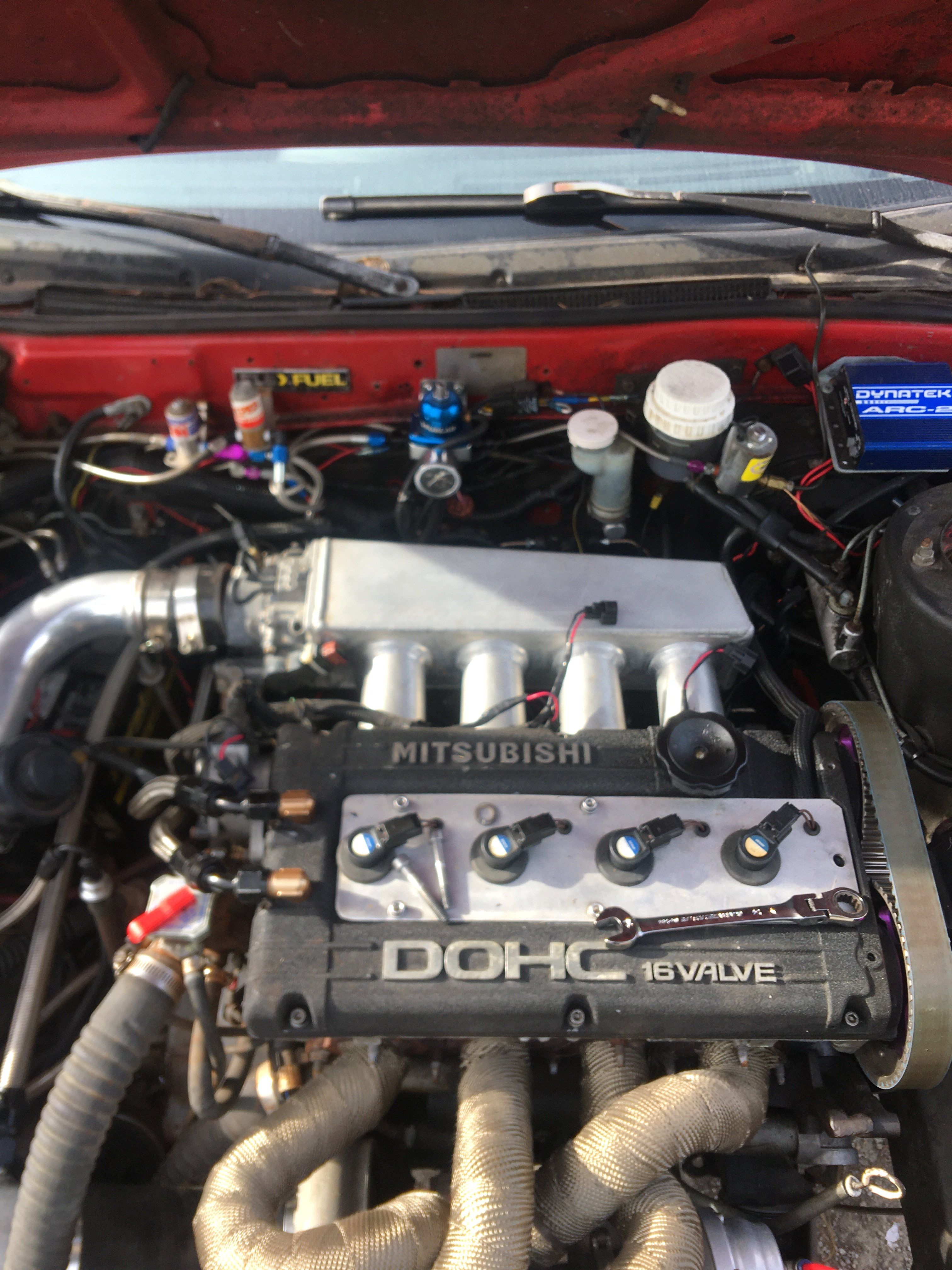

Engine is back together for the most part. Throttle cable need installed and t bolt clamp on the throttle body needs tightened but it’s running again

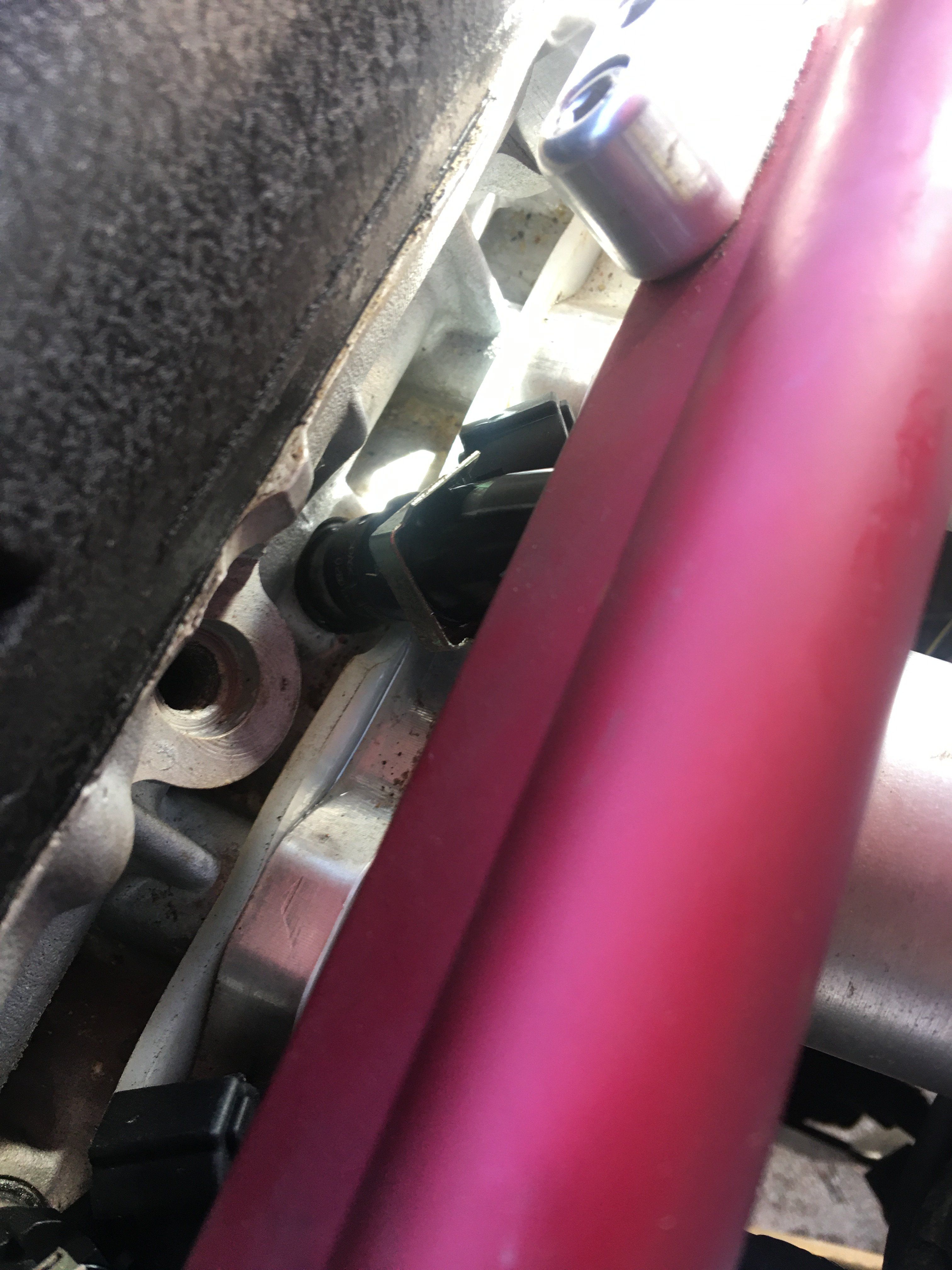

On startup I did find one of the upper injector seals was leaking pretty good. Gonna have to order those now.
still need to put a couple things back in the inside of the car but its getting there

Injector seals showed up a day early
going to get these thrown in this weekend. Might take it to the local cars and coffee sunday. Still a few more things to do to get it 100% but it’s on track.

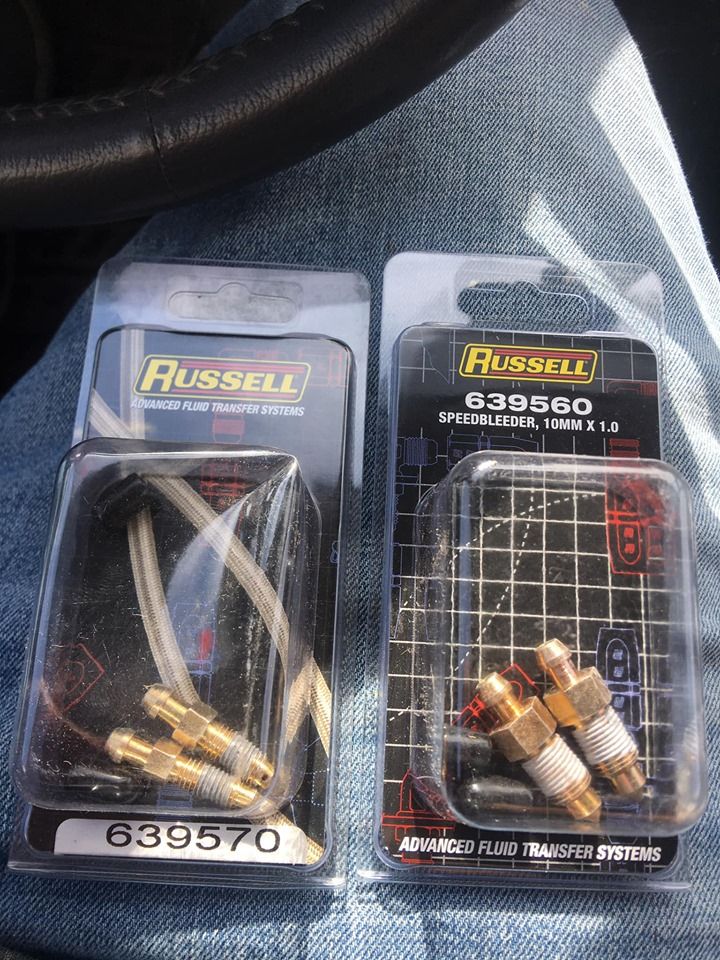

When I did my son's rear dif in his Z28 this week, we had to bleed the rear brakes since it was all new and I came across this and LOVE it. It gets 95% of the air out. I had ONE burp of air after using it and it was so much handier than "pump, pump, pump" and "bleed", repeat. Just wanted to share. It works off of air like my pneumatic A/C vacuum pump.
Amazon product ASIN B016M68PUW
Glad you got your seals Josh, I always keep at least 4 on hand at the house at all times, sometimes 8.

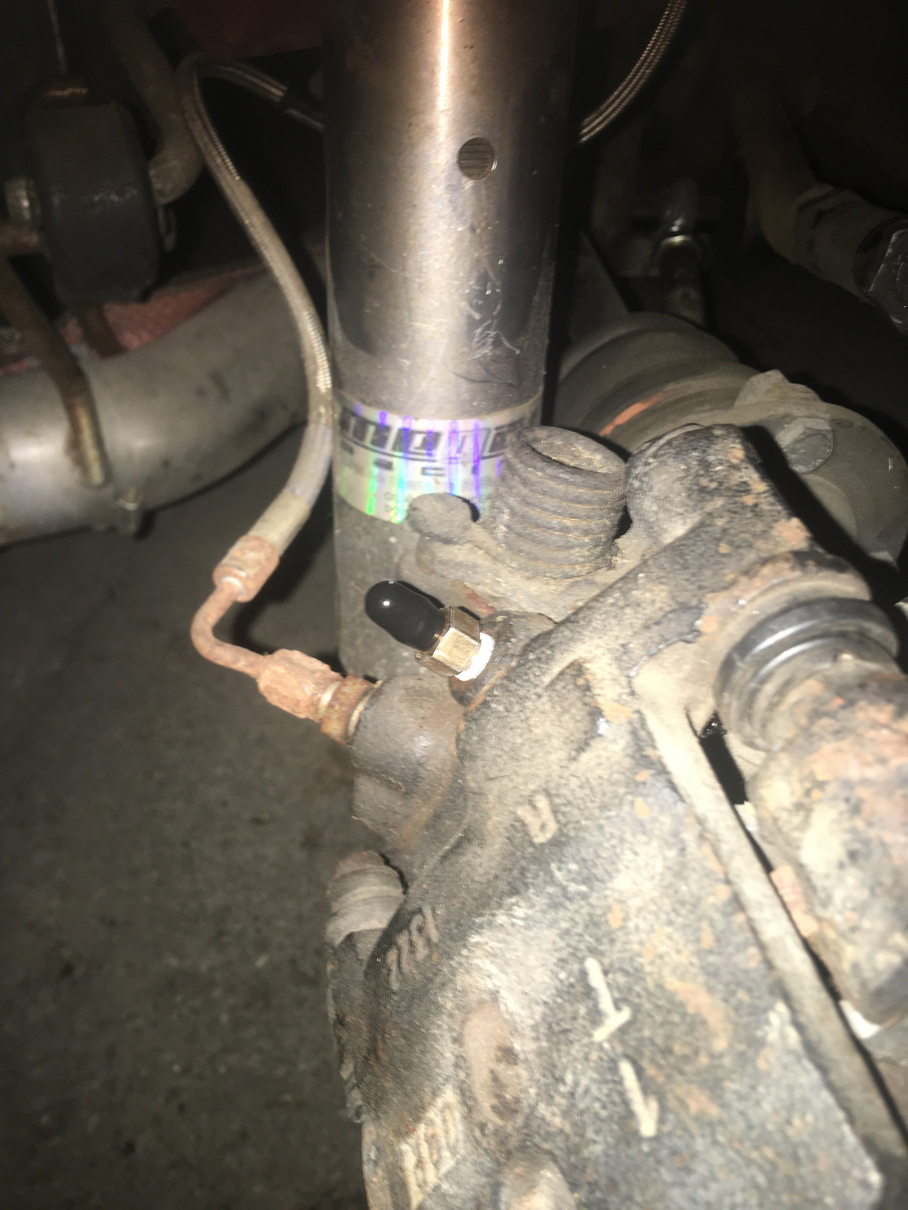

heck ya thats awesome marty. the speed bleeders seemed to have worked well for me. pumped them all about 4 times each and all the air was gone out of the system. technically only needed about 3 but did another just for good measure.
