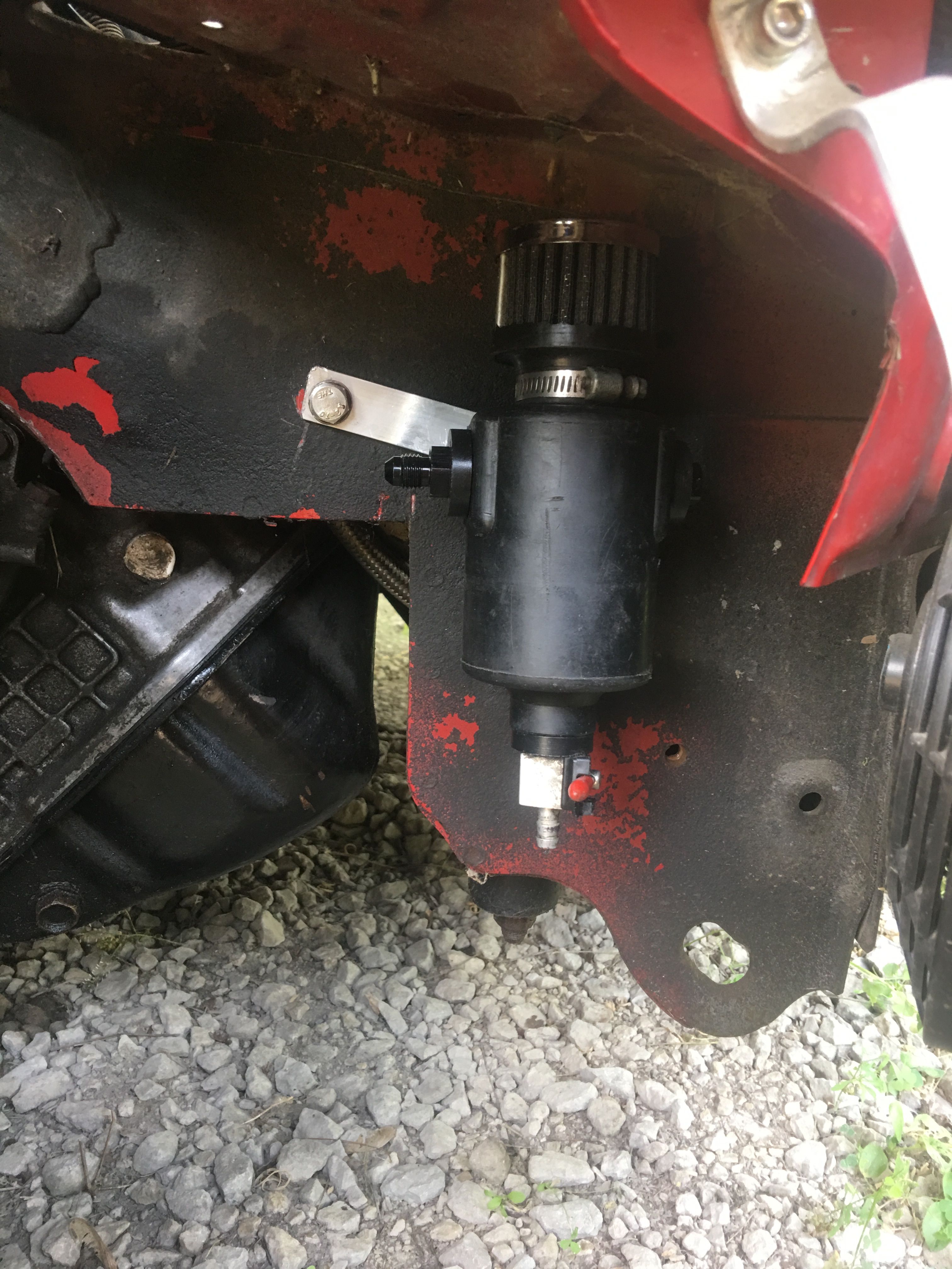

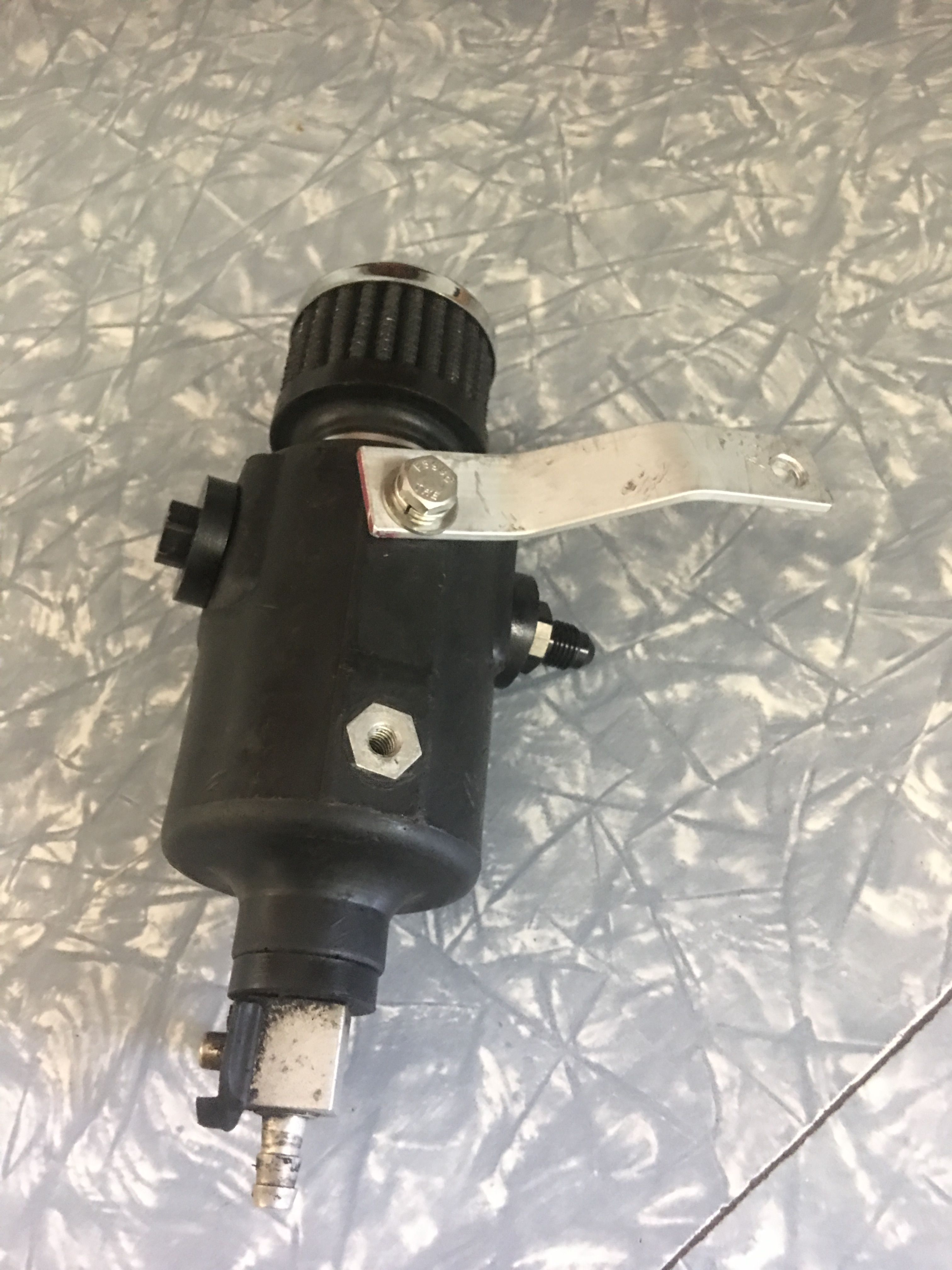

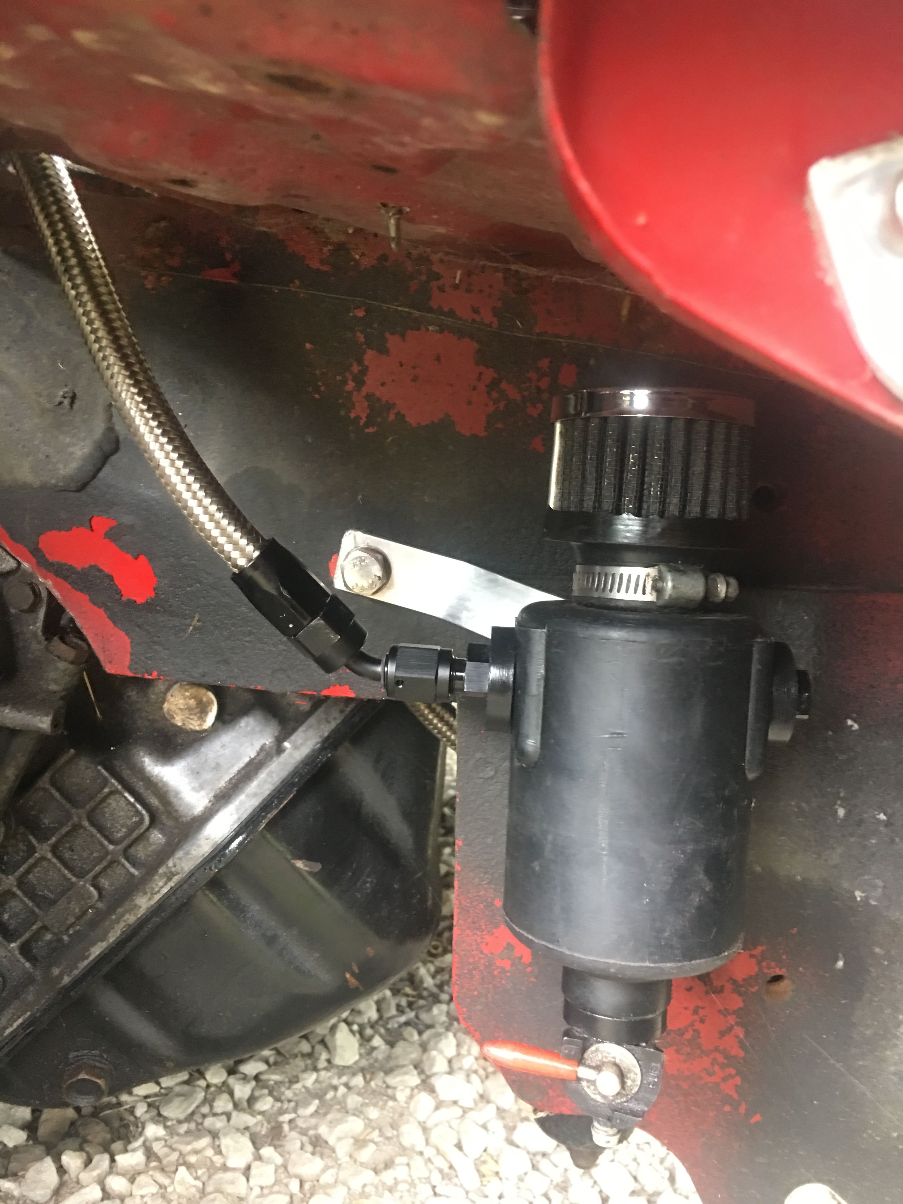

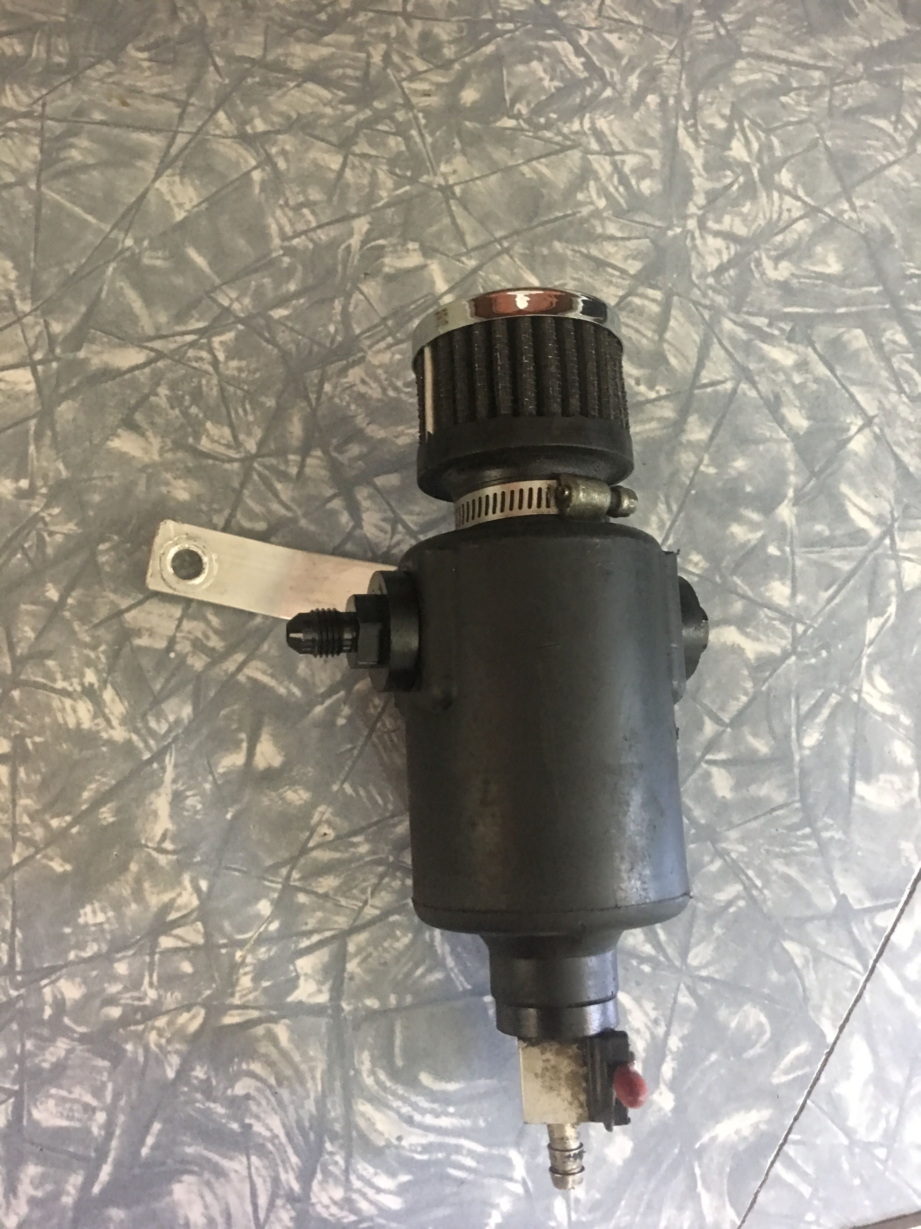

couple pics of the bracket i made up for the catch can. talking to warren the trans shouldnt ever puke but can be possible in high hp applications, this is mainly being used as a vent but just in case it does have some come out the top of the tube this will catch it.
and mounted up. i felt this was the best place for it as the bay is kinda tight with all the other stuff going on. now just to get some hose end fittings and wait till the new dipstick gets here to get the line made up.

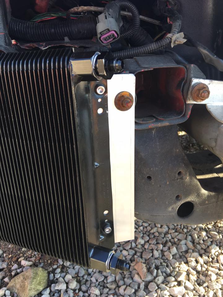

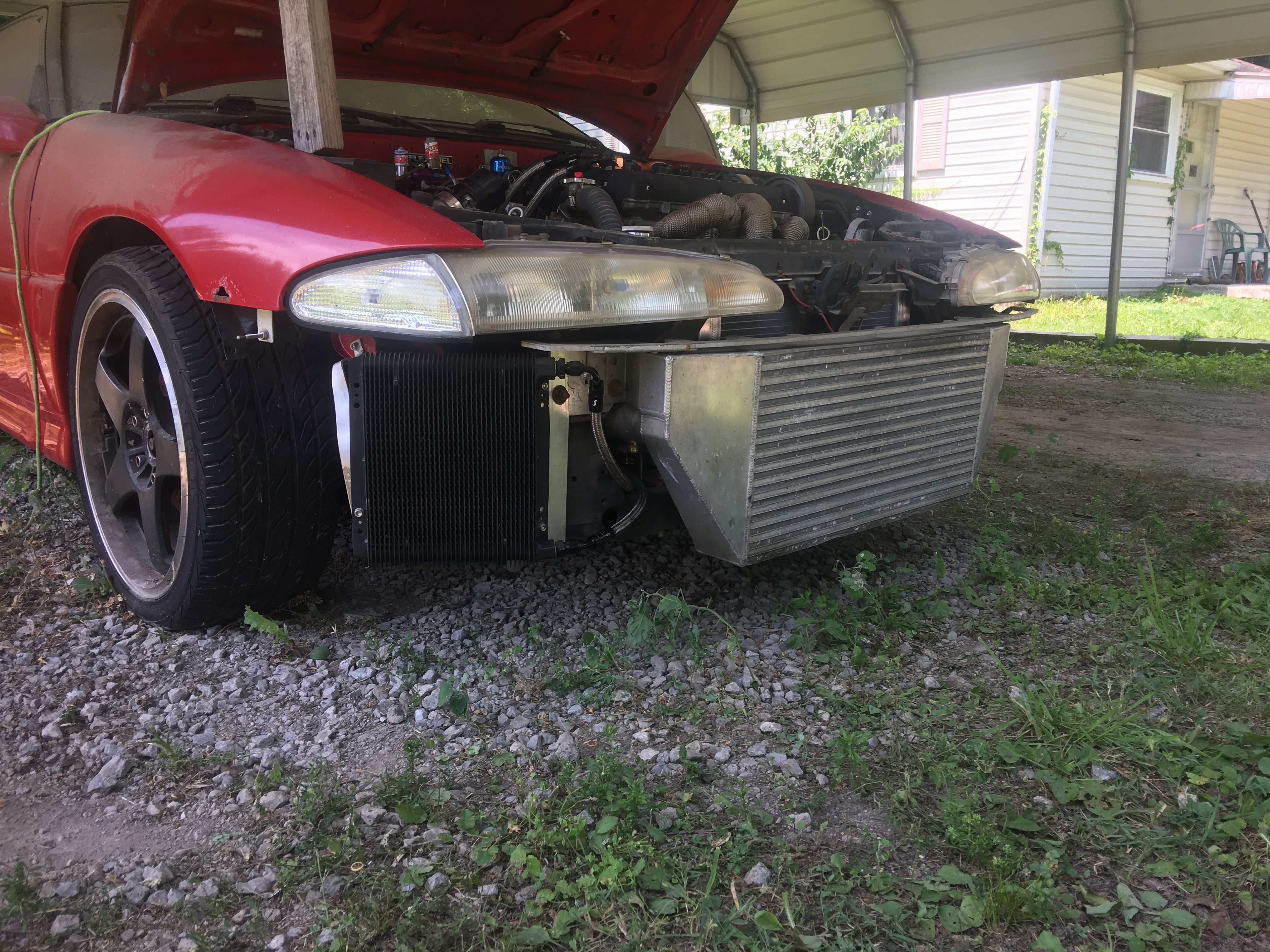

its a b&m 11x8 cooler with a cheap 8" fan. if i were to go back and do it again id get a derale cooler instead (still might later LOL) biggest issue with the b&m is its a total pita to get a fan on it. had to ziptie because the regular push through ties wont work.
It must be a plate and bar, those are tough to mount to. Did the SMIC area give you plenty of room to work with? I think the cooler I was looking at was 12.5 x 7.5". I have it all tore apart on that side and need to get a cooler ordered and mounted. Hoses out the top, side or bottom on yours?

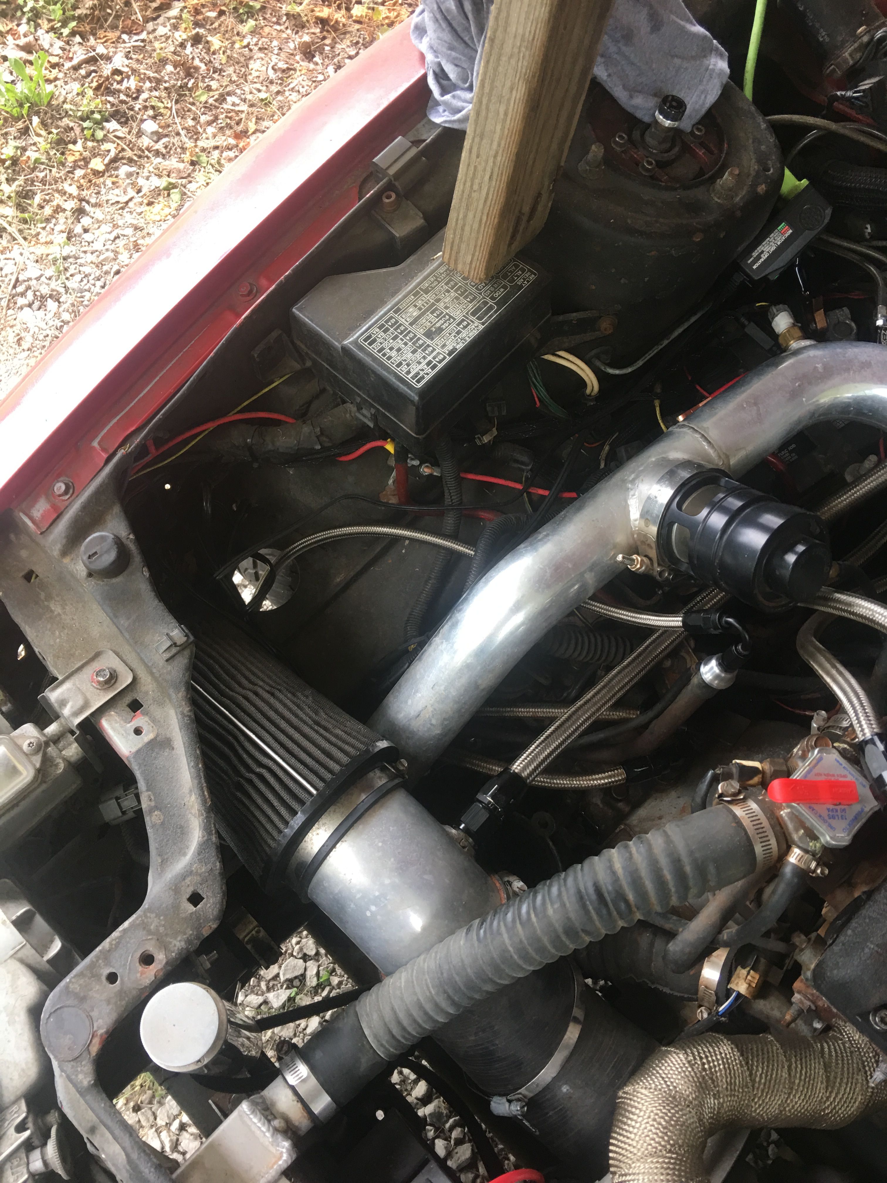

yea it worked out really well. i made a bracket that ties in to the front bumper mount bolts to holt it there and then made another brace to tie up the back.
hopefully these help
Very helpful. Cooler doesn't have to be perfectly straight, just get airflow so it cools. I like the bracket, it keeps it solid.

yea and adding the fan helped a ton too. just the cooler my cruising trans temps were in the mid 180s. adding the fan dropped them to a mid 170ish if i remember right
Great info! I didn't know if I was going to need a fan but was going to mount the cooler in a position that would accept one if I needed it. I kept the stock ducting to my SMIC hoping it will funnel air right to the cooler.
yea theres a good bit of room to work with right there. with mine i did have to relocate the horn to make it work but thats no big deal
Who needs a horn.......:p
That's why there are 2, LOL.
What do you think of leaving the fog lights in? My VRSF kit lets them stay but I don't want to block a lot of air, still like the fogs tho.
im not a fan of the 1gb fogs so im more than content with them gone LOL. with a fan on the cooler it might not be too bad. only one way to find out

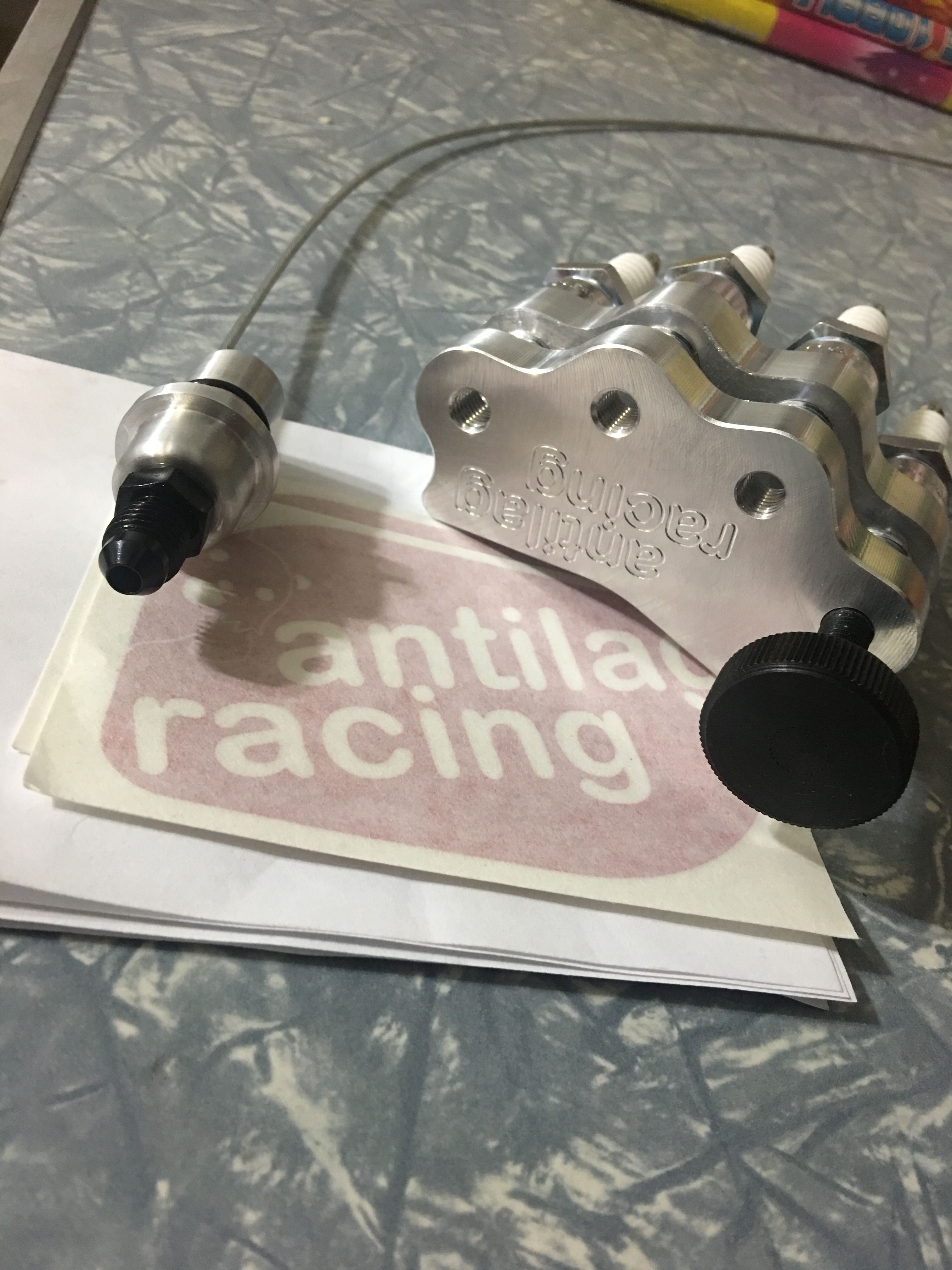

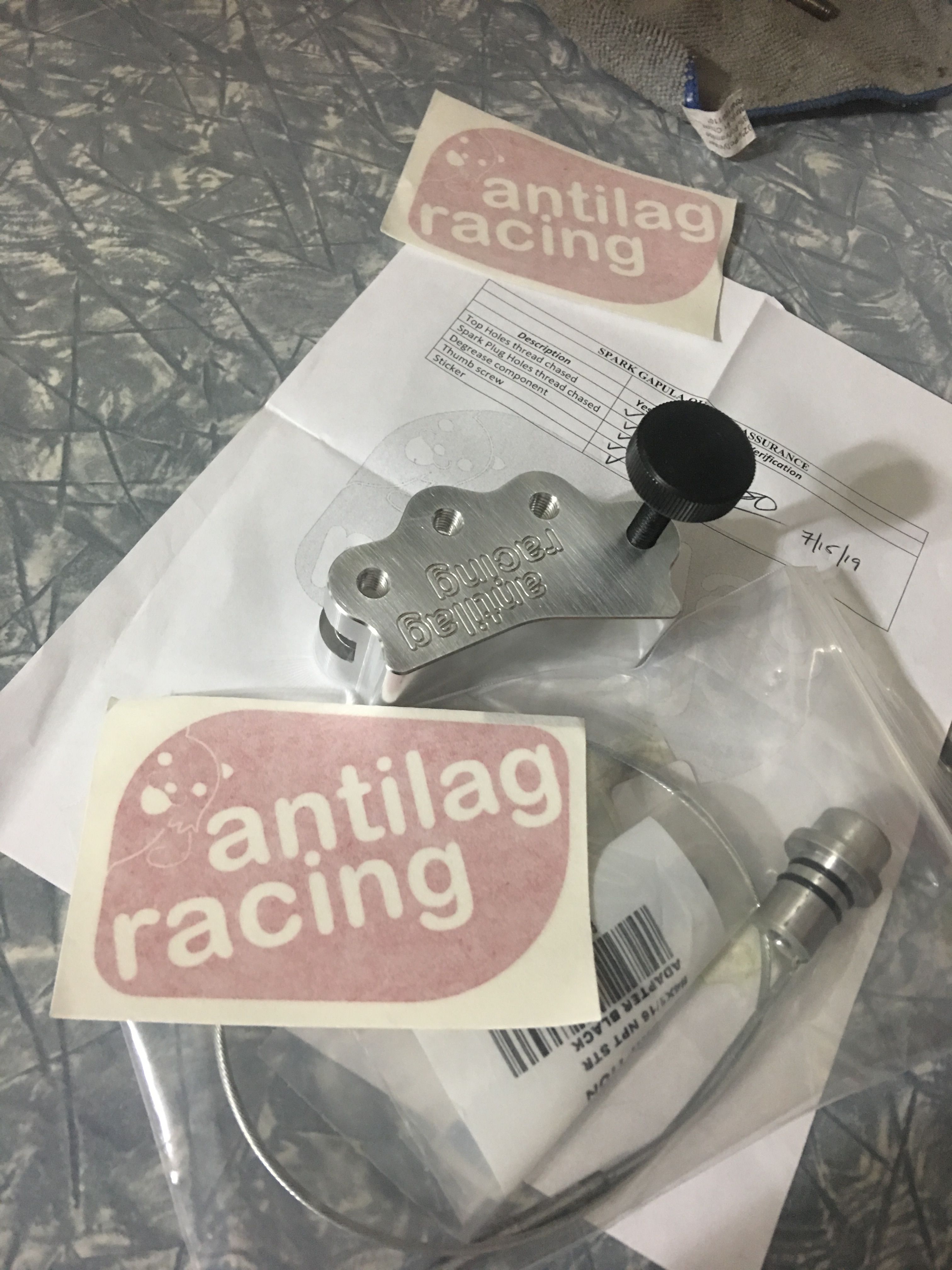

gapula and my dipstick showed up last night.
just need to get some fittings and ill get the dipstick in this weekend and all hooked up. the quality of both of these products is amazing. if anyone wants or needs either or a damn nice wilwood brake kit hit up @antilag_200 for them. he will take great care of you.

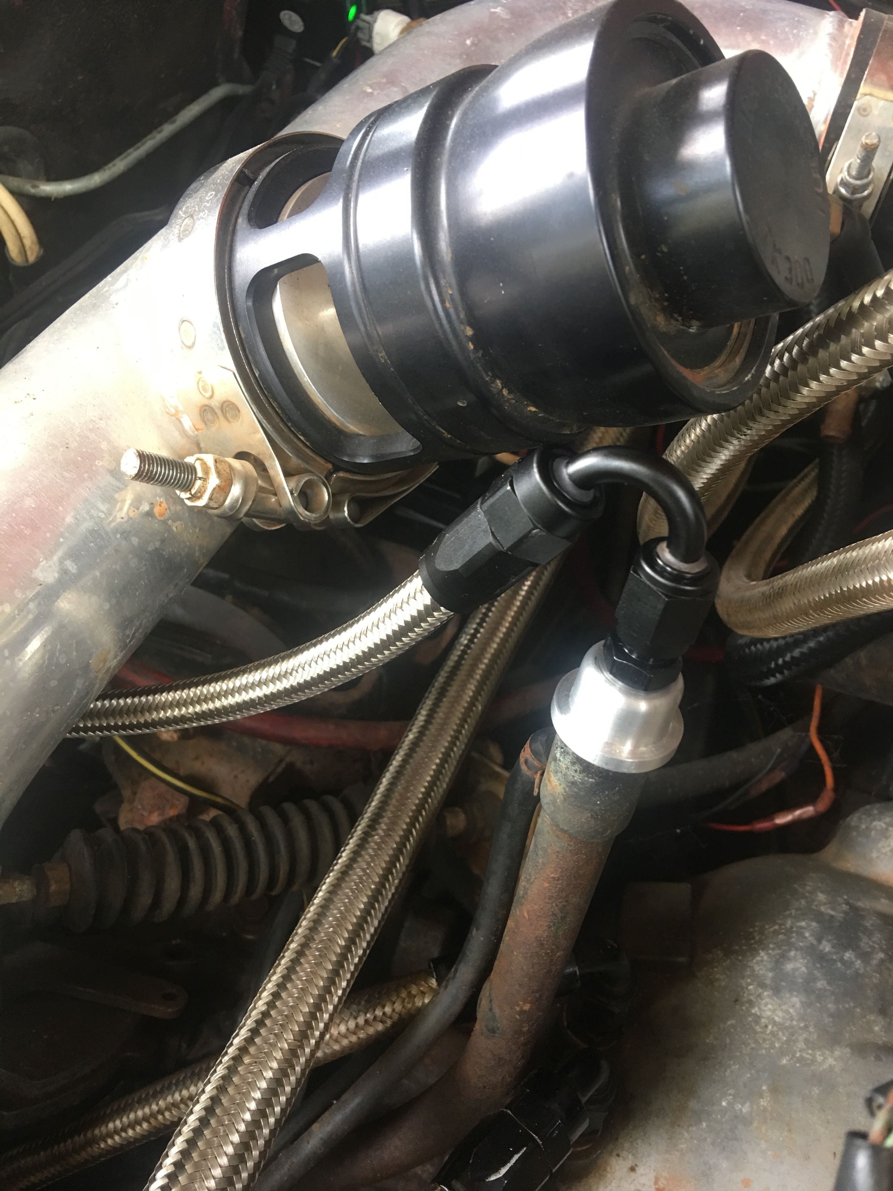

update. so got the new dipstick in and line made from it to the catch can made as well. came out pretty well.

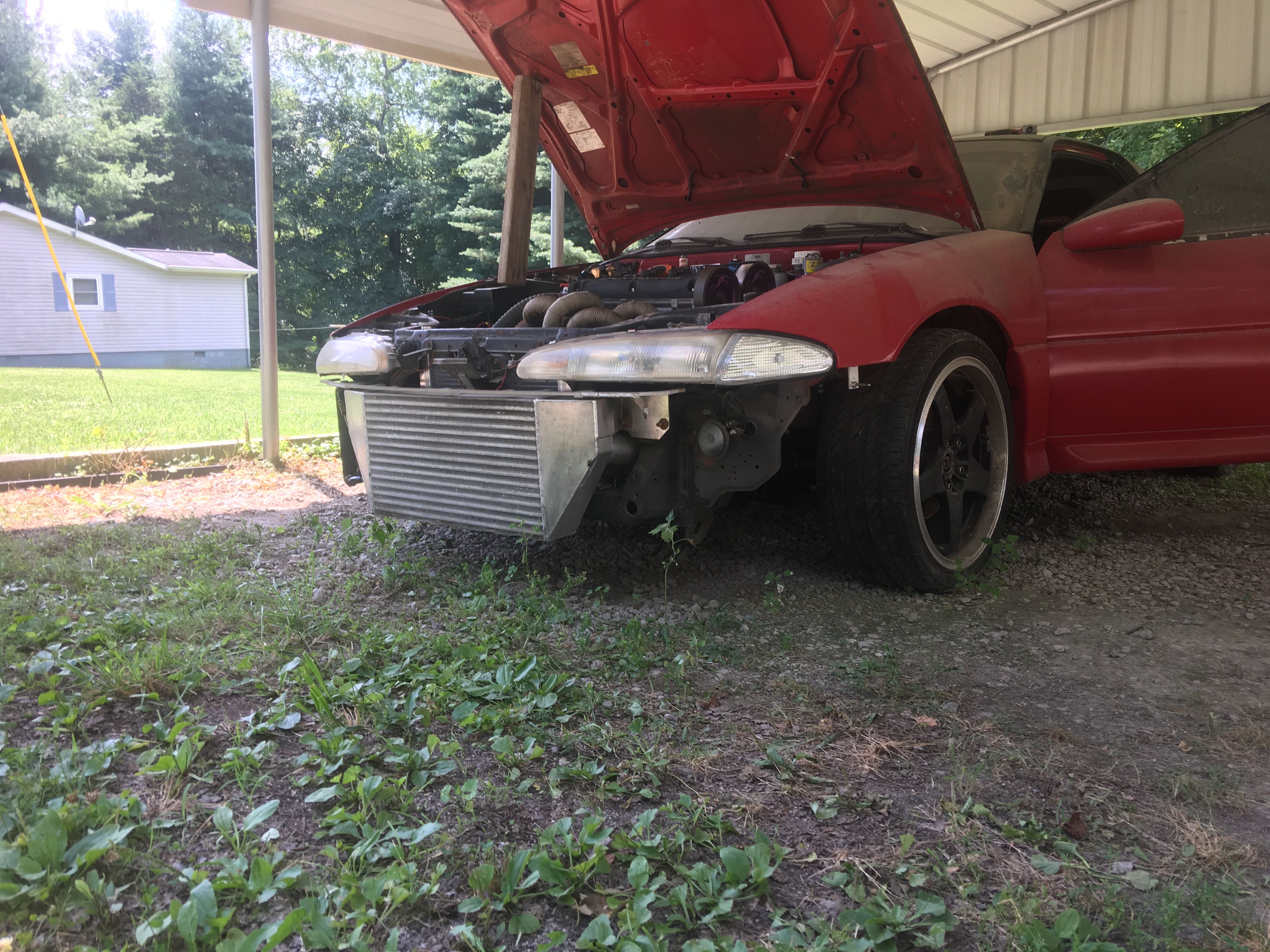

so ive got the car up in the air to get started on the scramble to get it to shootout

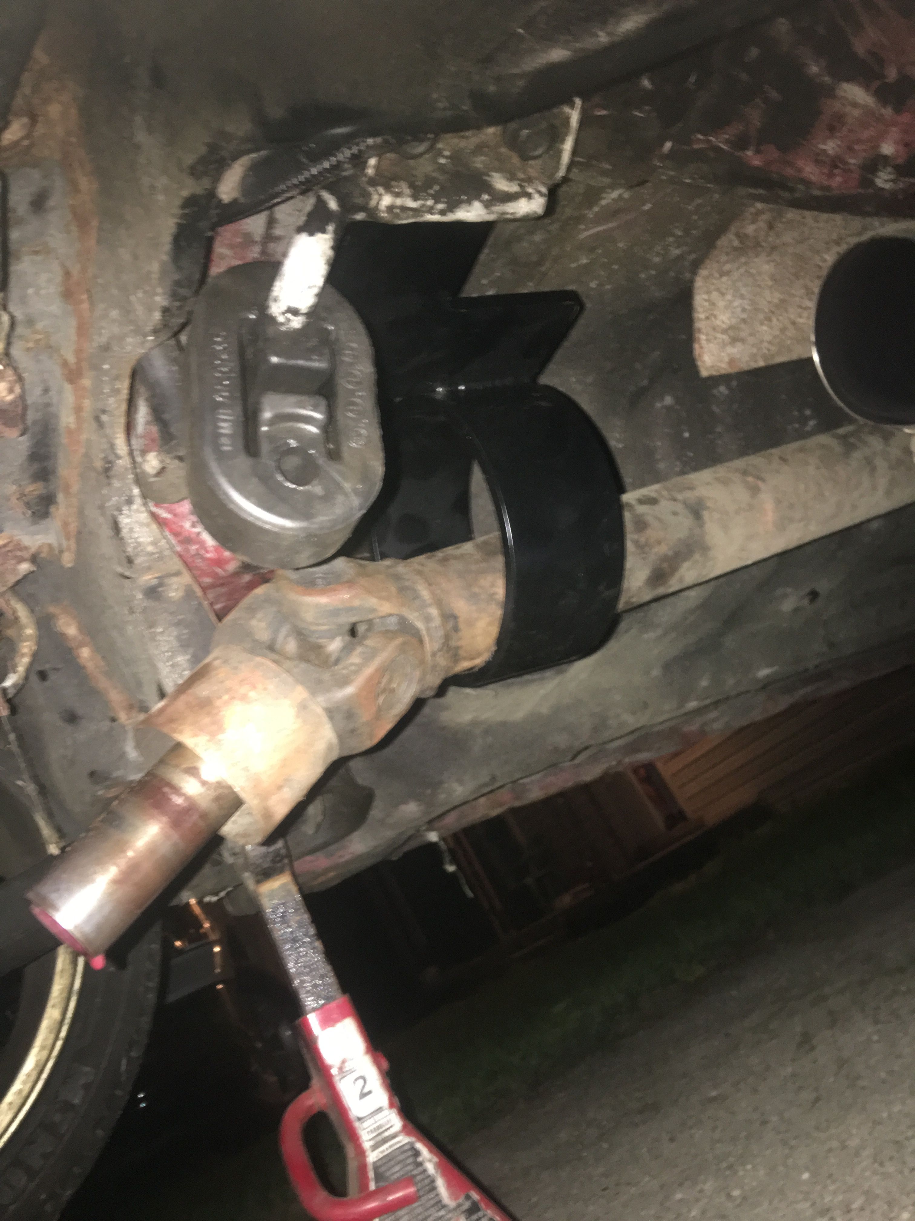

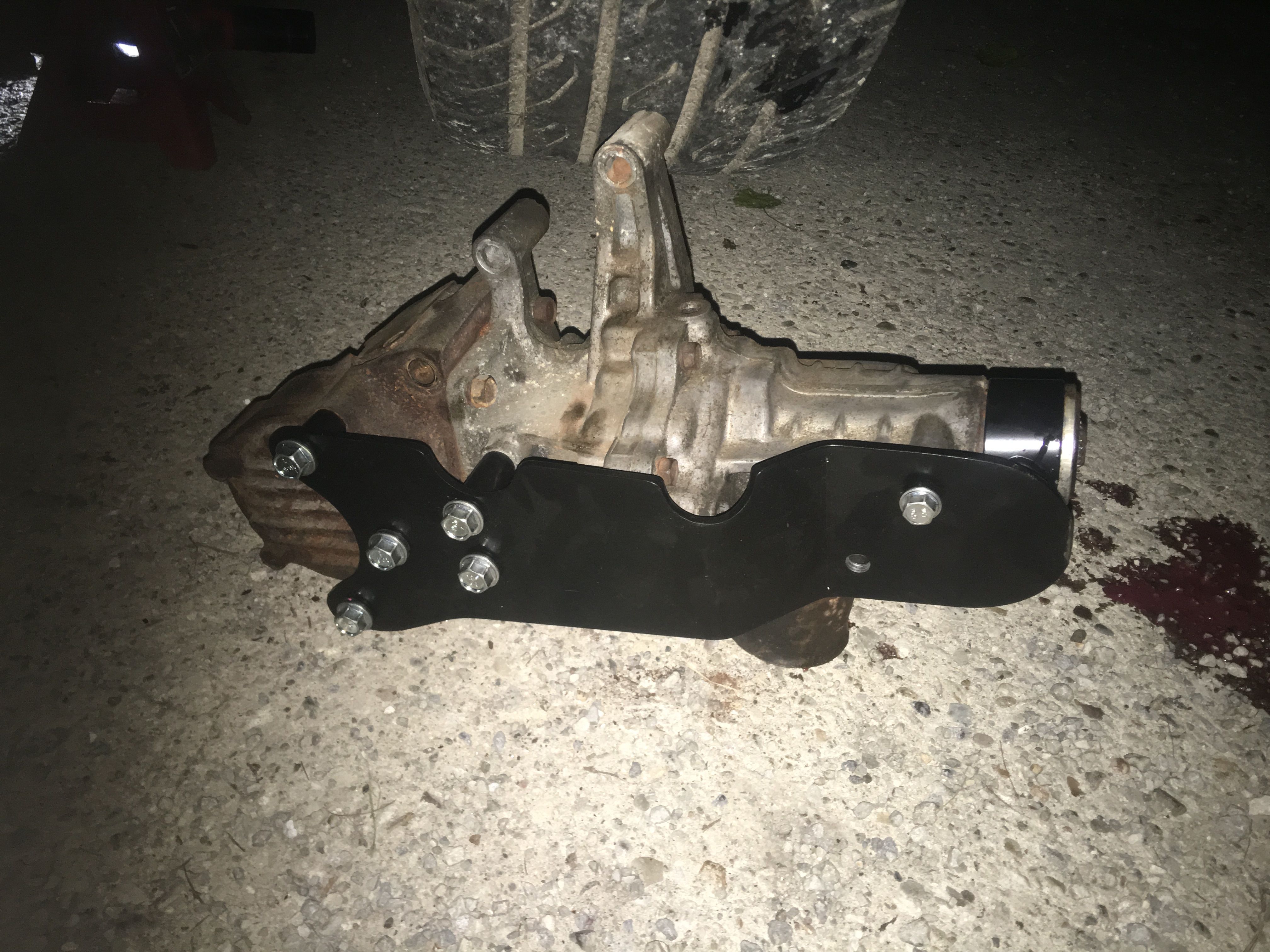

i did start working on some of the easy fixes under the car first. i got the jb designs t case brace installed and also the masfab driveshaft loop

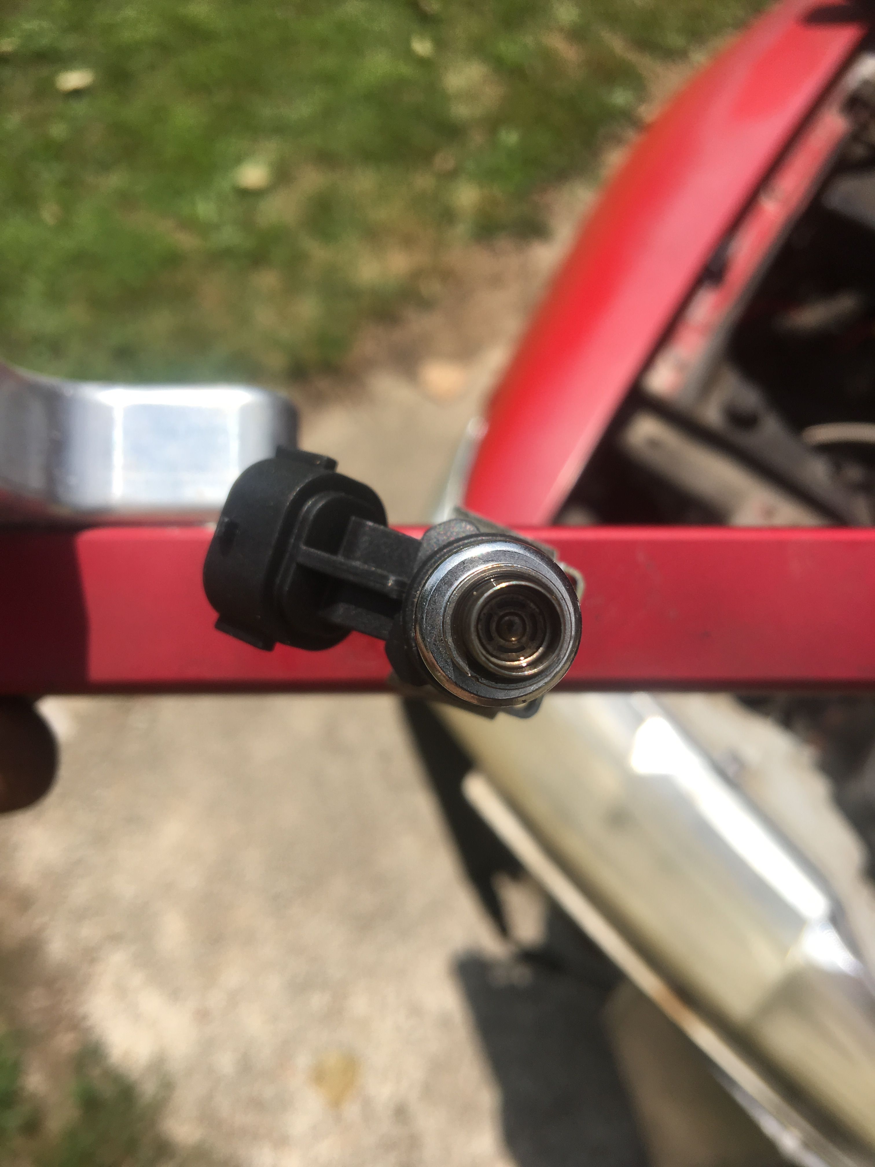

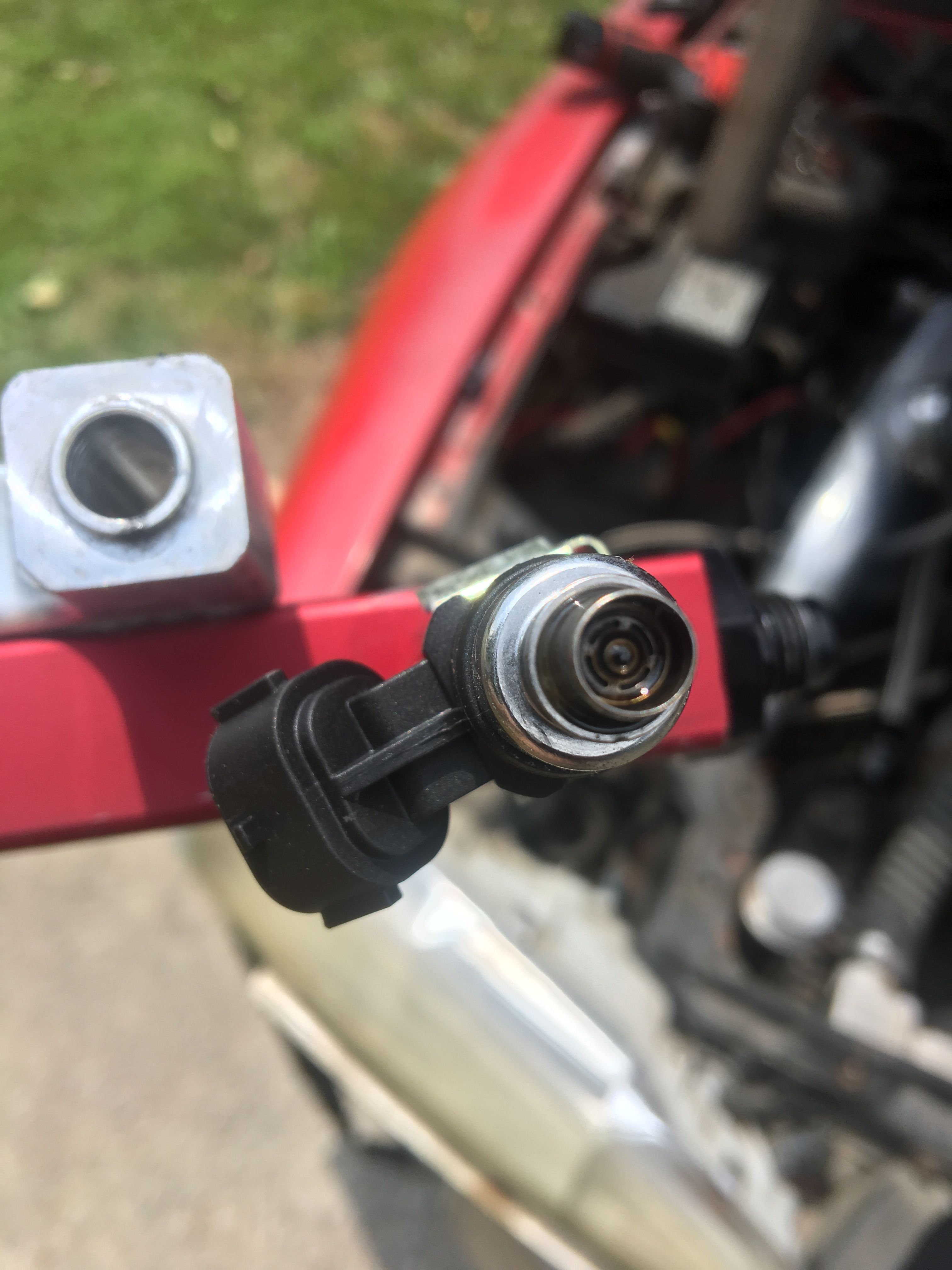

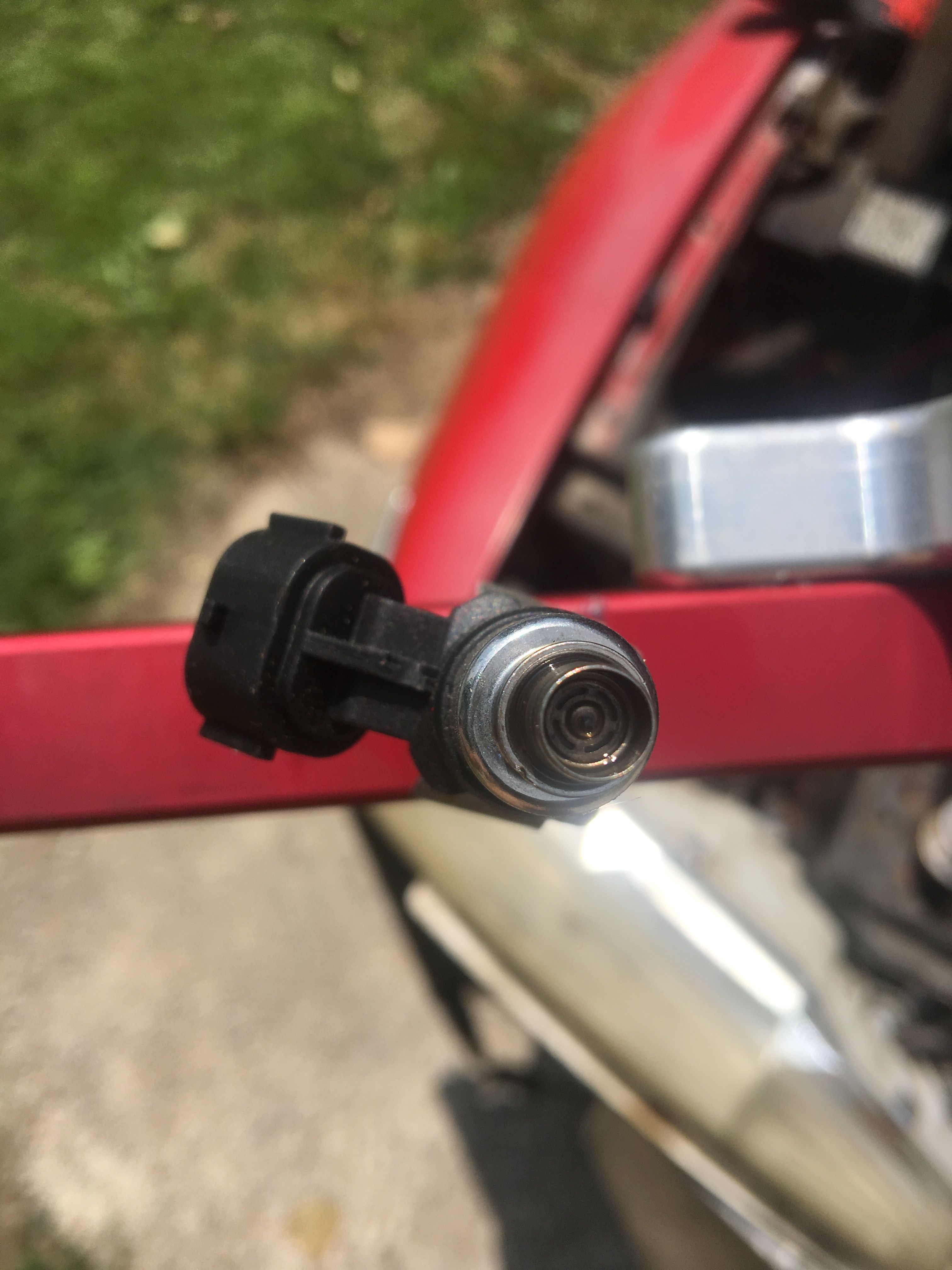

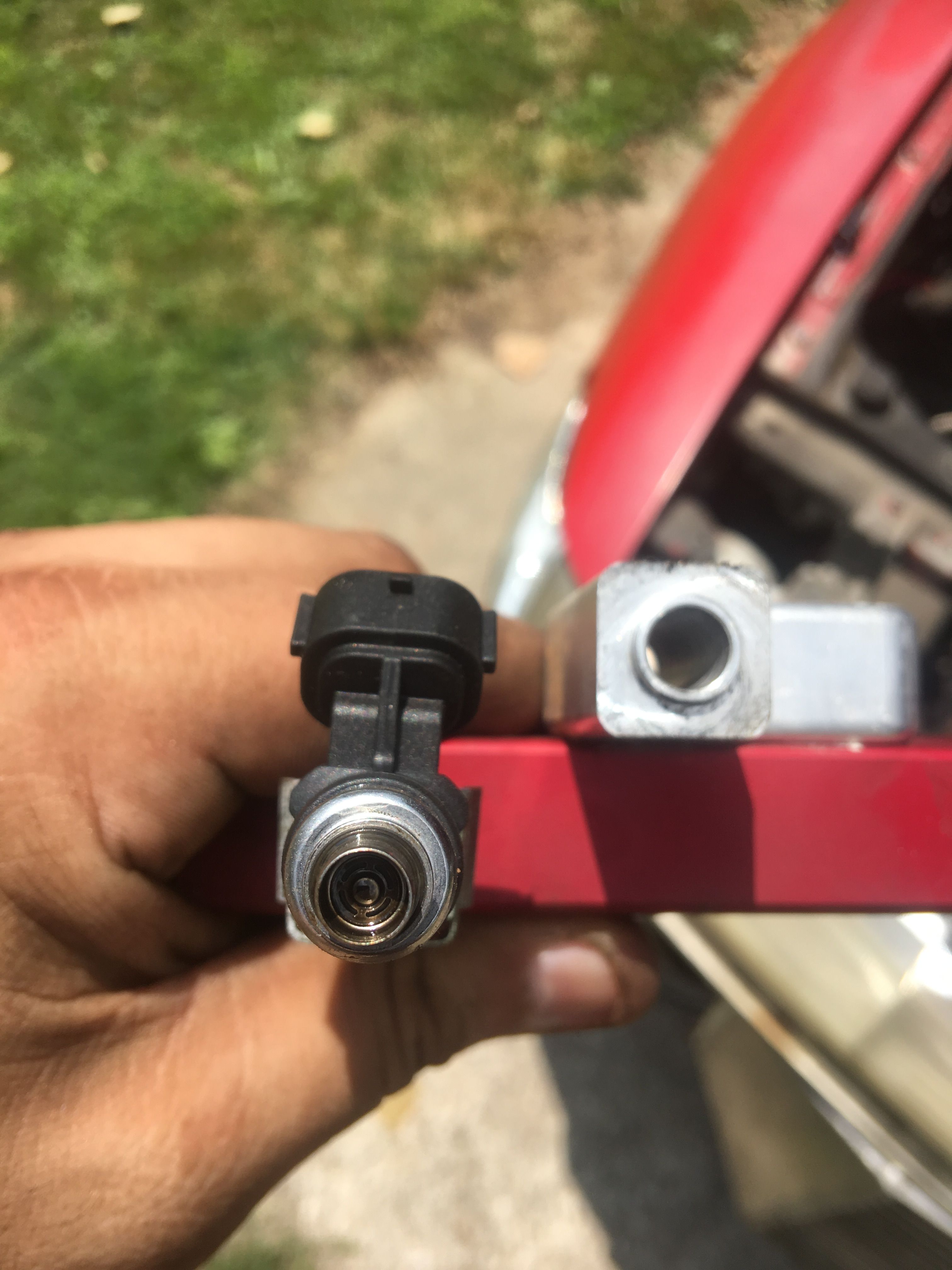

i did have a little issue and had to pull the brace back off to get the lower mounting bolt in that i forgot jeff told me about LOL but got it resolved. also decided after three years of pretty much nothing but ethanol use id pull the injectors and have them cleaned and tested. theyve only had 93 ran through them maybe twice in the time that theyve been in the car and sat with e85 over the last two winters. i was surprised to see the condition of them
