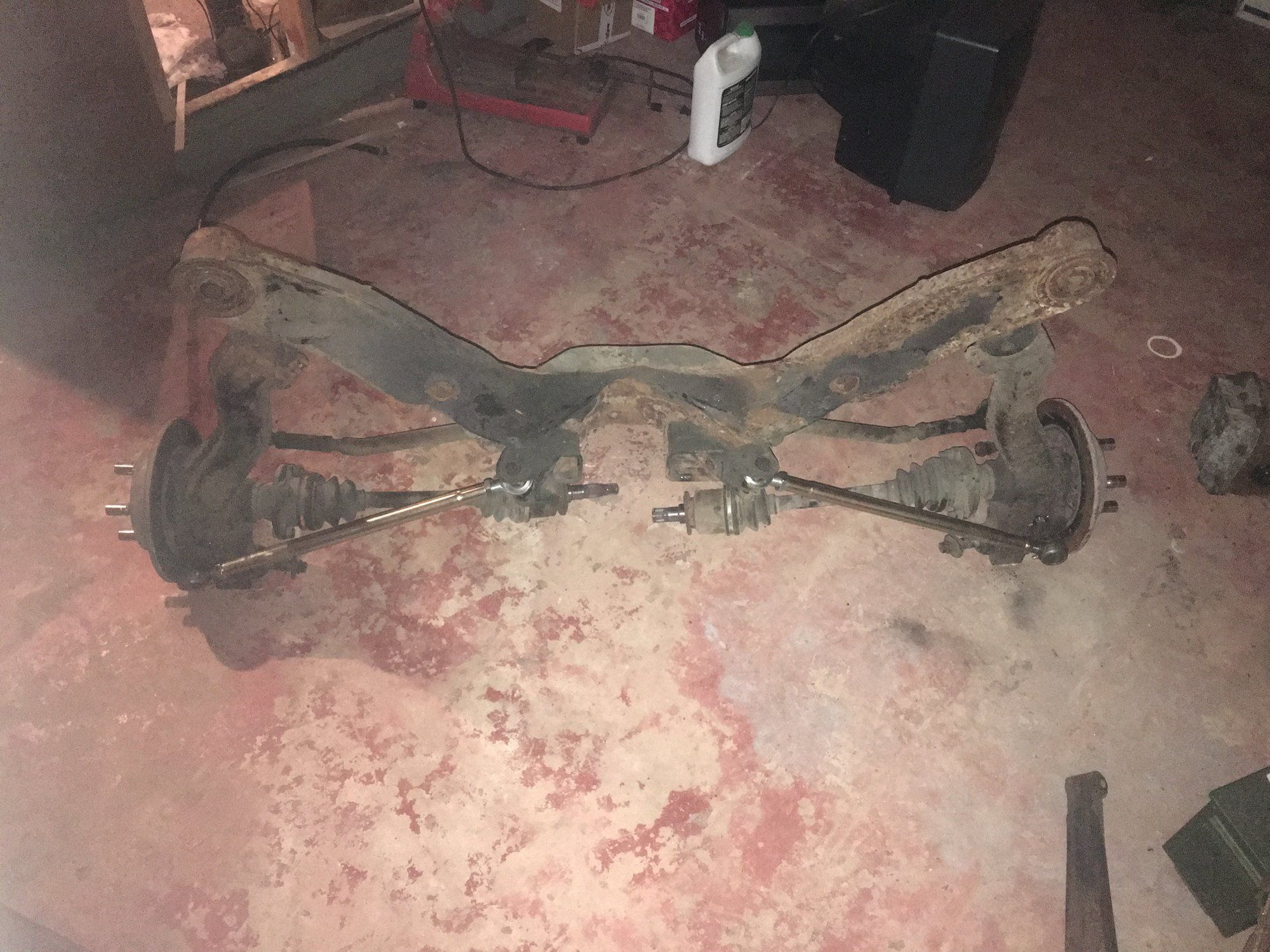

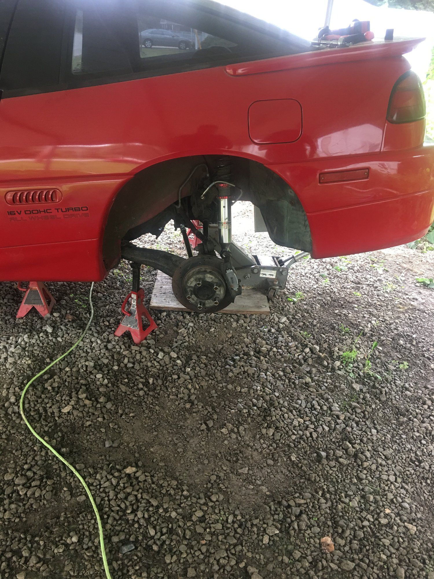

finally got some time to get the subframe out of the car. started calling the it lt. dan LOL
lt. dan status LOL.
didnt take any pics but after this i got the subframe stripped down to get all the new stuff put on. more pics soon to come on that.

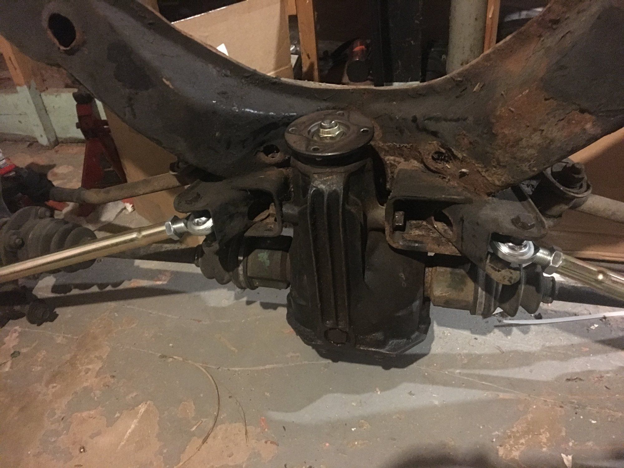

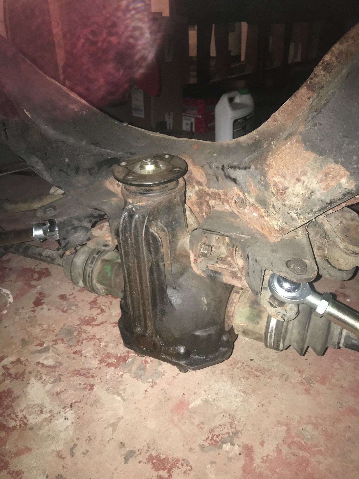

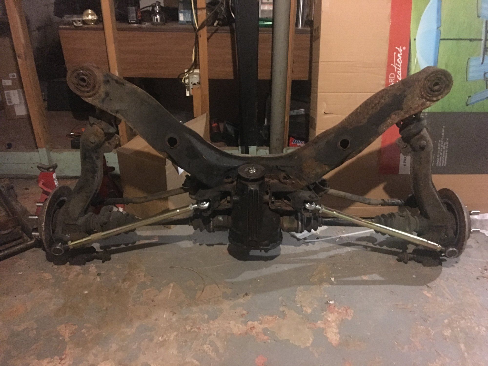

got the subframe all re assembled last night. after lugging this thing around im really thinking i want to spend the money on a tubular.

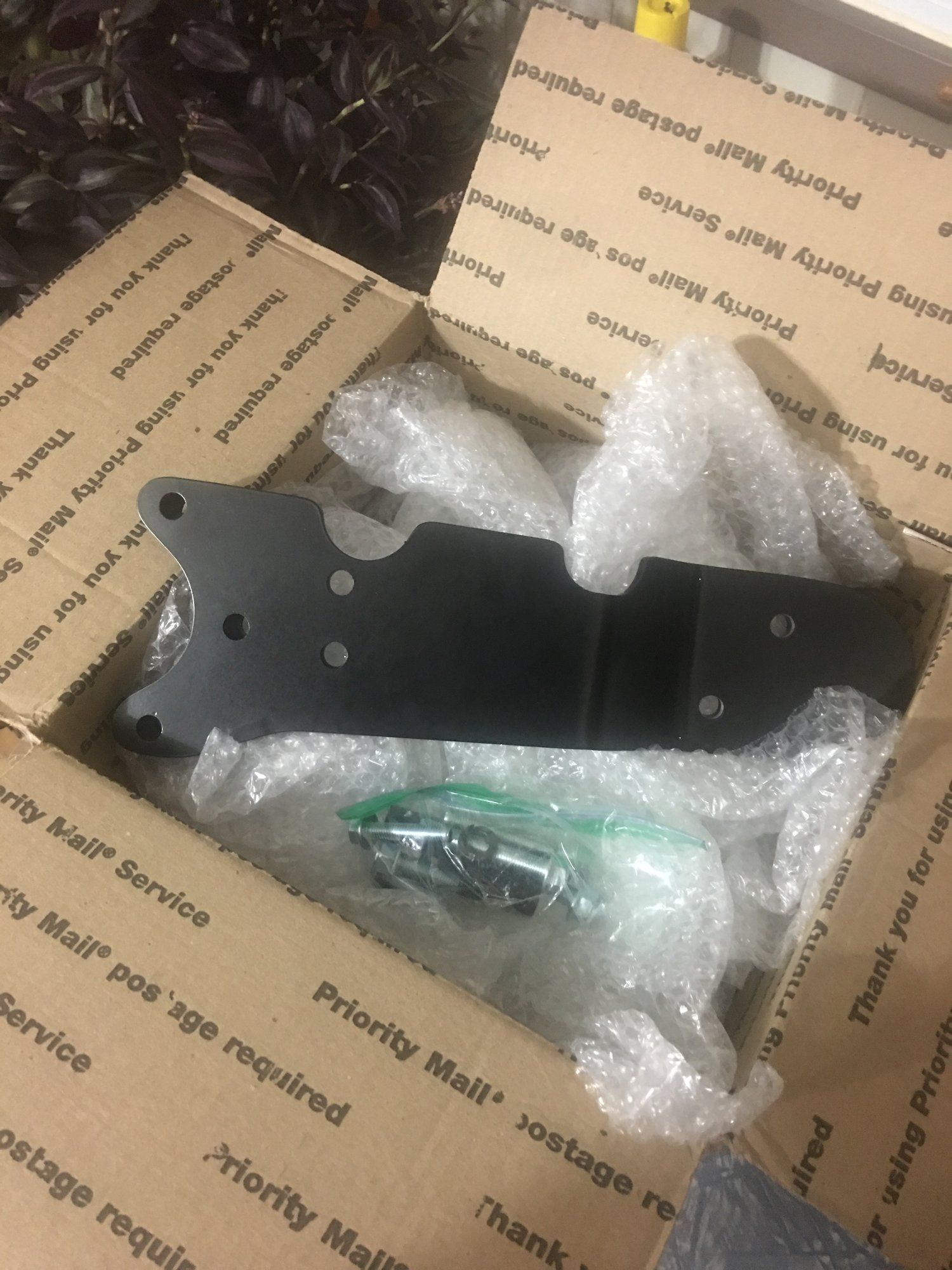

the jb designs transfer case brace showed up over the weekend. cant wait to get this installed on the car. jeff actually messaged me and gave me a few tip on how to install this once i go to get it on.

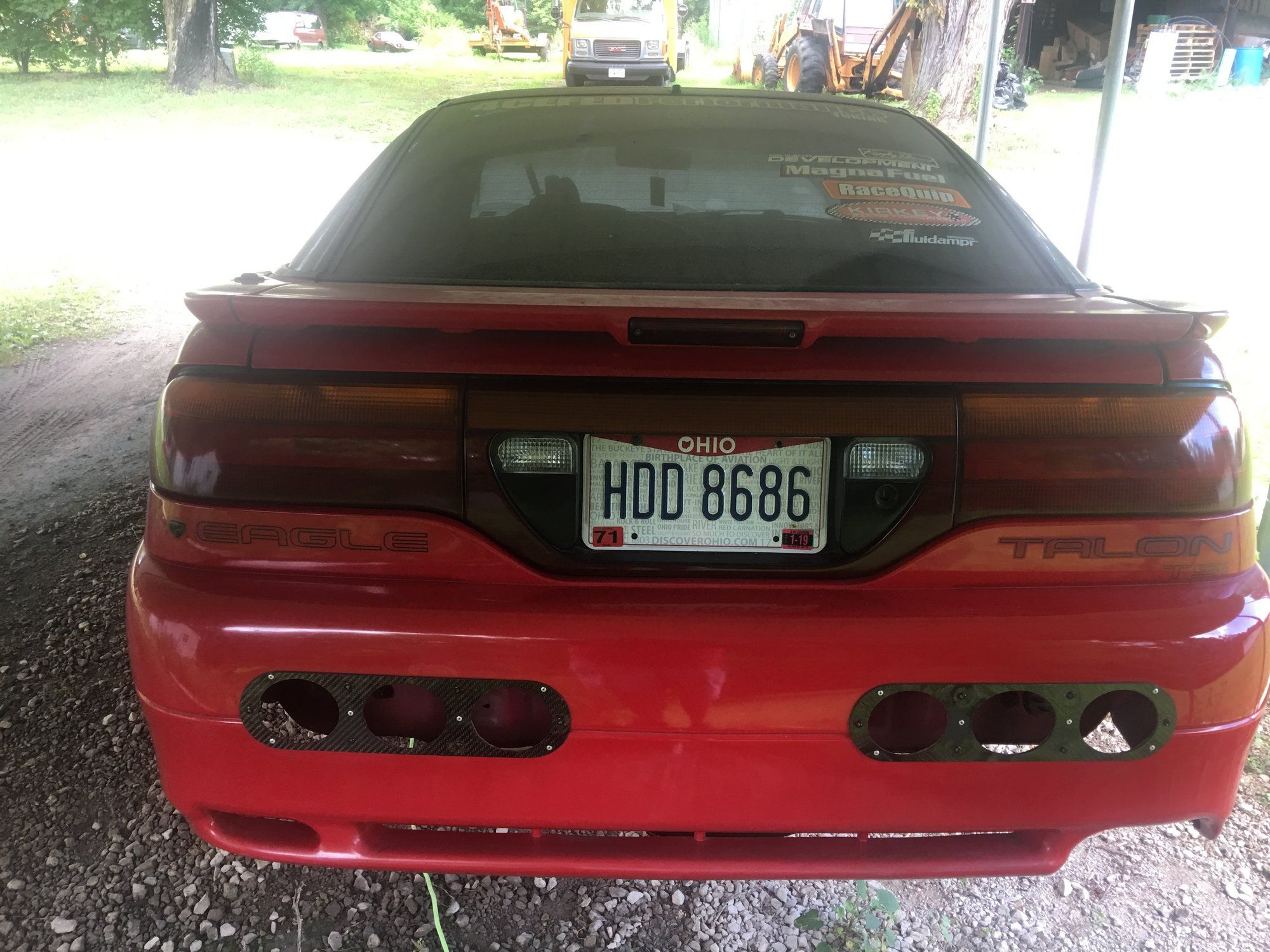

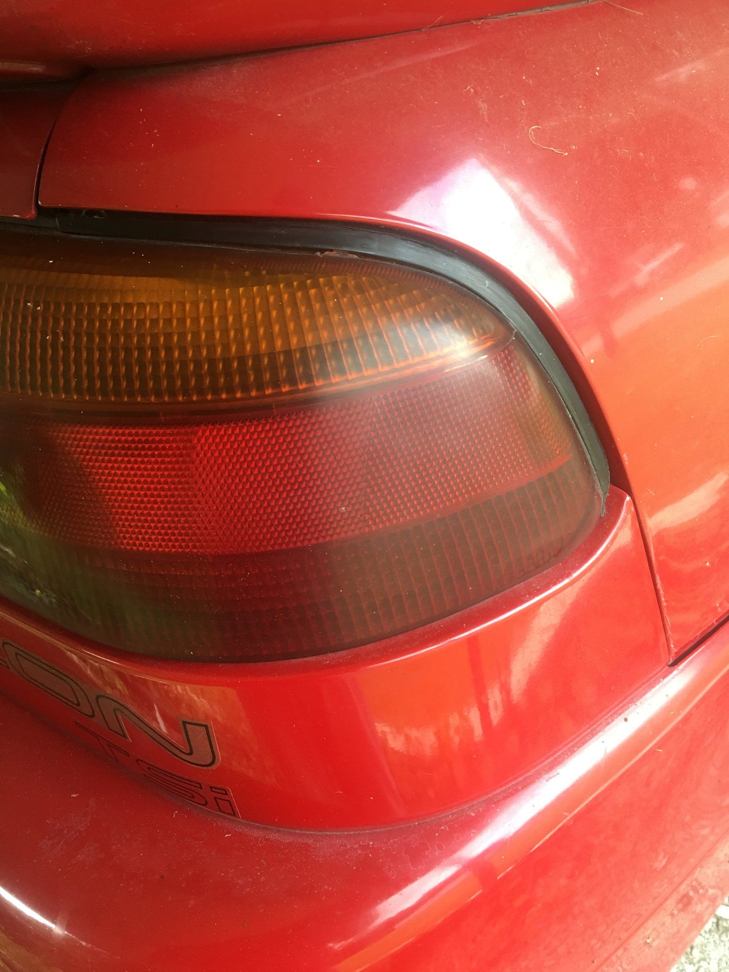

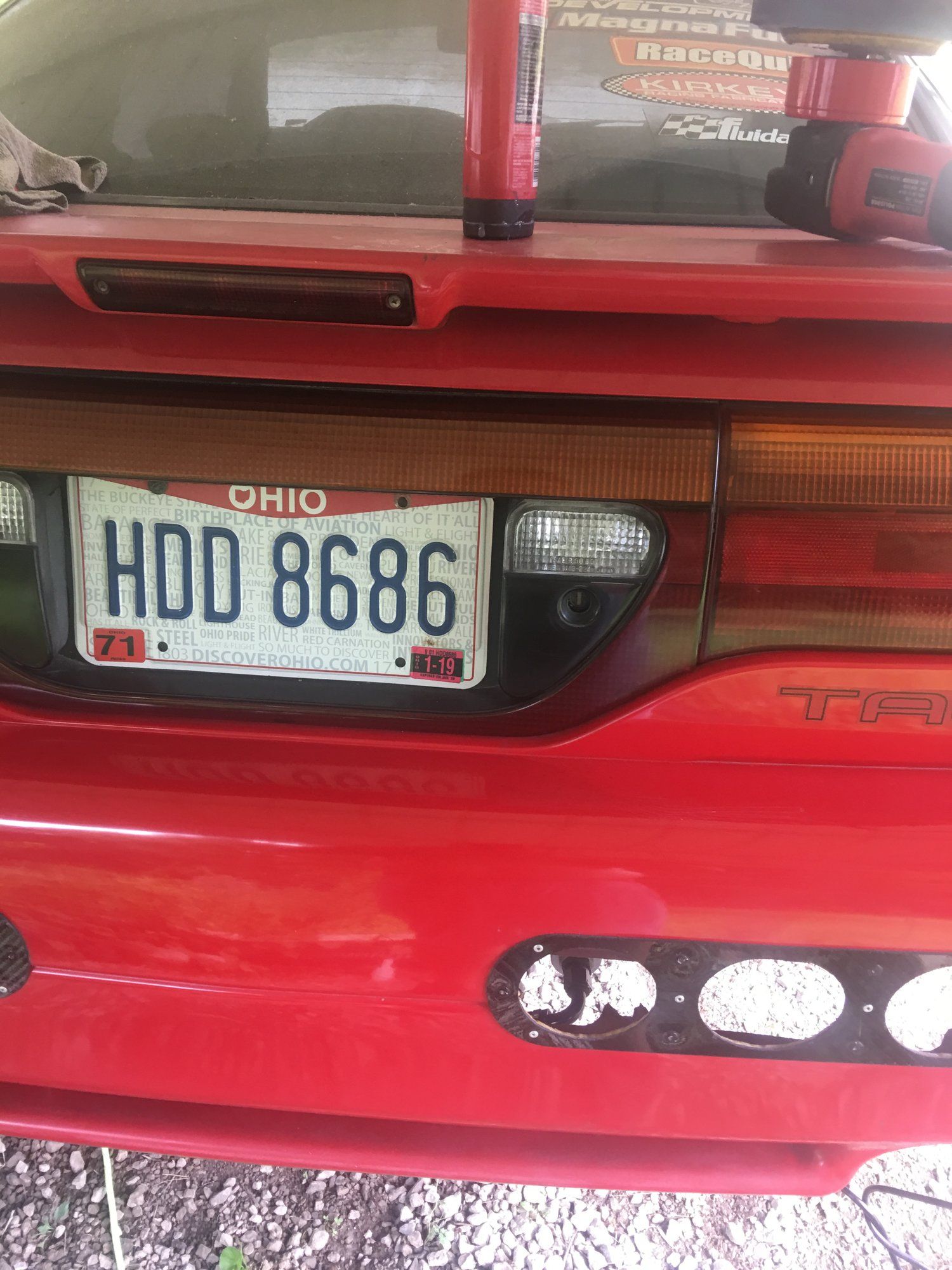

finall got around to polishing the taillights since i took the nite shade off.

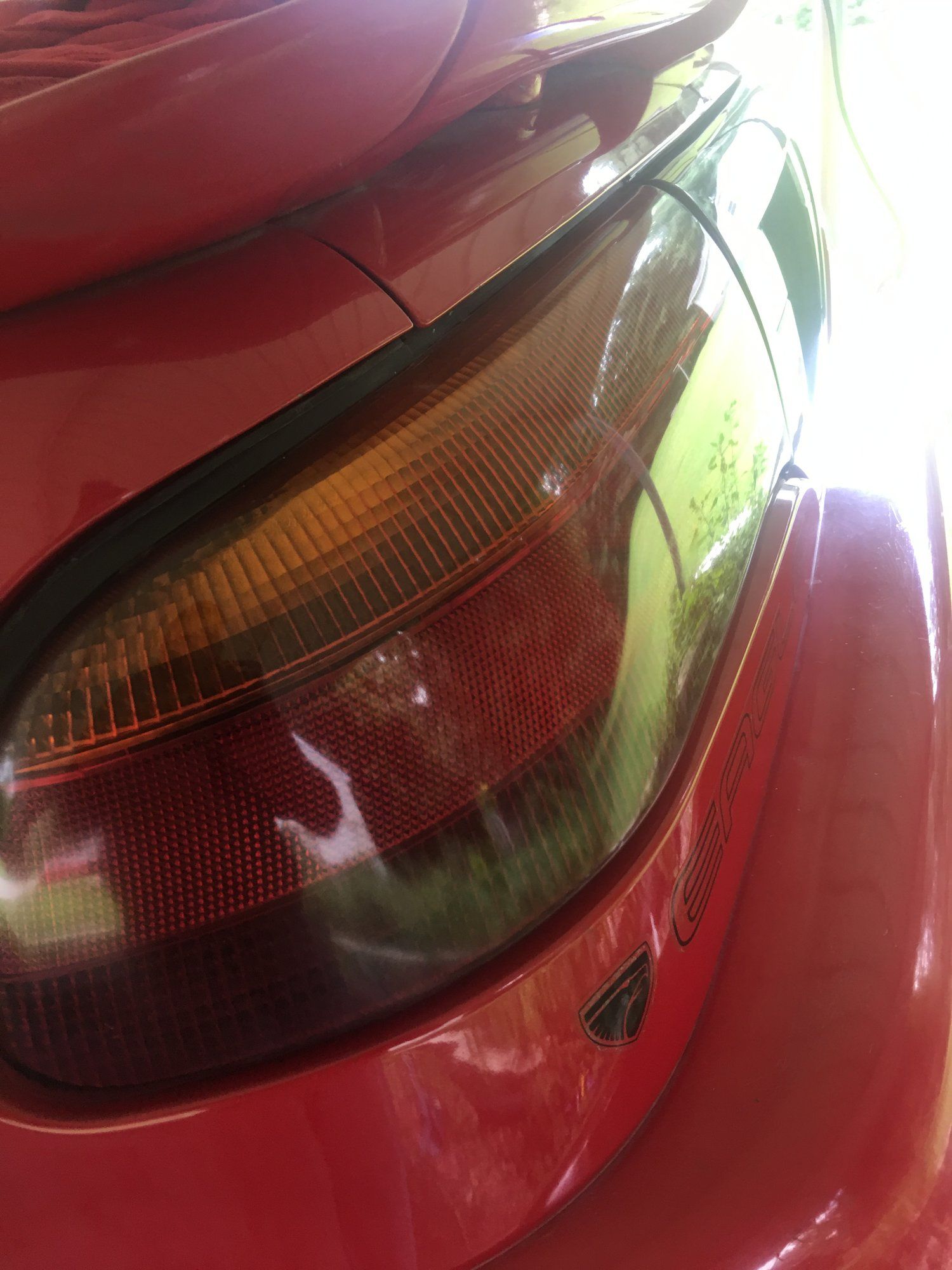

the before polish

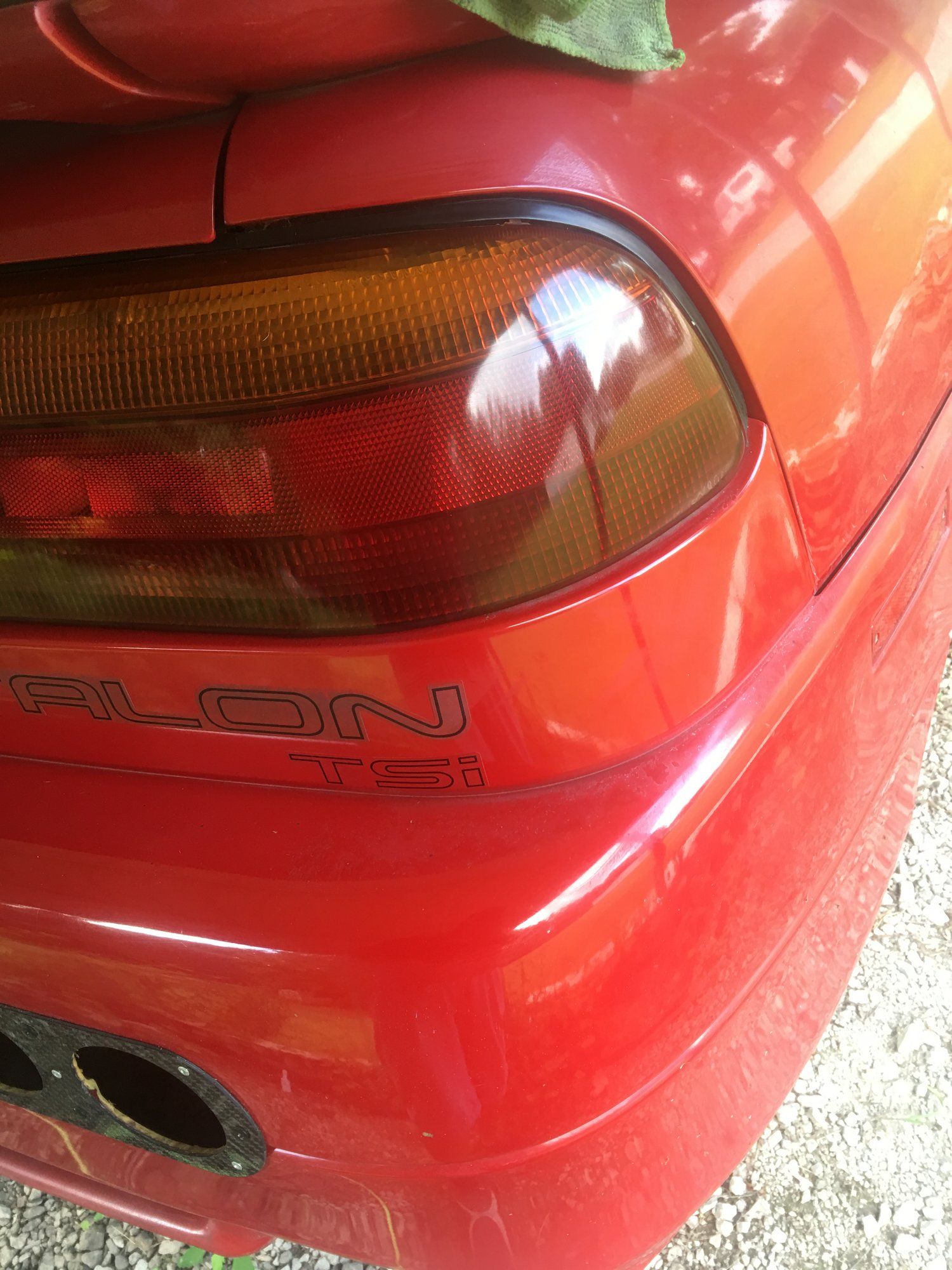

the after polish
this was after the first run of polish. i went back over a couple more times,
some other views of after i got done.
going to have them cleared with some good quality clear coat next.

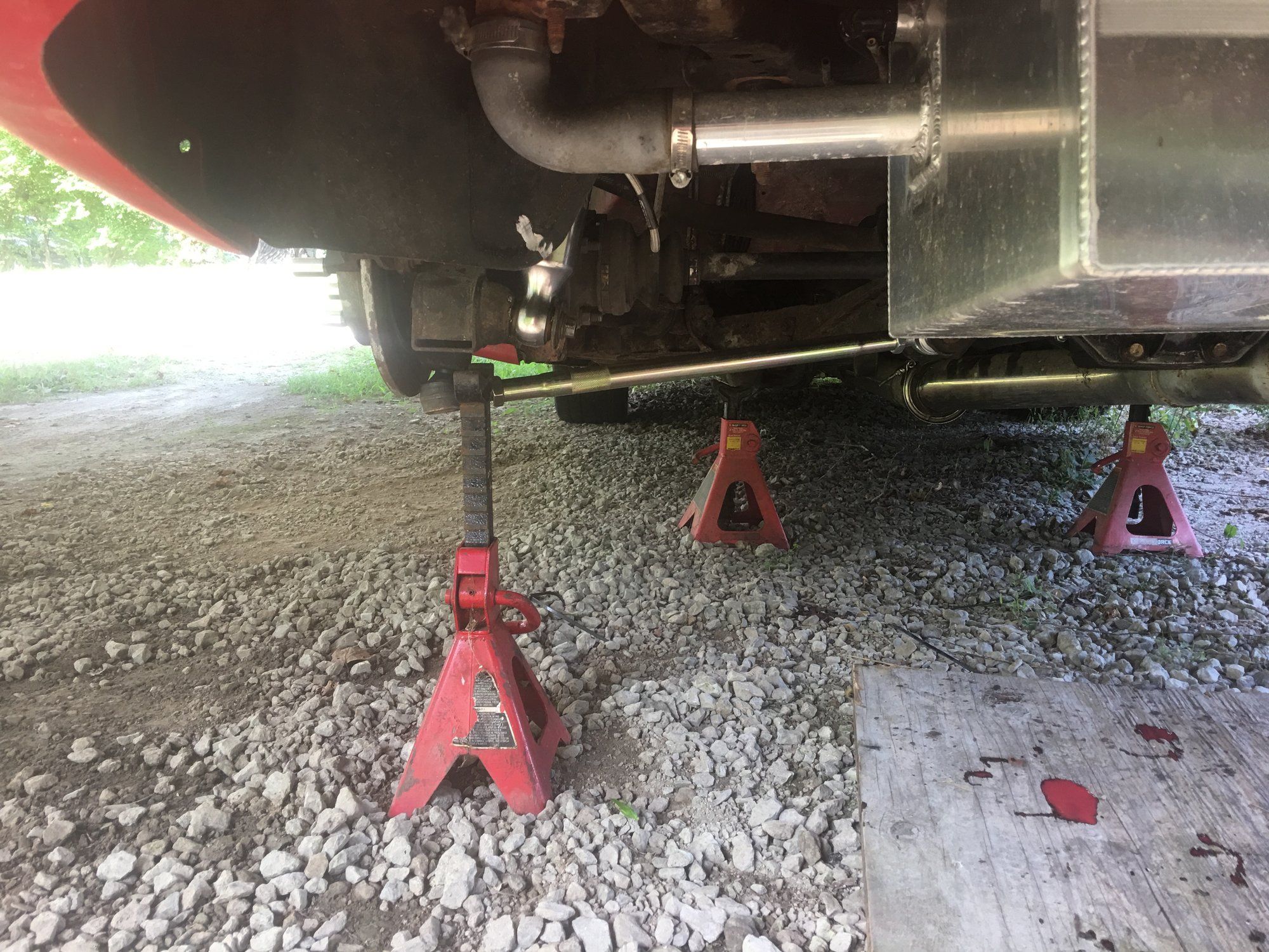

went on vacation last week and finally got a chance to get the rear subframe back up in the car. now to get everything else buttoned back up.

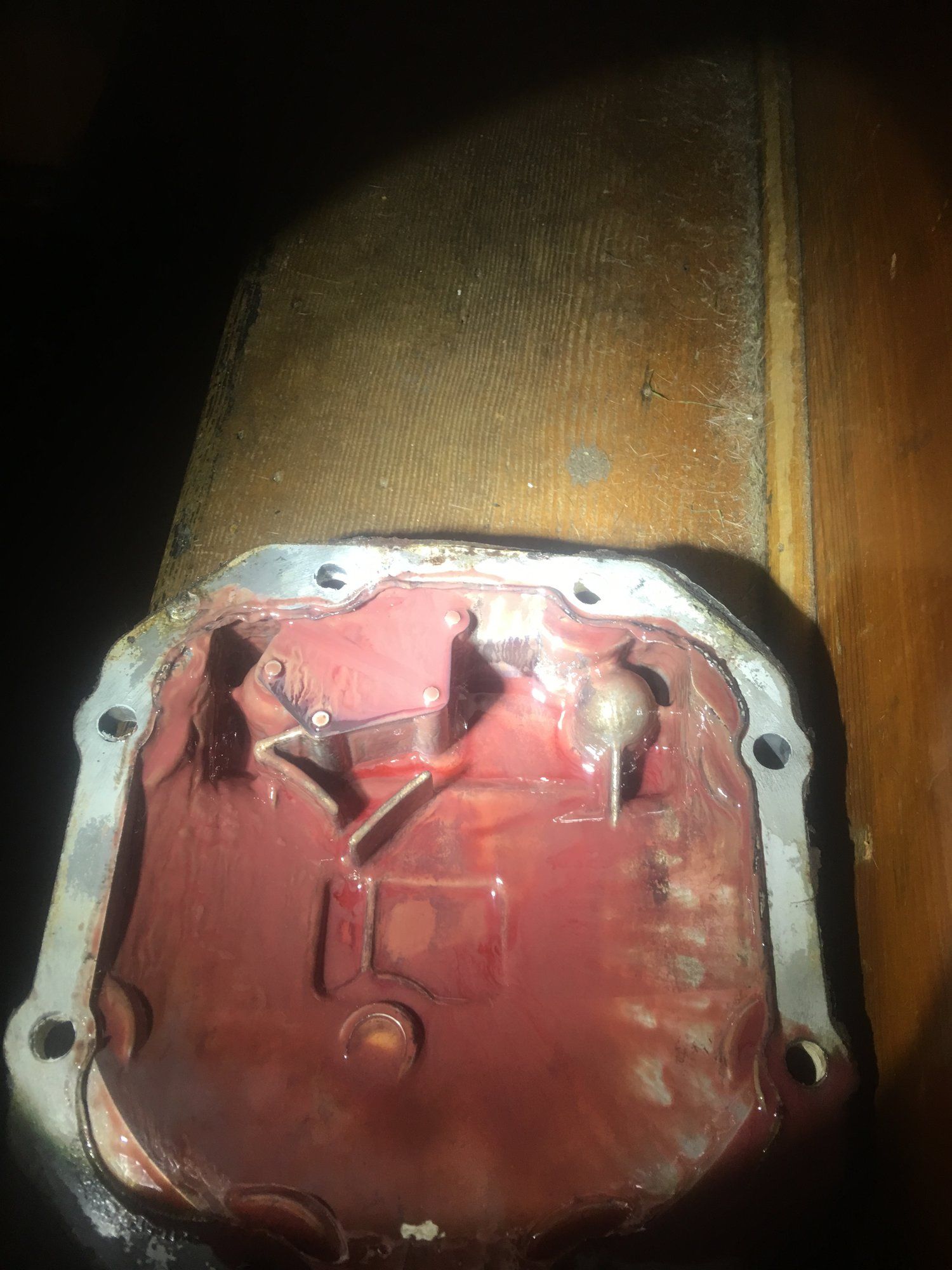

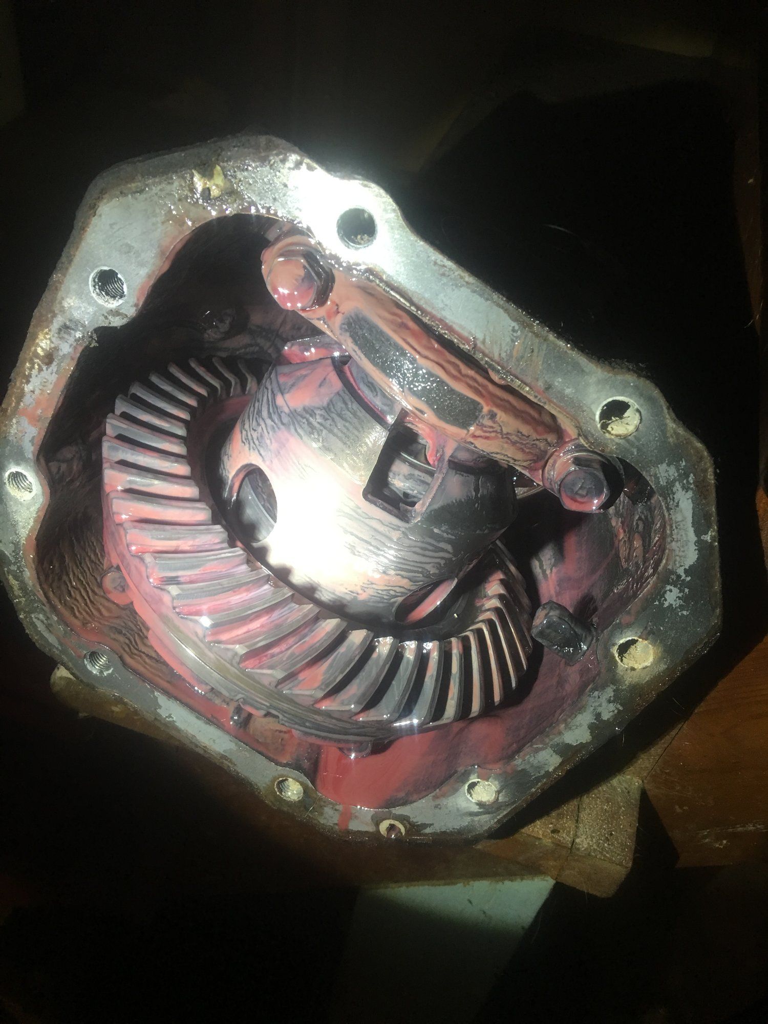

i also took some time to pull the cover off the other diff and to be honest, what i saw wasnt quite what i was expecting after seeing the amount of metal and hearing the noise it was making. honestly looks like water made its way into the housing somehow though. the gear teeth all looked really good but id need to get some marking compound and check the mesh and that to be sure. other than that im kinda stumped.
might send it out and have it looked over and just keep it as a spare.

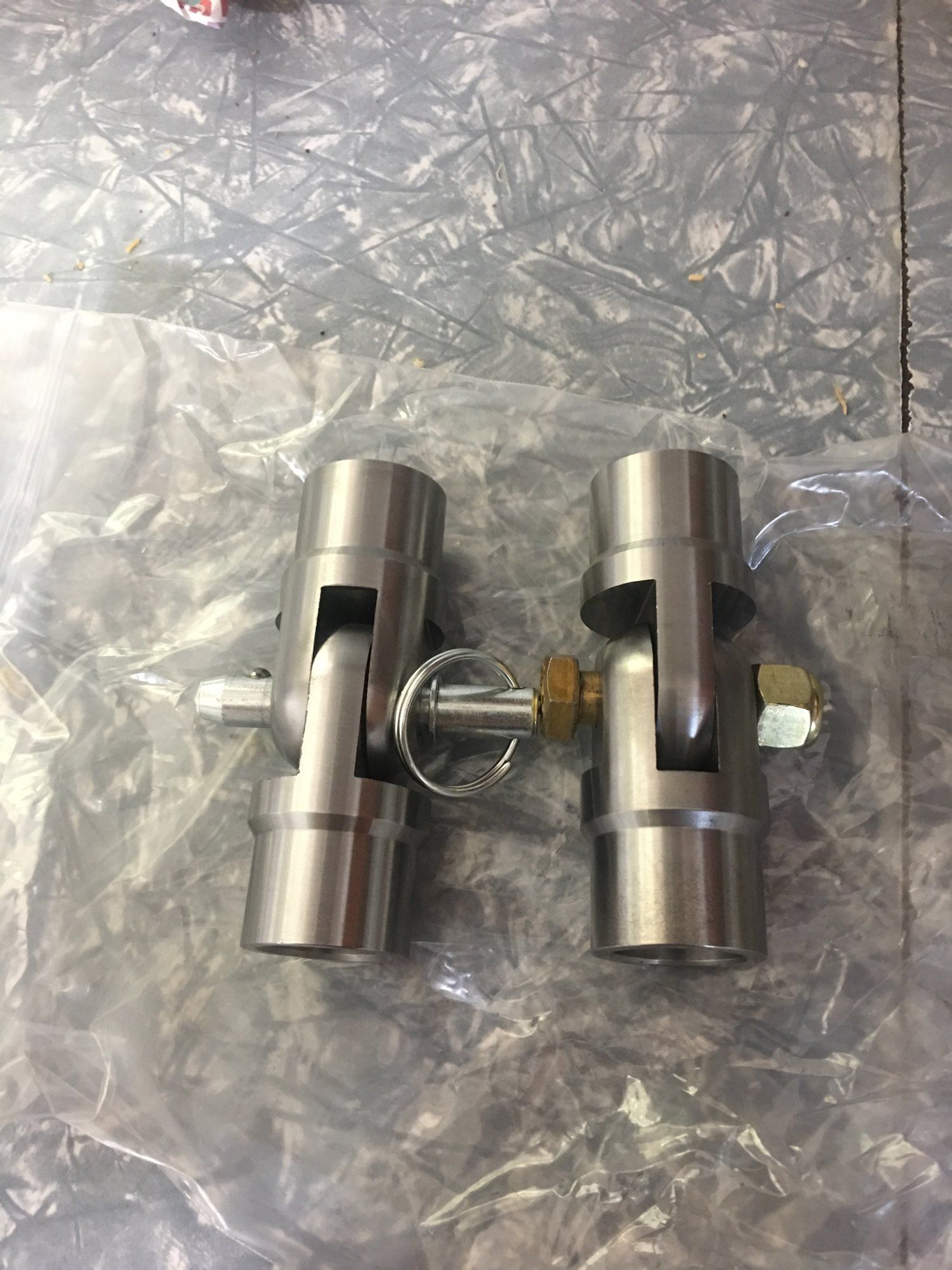

with winter coming up we are planning on finally getting my cage put in. i had bought some competition engineering swingout bars to put in the make the car a little more street friendly but i honestly wasnt too thrilled with the look of them so i decided to change things up a little bit.
bought these units from rhodes race cars. these are their elite series swingout bar kits. these will look so much better than the other set.

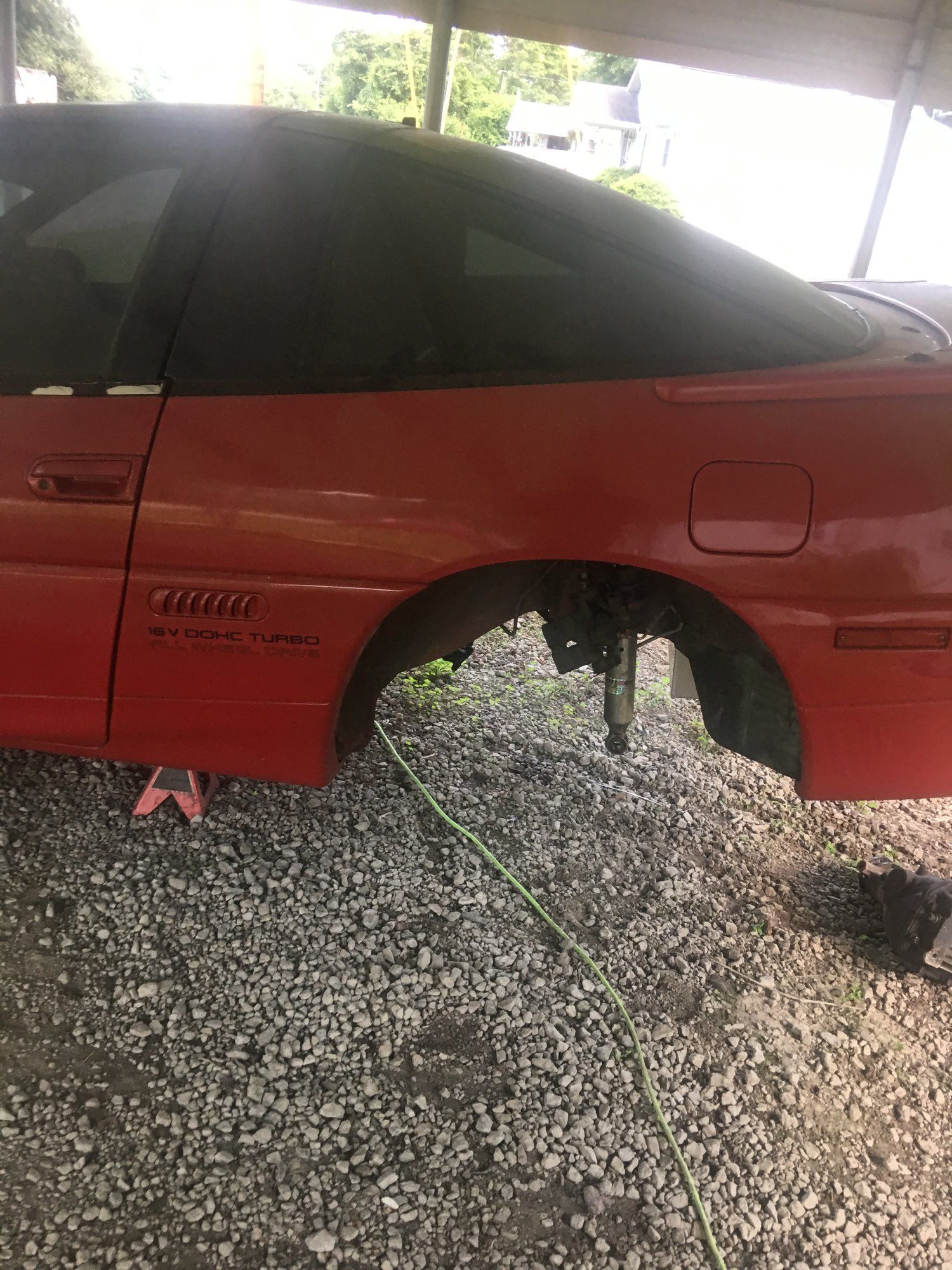

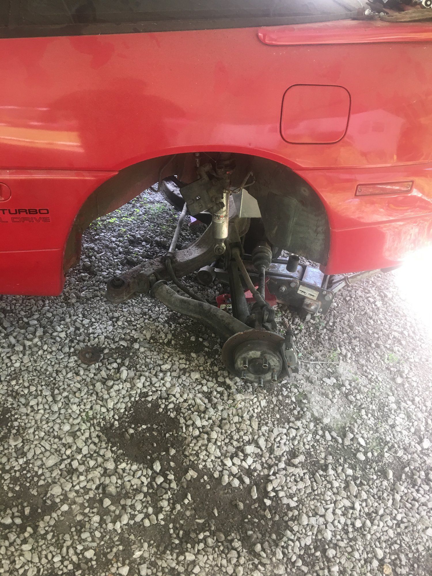

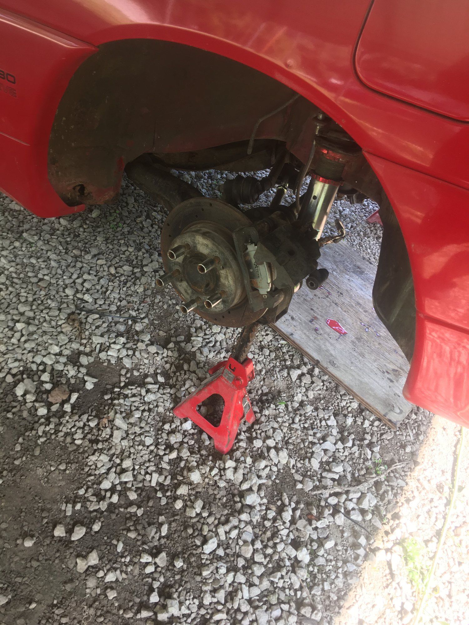

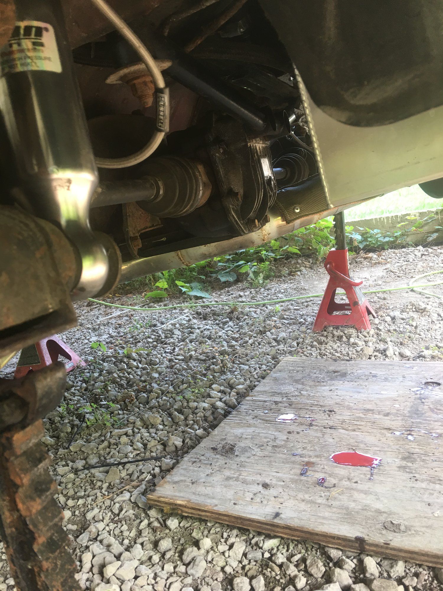

yesterday i finally got some more time to start finishing up the rear end reinstall some. ran into a snag with the rear calipers. had my fiance bring home the piston compressor tool last night from work to get those knocked out.
gonna try to get the calipers compressed and put on tonight when i get off work. then throw wheels back on and drop it down. i think its definitely going to need an alignment before i do much of anything else with the car since i didnt have a good way to measure out the old arms to get proper length. its close but imo not close enough. next thing i need to do is get my transfer case brace on and order my driveshaft loop as well. i dont think itll see the track this year so the plan is to get everything installed and ready for next spring.
and its back on all 4's! gotta throw the seats back in and its definitely going to need an alignment to get the rear camber fixed but its all back together.

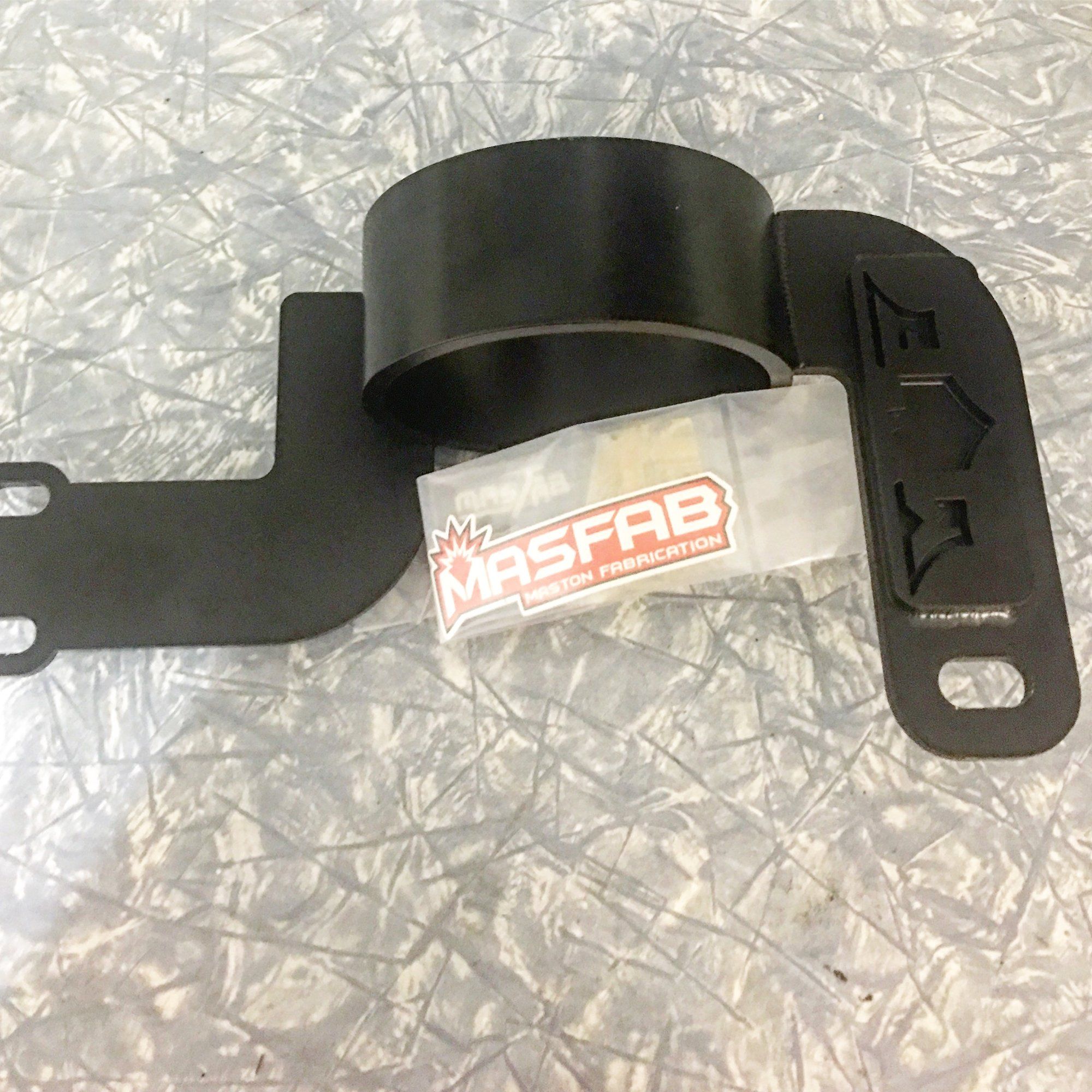

gonna put some miles on it this weekend i think though. i miss driving this damn thing. waiting on my masfab driveshaft loop so i can put it and my brace on.

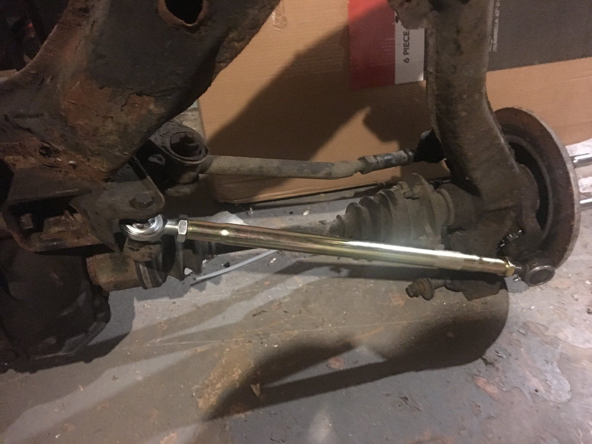

Yeah most of the best parts youll never see or cant, just got the paul volk toe elimintaor next contrl arms.
i keep going back an d forth on getting a set. he was talking about modding the control arms once he does the tubular rear subframs and id hate to buy the kit just to get cut right back off.

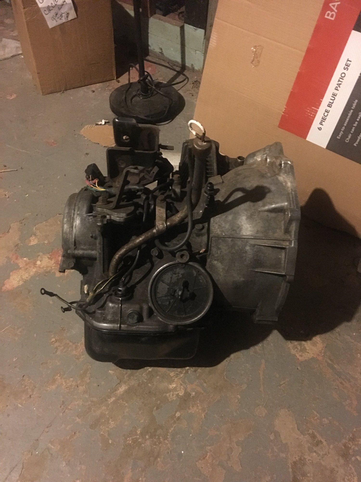

so i got a call from my tuner/buddy that had been parting out his old auto car wanting to know if i wanted a spare trans. i knew the condition of it and after coming to a hell of a deal i picked it up. not sure what route i really want to take with it just yet. the only thing it needs is front clutches. the trans is stone stock at the current moment. not sure if i want to do the basic upgrades to it or slowly start putting the high dollar stuff in it.

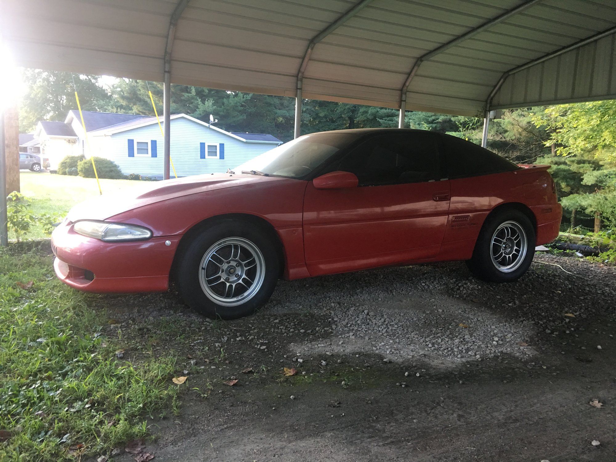

not much of an update. waiting for the ground back to my buddys garage to dry up so i can get it back there to finally get the car tore apart so we can get the cage in. i did however put some more miles on the car yesterday running a few errands while i was off work. then stopped to visit the fiance at work and snapped this pic of our cars together. we are going to be 4g swapping her car once i get my other motor done for the talon.

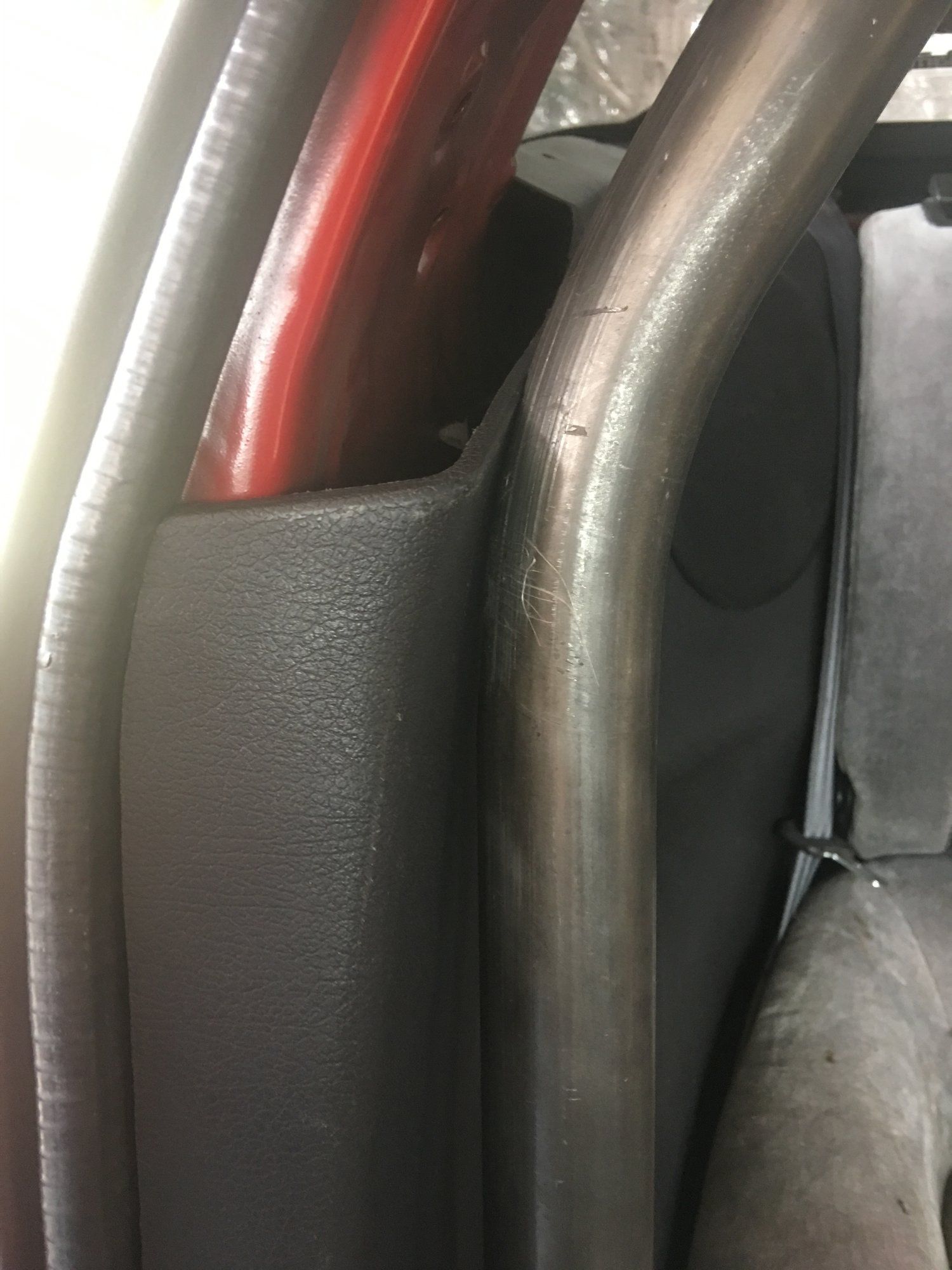

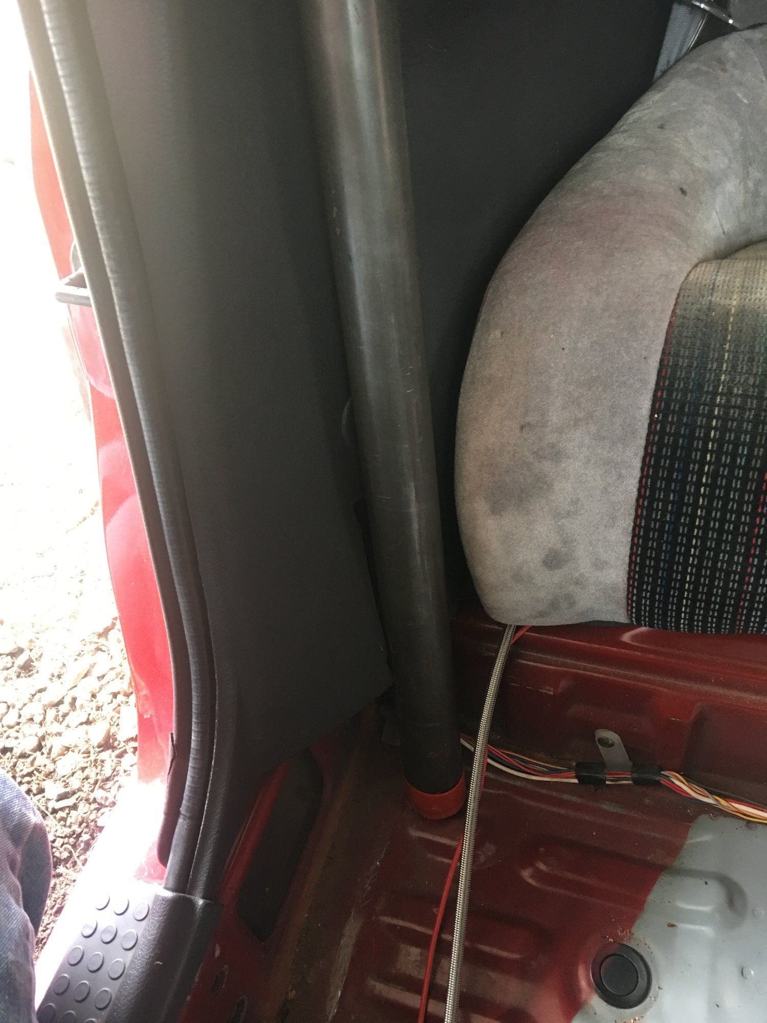

So finally got around to taking the car apart and getting things ready for the cage. Decided to test fit the main hoop in the car. The only issue I had was that since I’m so tall (6’2”) and having the main hoop far enough back where it needs to be according to nhra rules I’ve had to trim some of the bottom b pillar trim in the car.
Trying to decide if I’m going to trim the top side as well where it’s pushing in slightly.
