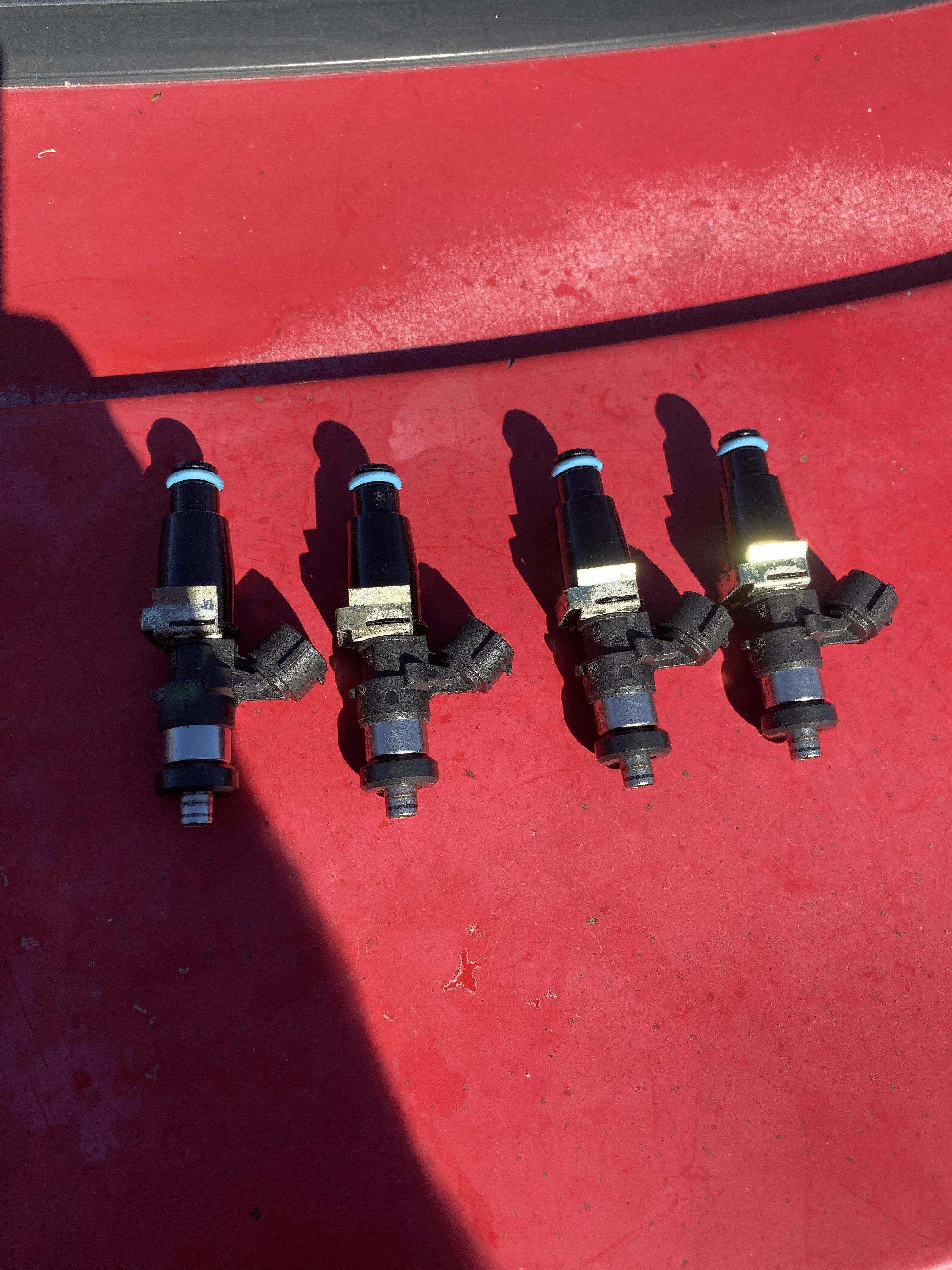

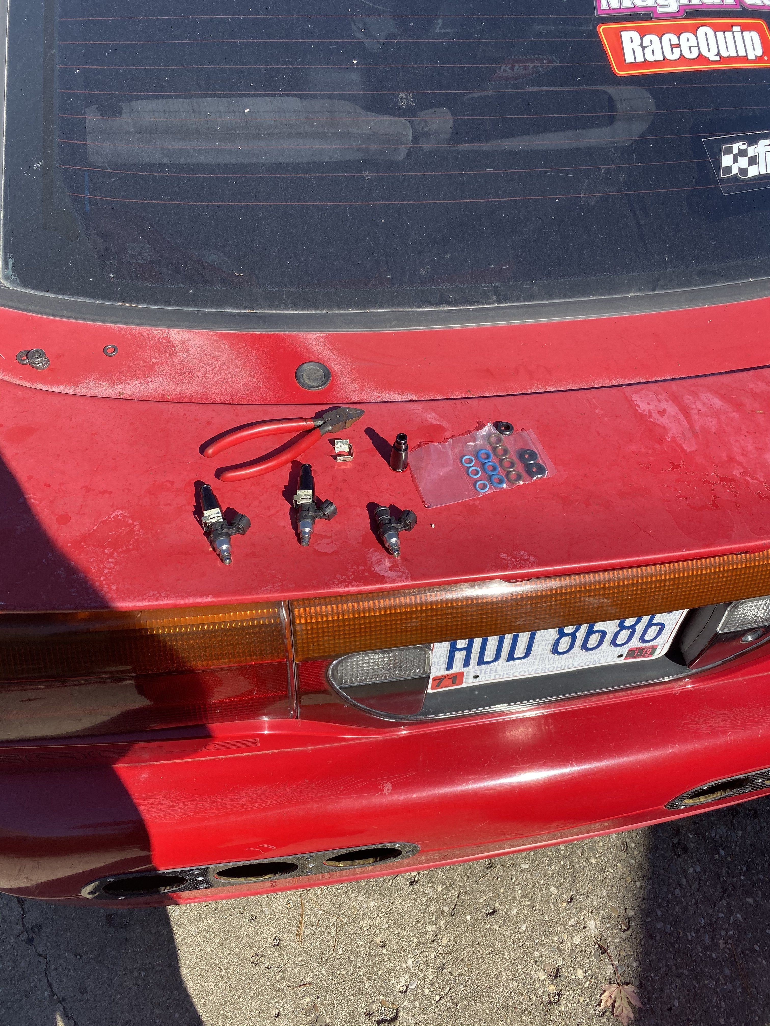

pulled the injectors out and got the seals in them all swapped out
Once I got these back I’m fired the car up to make sure there were no leaks then I wired my wideband back up and calibrated the sensor again. Next on the list is to bolt the harness bar back in and go for a drive.

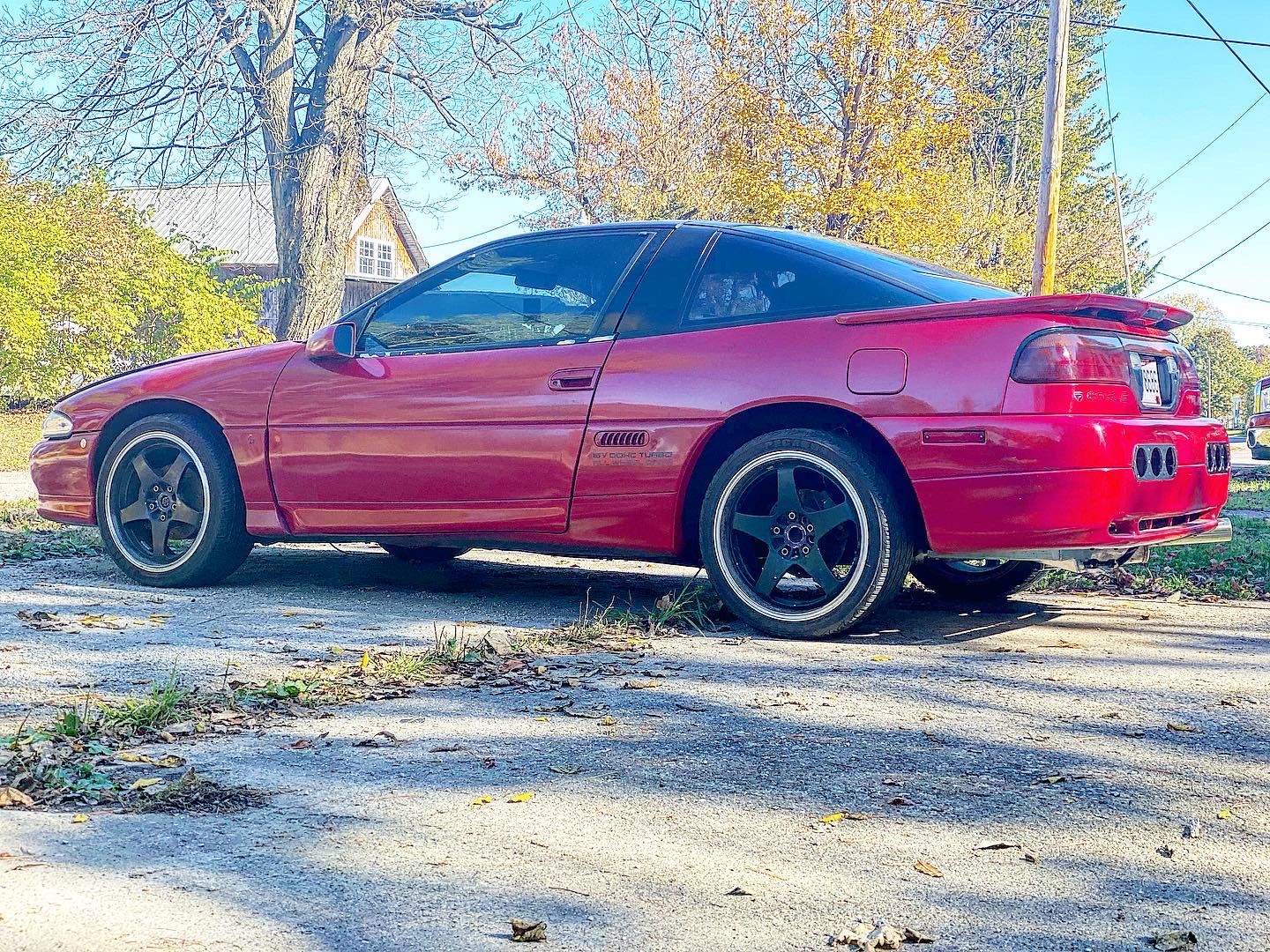

couple shots I took once I got her all back on the ground.

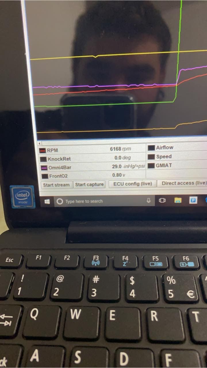

So after a plug change she’s makes some power.
This was right after the 2-3 gear change. This is a combo of 23psi gate springs+ exhaust back pressure+ cool weather LOL. Needless to say the short drive felt pretty damn good LOL

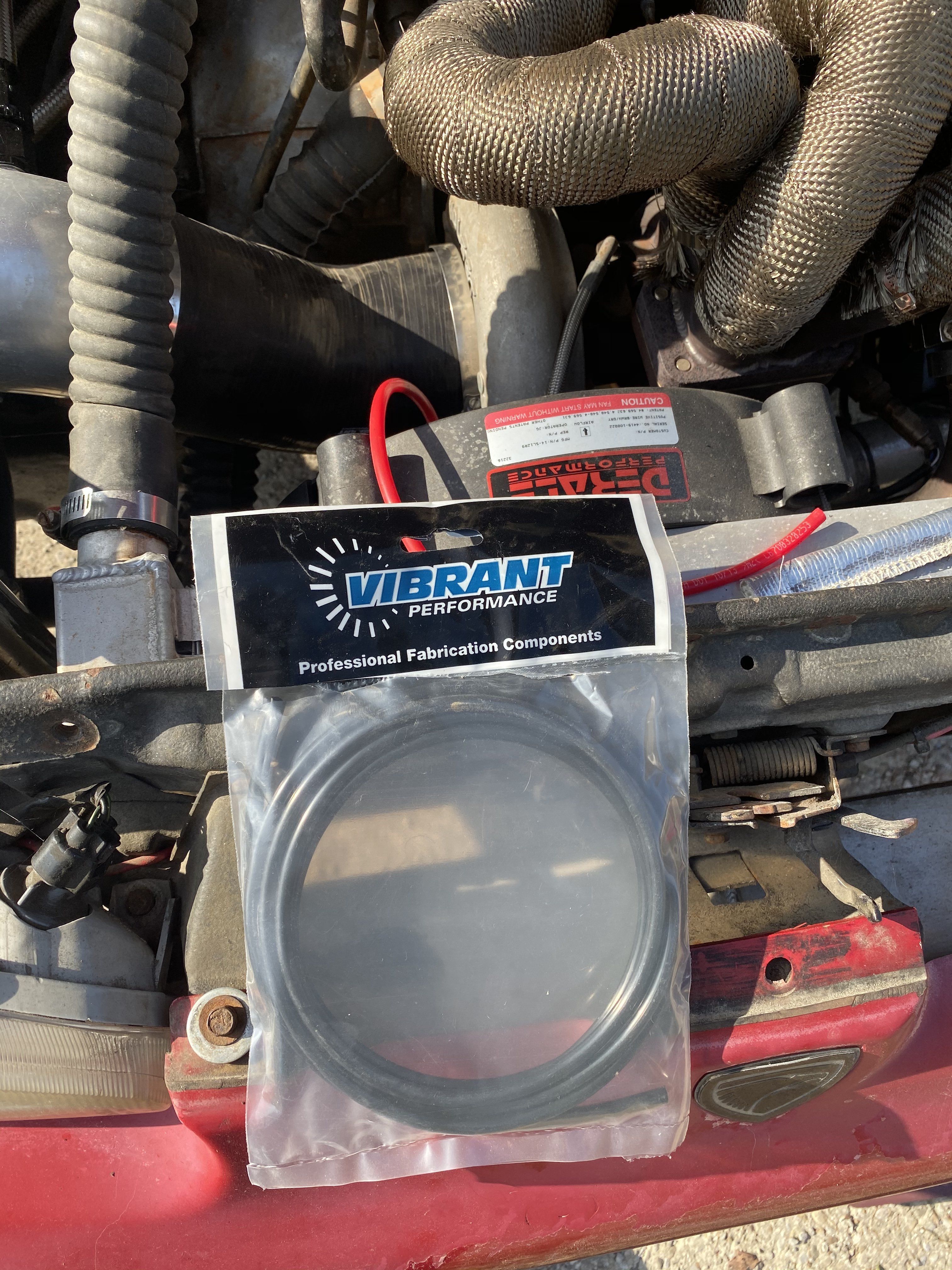

drove it a little more. still runs so good. going to pick up some new fluid for the transfer case and swap it since its the only fluid i havent changed in it recently. also need to find a vent car thing for it because at some point mine fell off. also going to pick up some new line for my wastegate since the red just looks odd to me. need to hit up my local fastenal and get the other fittings i need to change out the other vac lines to the push connect fittings. more on that when i get to it. going to start calling shops again since its winter time to try and get the car in to get caged.

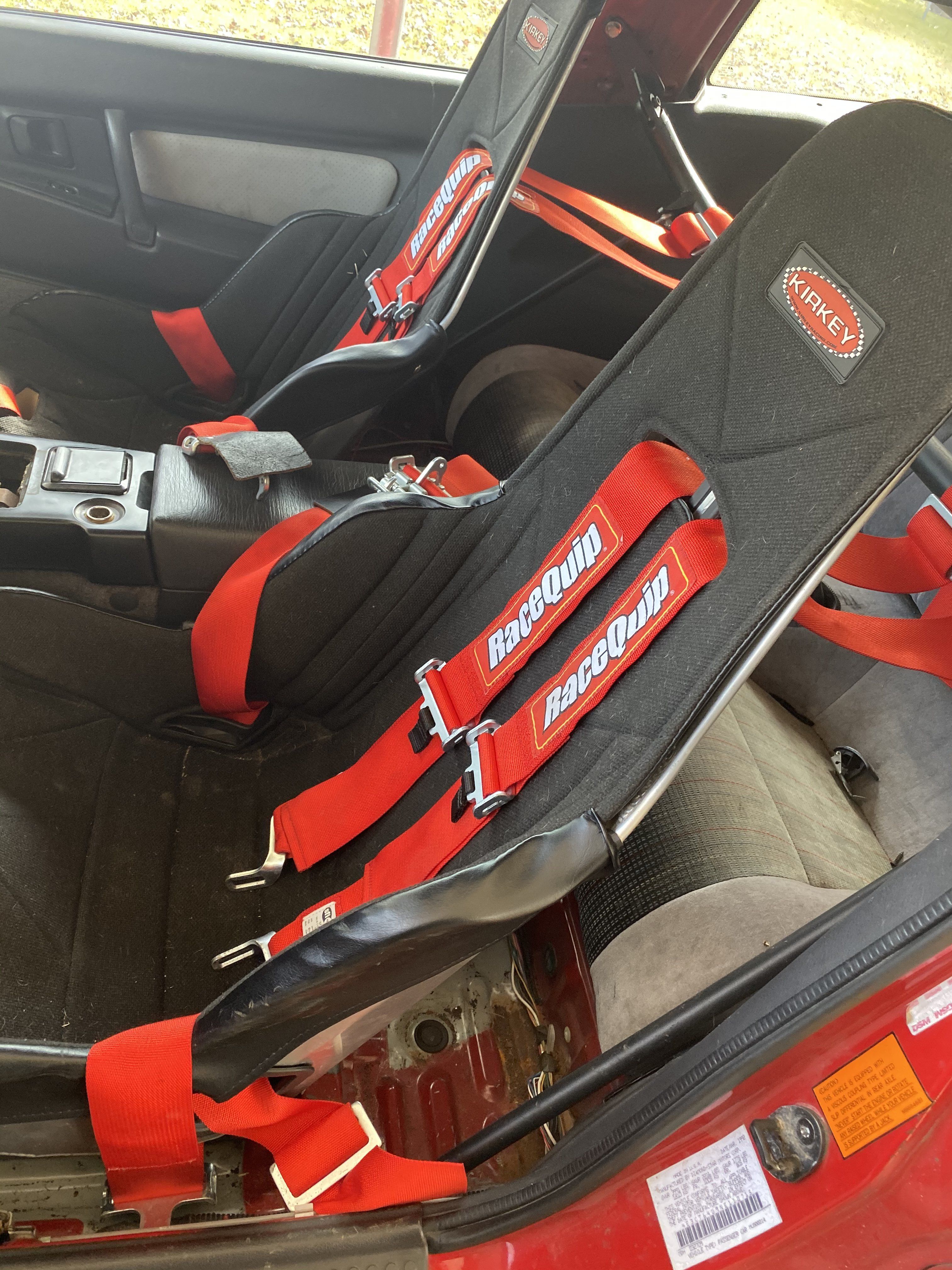

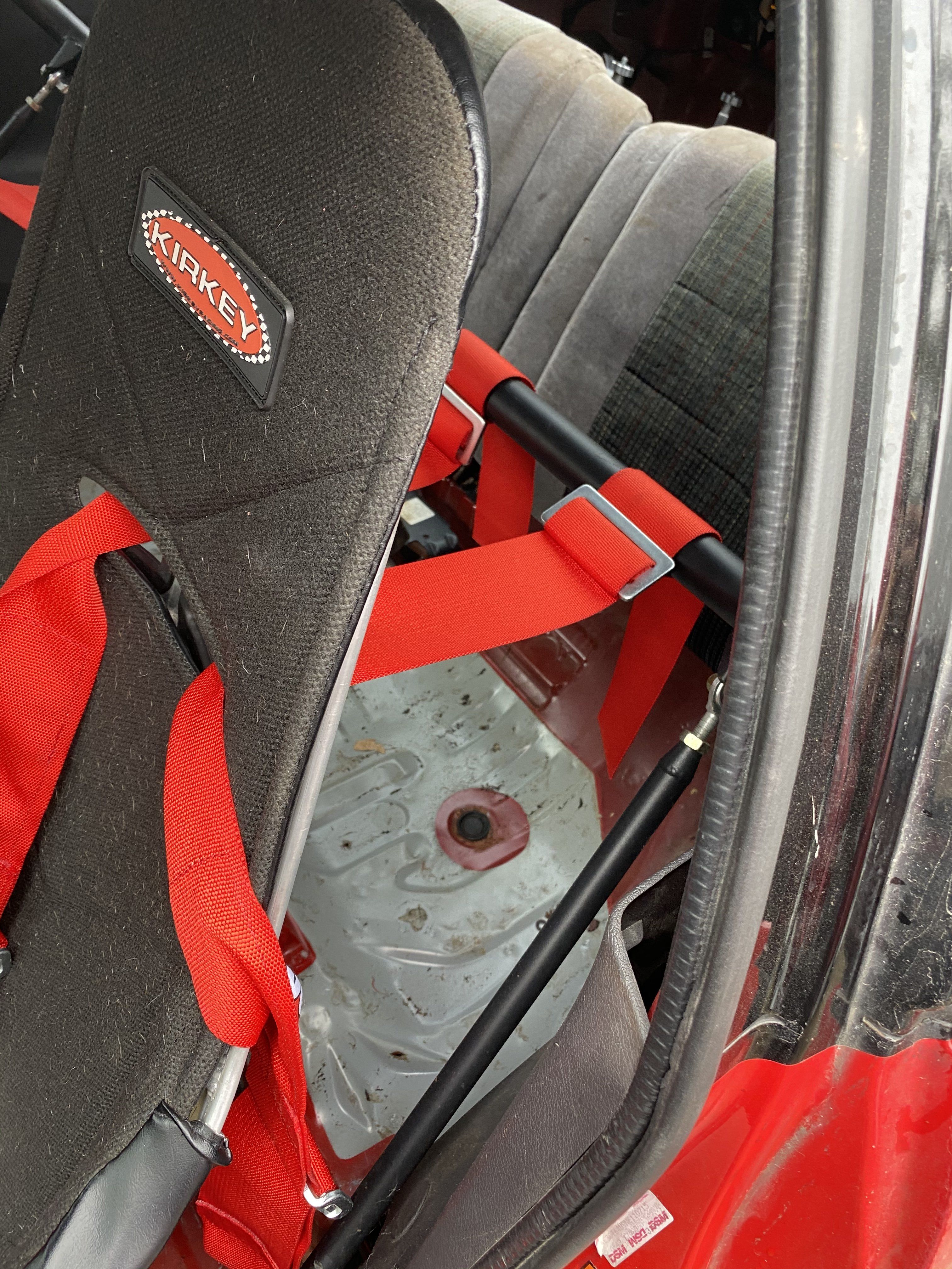

Sunday decided to put the harness bar and harnesses back in the car

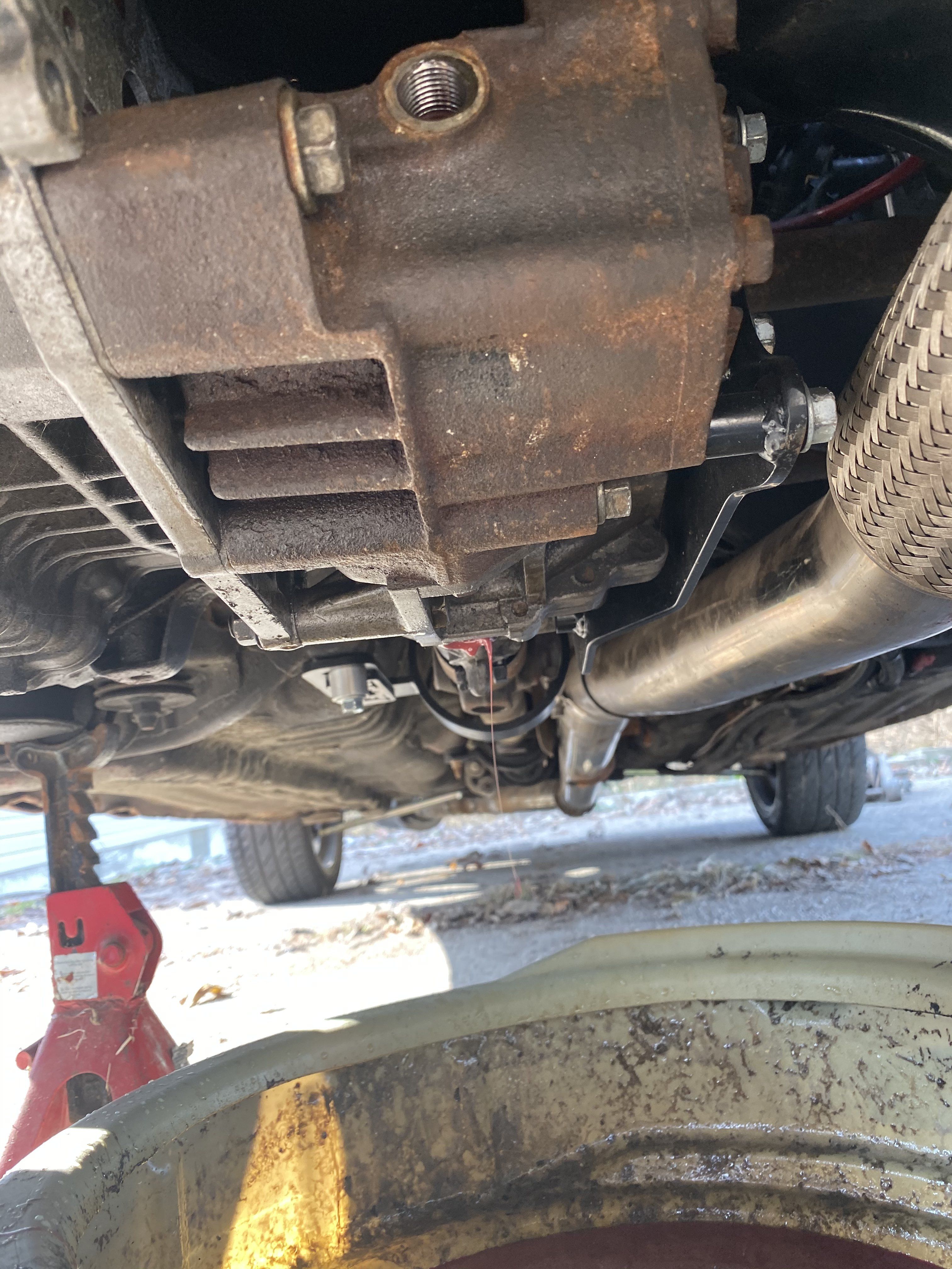

Also got the fluid changed in the transfer case today

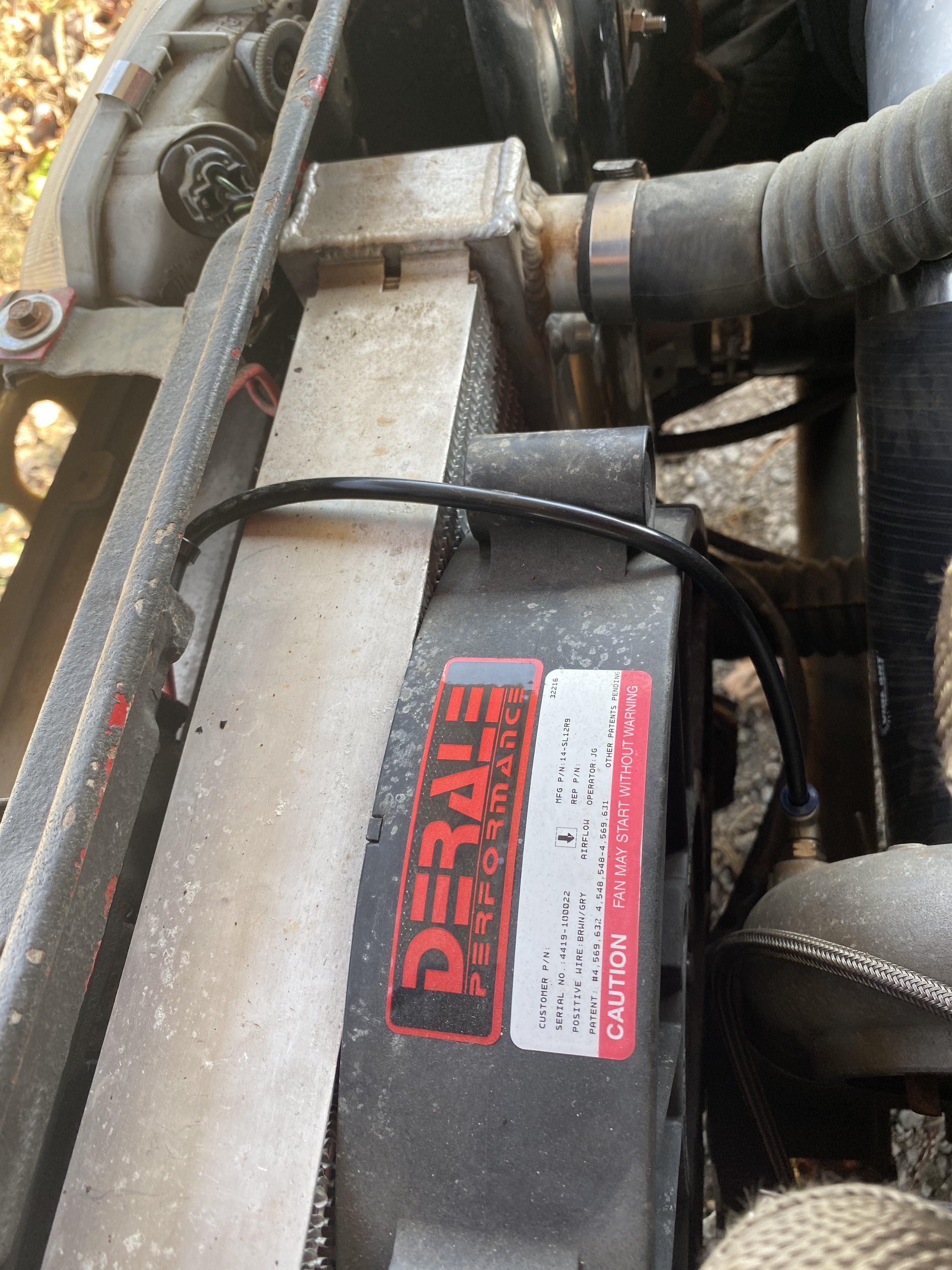

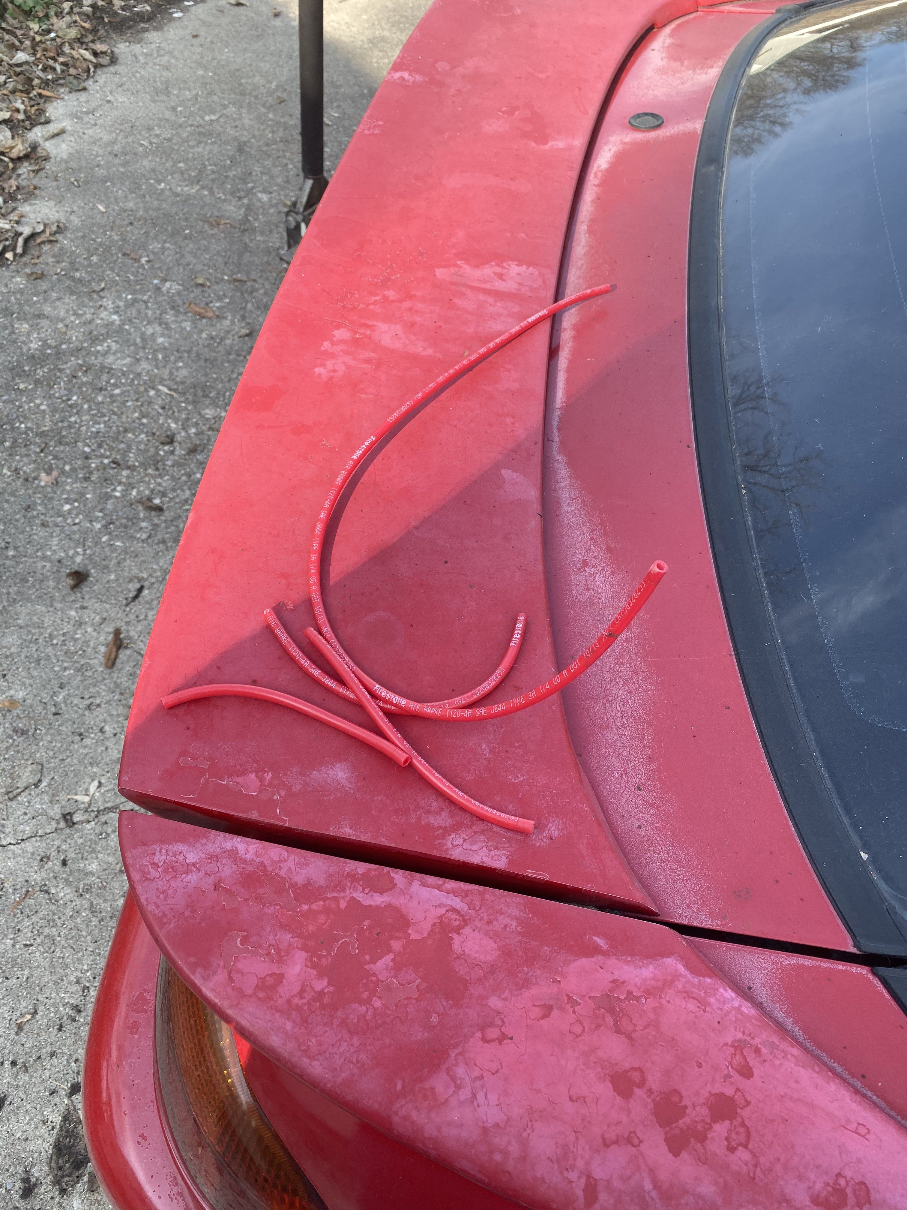

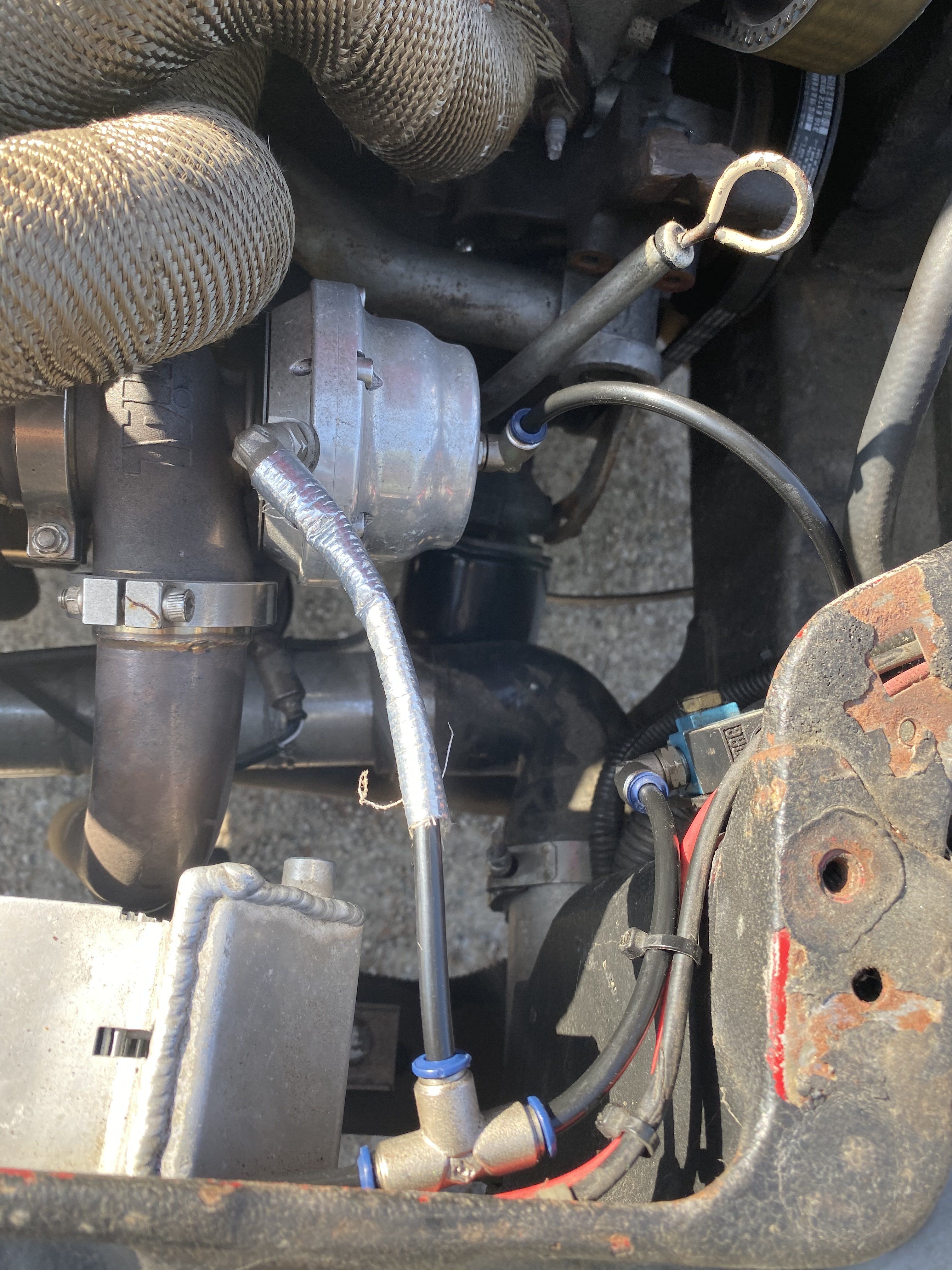

Also decided while I was at it I decided to change the lines on my bcs to black. The red was a temp thing to get things going but I wasn’t a fan on them so they had to go.

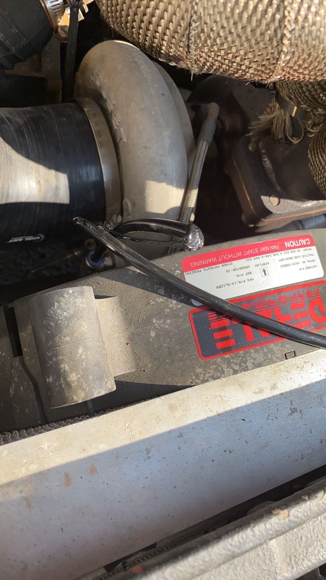

So once this was all done decided to take it on its first real drive. I ran into one issue while I was out running errands
I guess when I made this one I cut it a little fldiffetent and on the drive it decided to touch the manifold and melt. Thankfully I had extra so I just made another one and all was good to go

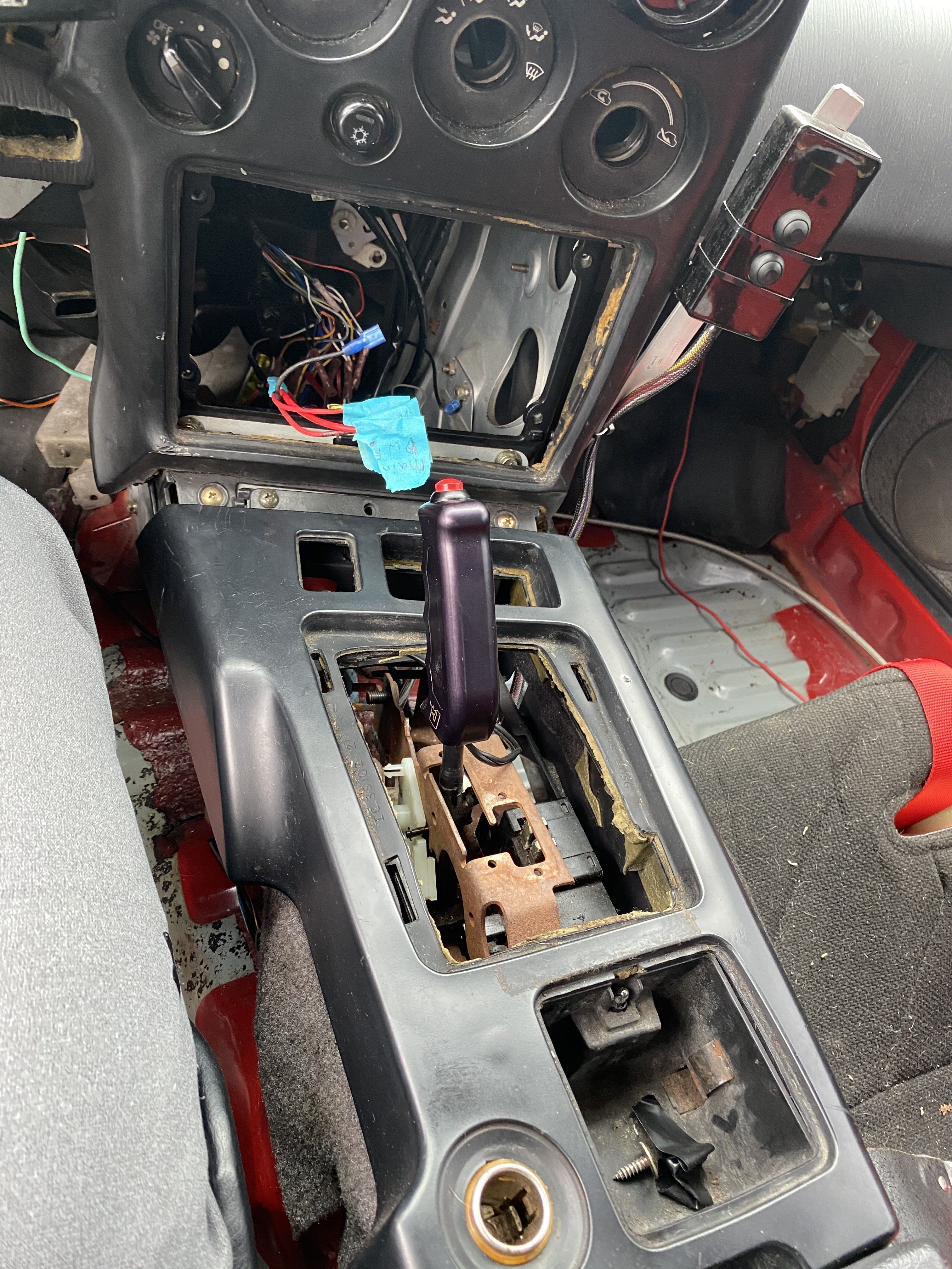

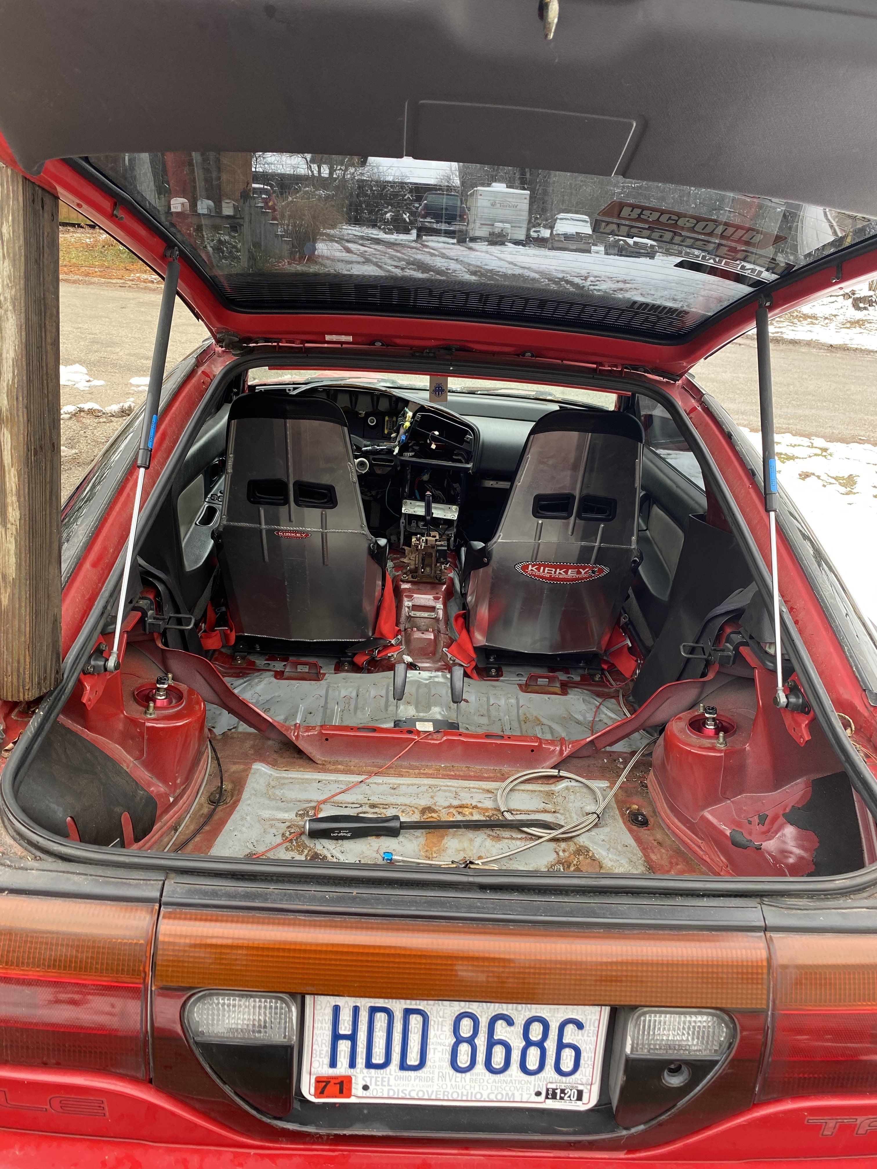

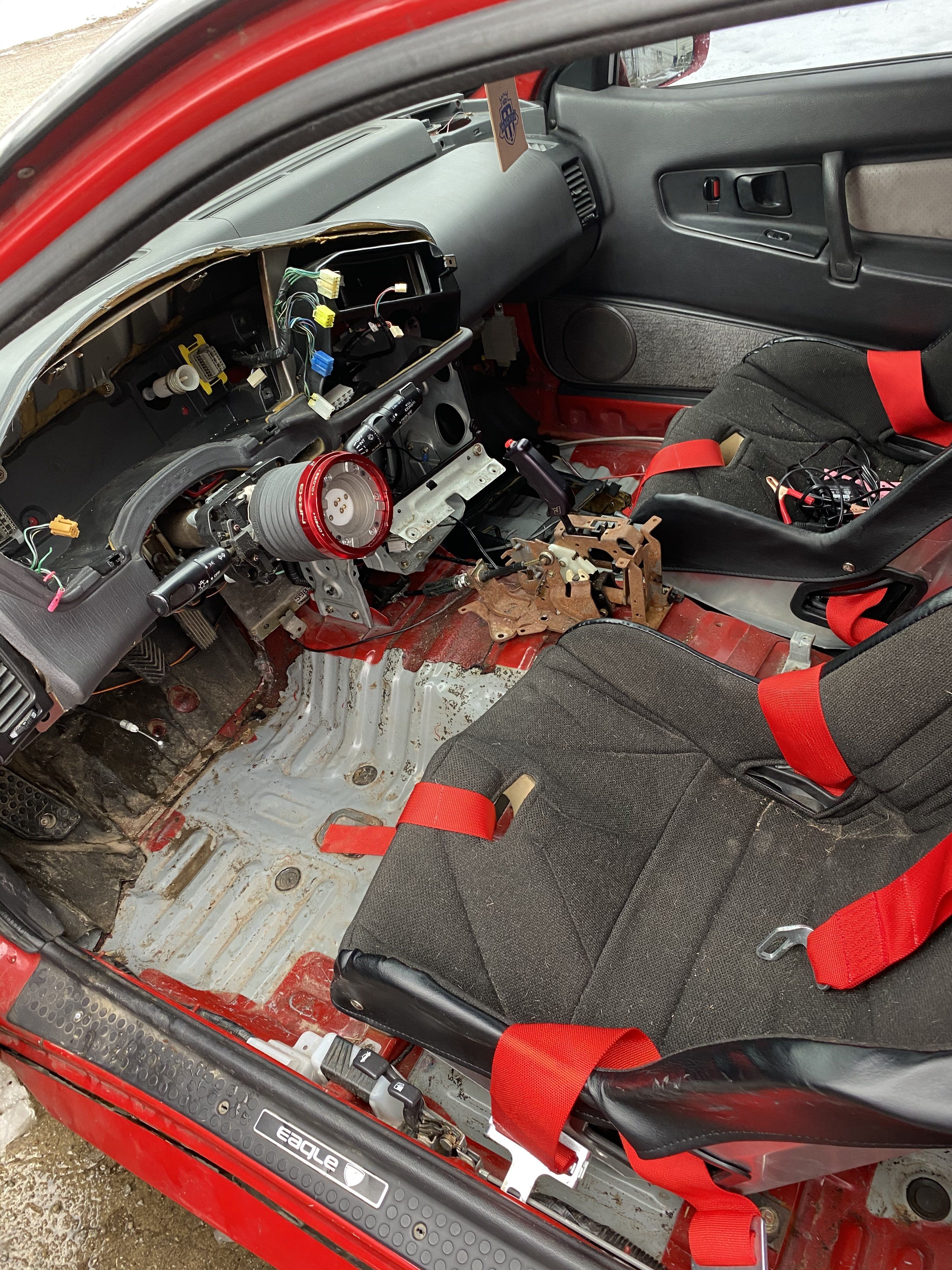

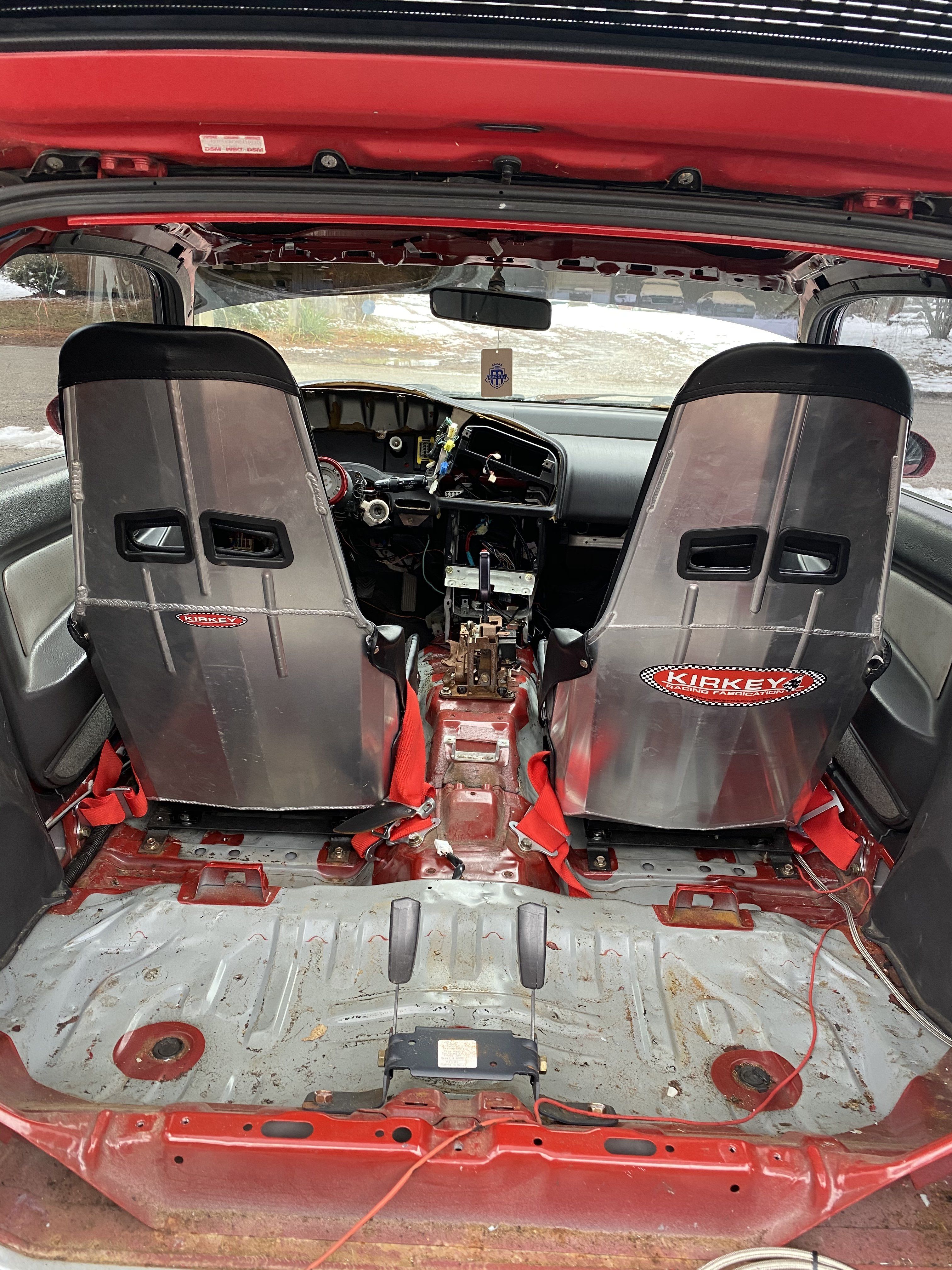

Finally got some time to start pulling the interior back out to go get caged. Got a good chunk out of it. Only thing left is the dash
Next post I make should be of it on a trailer heading to Norwalk
Let us know how hard it is to take out the dash......I need to swap one into another car and don't know if I want to tackle it or not.
Looking forward to the next picture!!!!
Dash has been out a few times LOL it’s not bad at all. Easiest way is to drop the steering column down too. But all that was taken out only took me about an hour. Another 15-20 minutes dash would’ve been out but the fiancé came home and needed some help.
